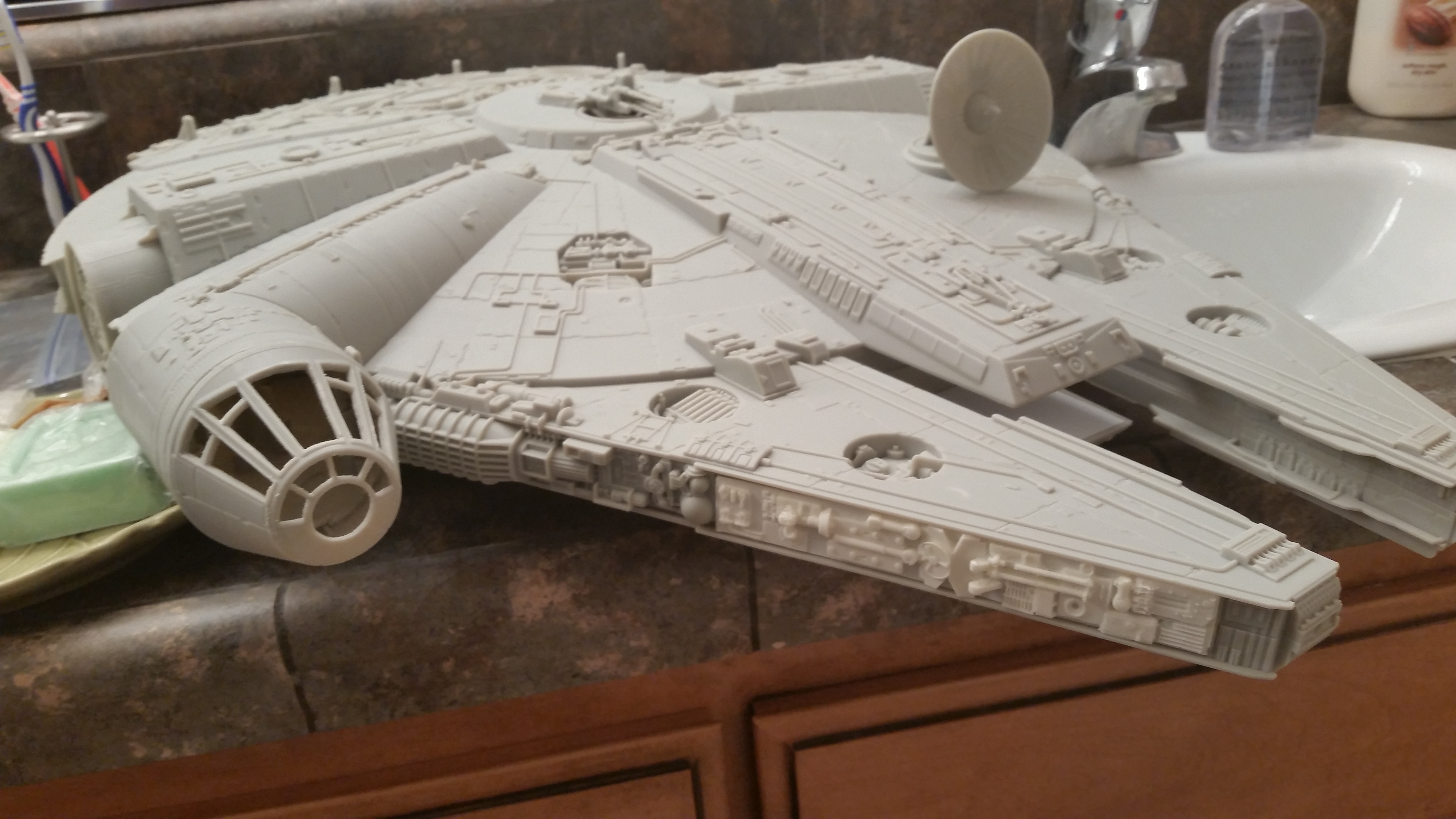

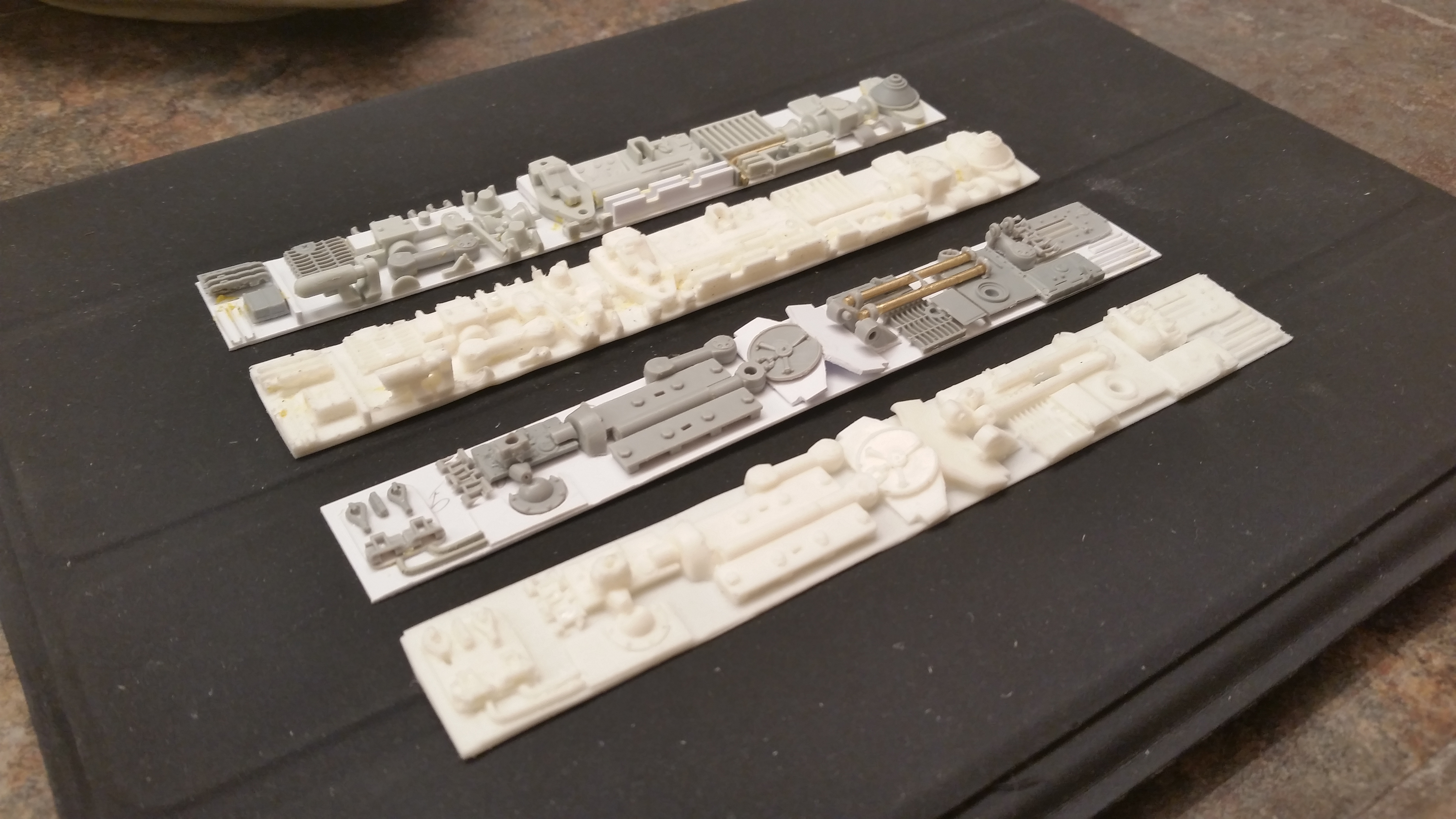

I've started my Falcon back up again. Man it's been a long time. Thanks to all those who've added to this thread in the meantime. I got impatient waiting for the resin sidewalls to come out so I've started making my own. It's better this way so I can reproduce them if I ever do this project again. I used a combination of found model parts and scratch built parts to produce sidewalls that resemble the 32" Falcon. They came out pretty close and after I molded and cast them I thought they looked pretty darn good. I have the Shapeways cockpit components on there way also. I can't wait to get my hands on those engine vent grills with inside detail too.
Here is a test fitting (Not glued on yet).
Kokkari, Very nice! Any chance you want to sell me a set?
Still waiting for the resin kit...I'm also the same where you are... just got my Blue LEDs.....getting started on those..
Sure, I'm willing to sell sets when I'm finished. Still working on them though.
