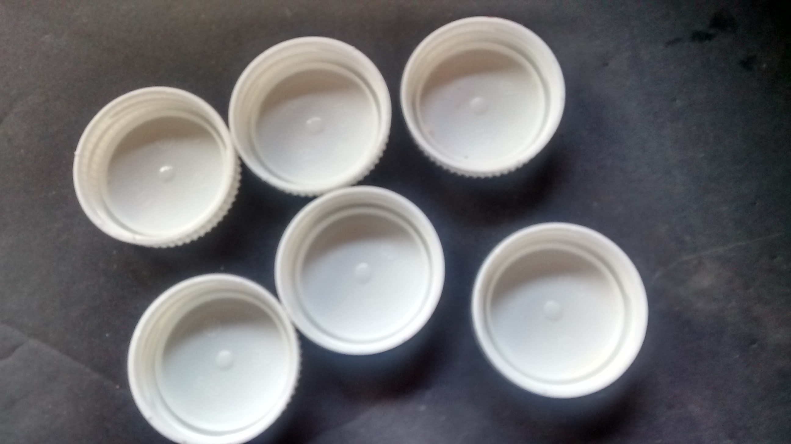

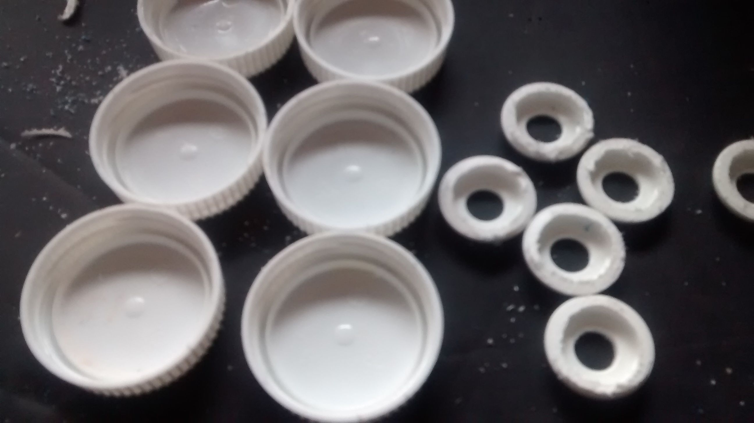

Just to wet your appetite, I am working on my inserts, and have a found a real cheap way of doing them, just using bottle tops, will post photos from my camera phone when I can find my USB cable.

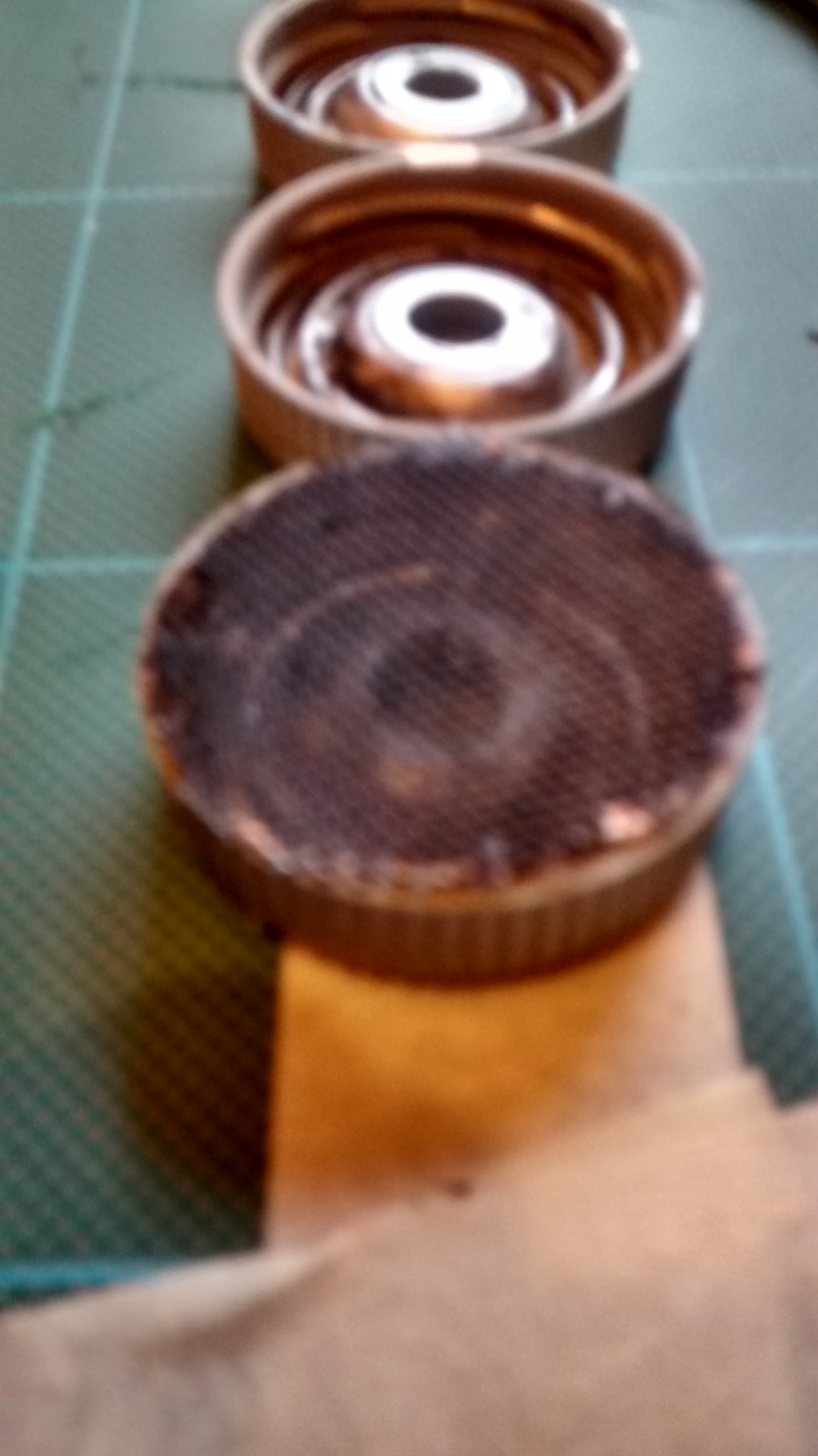

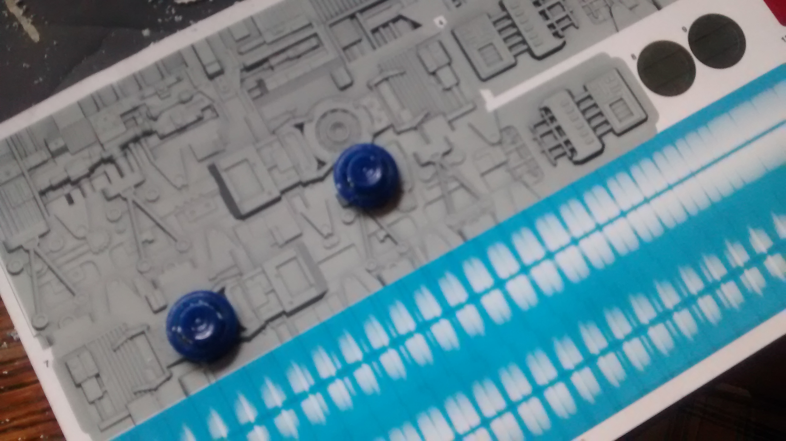

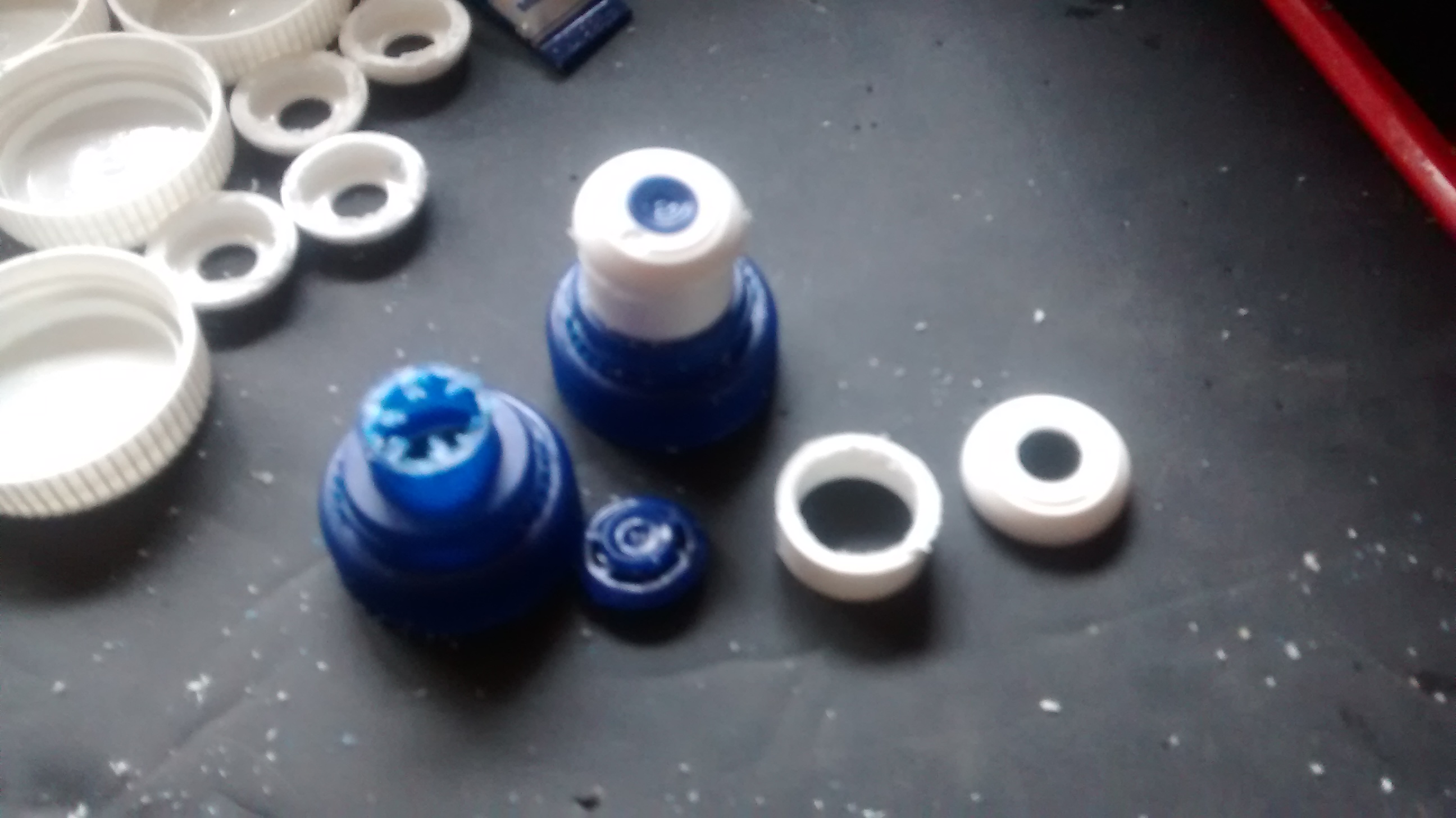

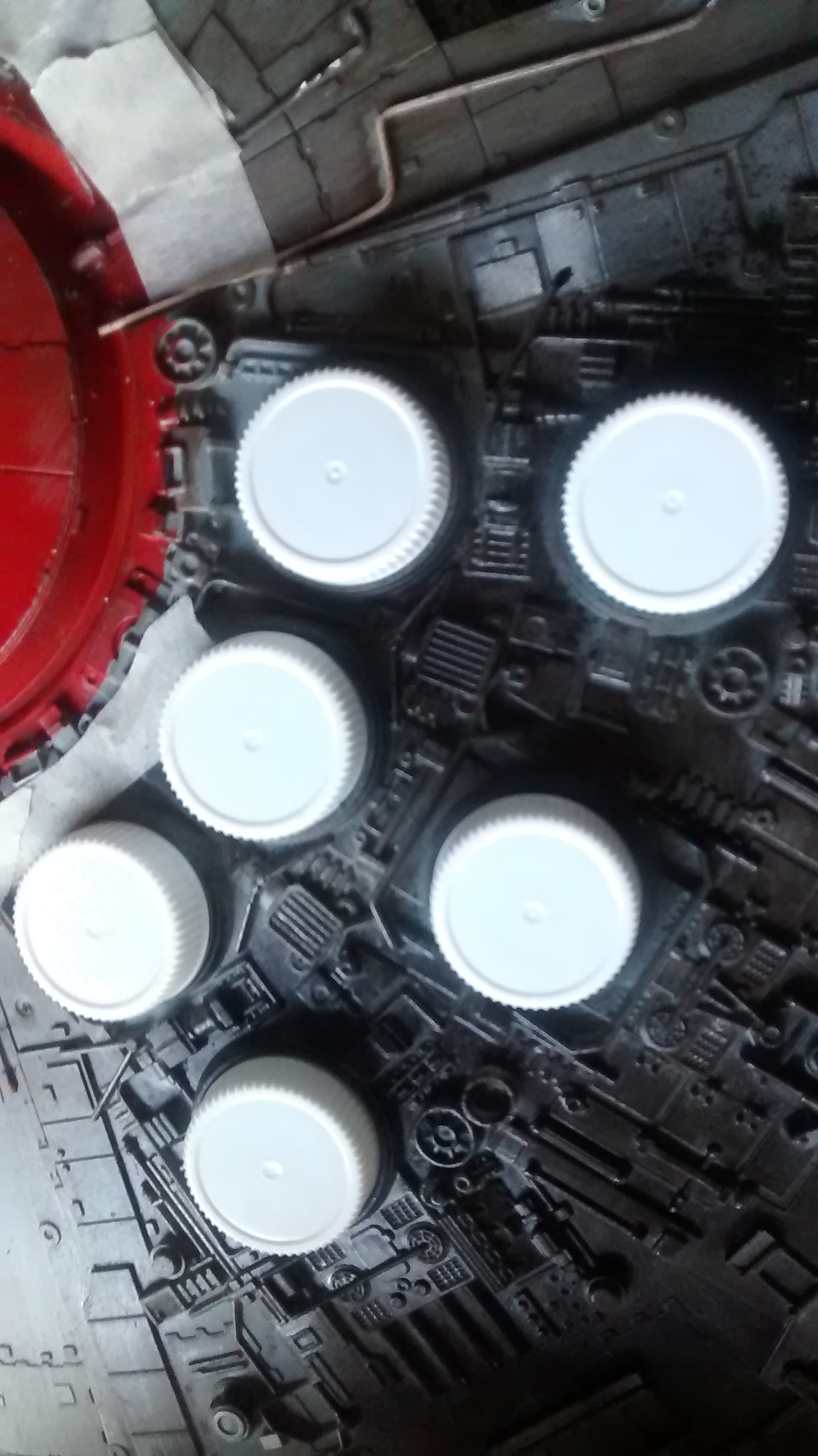

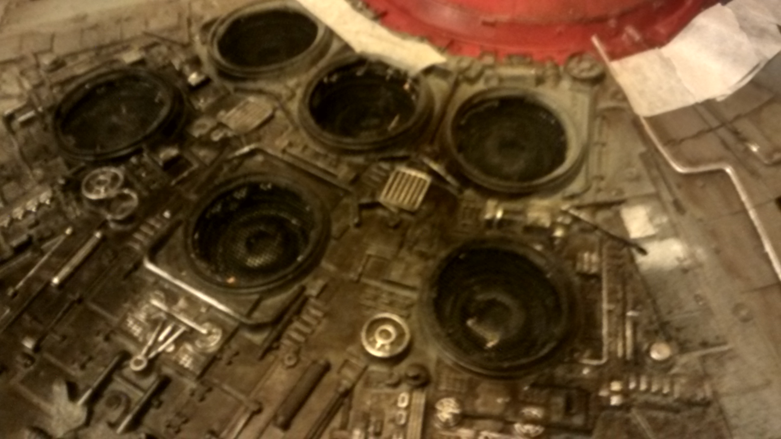

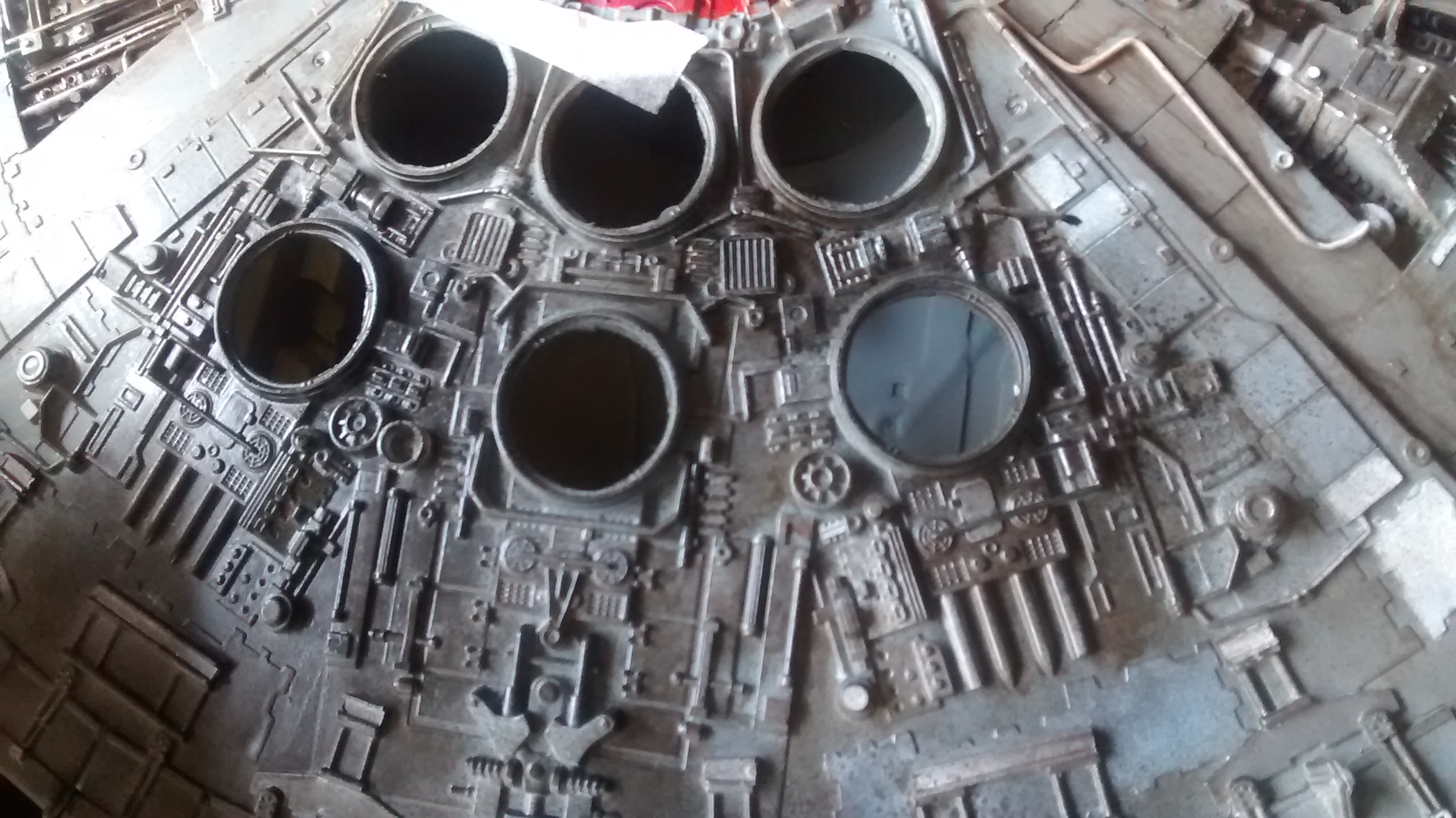

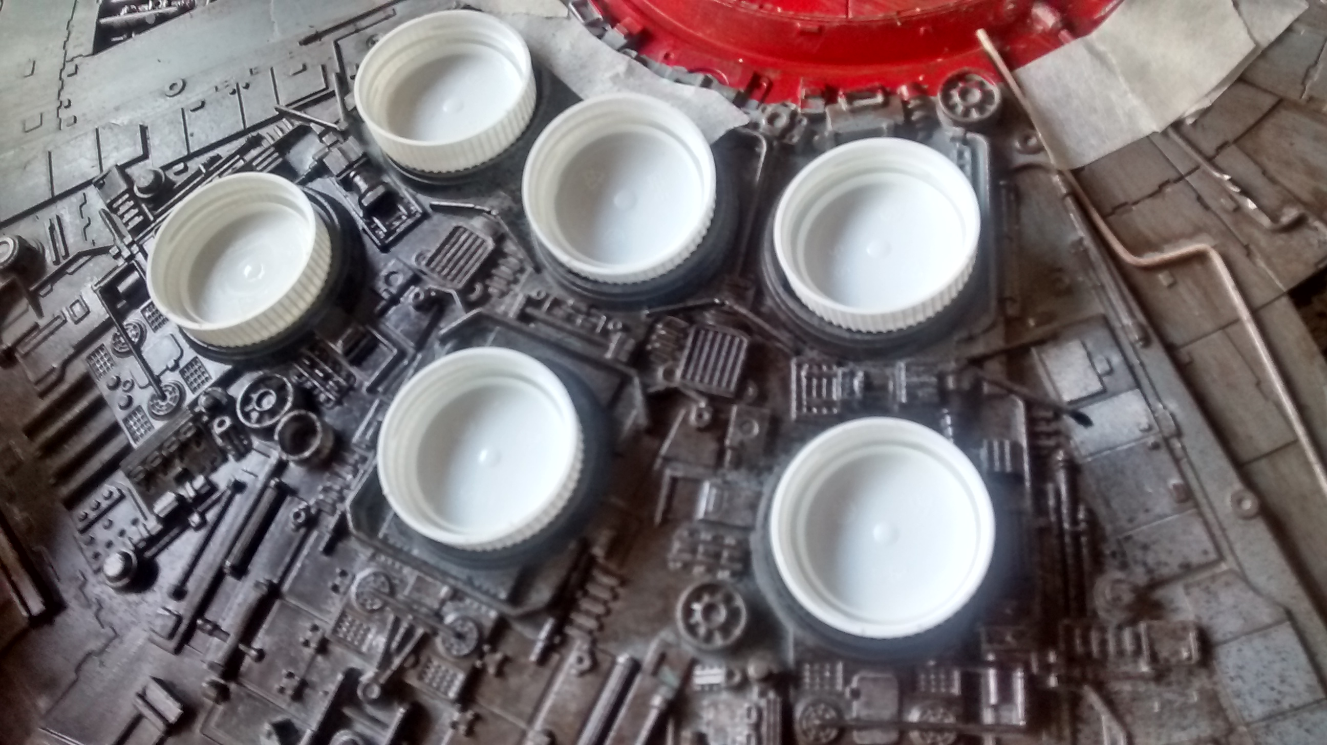

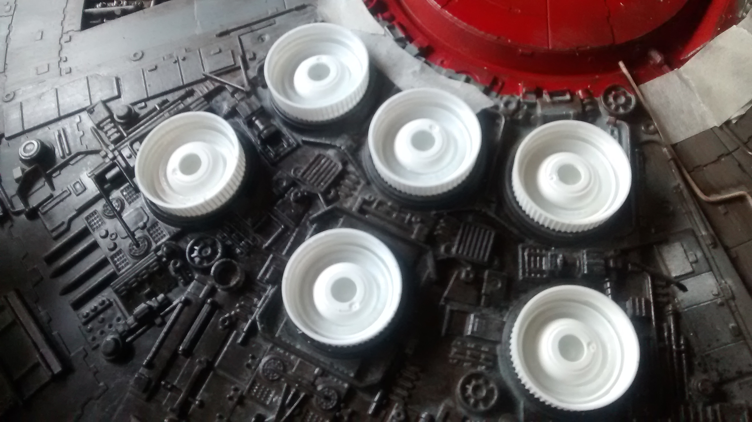

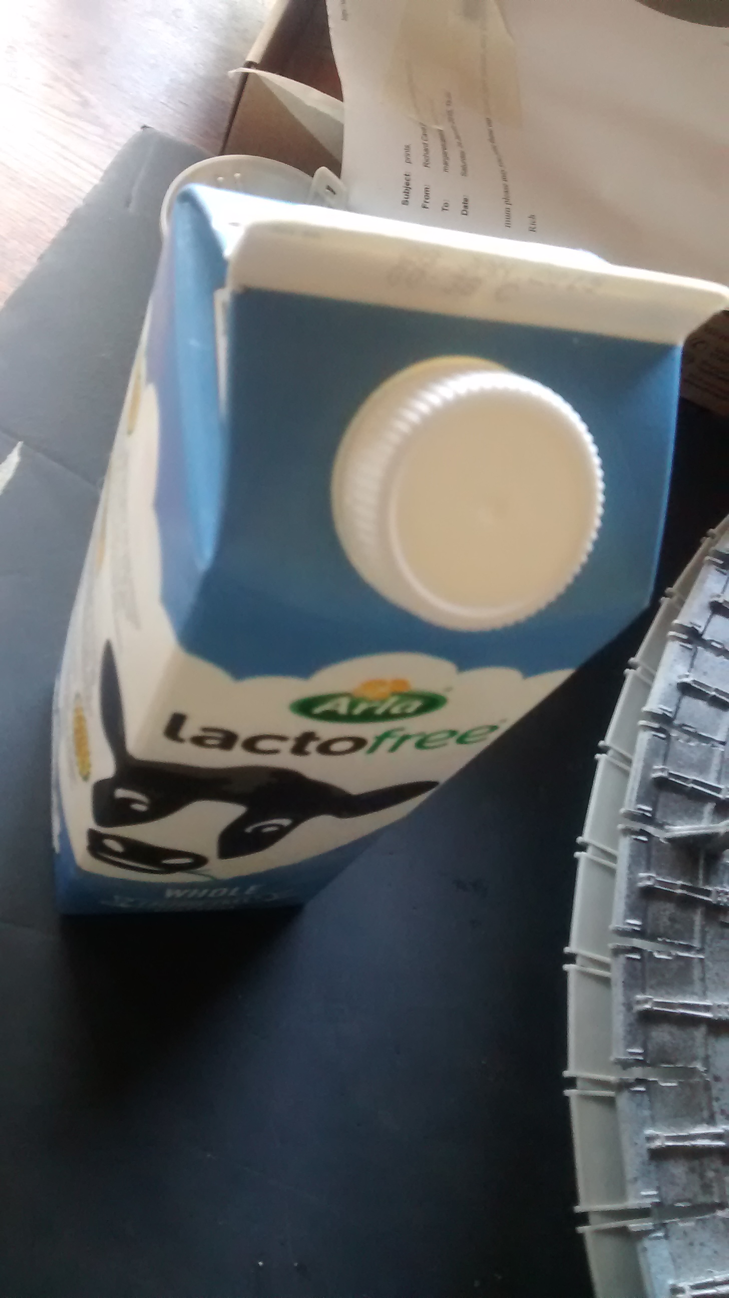

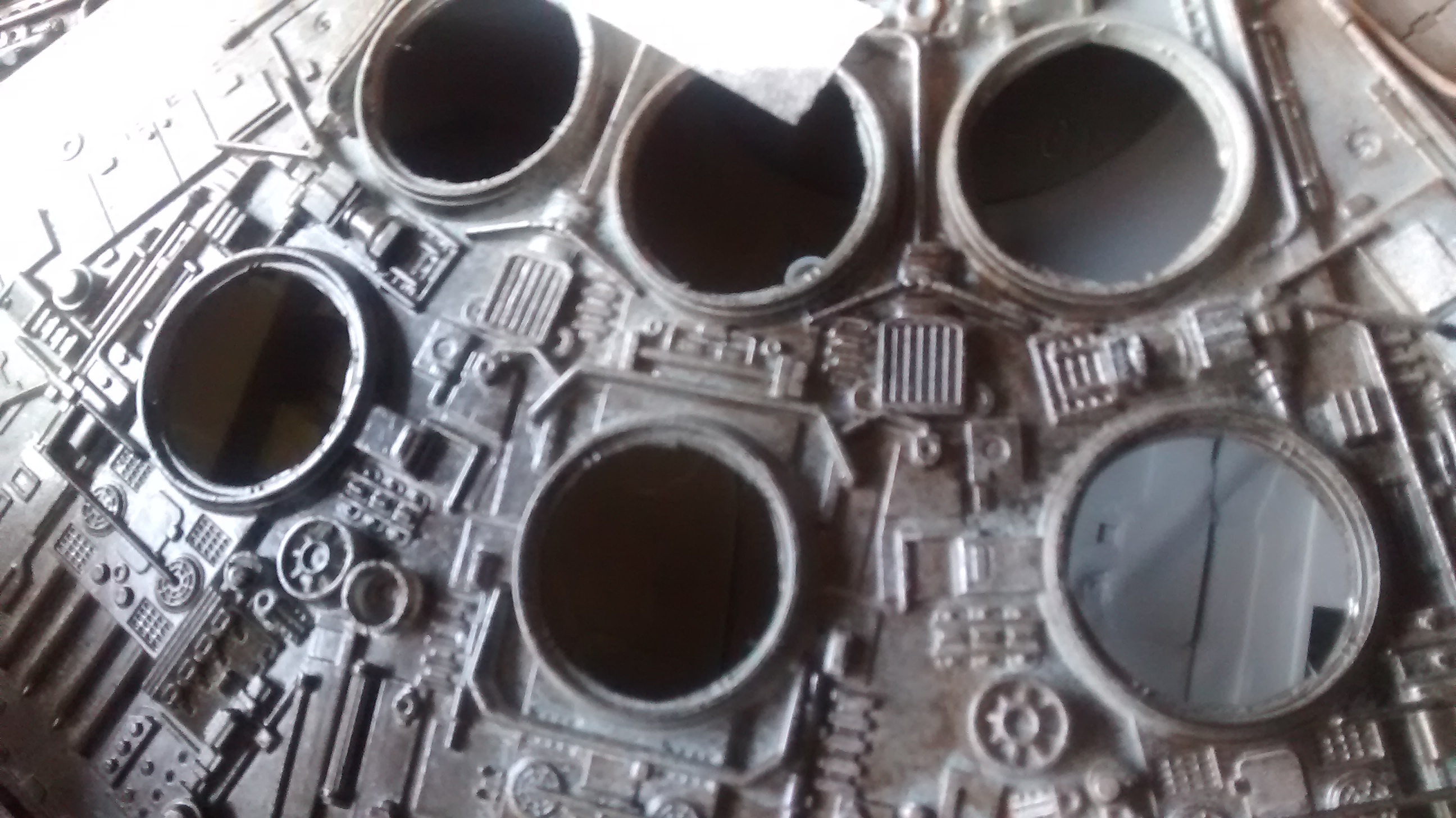

The real cheap way of doing the engine vents, dont have any money but have bottle tops from milk cartons, and have the pull out sports drinks tops, yes I know its not Canon, its my build and it came down to being frugal, I also painted the rear deck in advance, so I could work out how much needs to come off. To be honest it actually is a very good casting, the piping needs replacing as they could not have any undercuts. I have also noticed that the inside mechanism of the sports drink is near enough a match to a vent on the side walls. I do have one problem. I have no etched brass to simulate the top. I am looking everywhere for a mesh that is not woven, square design. So trying to think out of the box on that one. If any of you have any ideas please let me know.
Also apologise for the shoddy photos, I dont like bringing my DSLR into a dirty environment.
Richie.
Richie.

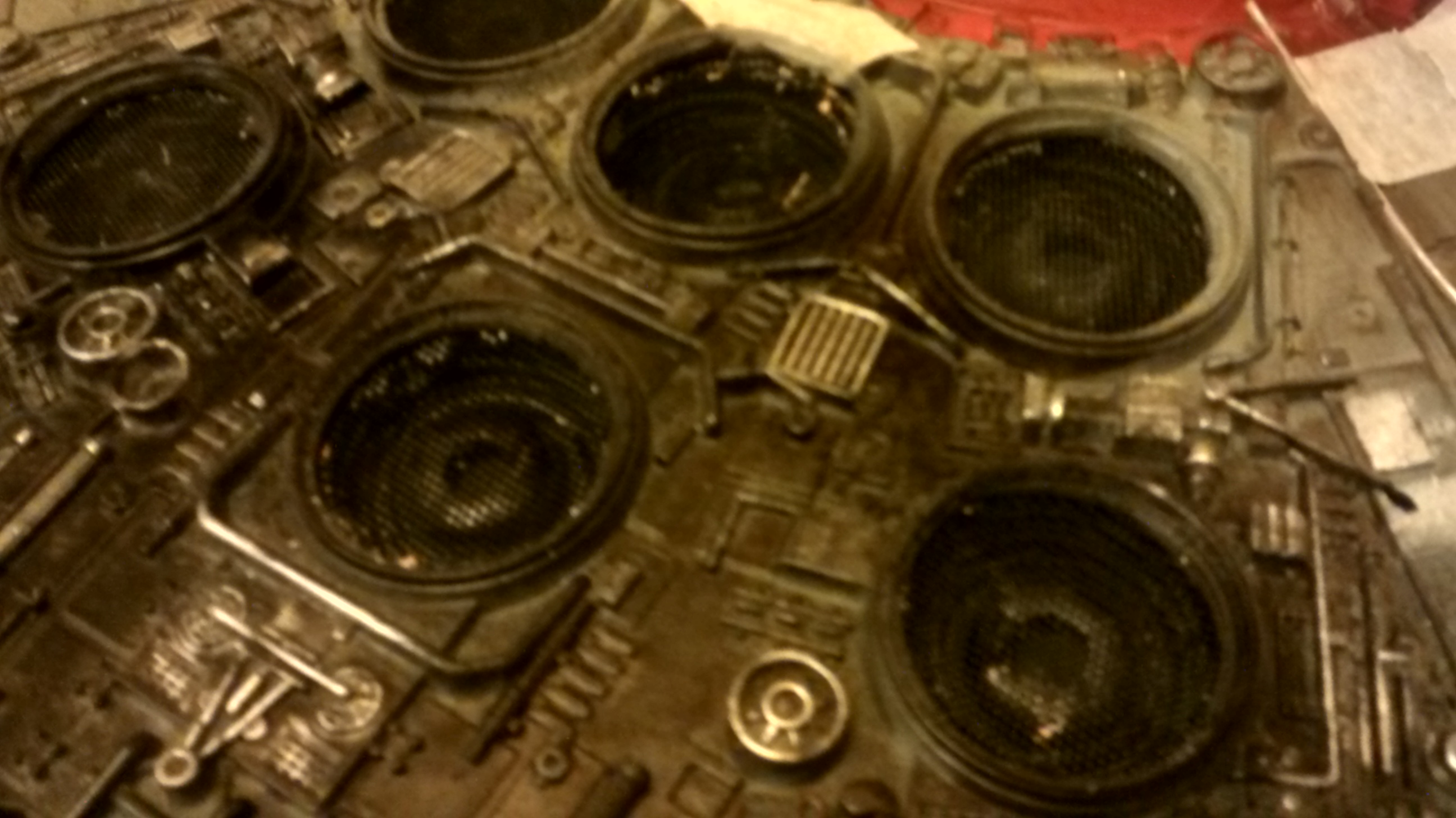

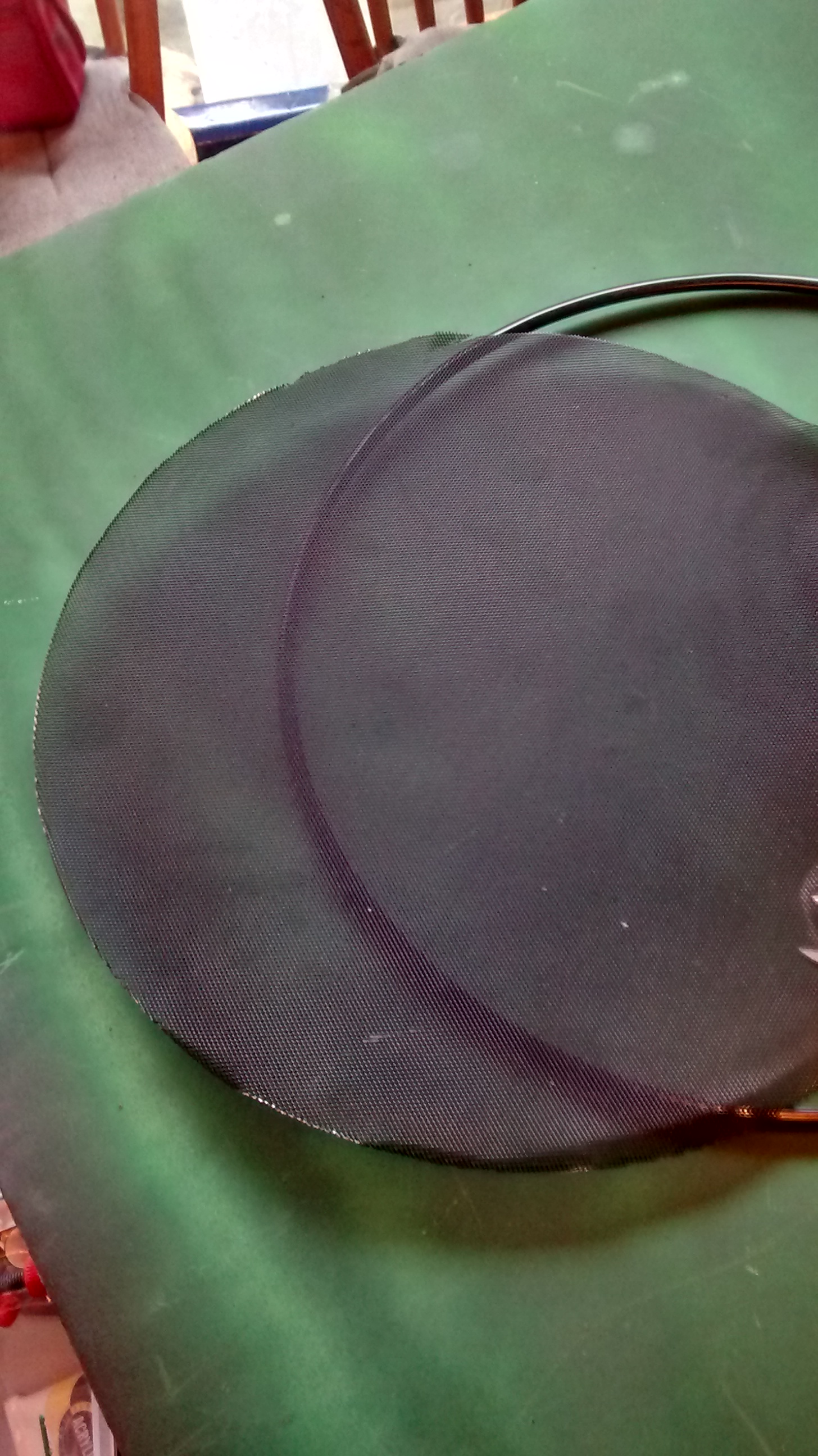

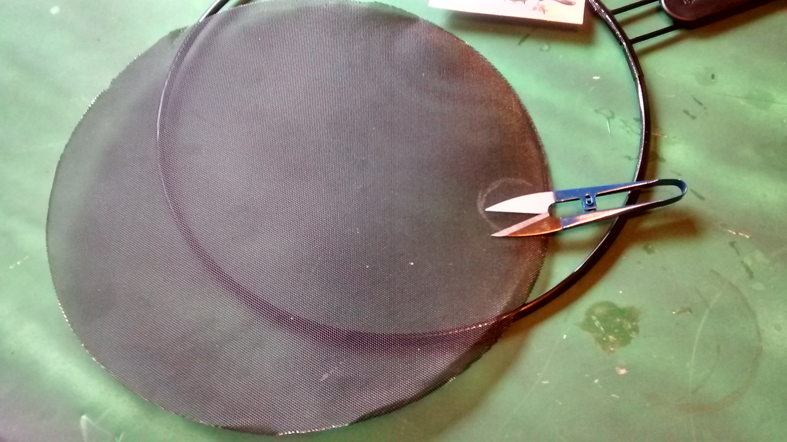

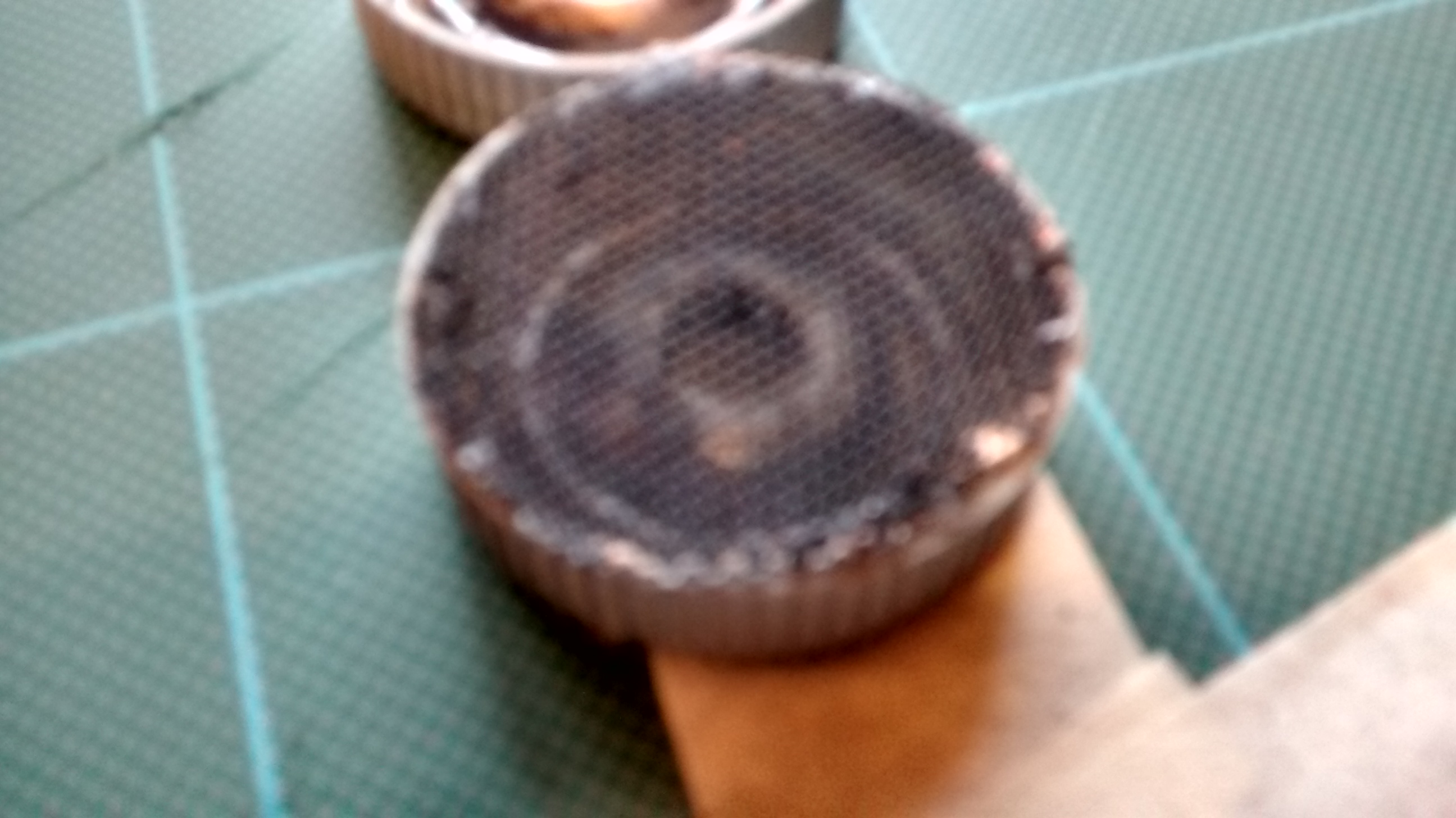

Awesome going to do the same as well, your cuts are a lot neater than mine, apologies for the camera phone shots. I went and bought a black splatter guard from a shop for 2 quid. The mesh is not right but close enough for me. Using lipstick, I got a spare bottle top smeared it on the edge. Pressed on the mesh to make a circle and cut it out with sprue snips. This was glued on. I am missing the 6 bars that go on the vent. I need wire for that, and better CA to stick it. Over the moon with the result. My camera phone sucks. I dont really want to use my work camera on this. But will get better photos tommorrow. All this cost me was a dig around my greeblie box, and 2 quid. Not canon but it saved me 60 quid. Really happy.
RockHopper, you could further dress up your screening with thin slivers of plastic card (if lacking thin styrene plastic sheet, use the plastic from fast food joint coffee cup covers - if is #6 plastic, it is polystyrene... and really thin!) laid on for the little ribs. I was considering whether thin wire or waxed thread might do also... but I like the thin plastic better.

Robert many thanks, and a excuse for a cup of coffee, thank you very much,

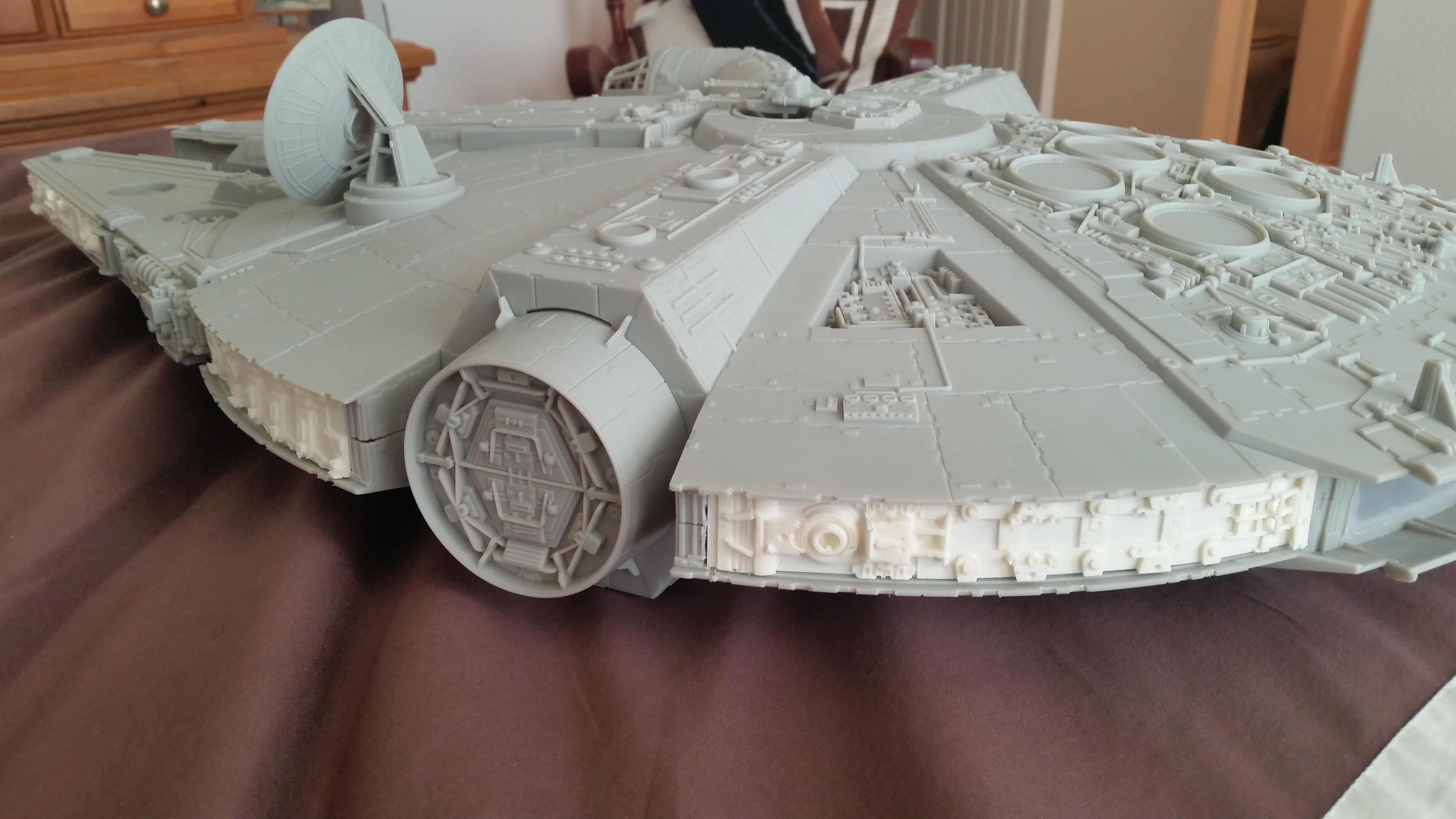

I've been making slow, but steady progress on the sidewalls. It's a real pain to try and find greeblies that somewhat resemble the actual pieces and then scratch building the rest. That's why I've been making molds so I don't have to do this again, if I ever make another one of these bad boys.

haha! I appreciate that. I am finishing up the remaining sidewalls and molds this week. This includes all the sidewalls, inner mandibles, and inner jaw boxes. More photos to come.

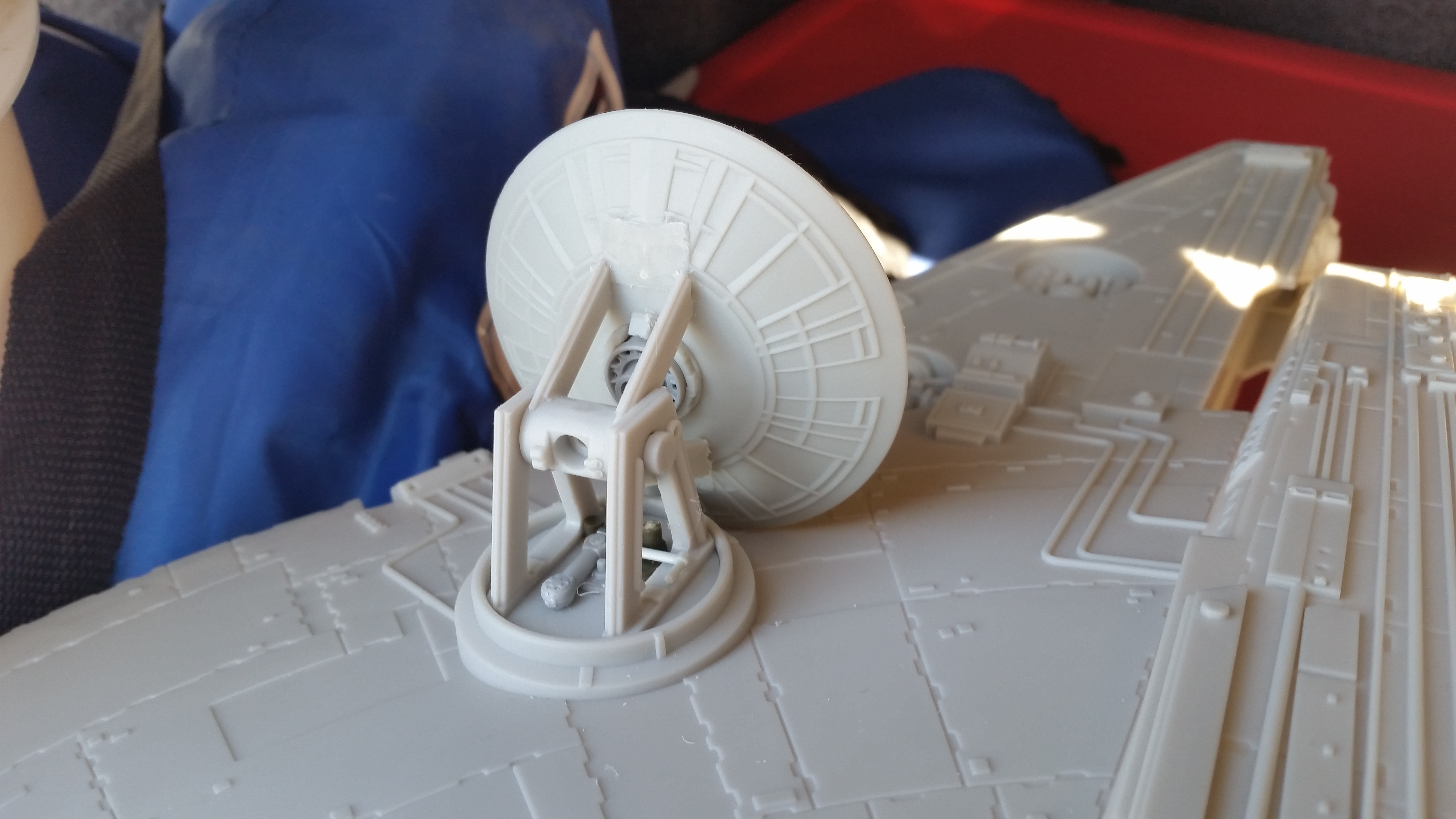

Made some progress on the dish. I decided to keep the dish that was included with this Falcon cut off the support and make a hybrid using the support from the Legacy BMF. I still need to add more details.
