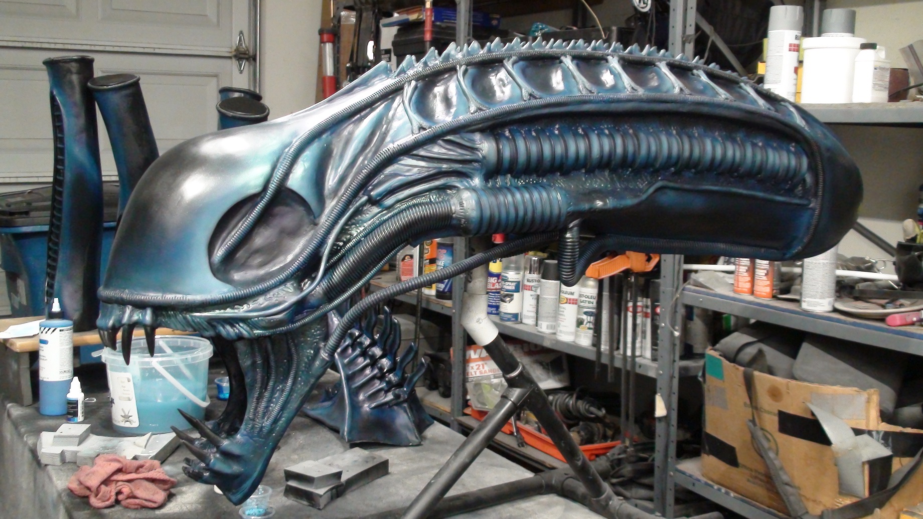

Fullsize Alien Warrior Build (Xenomorph)

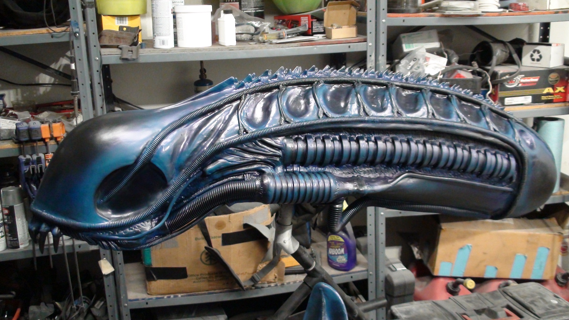

Looking really good so far. Wonkiness is fine...it's an organic thing and more layers will just make it look better.
p.s. To get more dynamic range consider (if you haven't already) shifting the hues for your shadow and highlight colors. Maybe slightly toward purple (or brown) in the shadows and cyan (or Permanent Blue Light) in highlights. Varying tones in the "stripes" of the tubes could add a lot of visual texture too. Just ideas, you do you!
all good ideas... will try! thanks for all the help!
Throwing a bit of FW ink indigo on there just to try it out..

I really like it! If you're ambitious you can also go outside the box and use a torn sponge or crumpled towel or plastic wrap to make weird random pattern textures in contrasting colors, then spray over them with your base (or highlight, etc.) color to tone down the effect. Might be a good way to fill space on less physically detailed areas like the dome or whatever. Just giving you more ideas because clearly you don't have too much on your mind already! :p

Love the paint job so far. As Palantirion said, it's all about layers and layers: spray one color, then spray a coat of clear and spray another hue, etc...
Eager to see the rest:cool::cool:(y)(y):love::love:
- Quick note on that: IF you are going to clear between layers make SURE you use a clear of the same binder family as the paint! IE: If you're using water-based acrylics then use Liquitex Gloss (or Matte) Medium (not Varnish, that closes the pores). It will catalyze any paint that needs it (was super important on my art car projects) and will seal it well enough that subsequent thin layers could be removed (quickly after applying, oopses) but is also porous enough that it will act as a primer.
Conversely if you used a 2K or Urethane clear between layers of acrylic I'm 99% sure you will get cracking later on. Urethane over top of cured acrylic is fine...I think...so far no issues on my projects.
What about for the final gloss coat?
Sort of depends. If you are airbrushing paint, and airbrushing isolation clears, then those layers will be thin and cure fast (as opposed to brushing). Then I see no problem using a good quality auto urethane over them as the final finish.
However you know your statue better than anyone. Does it flex more than the fiberglass fender of a Corvette? If so, then maybe a more flexible (and less hard) clear like Liquitex Gloss Varnish or General's 450 line (can only find semi gloss for some reason Amazon.com) would ensure flexibility.
One other note on top coats: A varnish (that is truly a varnish) will SEAL the surface. Which is why Liquitex "Gloss Medium and Varnish" is not a varnish, but Liquitex "Gloss Varnish" is. Anyway, the point being that once the surface is sealed it is air tight. Which means that any offgassing from materials under the paint will not be able to escape. This hasn't happened on my Green Queen (old fiberglass, sealed with urethane), or on the (old) fiberglass Avanti I painted (sealed with Liquitex Varnish), but did happen on the aftermarket CF roof (as the epoxy degraded) on my Z4 (sealed with Liquitex then later with General after some touch-up), which caused the sealed paint to bubble and it means I'll have to repaint that panel. If you think there will be risk of offgassing later on, then I'd seal it with just the Medium to allow for porosity...or maybe use a urethane because I believe (but cannot confirm) that this medium would be permeable to escaping volatile gasses in a way that an acrylic varnish would not.
I bought that clear coat that you suggested in our pm
-The Upol, should be fine....unless your sculpture is particularly flexible and will move/shake/rattle often. I think not, given your target location. Was more of an afterthought because I realized I didn't actually know the material. As long as it's similarly stiff to thin fiberglass then I would expect no problems.
Sometimes I over think things.
It looks better, more dimensional to me. But I couldn't have told you why without putting this and yesterday's side by side. Then it's more clear. Heading in a great direction!

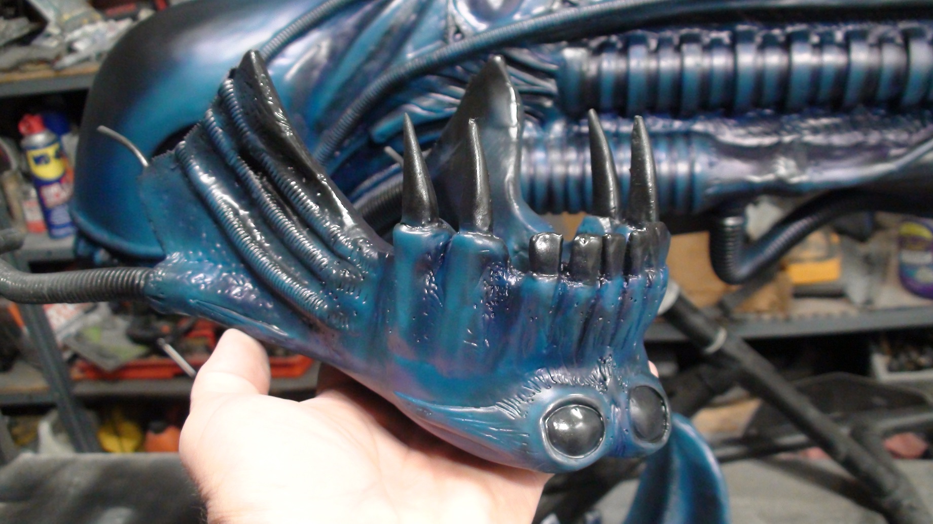

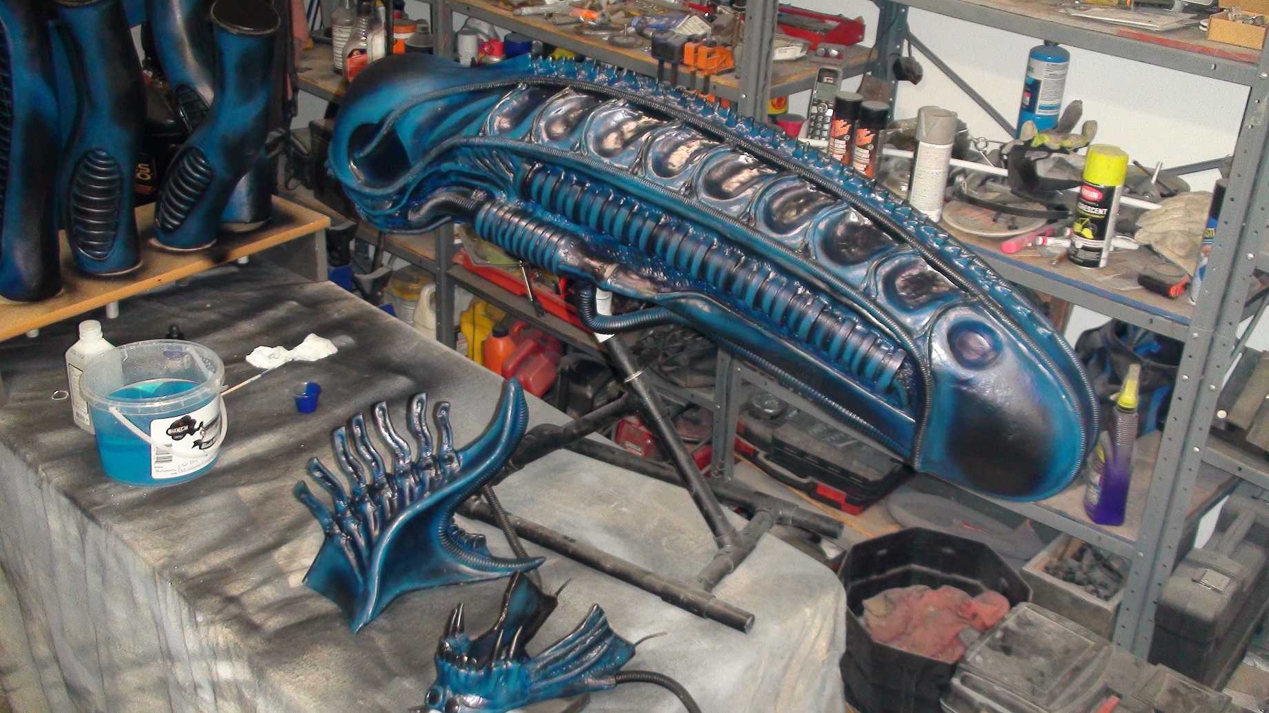

I like the blue but I am adding a green tint to mine as well.
