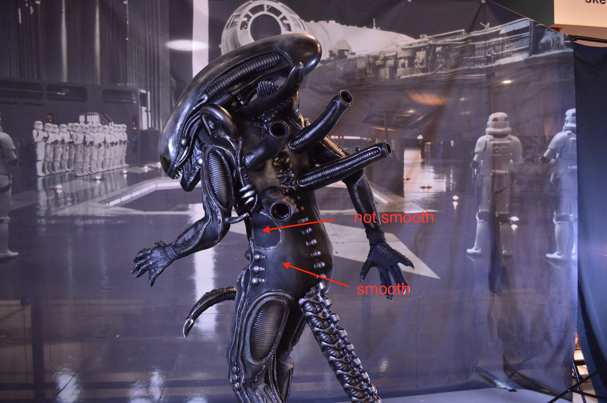

in this pic from your facebook page, how did you get the spandex to look so smooth and metallic? did you just paint it?
edit: i put the arrows in btw
Just paint. It is as smooth in both places. Just the lycra fabric with no attachments. Just more silver paint on the butt. (Keeping the waist more black to make it look more slim.)
