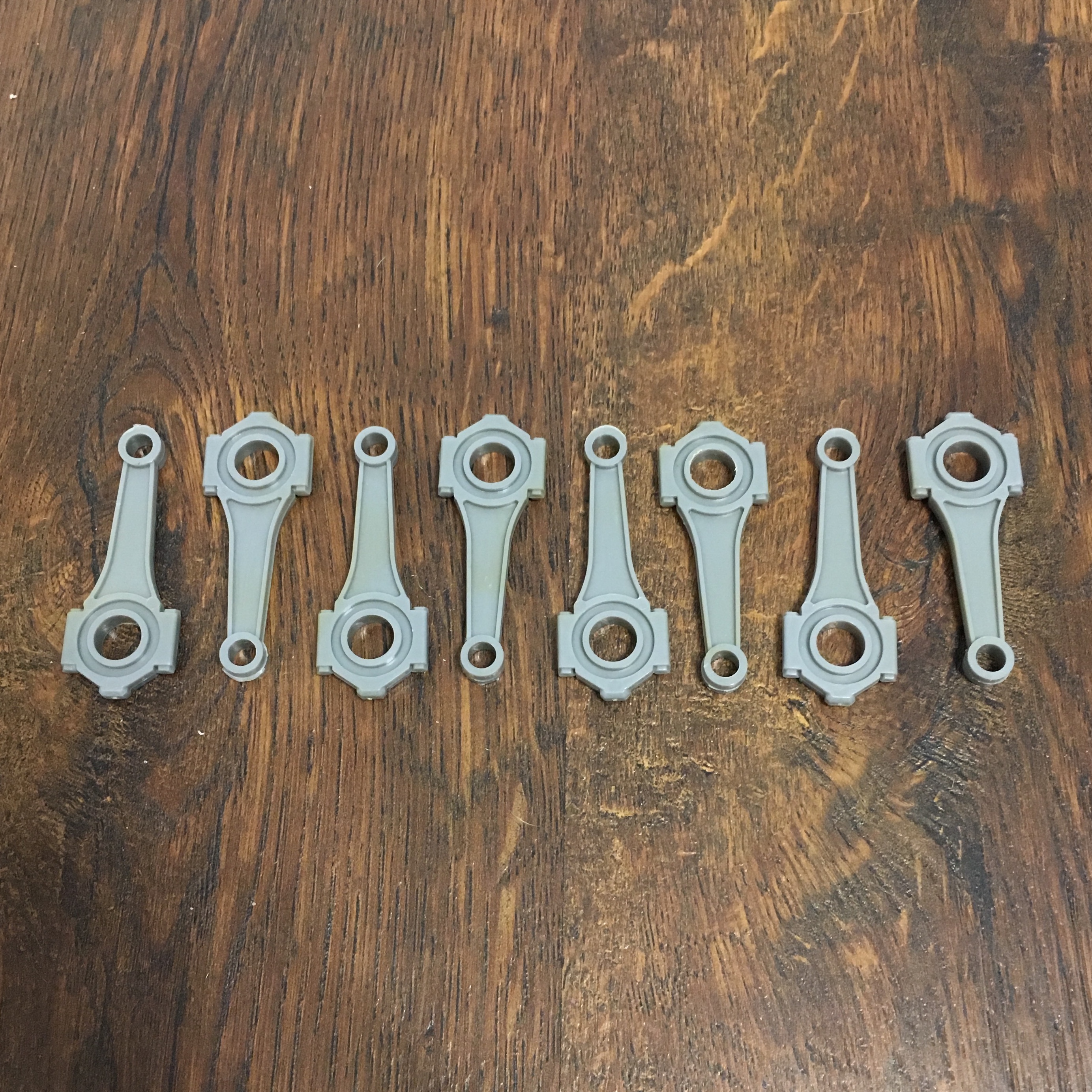

Just got an original Renwal 1960 Visible V8 model kit. All that I really needed were 2 of the 8 connecting rods. I'm hoping to be able to trade the other 6 for some other found parts.

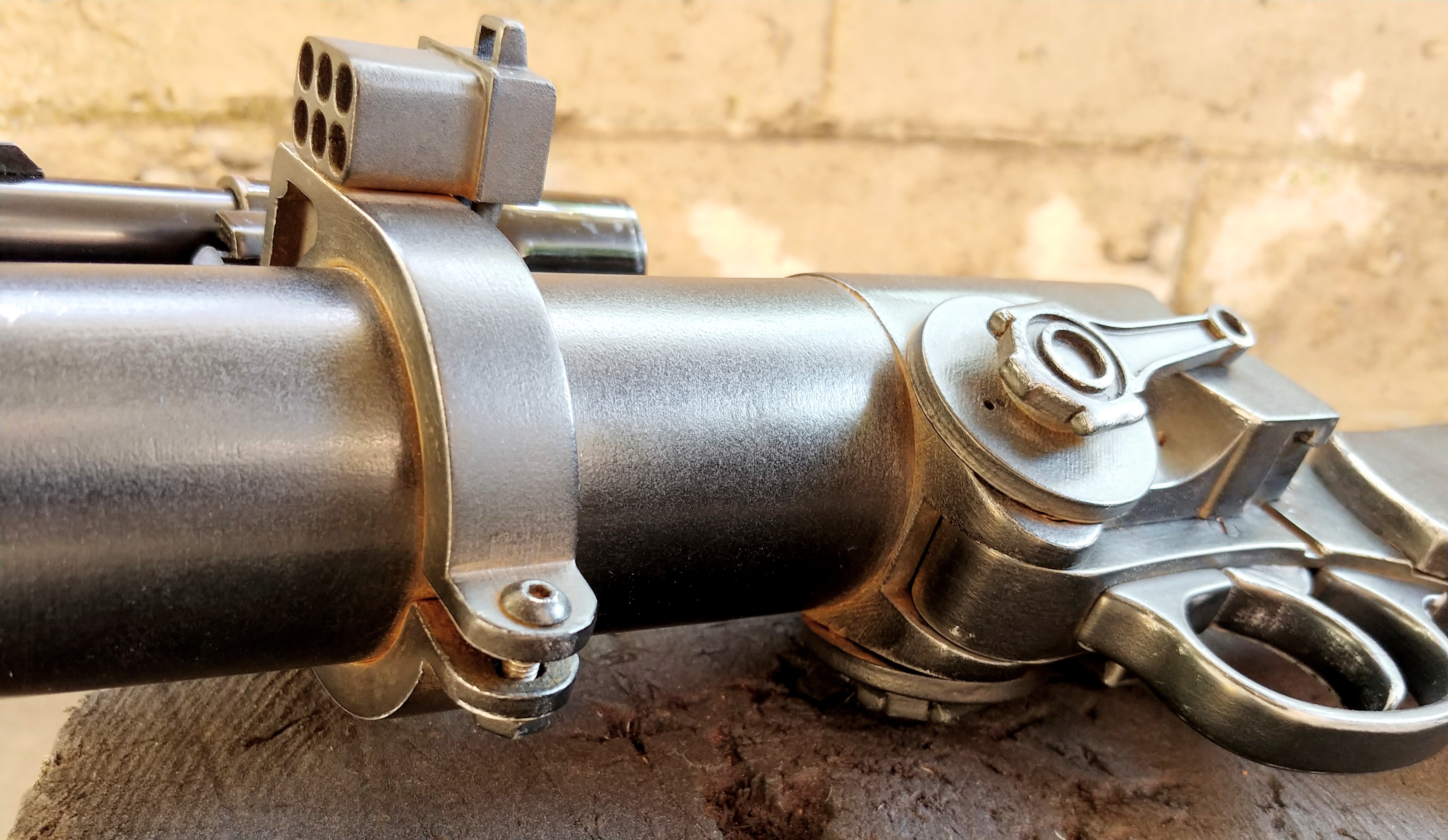

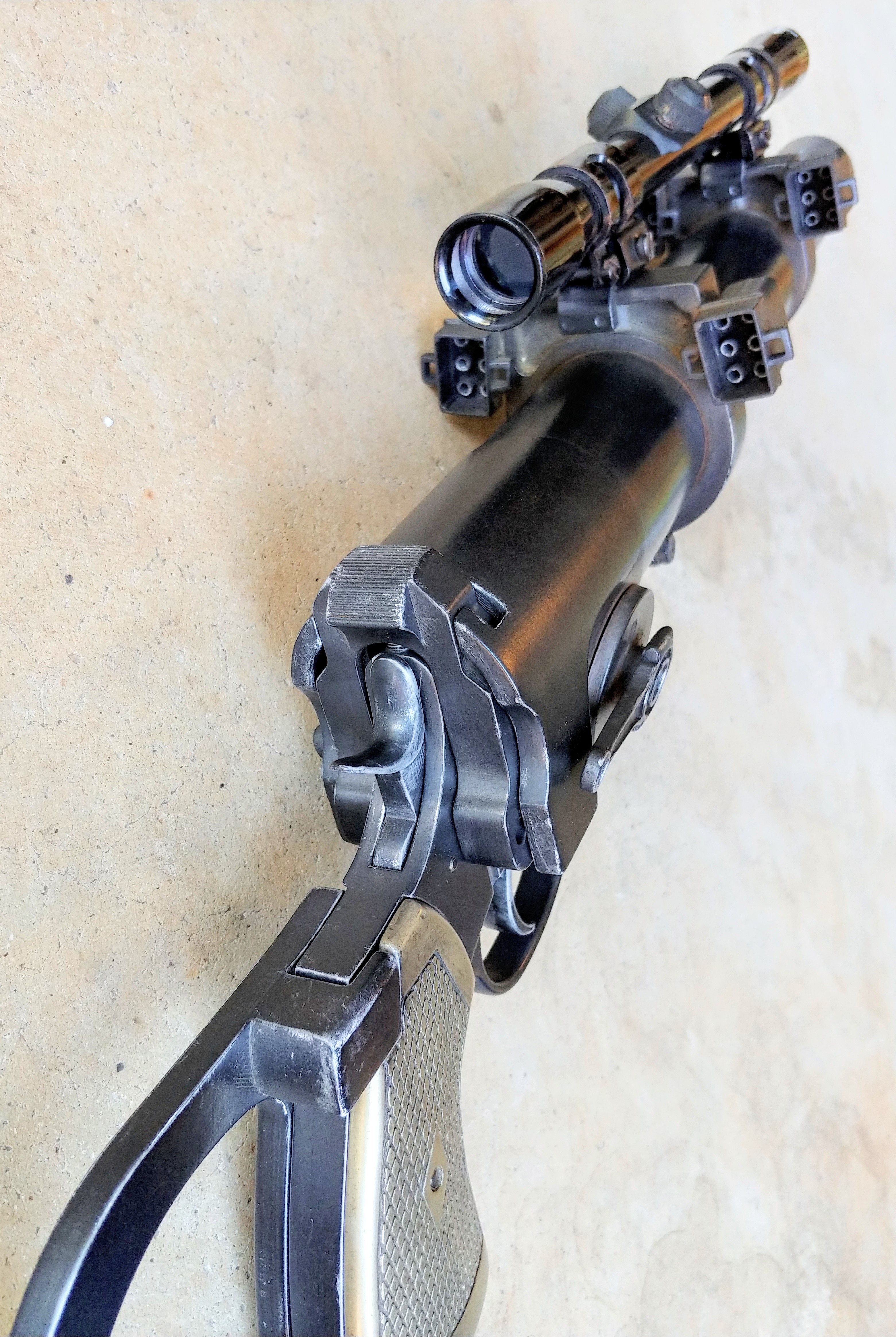

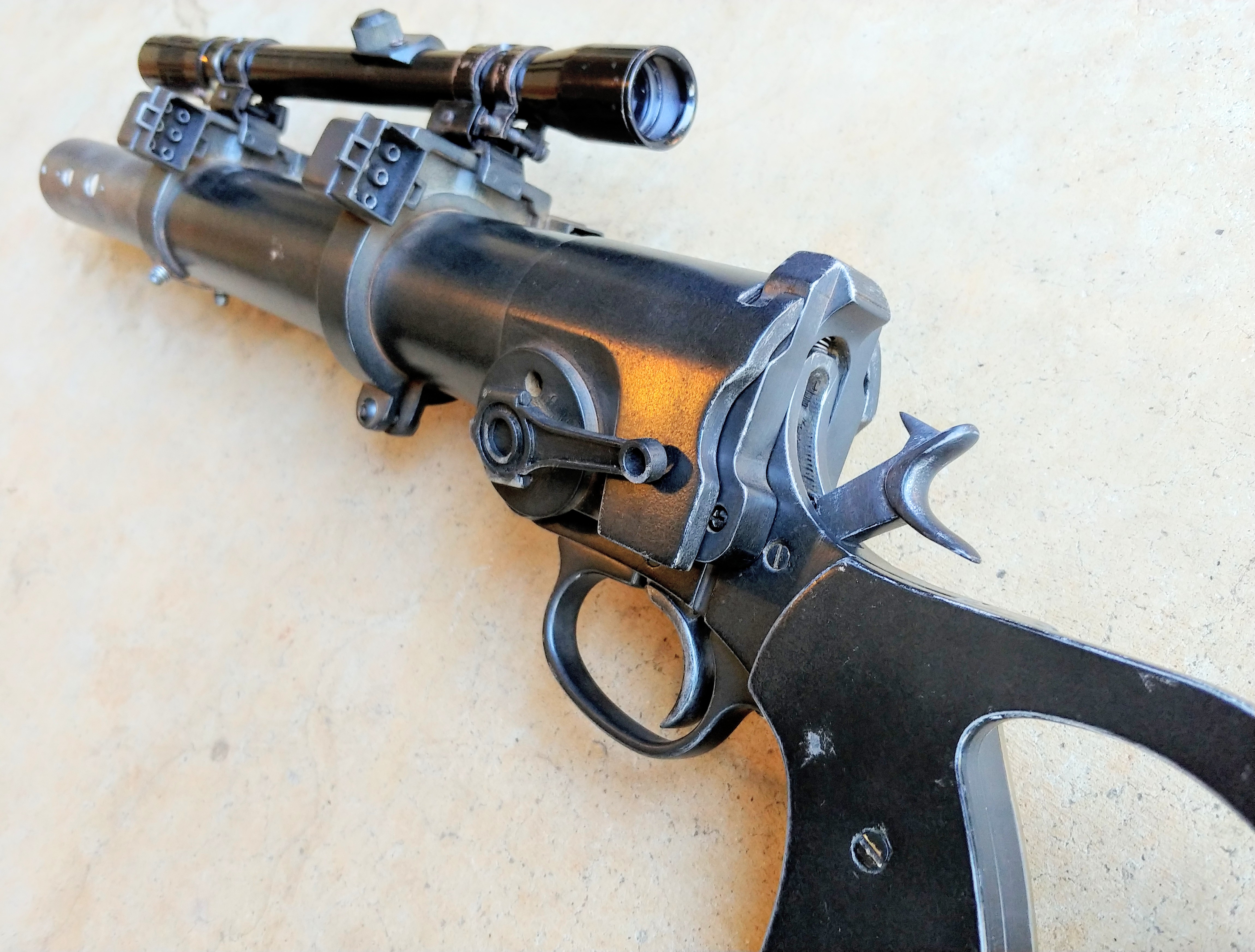

As for the "Disney Parks", if it's the same as the old Master Replicas FX or Hasbro FX (which are essentially the same), then the tube is slightly too large in diameter. Originally I was gonna use a torn-down old MR FX tube, but really didn't want to alter it (by turning down the diameter of all that would be inserted into the barrel on the lathe) or the printed barrel (sanding until Doomsday) that much, which is why I opted for the Synchronar for my printed build. A Heiland 2 cell is also a great placeholder. I would've used one of those, but my Synchronar was the cheapest.

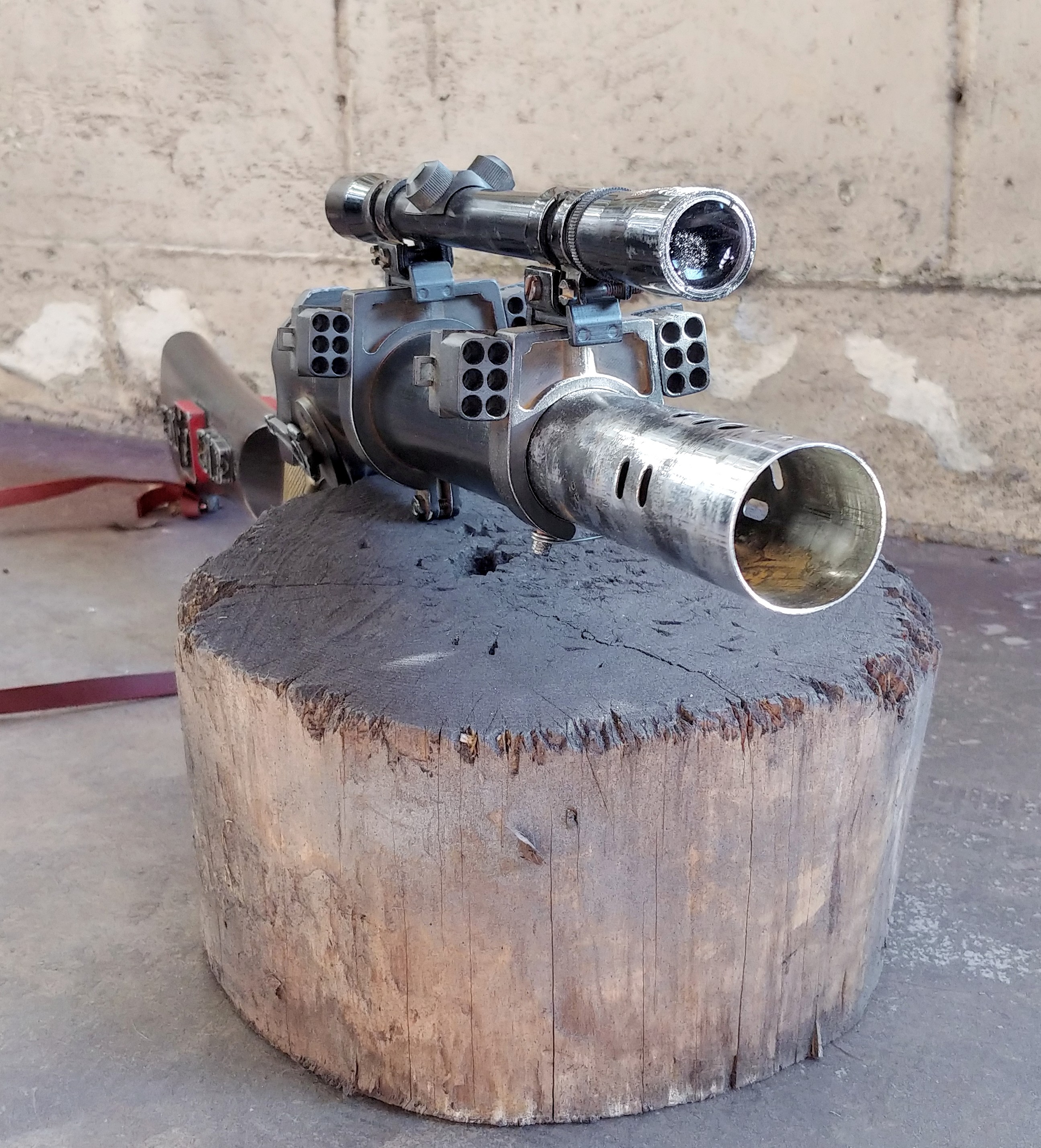

I do realize my Heiland is not oriented correctly, as an MPP should be, but since it's a printed replica, and I'm not as concerned for accuracy in some areas, I went the aesthetic route in some places. The holes don't match up well enough to an MPP in my opinion, to be convincing to the trained eye.

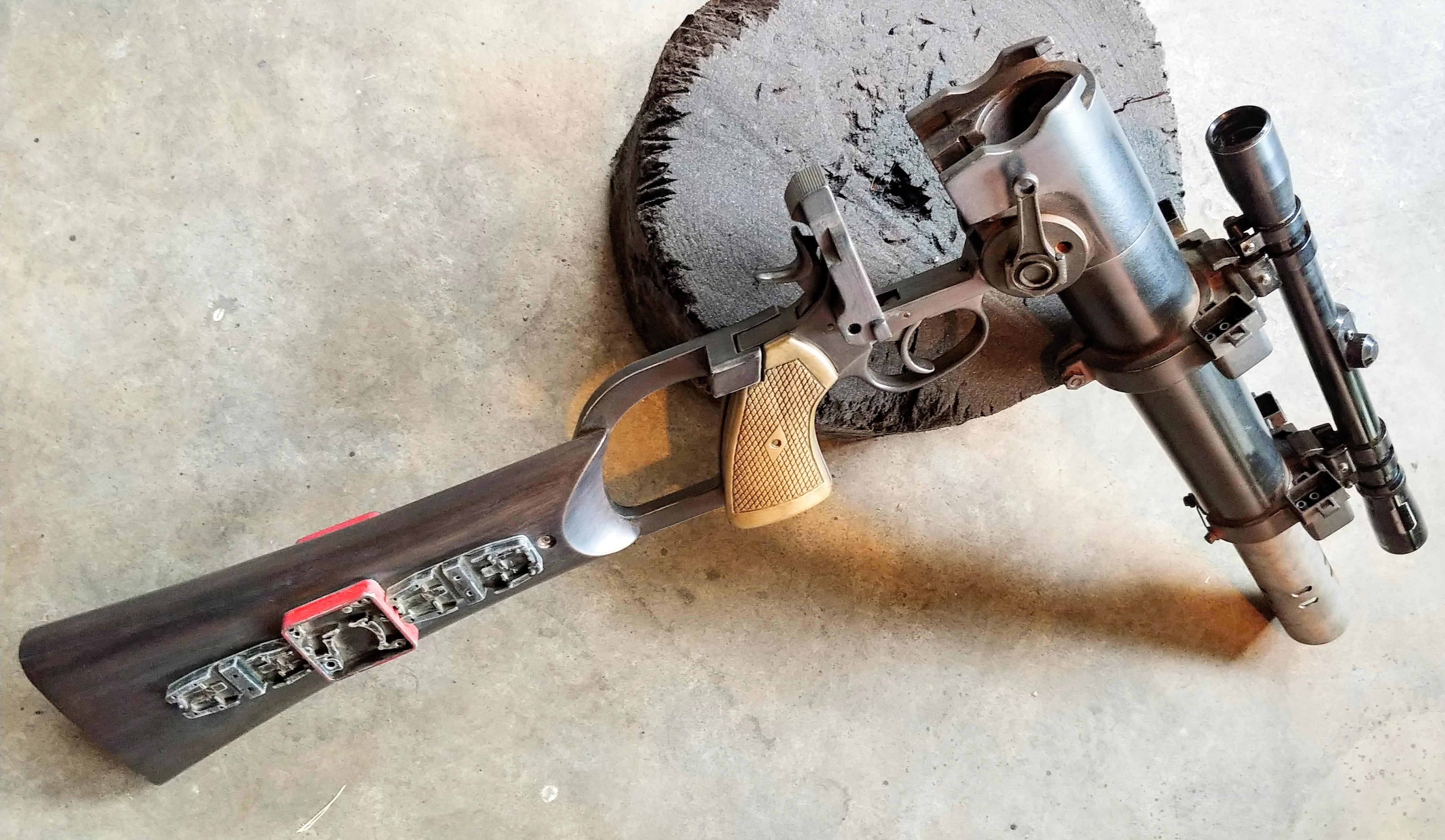

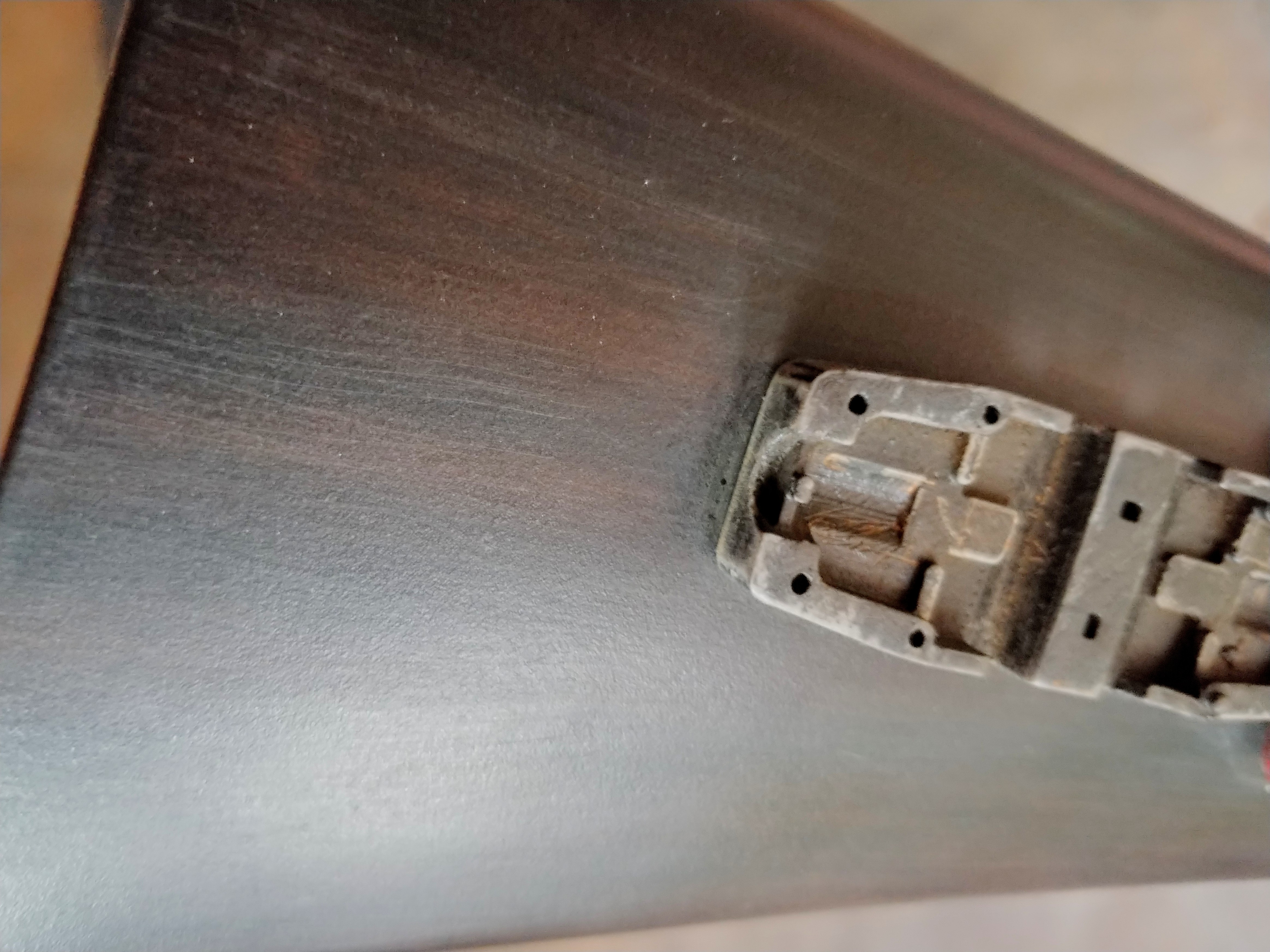

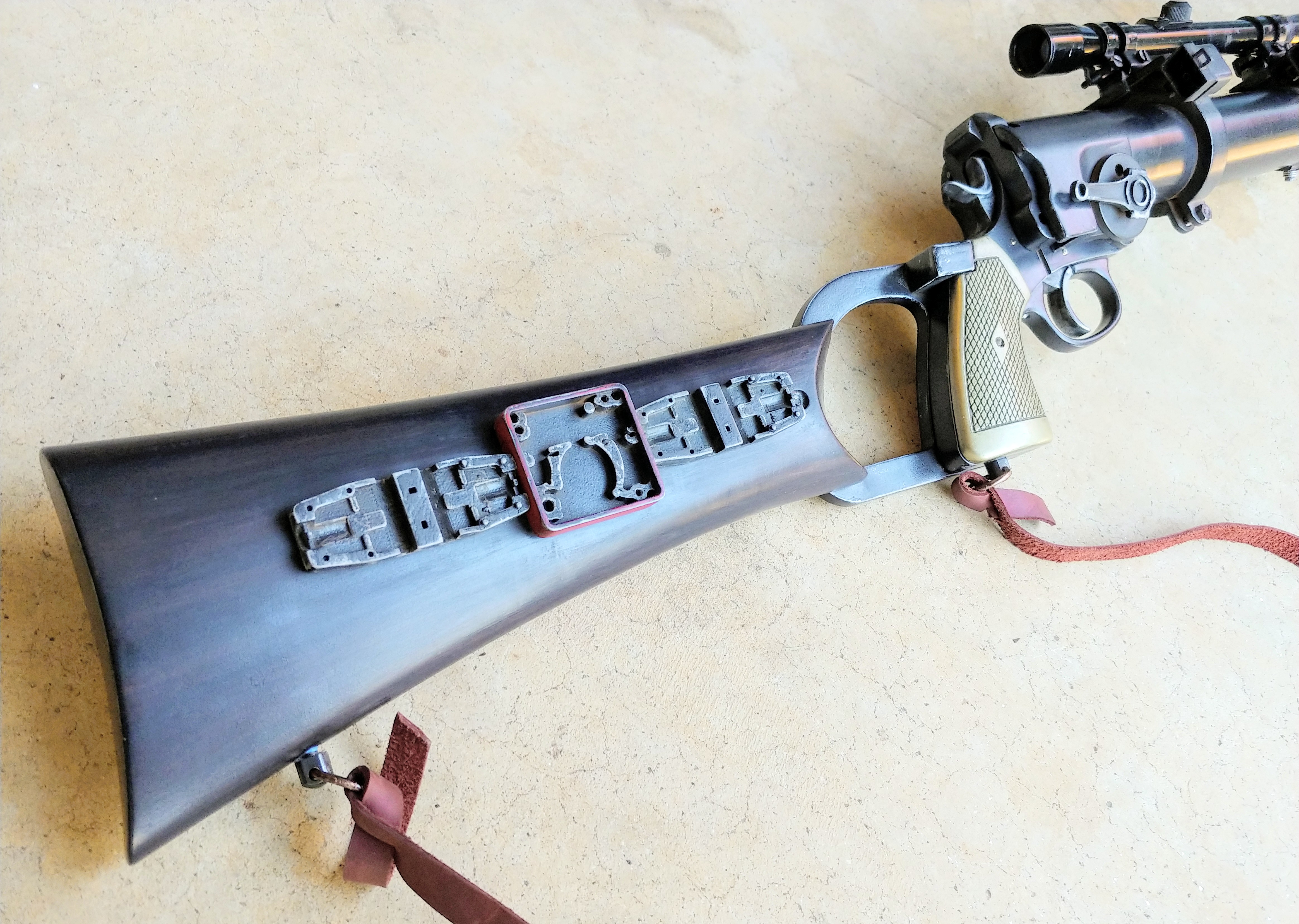

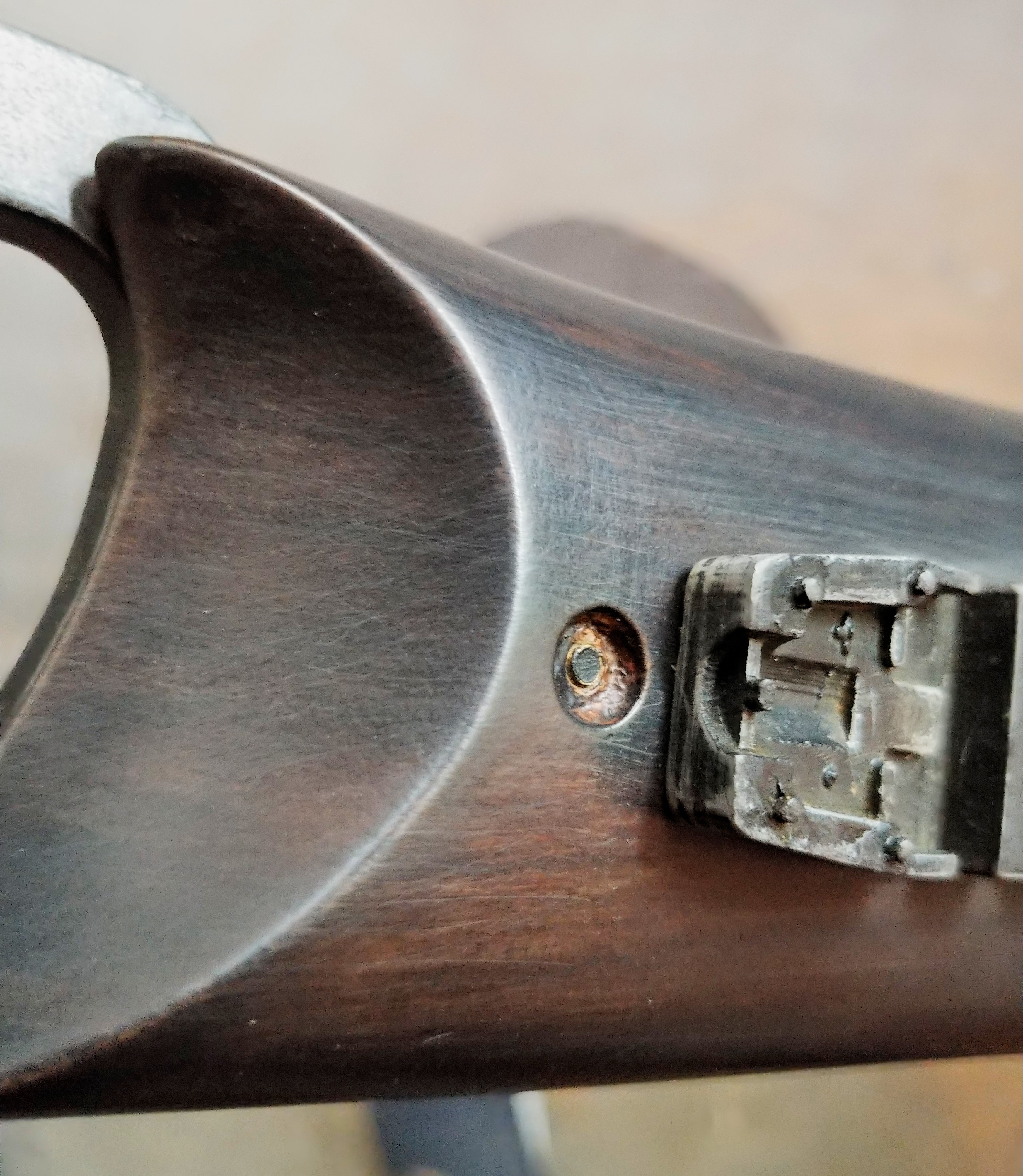

Like you say, my stock is WAY too dark! In my thread where I show this thing off (and there are lots more pics there), I think I do mention that. It was my first try at faking a wood finish with paint on plastic. I do plan to go back and refinish my stock. It was done with a light tan base, then brown washes. Lots of brown washes. The very last wash, I was like, "Oops! I think that might be too dark. Oh, well. If it is, I'll fix it later.". :lol:
And yes, the stock is also printed, in two parts, and I inserted two lengths of 5/16" steel rod connecting the two halves. Then I used a ton of Bondo to get it smoothed out.
The scope is real, it's an ASI, and those are NOT tall feet on the mounts in those pics, but I have since found some! It's the ONLY set I've seen so far in my searching, and I've been searching pretty good for a while!
Are you saying I need to weather the scope, or the entire blaster? I kinda like where the "Webley" is at right now, but if you mean the scope, I think you're right. The real ESB scope was painted a flattish black, correct? I'd have to look back at some reference. The printed Molex connectors could probably use a few scratches here and there, too.
Here's a few more pics of my printed blaster (I did have a different scope on there for a minute, I'm not sure at what point I switched it out for the ASI) and some closer shots of the overly dark stock...
EDIT: Shoot, I forgot to say, I started out with a fully printed MPP tube, which actually WAS correctly oriented! It was ridiculous looking, though, and needed to be replaced ASAP! There's no real substitute for real chrome plating, there just isn't, and that's what helps sell my attempt to pass something that's mostly plastic off as something that's much more substantial.

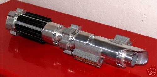

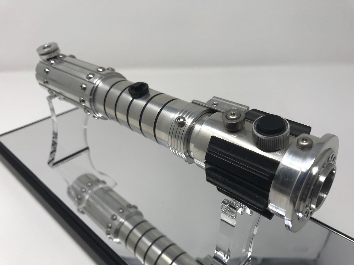

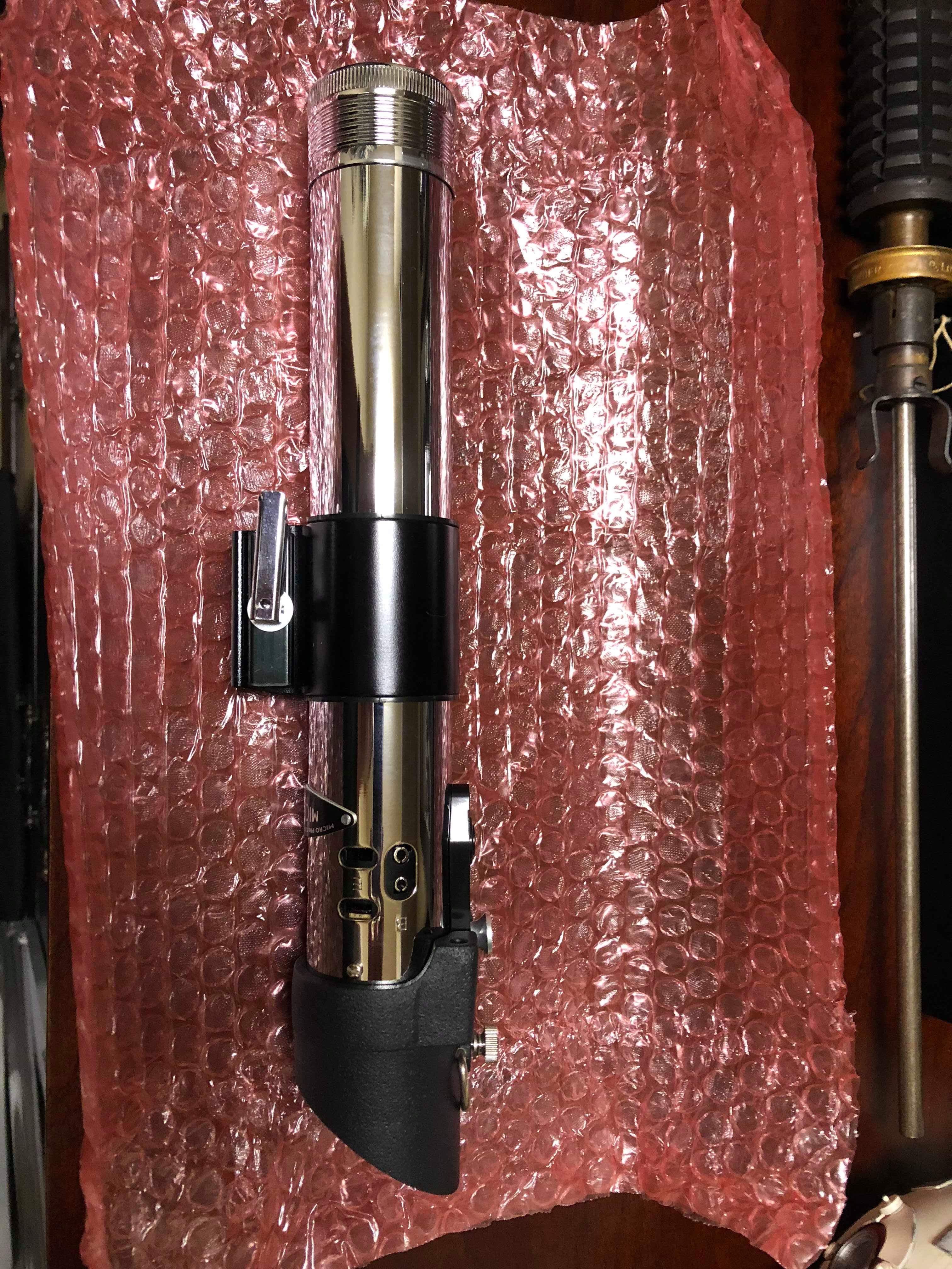

Here are some pictures of my Parks MPP. It came as a kit that I assembled.
Dann, I first came across Parks in Go Figure! magazine. I wanted one of his sabers so badly. The Shadow saber was one of my favorites.

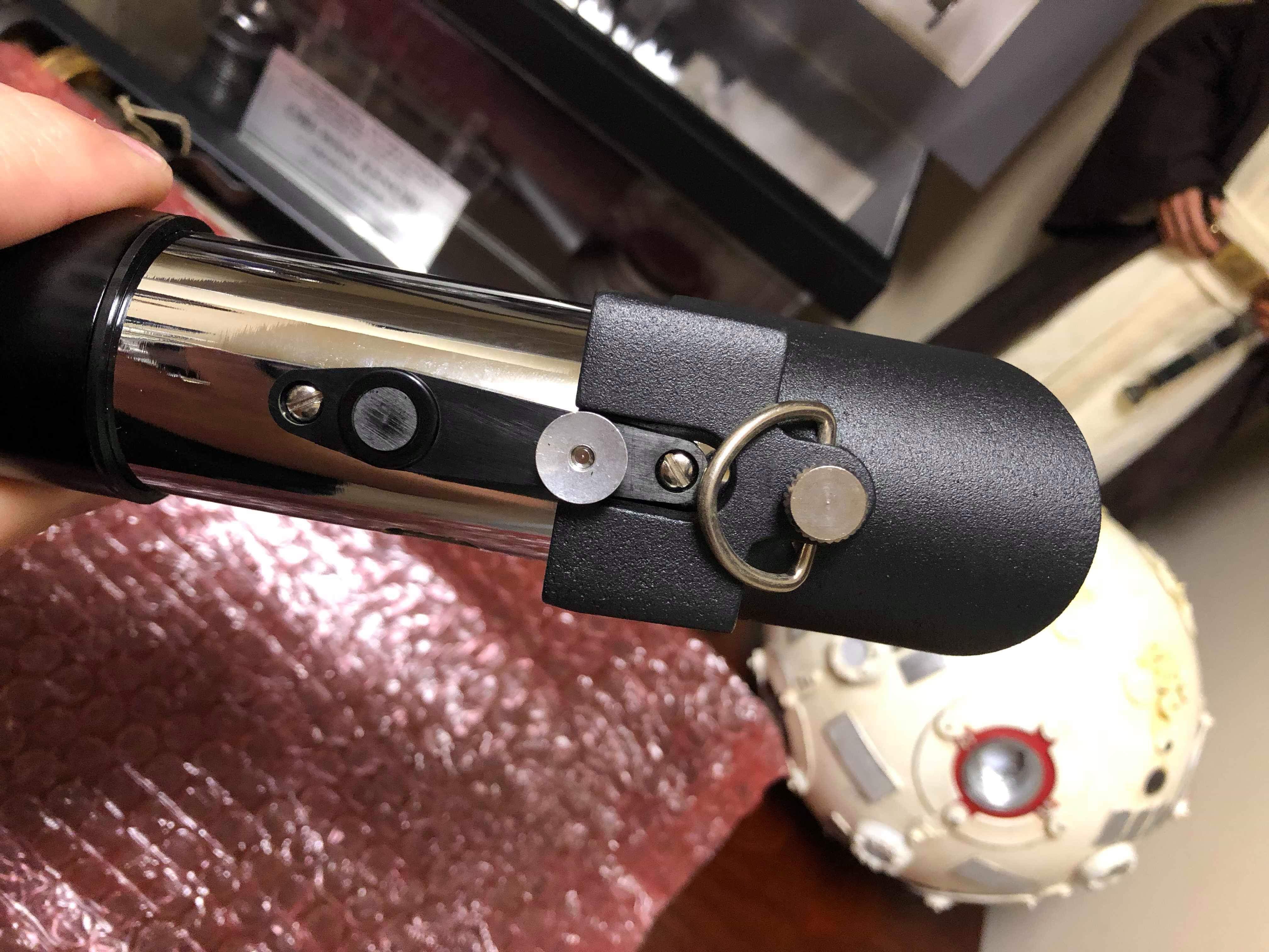

So after removing the trigger and bulb release housing on what I thought was my Larbel MPP, I was surprised (pleasantly) to find that I've actually got a Parks replica! All the correct size holes.

Yes, I recently discovered that the Parks replica mpp has the correct size holes and correct engravings. This seems like the best placeholder to an actual mpp. Crrently I have a romans on the way and a Parks in the works. As far as found parts I have a few things en route and that will be updated very very soon :)

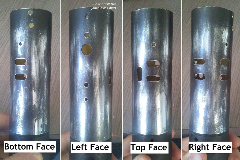

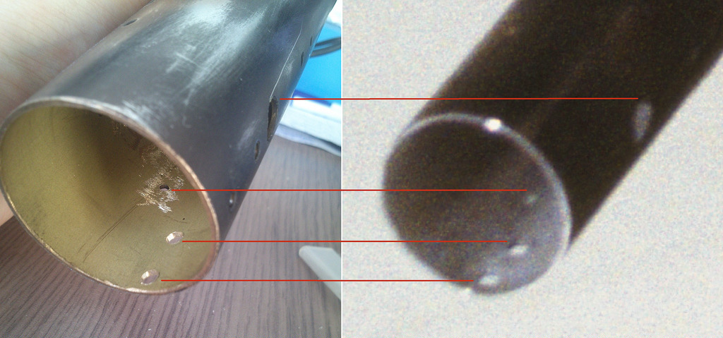

I don't know if this is common knowledge by now, but I remember that few years ago when I assembled my EE-3 blaster I realized that for outmost accuracy the MPP has to be altered and two extra holes need to be drilled through it in order to match the reference pictures.
The two 'mistery holes' are located at the end of the MPP and facing downwards (located on the bottom 'face' of the tube).
At the time it seemed pretty new to everyone.
Yes, I remember this coming up a while ago. I remember some people believing them to be indented or divots and not holes but I personally think it's pretty clear they were in fact extra holes that were added for whatever reason.
Did you make that flash tube yourself? If so you did a really really good job with your hole placement!
Also, for "outmost accuracy" shouldn't the B-Port hole on the "top face" be the large B-Port hole and not the smaller version?
