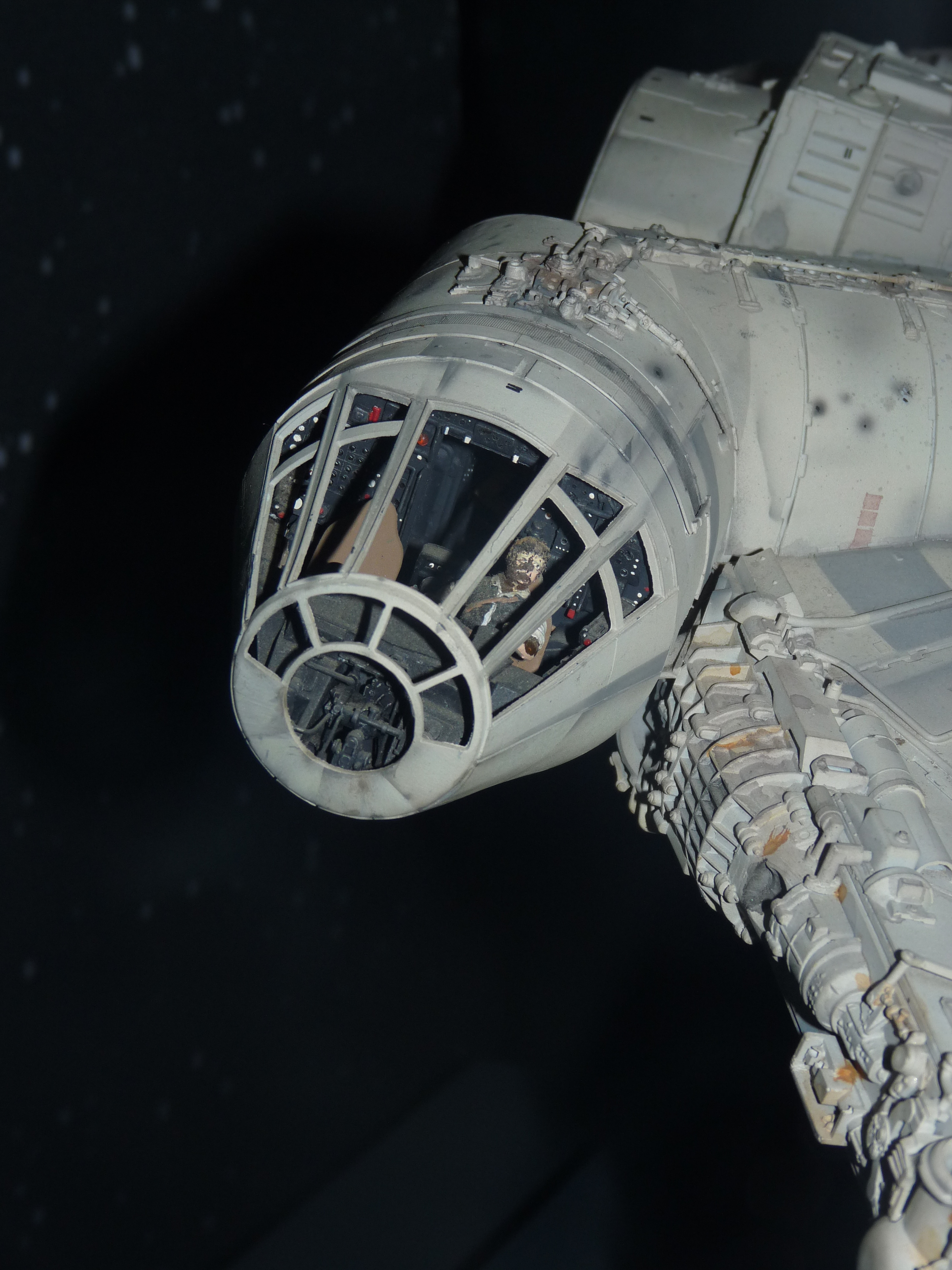

Those are testor model master numbers - 4876 is concrete. dark, these are the last pictures I will post. This is actually your fault, if I had not found this thread I would not have just bought the12 back issues of the falcon. I also have picked up the A B C Tamiya weathering pastels. Love em

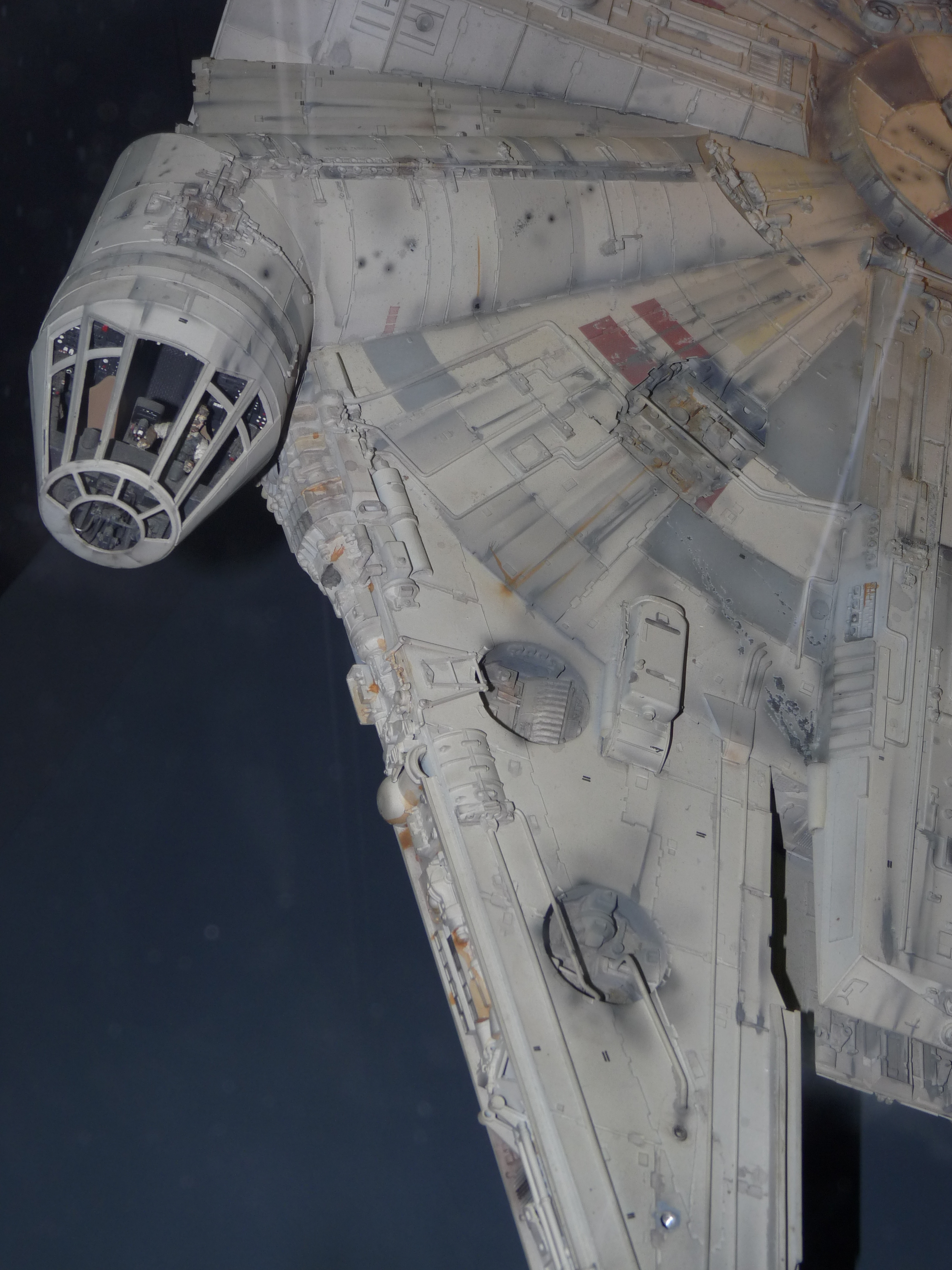

Also the grey areas you may see in loads of photography look a blue like grey!!! NO! That's just other version etc & bad photography scans making it look that bluey shade of grey... Even my greys will be tamed down at a later state... Good thing is l can correct at any stage if I've done something wrong in shade masking...As always using the Black Lamp oil rub as a base....
The prominent greys are Humbrol tin paints mix from black/white matt mix to suit. Only one shop left in my city that sells model tin paints!!!
You may spot one of the three red square transfers on the bend came off....that will be fixed soon as lve lots from the model kit it came from ;-)
This looks amazing. BTW the 3 red squares are supposed to be on the 32in model anyway. It's something that was only on the 5ft ship only.
I stand corrected. I guess I haven't looked close enough but just looking closer at the cockpit now and do my eyes deceive me? Is the raised edge around the cockpit windows actually thin rod/wire?
