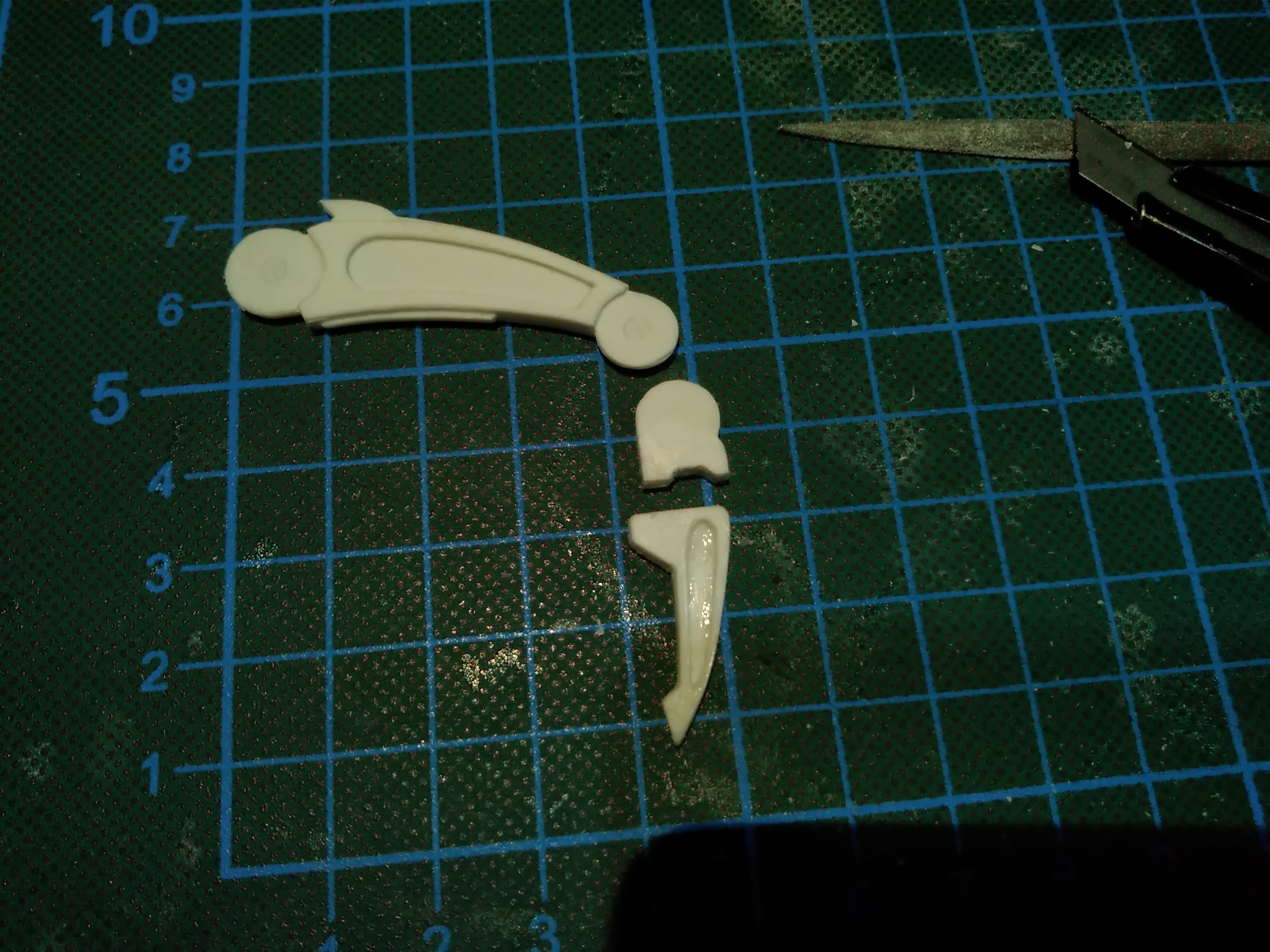

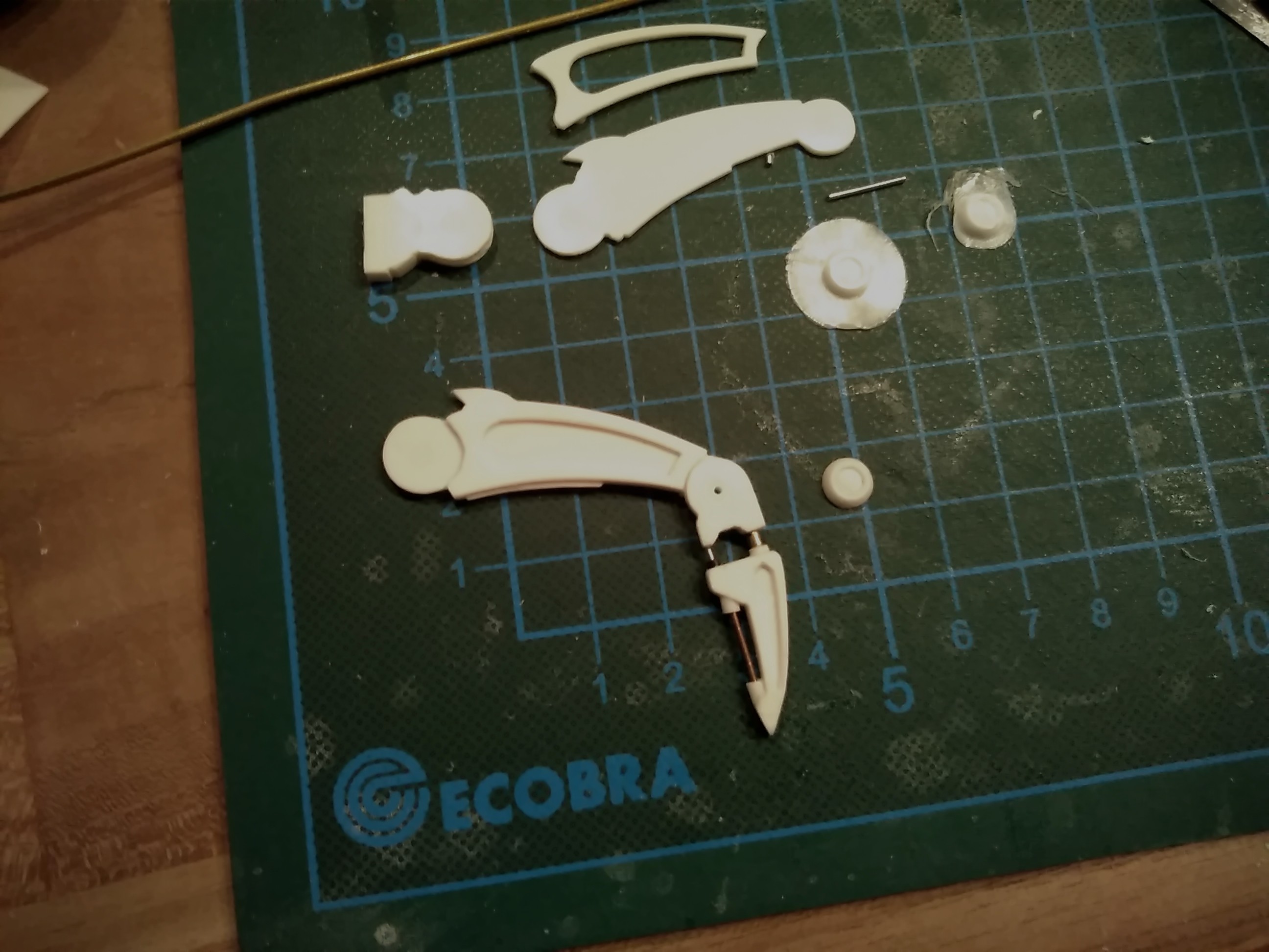

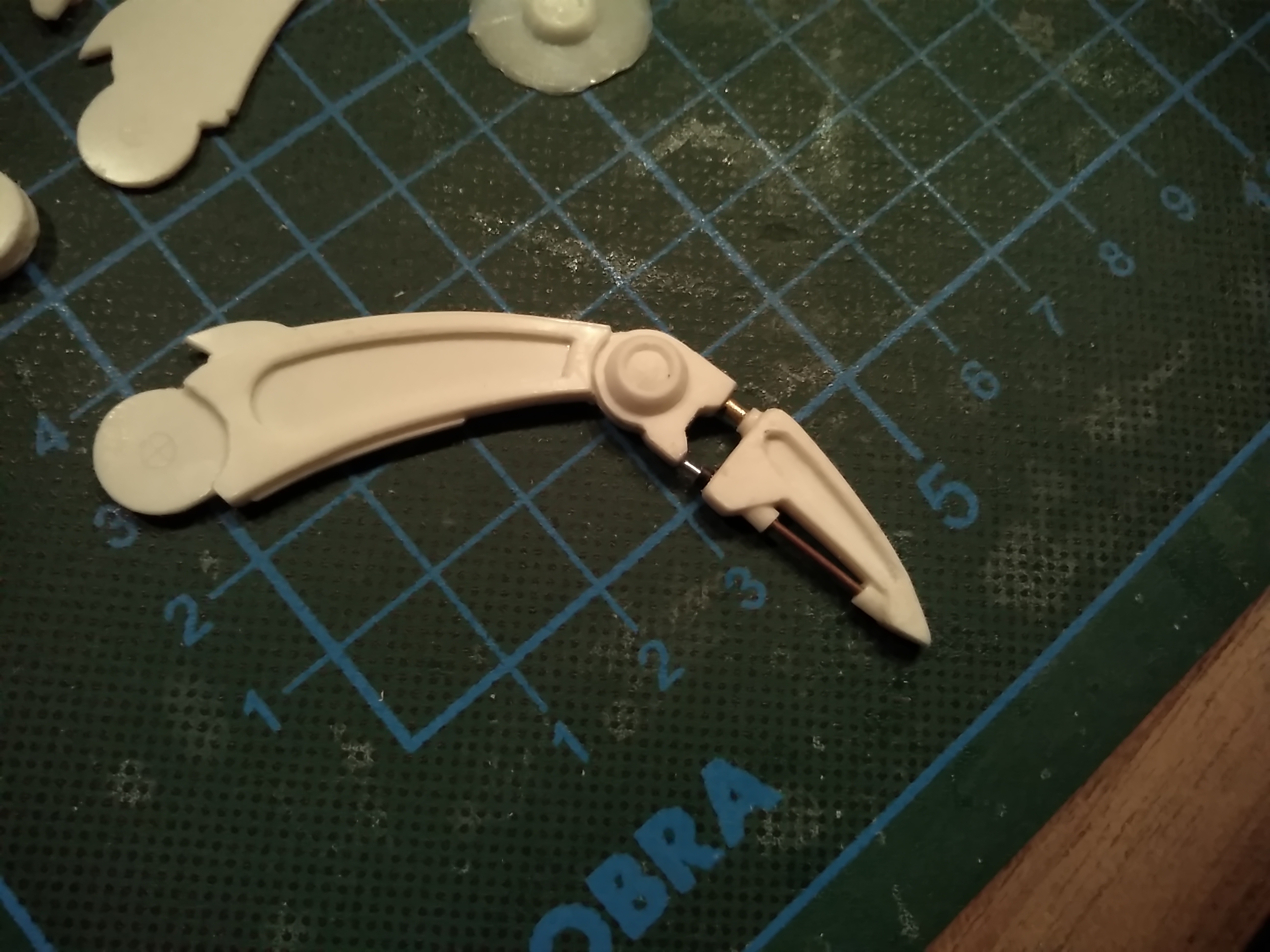

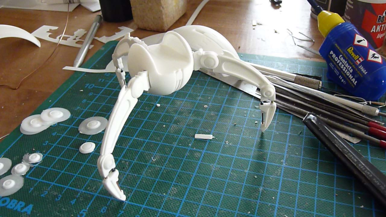

Started with the legs. The pattern drawn in Illustrator:
Cut from 0,5mm PS sheet and the 6 layers glued together:
I'm trying to make them moveable, so wish me luck...

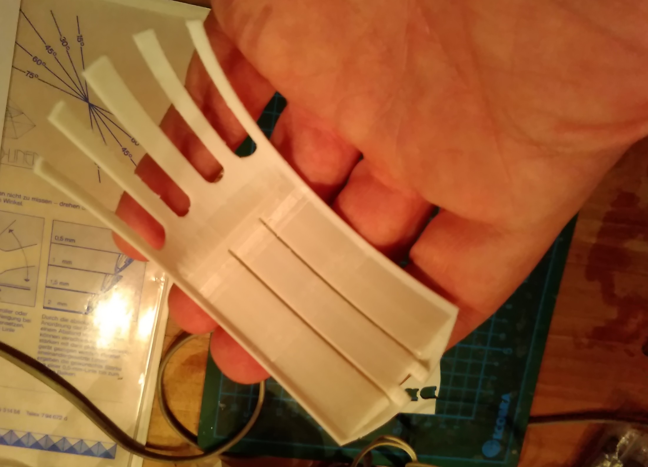

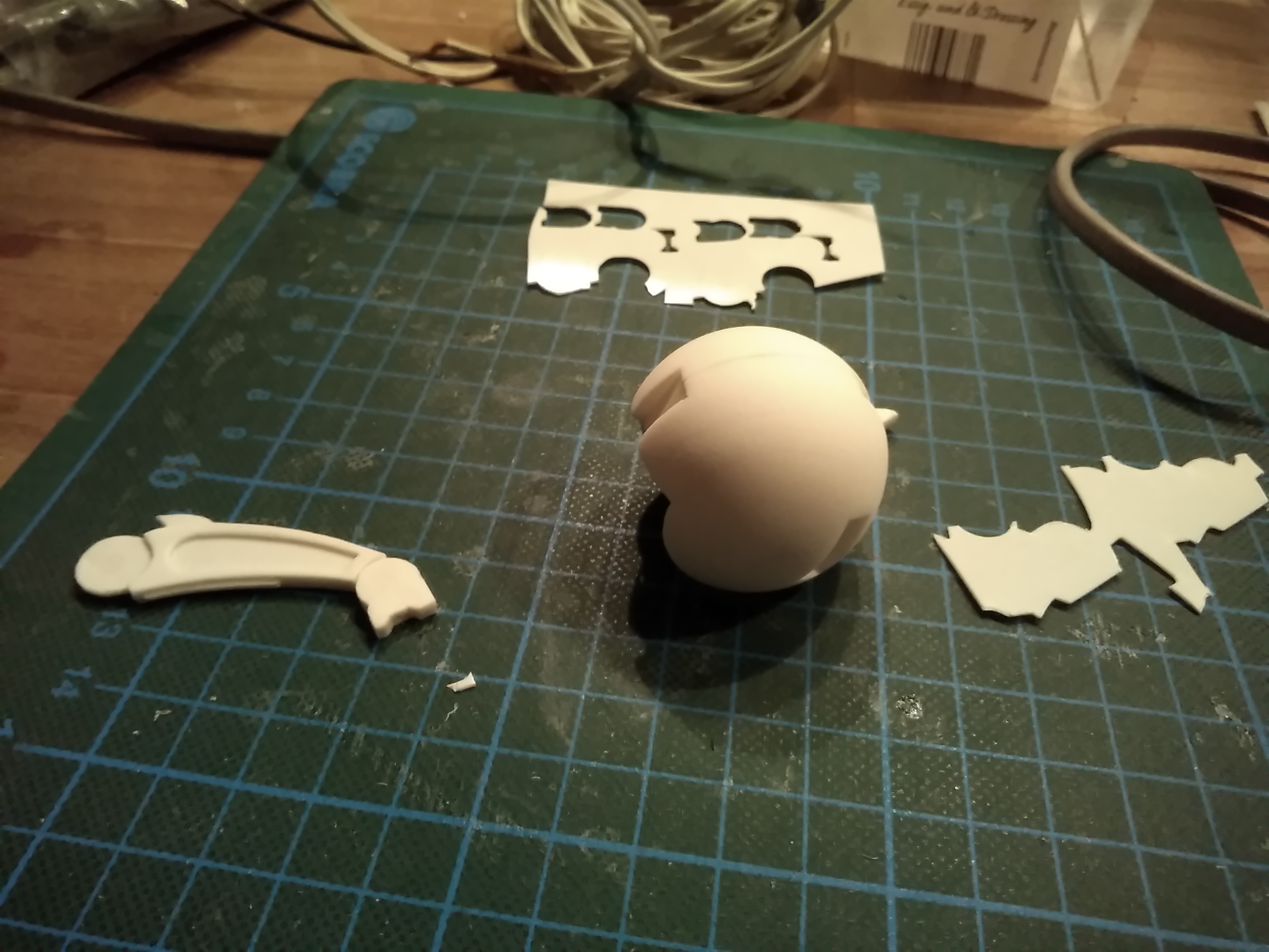

The two printed halfes of the hip sphere. Glued together and sanded:
The back shield direct from the printer bed. Only the support material removed:

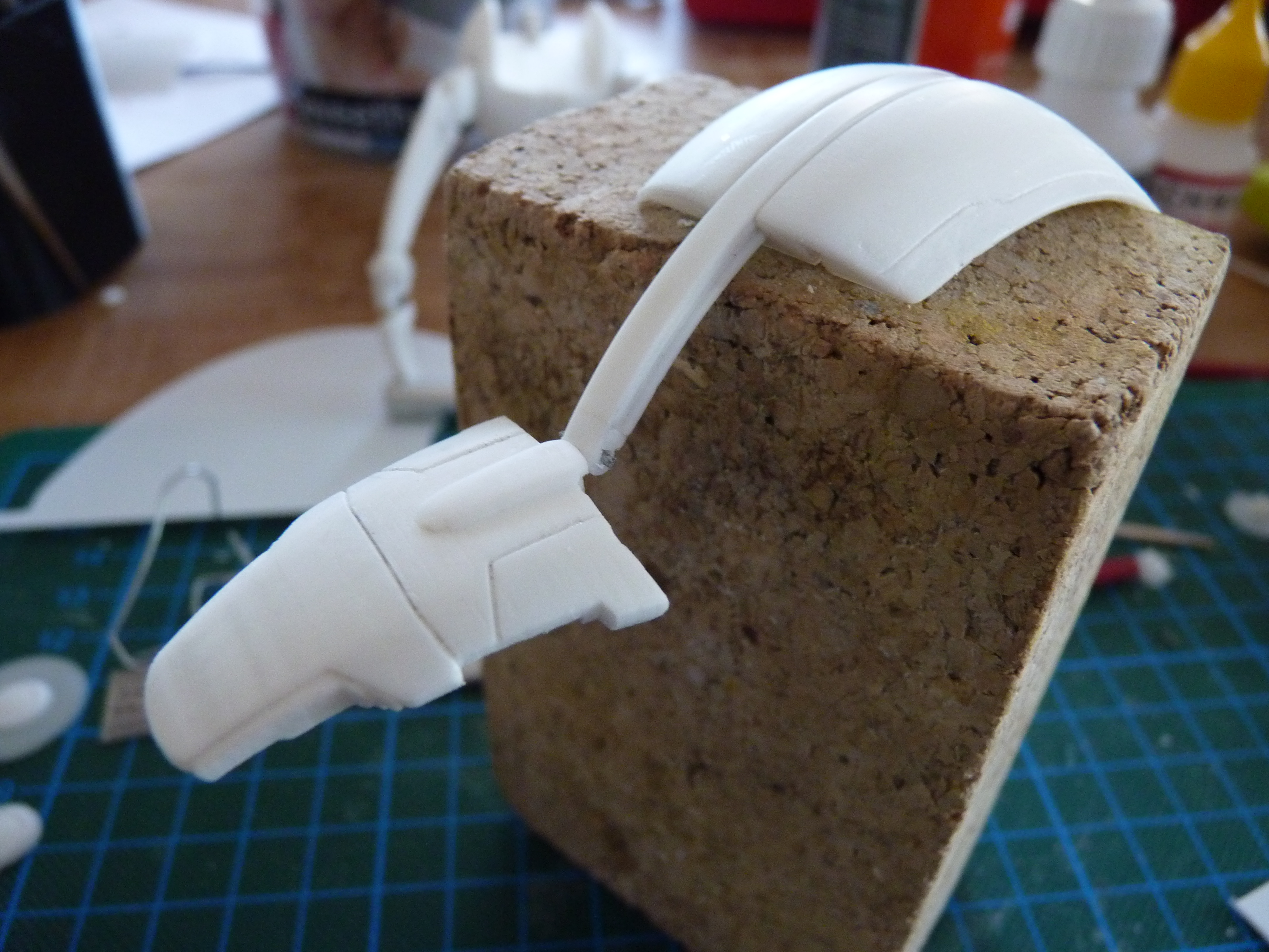

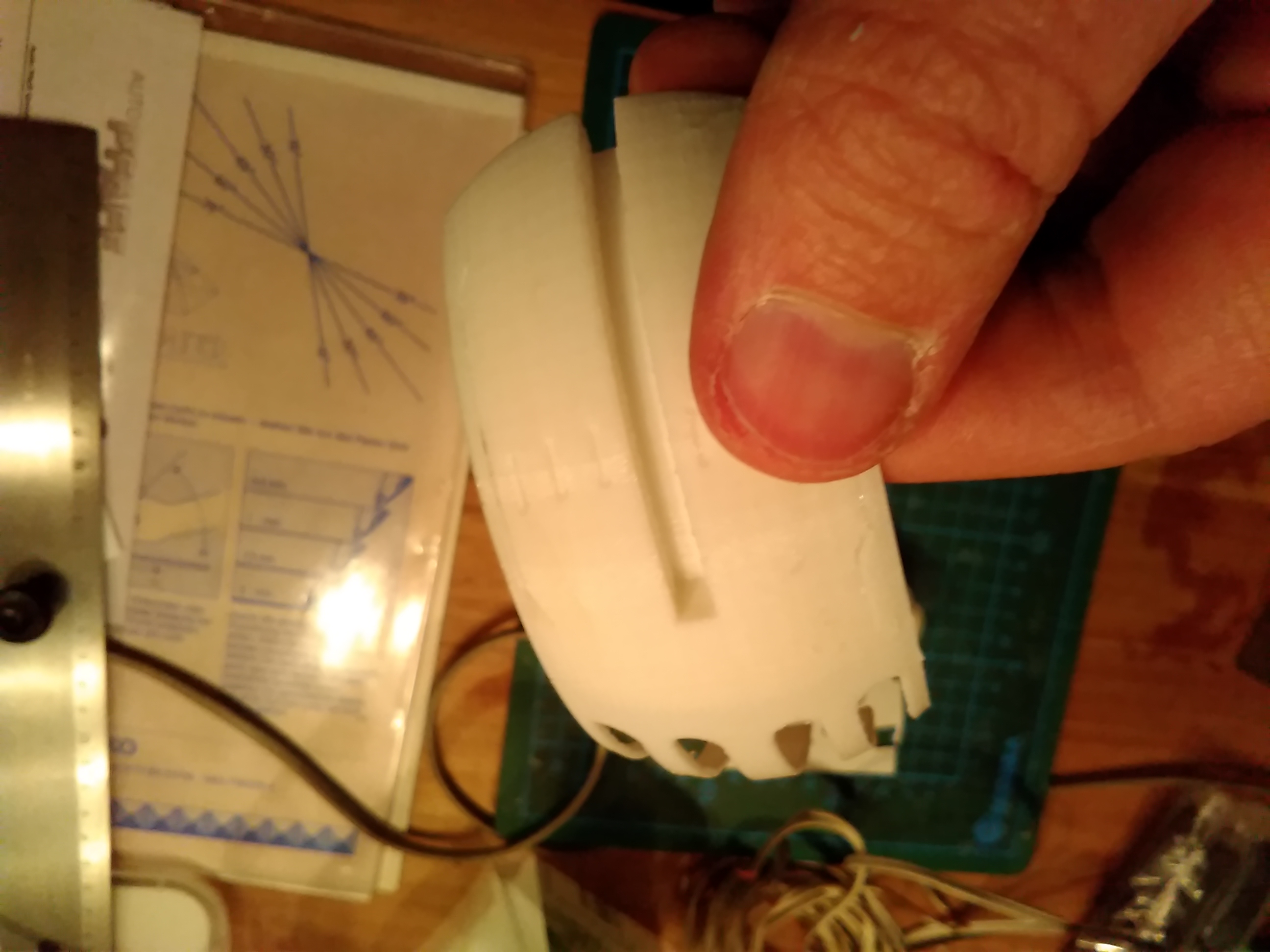

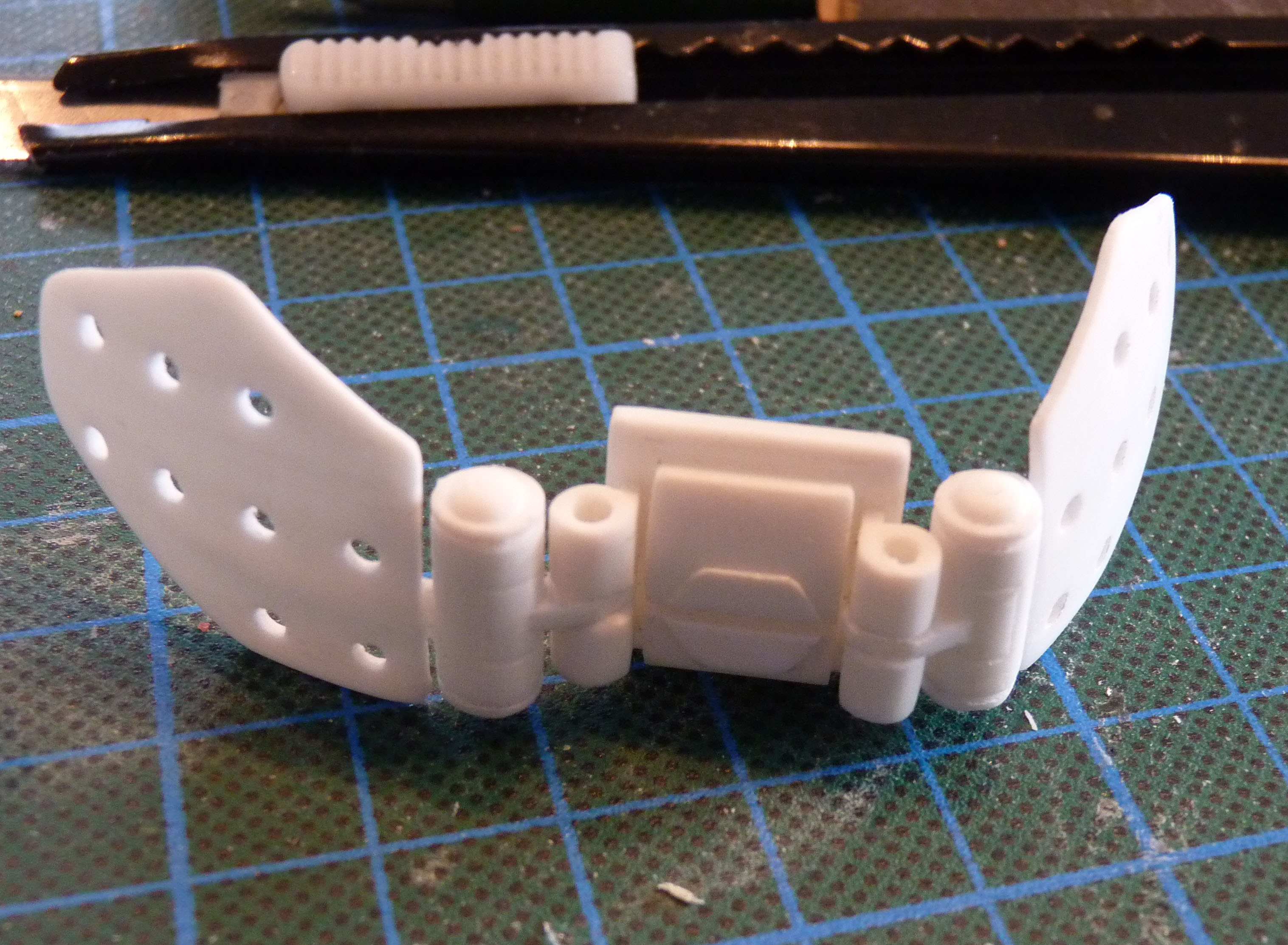

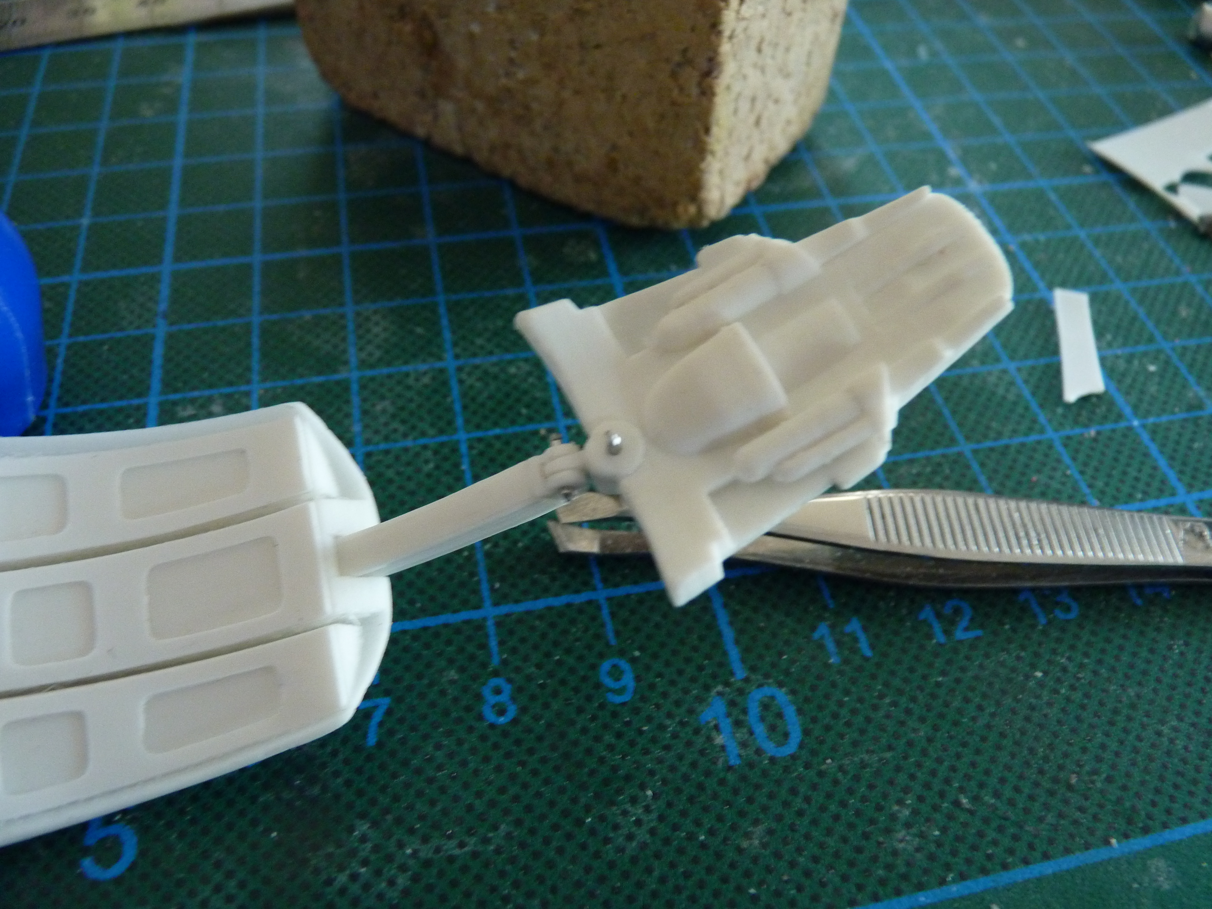

I've managed to glue one rail. And the neck sliced smooth.

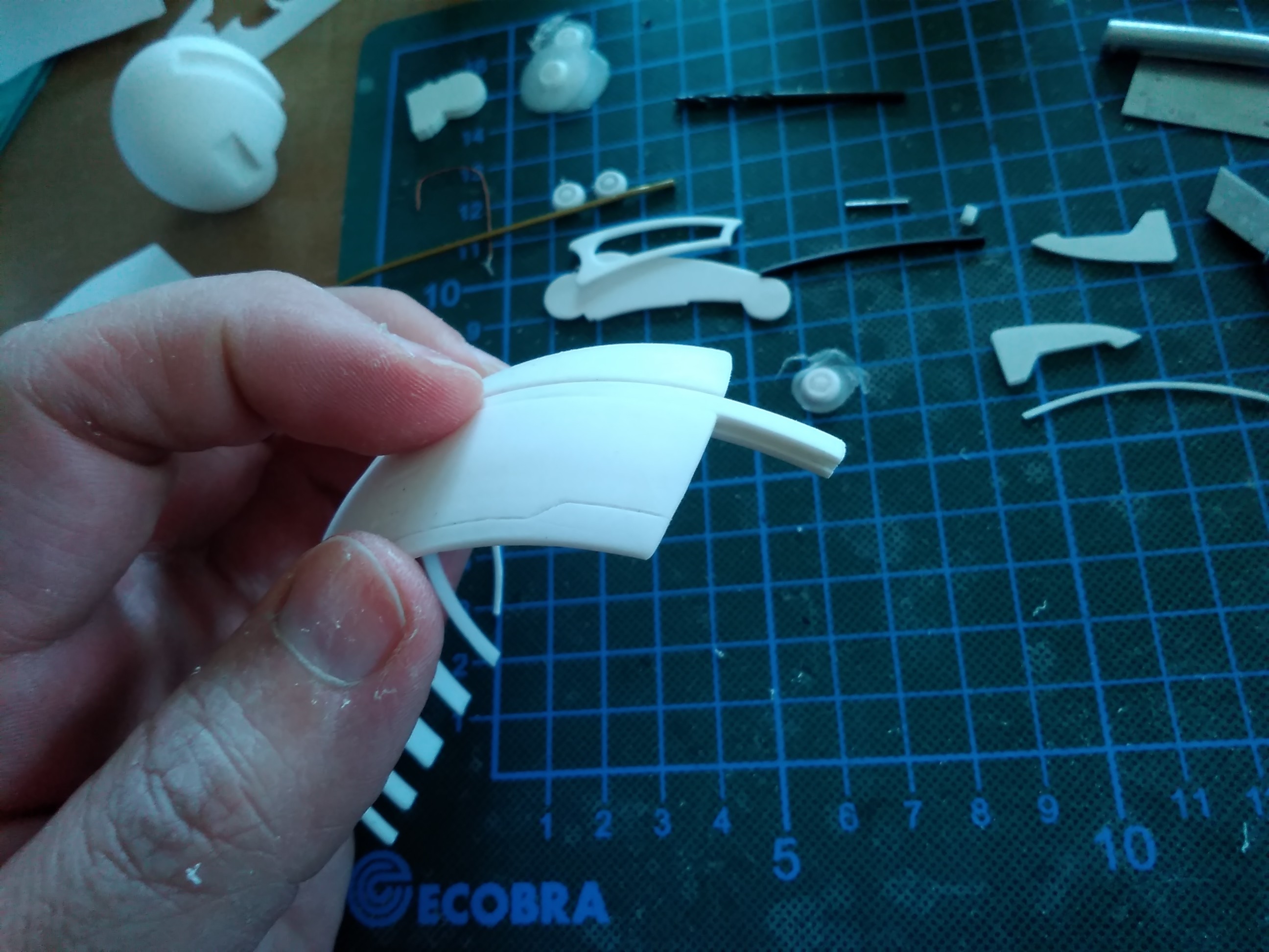

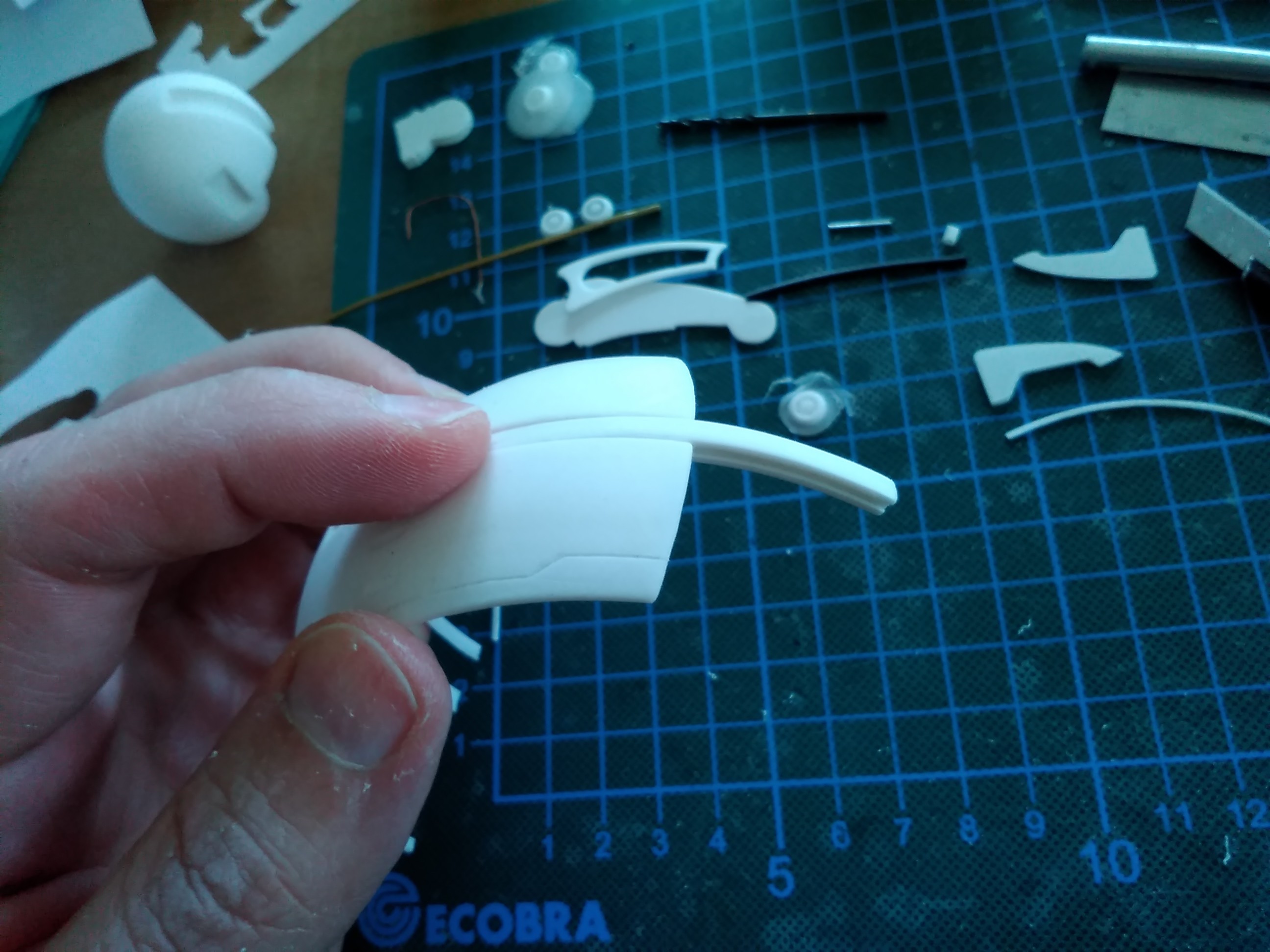

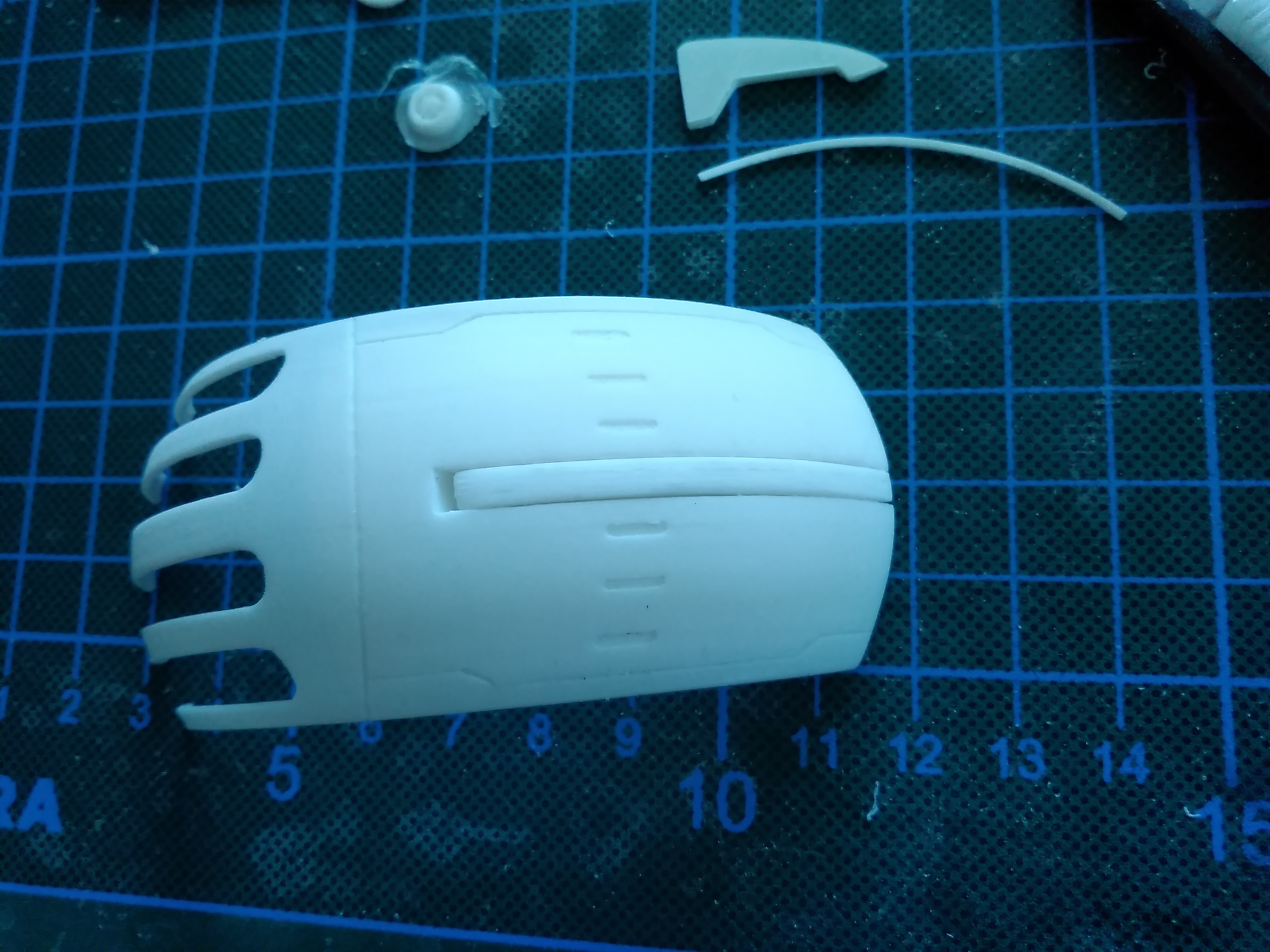

But as I start modeling the head for 3D printing and study the reference pictures, I realize that the shape of the shield is not correct! :(
I remodel and printed it (with the rails for the neck :D )
New one on the left, wrong shape on the right:
Here's a video of the sliding neck (sorry for the bad quality - need more light :oops: ):
And one with the poseable leg.
Duncanator
This is really cool.
You made the legs the same way that John Goodson made the original maquette, by stacking layers of styrene.
