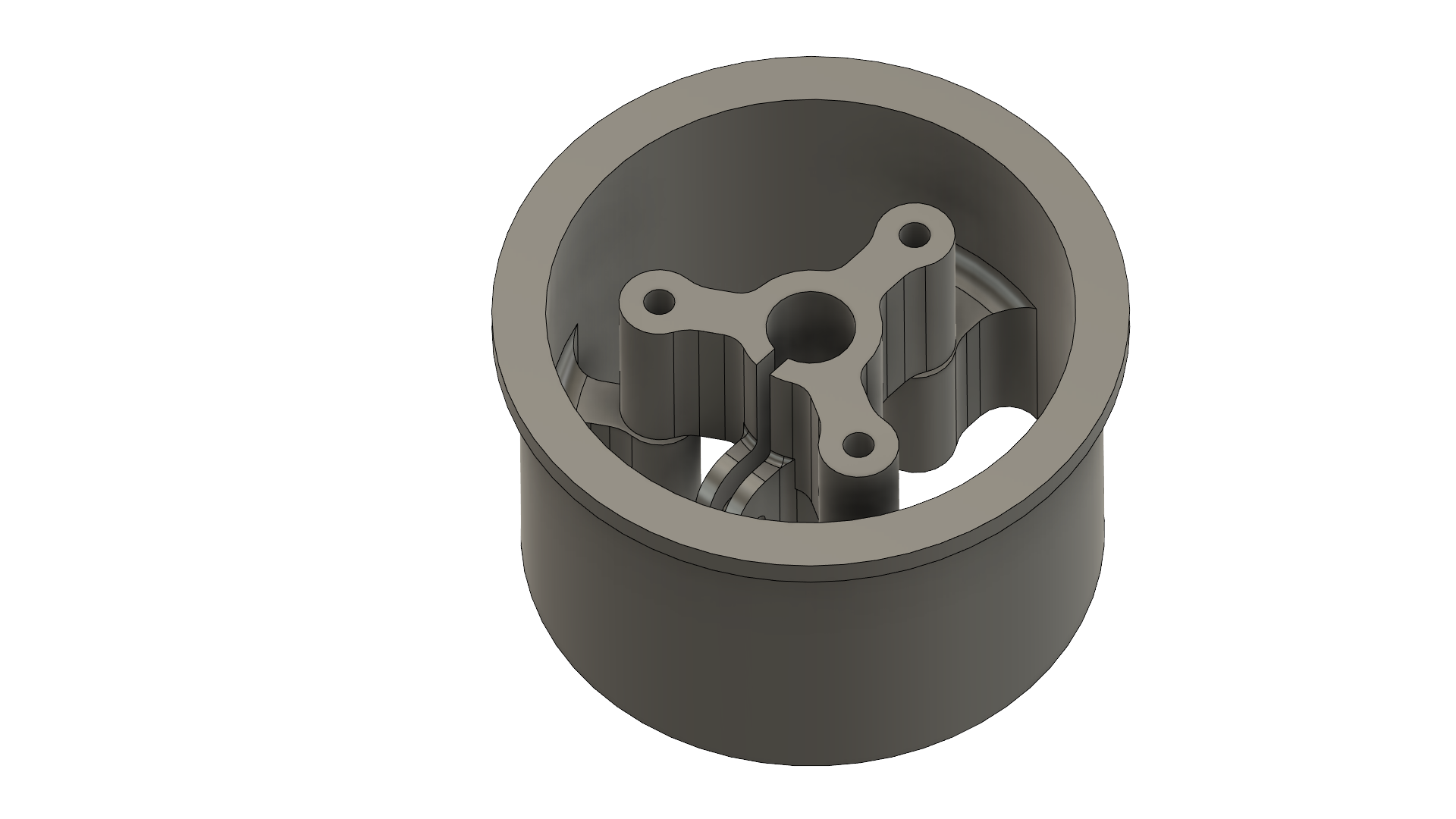

First pass is the creaser, it's spring loaded with a 1/8 rounded steel rod tip which will create all the fold lines:

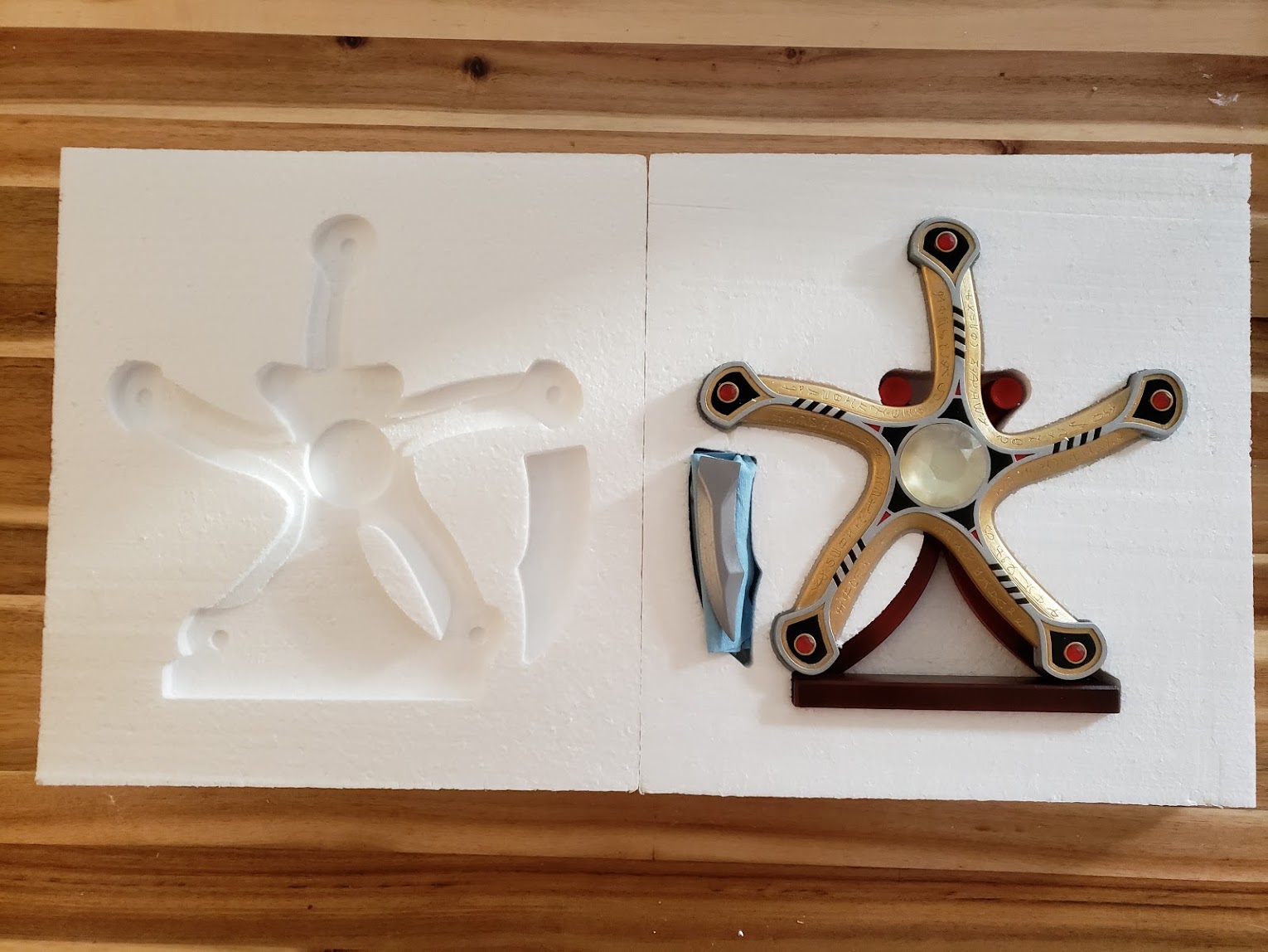

Question: In the past when I've shipped props, I've created custom packaging by CNC cutting clamshell inserts out of styrofoam. As awesome as this works, I'm looking for something more environmentally friendly. I'm rolling around CNC cutting cardstock to sort of an origami inset/box all in one, but even sketching this out makes my brain hurt. I've never seen it done so it does appeal from a nerdy perspective.
I don't just want to shove it in a box with crumpled newspaper, I have standards, but does anyone know of any good, environmentally friendly, and non-cranium imploding, options?

This is how my previous packaging looked:
Looks great, works great, terrible from a sustainability standpoint.

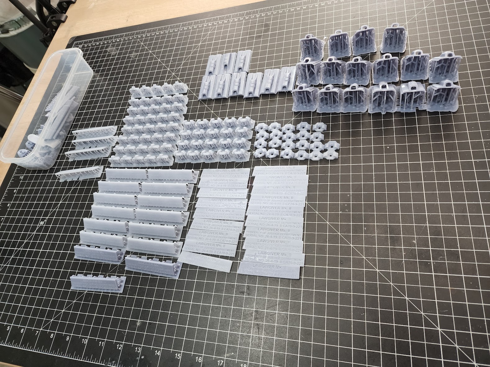

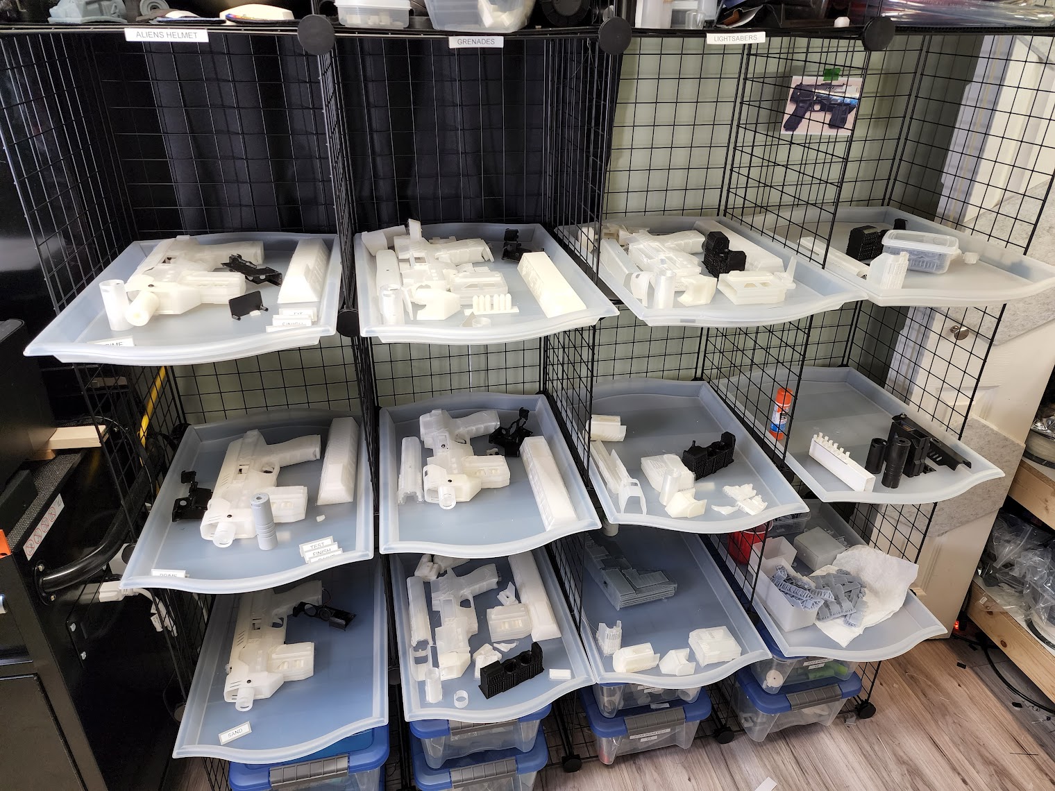

Here's a snapshot of the progress so far:
3 sanded, tapped, and fitted. 3 more fully printed and in sanding, and the rest in various states as you can see. I'm working across from left to right by row.
The gray frame 3 down and 3 over was for the YouTube video, but as I said before, there's something magic about this natural PLA and it turned out substandard enough that I'm just going reprint and do the YouTube ones in clear. I don't want to go through all that and have more for the 'seconds' bin. I'm starting priming and more rounds of sanding for the first three from tomorrow, I figure I'm going to work in batches of 3, should keep progress snappy while not making anyone wait longer than necessary. I'm timing everything so after the first 3 I'll have pretty accurate ETAs on the rest.

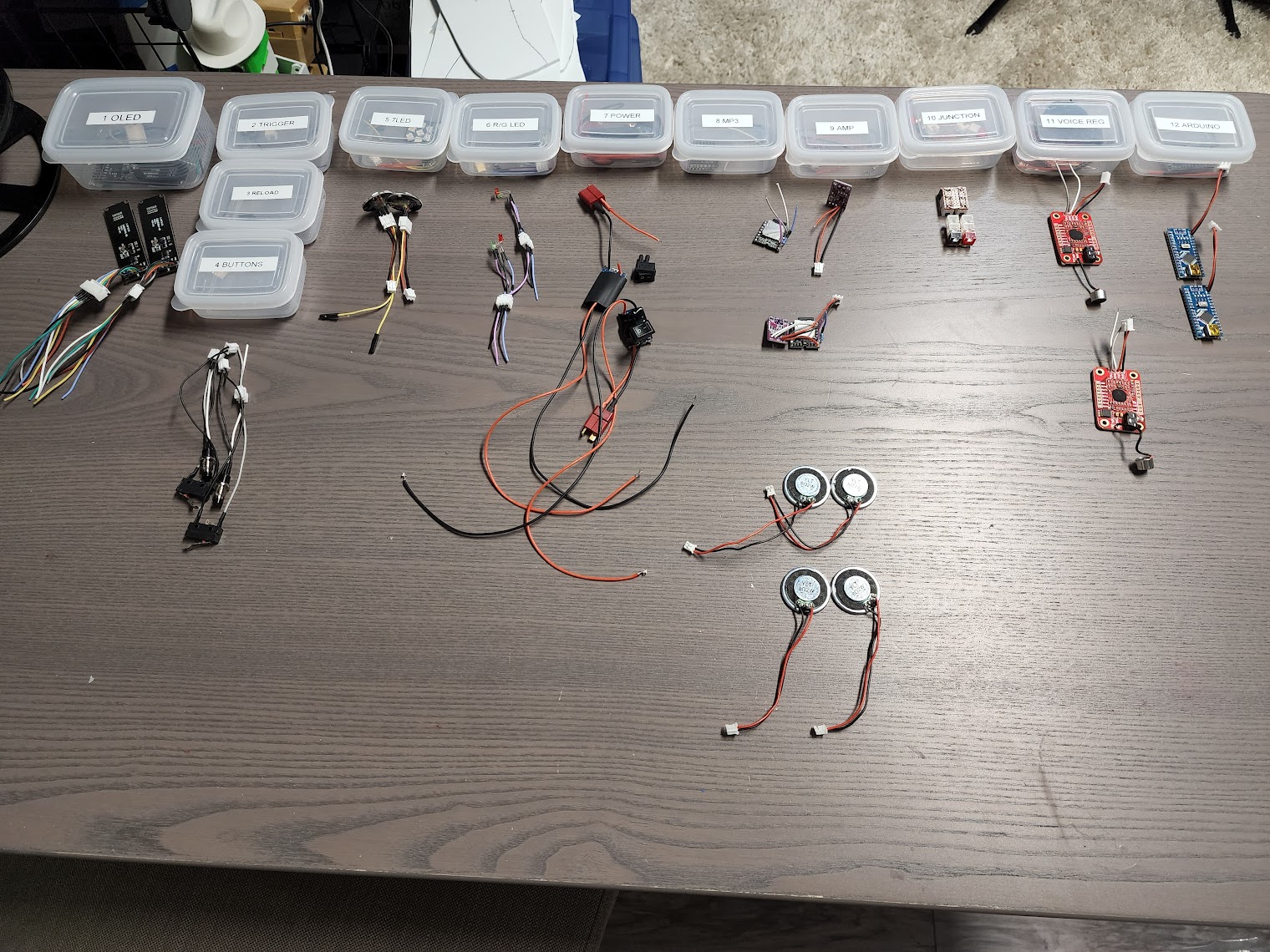

Dredd 2012 Electronics 3D Model and Build here's some insight into all the electronics that go into this. I did this today as part of an inventory and a setup to start powering through all the electronics for the run as well as a guide for those building their own, 2fer! Those who just wanted the soldered electronics won't have long to wait, I should be ready to ship those in a week or so.

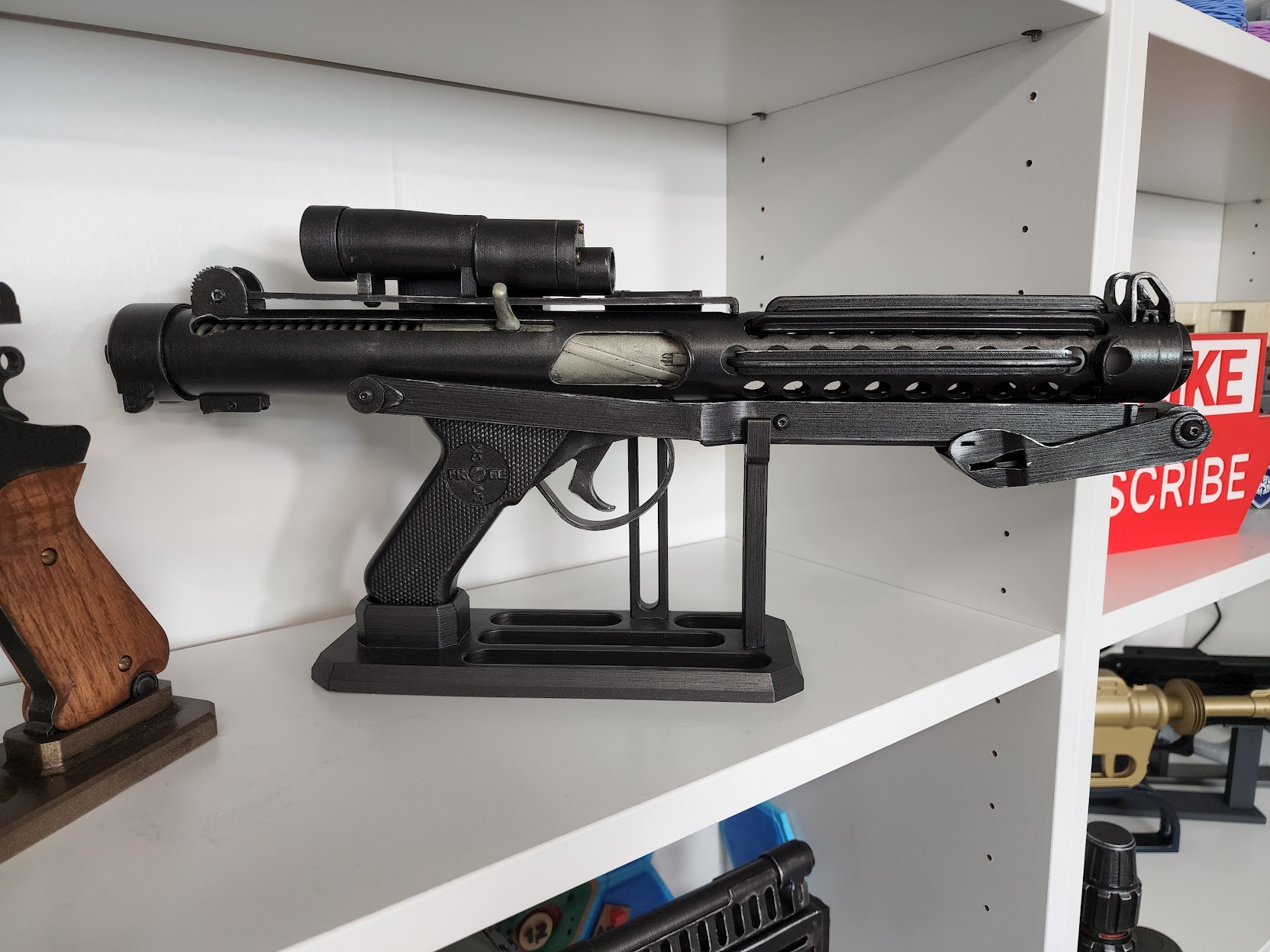

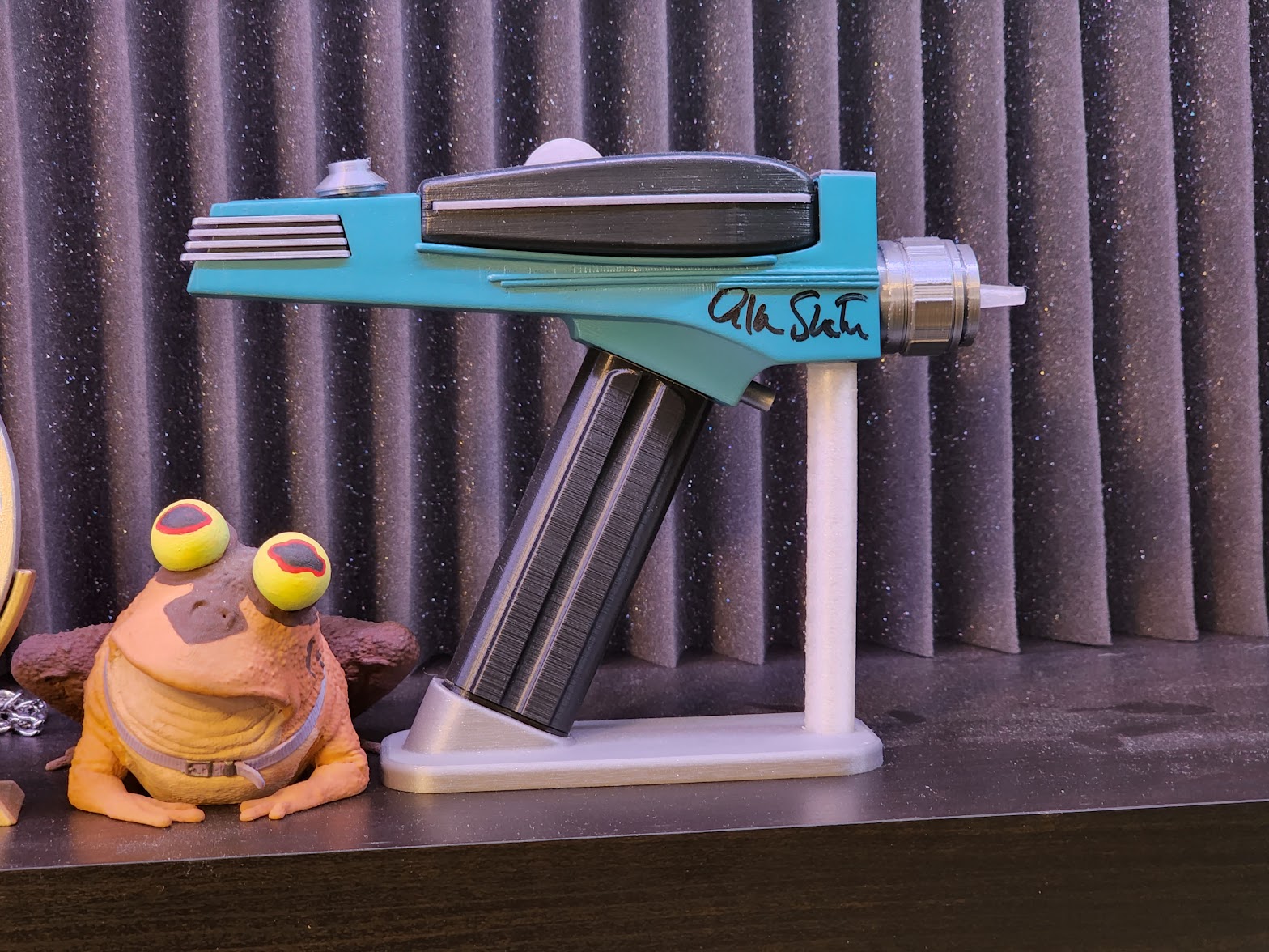

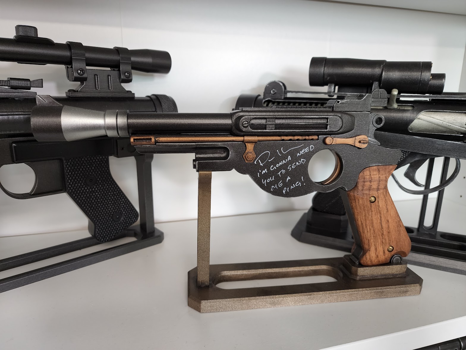

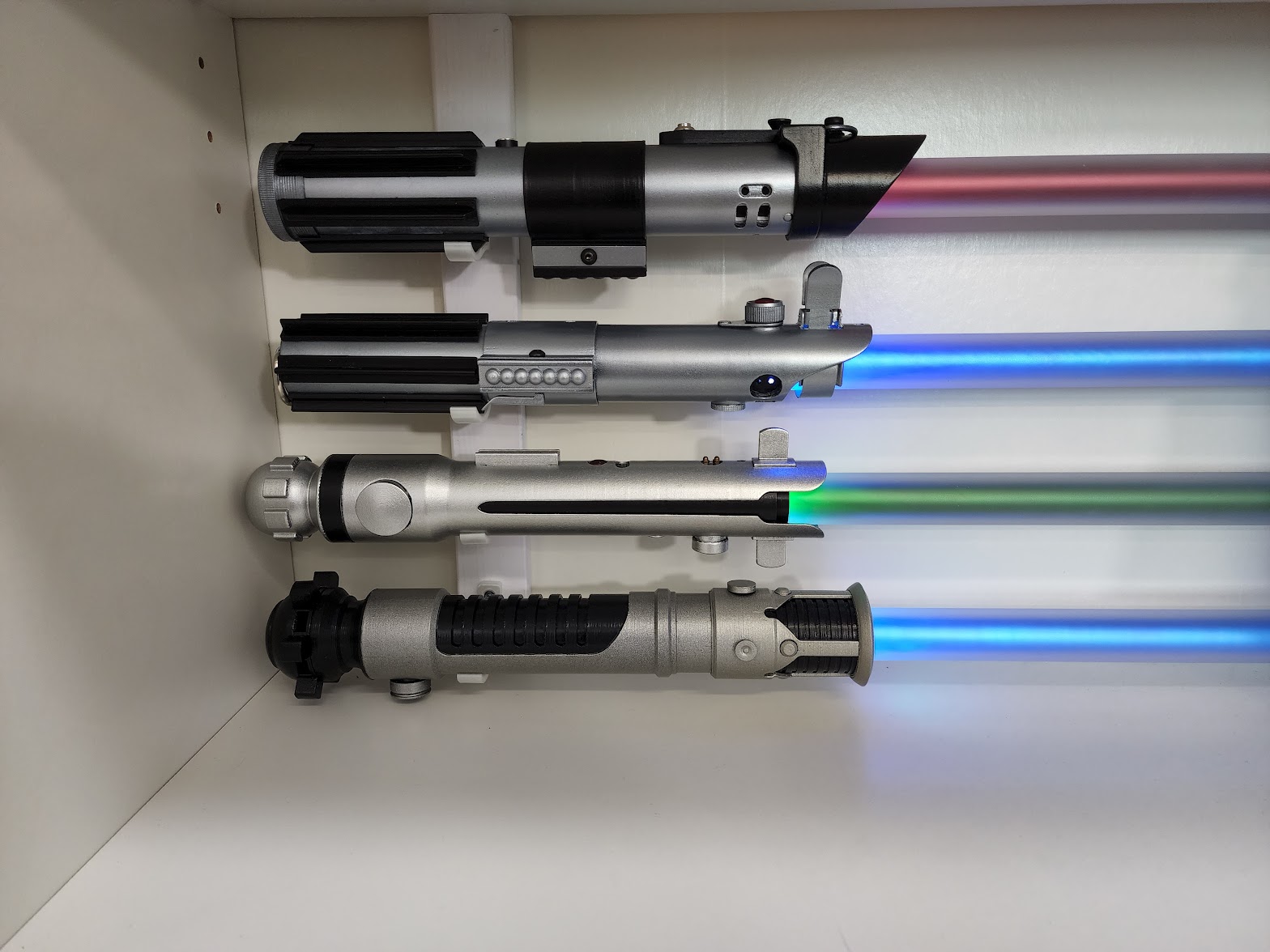

Just for fun, here's a few of the ready to film 3D printable completed projects I will be releasing as soon as I can:
TOS Phaser, type 1 Phaser is removable. I was showing it to this dude Bill and he scribbled his name on it, decided to leave it there...

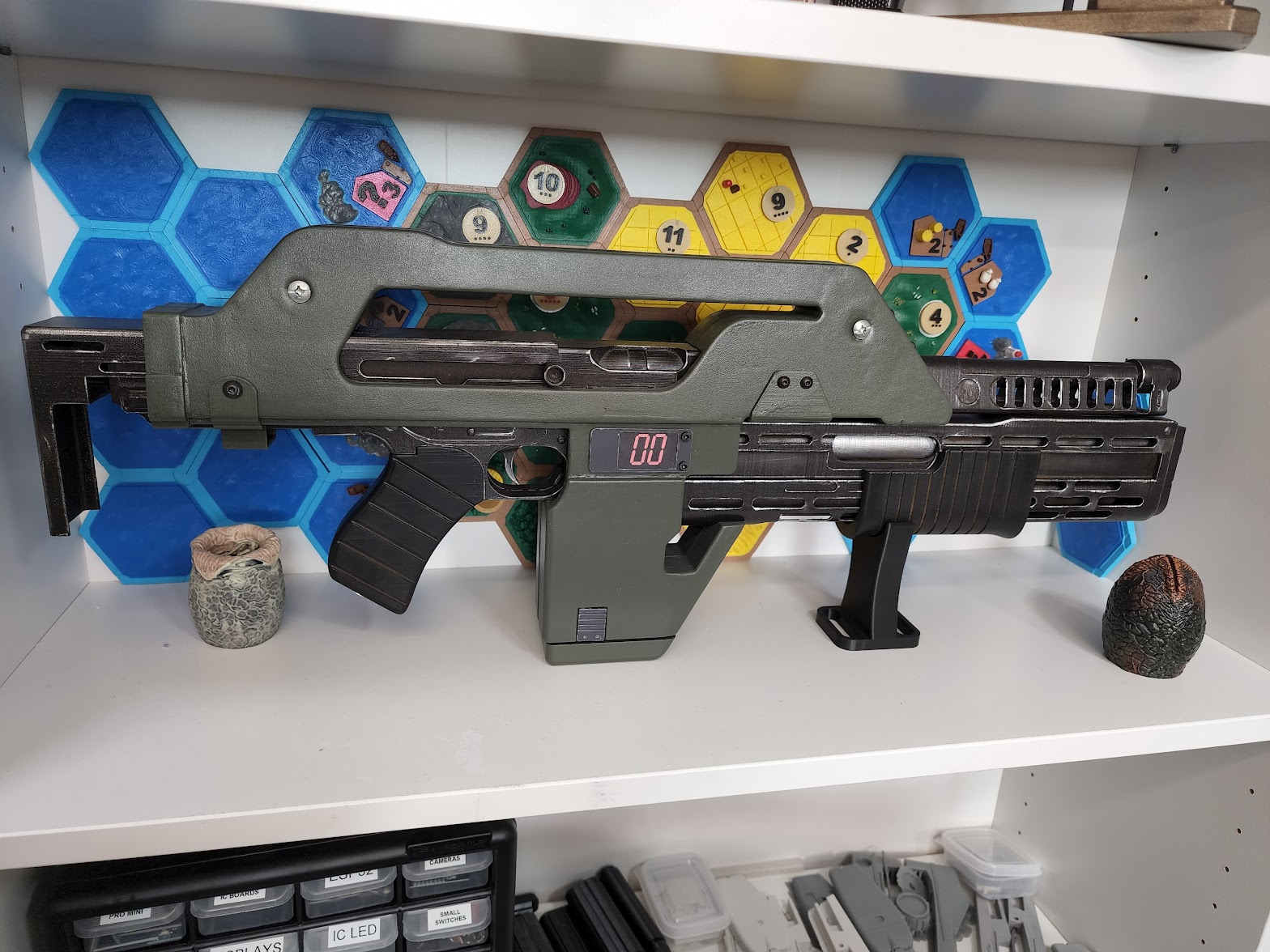

Aliens Pulse Rifle, this is already released as fully mechanical version but I'm doing it electronic! All parts move, shell comes off, grenades insert
A whole whack of lightsabers that use cheap PVC core, these are compatible with many saber kits for pixel, smoothswing, etc.
Droid popper with mutiple lighting modes with countdown time, weighted so it's always the right way up!
As seen in Bucketheads, awesome fan show, check it out on YouTube. Full lights and sounds, working bolt, working stock, light up scope, etc

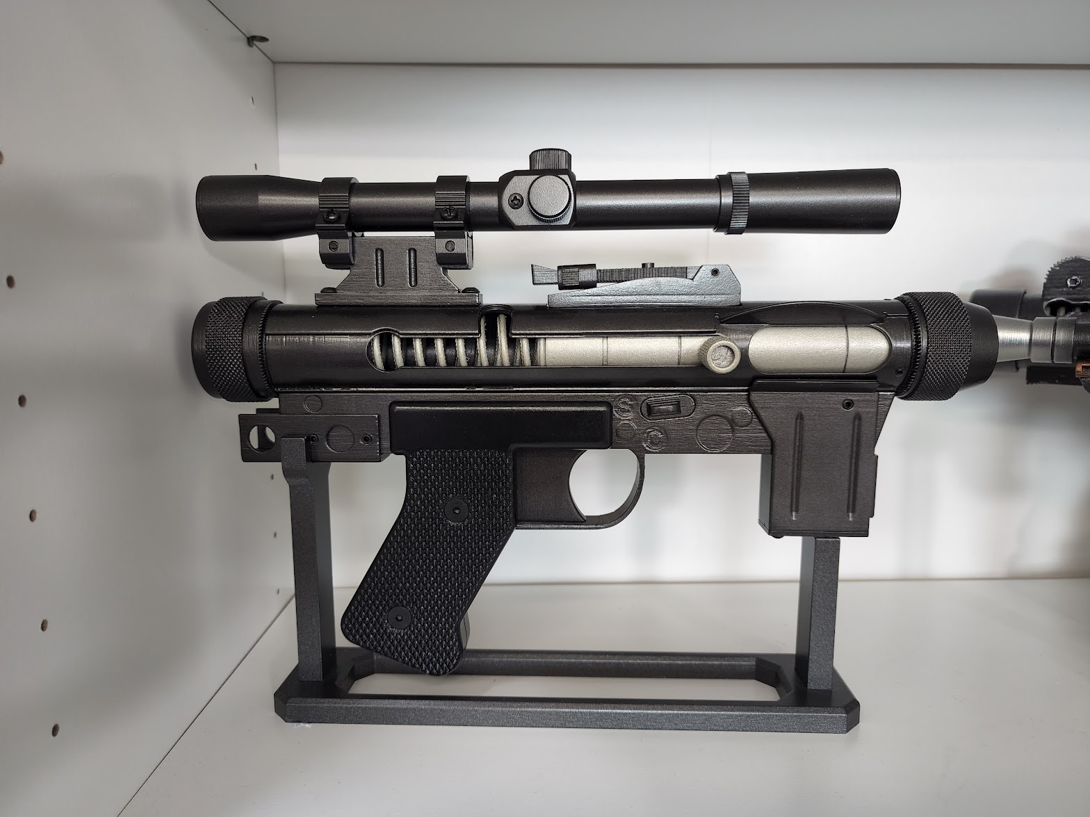

Same as the E-11 except this is an experiment with haptic feedback, scope is real too!

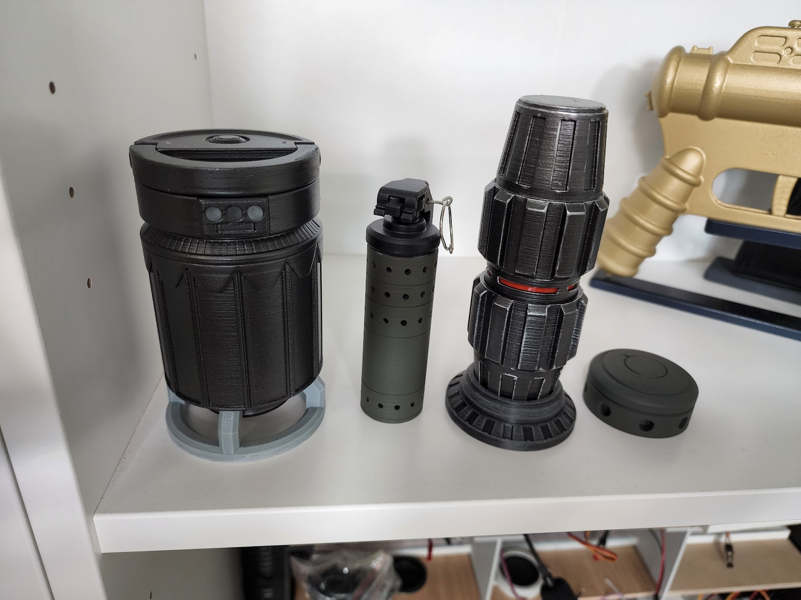

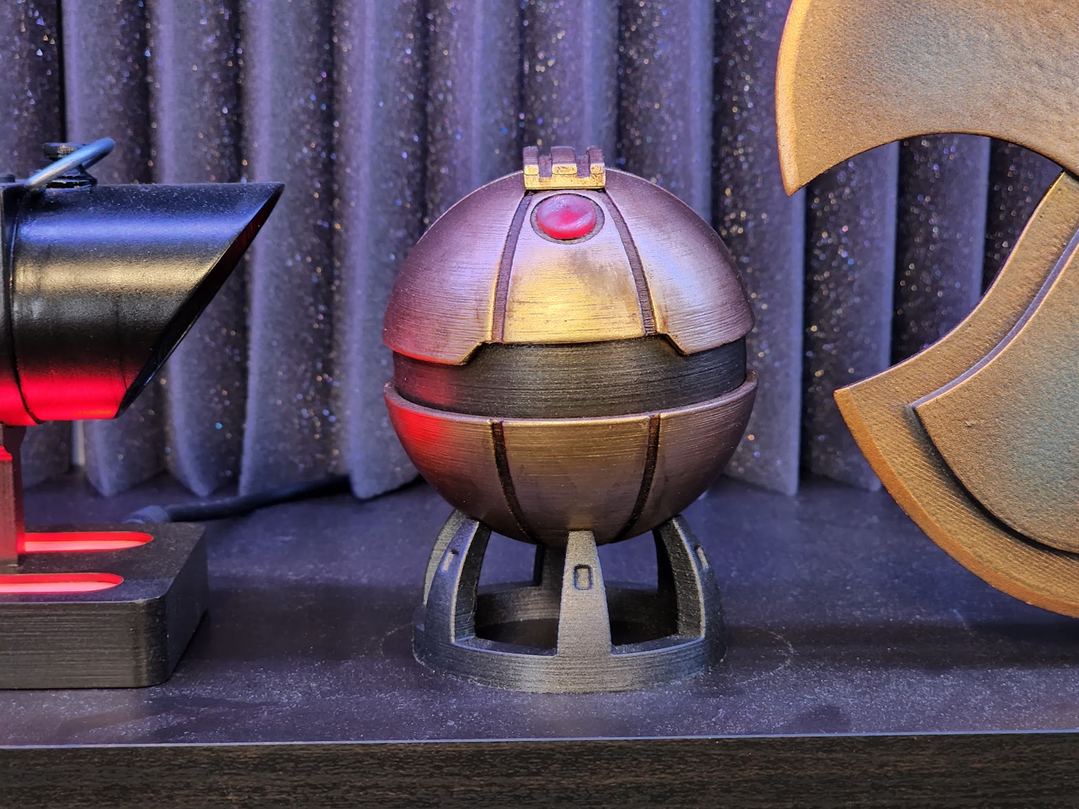

Lots of grenades. Frag has working lights, Dredd smoke has working pin action, Dredd mine is magnetic.
Mando blaster has full working electronics in this teeny little package. This was a design nightmare!

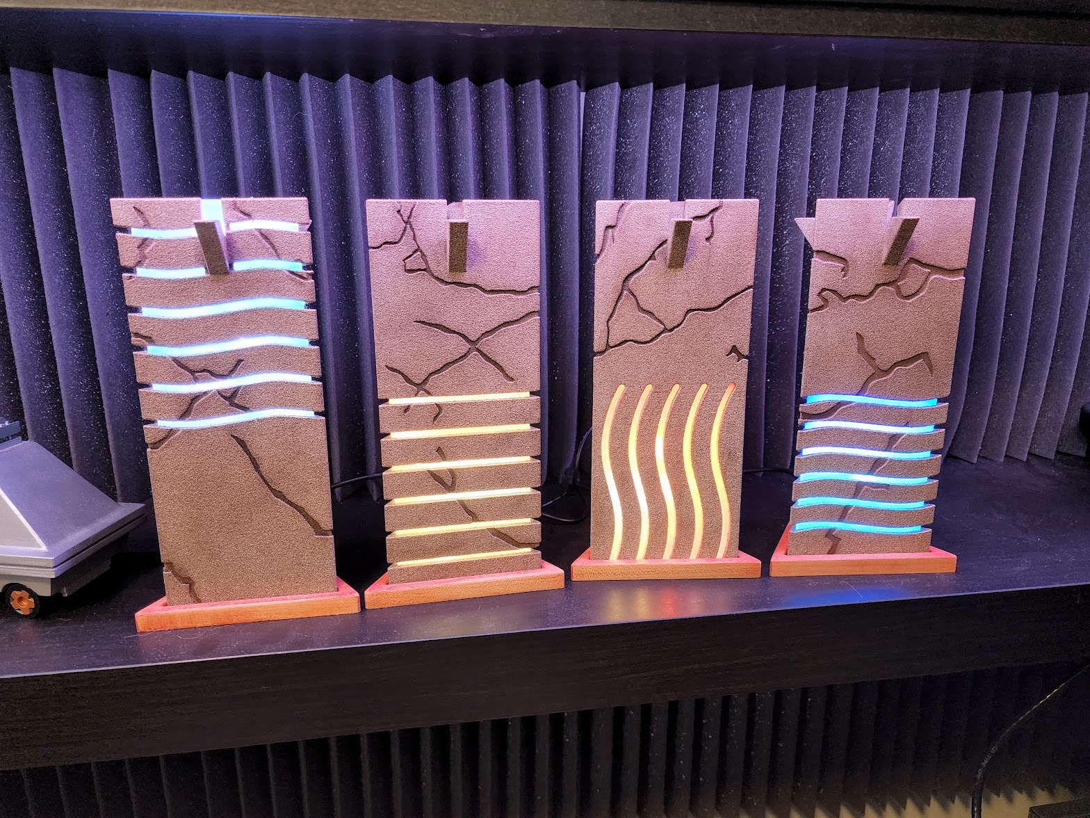

5th Element stone each have different animations representing the movement of each element, surprisingly easy to make
And there's about twice that in my computer waiting to go. Apologies if this is horn tooting, but I'm excited to be sharing all this work and I gotta get my butt in gear to get this all out, the E-11 was printed in 2019!!

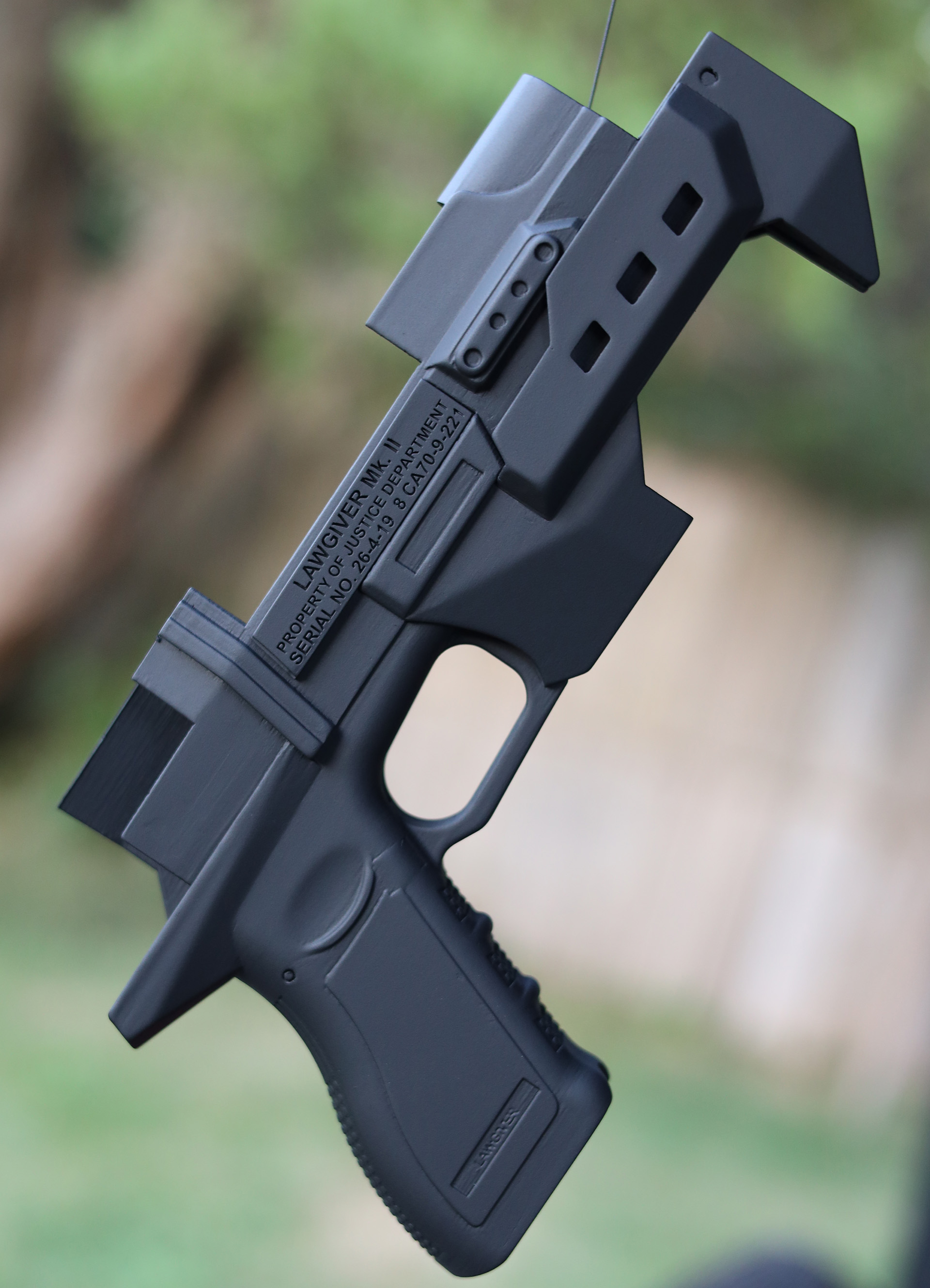

It also occurred to me that I may be able to send him the first one in the pics just to make sure the paint is cured, (after it has been stripped, resanded, repainted, refinished, and has updated electronics. No compromises!) but I want to ask to be transparent and keep options open to make this happen.

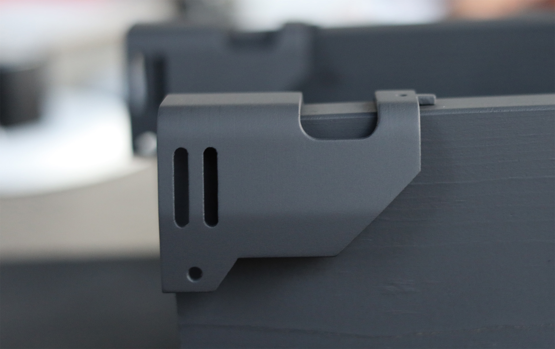

Someone asked me on my discord my prep method so copy/pasting just fyi. Pic at the end of a frame in process :)
Pass 1:
- Sanding flat surfaces with diamond blocks(120,200,400)
- Sanding details with diamond pin files (150,220,320)
- Sanding with 3M flexible (150,220)
- 1K black primer
...wait a day...
Pass 2:
- Fill small imperfections with acrylic paste (acrylic mixed with marble), large with bondo glazing putty
- Detail cleanup with carving tools and knives
- Sanding with 200,400 diamond block
- Sanding details with diamond pin files (220,320)
- Light sanding with 3M 220 flexible
- Scotch bright pad fine
- 1K black primer
...wait a day...
Pass 3:
- 400 diamond block
- Extra fine scotch bright pad
- 1 more light 1K coat, only extra fine scotchbright
Then it's ready for final paint!
