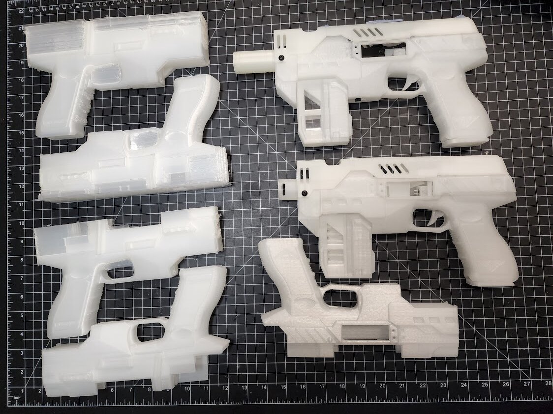

Looks like I'm reprinting all the front and rear sights, but I think it's well worth it:
I'll measure progress in frames completed:
The stronger engineering PLAs are a real PITA to remove support material from and sand so I'm just going slow and steady. If I ever have a fail or sub-standard I may do a short vid hammering a nail in with one to show just how good this new PLA is...or if they all work out I may just print a hammer for fun, we'll see. Though these are mostly only frames in the pic, I'm printing them in complete sets. Laying out that many parts would have been a little crazy.
I'm working in sets of two, I may mail them out in sets of 2 or sets of 4, but no more than 4 complete before mailing for sure. With BeakZ and Spidey74 doing their parts, this should fly once the initial work is done.
Status:
2 - Sanded, fitted, tapped. Ready for first primer coat and then second detail sand
2 - Support material removed, in sanding
3 - Printed and ready for support material to be removed
more printing as we speak...

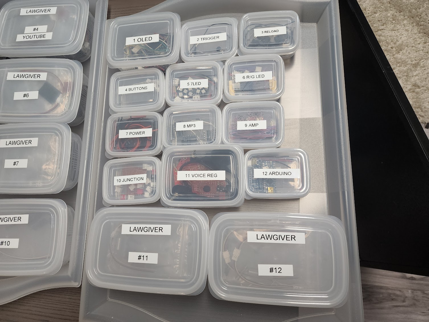

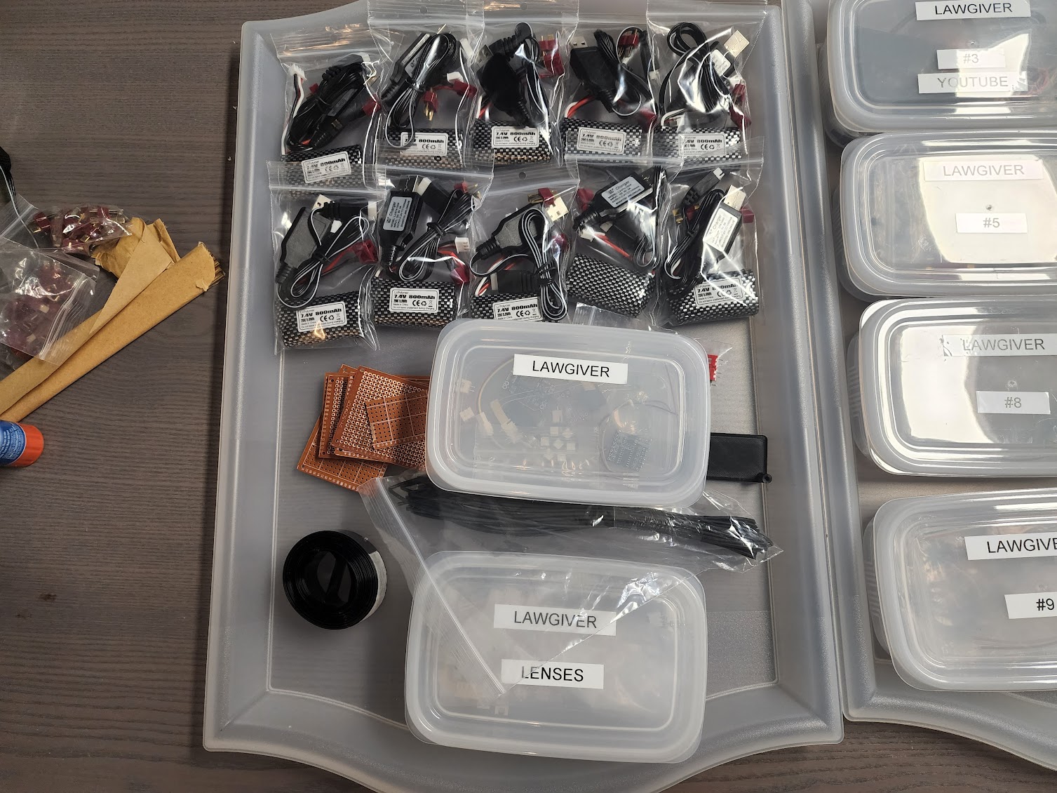

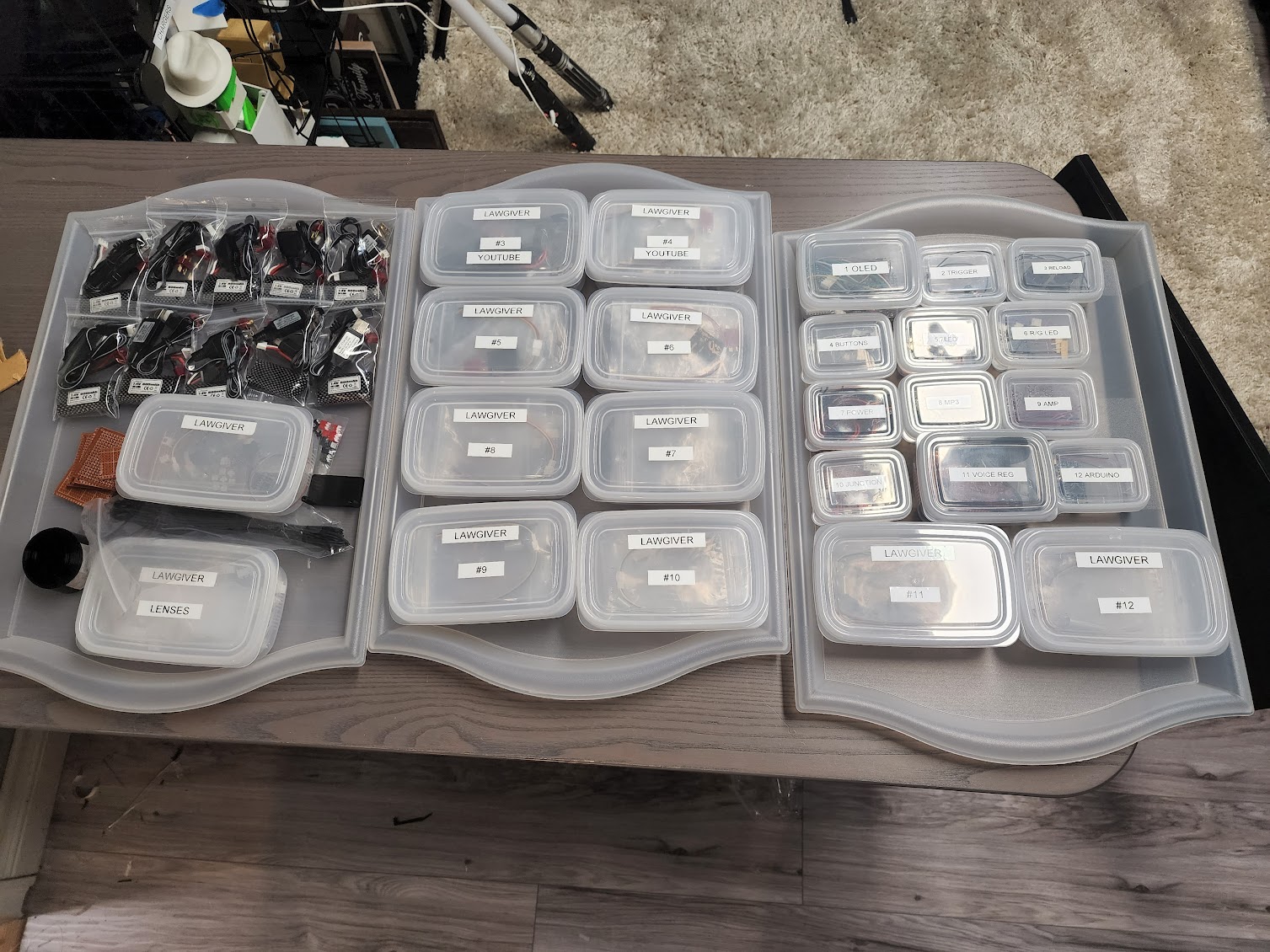

Electronics are almost all kitted and ready for solder, going to try and get at least 2 kits done tomorrow to pair with the 2 going into the paint process, it's a crazy amount of soldering but if it goes well I'll try and get 2 more done, still want to work in sets of 4 if possible:

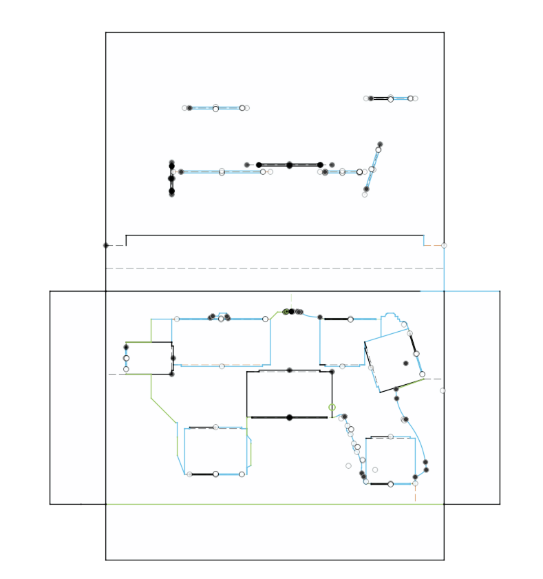

Question: In the past when I've shipped props, I've created custom packaging by CNC cutting clamshell inserts out of styrofoam. As awesome as this works, I'm looking for something more environmentally friendly. I'm rolling around CNC cutting cardstock to sort of an origami inset/box all in one, but even sketching this out makes my brain hurt. I've never seen it done so it does appeal from a nerdy perspective.
I don't just want to shove it in a box with crumpled newspaper, I have standards, but does anyone know of any good, environmentally friendly, and non-cranium imploding, options?
After an hour of noodling, and I'm still VERY open to ideas, I think I have an answer. I can buy unbleached cardstock and my CNC drag knife to cut a pattern like this (lots missing from this insert still):
This will create a foldable insert design that locks together, securing the lawgiver, and suspends 1 1CM at the bottom for a small foam insert. Then I can do the same for a box and add another 1cm insert on top. Secure box, looks great, minimal material, thoughts?
edit: to head off the 'it won't fit together' comments in advance, I know, I just gave myself 1hr to solve the problem, doesn't have to be perfect as long as the idea is captured :)
