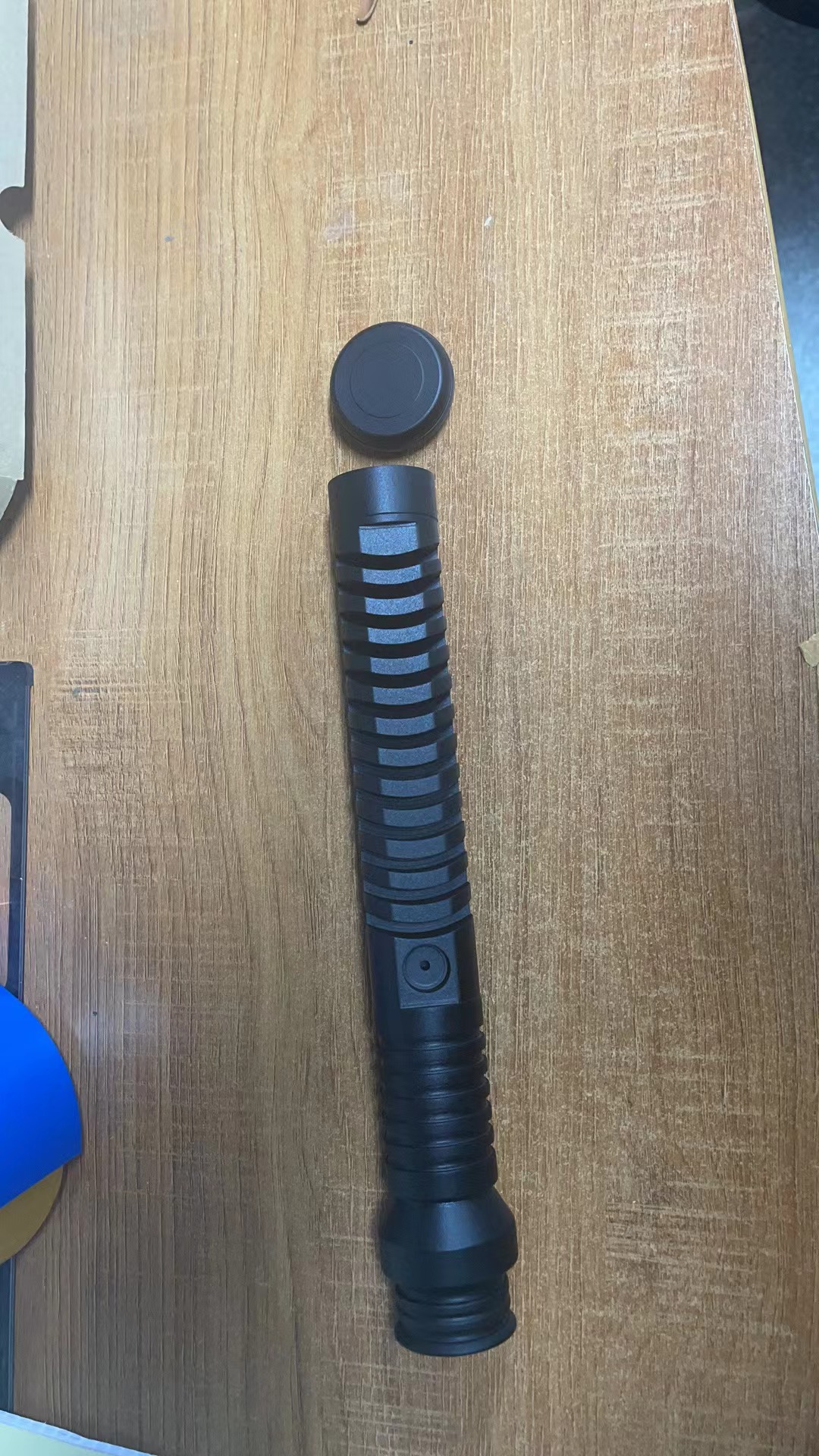

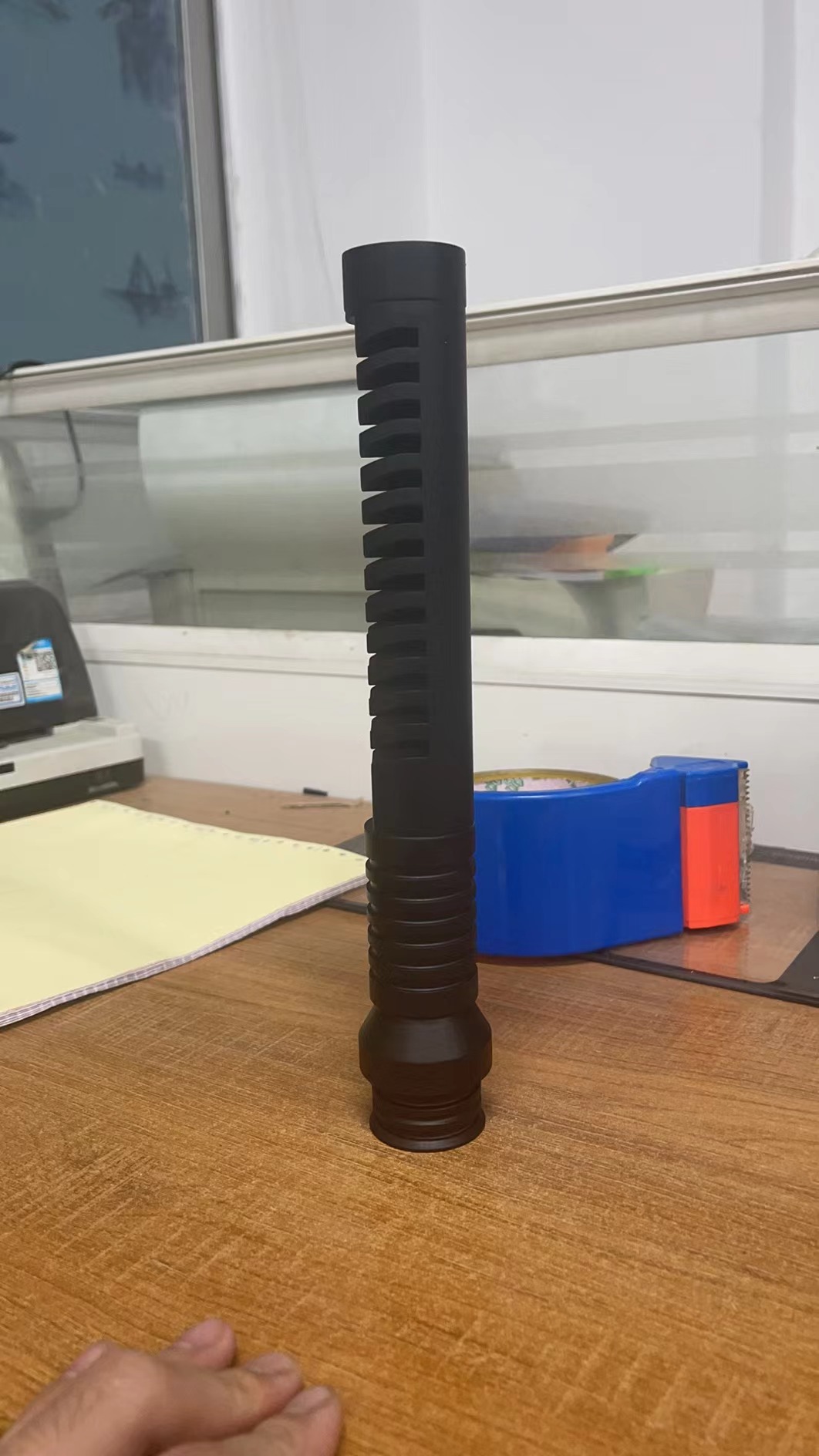

tried ABS from a different shop. The material held up well, with no warpage. The only issue is the finish is not as smooth as delrin, so if we go with it, well probably have to get them painted.
I’d personally be okay with a ‘finish at home’ type kit since a lot of us painted the delrin anyway.
I'd be ok with painting it myself. Just need to know what Spraycan I need/can get in europe/austria. Satin black? Not that common here but seems to be the "semi-matte/silk-matte" most of the time?

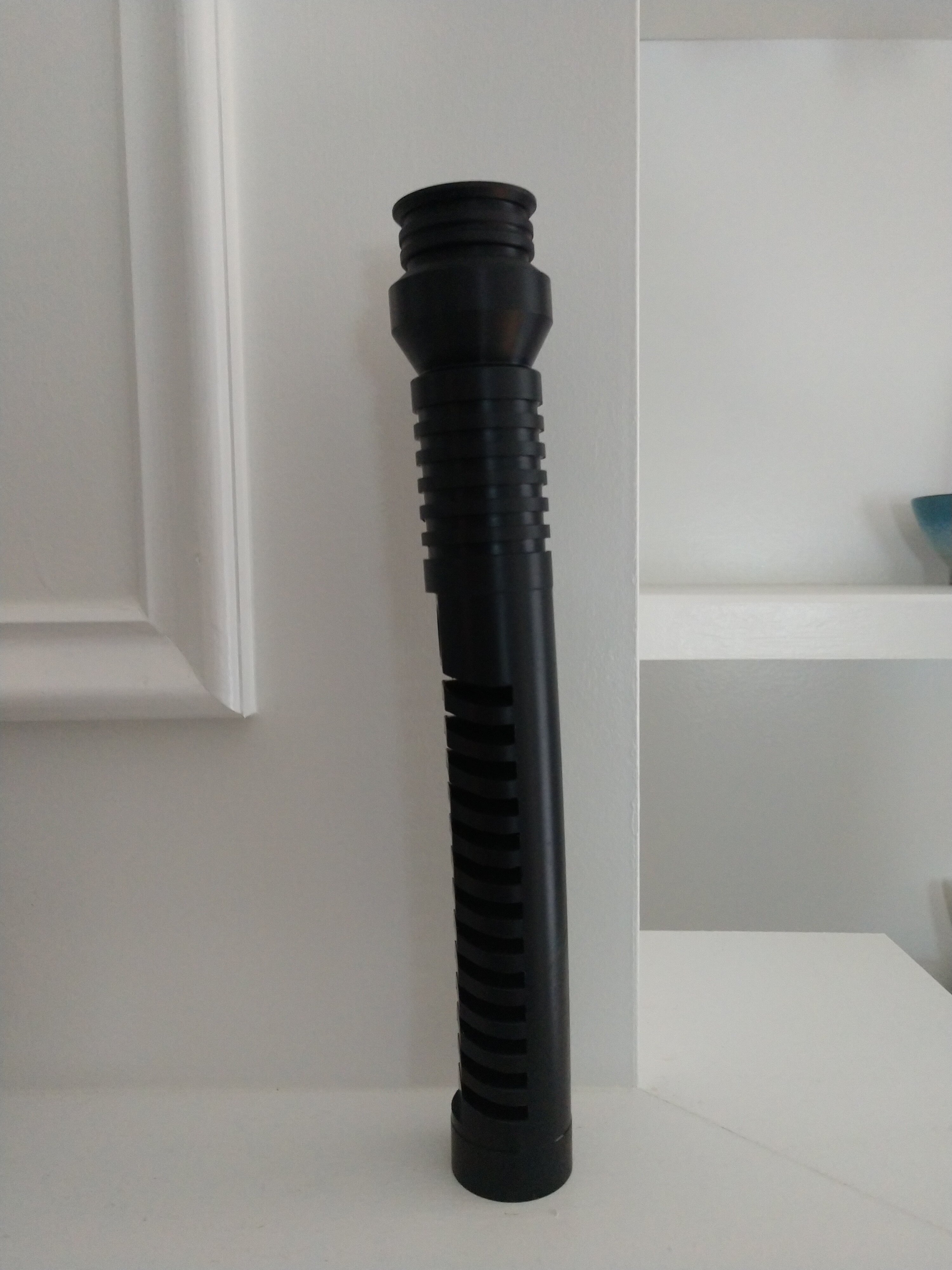

My theory: Acetal/Delrin stock is made one of two ways, it can essentially be cast or extruded. The extruded stuff has a ton of residual stresses in the material from the extrusion process. Without some type of stress relief heat treat before machining, the part can warp during machining.
I don’t think it’s worth trying to nail down Delrin specifically as I really don’t believe that is how the originals were made.
Here is what the delrin parts looked like
Here is what the abs parts look like
