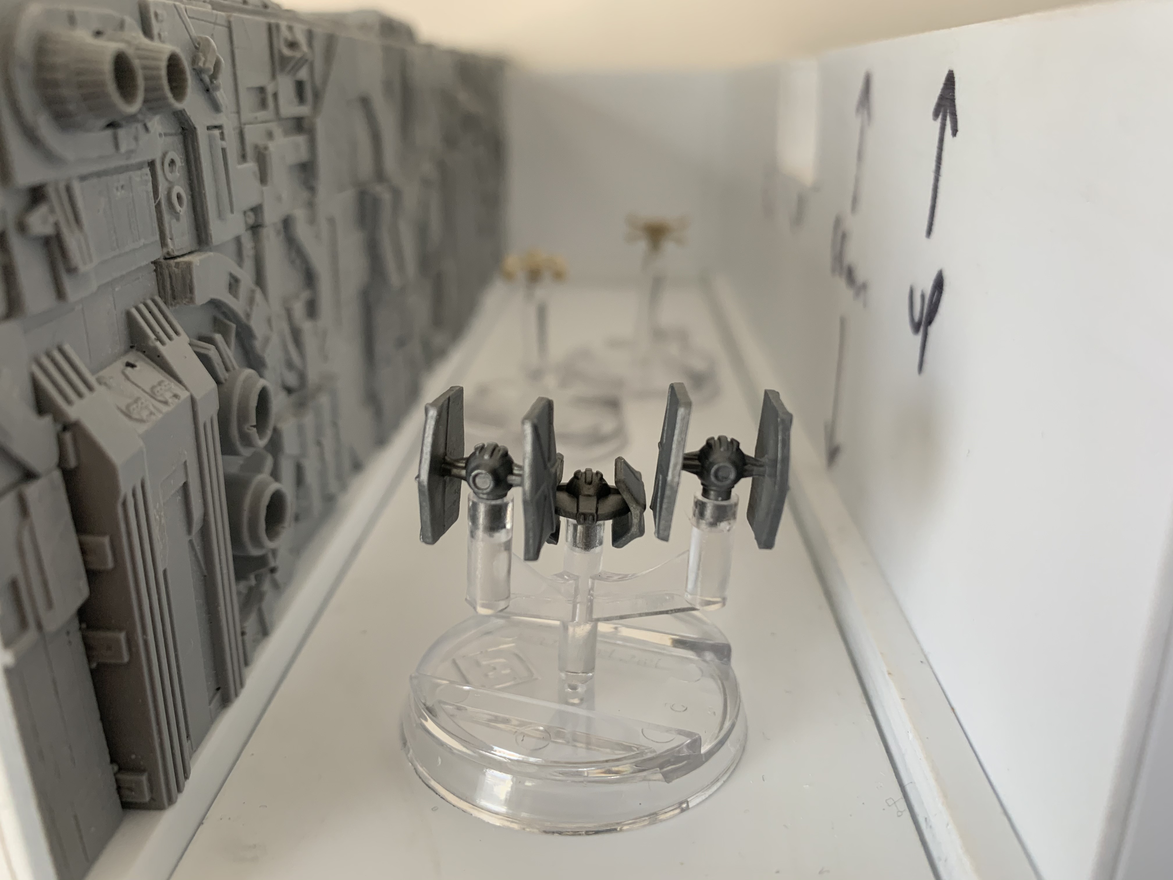

First, I got some rebel ships from the Fantasy Flight Star Wars Armada game. Rebel Scale puts them at about 1:600 to 1:950 scale, and I think they look really pretty good with these tiles. Really looks like you could actually fit three fighters in formation in this trench.

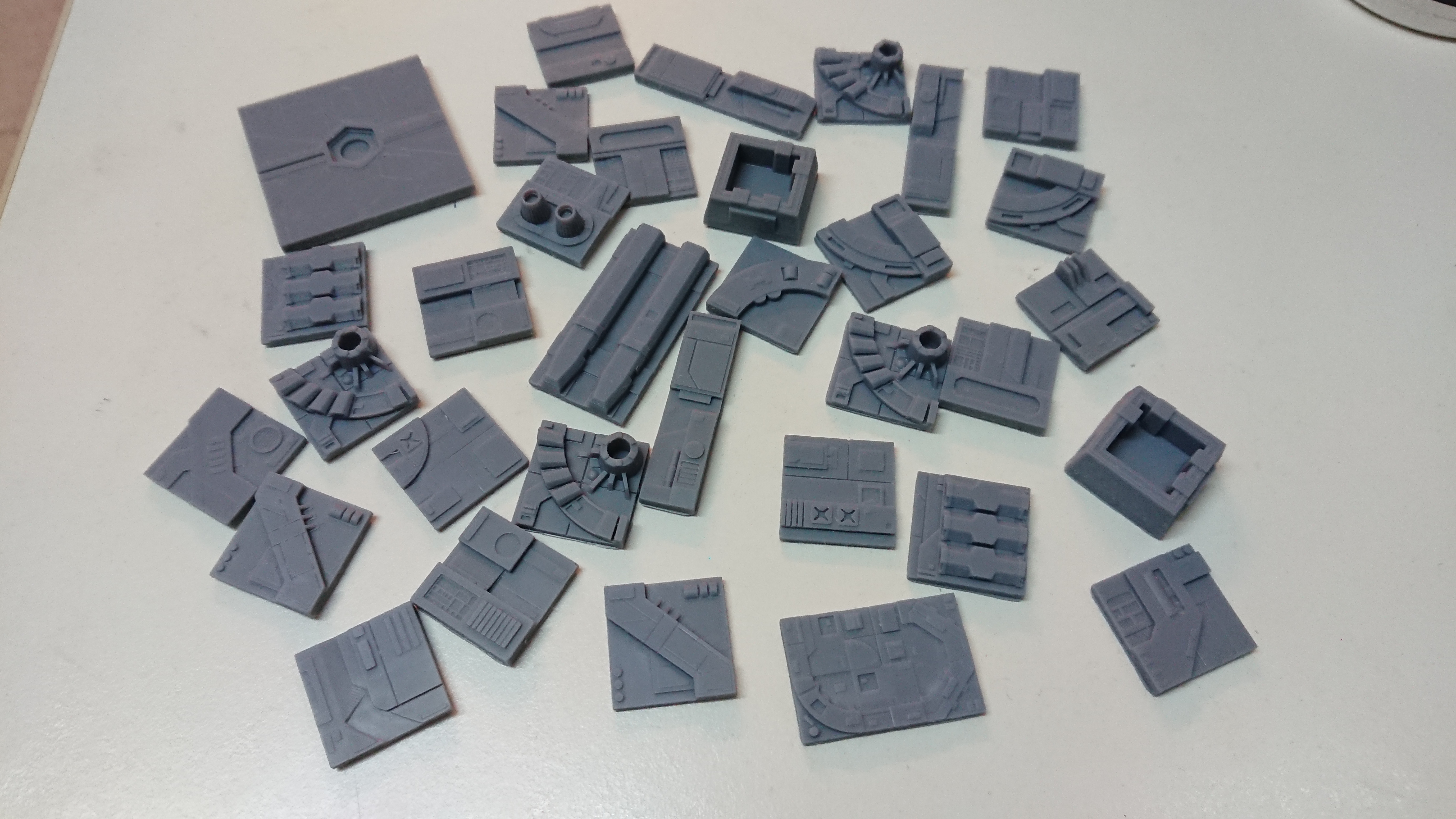

I've started printing the tiles, plus the new tiles I've designed and my turbolasers.
This will be amazing!!!

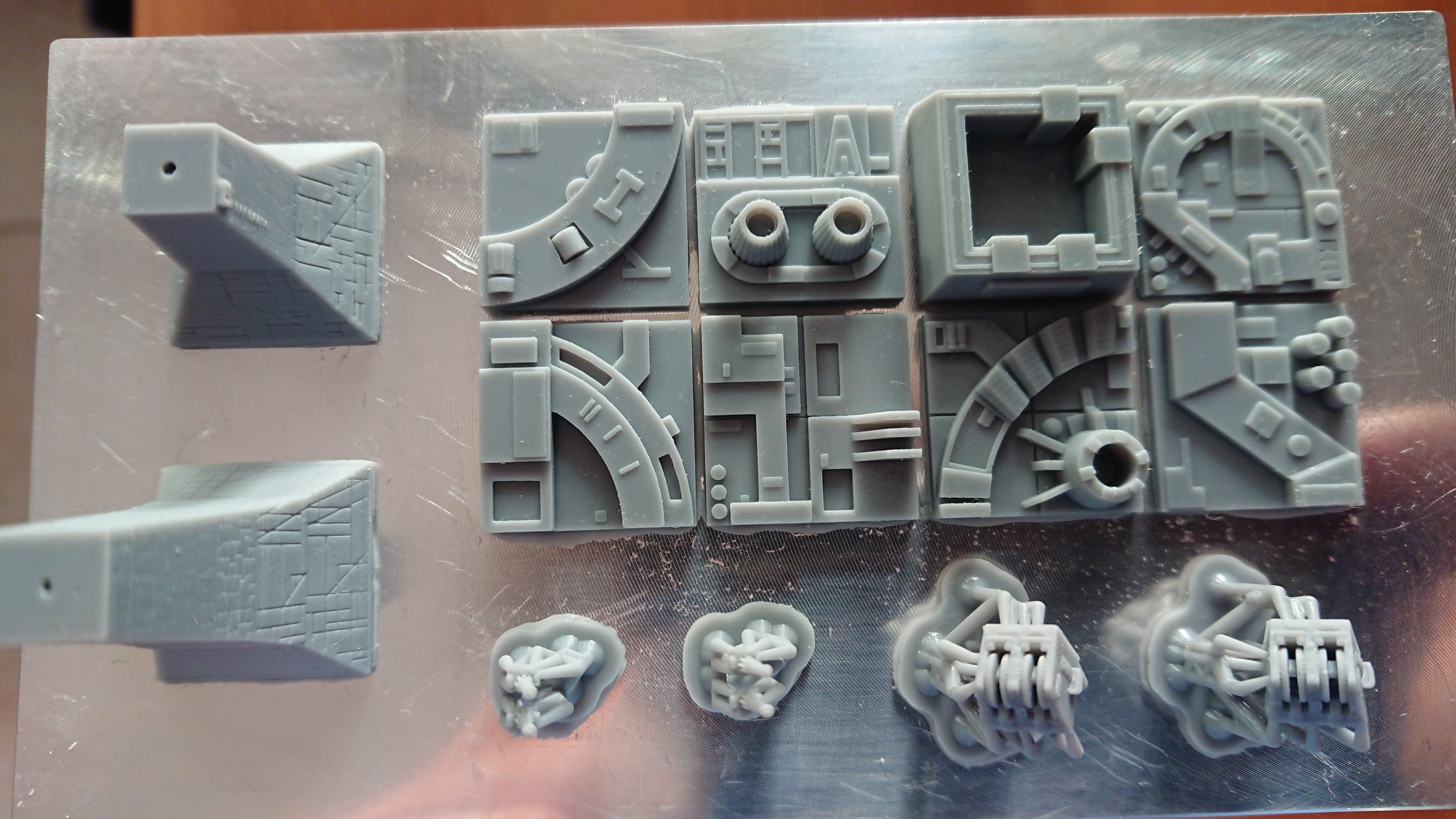

Thanks again for posting the tile files. I have started printing them to follow your lead and make my own version of the trench run. I also found an X-wing, TIE and X-1 STL files and printed them at about 1:1000 - which at 60mm wide seems to work with the published trench width of about 59M. The camera in my phone does not do them justice, they have extremely fine detail - especially the X-wing cannon tips.
30 tiles printed - only about 200 more to go.....
Wow - my workbench is dusty.....
I have an Elegoo Mars. Only had it for about a week.... Quite a learning curve, but I think I'm getting the hang of it. The tiles and ships were the first really successfull prints.

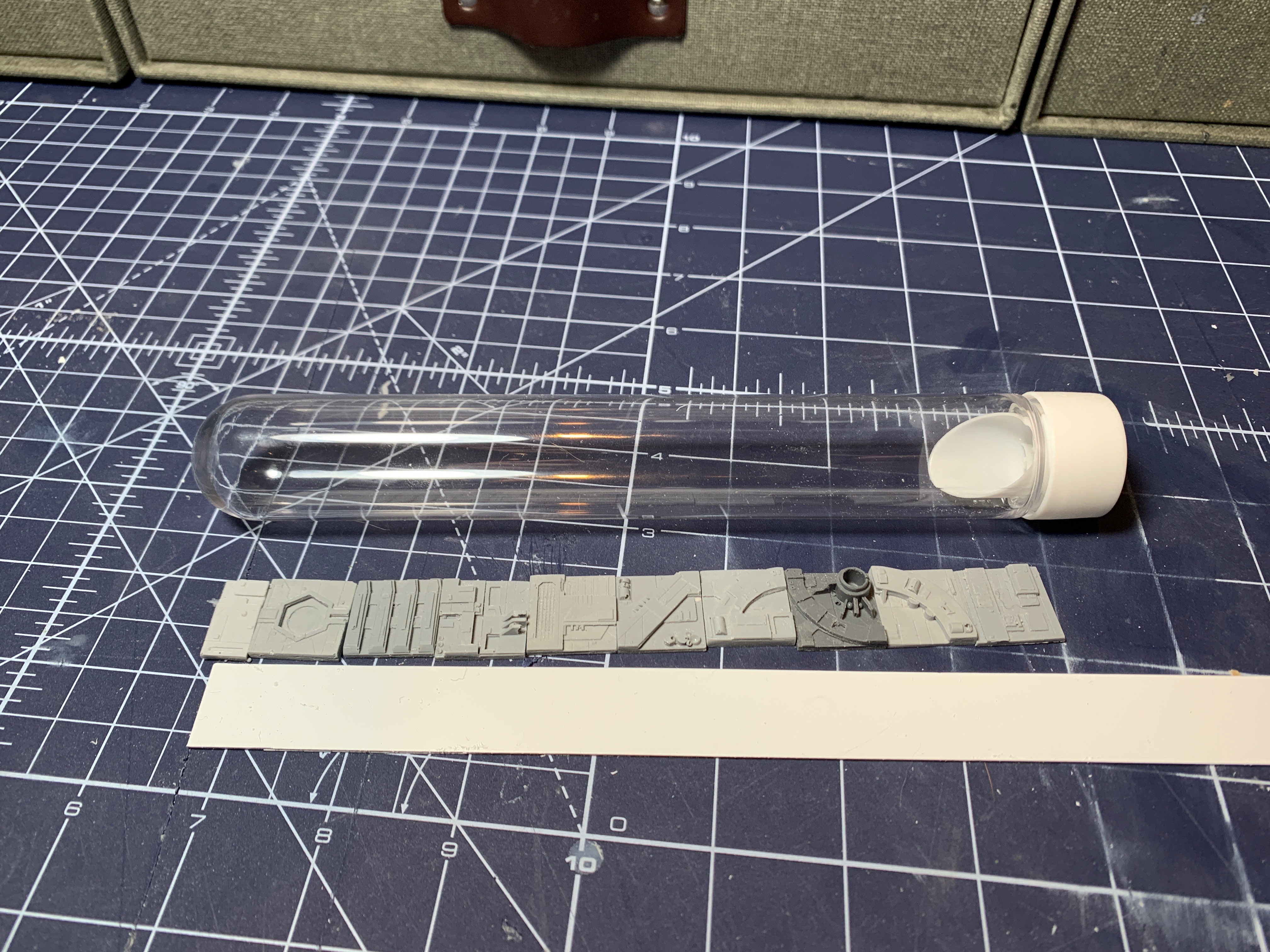

So, here's a quick digression from the main trench run build, but it's very cool. My wife and I recently got new electric toothbrushes from Quip, and they came packaged in this long test-tube shaped container with a screw cap at the end. It looks like a very long, thing glass display case like you'd use for a small diorama or a fancy clock.
Hmmmmmmm, I says. The opening measures 21.5mm. My Death Star tiles are 20mm wide....
So, let's cut out a strip of styrene to fit....
And pick some tiles....
Yep, that'll do!

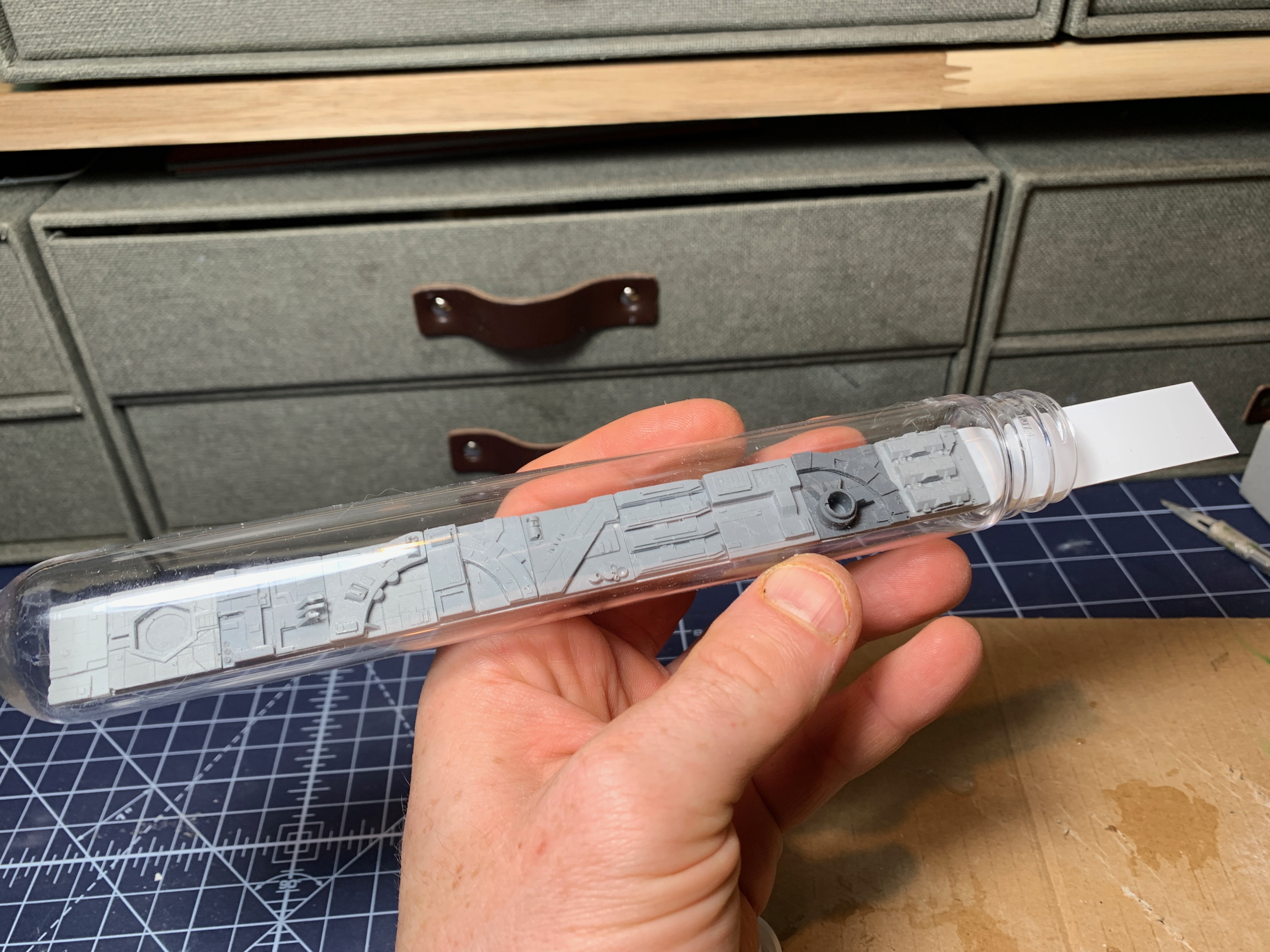

Now gotta work on mounting it to the screw cap base...
Lots and lots of CA glue gel later....
Looks cool already!
I put a rectangular styrene tube on the bottom for rigidity.
The visible end is mitered (and later filled), and I put a small length of tube on the end to keep it propped up and level, so the run of tiles doesn't sag downwards inside the tube when it's horizontal. Then I started greebling it with pieces of sprue for piping and some of my cast Bandai parts.

For ships I used fighters from the Star Wars Armada game, which rebelscale.com puts at between 1:600 and 1:950 scale. The TIE fighter was too tall to fit through the bottle opening, so Darth Vader has to go it alone on this one.
