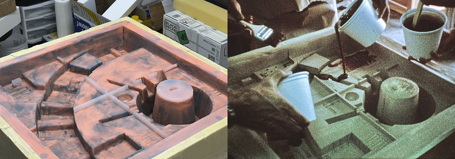

Then it’s time to pour in the first ever casting- using FoamIt 4, expands 14 times by volume.

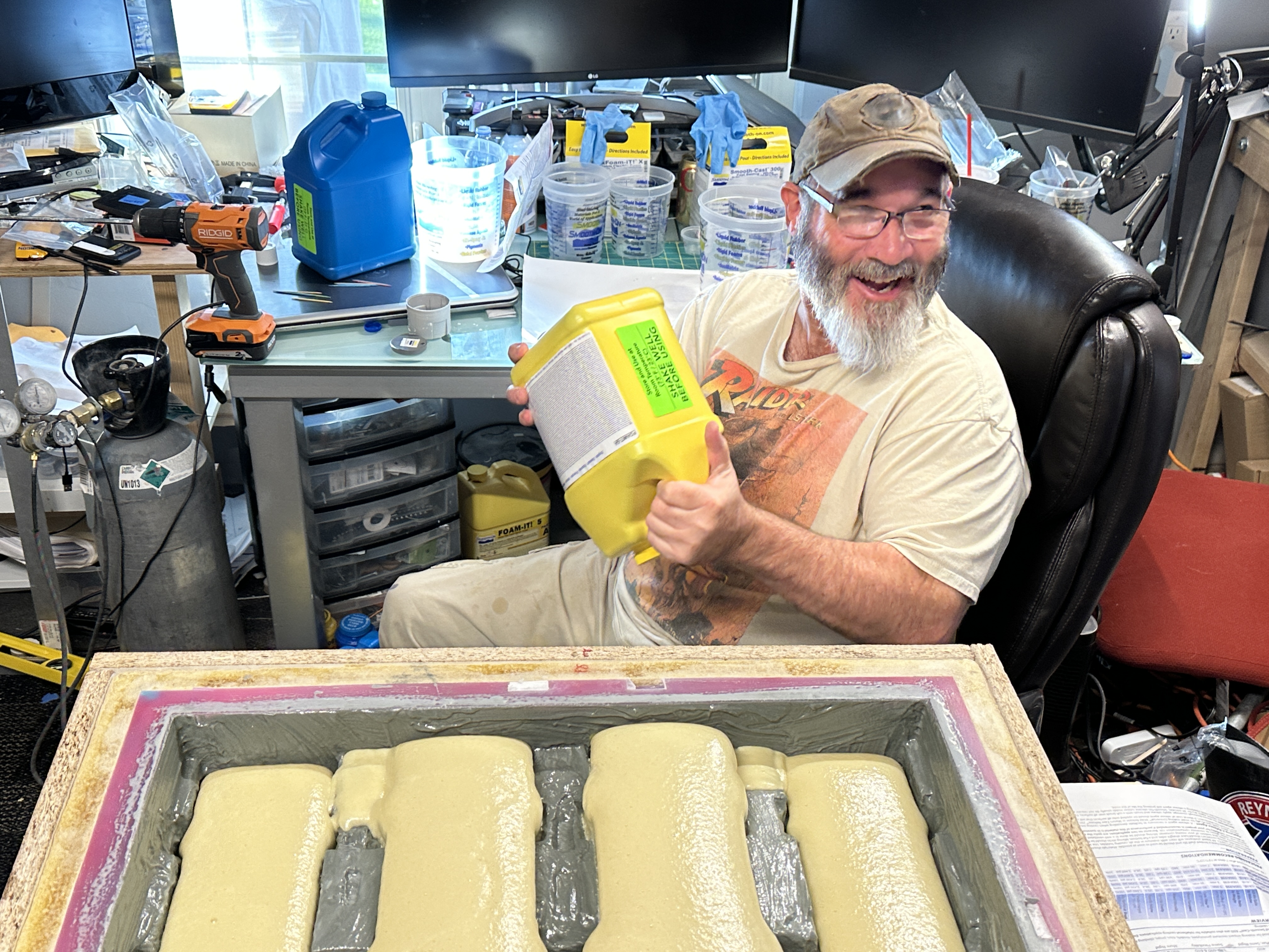

2nd pour of FoamIt 5, this expands 10 times by volume.
Shakin a new batch
We called this ‘baking the bread loafs”

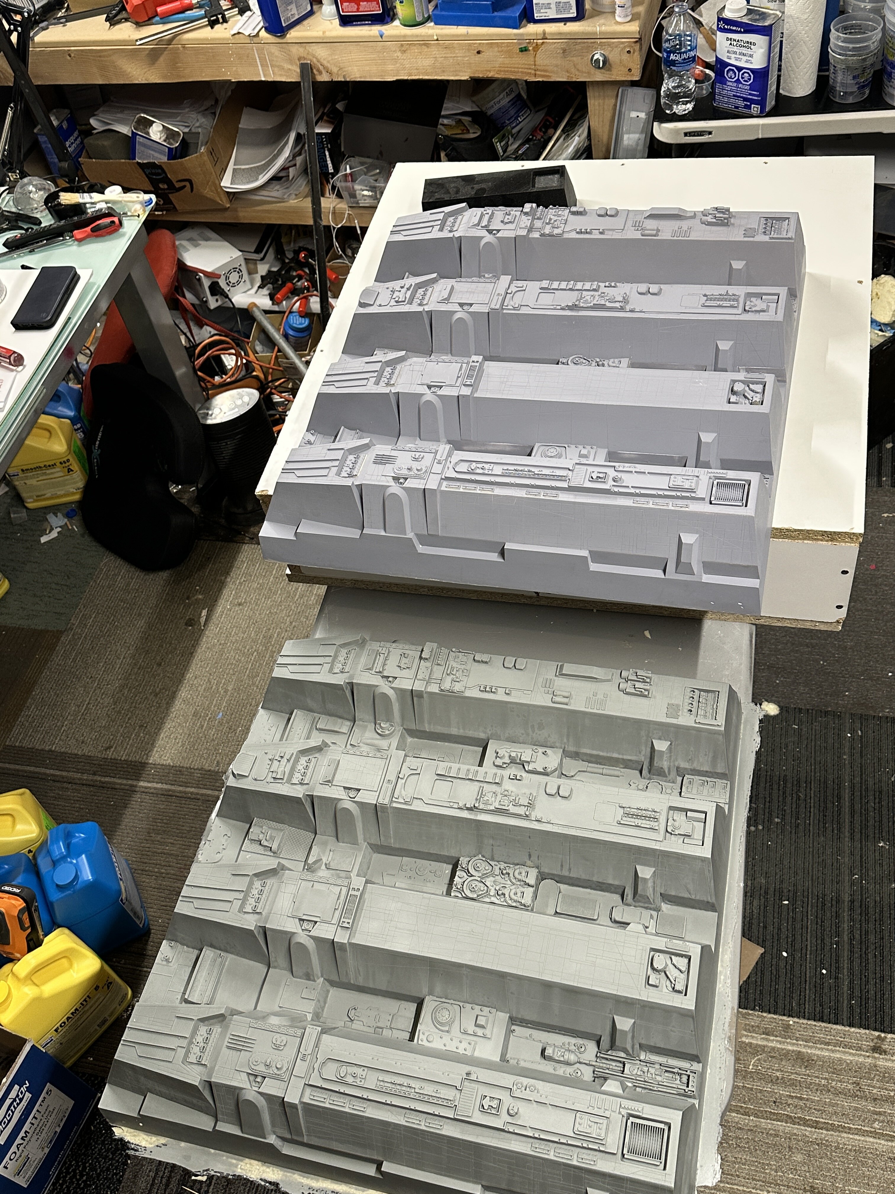

And the first casting joins the tile wall!!

Pretty much have the volumes for resin and foam nailed.
I don’t think this many Kit Kat Death Star Surface tiles have been together in a room since the 1970s!
The castings look so clean! Wow!
I thought the same thing. It's amazing to see the clean castings that allow the scribe lines and model kit parts to appear perfect when this doesn't fit in a pressure pot. The work time of the smoothcast 66D also isn't very long, but clearly the viscosity is perfect for limiting air bubbles.

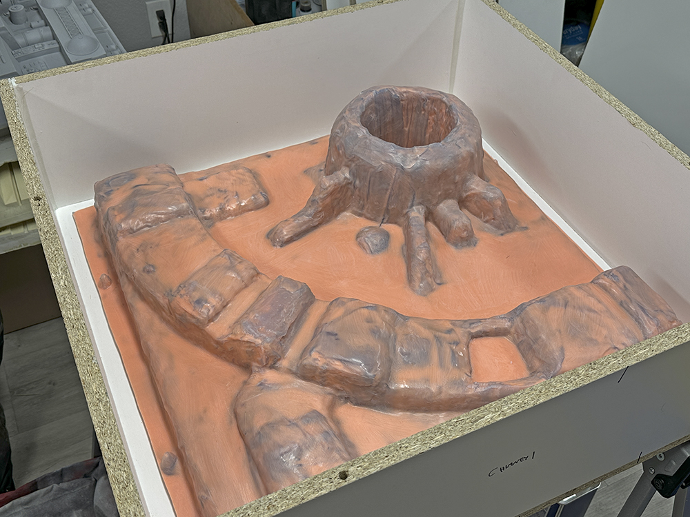

The round 'chimney' tile (and the 'three fins' tile as well) have been sitting all silicone-covered for several weeks now:

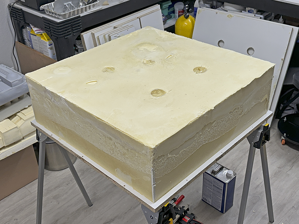

A couple weeks ago I managed to get the mold box for the chimney tile all reassembled and the expanding foam hard shell poured:

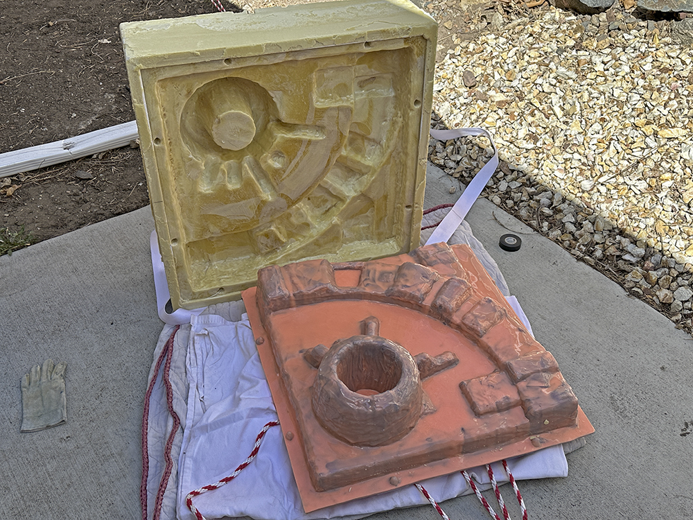

And that's how it has sat until Sean could help out today to get the hard shell separated from the silicone-covered master (no easy task and one that I was unable to manage on my own - THANKS Sean!):
This is a beautiful mold! It incorporates a lot of lessons-learned from our previous efforts and I think/hope is going to produce some really nice casts.
Not evident here is all the really fine detail captured from all the greeblies - really amazing!
Fun to compare with what was happening about 50 years ago in Van Nuys...
So, I hope to get a first test cast done some time this coming week - stay tuned...
