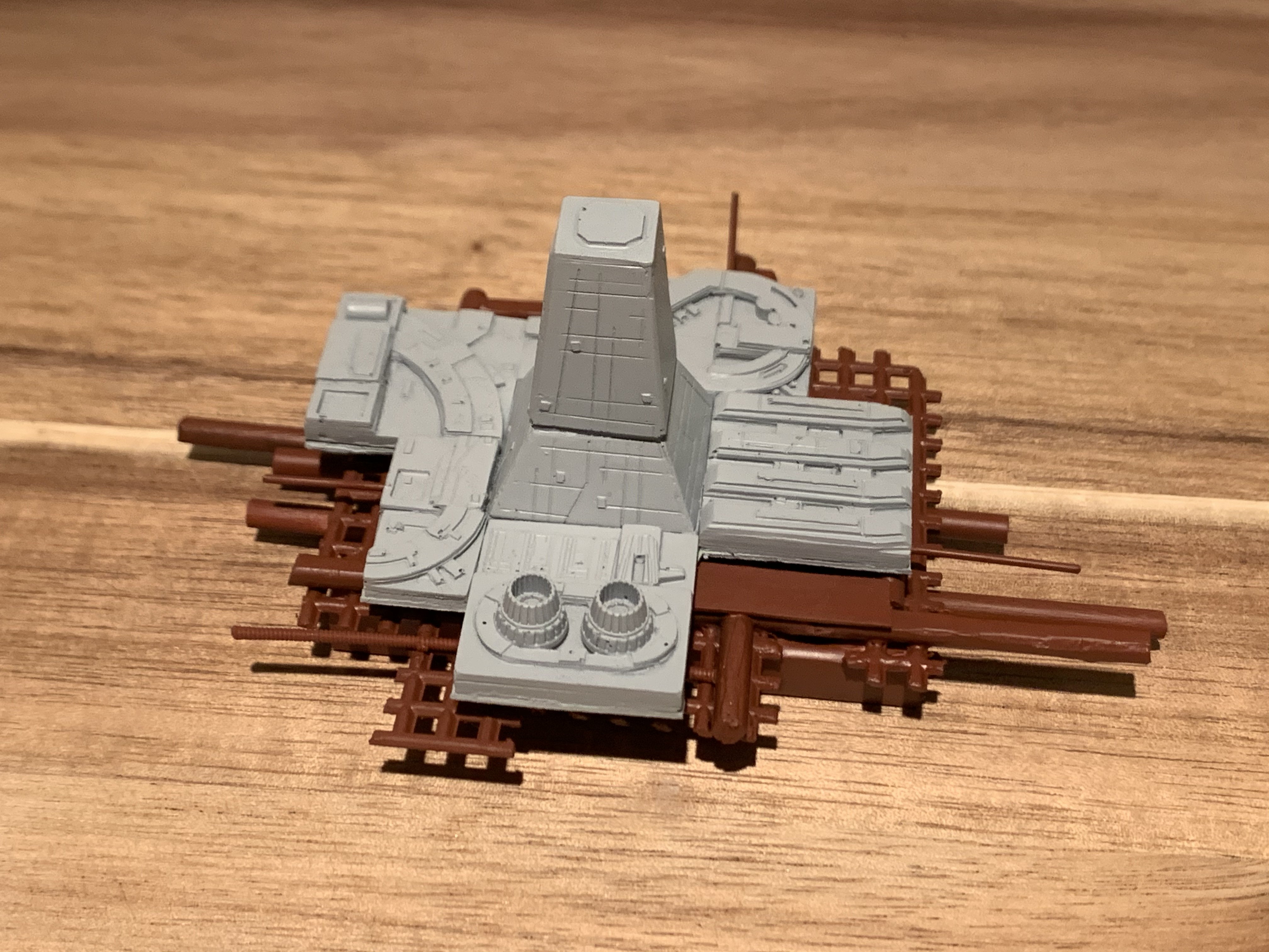

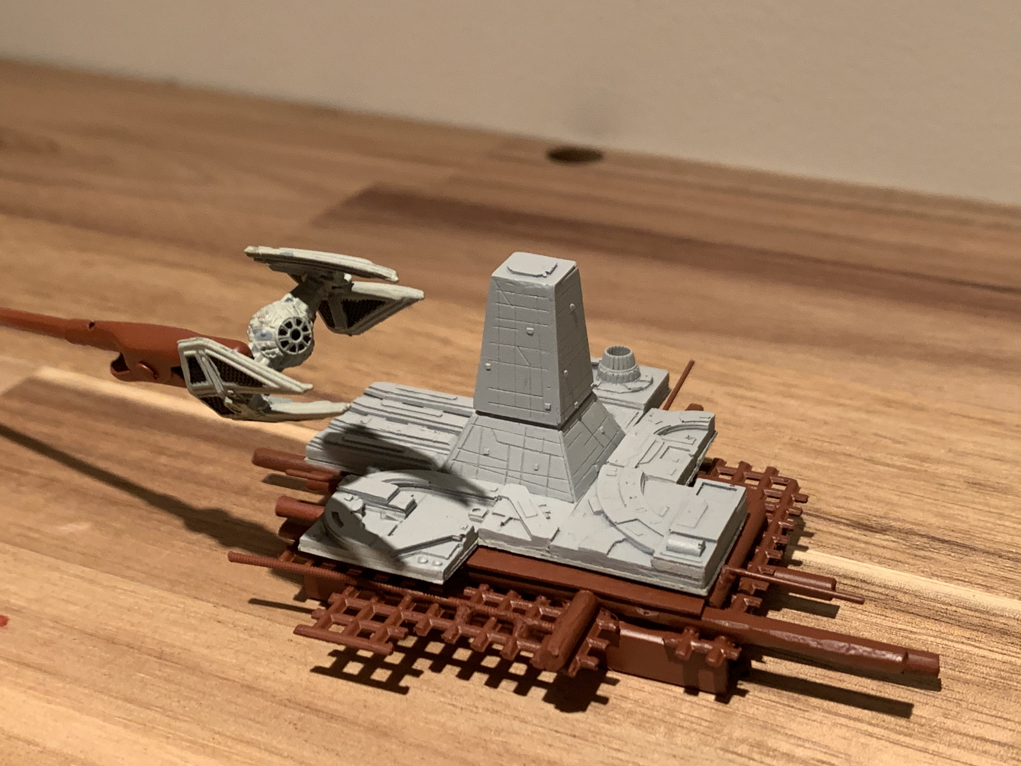

And, finally, I made a test assemblage of a few tiles, a tower, and some sub-structure made from leftover sprue bits and offcuts, primarily. Painted Tamiya red oxide primer for the substructure, and grey fine surface primer for the tiles. Still to add the cannon to the top of the tower, paint a few panels differing shades of gray, and do a panel wash - just a quick prototype.
The TIE Interceptor is from the Wizards of the Coast Starship Battles game - it's about 1:350 scale..

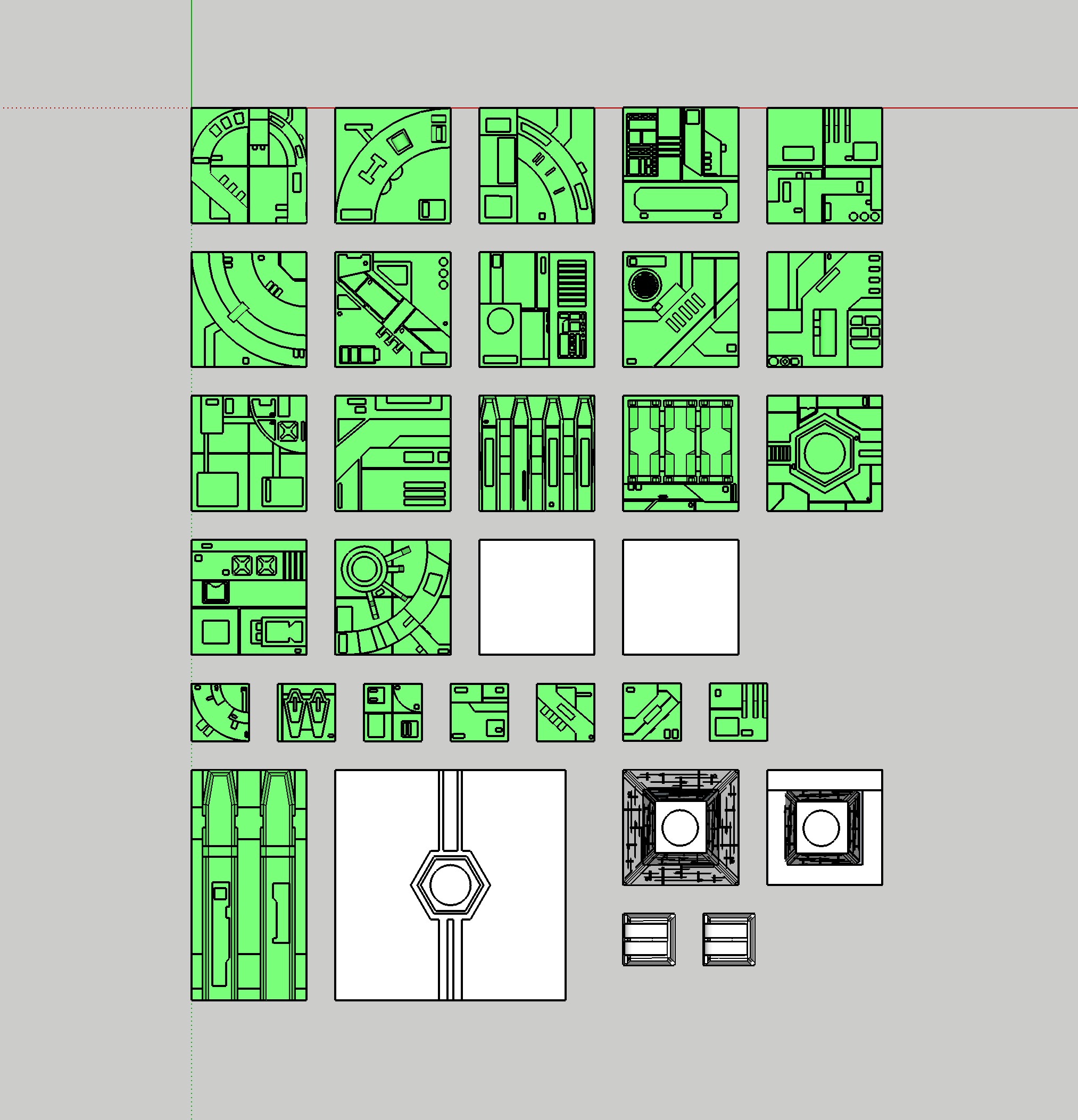

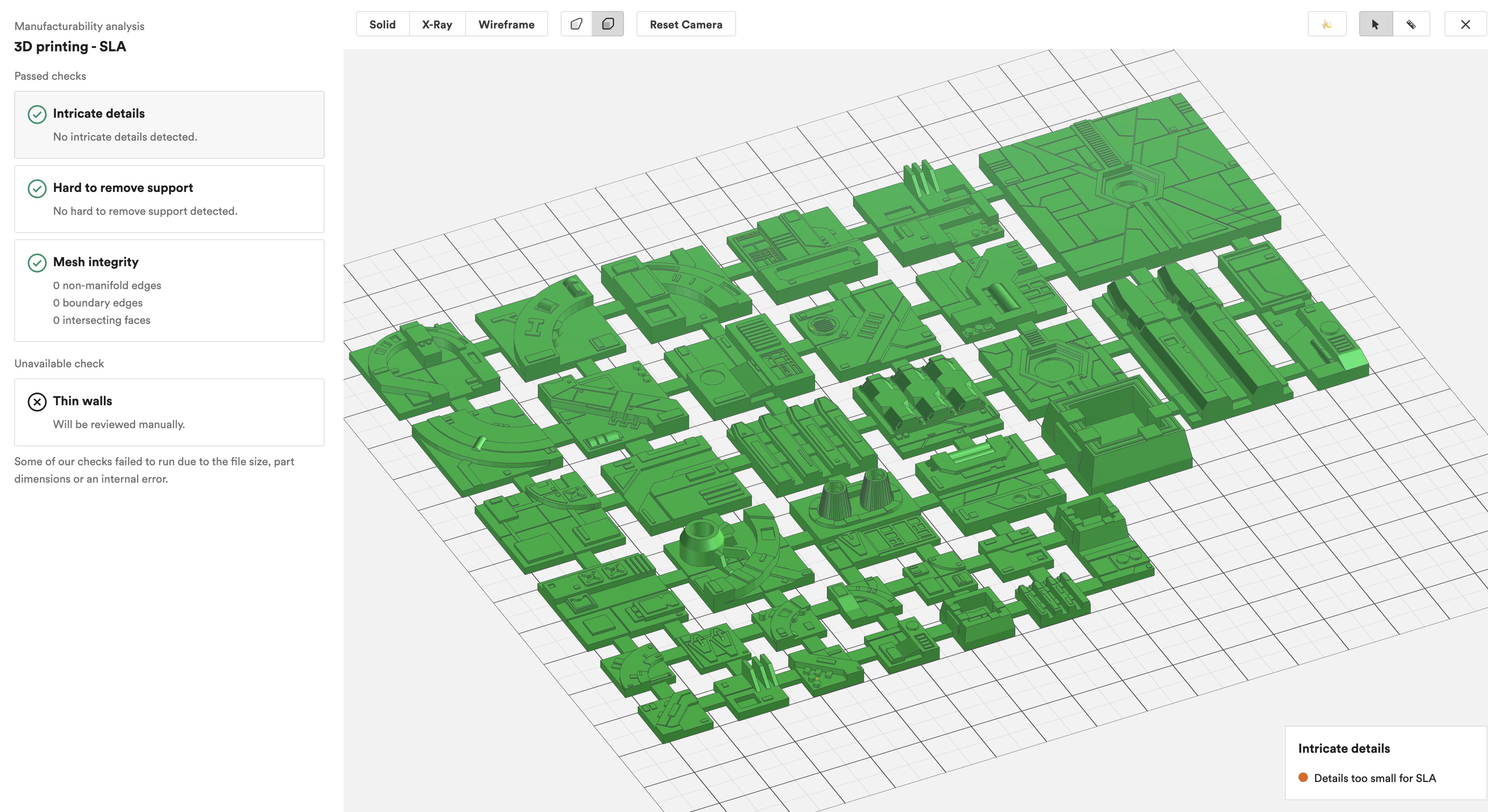

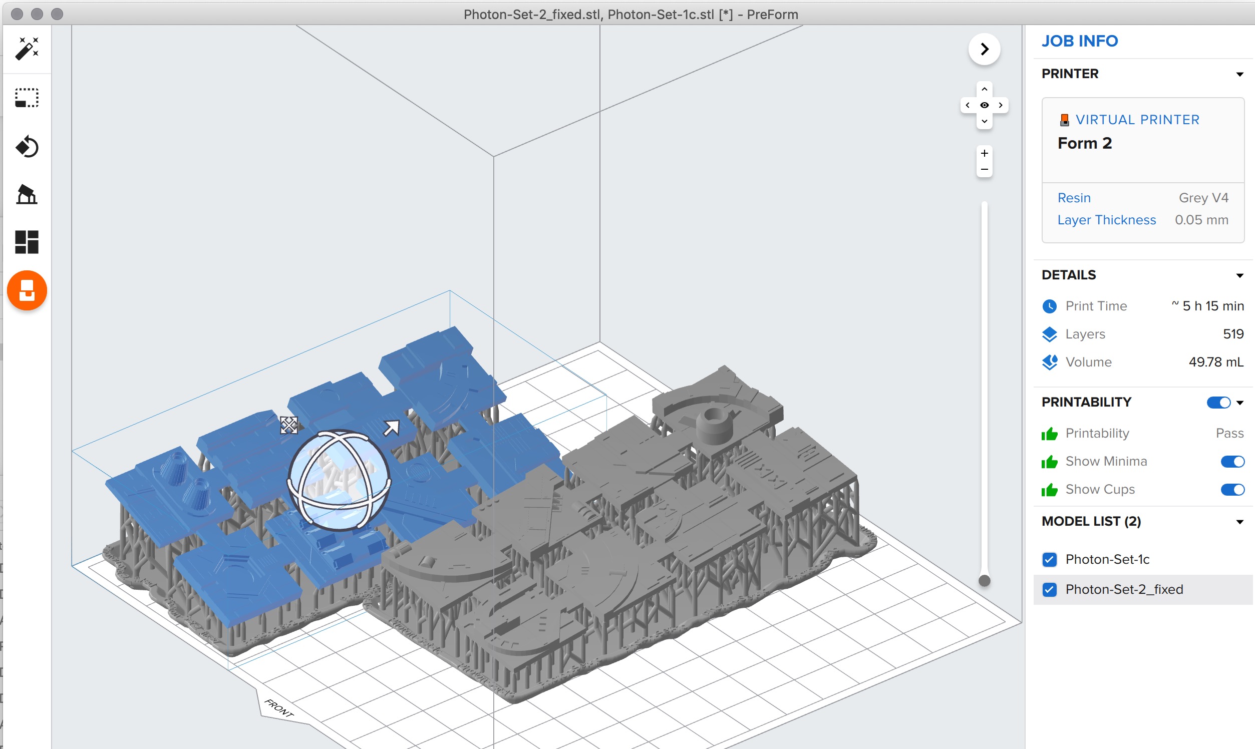

Well, while I'm waiting for some materials to arrive (and some tiny ships to blow up), I've been working on the digital tiles. I've got each individual tile to pass printability checks, but it's taken quite a while of tweaking to get all of them on a sprue to pass the same checks. FINALLY got it!
(this is the printing check on 3dhubs.com, btw)
One more printing check -- the full set was too big for a Form 2 or the smaller Photon, of course, so I chopped it up into four sets of tiles. I may not have a Form2 (alas), but their software is still quite useful for checking printability.

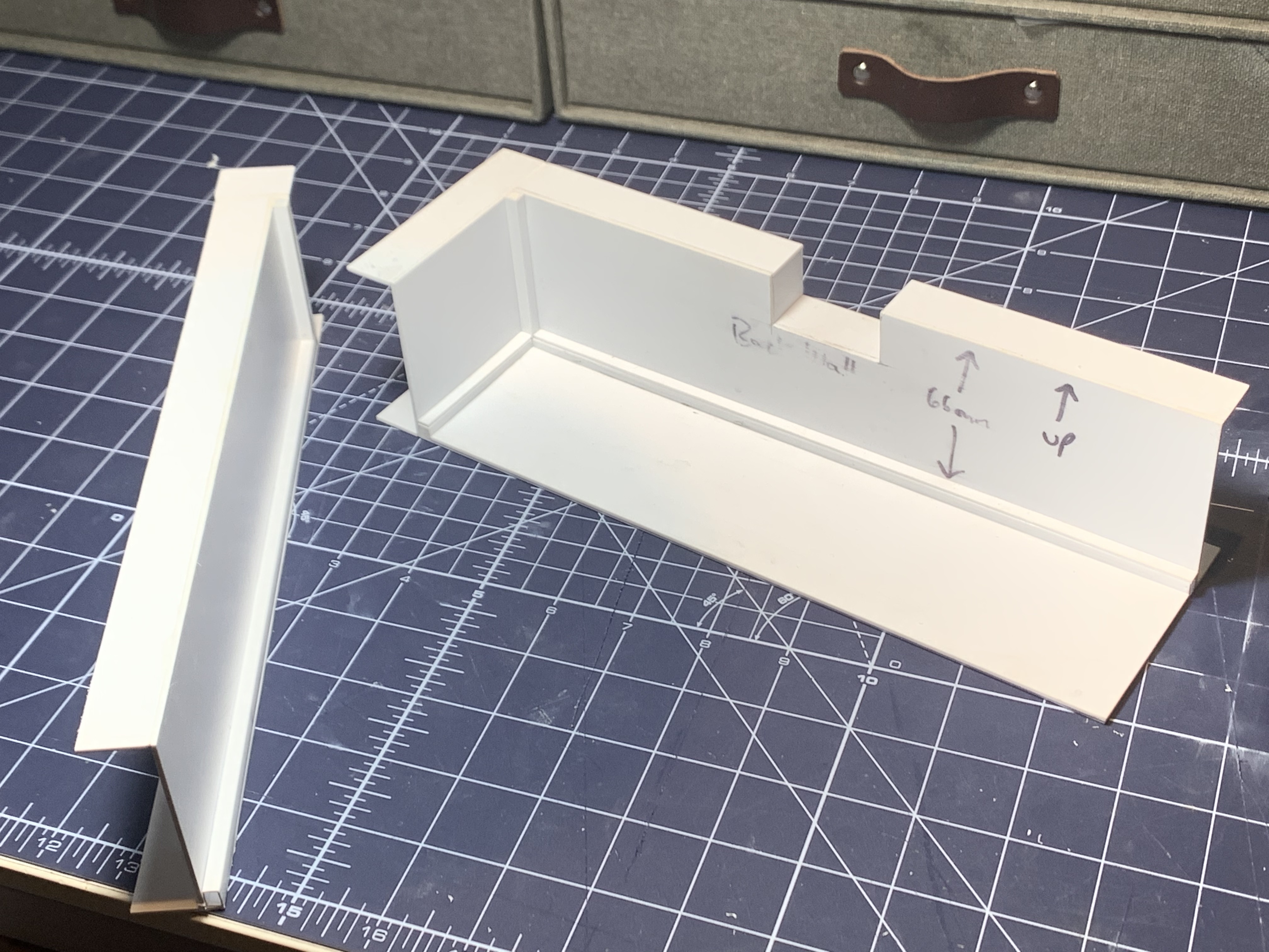

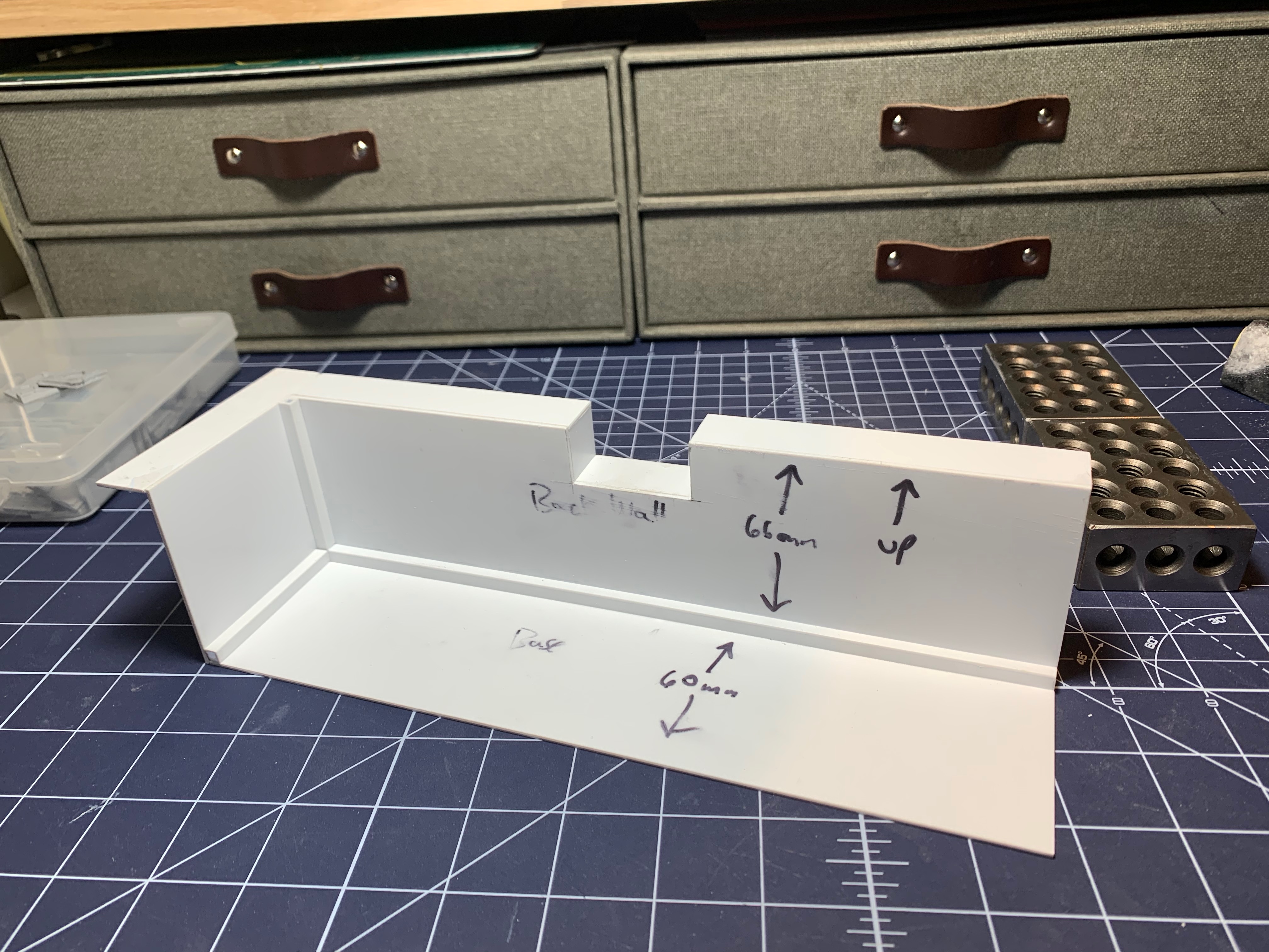

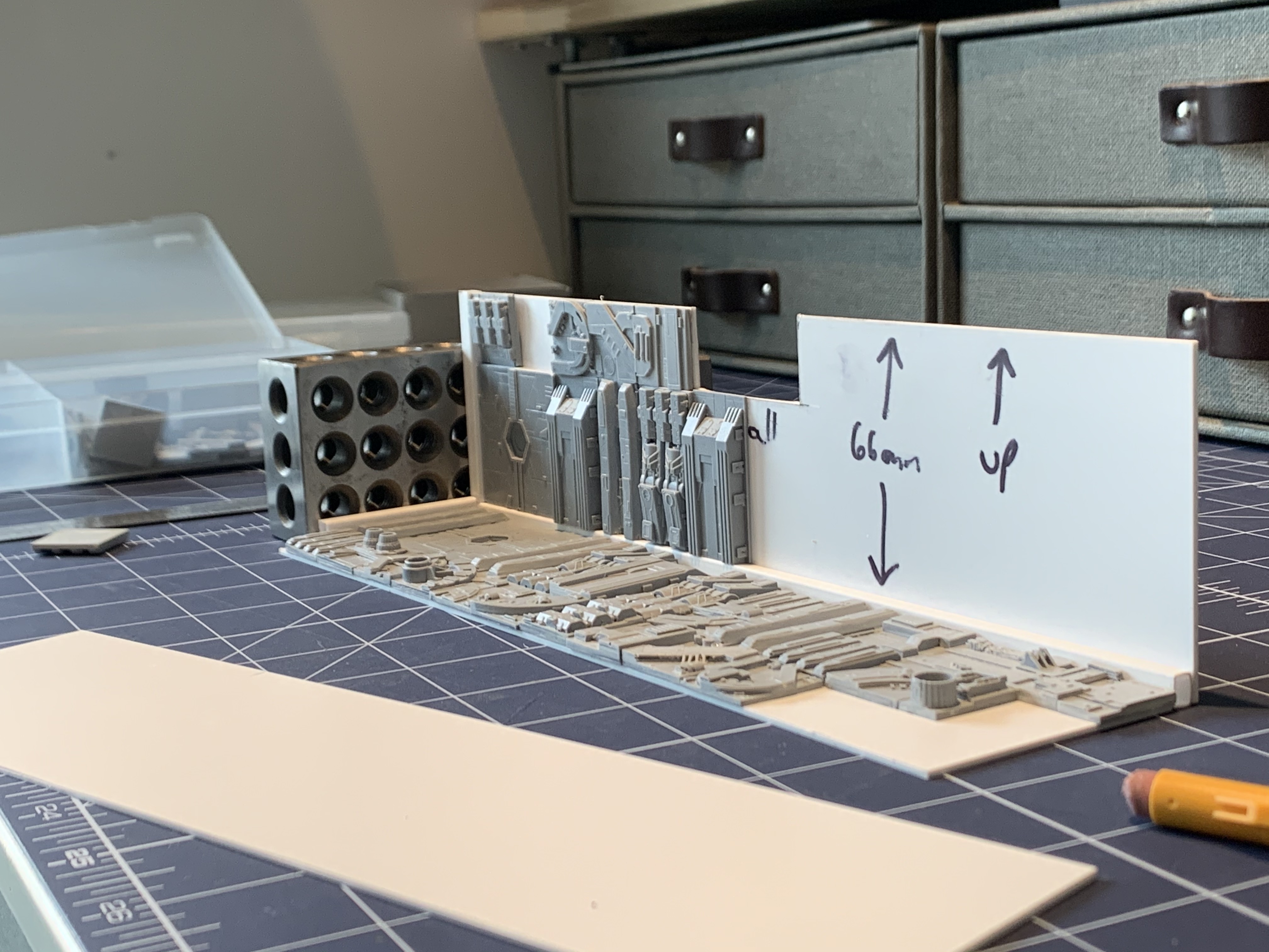

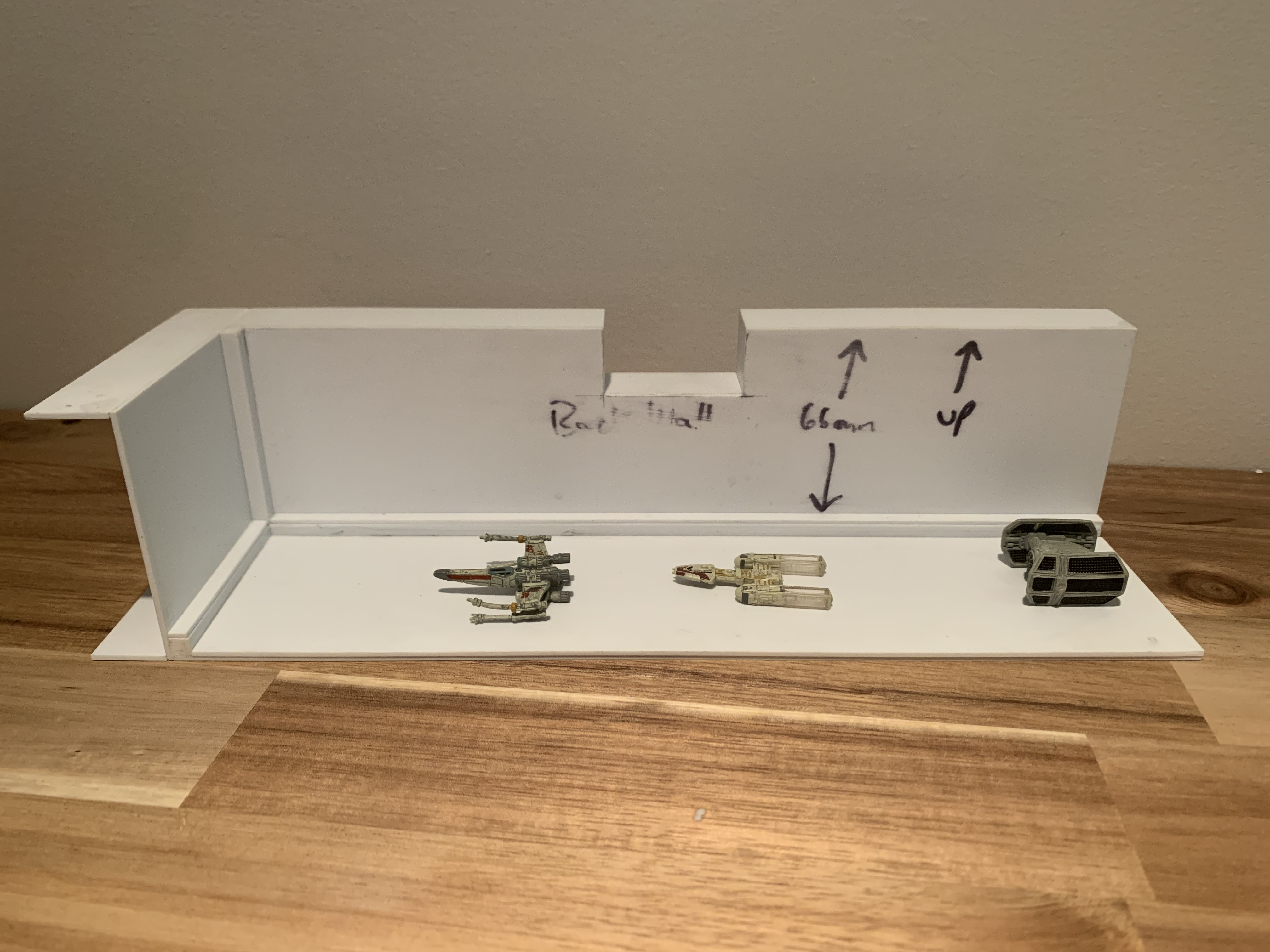

Made a lot of progress today on the support frame for the trench run. The version of the trench I'm making is my own concoction taking elements I like from the different trenches that were built for ANH and elsewhere. Obviously, the recessed area isn't canon.
Here's the current frame -- all hand cut from .060" styrene, with some square Plastruct tubing so the tiles can sit cleanly:

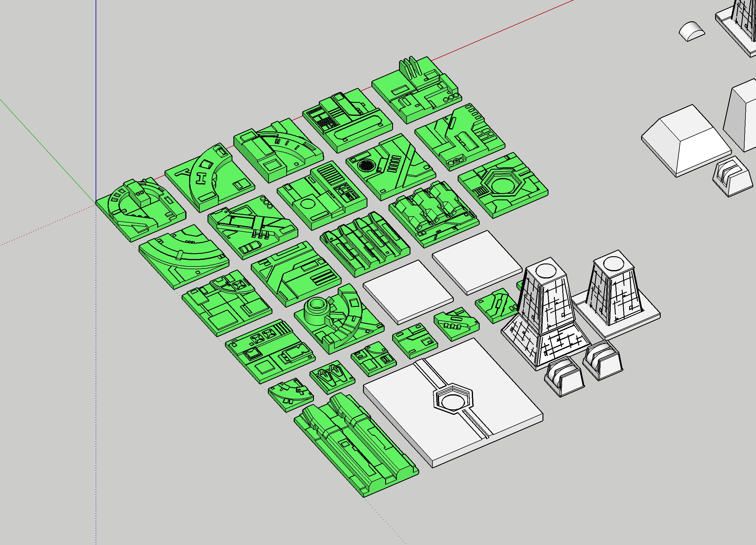

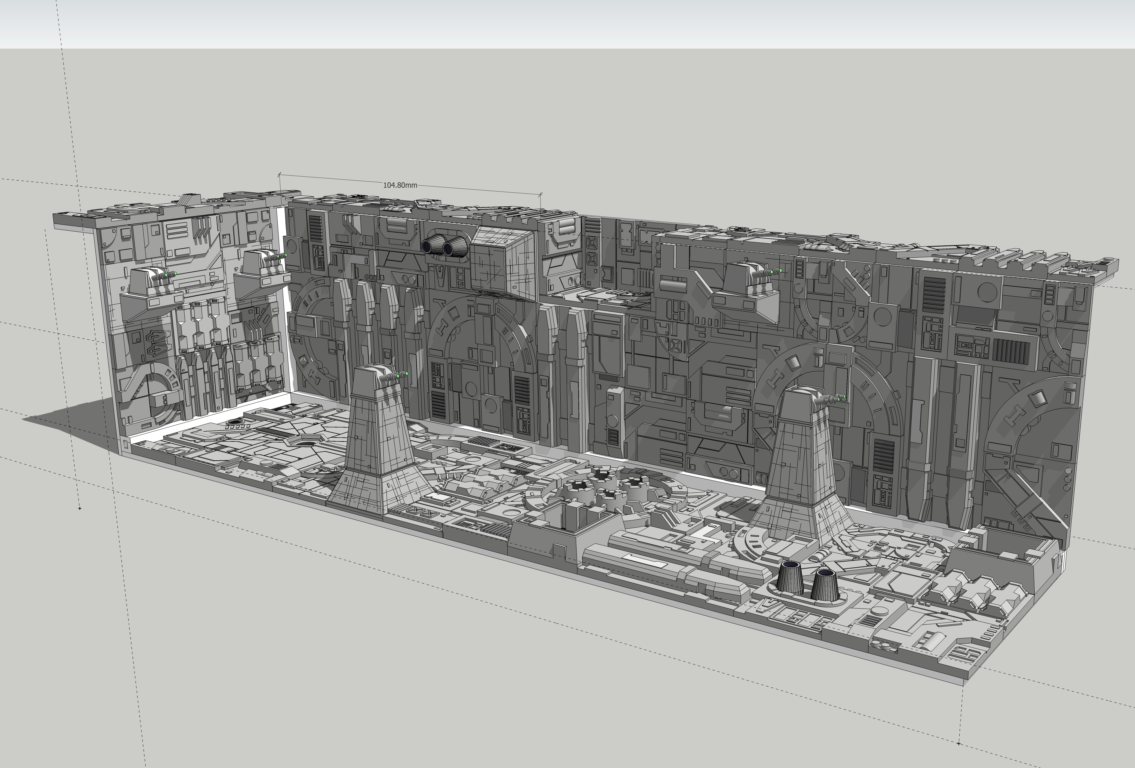

And the digital mockup, which is how I plan what to cut for the frame:

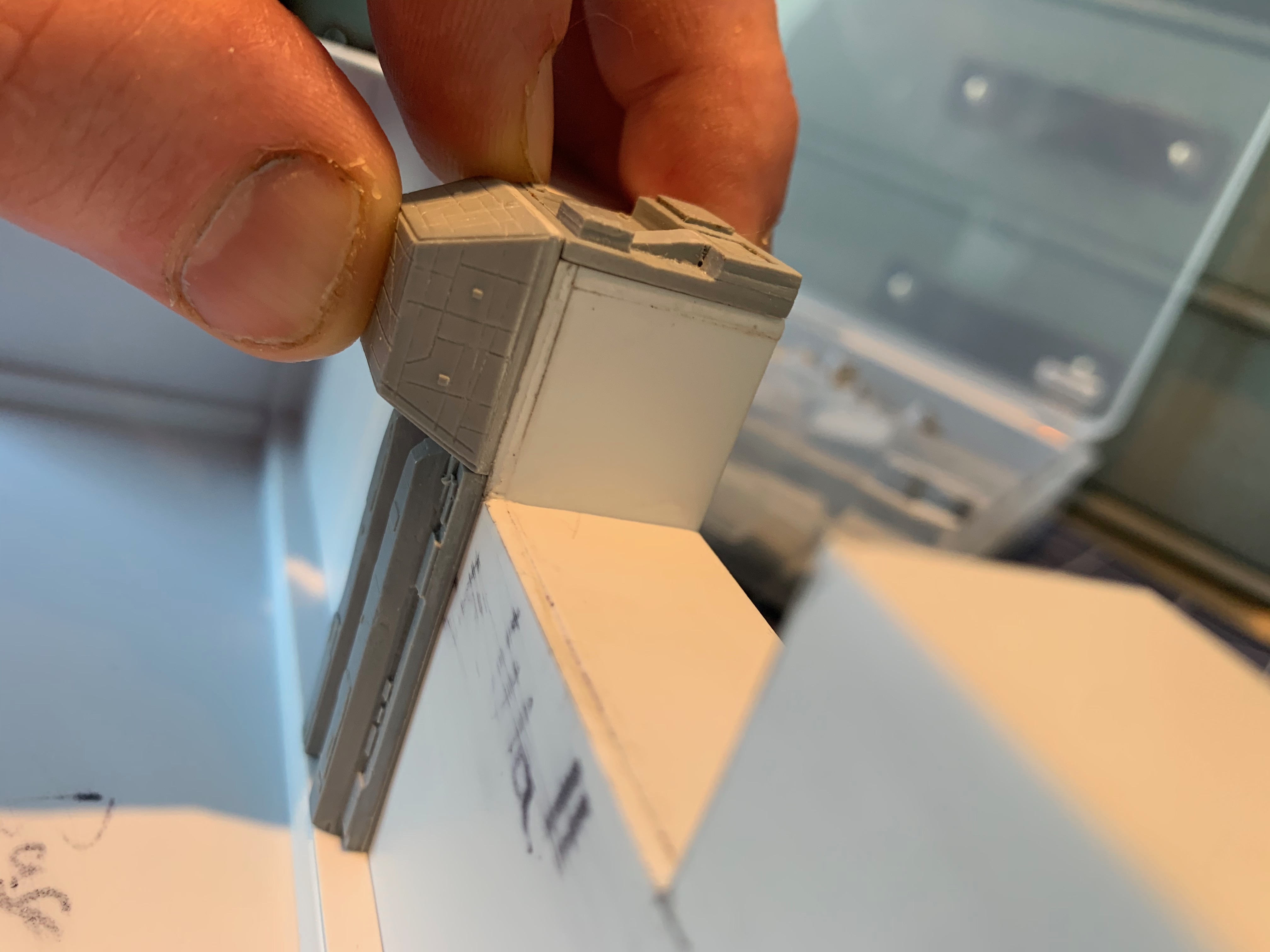

And a test fit during assembly to make sure the pieces line up perfectly with the tiles:

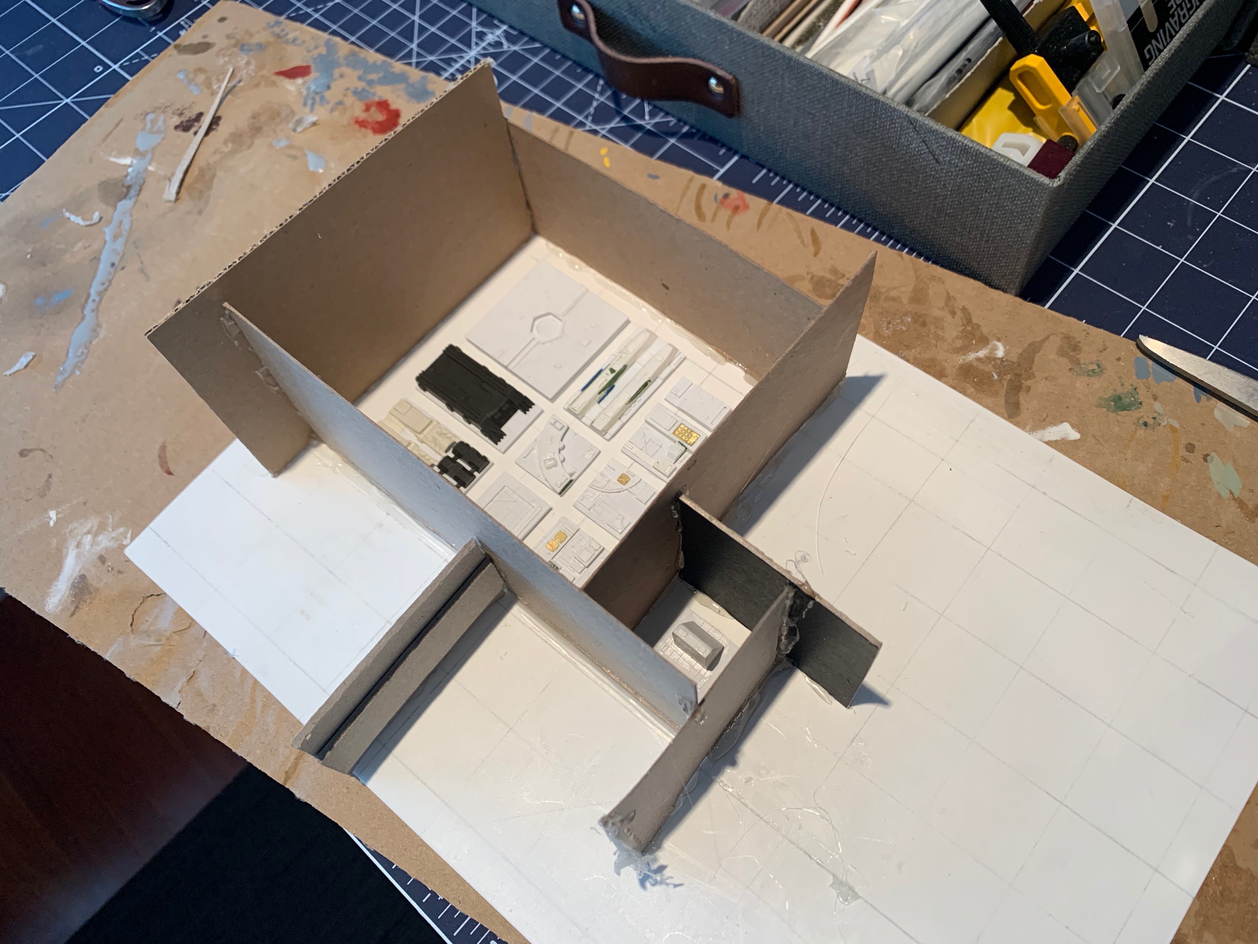

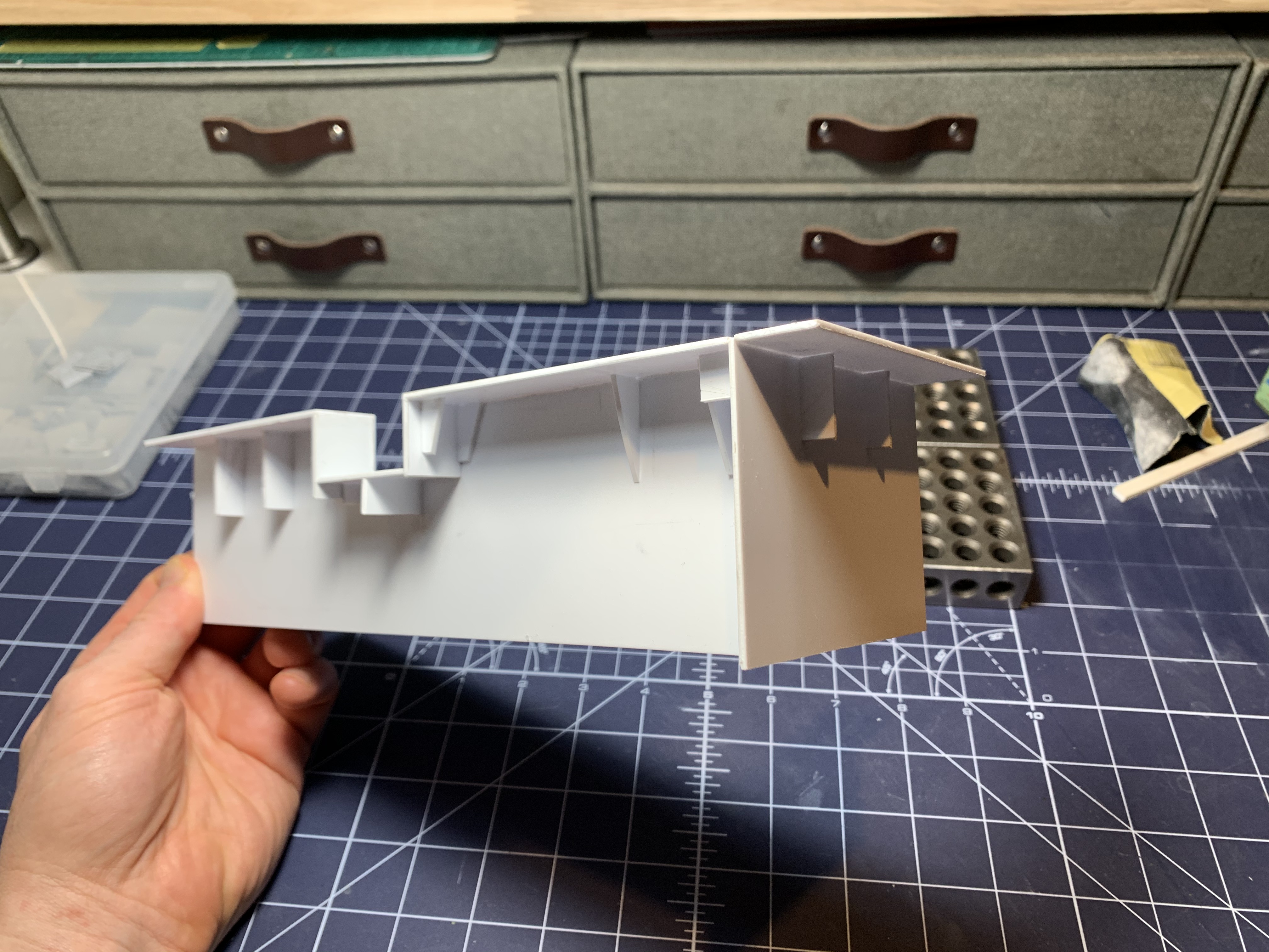

OK, while yesterday I mostly got the digital files prepped for upload, this evening I went back to working on the trench support frame. I'm quite pleased with how it's been going, for the most part. It's made out of .060" styrene, which is very nice to work with - it's entirely hand made. While I've mocked it up on the computer to get a rough idea of what to do, there's been no cutter involved - just a knife, a straight edge, calipers (these have been critical!) Tamiya Extra Thin, and the machinist's blocks to keep everything square.
As I've seen how well the frame goes together, my ambitions....have grown :D.
While I was first just going to have a basic three-quarter trench (just the bottom, end wall, and one side wall, I'm now building something with sub-structure as well (which will hide the battery pack for the LED lighting), a top surface of tiles, and a removable second side wall. This will make it displayable in several ways (including vertically -- it stands up quite nicely on a shelf).

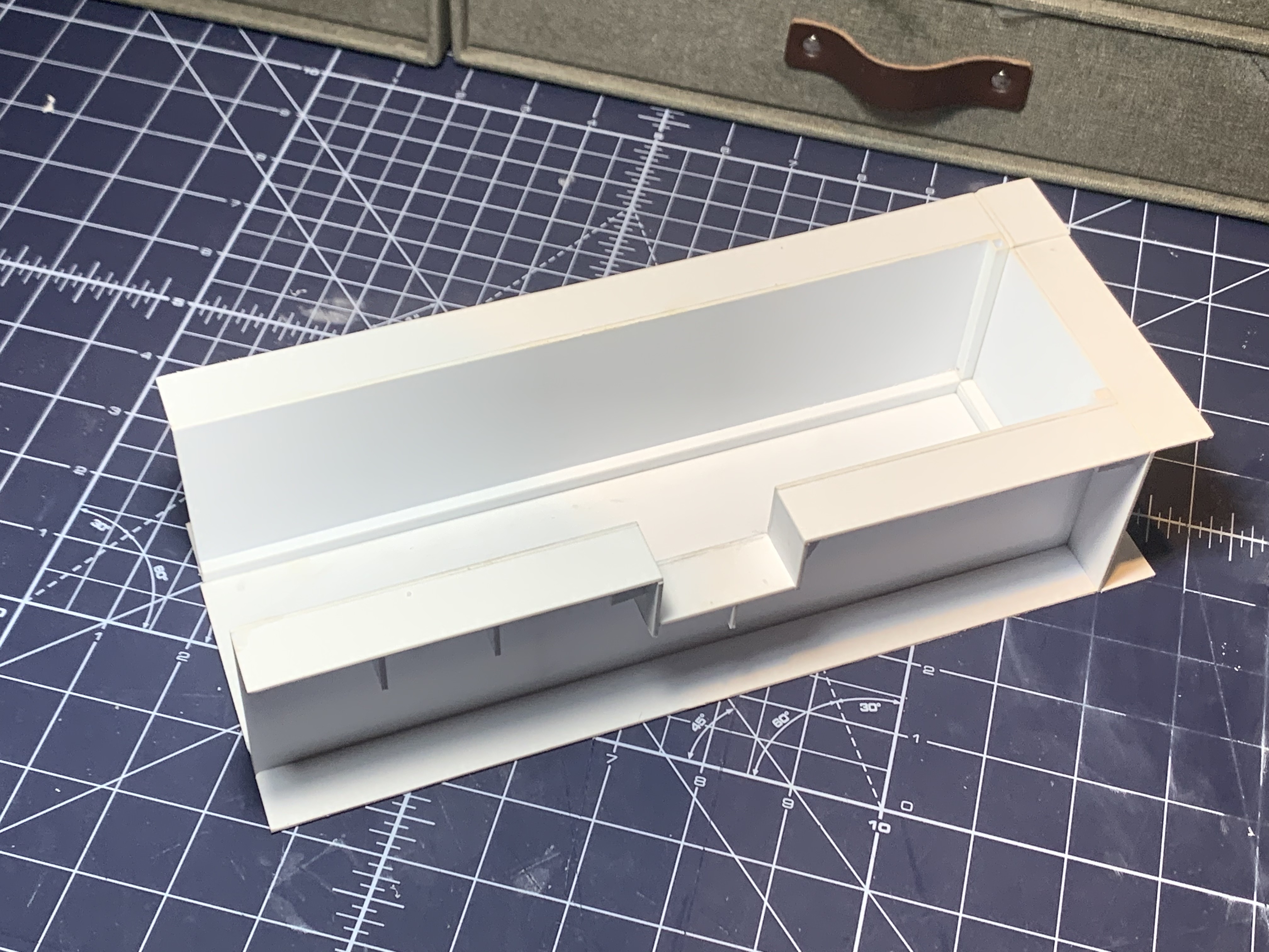

To explain better, some pictures:

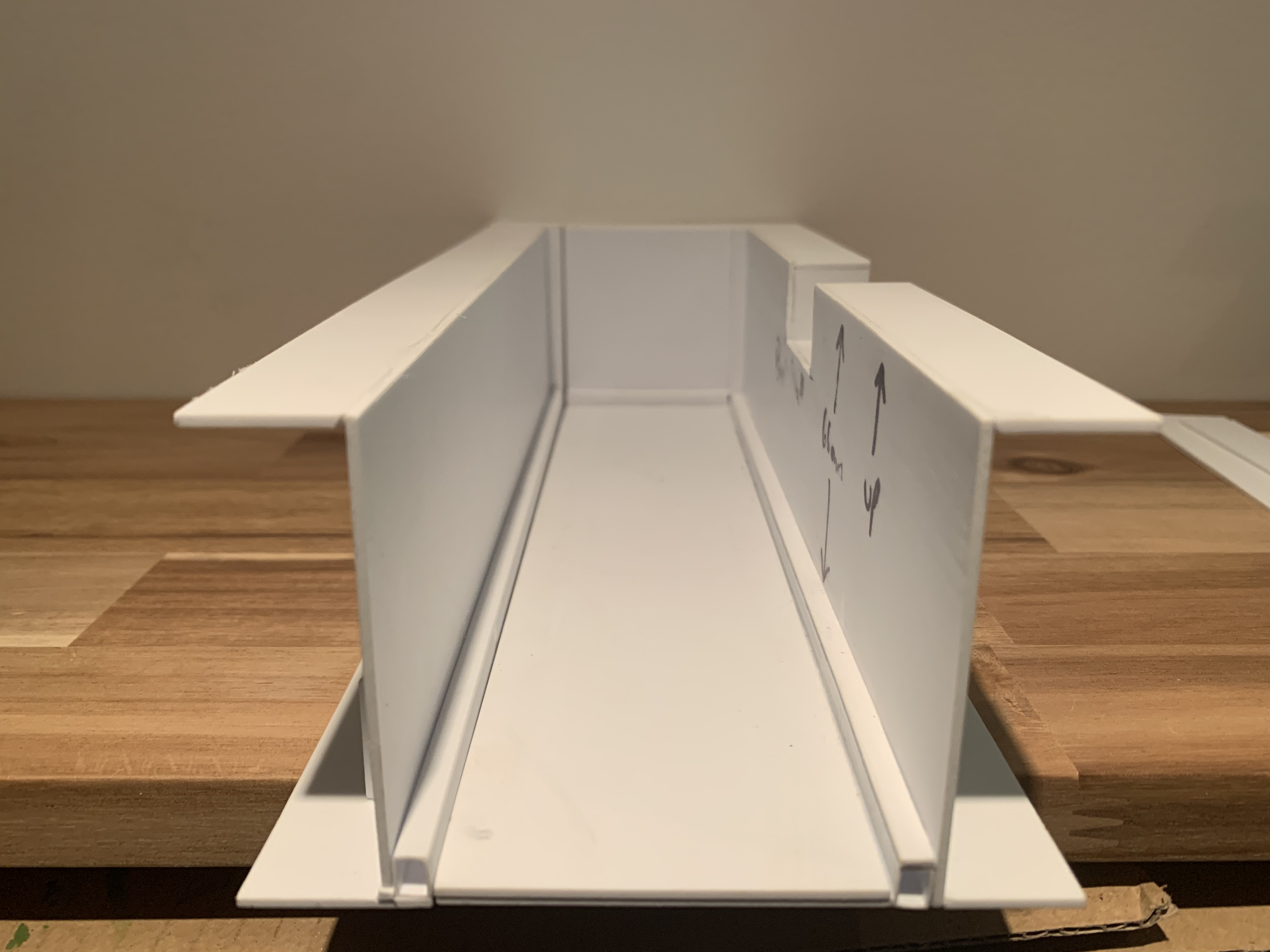

First. here's the main three-quarter trench part, with the top surface as well. (the cutout will eventually have a back wall).

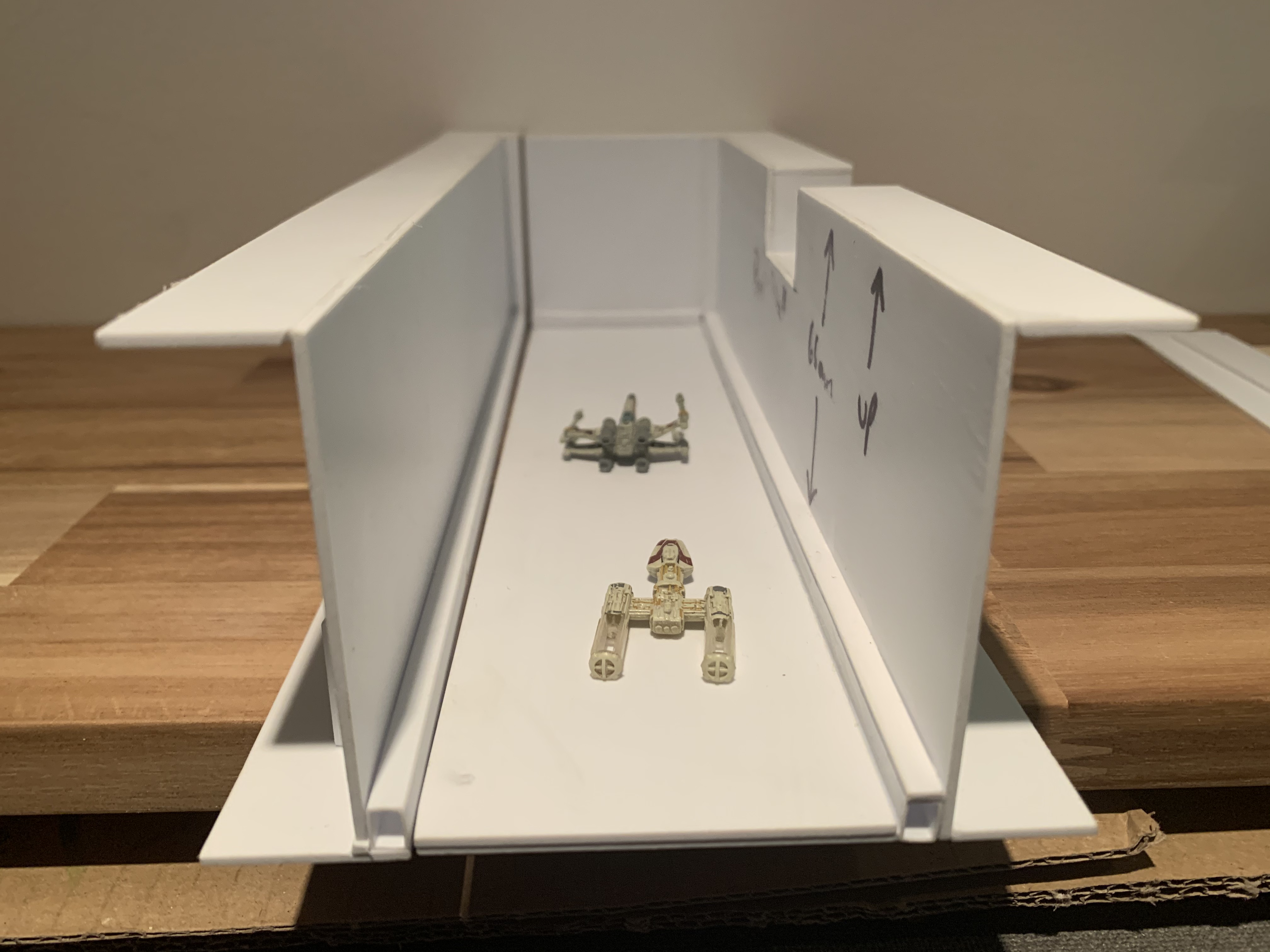

Here's what's now a full trench, with the second side wall and surface that lines up with it:
Naturally....that's going to be removable.

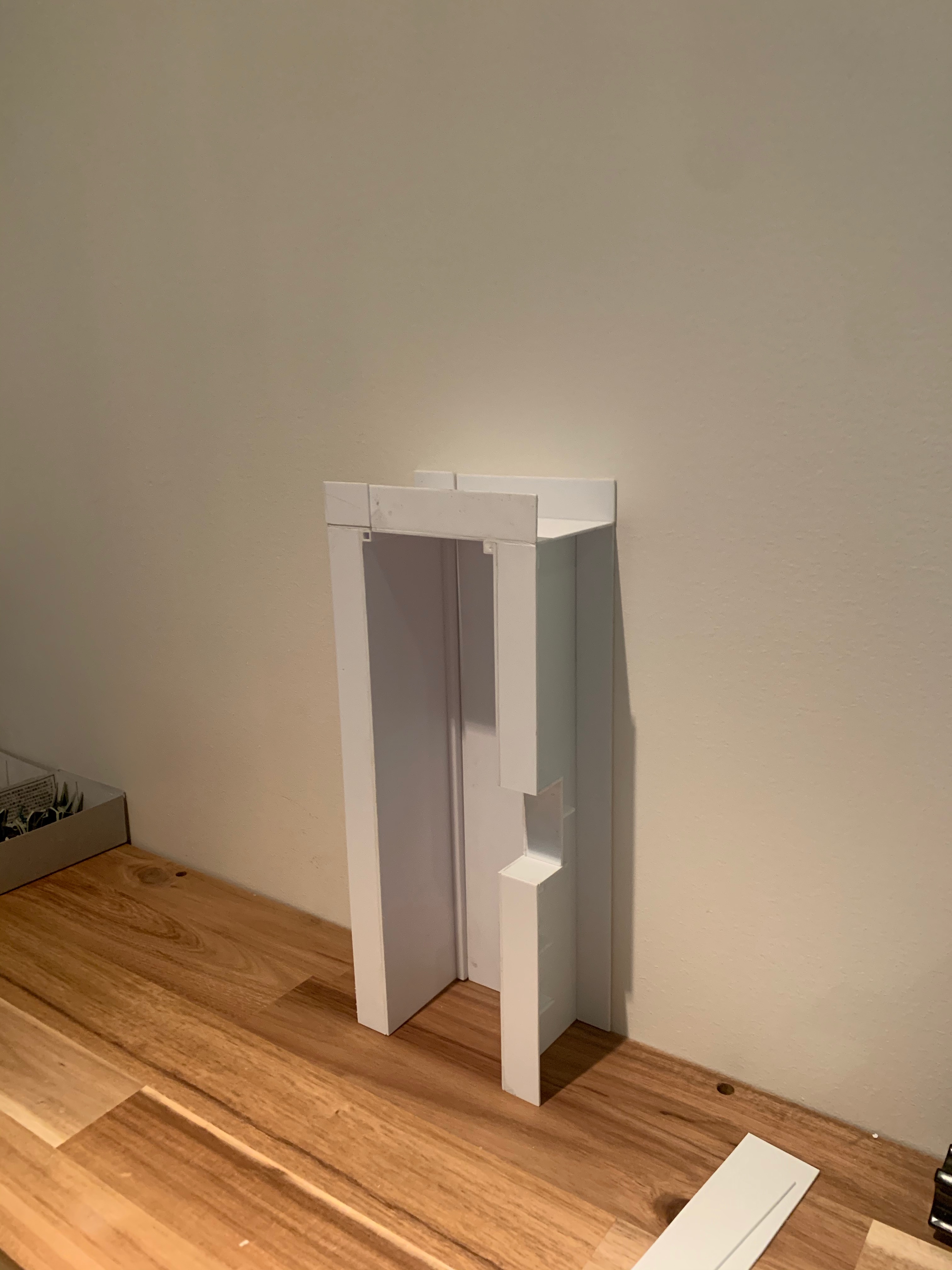

I'm going to build some sub-structure on both sides, with some magnets to attach them together, and channels for alignment. Here's the possibility for displaying it vertically:
And looking down the trench - this should make for some fun photography when it's done.
I've basically been improvising the structure as I go, so it definitely could have been constructed more simply. Maybe if I ever do another it will. But it's solid and well-aligned.
Next up I'm working on the sub-structure and the attachment mechanism, before making some more tiles and covering the surface. It's going to take a lot more to greeble the inside now!
