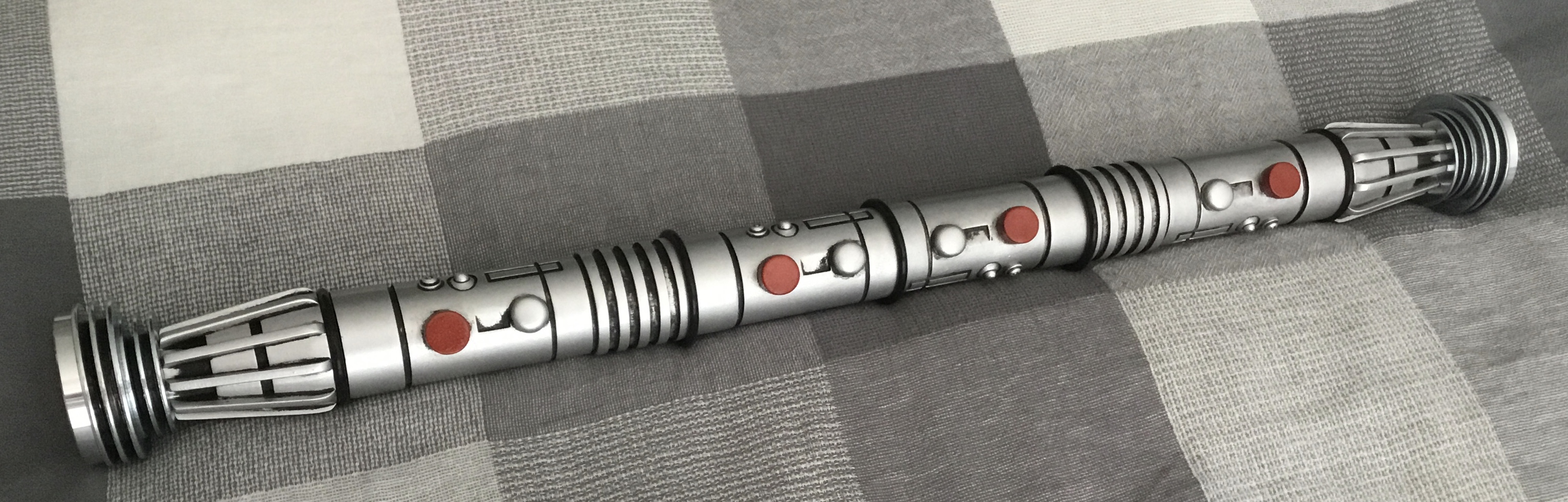

Better late than never. Finally got one of these kits off ebay. Finished assembly today.

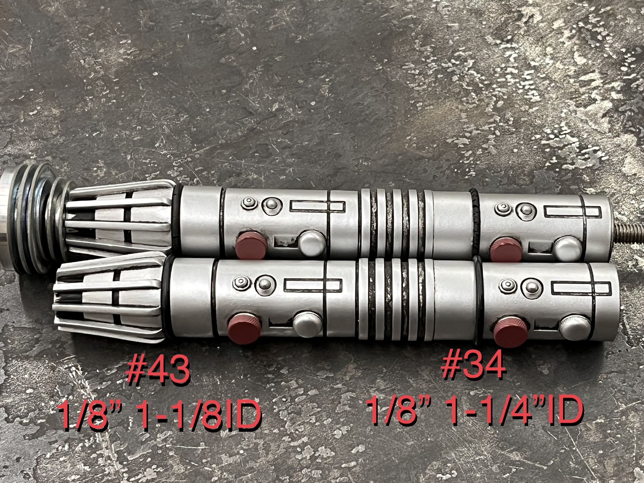

Here is my findings: the 1/8” rings are about 3.4mm uncompressed so that’s close to what Halliwax shared.
Darth Maul TPM Lightsaber O ring Replacement (written out for google searching)
2@ #43 for emitter
(add three for the body if you want to stretch them over)
3@ #34 for the body
(for a relaxed fit)
P.S. a pack of 10 from Lowe’s for the #34s is about the same price as getting 2 from Ace. ($3)

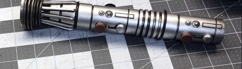

A reminder however that they are not the Buna-N rubber
(ew, pardon my metalworking hands)

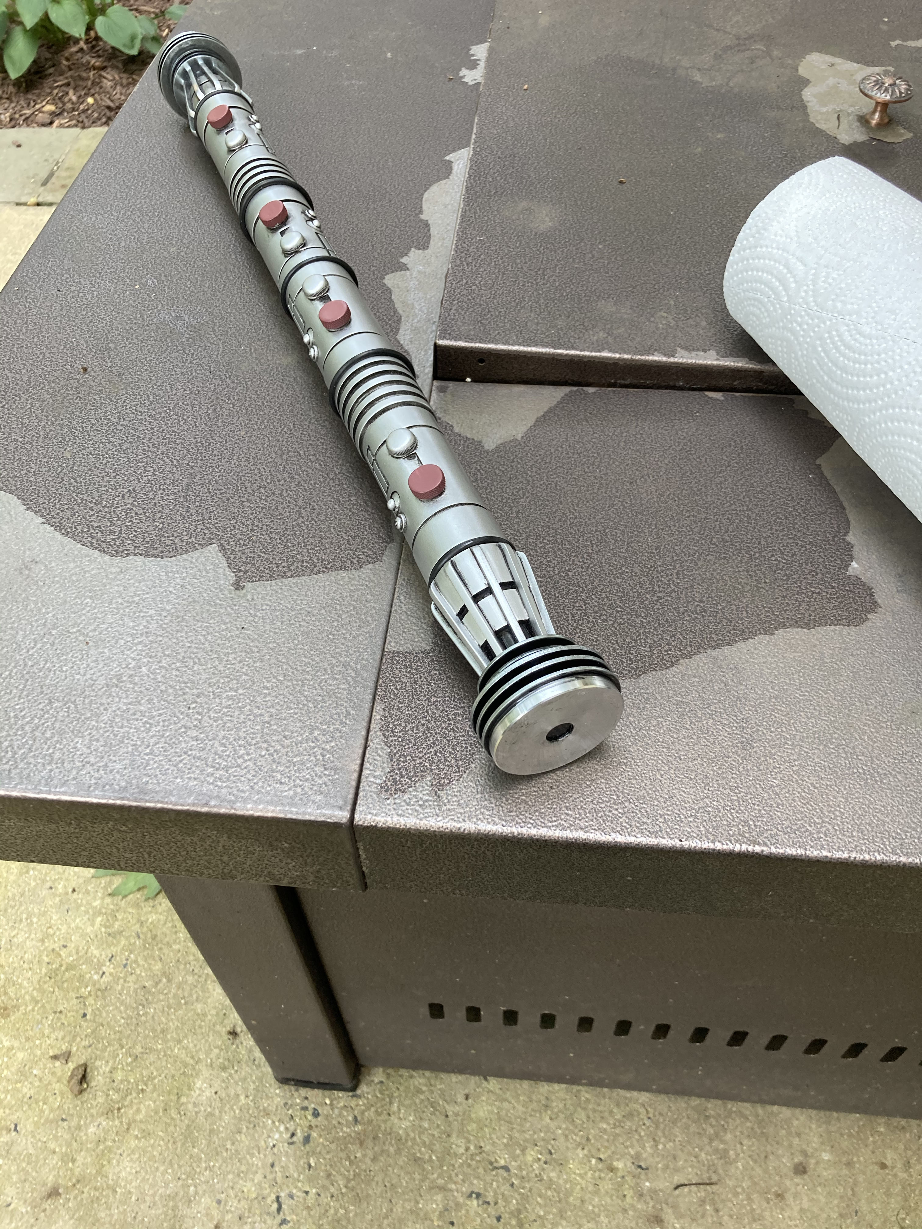

Recived and installed the Buna-N rings. I can already tell that they have more durability and stretch to them than the hardware store rings I’d been using. They were also easier to apply—previously, I had to string dental floss under the hardware store rings in order to pull them over the buttons and other raised surface features. The Buna-N rings basically just slid right on, with very little effort.
We’ll see how they last. At least I also have a bunch of spares, since it came in a 50-pack.
