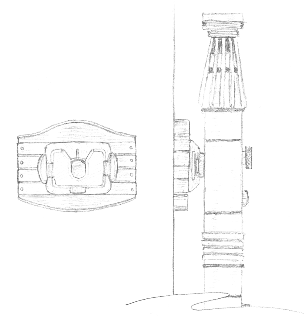

Great stuff! I hope to snag a kit from Dan soon. I was just messing around with a design for a vertical display option that references Maul's leather belt with the Covertec clip incorporated into it. I thought it might look kinda slick!
