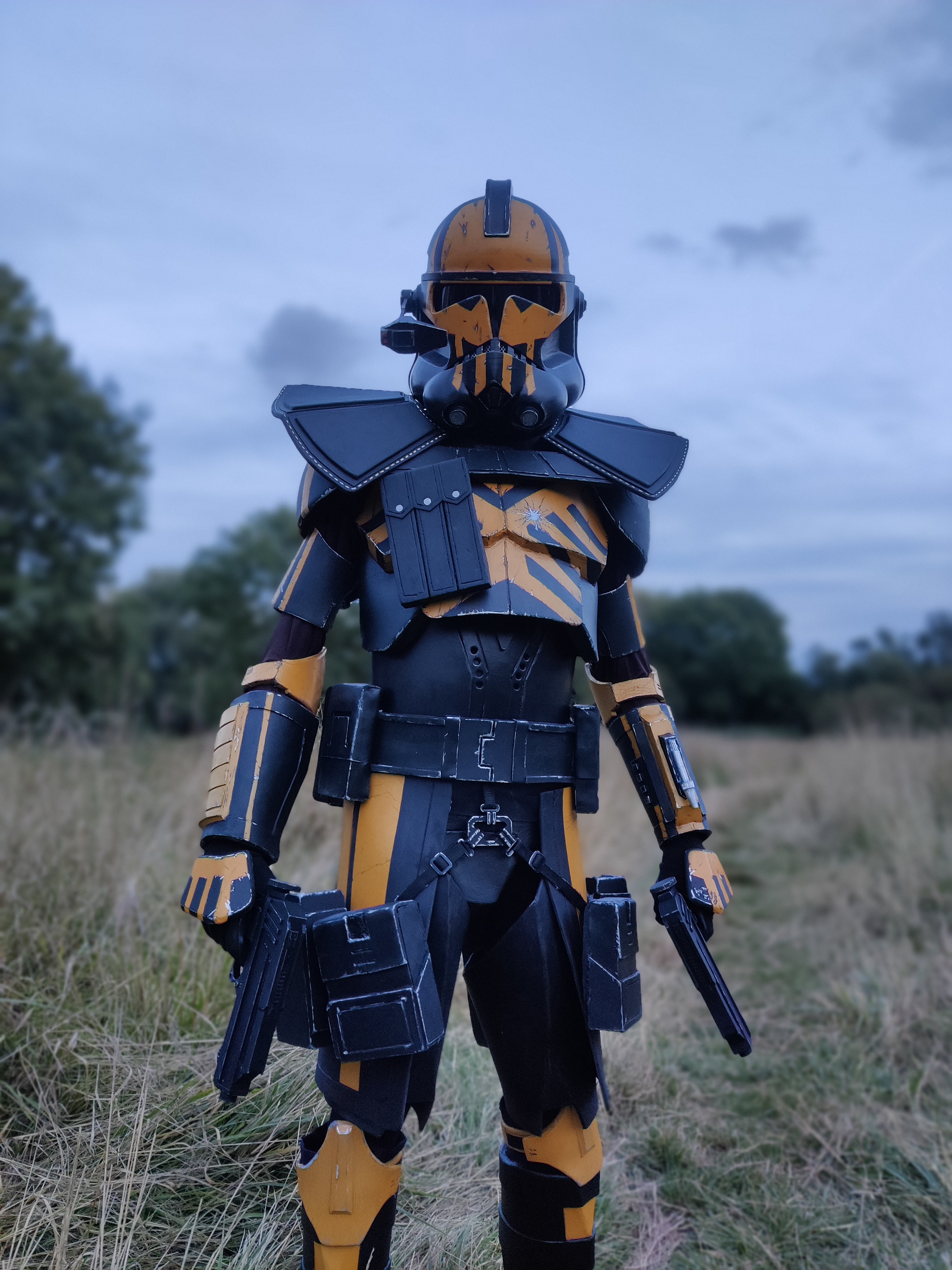

Hi, I am looking to make this armor. What glue did you use to connect the parts?
What country are you based in depends on brand but it is Contact Cement(EvoStik in UK,Barge in USA.) And also use CA glue(superglue) don't recommend really cheap runny ones as it goes everywhere. Watch YouTube videos on making this armour, using this glue as it needs to be left to dry before sticking parts together. Good luck with your build

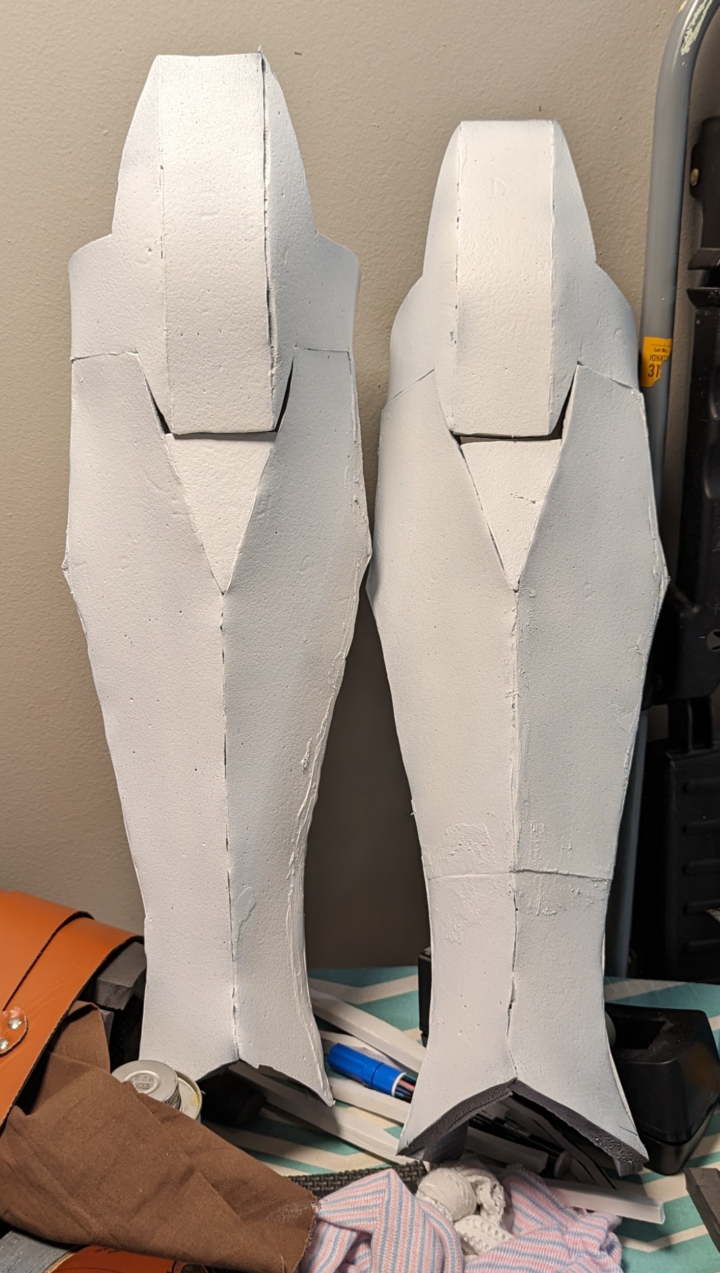

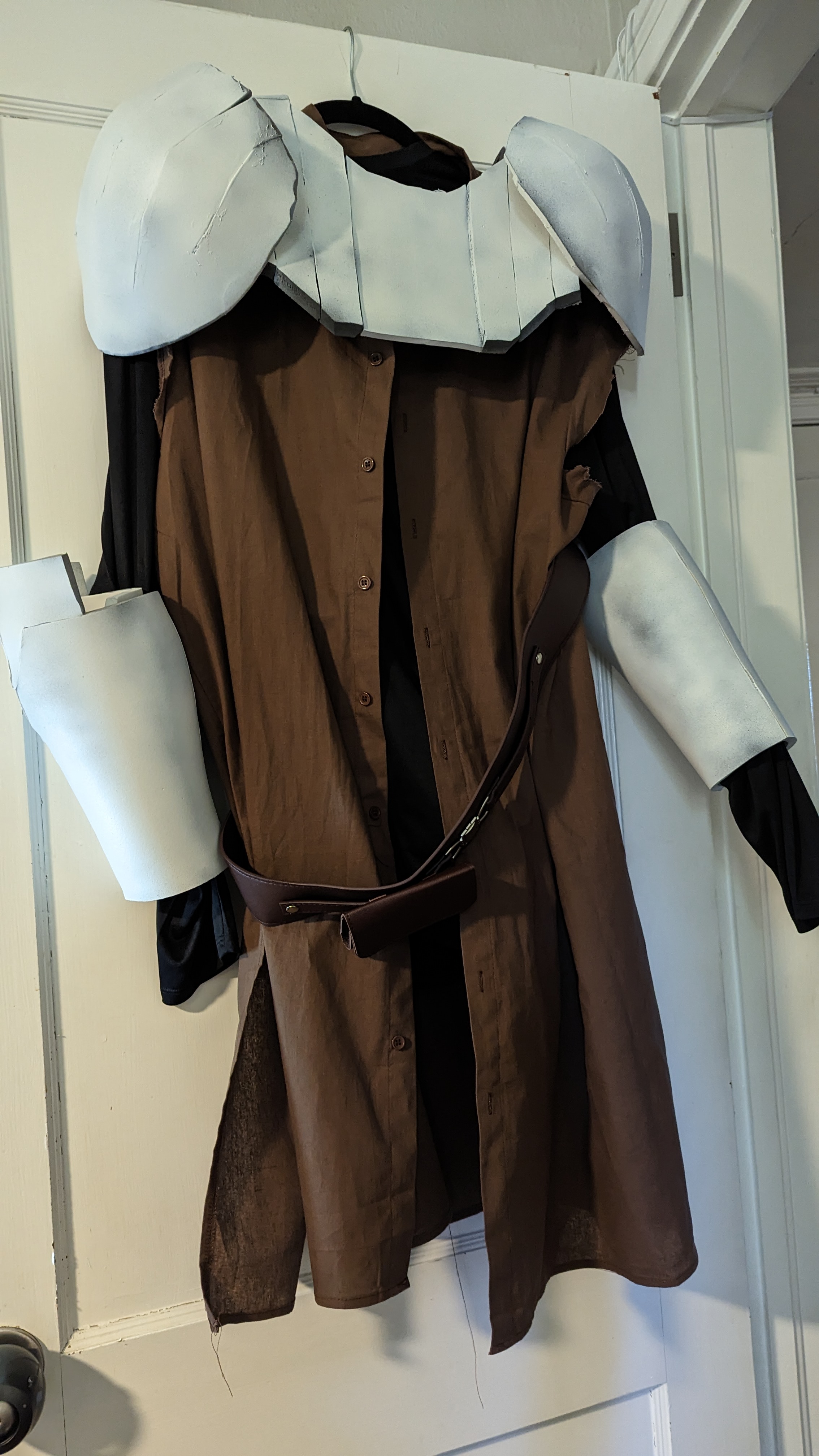

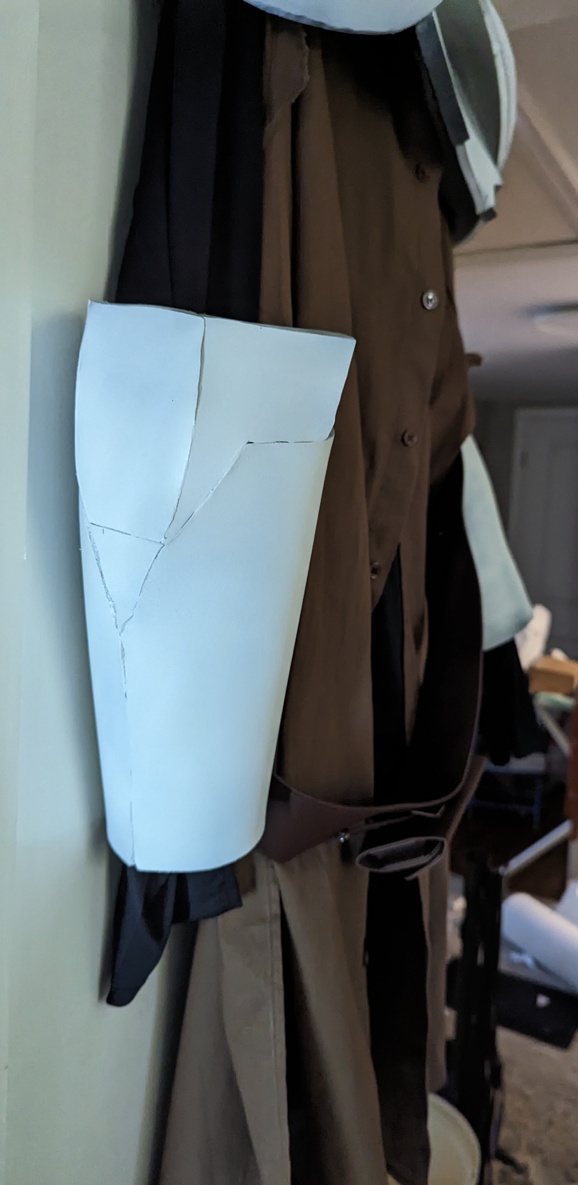

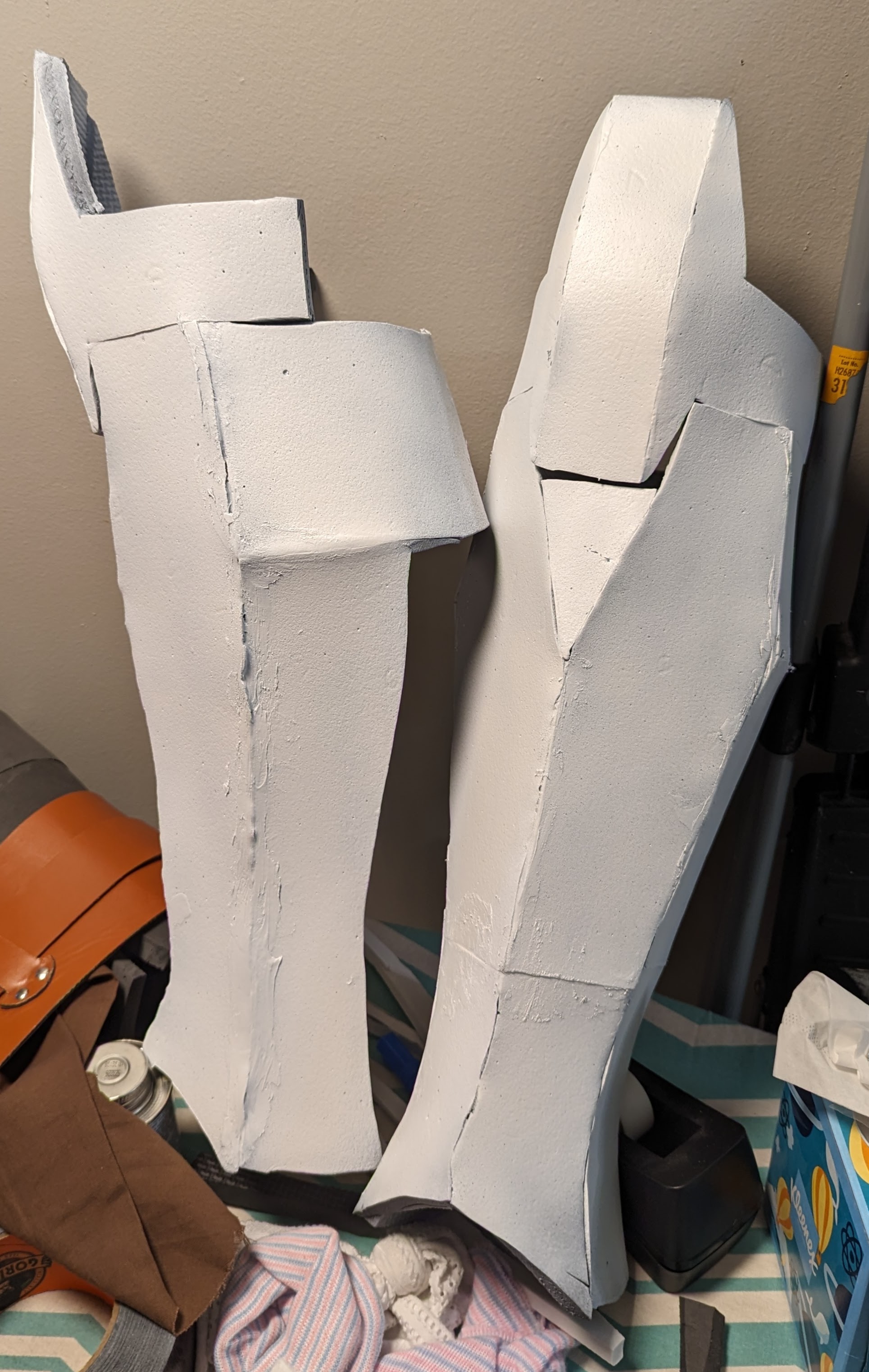

Used this clone armor to recreate parts of the Gerneral Kenobi. They're in rough shape since I didnt have time to sand it before Halloween. Plan on wearing it to Megacon. Going to add the thigh pieces and bicepts, sand, and repaint.
