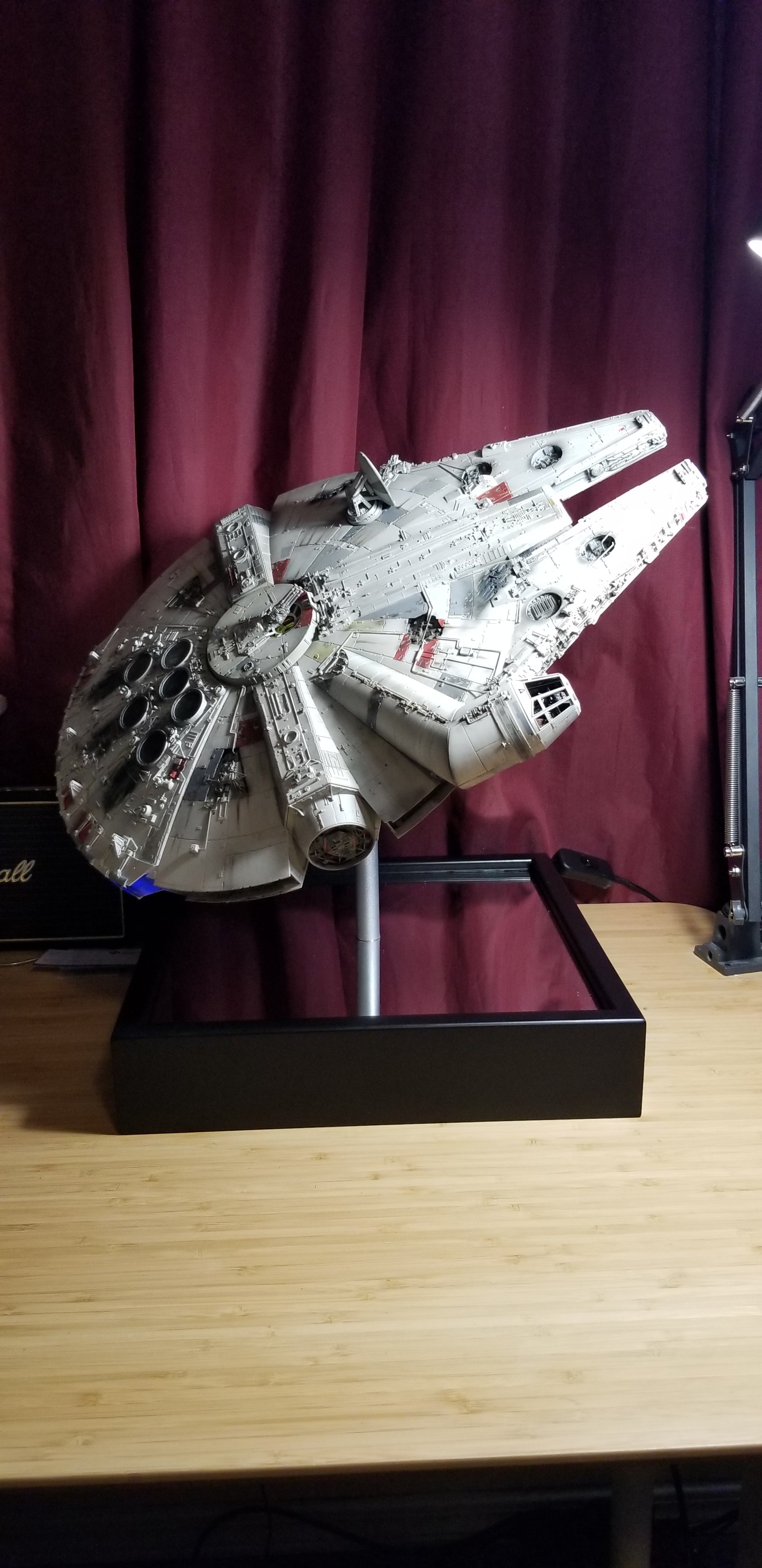

Bandai 1/72 PG Millennium Falcon (also the Revell Germany rebox)
Nice build, especially for a re-entry into the hobby! What base color did you use for your Falcon?
Thanks Demigod,

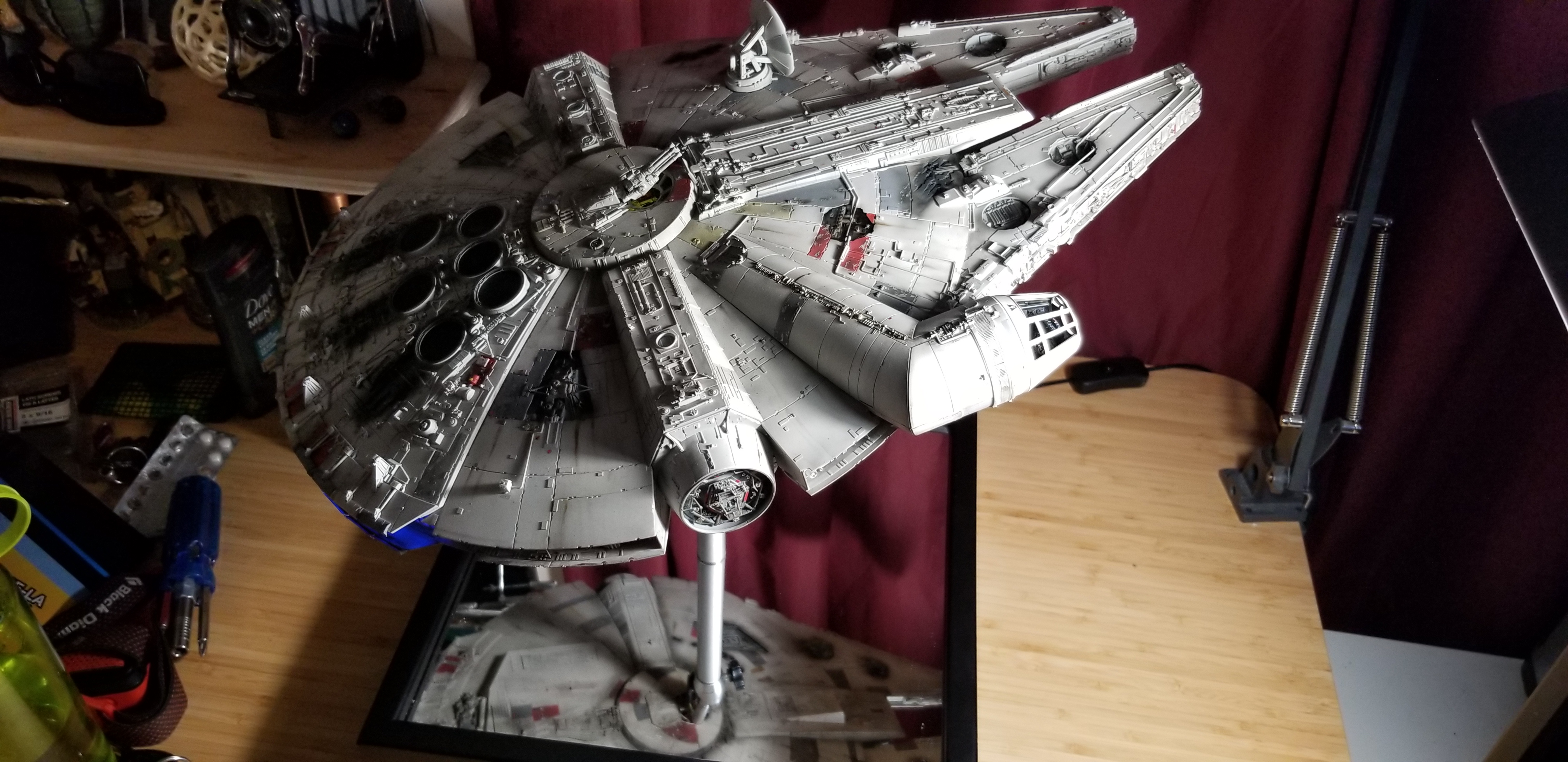

I used a 10:1 mix of Vallejo model Air 71.119 White Grey and 71.132 Aged White.
I got the mix form ModelChili Scale Models on youtube, he has a great video series of his build of the Falcon that helped me alot.
So I built a basic base for my stand out of a cheap 2" deep 12" x 12" shadow box frame and a 12" square acrylic mirror that at drilled an 18mm hole through for the stand. All up it cost about $55 Canadian including the projector stand.

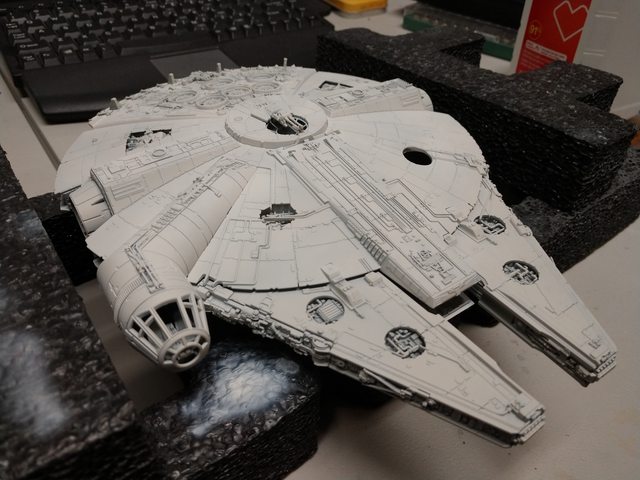

I spent some time this weekend painting not one but two Falcons. This is my first go at using Archive-X paint. I mixed Reefer White with mineral spirits until it had the consistency of milk. I applied this over the top of my AS-20 and it has a warmer color that already feels more screen accurate.
The only issue I've had is the paint after fully drying is easy to scratch (found that out on the smaller model). Are people applying a protective coat? Did I soften the paint by using the wrong type or too much mineral spirit? Or is the Archive-X not bonding to the Tamiya AS-20?
Edit: I did a test and applied Testor's 1260 Dullcoat lacquer to the battery door. It passes the fingernail test now. I'll try a couple more test pieces and then give it a few days to see if there's any discoloration.

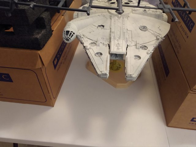

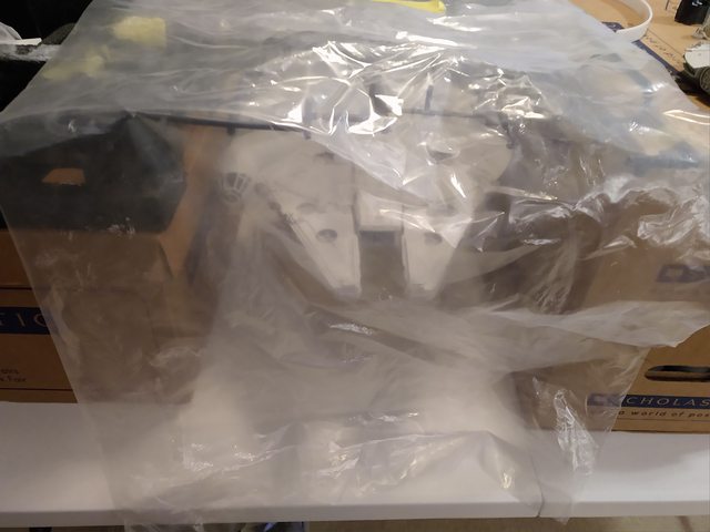

1:144 with Perfect Grade:
drying under plastic:

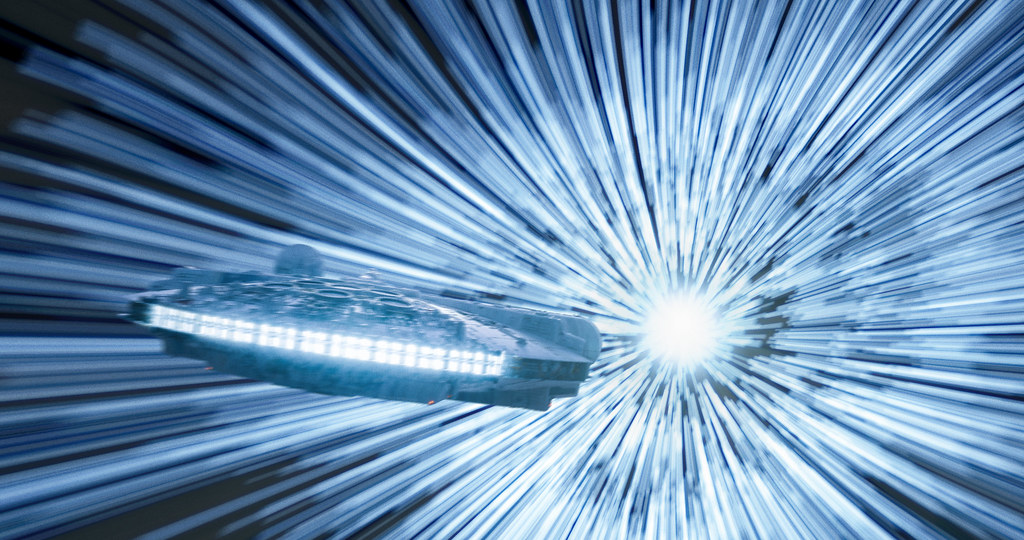

I posted this elsewhere, but since I've posted a few of these type of images here before, here's a recent shoot I did with my Falcon. I took a frame from the first Ep IX teaser and used that as my reference:
View attachment 1055379Punch it, Chewie! by Steven Bills, on Flickr
Can you go into more detail on how it was made? Are the star streaks a long exposure or computer imagery? What did your before and afters look like.

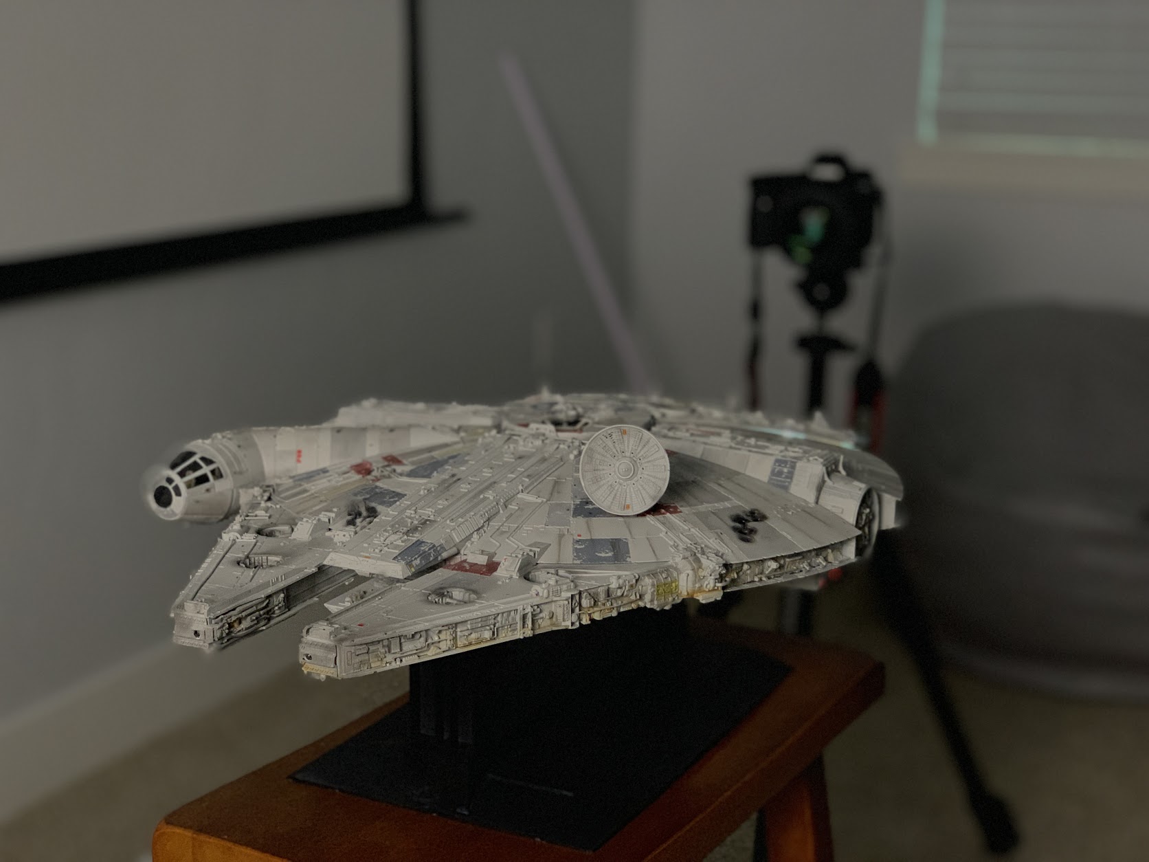

Yeah, for the lightspeed tunnel, I made a custom dot-brush in Photoshop, and then did a radial blur set to zoom, and then an added pinch to give it a bit more "distance" to the end of the tunnel. Added an outer and inner glow via the layer styles, and changed the hue on the Falcon to match the blue of the lightspeed. The engine glow in this one is all real, as the photo was a 10 second exposure. I noticed that the longer the exposure went, the brighter and bigger the engine glow became. I thought about doing a 20 second exposure for the engine glow, and then a 5-7 second exposure on the rest of the Falcon and then doing a composite of those two, but it turns out that the 10 second exposure was the sweet spot for both.
Here's what the shot looked like out of the camera:
(Tech specs for photo nerds: Canon 6Dii, Sigma 50mm ART lens at f/16, 10 second exposure, processing in Photoshop).
Then it was a simple task of cutting it out with the pen tool (although that's a pain because of all the greeblies, but oh well).

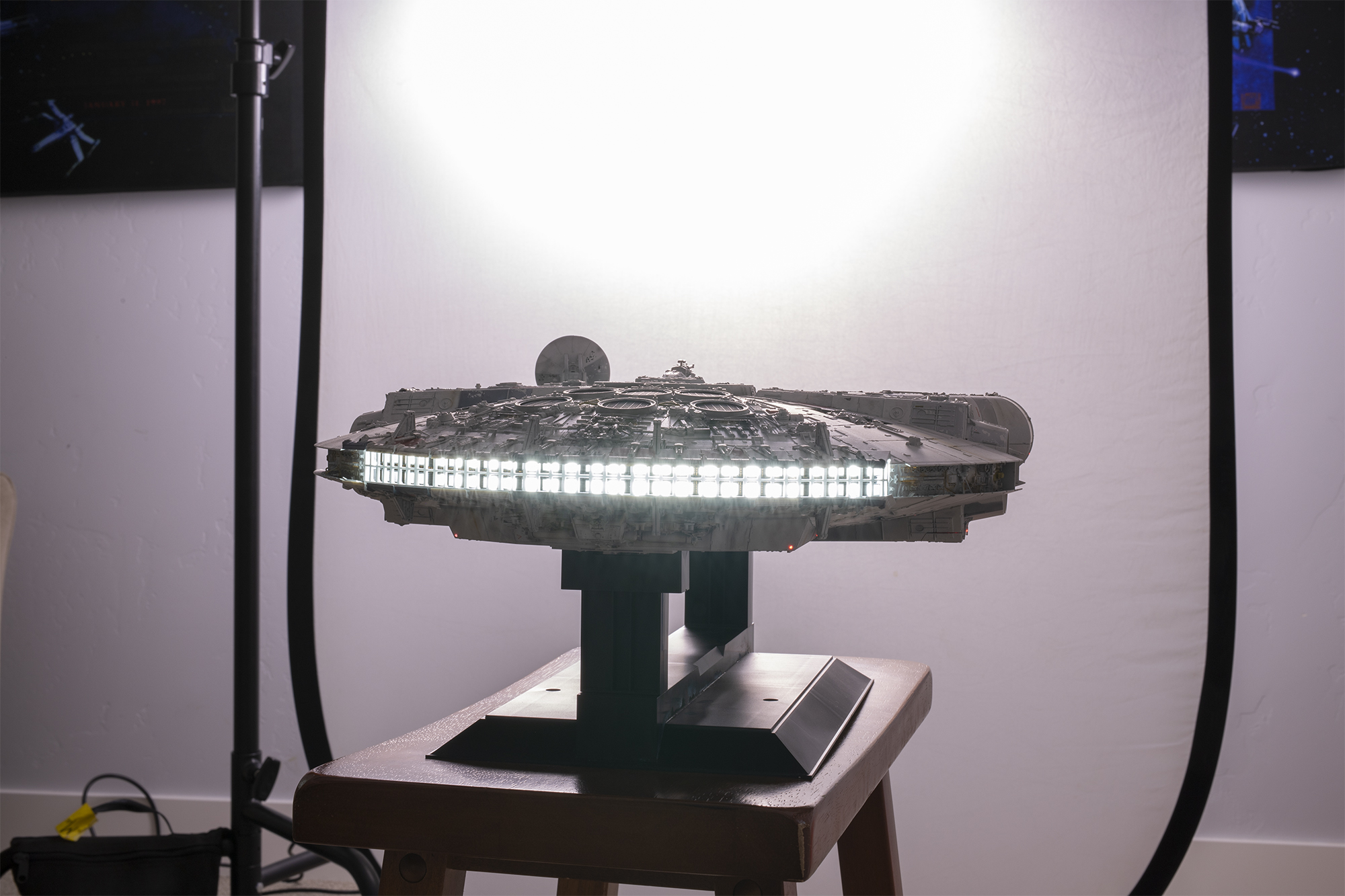

Here's a few BTS images. Just taken in the basement with a diffused light source coming from the front, and then I held up a bounce card to fill in a bit on the bottomside of the hull:
