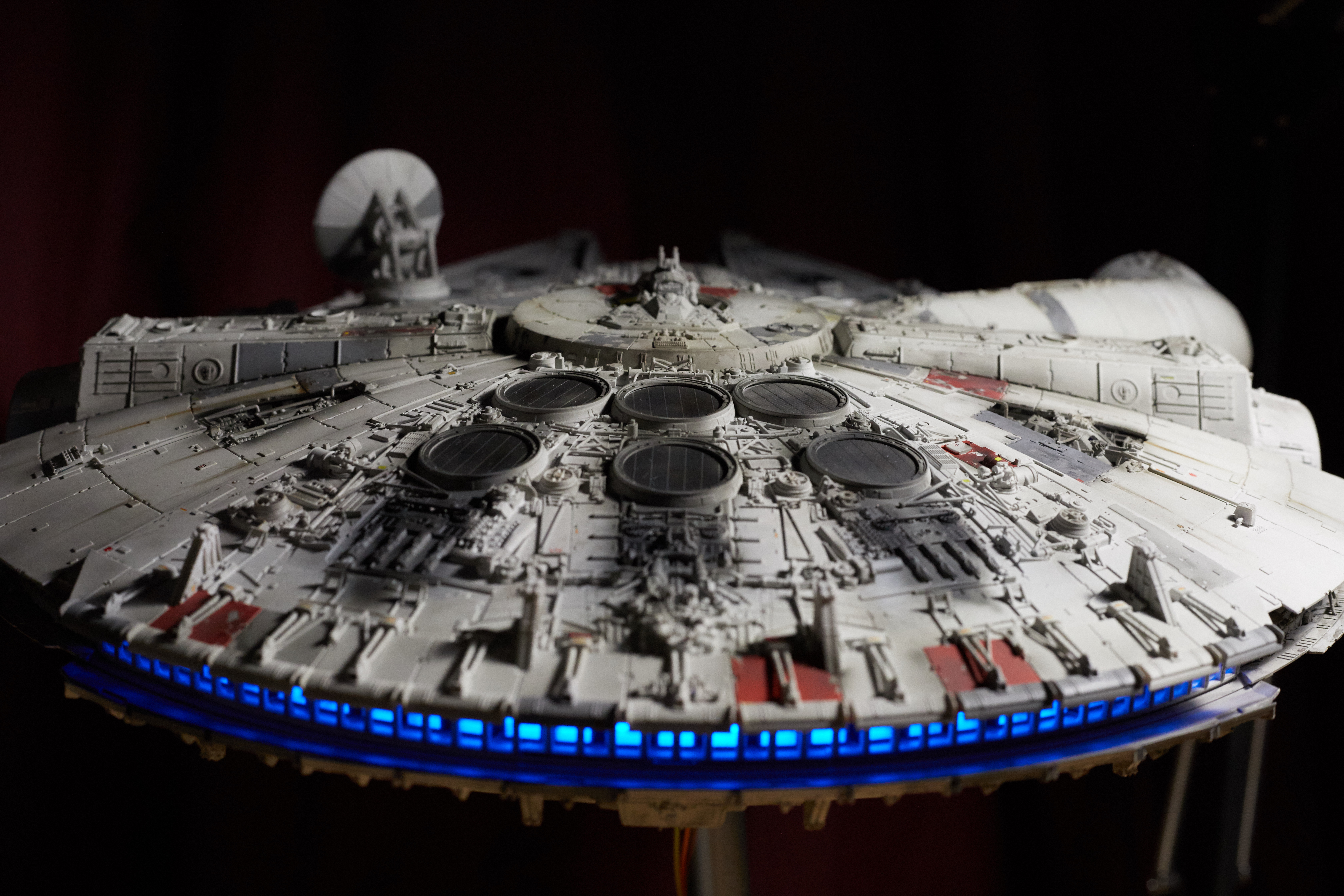

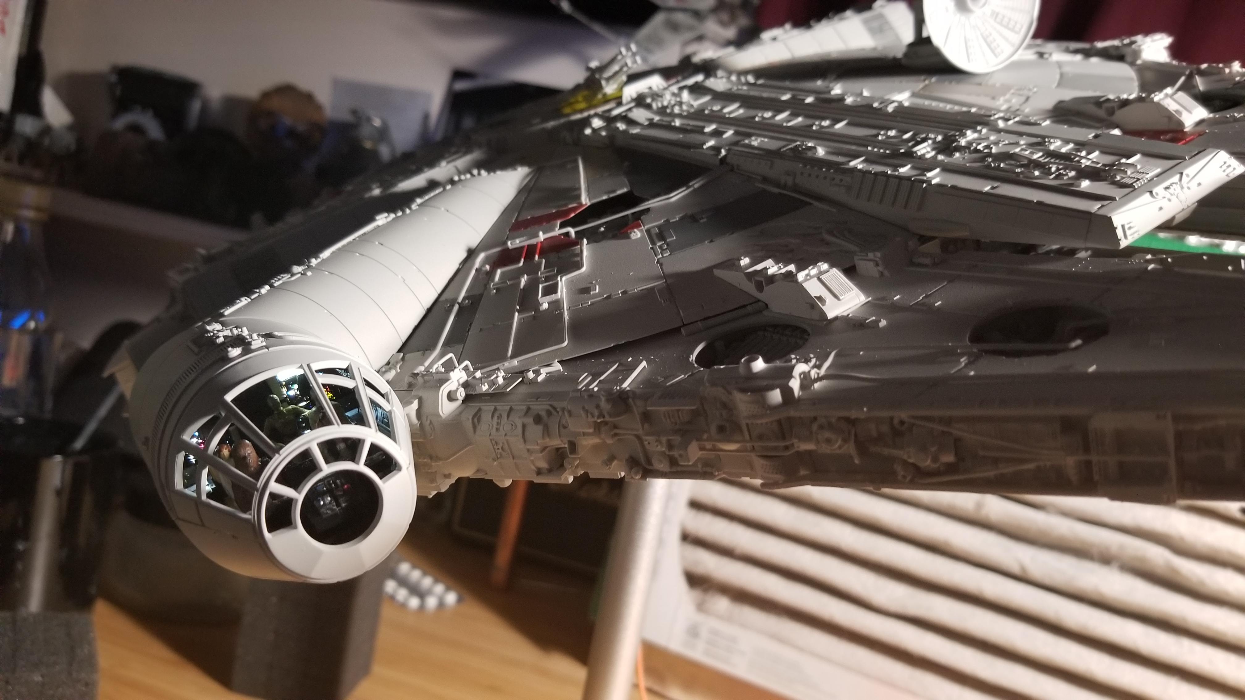

So I thought I'd share my Falcon build so far, I am a complete beginner model builder and airbrusher.
I hadn't built and painted a model since I was a kid, like 25+ years ago which was terrible from what I remember.
Before the falcon I built the Bandai 1/72 X-wing as practice, it's by no means perfect or accurate but I had a lot of fun.
So over the last few weeks I've been building and painting the Falcon and this is where I'm at.
I'm pretty a happy with what I've done so far, at this point I think I want to put on the decals and do the chipping and weathering.
Again I'm not going for super accurate, I just wanted a Falcon.

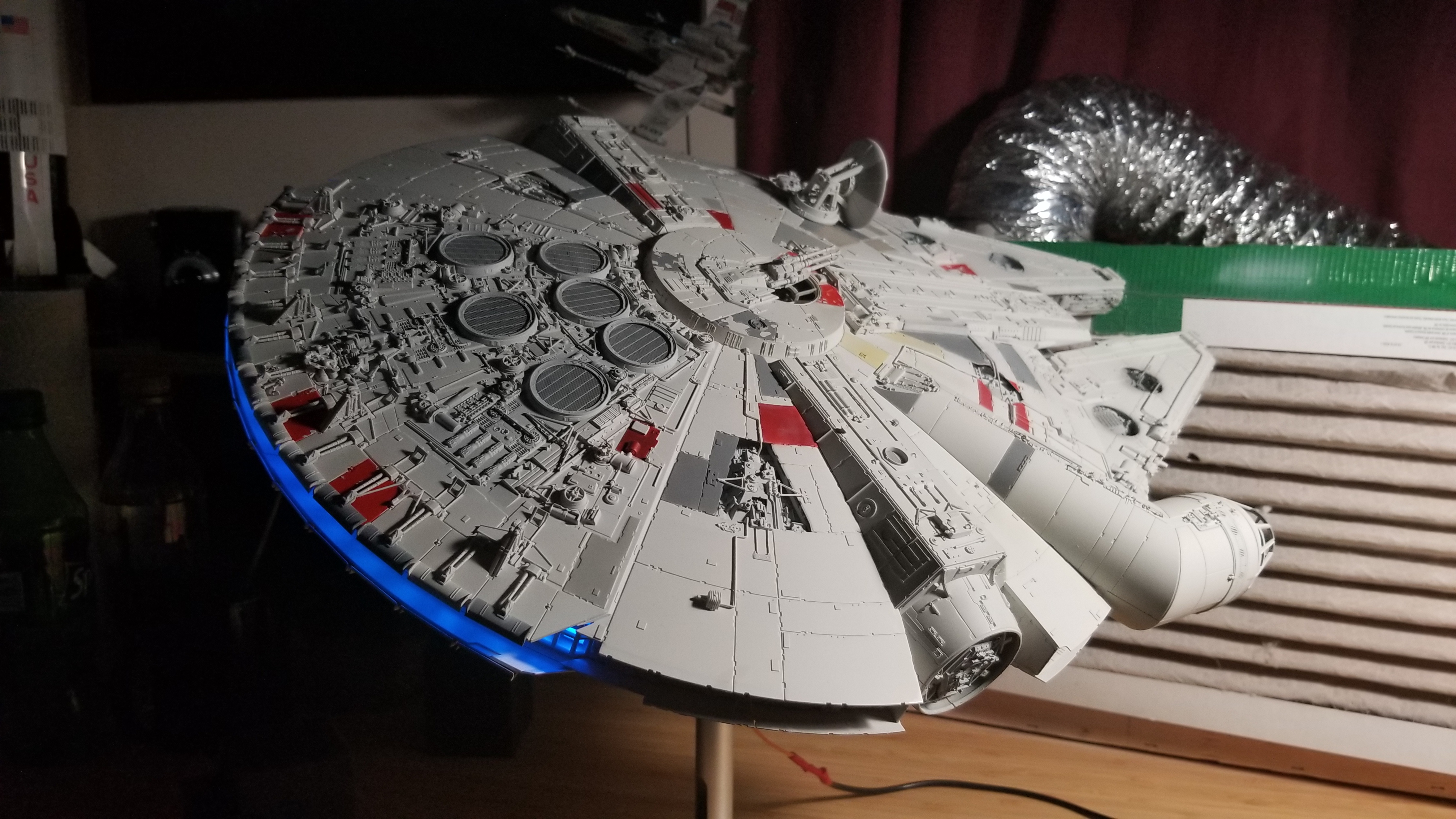

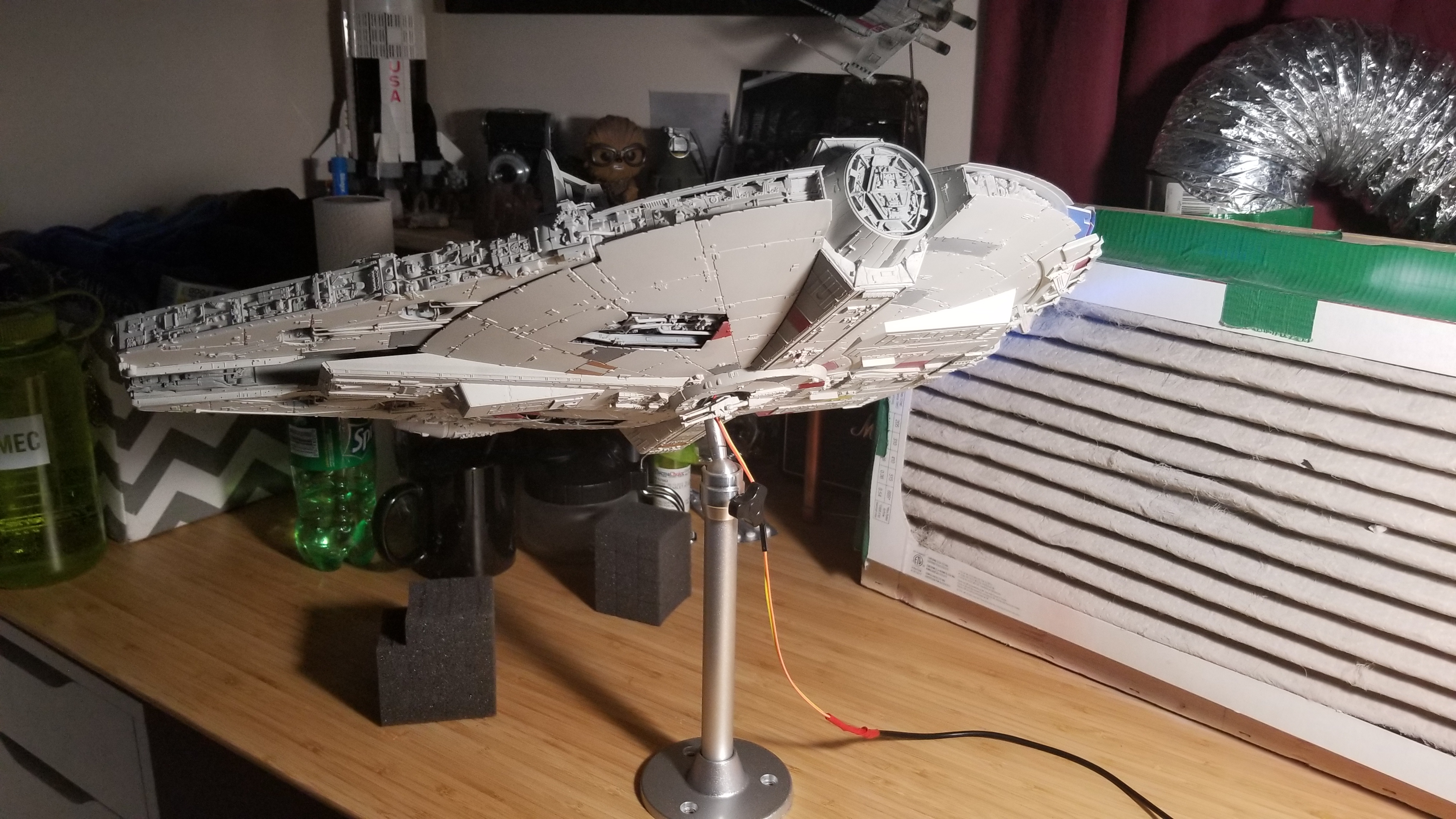

I've also done a couple of mods, I've used an RGB usb strip light with the existing light tube? for the engine light and wired it to the light control box so it can run on battery or usb. I decided not to use the open ramp and used that LED to light to top turret where I placed Luke, also modified C-3PO so he's standing at the back of the cockpit.
I've mounted it on a cheap mini projector stand, I was going to use Lab's mount but I wanted to keep the lower gun so I cut a piece of scrap polycarbonate to fit tightly in the hull and put a 1/4" stud extending out through the turret window just right of center.
If anyone has and input or tips on what weathering techniques I could try, like how can I tone down some of the brighter coloured panel? Or anything I could try differently please let me know.
I've had a lot of fun so far and have really enjoyed seeing everyones work in this thread, it really helped me a lot.
Thanks for looking
Adam

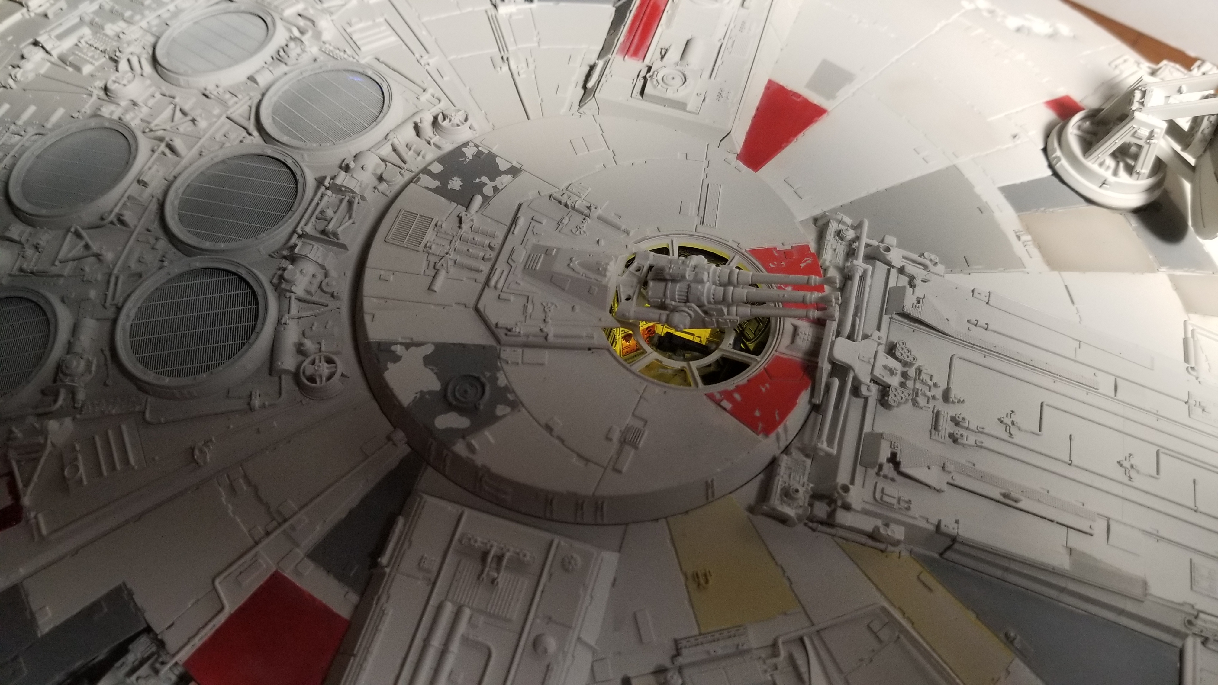

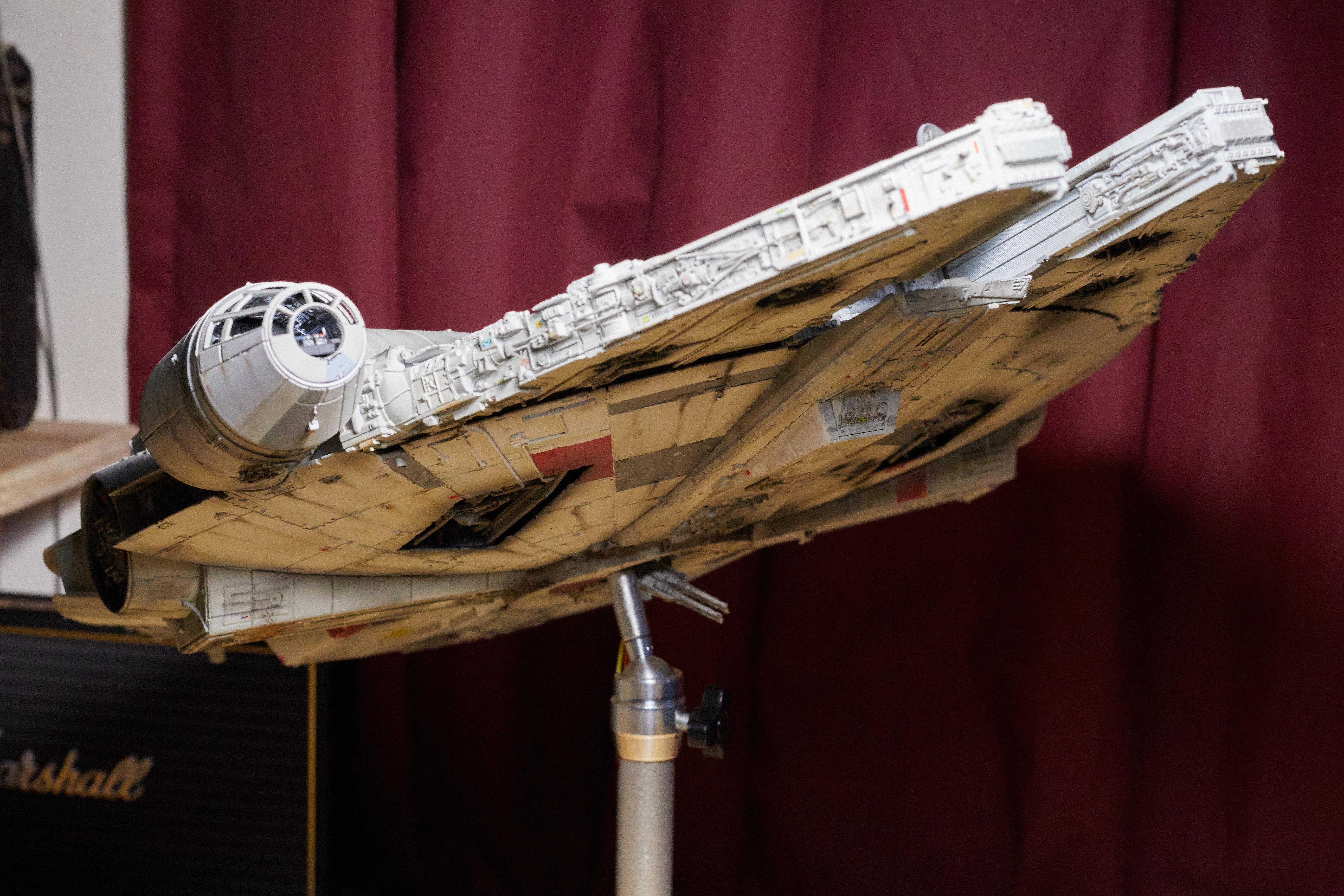

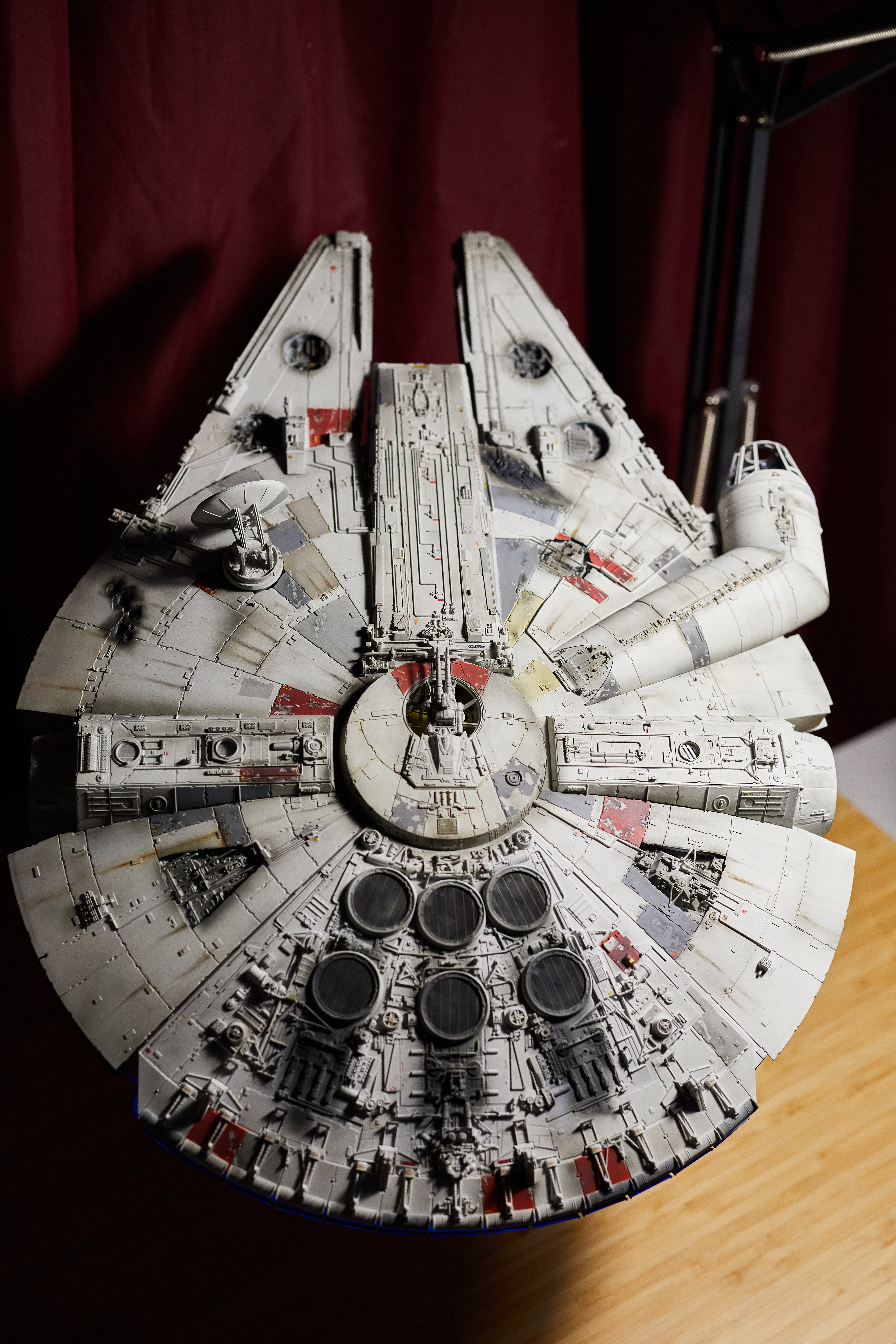

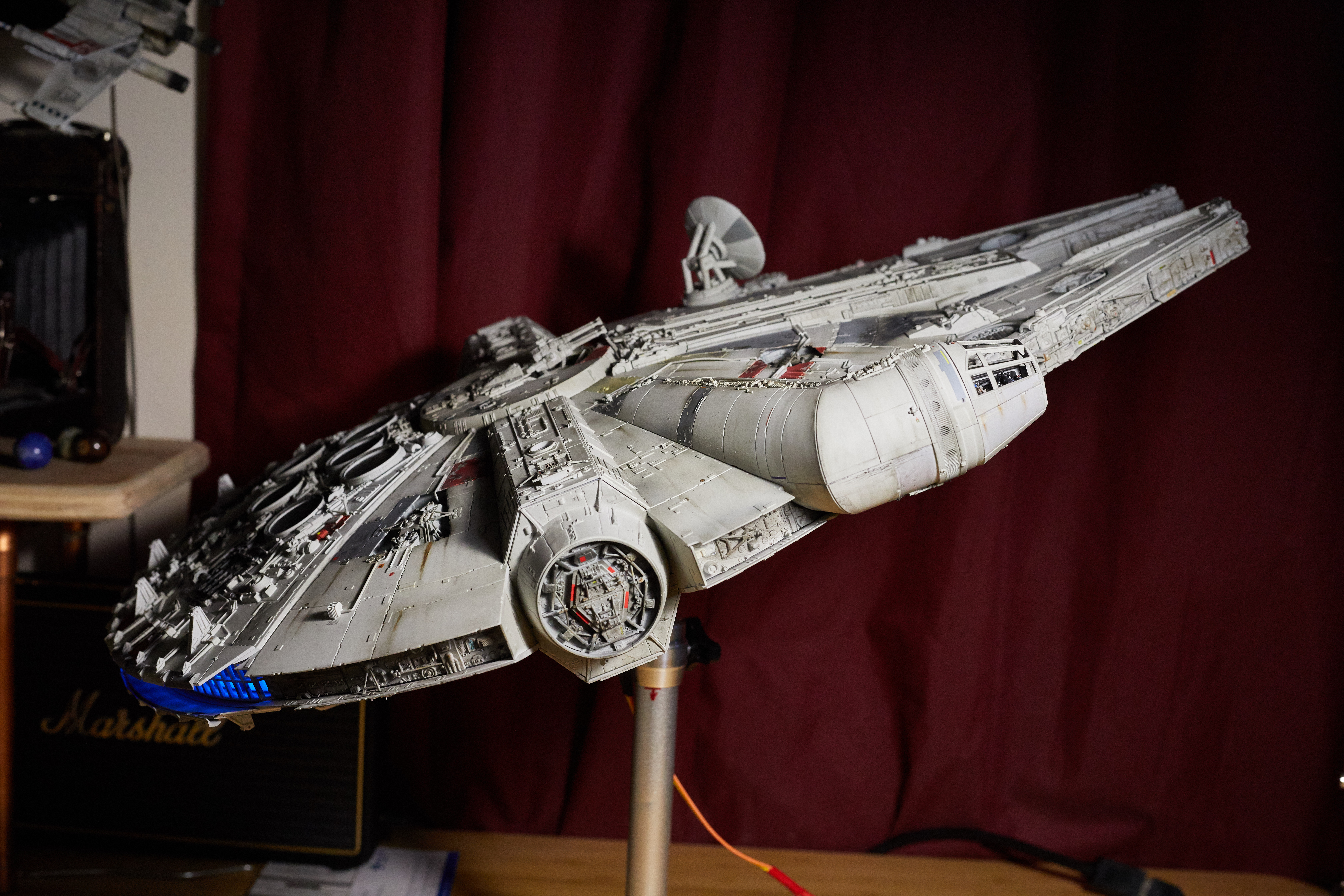

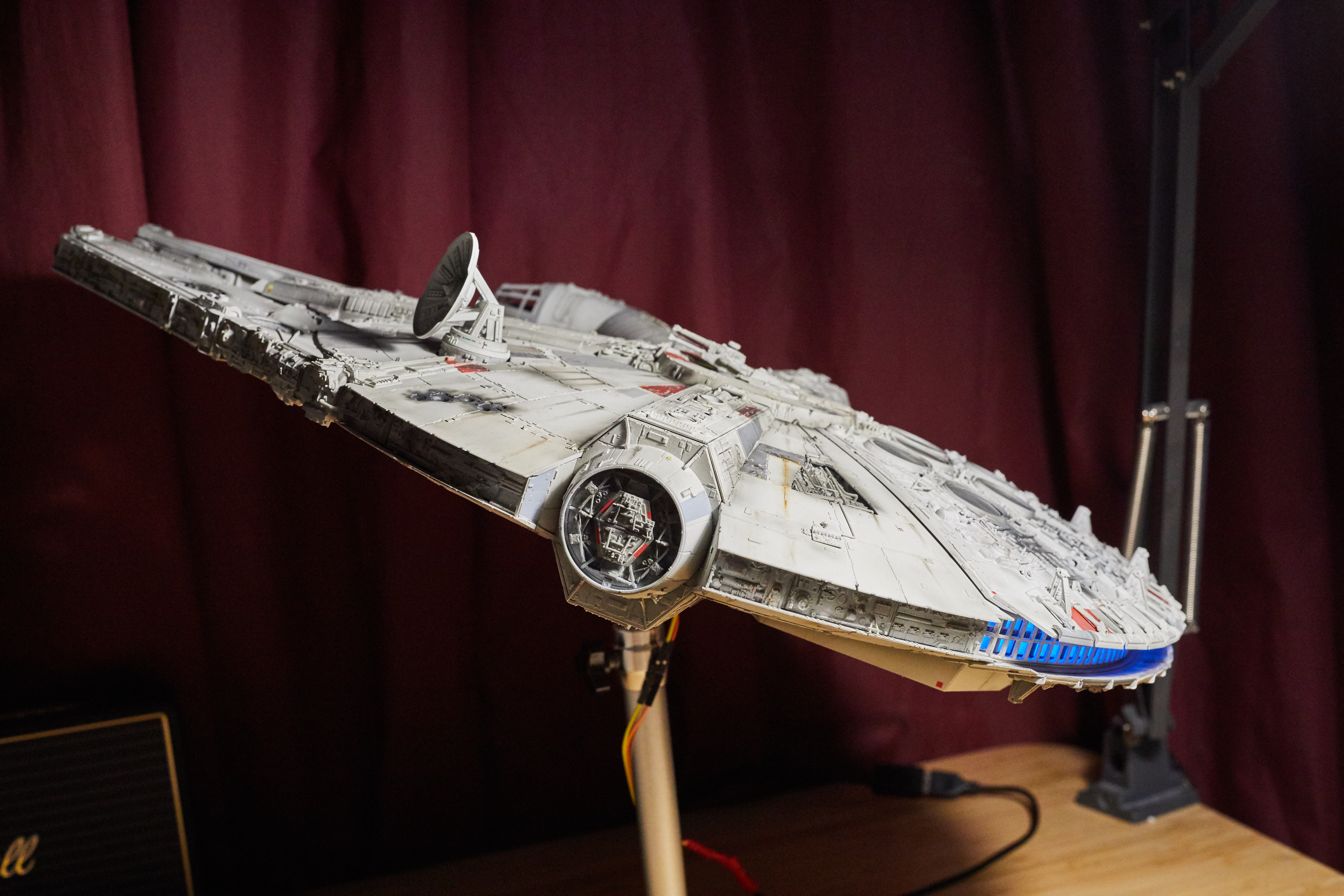

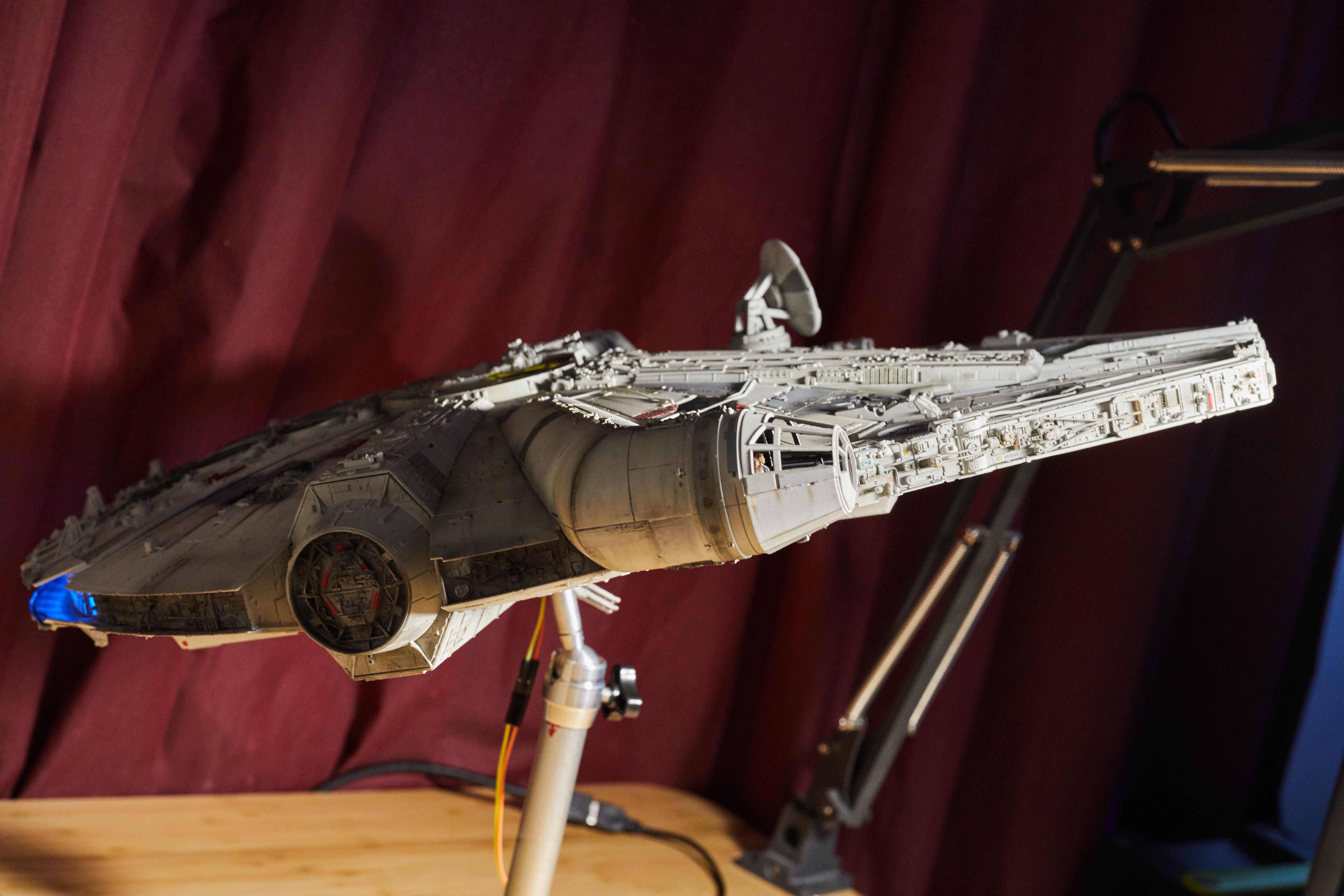

So I've finished weathering my Falcon and gave it a matte coat.
I tried my best not to over do the weathering and it's not perfect but I'm pretty happy with the final result, I just need to finish my display stand.
It was a very fun and enjoyable build, well except for maybe all those tiny little decals that was a bit mind numbing hahaha but it was worth it.
Please let me know what you think, what you like or what you would do differently. I definitely want to build and paint some more models in the future so any input would be very helpful.

Very nice job. I think the weathering is nicely restrained and not overdone.

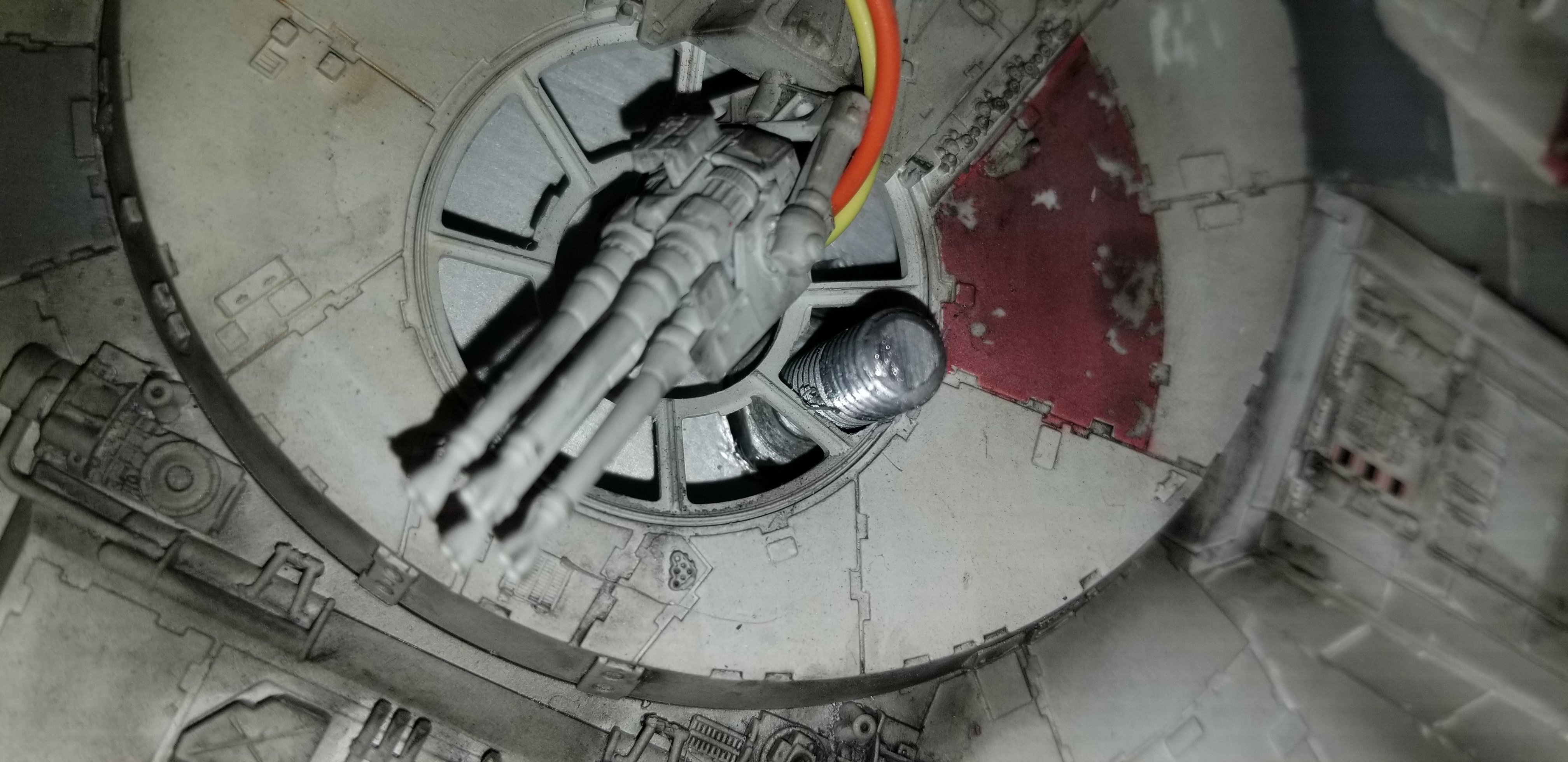

I’m curious about the inside of your Falcon for your mount. Any photos of your setup? I like that you preserved the lower guns.
Thank you.

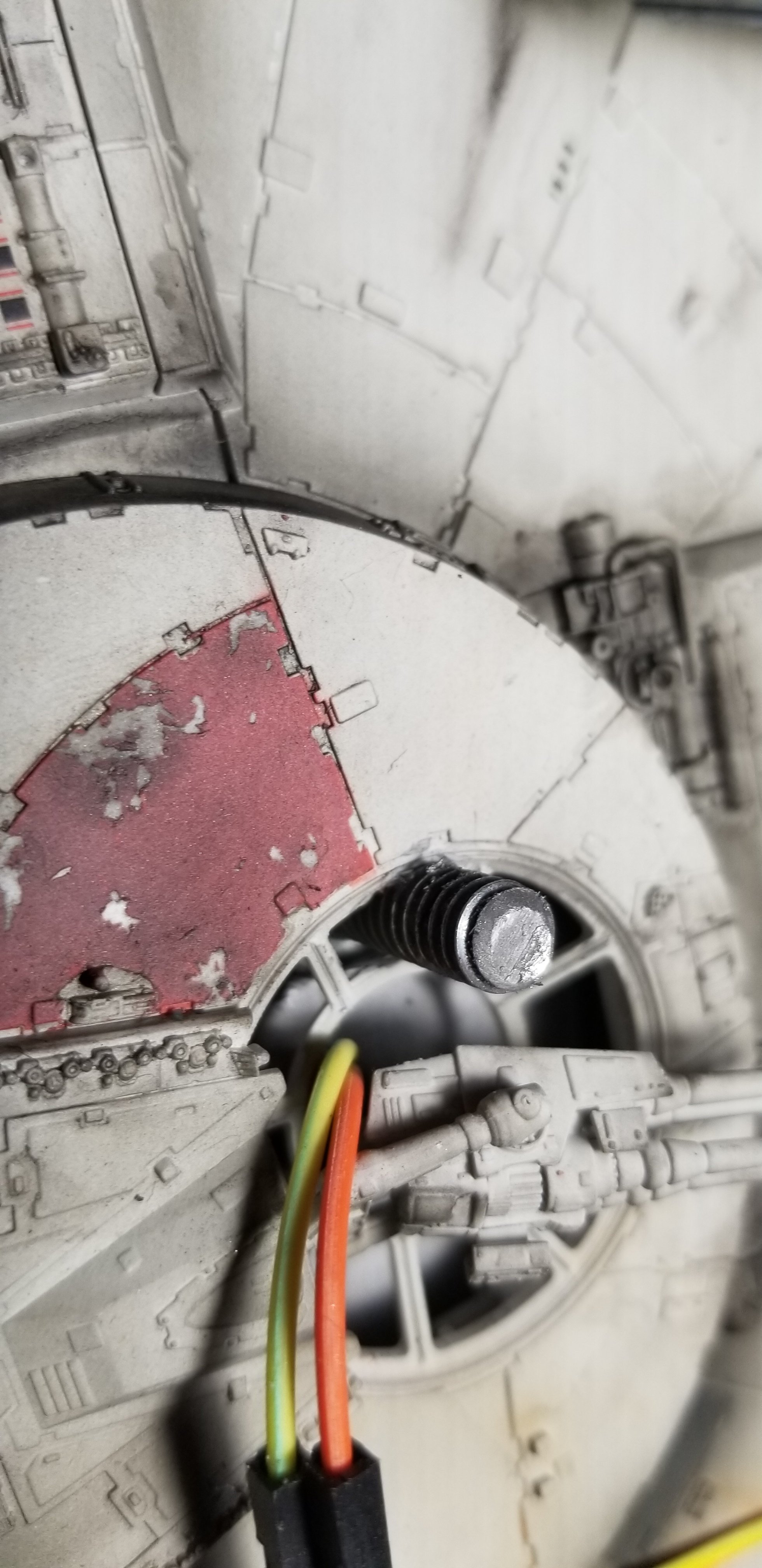

I thought I took a photo but I can't find it.

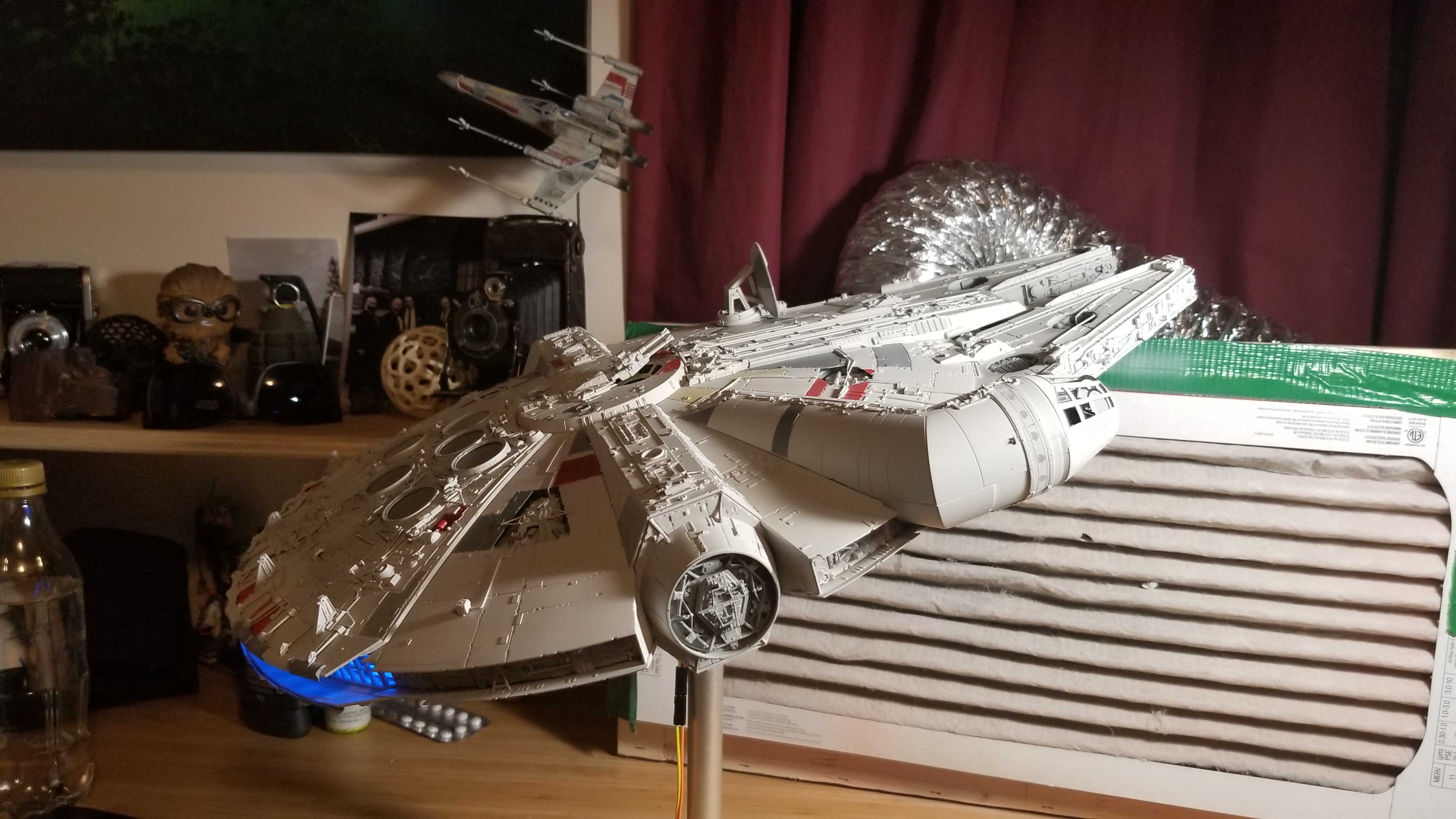

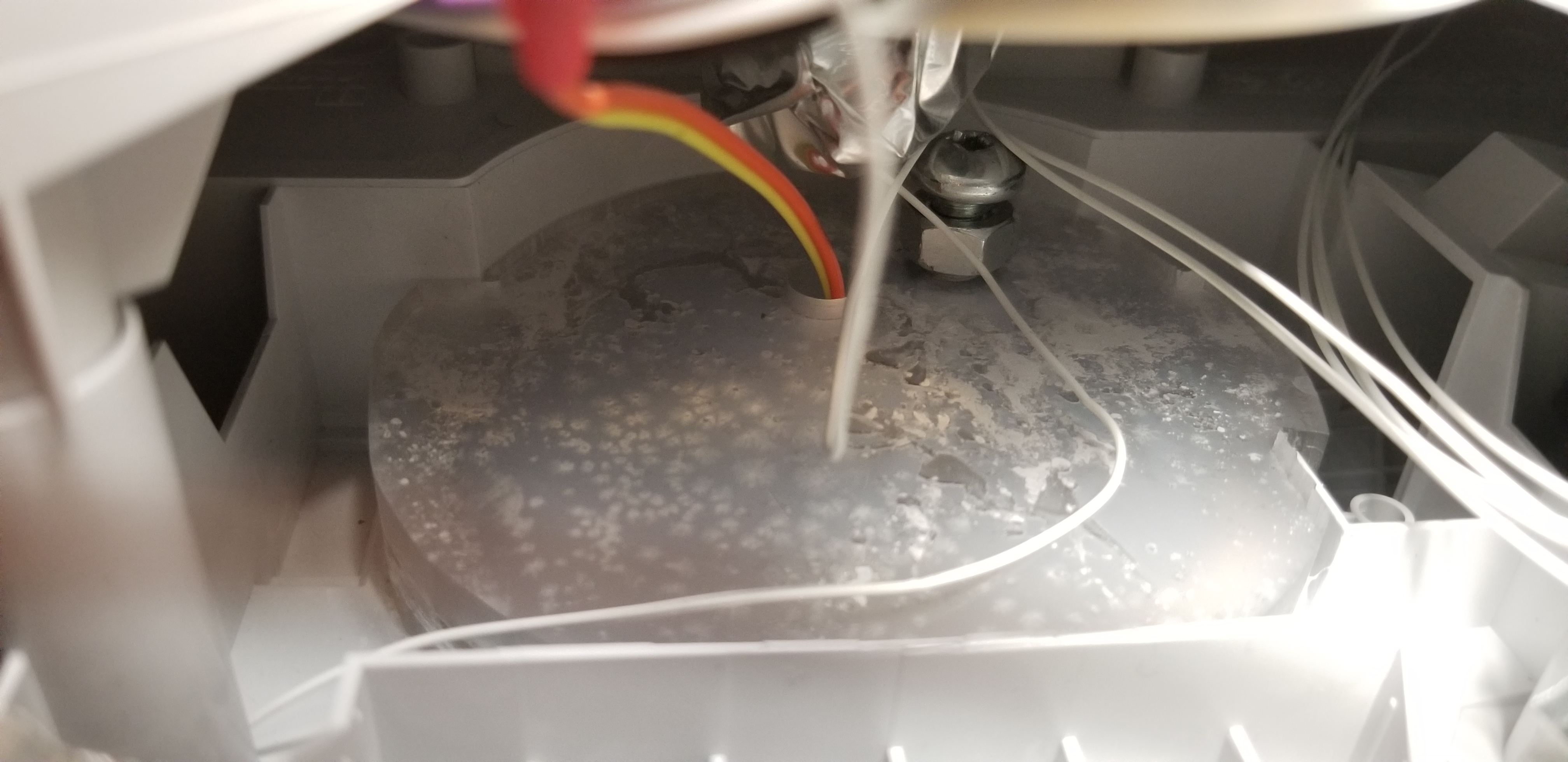

Basically what did was cut a template out of card paper that tightly fit inside the bottom half of the hull, it's kind of a circle with a couple of cut outs. I did this with the inside "hallway" part removed because I didn't want to use it. I traced the template onto a scrap piece of polycarbonate, cut it out on a bandsaw and sanded it to make a tight fit. Then I drilled a hole to the power cables and a hole for a 1/4 screw which I tapped out that lined up with the hole in the turret just off centre. It's a little tight for the screw to come through the window so I trimmed away the frame a tiny bit. The screw is locked in place with a nut on each side, the underside nut I countersunk into the PC to clear the frame. The part fit very tight but I super glued it in place just to be safe.
Hopefully these photos help with my explanation.
The bolt screws into a 1/4" threaded tube I found then that screws to the projector mount.

Thank you. Your explanation and photos are very clear and helpful.
