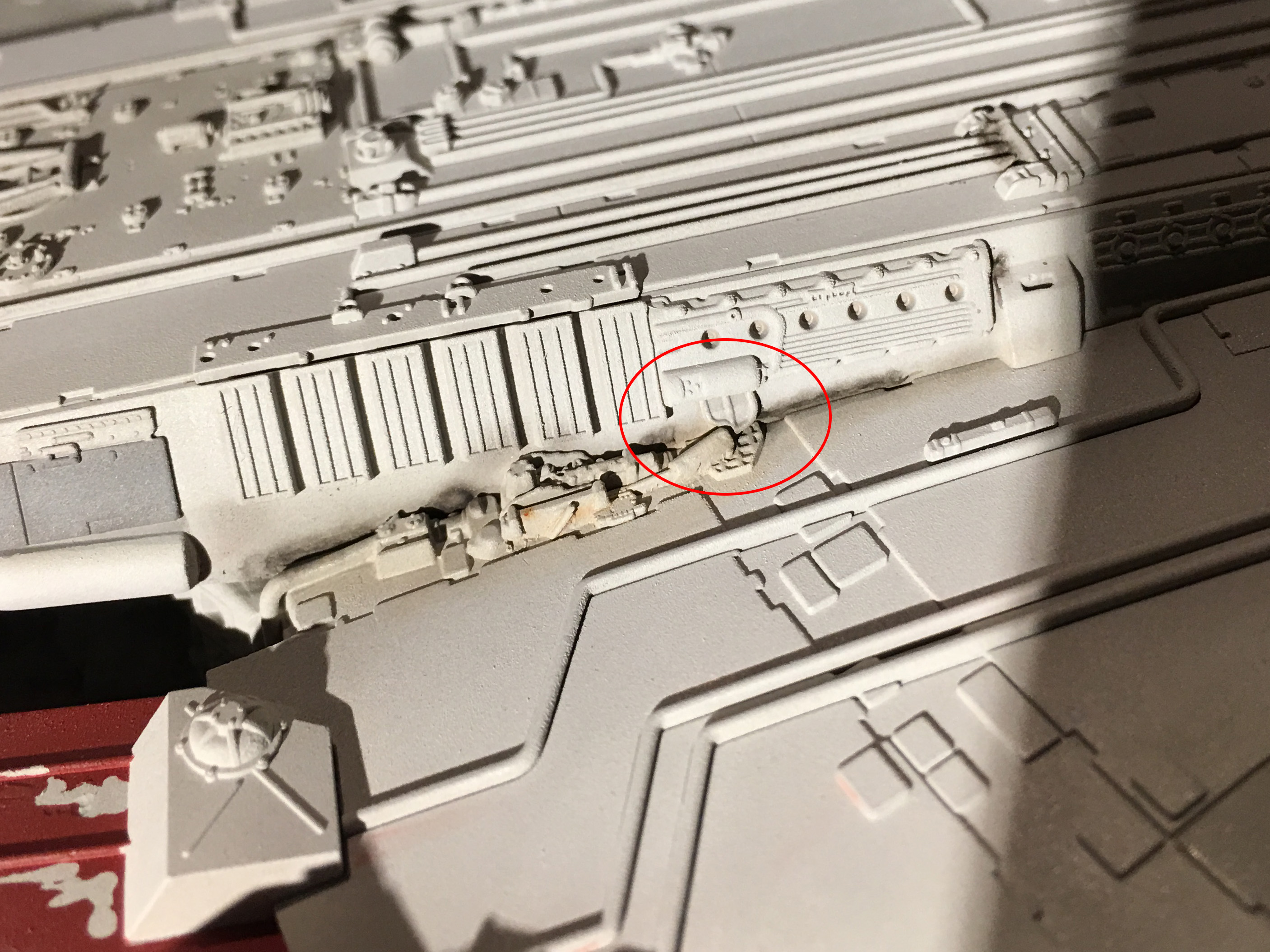

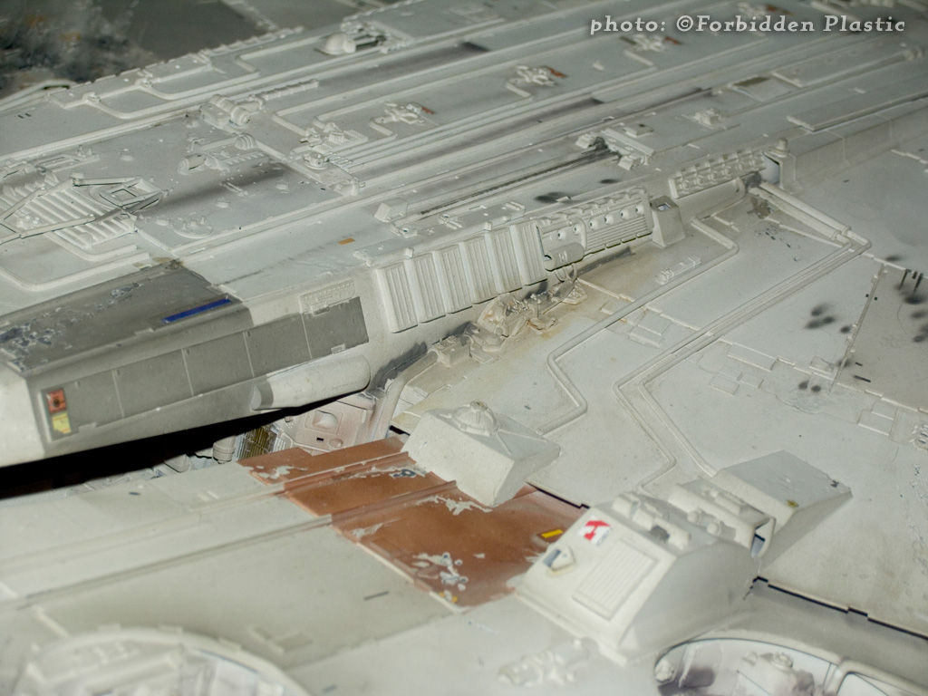

Looking at JoelSG's closeup of the jaws this jumped out:
I don't see this bit in the instructions but I do see it on the 5 footer. Did Bandai miss this part or am I overlooking something?

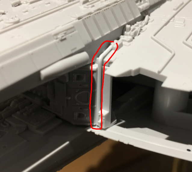

JoelSG
Ha, sorry for the confusion, it’s some styrene rod that I added. The 5 footer has a similar piece. The bandai version is molded partially into the “saucer”, and partially into the back of the mouth section. So there is a gap/seam in what should be a solid rod/pipe. I chiseled the bandai parts away, and after I had glued the top and bottom halves of the Falcon together, added the Evergreen plastic rod. There’s always room for improvements!
Hunk a Junk
Sweet Jebus! I never looked closely enough at that rod to realize it would look better replaced. And now I'm never NOT going to see that molded detail. So -- argh -- I'm going to have to see if I can replace it. Good catch, JoelSG!

It's hard to see at least...although just behind it is a sort of trident-looking part that's molded in like a solid block... I thought about chiseling it out and replacing it too but I was like "aw, I won't notice it"...but I still do...
3Dsf
There are a bunch of details which, as wonderful as Bandai’s work is, they chose to mould into the saucer surface or whatever. So it doesn’t quite look like the separate pieces used on the original model... I think subtly undercutting some of the joins with a knife is as far as I’ll go on most of these. :)
