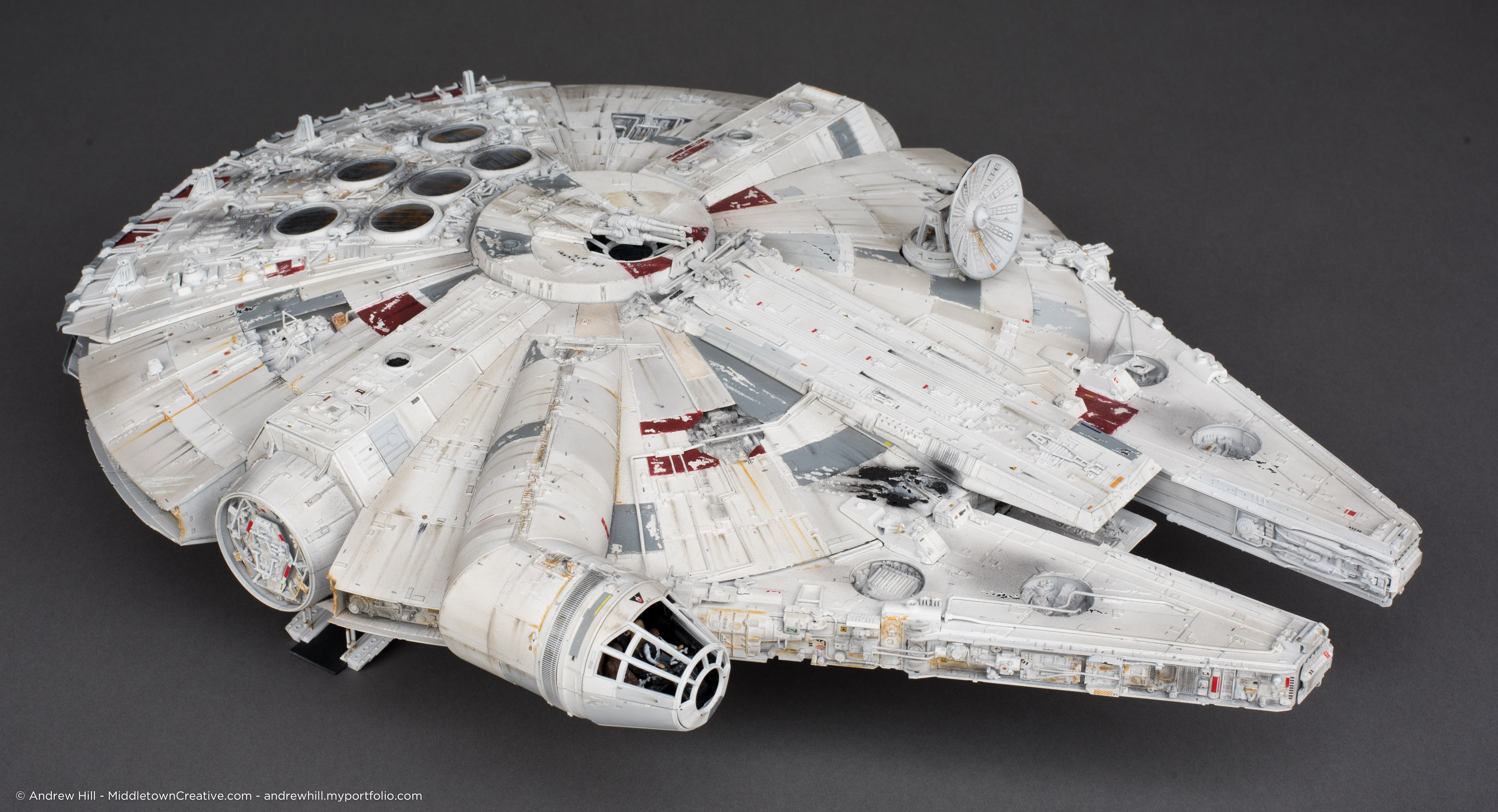

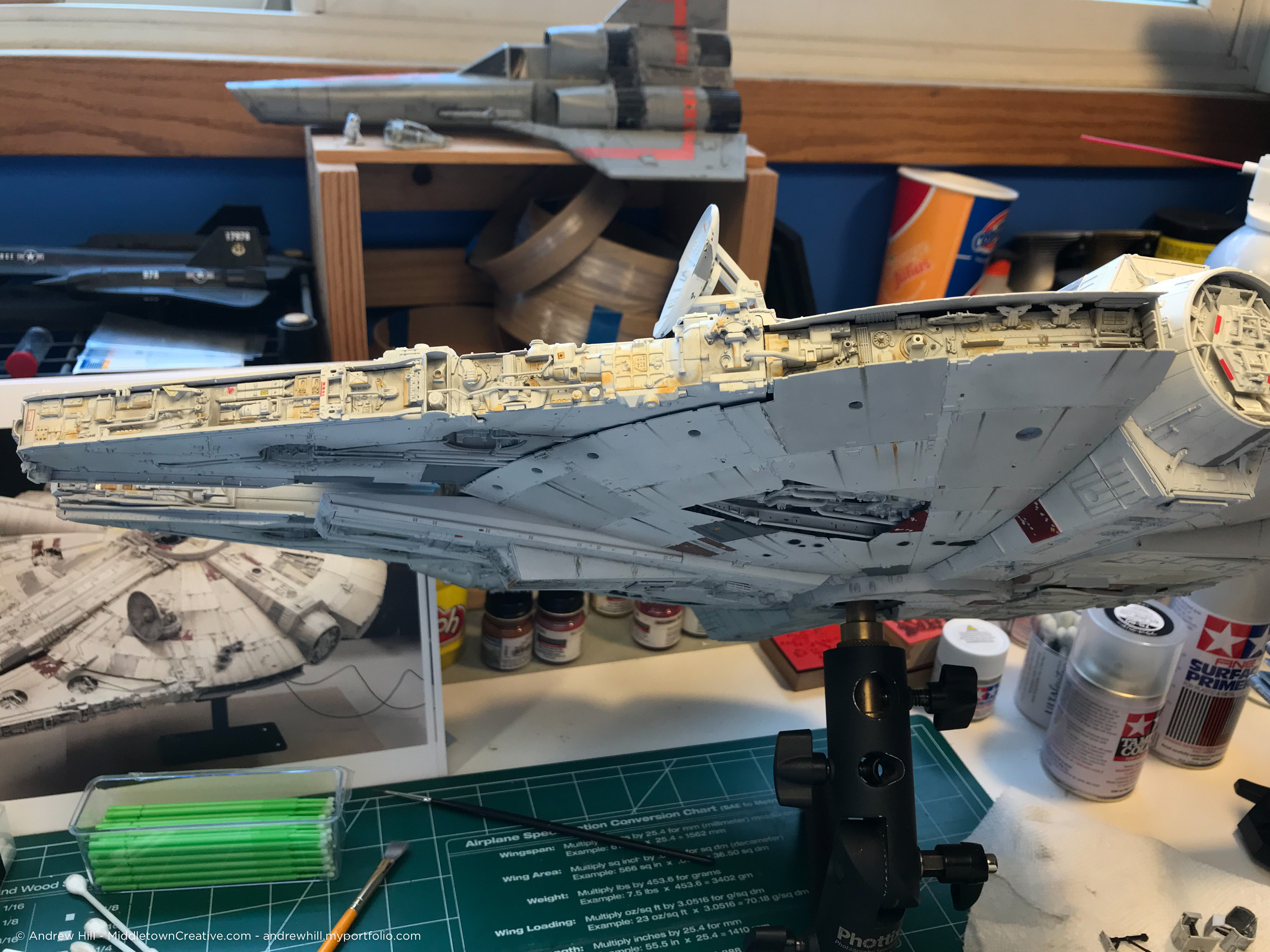

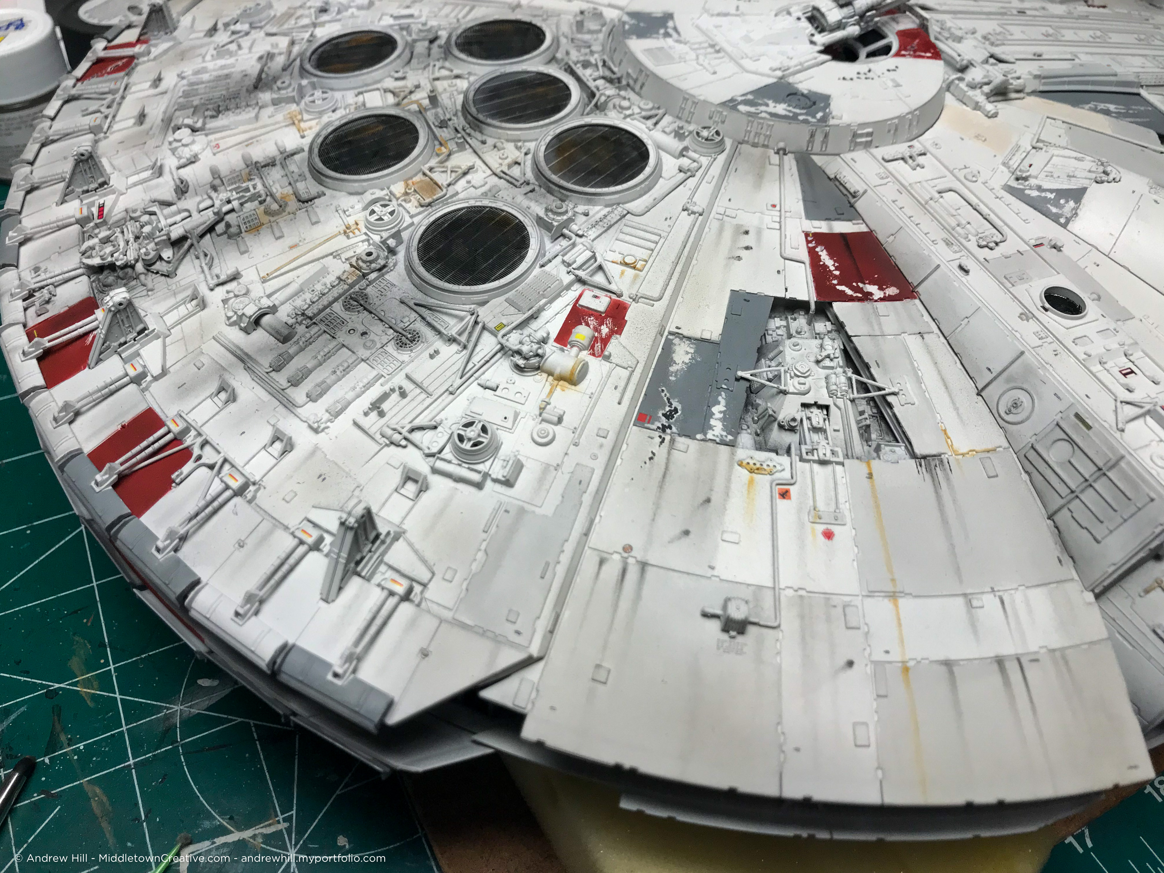

What colors are you using for your panels?
Red: MM Insignia Red with a little MM Rust and MM Gunmetal
Dark Gray: MM Neutral Gray
Darker Beige: MM Camouflage Gray
Light Gray : Tamiya XF2 flat white with a few drops of Tamiya XF69 NATO Black
Light Beige: Body base color (Tamiya XF2 mixed 10:1 with XF55 deck tan) with a little more deck tan added and something to warm it up slightly (I think it was a few drops of XF15 Flat Flesh... it’s what I had on hand at the time)
That Cream-looking color that‘s used in a few places: XF2 with some MM Sand
There’s a darker warm-gray-brown color used on the lower hull in a couple places I haven’t created yet.
Hope this vague-ness helps

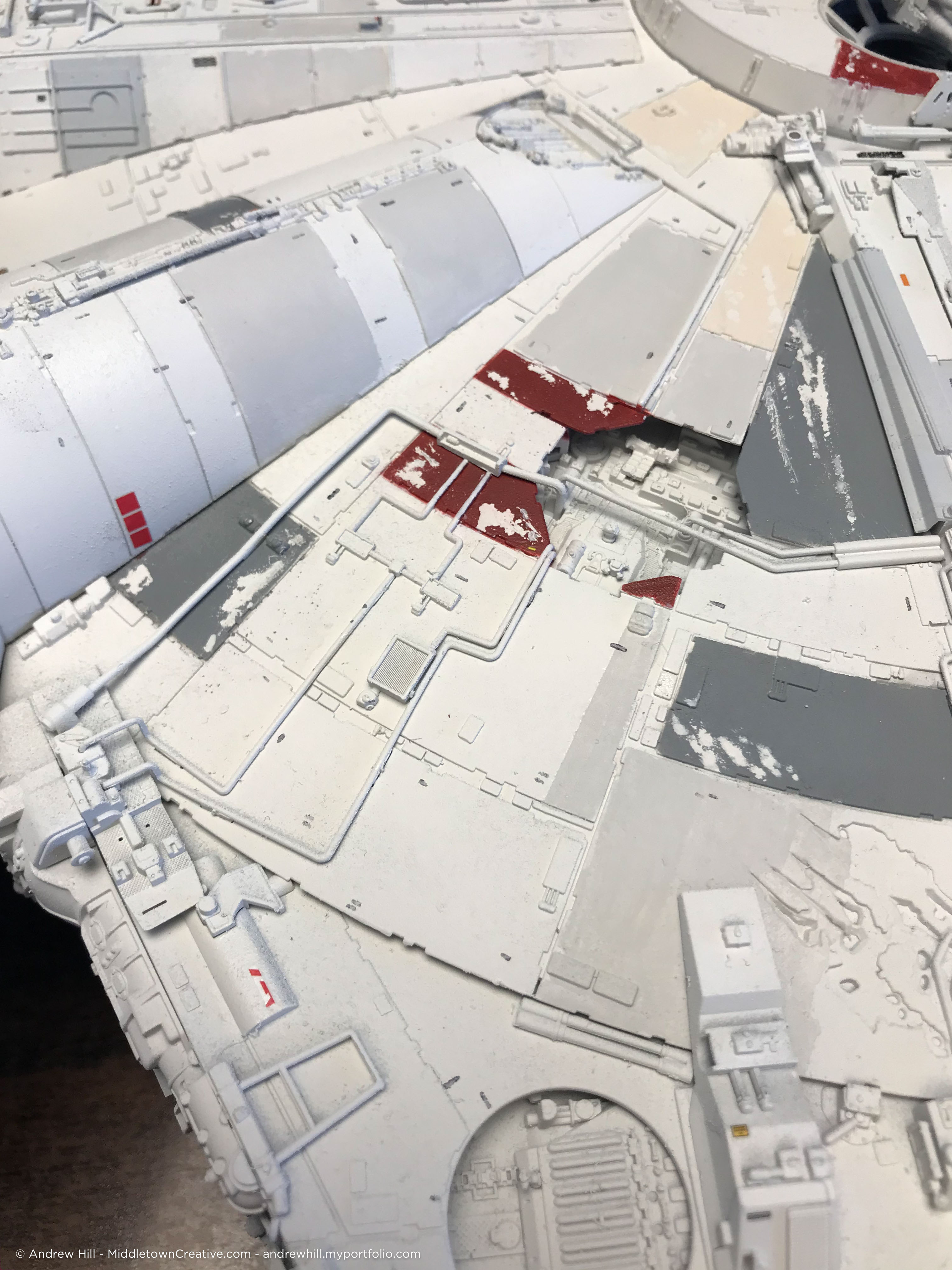

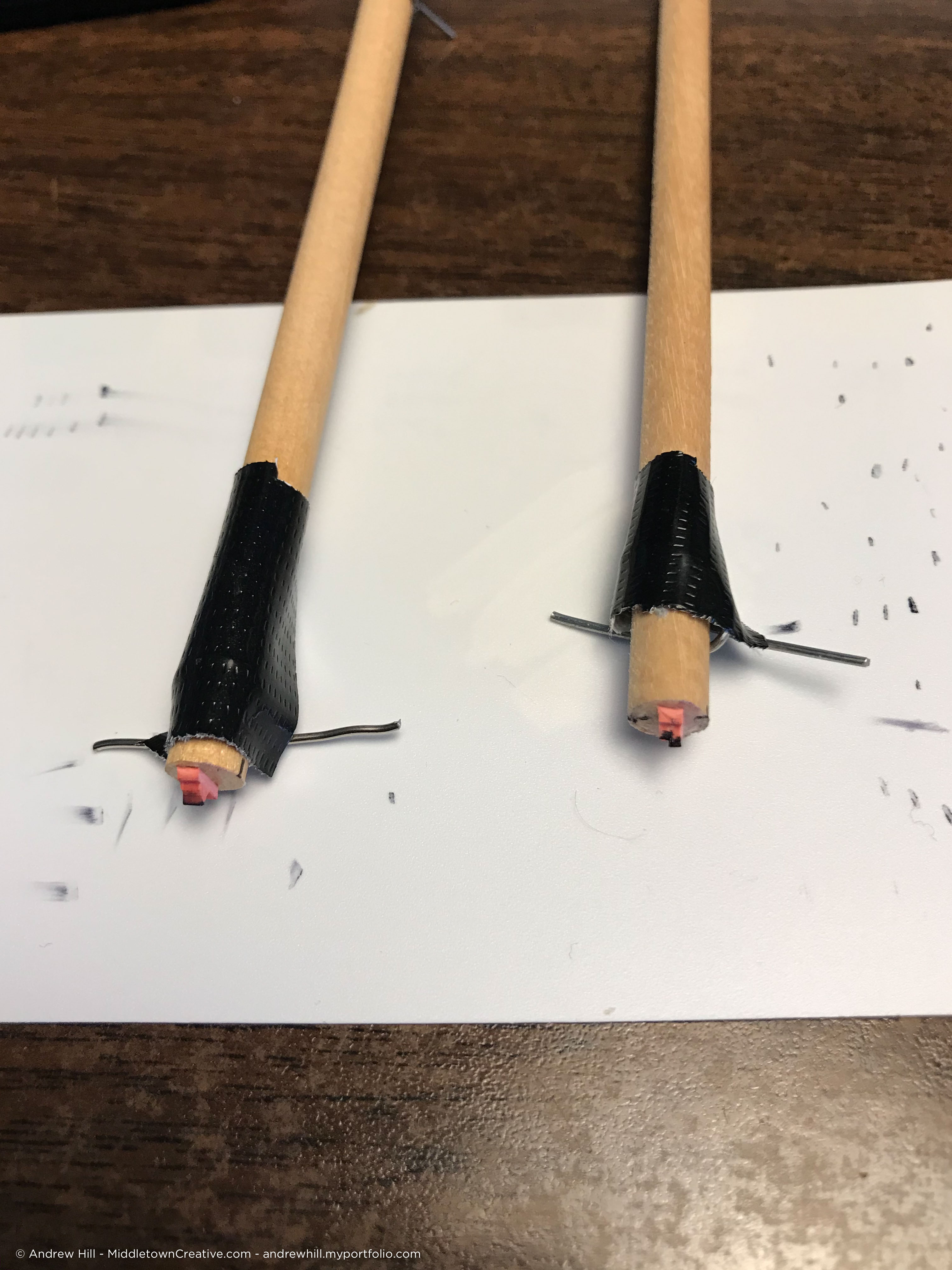

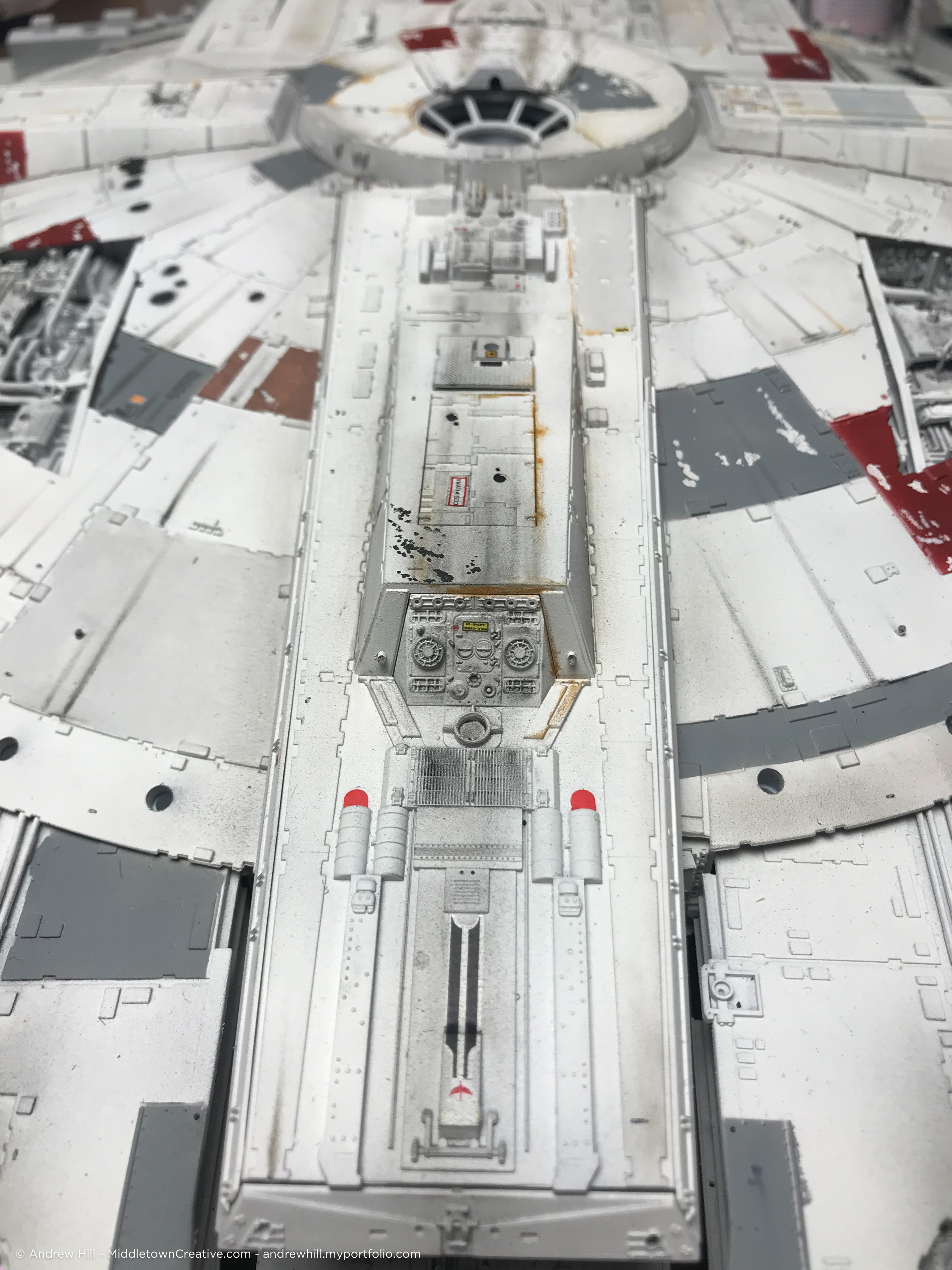

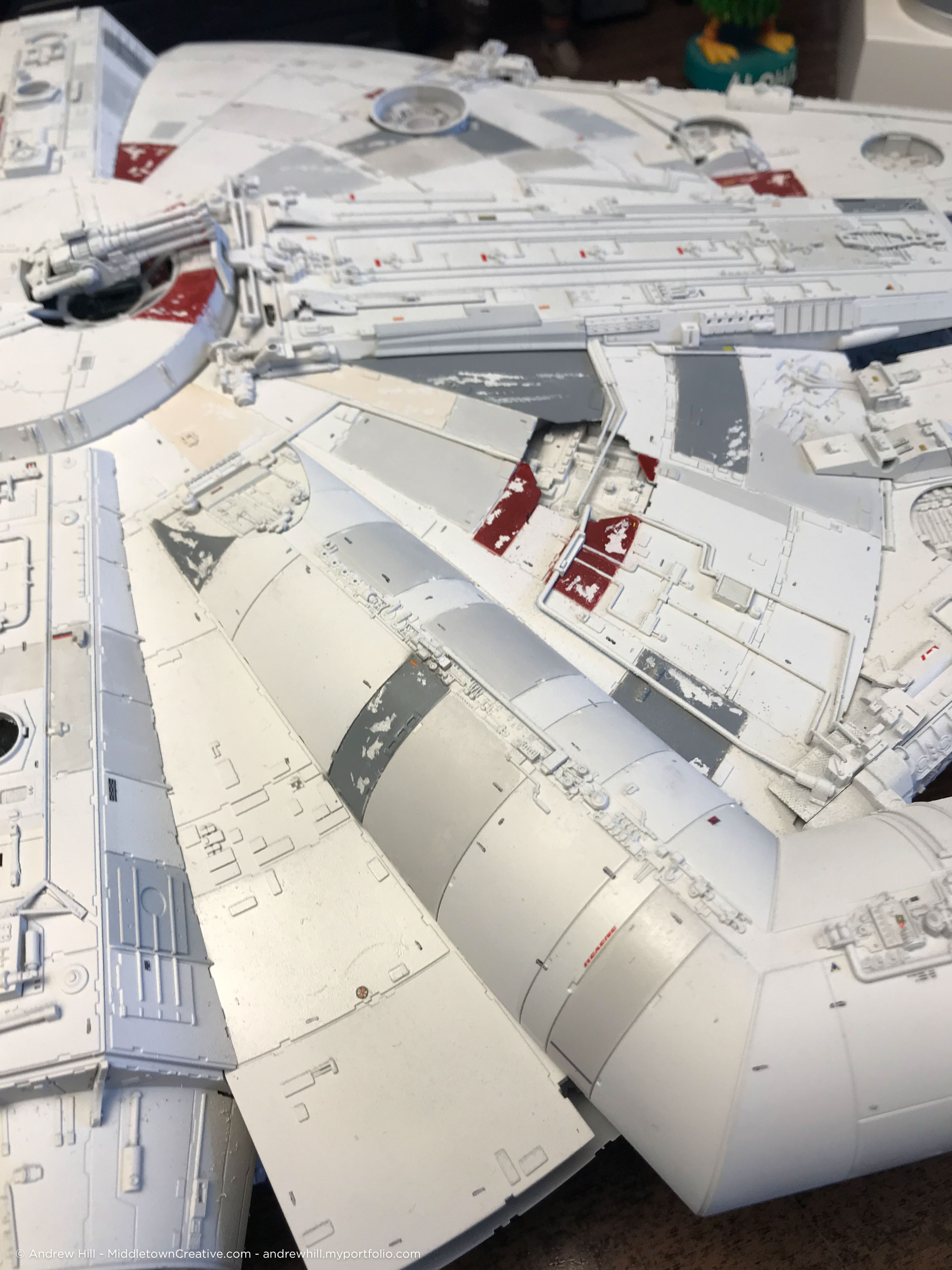

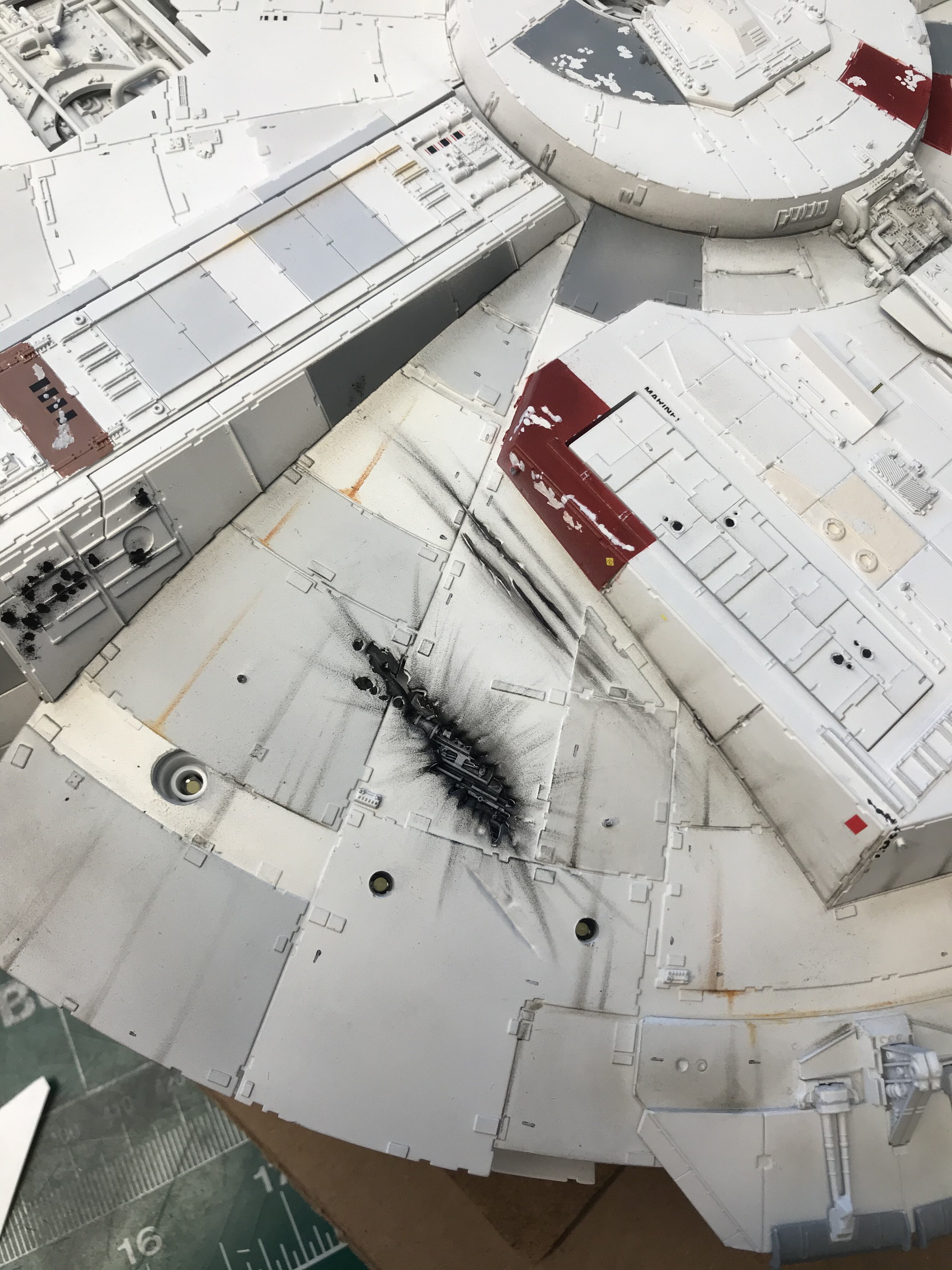

Now that the decals are done, I'm adding those damned little rectangles. Cut a piece out of one of my wife’s rubber stamps and cut it into two little lines. Glued to dowels and added paperclip guides to know what direction it’s going. Not trying to exactly duplicate the rectangle locations on the five footer, but used those reference photos as a guide.

Looking awesome so far! It makes me want to pull mine off the shelf and get to work on it.
And thanks for linking to the file for that mount! I want to mount mine on the wall but I have not really been able to find a good way, that will make it so much easier.
I am almost out of excuses now...

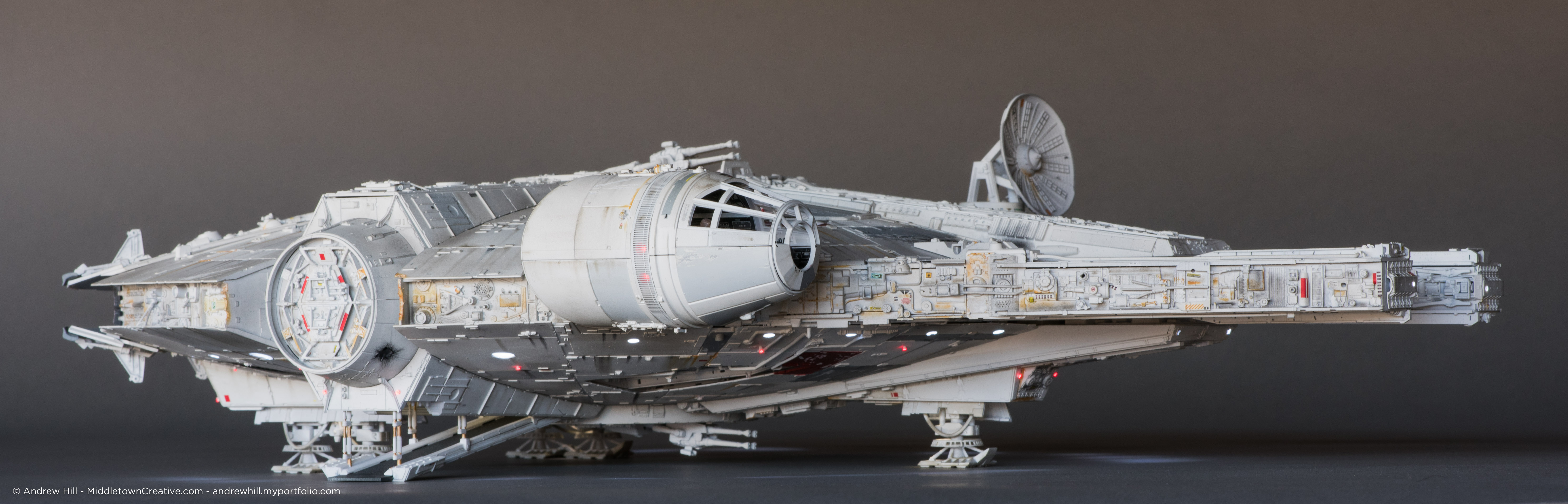

Don't know if this will help,..I created this for a decal set in 2015. Cool idea though for coming up with the stamp technique. Beats decals any day.

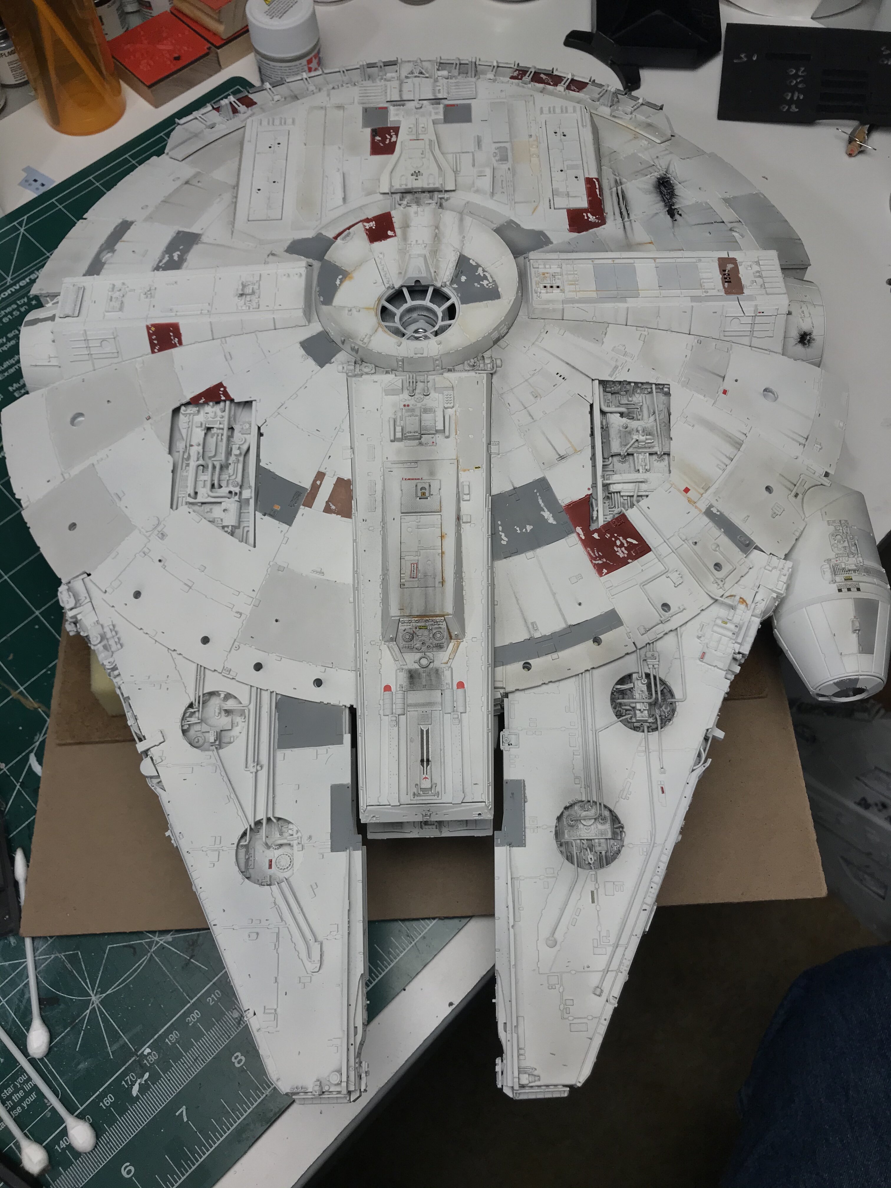

I'm really happy with the stamp technique, since I wasn't going for exact size/placement for the rectangles. Just wanted to remain true to the sprit and the idea of adding that little detail without resorting to spending hours getting every one positioned perfectly.
Depends on whether you're going for an ANH Falcon or ESB/later Falcon. :)
And mine is definitely a blend of the two :) Didn't want to go to the trouble of adding the front two landing gear boxes, but I wasn't spending this much on a model to build it without adding those landing and running lights...

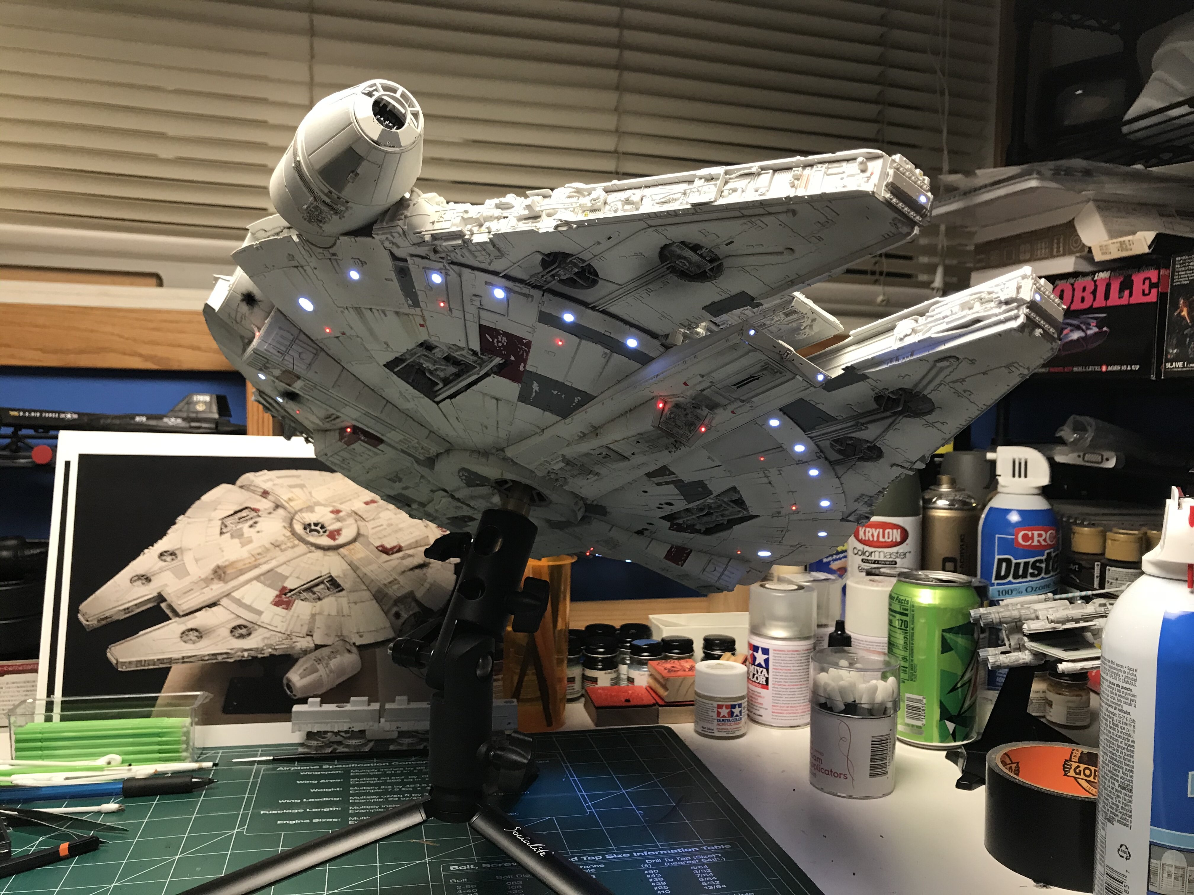

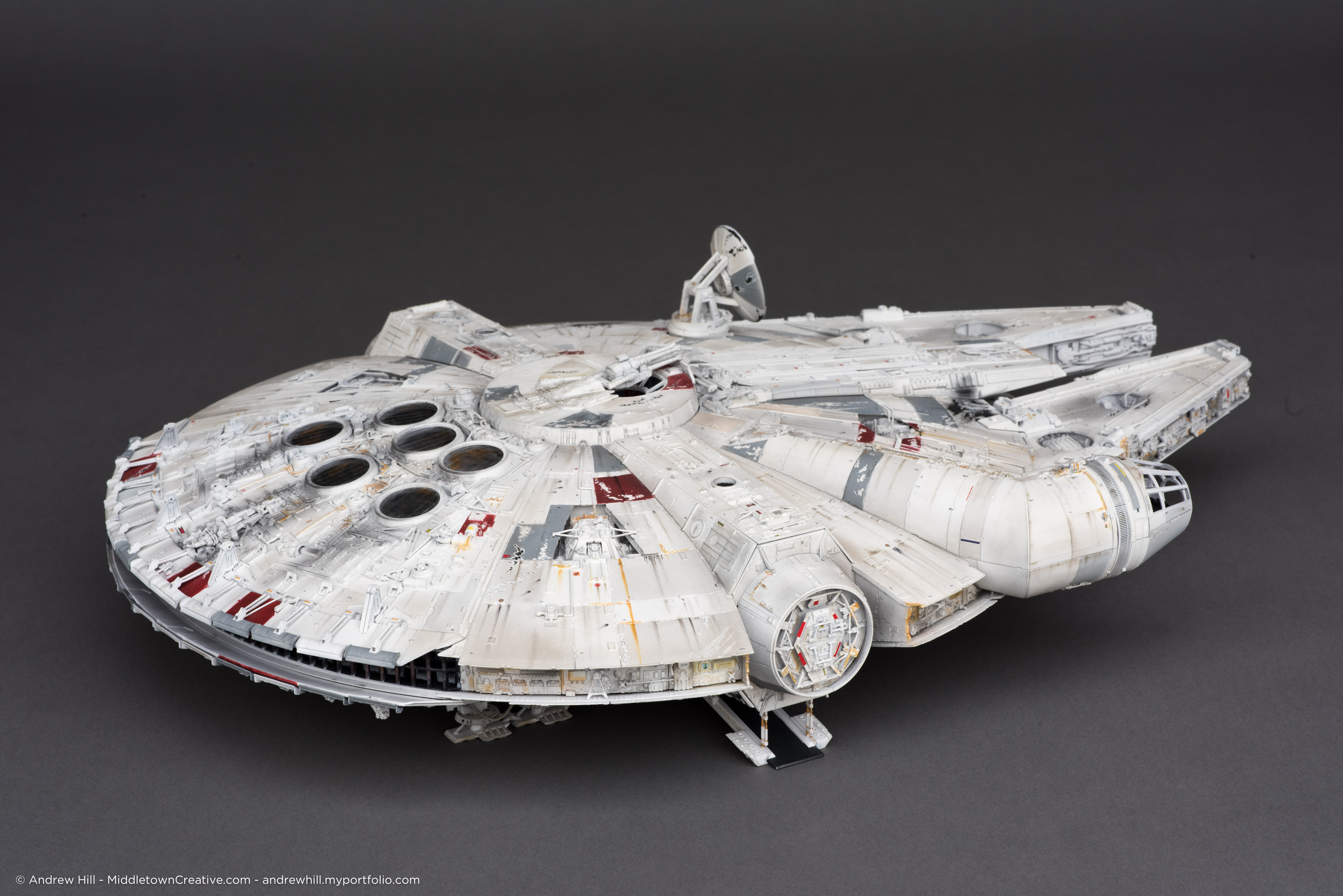

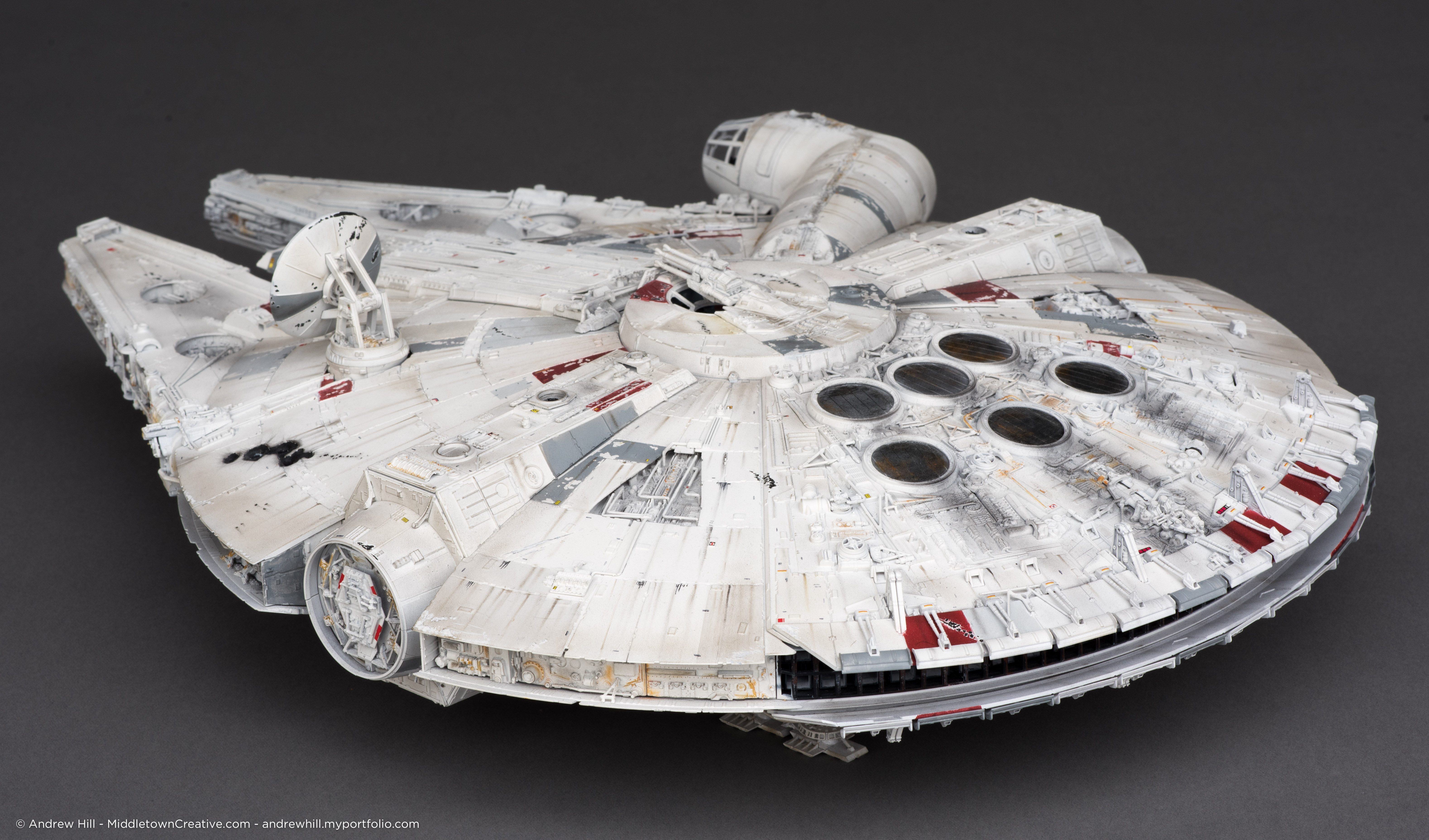

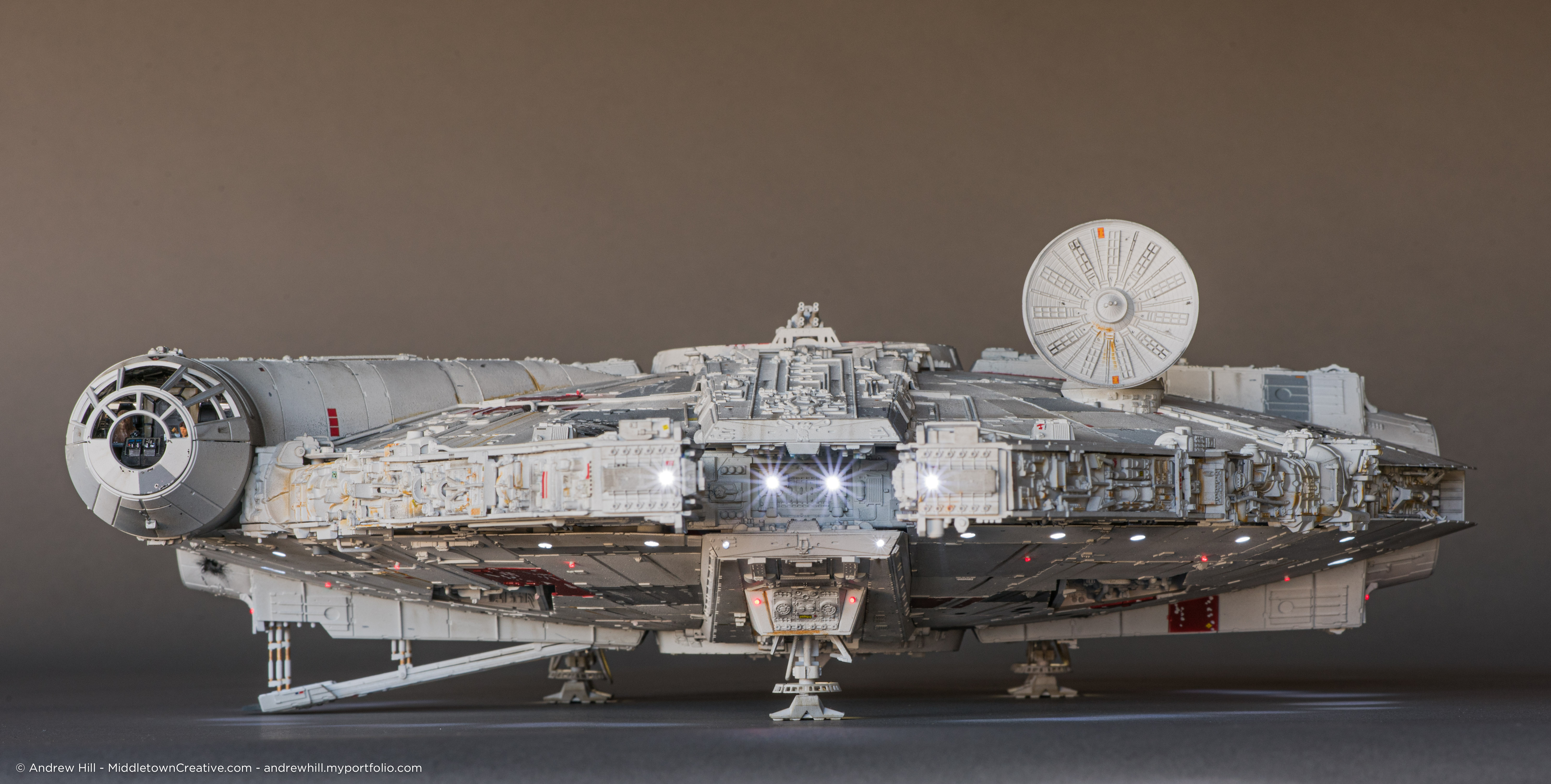

Think I'm gonna call it done. I mean, I'll likely find little things to fix (still might attempt to add magnets to the back access panel) but I'm very happy with how this thing came out. Now, I need to borrow a smoke machine to try some more photos. And build a base for it. And...
Does anyone have Arduino code for the engines? I am looking to replace the stock lights with LEDs and arduino to pulse.
