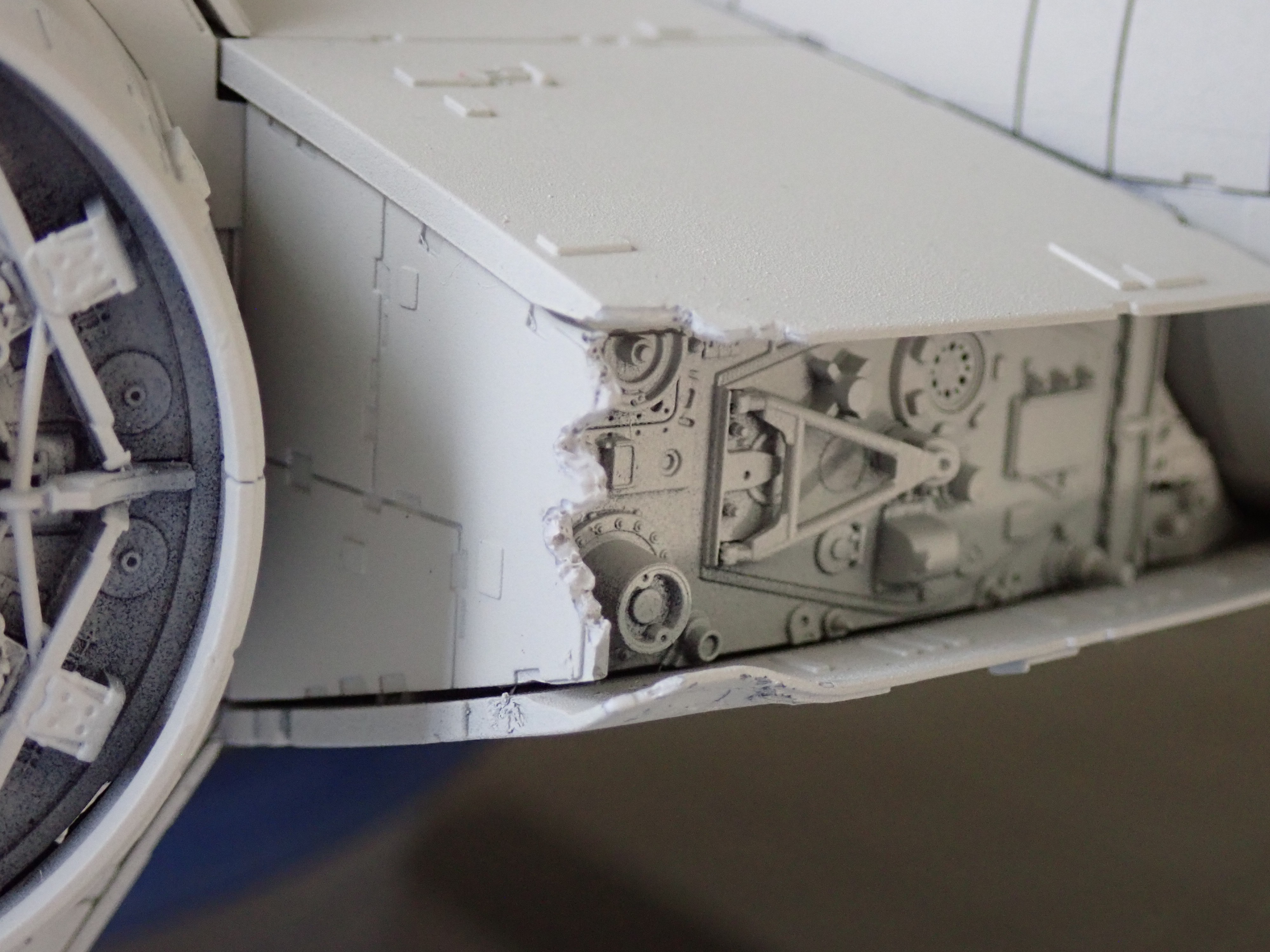

Annnnnd while we are on the subject of updates.....after the Falcon was assembled with the primer and base coat applied, I then decide I wanted to replicate the perimeter damage. Of course, it could be done after painting but in hind sight, if you are considering this, please do it before prime and paint. And when it comes to the underside of the cockpit, do it before you assemble the cockpit...more later.
Honestly, I contemplated this earlier but had decided then that I didn't want to tackle this. Well, as things go, I changed my mind....you can see how I did it here on Part 10 of my build series.
In short, after researching this a bit more (sorry I forgot who came up with this idea first) I decided to use the soldering iron method. What this entails is bringing a hot iron close (but no touching) to the panel while using non-serrated pliers to slowly bend and manipulate the panel as desired. I'd be lying if I told you this didn't cause some anxiety but at the end, it was pretty straightforward...... be patient, do not rush, and stay focused on where the hot iron is at all times. Note, I used this process for everything except the underside of the cockpit. More on that later.
Tools I used were: a soldering iron with adjustable temperature settings (mine were set between 550-600°F), jewelers pliers (round tips), regular needle-nose pliers without serrations, xacto knife, tweezers, sprue cutters, med paint brush, pencil.
Finished photos....port side, fore of docking ring

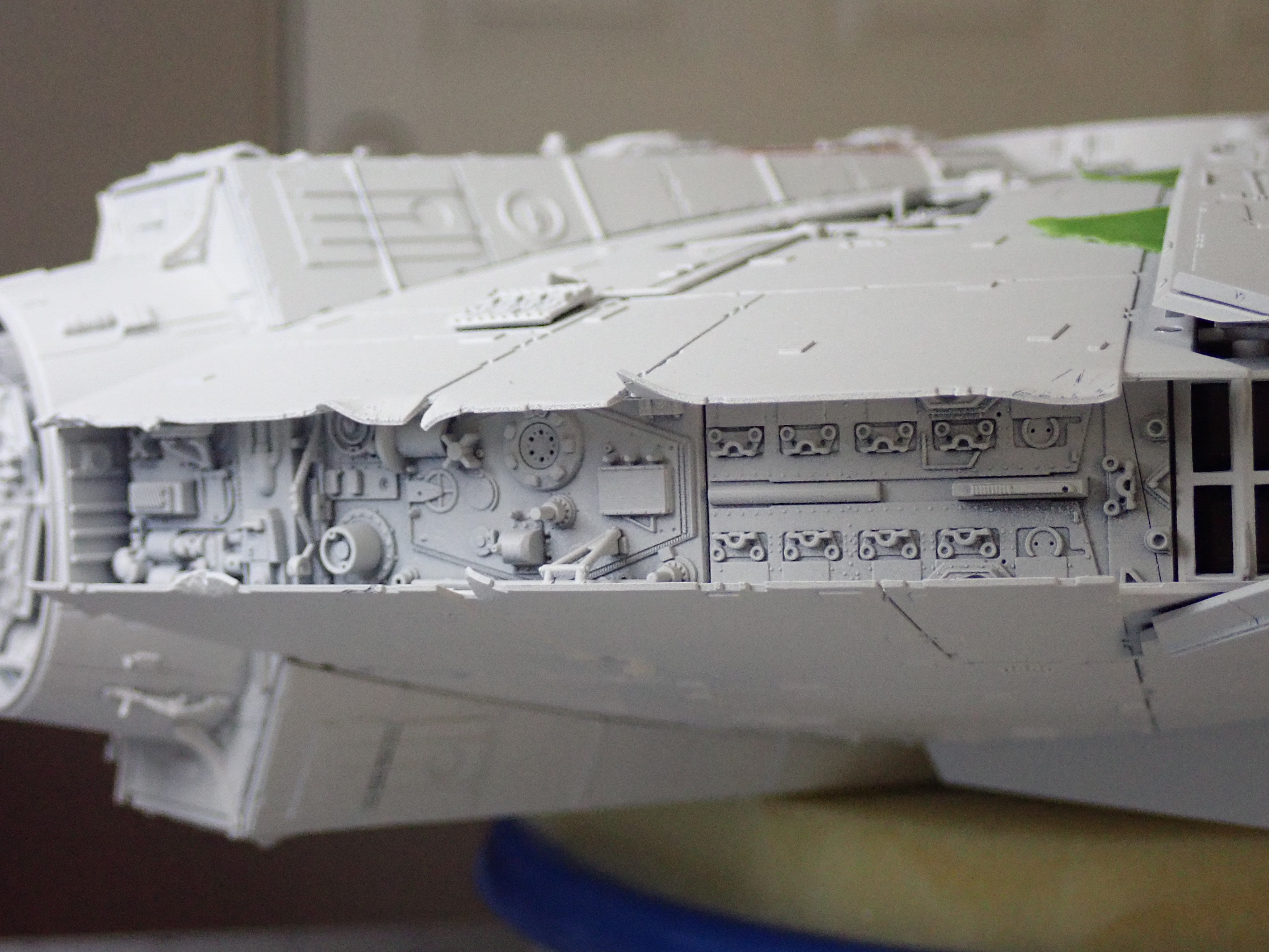

Port side, aft of docking ring
