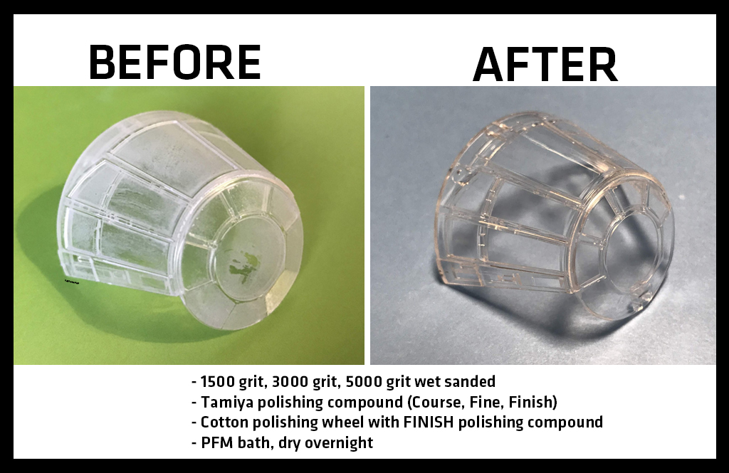

Used the clear plastic canopy as the paint mask on my 1/72 PG Falcon build, thinking I could just strip the layers of paint with oven cleaner later and that would be that. Well, turns out it took a bit more work to get it back to 100%. Pretty happy with how it turned out.
