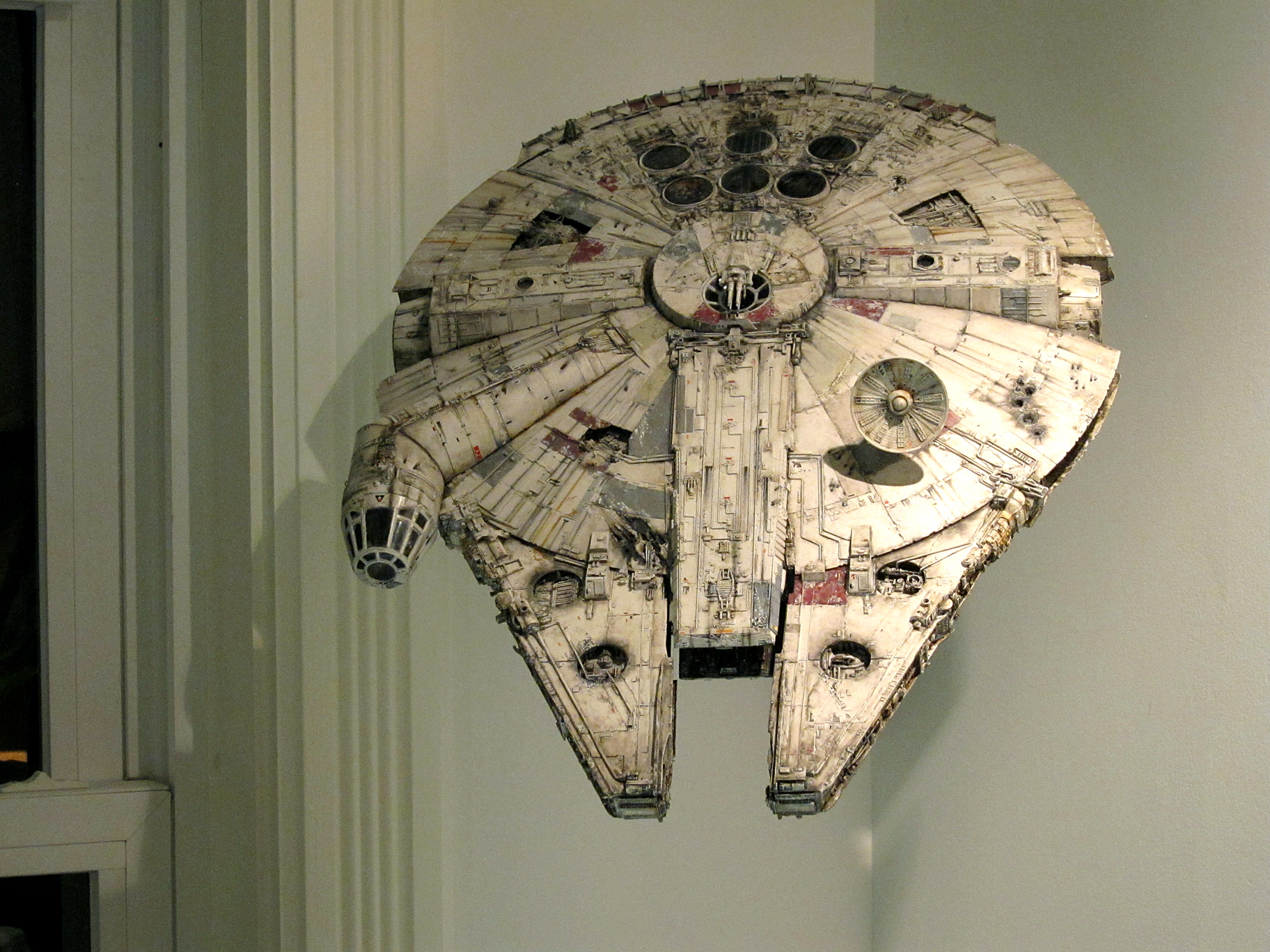

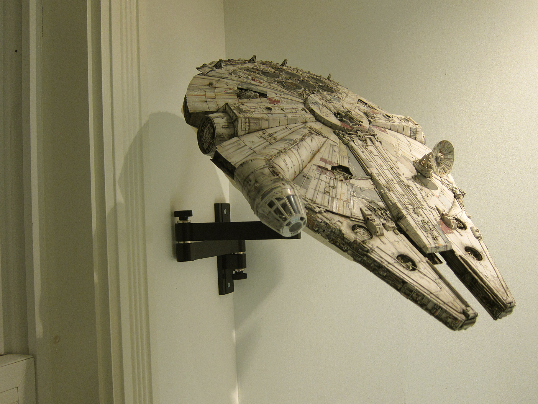

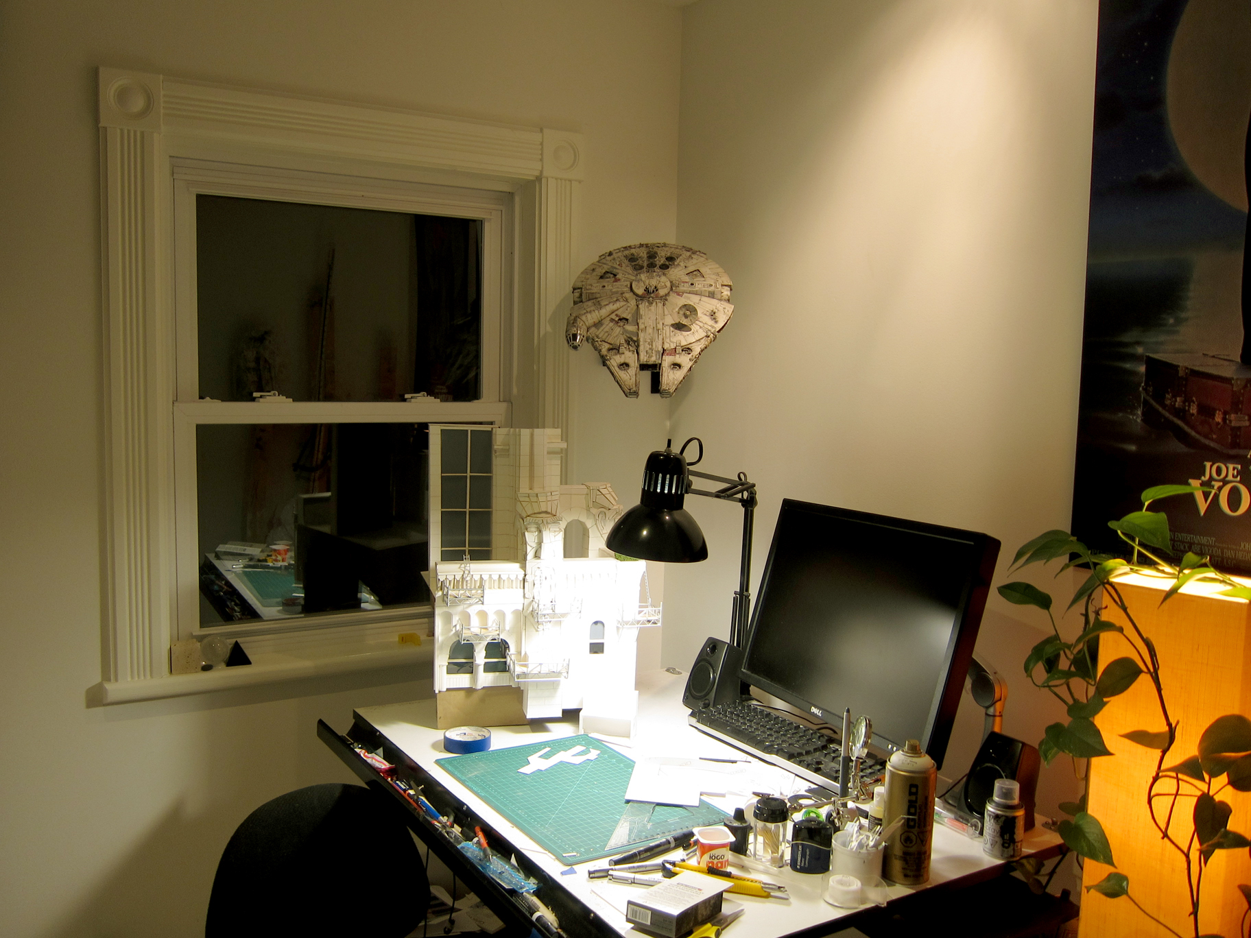

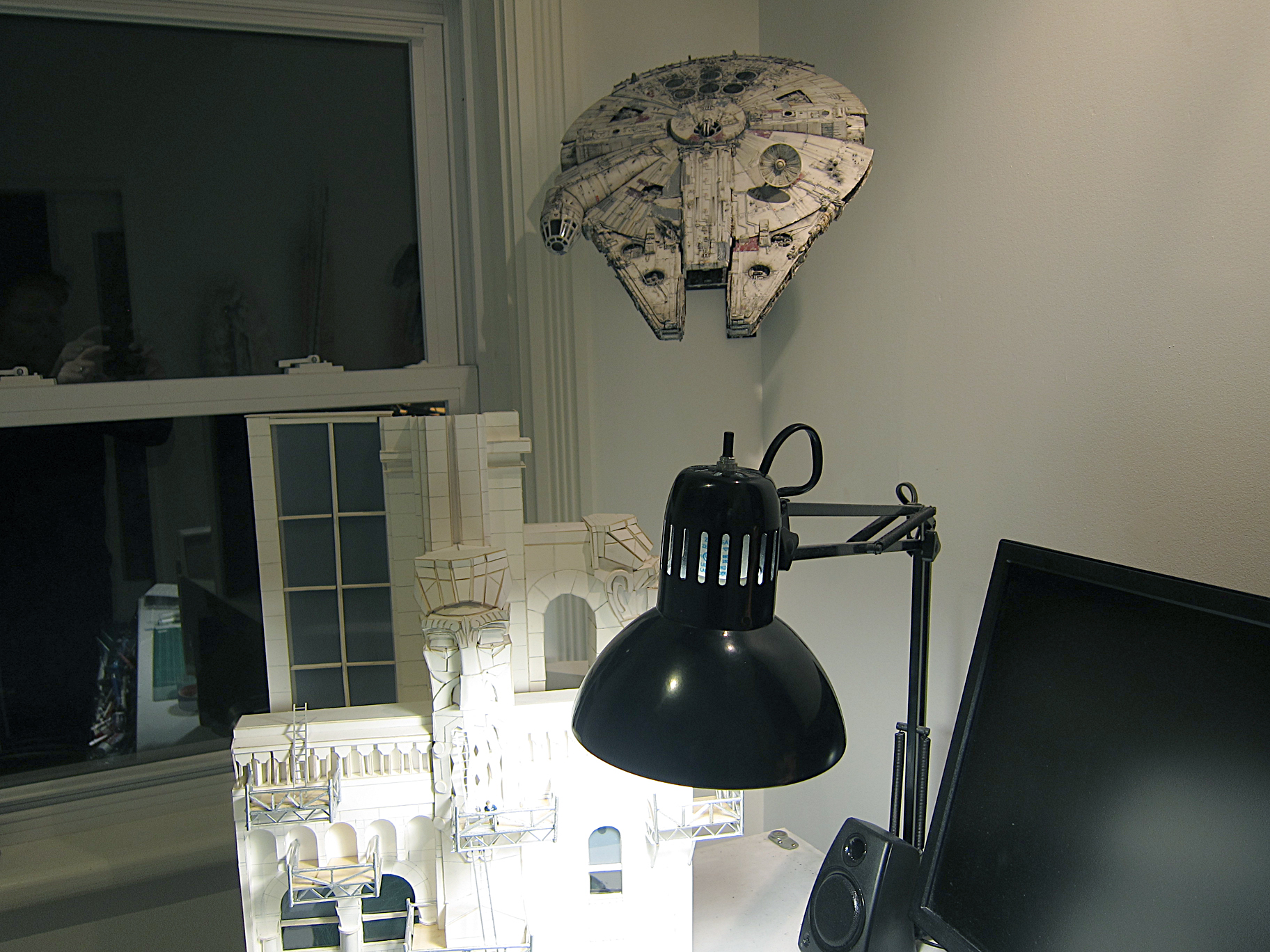

when I was a kid I used to see Falcon models hanging from the ceiling of hobby shops, I have a small little home office and considered doing
that, but didn't want to get into hooks in the ceiling and risking fishing-line to hang it, PLUS the top part is what I wanted to see, so I bought a mini LCD monitor wall mount, and built a custom wooden platform, worked perfectly..and I've angled it so I can see the top...suspended, but suggesting it's heading downwards, 'evading the Empire'
Now I think that is just cool as ****!(y)
