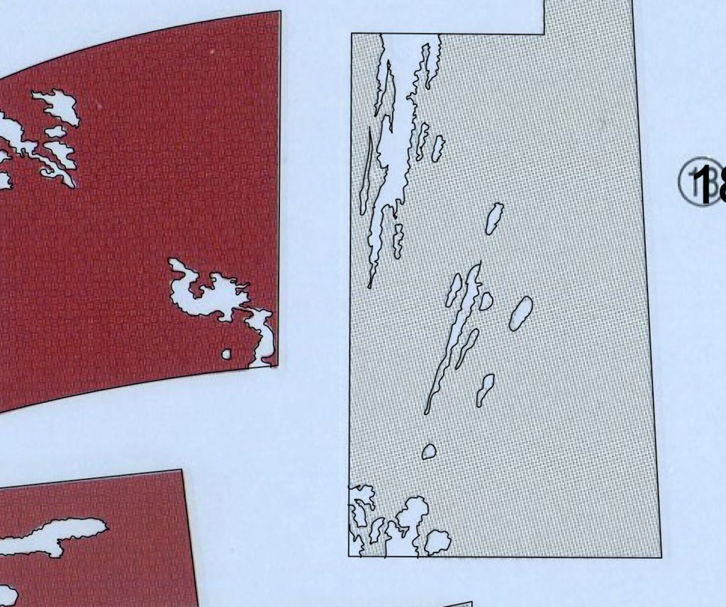

And I wondered how well such an idea would work in place of Bandai's decals. My focus was specifically the battle damage and areas where the paint was chipped or weathering applied to the colored panels.

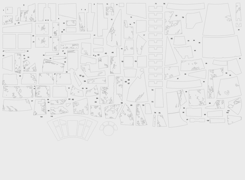

I scanned the decal sheet and manually re-created all of the features for the panels.

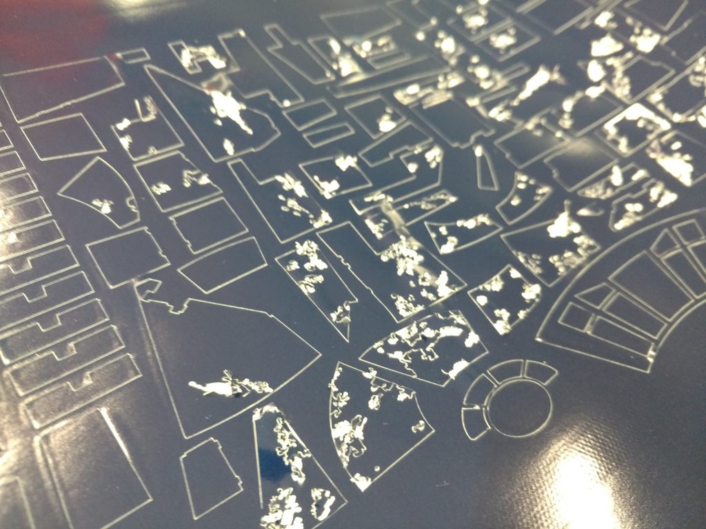

Then I went to my local maker space shop and tried their vinyl cutter. My results were less than... well...
I tried a few things and chewed up most of a roll of vinyl.
So anyway. Live and learn. Maybe I'll try just the damage parts and laser cut an airbrushing stencil.
In the meantime I'll give the SVG to anyone who PMs me.
I was impressed.
Fortunately it's not my cutter. We have a local maker space with some decent fabricating equipment.
In fairness I was trying to cut some ridiculously small stickers. You never know if you don't try.

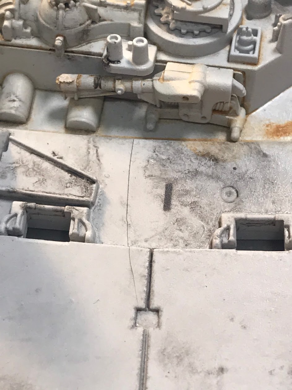

So I did another thing.
This gave me a bunch of nice masking tools I can use. I also might go back with some vinyl on a sturdy backing and try this again with the laser.

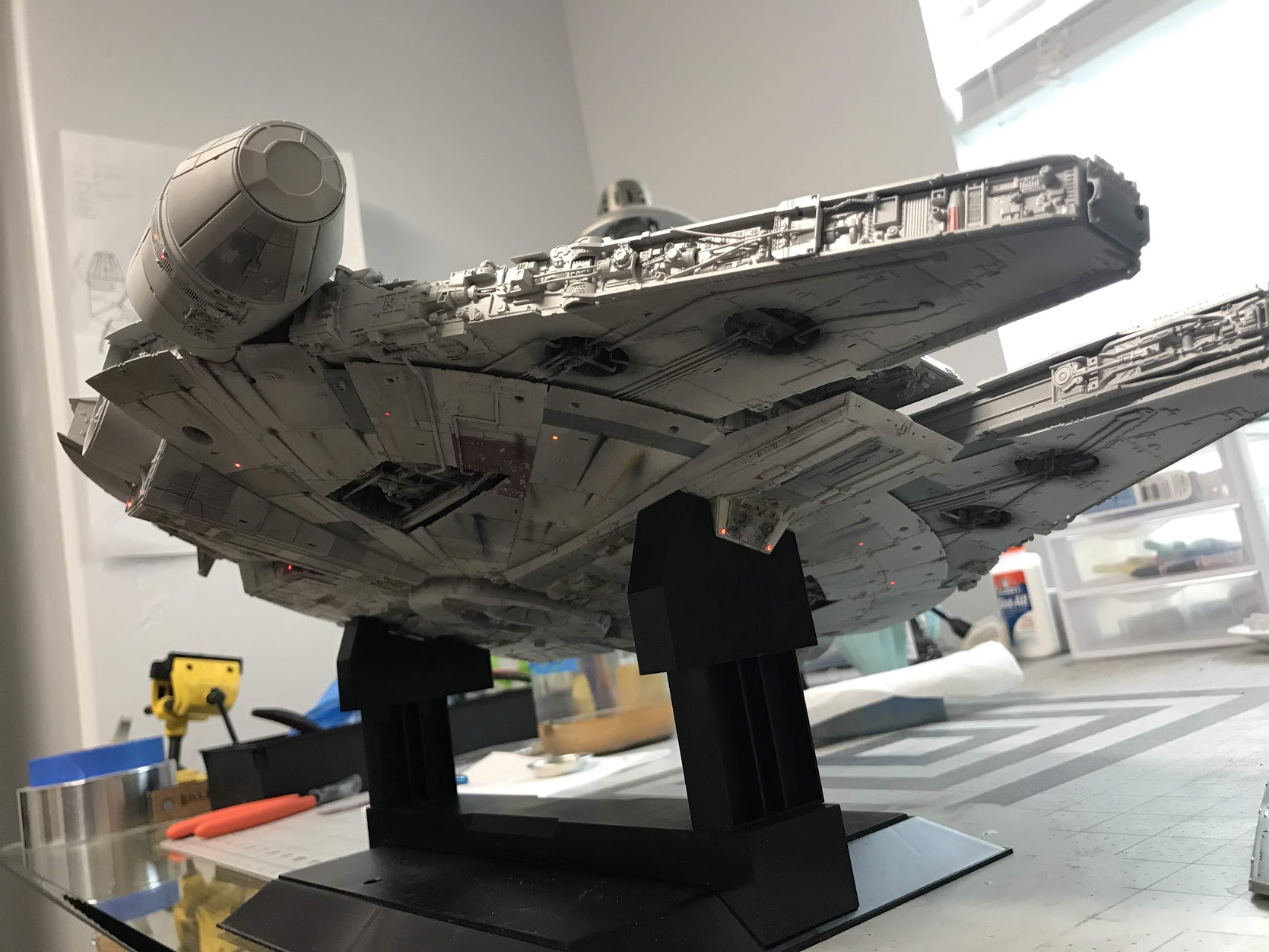

I just wired mine the way I wanted it. I added more gear well lights, 3 for each rear and two for each front. Then of course the landing lights, did my own engine lighting. I wanted a dull blue glow to simulate a just landed or preparing for take off. I put 11 LED's in the ramp ceiling so it would really pop. I built mine ESB with Shapeways parts, etc. Last count I have 64 LED's in this thing and bundles of .25mm fiber optic, as well as some .50 and .75. I'm getting close to being done. It's been challenging but a super fun kit to build(y) I'll probably use the lighting portion for something else...an MPC build or something. I hardly ever toss anything out:lol:
Rather than post a bunch of stuff here, my Echo Base Diorama thread, like the last 5 pages is where mine is if you wanna have a look
