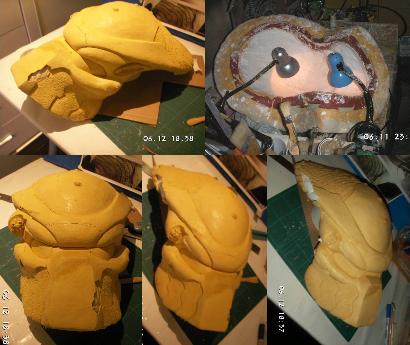

Update: Took off the top crappy mold, cleaned it and tonight will be re molding in the new molding plaster. Wish me luck! later
Finished remolding the top mold. Looks good so far. Defit need a bigger table space. Now need to wait another week. While I'm waiting I will be working on my Iron Man Mark 1 Face plate. Peace! :unsure:

Update: Demolded the top case mold, its holding together, not as thick as I thought but still strong. Not so heavy just very big. I drilled air holes along the keys and concaved areas for air to escape..

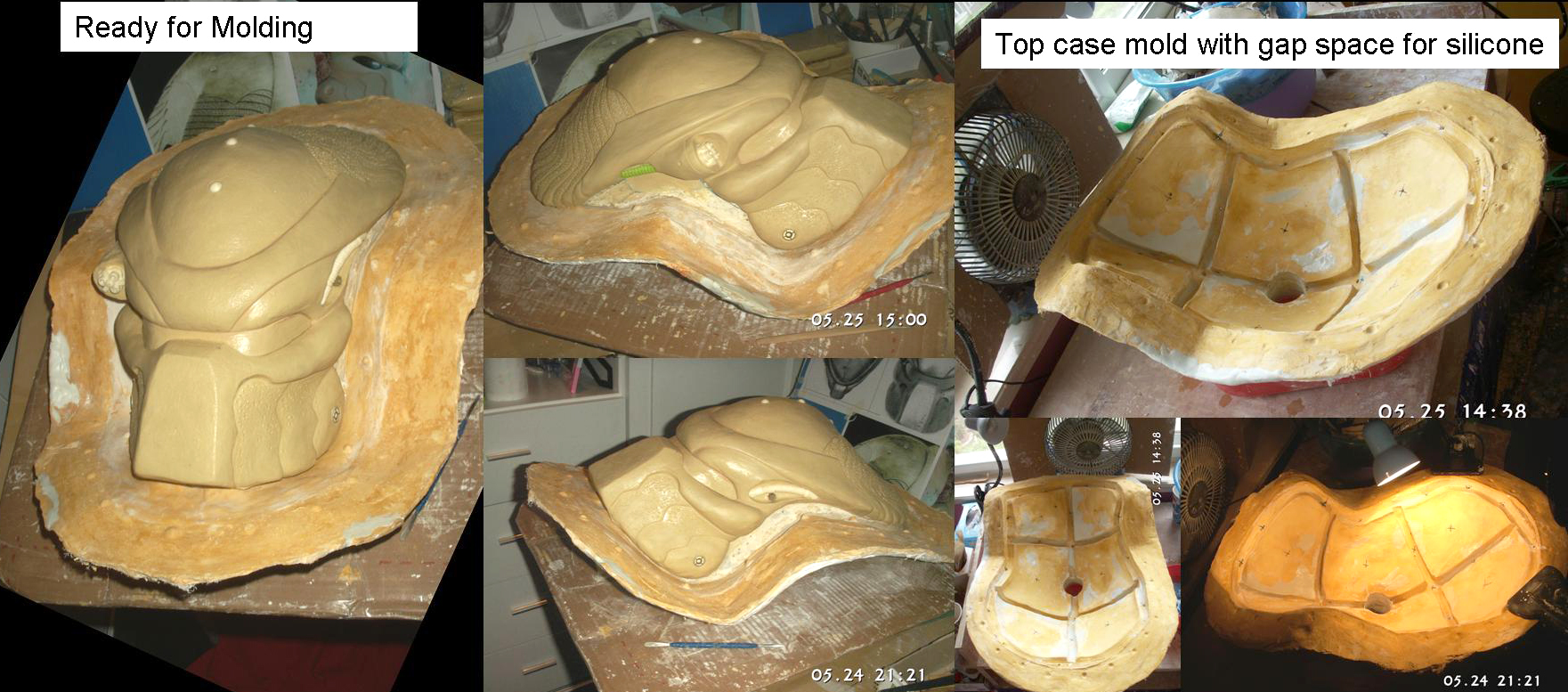

Pictures below: Top case mold with air holes drilled and Predator sculpt sitting on the bottom case mold. Ready for silicone pouring.

The top and bottom case mold is holding together except for the edges which cracked a bit during demolding, I still made it too thin and should be min 1 inch (2.5cm-3cm) thick. I'll have to reinforce it with more epoxy putty. I also have to make keys on the side edge of the silicone so that it can jsut stretch apart during the casting stage.

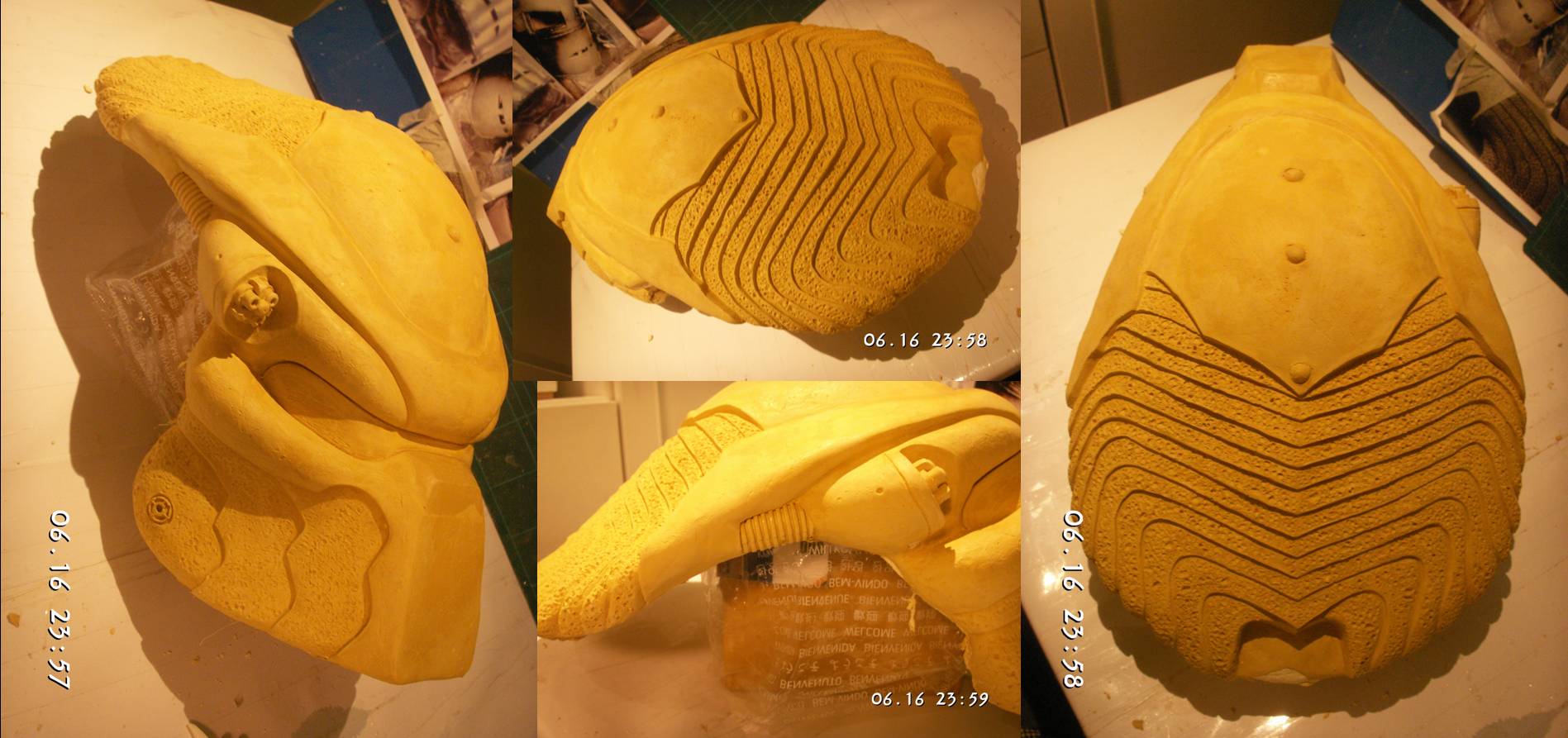

Sorry for the lack of update on this molding. I'm actually test molding my Iron Monger faceplate in plaster to make sure demolding is ok, so a lot of time invested on testing the case mold so i don't waste any resin. I split the mold in half and built a jacket to hold the split molds together while casting.
I will also test mold the predator helmet in plaster first to see if I need to split case molds. The idea is that the helmet is a thin fragile cast & the silicone mold must be gently peeled off the mold and not ripped out directly from the case mold which may damage both the rubber mold and cast. So the mother mold should be split in half but can be held together with an external jacket during casting stage. Seems like a lot of trouble but this way I can do multiple casts by preventing damage to the rubber and case molds.
Picts below of the Plaster Casted
