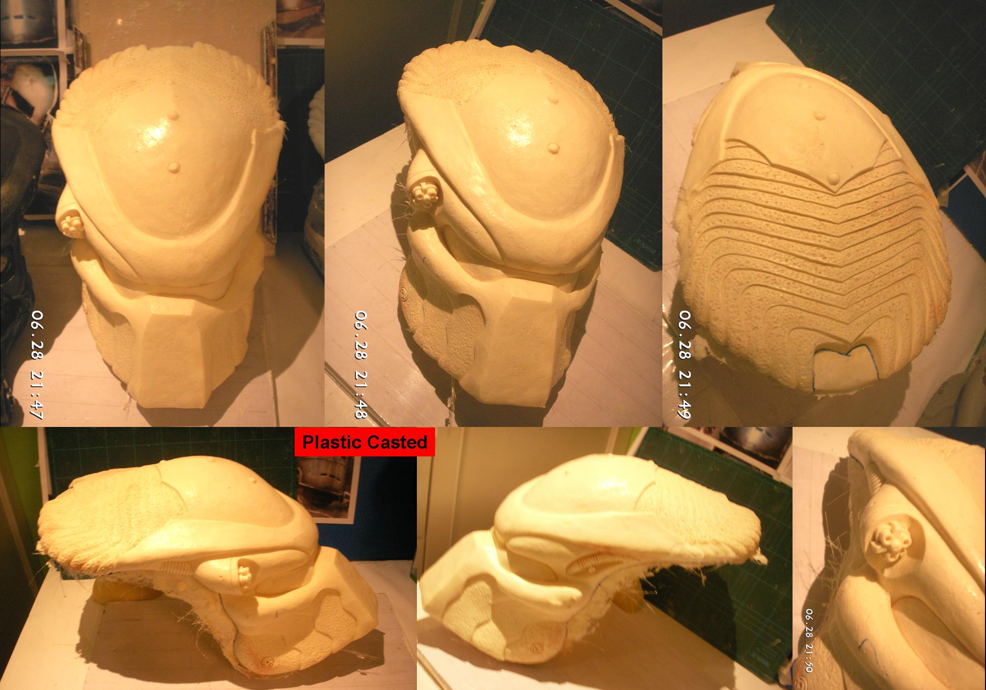

Well Here it is casted in plastic resin reinforced with Chopped strand mat fiberglass. I used about 1 kg worth for it and kept layering this mask. ITs pretty heavy and thick casted.
Some of the edges around the back part didnt cast so well - but nothing some epoxy putty and resulpting some minor details. Here's the picts.

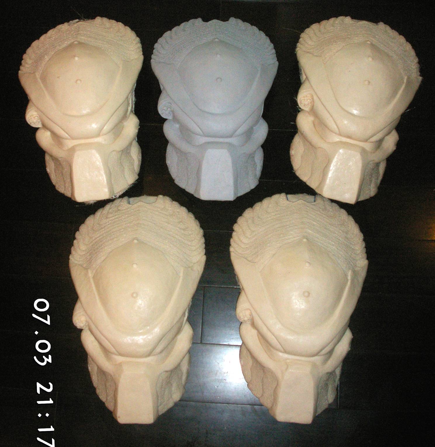

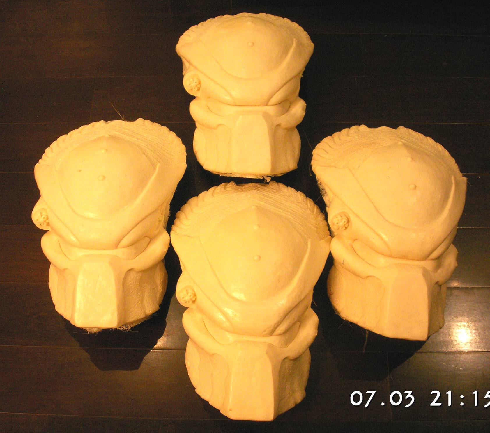

Wow I got a secret admirer I made 3 plastic ones so far. The weather where I am is blazing hot now at 35c which is not good for brushing casting resin. Gotta wait until it cools when it rains.
Making these things takes 1-2 hours for 1 cast and its pretty heavy. I got about 100 meters worth of CSM fiberglass so i just go nuts and lay it on where I think I need it so it ended up being heavy and used a lot of resin. At least 1 kg per mask. Also eats thru 5-6 chip brushes each casting. I'd like to make more but I need to save my resin for other projects as I am trying to build a portfolio of masks. I am also going to make my Bonehunter concept Bio my next project.
Bio CLone Army!!!
Sorry 2 for myself and 2 already pre-ordered The grey one is plaster cast and will break eventually...

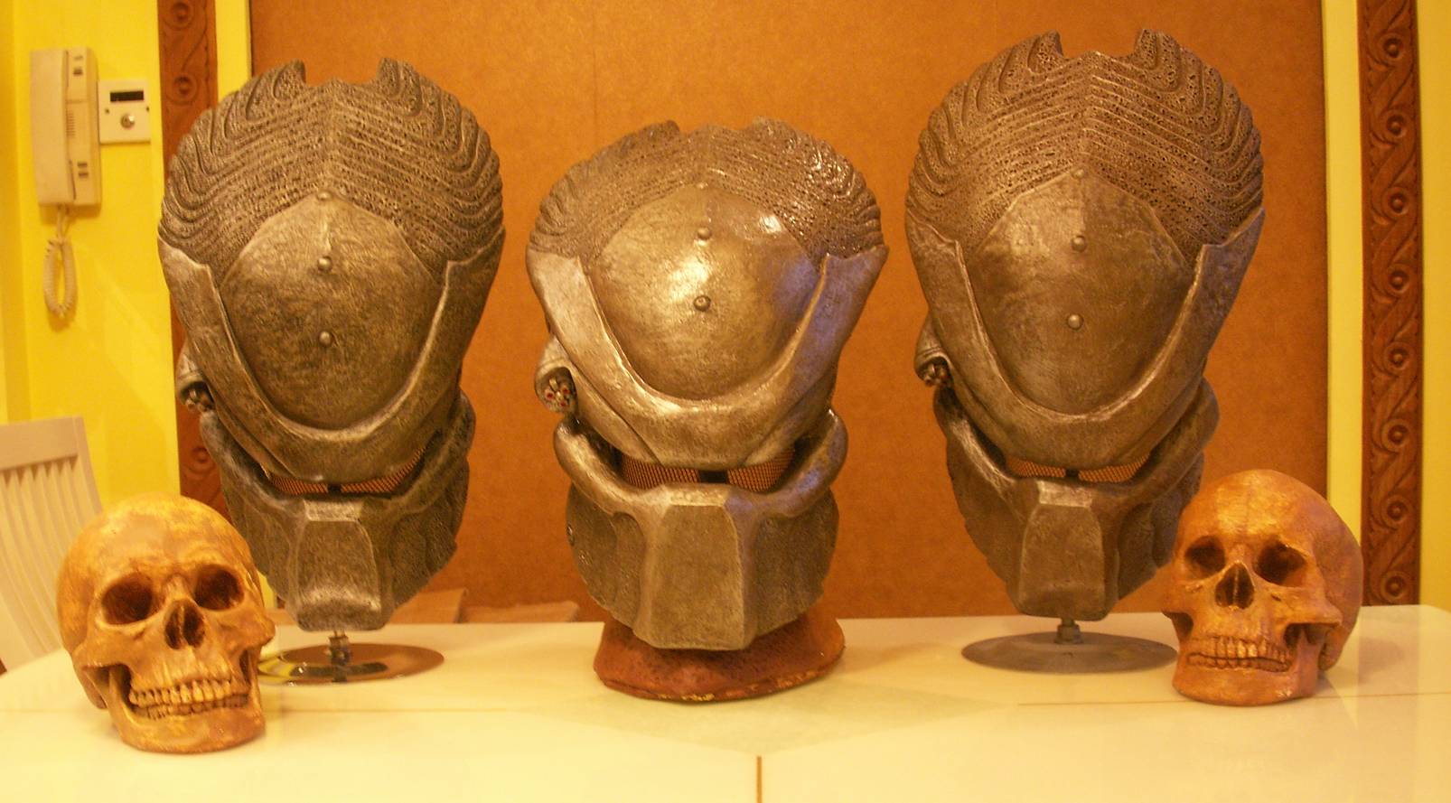

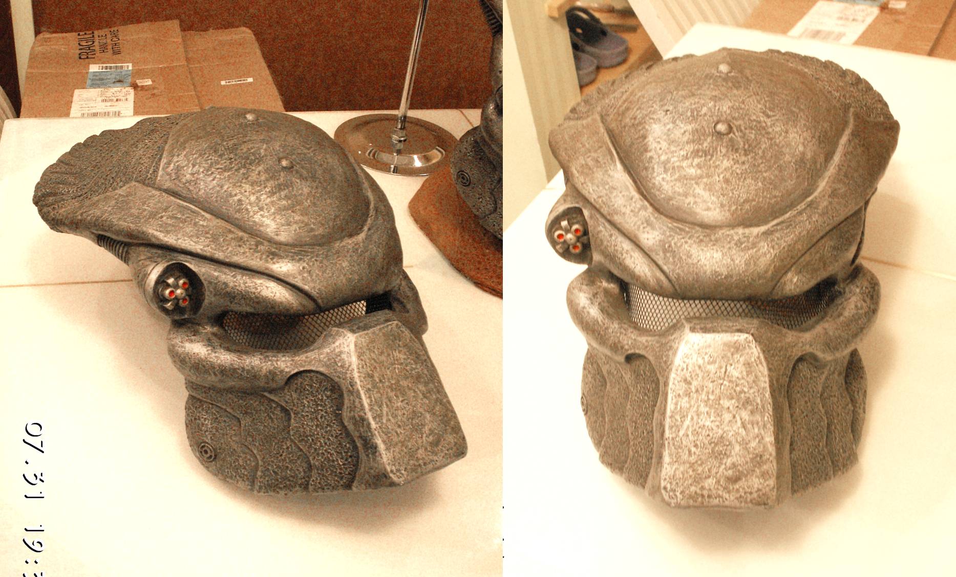

Well Here it is. Finish putting on the screen mesh and all the paint work. Sorry for my crappy camera.
Enjoy and Thanks for watching. You've all been a great support and inspiration to my project.
