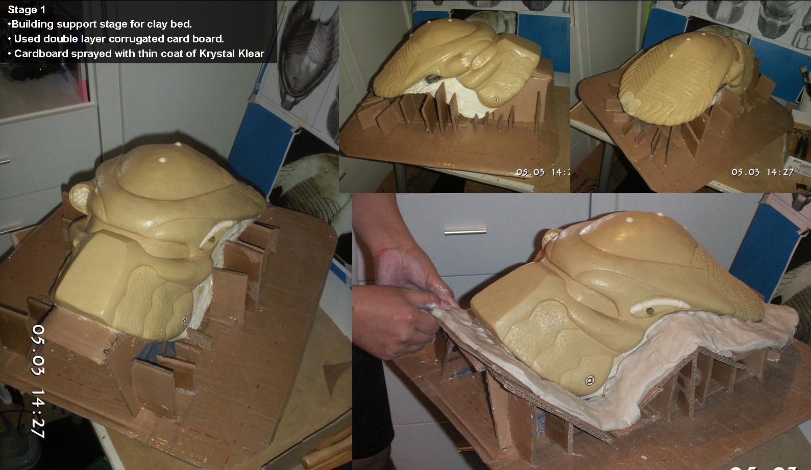

Started making the mold, Laying the support structures for the clay bed. Boy! I'm exhausted. This mold is huge and heavy and I haven't even done the mother mold yet. No wonder ADi & other FX shops have their own molding department. Will post picts once I pick my self up off the floor. :unsure:
Update:

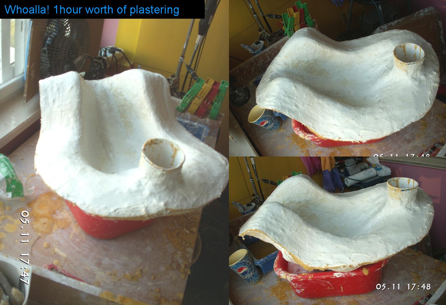

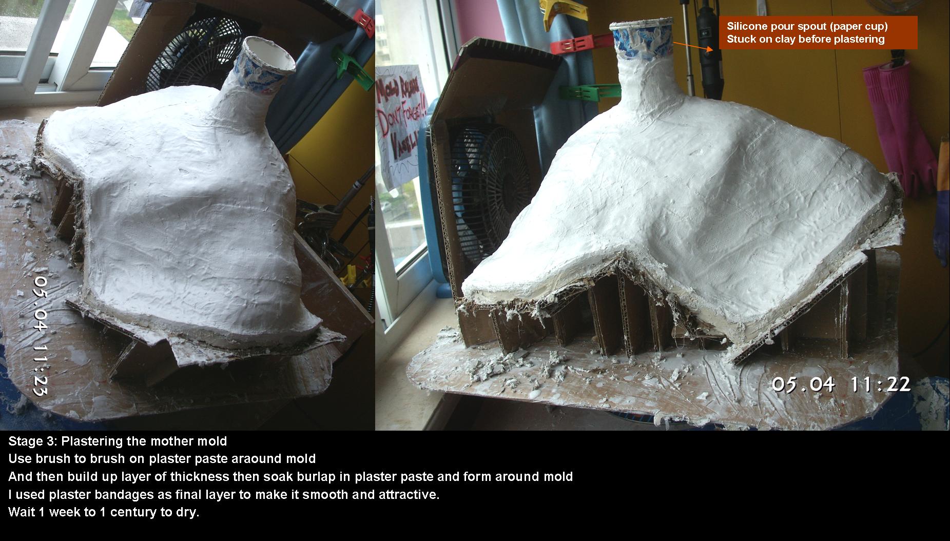

Made the mold. Since I don't have HydroCal I had to use normal construction grade plaster powder which dries faster than hydrocal. I had to work fast and results may vary. Don't Forget to spray a clear coat of clear lacquer or Krystal Klear before laying on the plaster. It will help demolding. I always forget and it may be tough to remove the water clay from the plaster later.
Here are the picts. Demolding time could be up to a week. So maybe the end of this Huntorial ?
If all goes well Part 2 will be demolding and silicone pouring. SO pray for the plaster to set properly and the mother mold to take shape.
Could be 1-2 weeks of worktime needed to fully demold, make the silicone mold and then start casting in resin. Check back!

I just made the mother mold side A for the front part.
- I still need to make mother mold for the bottom Part side B
- Then reverse to top A, demold and clean the wet clay from mother mold and check sculpt to ensure details are ok for molding/ recording
- Then Pour silicone into top mother mold A.
- Reverse process for Side B.
- Now waiting for the Plaster to cure & dry so I can demold this could take some time as said above.....waiting :unsure:

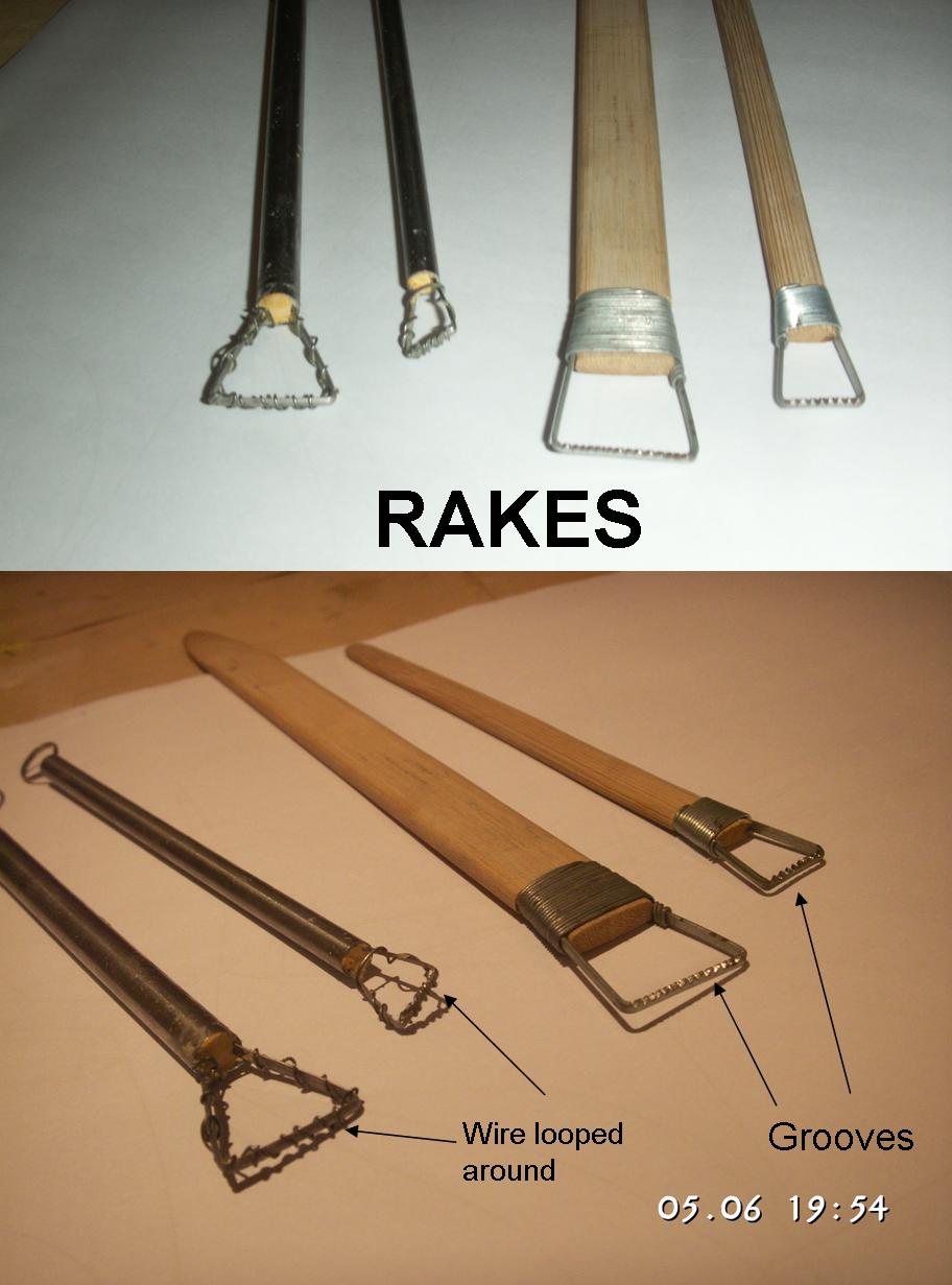

Q: Some one ask me about smoothing out a clay surface.
A:
To flatten or even out a surface:
Using rake tools, a triangular wire loop and add thin metal wire to loop around this to form a rake. Can also use dremel to cut grooves into it
Do this to a medium size and small rake.
After you lump on your clay on - no doubt its uneven, using the rake tool to go over the surface in crosshatch pattern
you will see that your surface is not even you keep going over it until your surface is nice and flat/ even.
You can add tiny clumps of clay raked up (if clay is still clean) to add back onto the concaved craters to make it even
keep raking until flat. Use the smaller rake tool to keep raking until evrything looks flat and even.

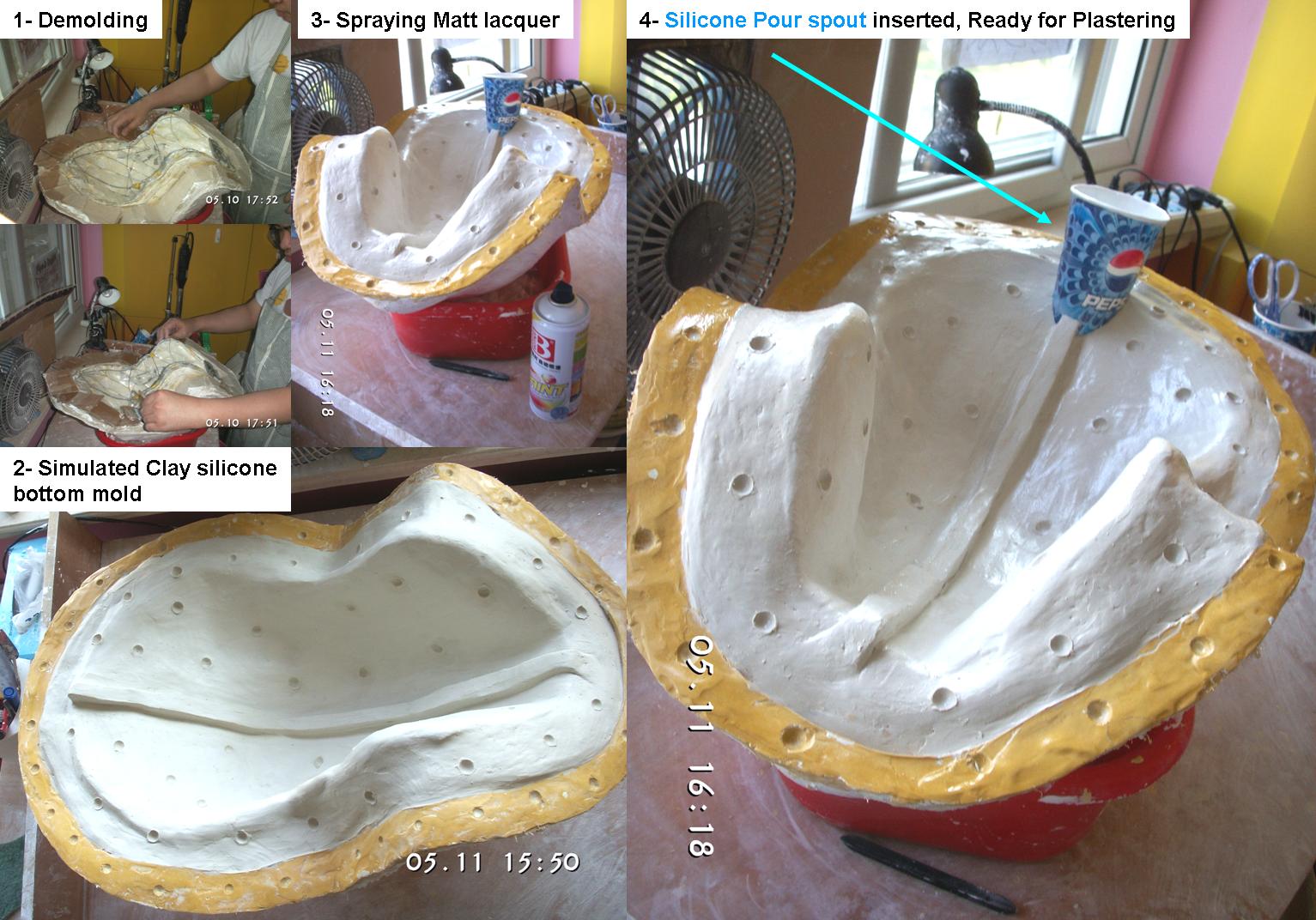

Yes! I'm back!Its been a week. Can't wait any longer I've demolded the top mold and began making the bottom case mold. I finally got the right kind of molding plaster. Its yellow and it dries very hard. Uses 38:100 ratio water to powder mixing. This stuff is better than the construction grade plaster I've got which will crack and ruin the top mold I've used. Its been a 2 day process and for my aging body I've split the process into day one demold and slaking my paper clay(as an alternative to normal water based clay) for making the bottom simulated clay silicone & Day 2 making the clay bed and plastering which took me 4 hours.
So hopefully the top mold is hard enough to demold next week and we'll see if I have to make another top case mold with the yellow plaster since I fudge up by using the wrong frakin plaster.. doh

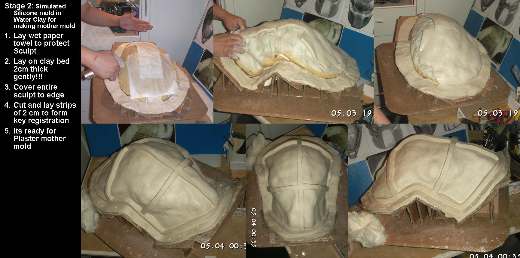

Note: This process I'm doing is for making Matrix molds.
This involves making the case mold first by making a simulated silicone mold layer using water based clay and
scultping it with keys and then mold a plaster case mold on top of it. Then demold and remove the wet clay, clean the case mold and then fill in silicone.
Its good for making something huge and complex like a helmet and its produces casts more accurately with less warping and distortion.
This process allows you to make precise silicone molds with no waste and you know how thick your silicone is. The case mold will also provide a stable handling of the entire mold while casting/ pouring.
I know, its more trouble but its defitnitely worth the results in the end. I could jsut brush on the silicone until a certain thickness then make a case mold but i wouldn't be getting a nice silicone mold that has precise keys and precise thickness.
Picts:
