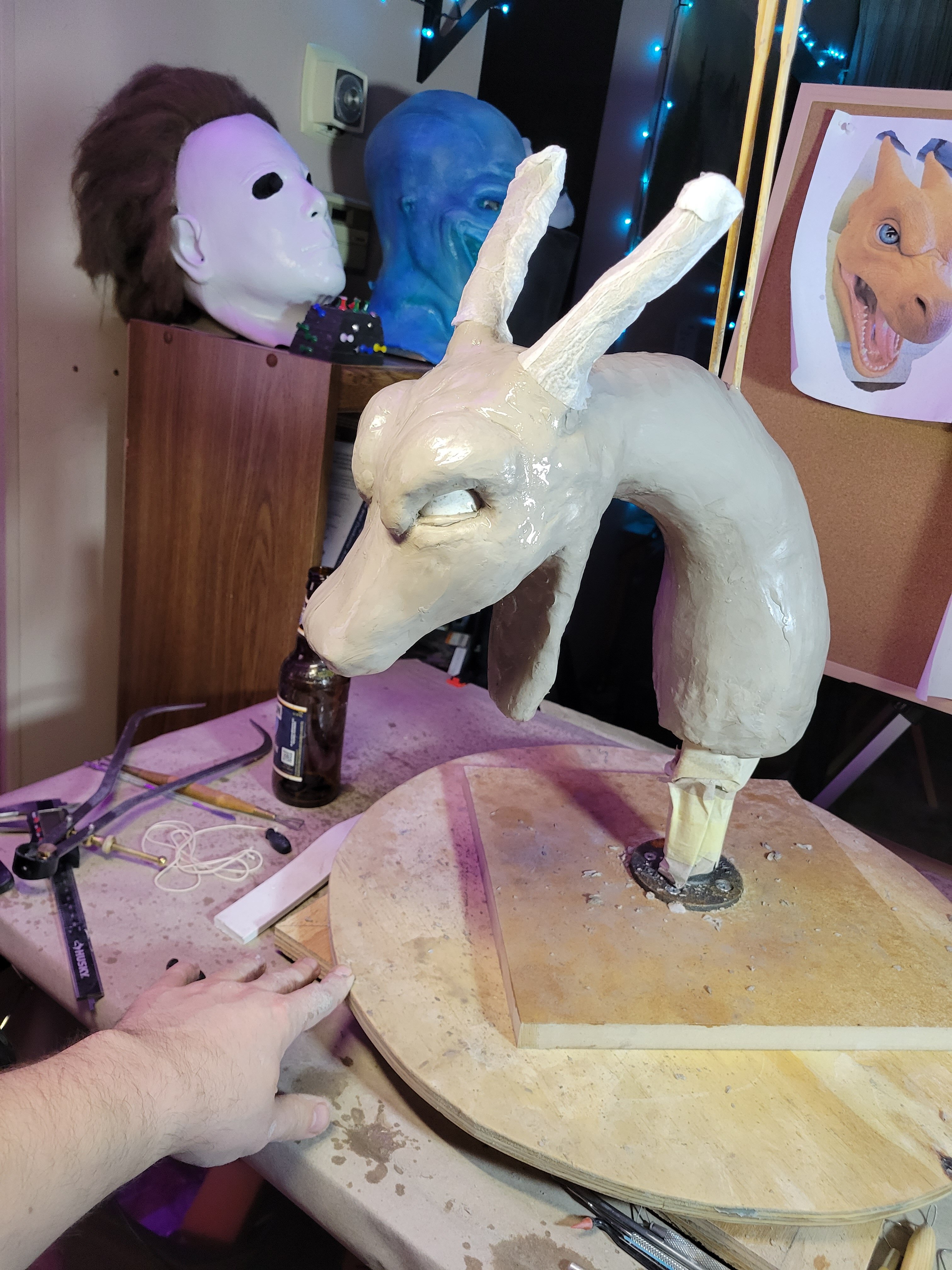

So right now I'm sculpting a Pokemon (Charizard) bust/statue. I will likely cast it in smooth cast, but I want to revisit all the casting options again. I know I want it in a plastic form hence the silicone mold. The sculpt is about 12" tall. Just his head and neck.
If I got my numbers right 12" is around 30cm tall (I'm in the metric system realm) it's big for a block pour mold in my opinion, lot's of silicone. A brush up mold with a plaster or fiberlass (or others) case could do better in my opinion.

Also for a better visual reference, here is my WIP. Still a lot to do before making the mold.

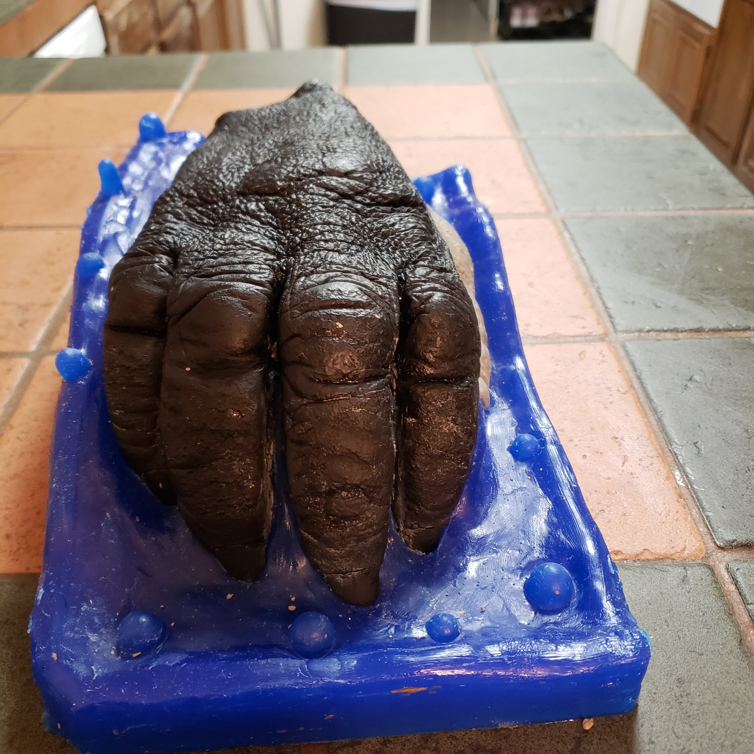

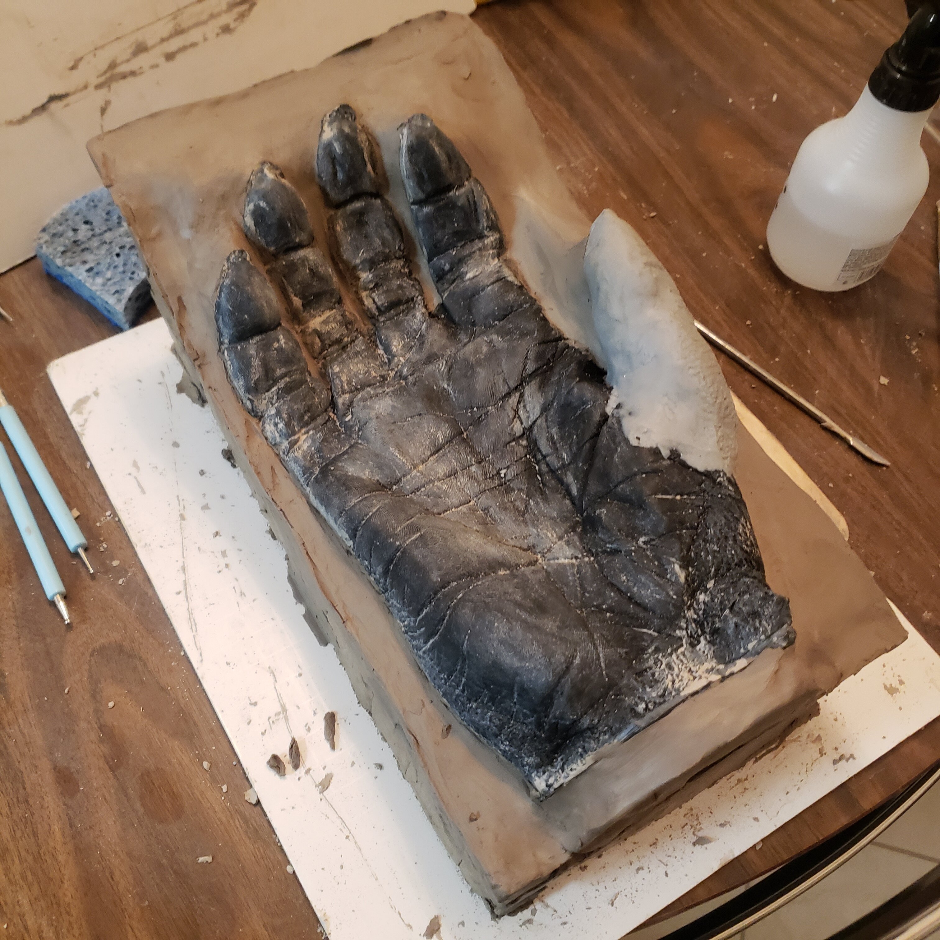

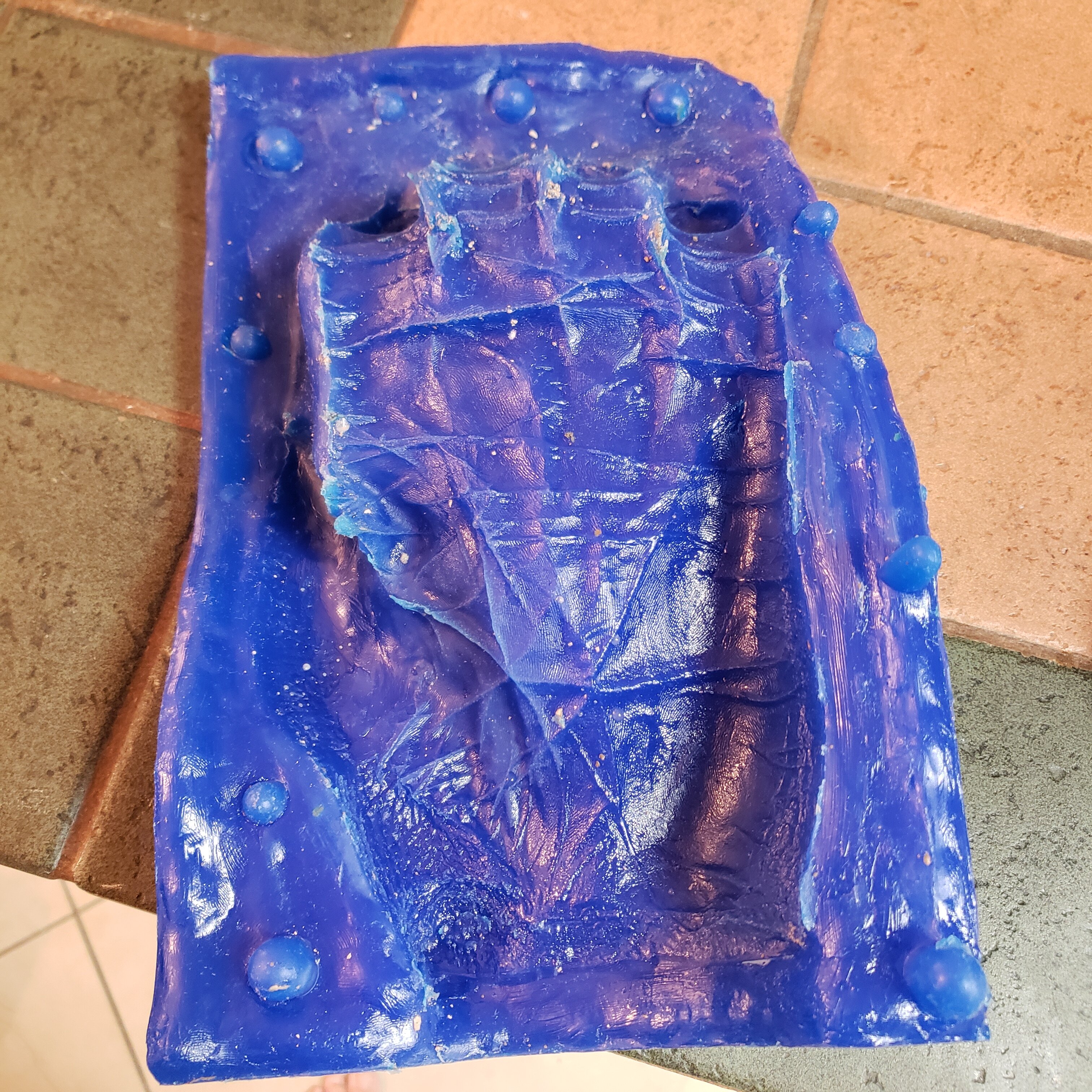

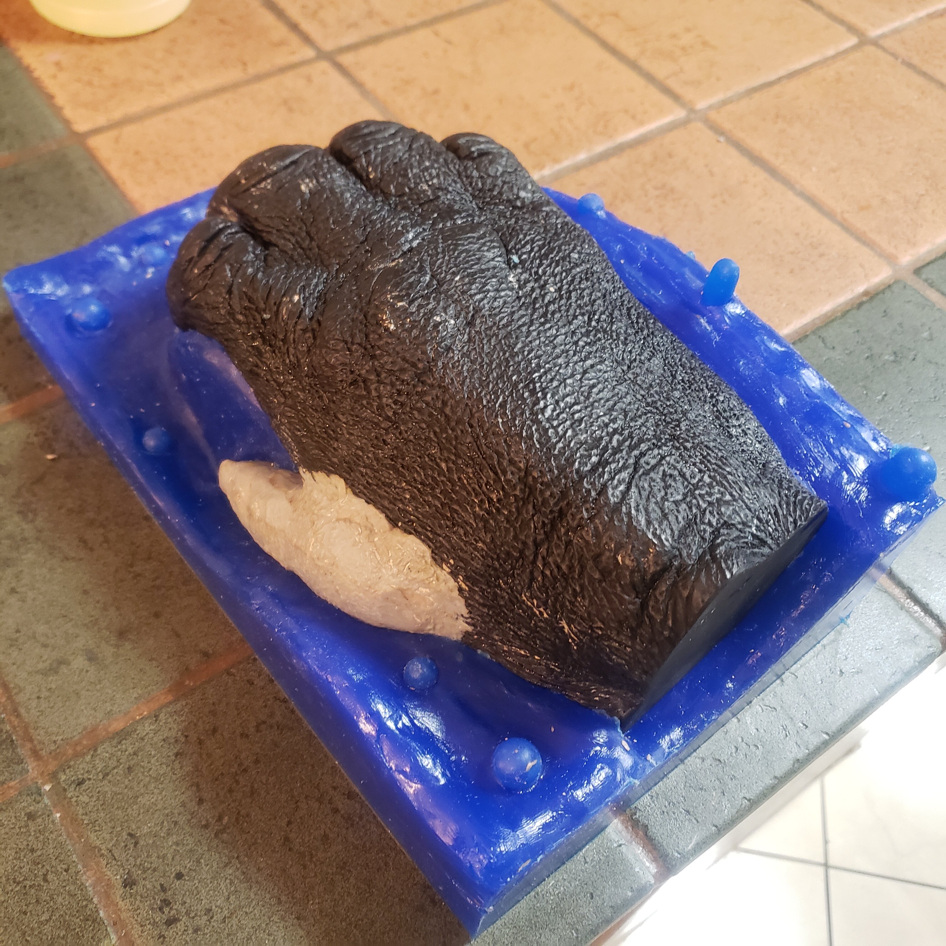

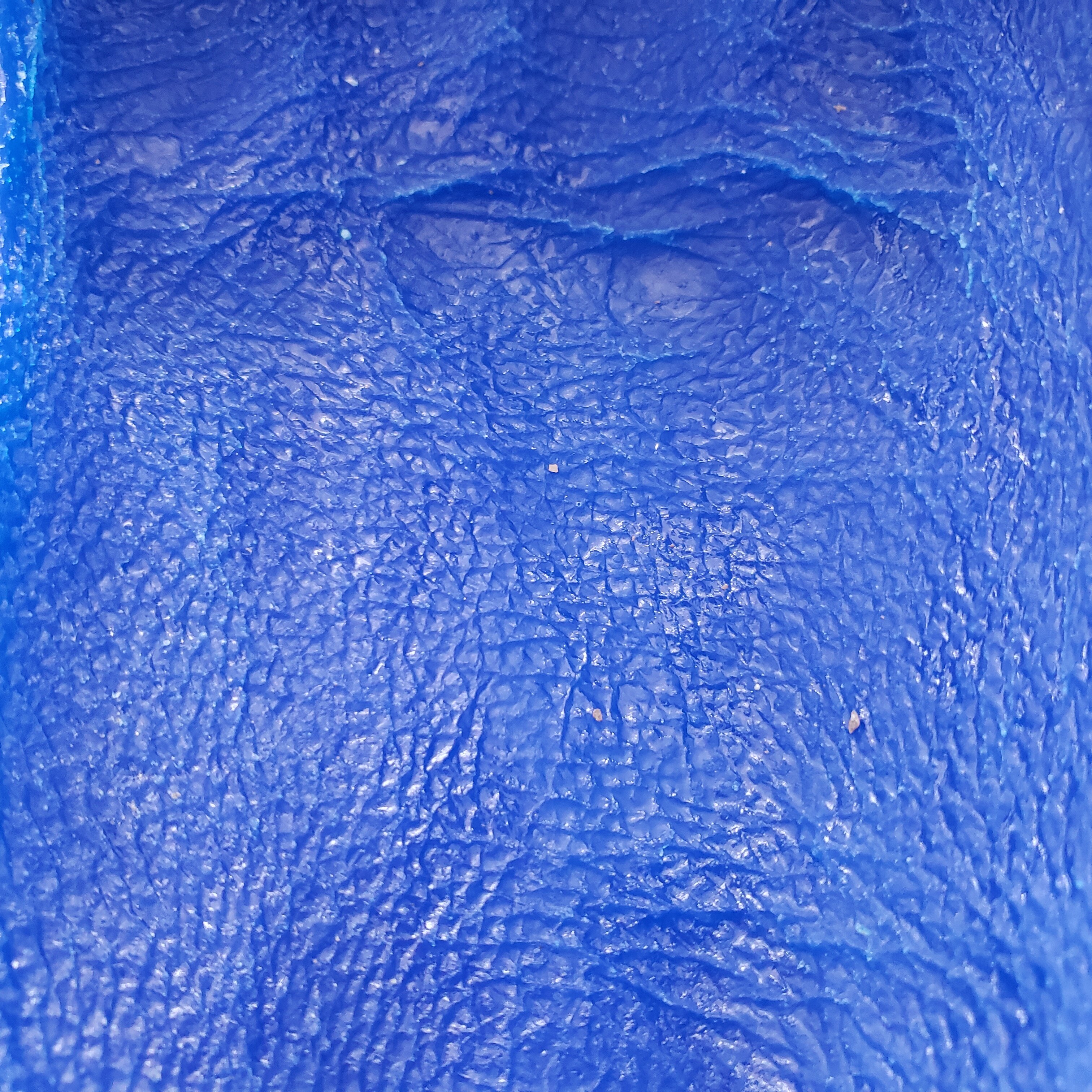

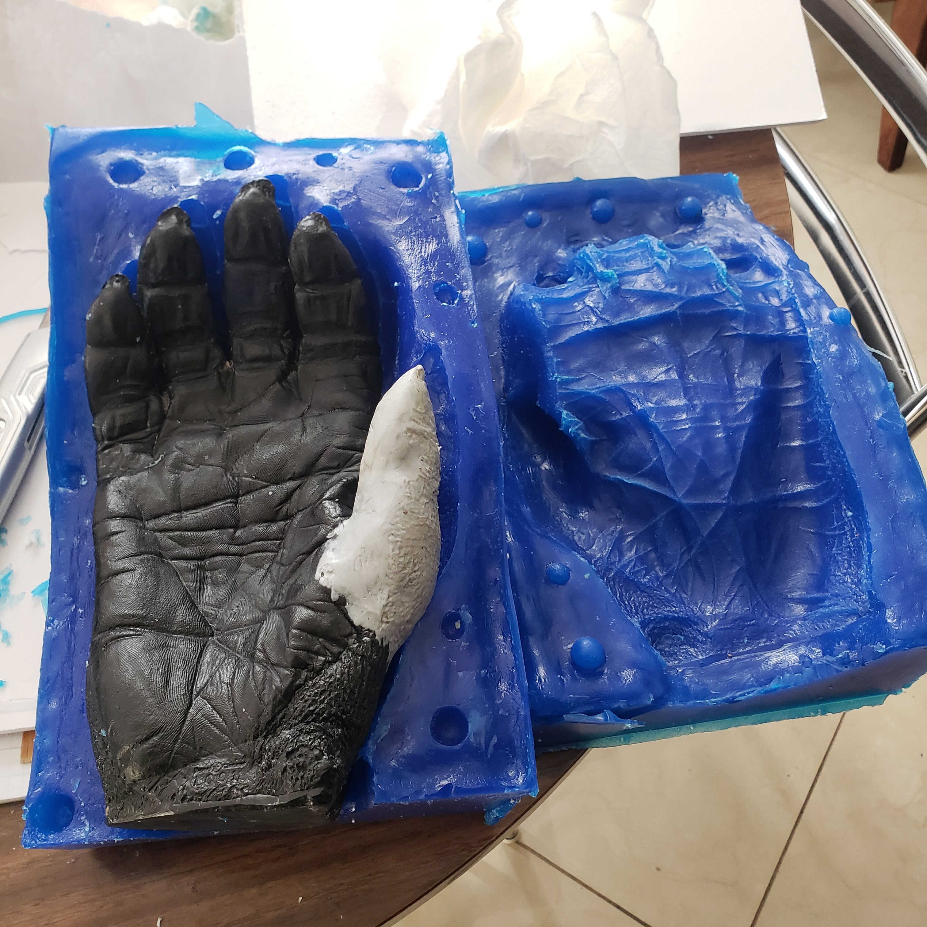

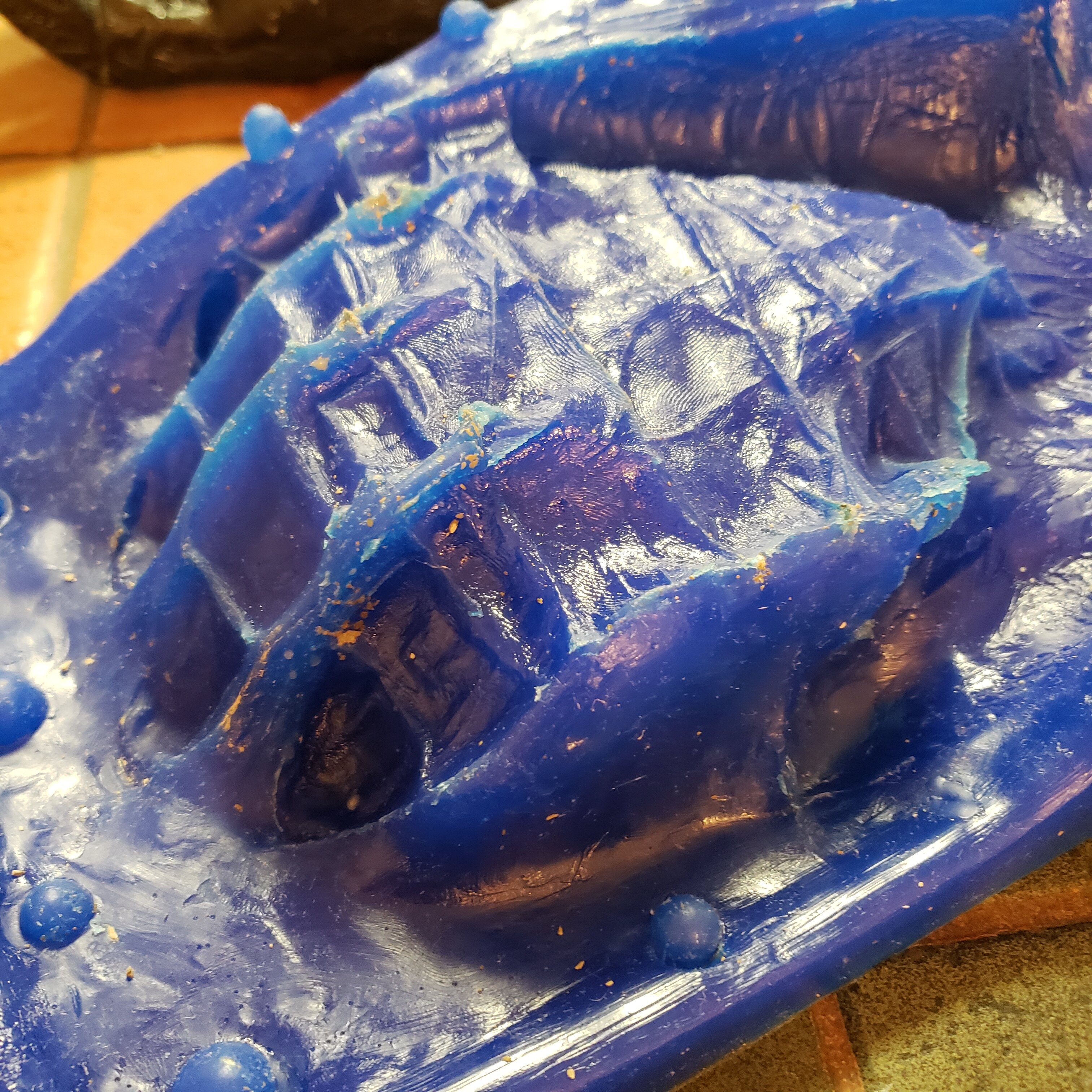

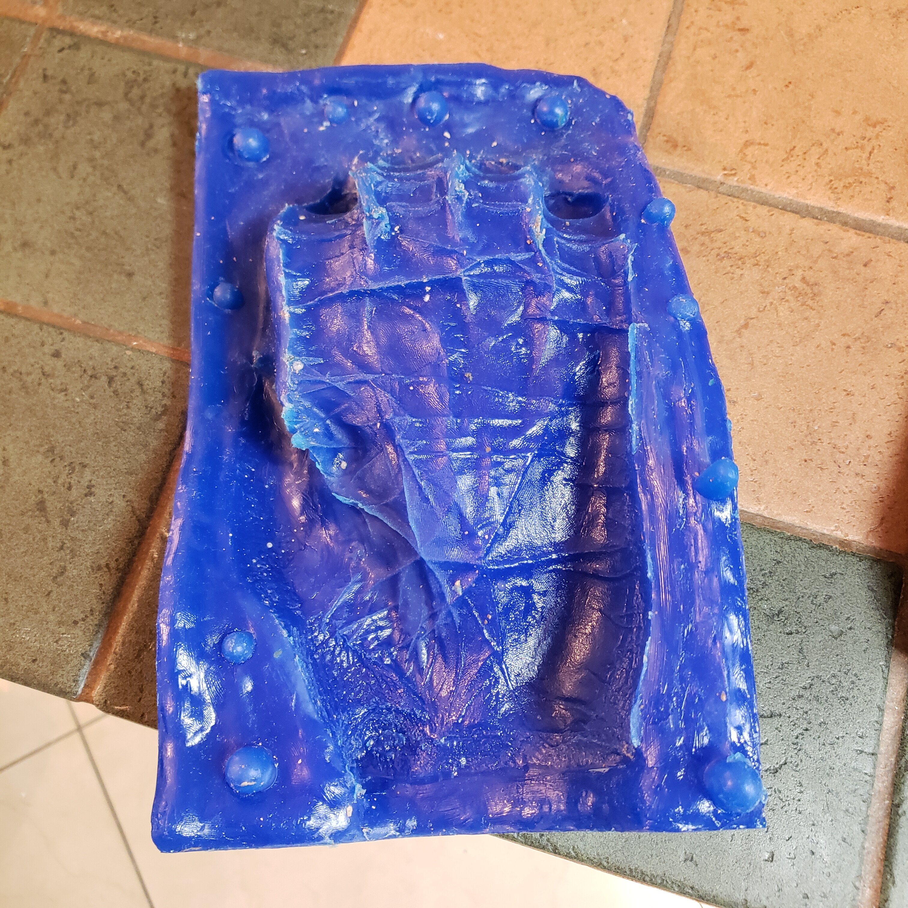

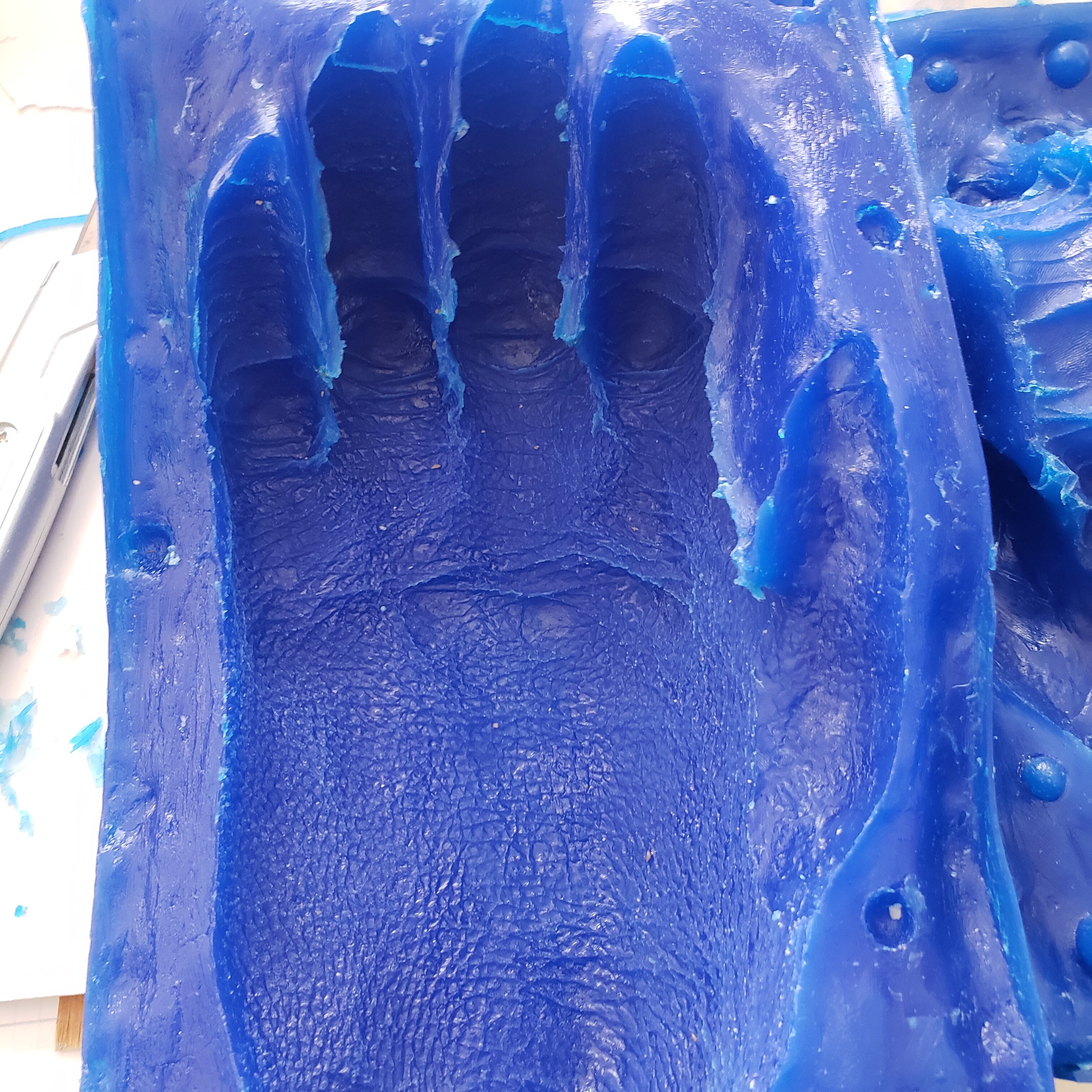

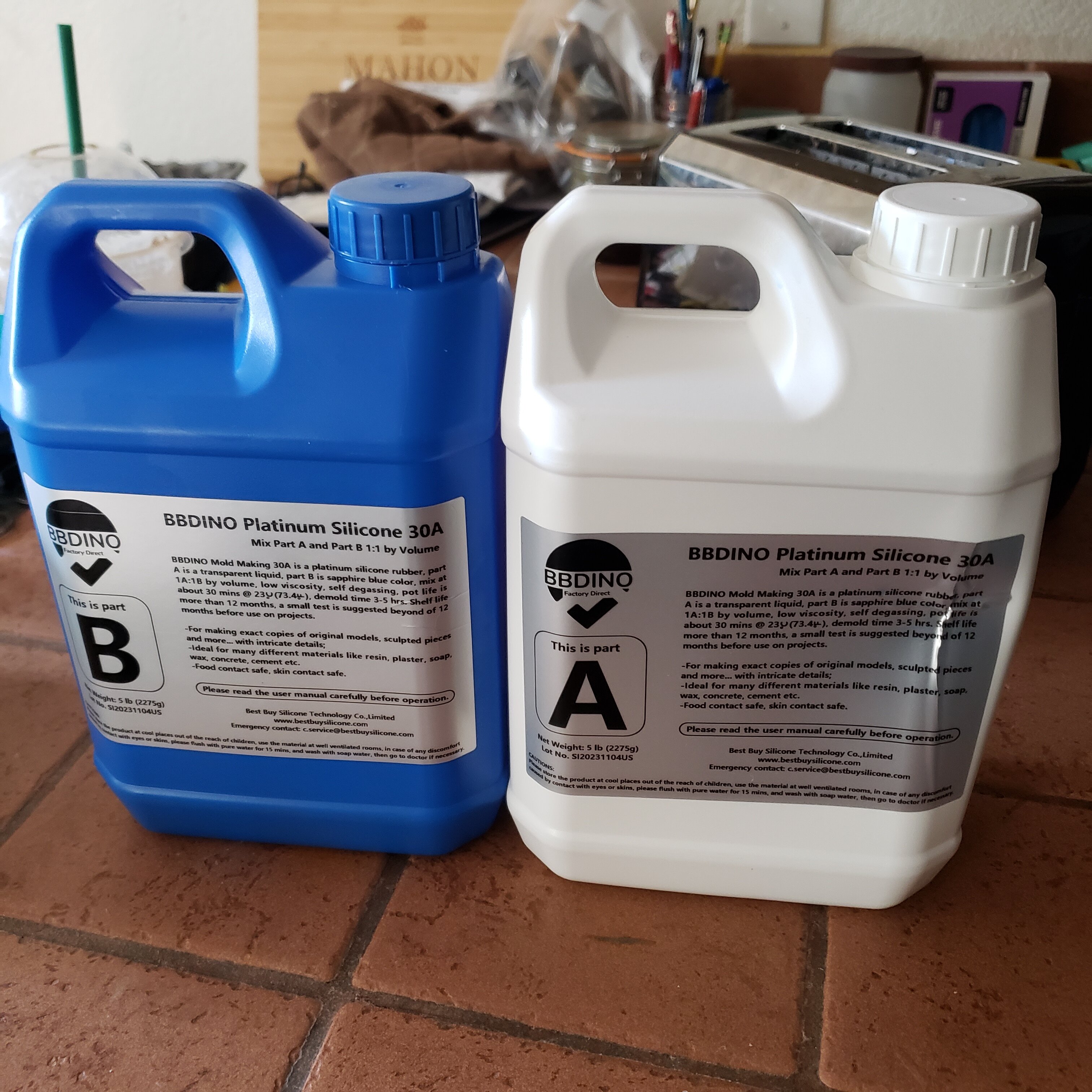

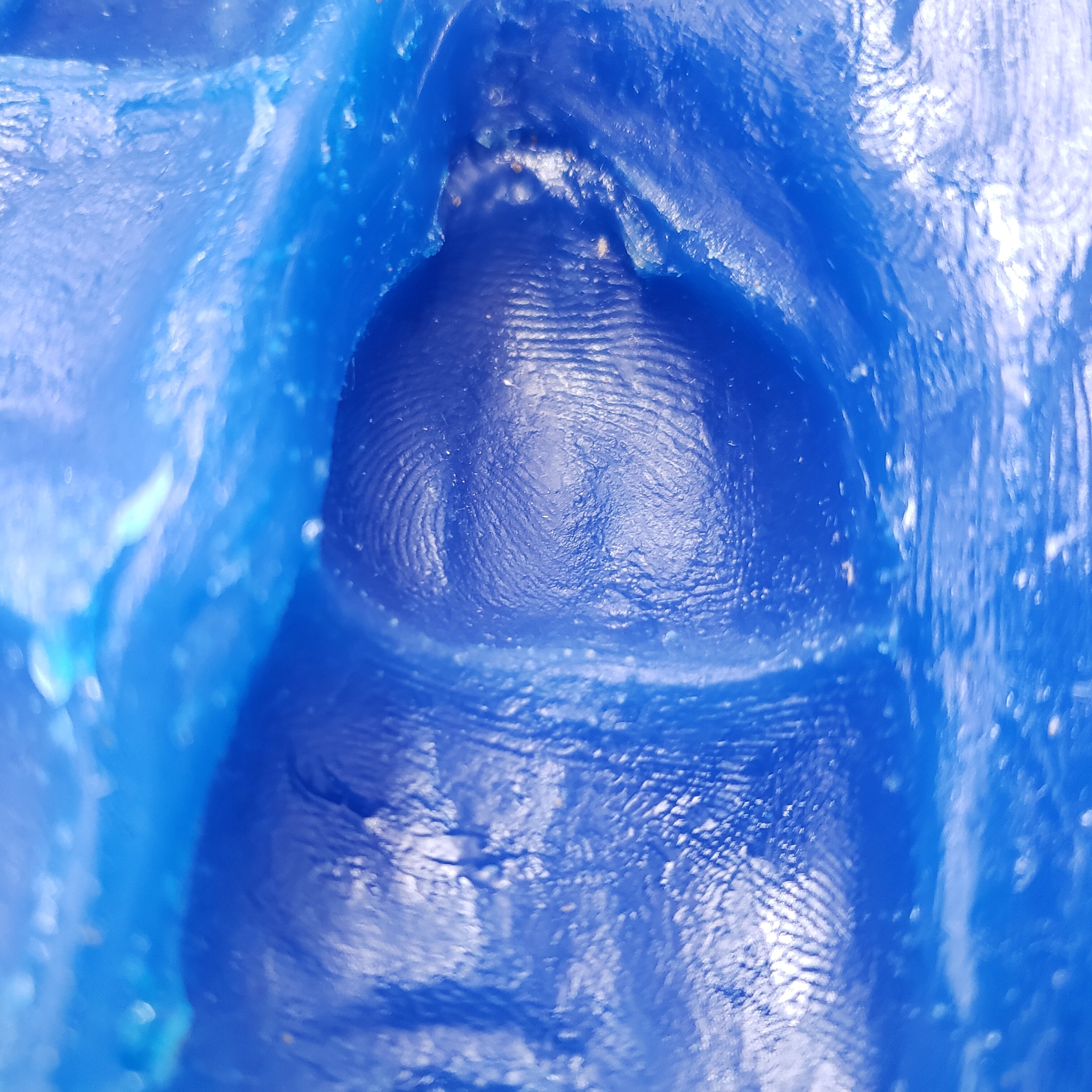

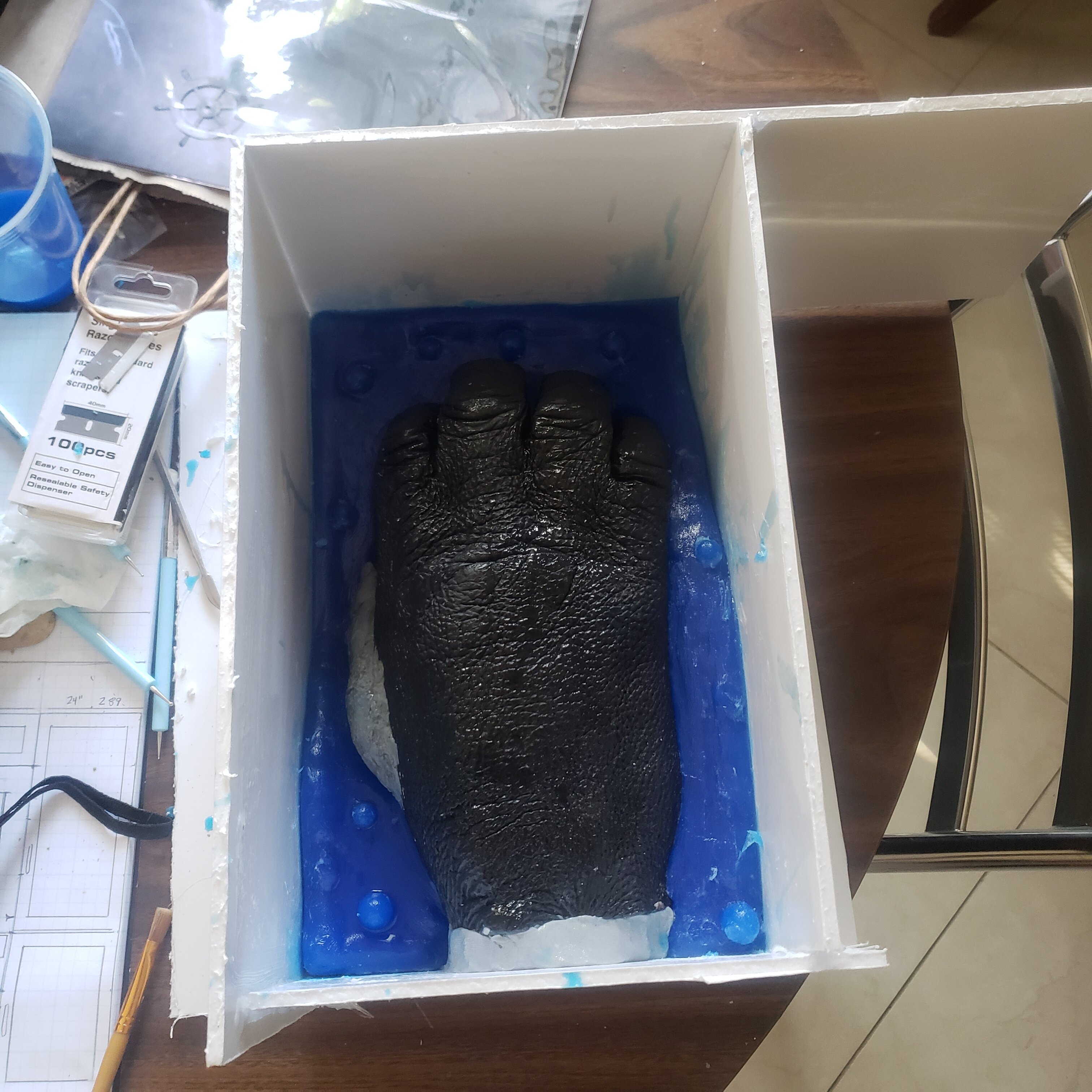

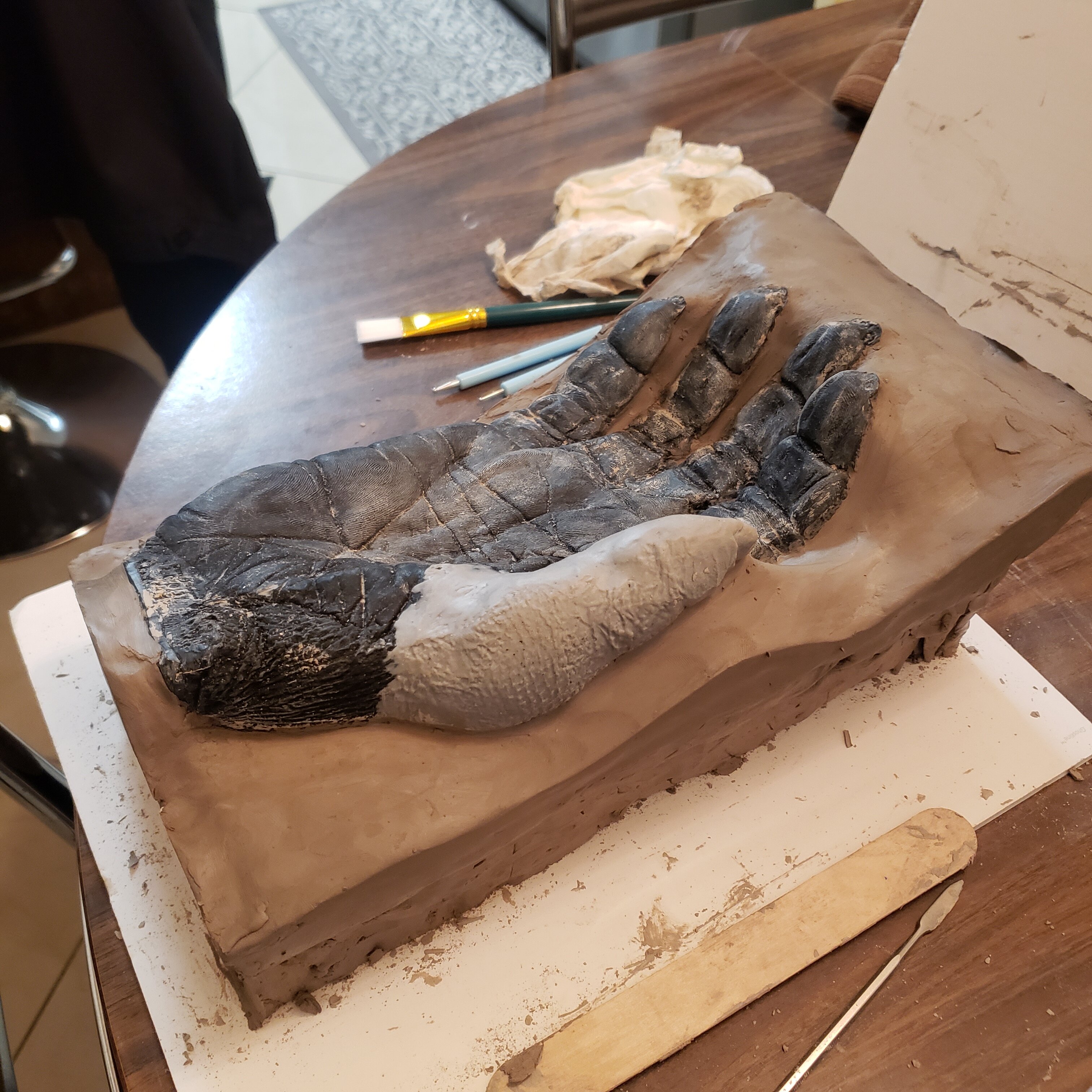

I recently molded resin gorilla hands to make into latex hands for my Gorilla Suit project. I knew it would take a lot of silicone so I came across BBDINO on Amazon. Not cheap but definitely more affordable than the same amount needed if I were to use Smooth-On or Polytek.
It's a Platinum based silicone with more of a ballistic gel look, but it worked great. It has a thinner viscosity and self gasses and captures amazing detail.
