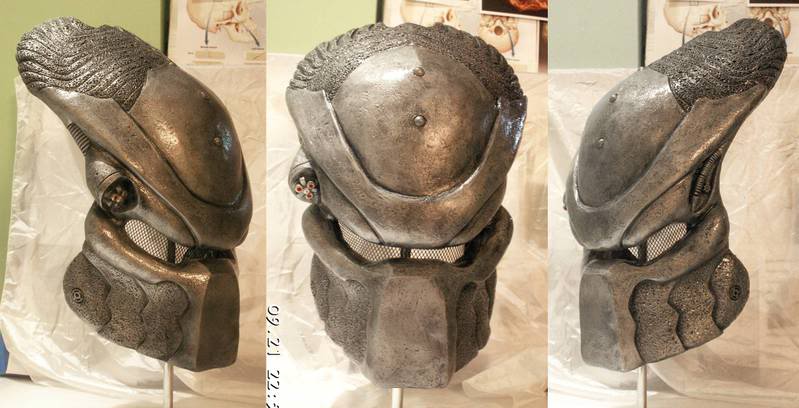

Hey Uratz, the mouth armor/plate on the right and left mask look kinda warped. The middle one looks fine. Is it the angle of the bio's or am I just imagining it?
Dude they are freakin awesome, when i first saw this thread i didnt know what you would come up with having not seen any of yr work before, i just wanna say they are beautiful bios dude, not warped in my eyes and even if they were im sure most of us like bios that lok kida organic not ones that are completely symetrical.........anyway forget that nonsense. I just wanted to say wow......your work is fantastic and the bios are damn fine. Love the paint job too.....keep rocking, i look forward to watching yr next projects dude.
J
The bio sculpt have minor asymetericalness all over the place, but not warped.
I tried to make everything the same proportions using a caliper. Anyway its one of those hand made imperfections that makes it unique haha.

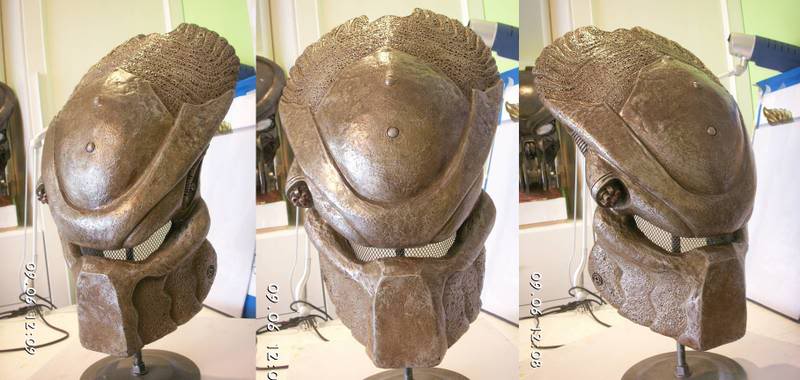

These 2 are sold. My best pieces and I miss them. 1 in Guangzhou and 1 in Baldwin NY.
Brownish-Rusty earth metallic
Bluish Metalic
