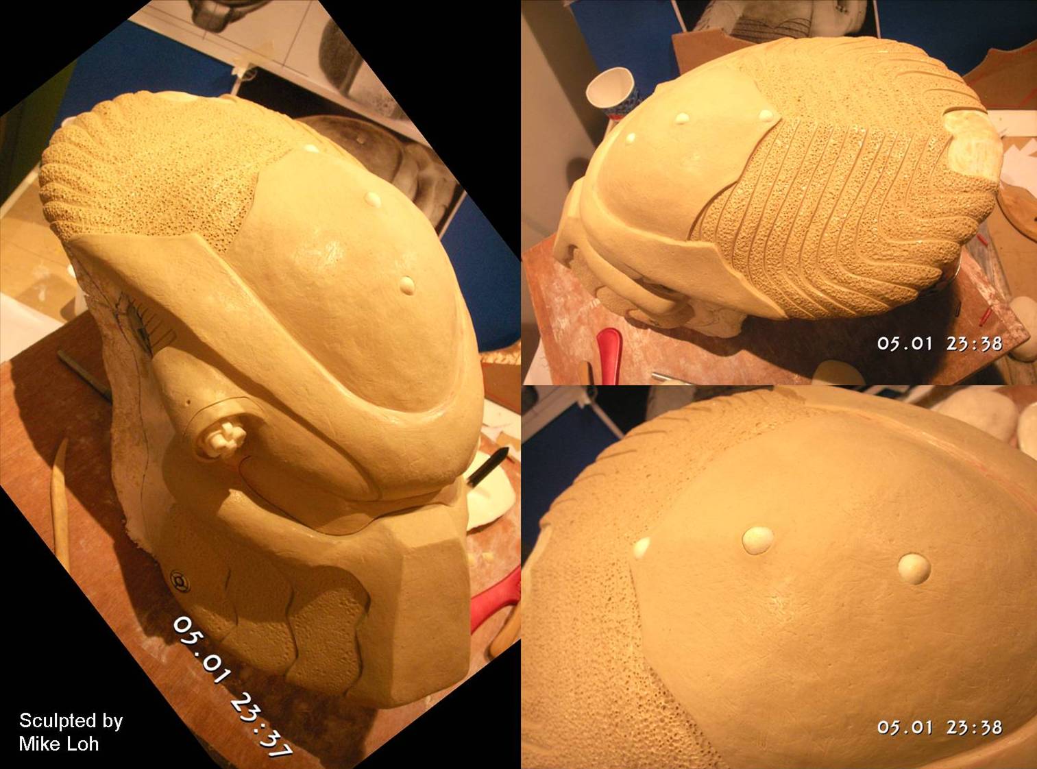

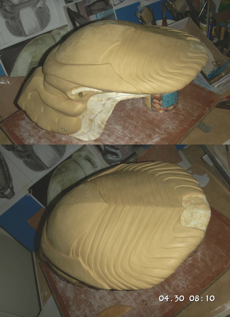

Mini Update: Trilobyte Armor Detail
The back part is done, still need to further detail it and make every ridge even. The entire Bio is almost there. Now just need to keep refining it and perfecting it. Making sure it as symetrical as possible then when thats achieved will use 75% alcohol to smooth out the surface and then add stone texture to the surface. Will be creating a special tool for that in the next post. Stay Tuned.

Well Its a good and bad thing. I think most professionals would've been done by now. I'm less experienced so there's more that I need to do to perfect it. If you know what you're doing you'll take less time to "finish." Since I'm not a experienced sculptor there's much I need to learn and I realized I made a lot of mistakes and miss a few things I should've caught (e.g. the underform was not symmetrical so anything on top will have to compensate more for the asymmetry or fix the underform first).
But there was no way for me to know it until I get to this stage. It's all trial and error. So for others who want to be a bold sculptor, you just need to have faith and jump into it. The more we sculpt the better we get right? Oh yeah having the Patience of a Saint will help also. Otherwise if you lose it you may end up chucking the whole thing wasting more time and clay, rather than scraping off :) and re modelling.

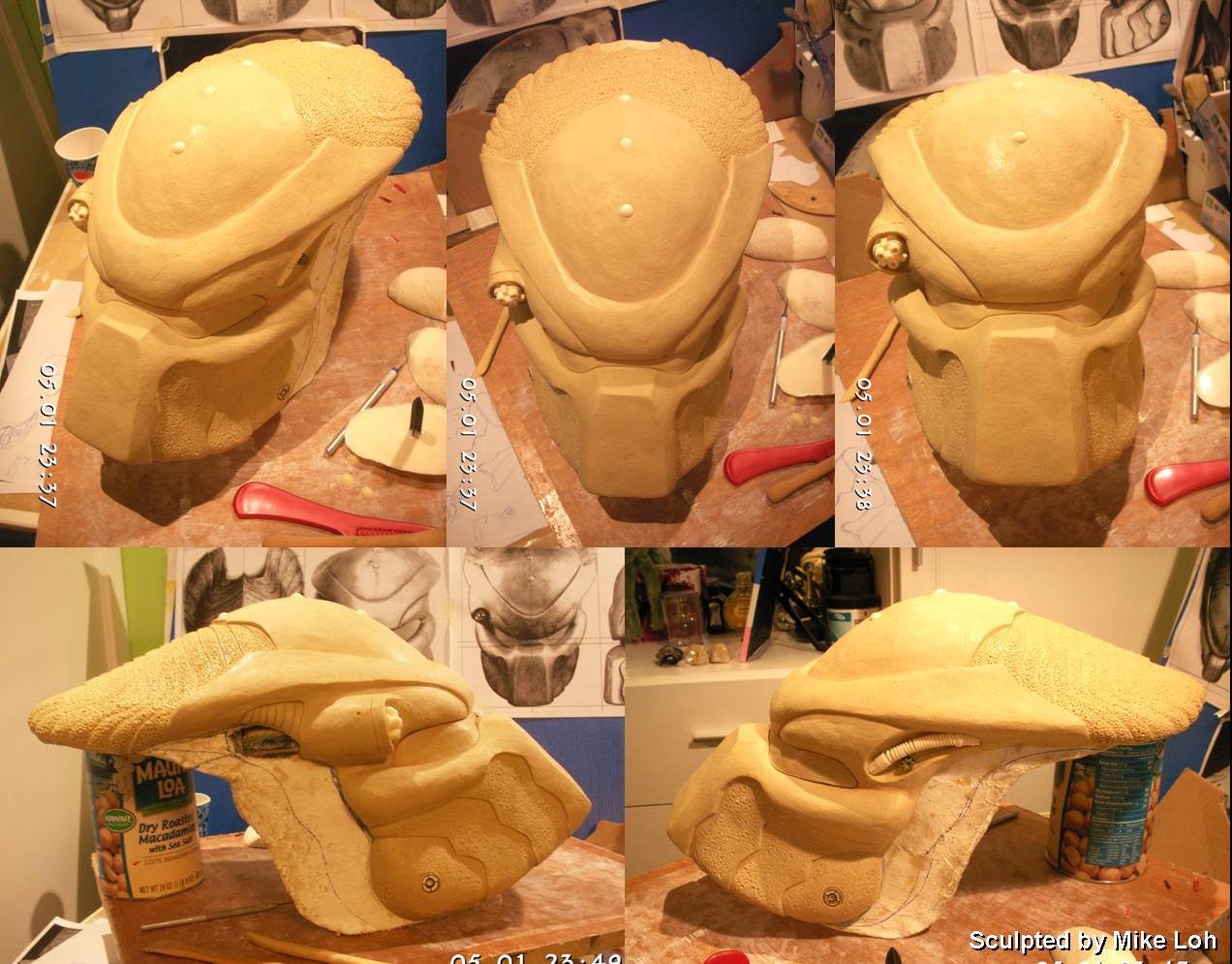

Is an Artwork can ever be said to be "finished"? To most artists it can never be. But for me "Yeah It's finished." Its not perfect but at some point you just gotta make that judgement call. Its done and I'm moving on to the molding stage, which will risk everything on the line. I took thousands of shots of this finished stage for my own record.
The trilobite stone dimples are added meticulously. The side cheeks have a slightly more "rocky" texture even though it has a similar dimple texture. I had to make my own rounded rivet looking things on the top forehead centerline. Those were cast in resin using clay push mold(no time to make silicone molds for small things & its a waste of good silicone). The object used for the little round rivets was a plastic eye of a plush toy. It was the right size and roundedness so I took advantage of it. Haha
Though I used Biohunter's sculpt for ref (thanks a bunch man for the inspiration) I applied my own touch to minor details such as the cheek razor pattern, overall interpretation of a Ancient Elder style, surface textures are different obvioulsy- my artistic license. I also made the surface of the sculpt to have metallic scratch patterns (which can be seen clearer once painted) along with hammered crater look.... blah blah blah.
OK Enough of me blabbing, on to the pictures! :)

Thanks for the kind comments. Gonna mold it tomorrow. Starting with Clay Bed and then make the mother mold first, then...? Better that I show you after I finished it. :unsure:
Yup, noticed that. Fixed up a few things as we speak. Some things you don't see until you take pics and really analyse it. I'm passing this sculpt off as an "organic" bio rather than a "machine perfect" one. :unsure:
