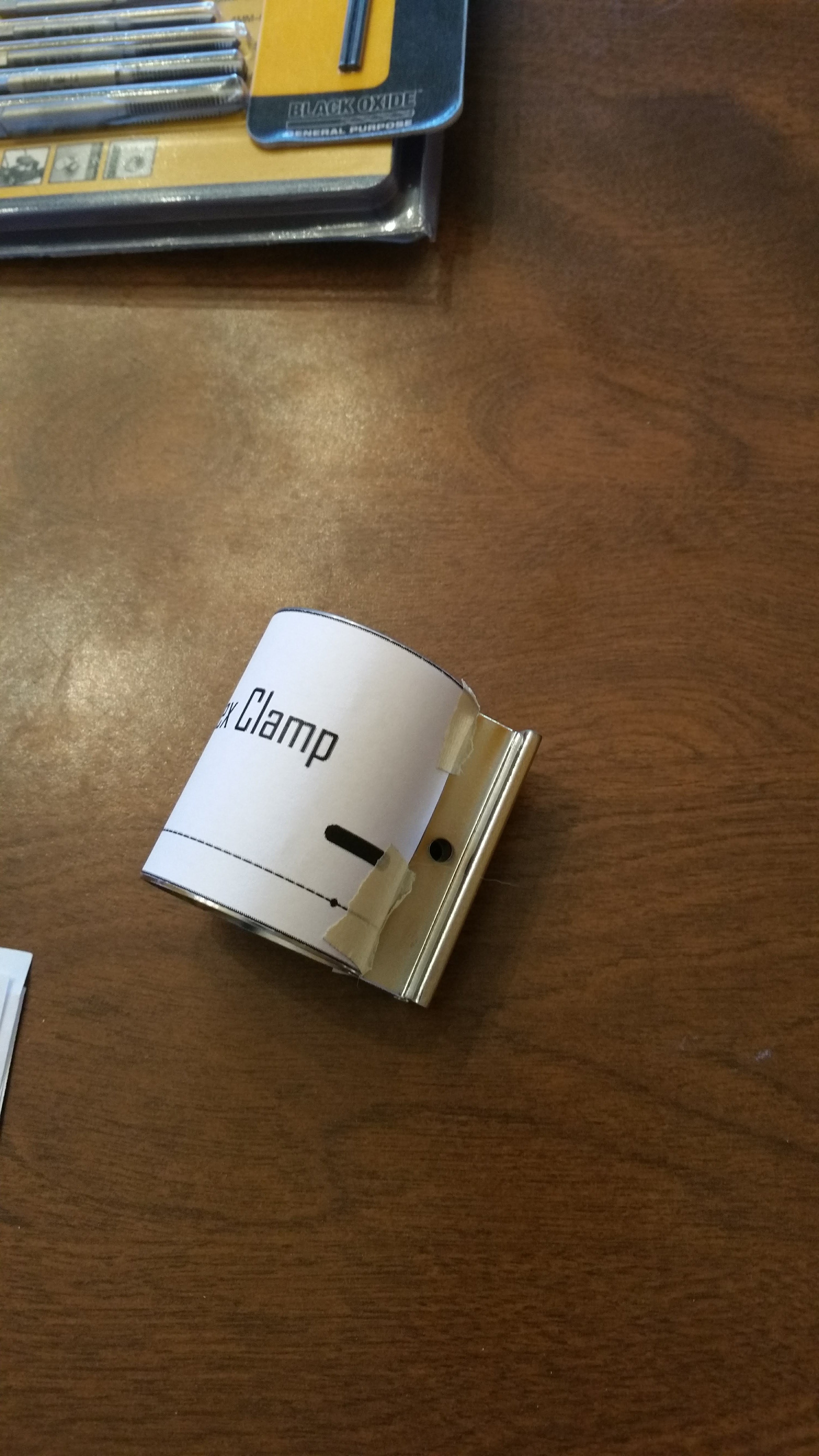

Do you know the exact placement of the 3 holes in the Graflex clamp? I wonder if trooper Trent could supply another paper template for this? I got a beautiful Graflex stamped clamp from The Graflex Shop that needs to be modified. I already flipped it upside-down for the install.

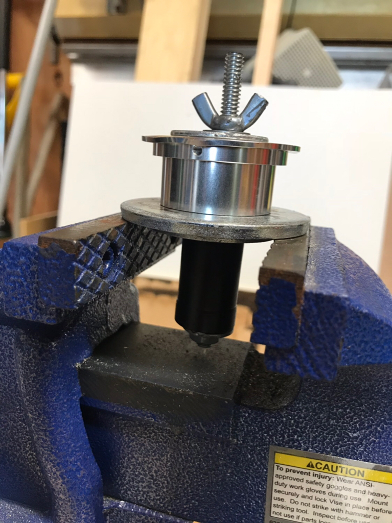

Dented the builders kit emitter today. Very different animal compared to the FX kit
Machined up a quick adapter to protect the threads
A lot more heat was required, did my “halo” around the emitter, then had to do each dent 1 at a time. Usually I can dent them all in 1 pass of heat.
Not with this beefy emitter
But end result came out great!!

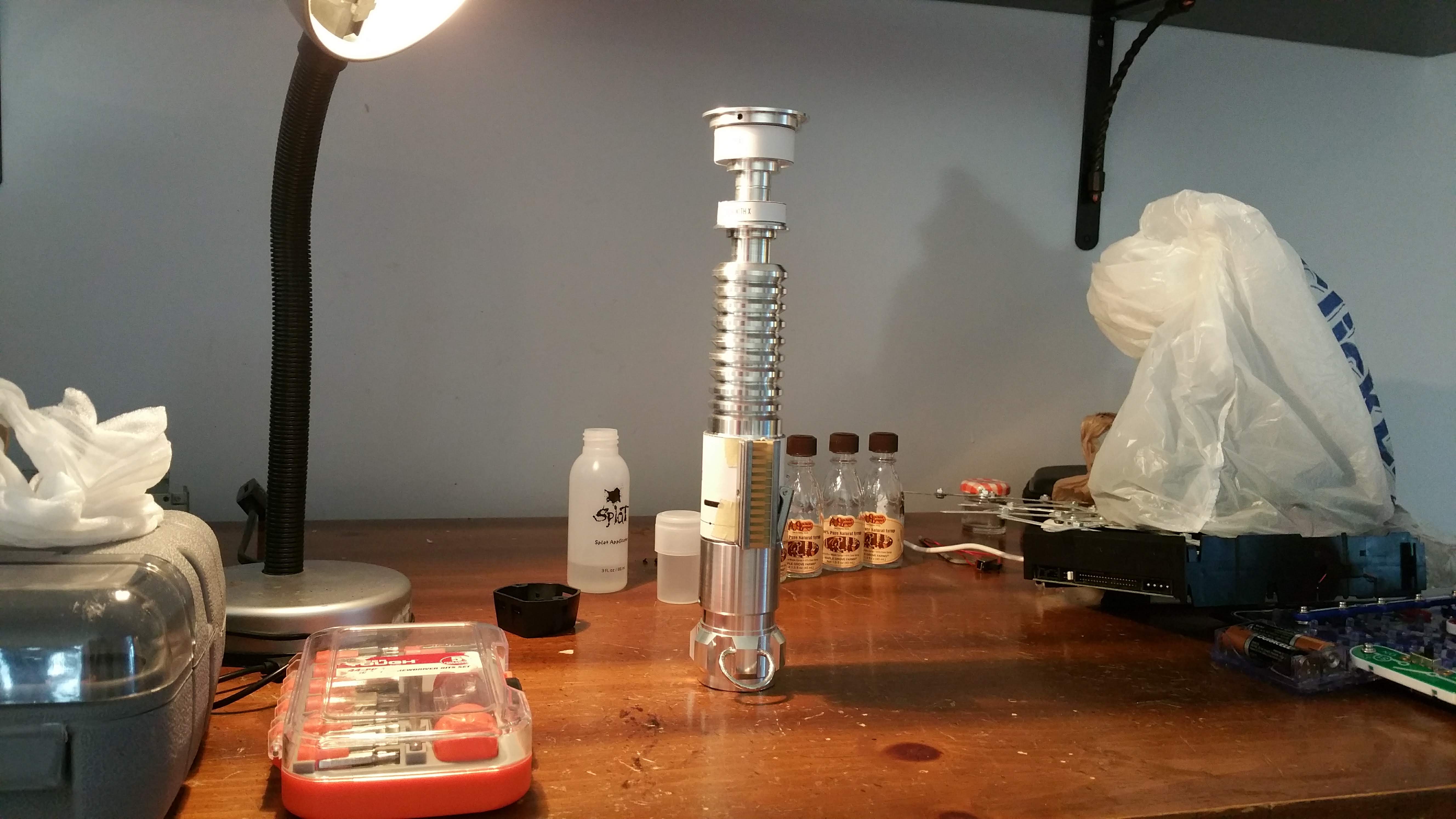

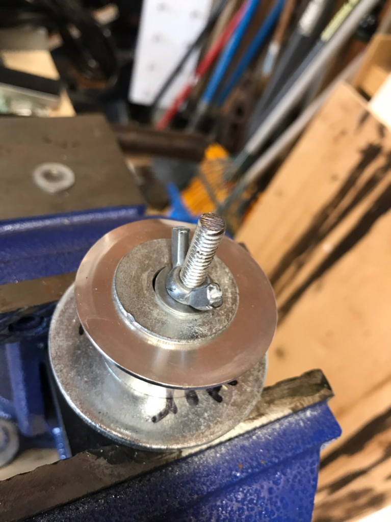

Great work halliwax, the only issue I am having is turning the mystery chunk's shaft down in diameter with sandpaper or files and my drill. I feel like it's hardly doing anything at all to the diameter.
Takes a long long time, turn the drill slowly, and push the file up into it
Be sure to clean the file out
The leather tool is steel so it will take some time to turn down
Keep at it!

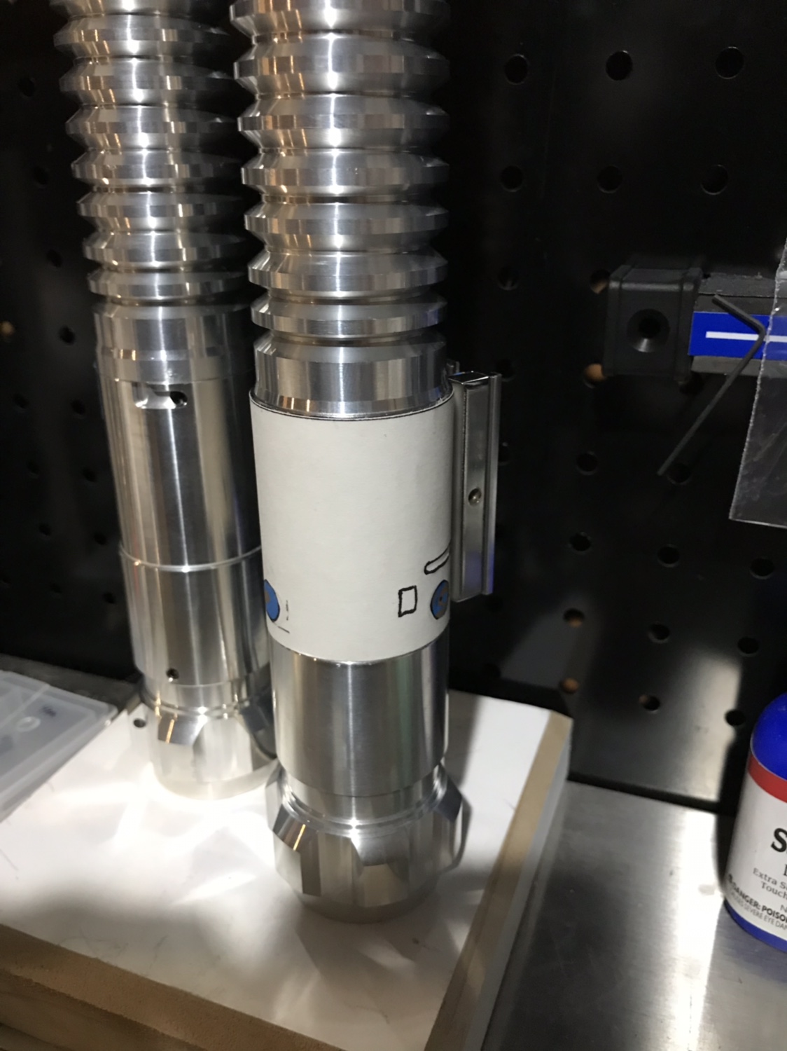

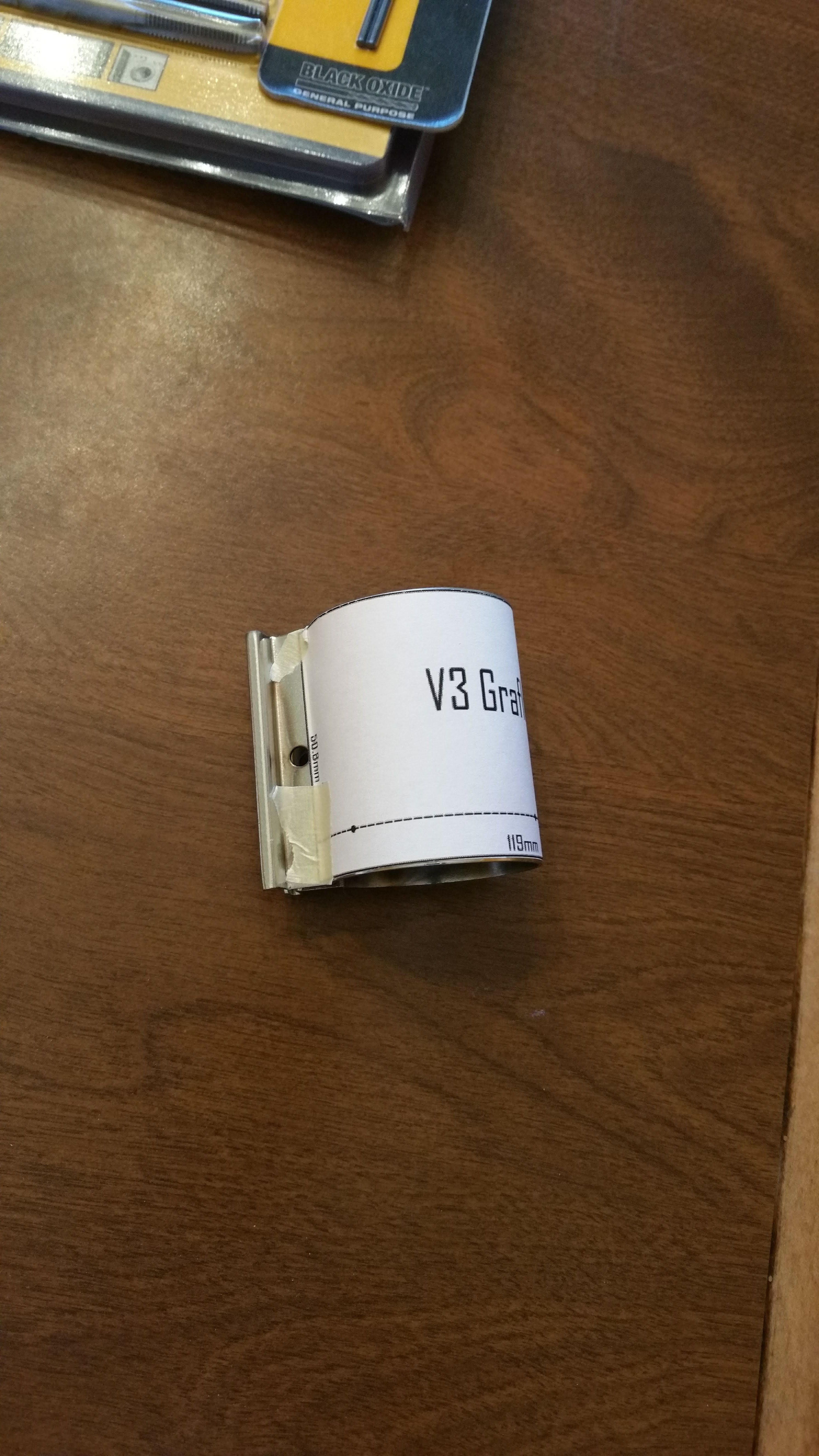

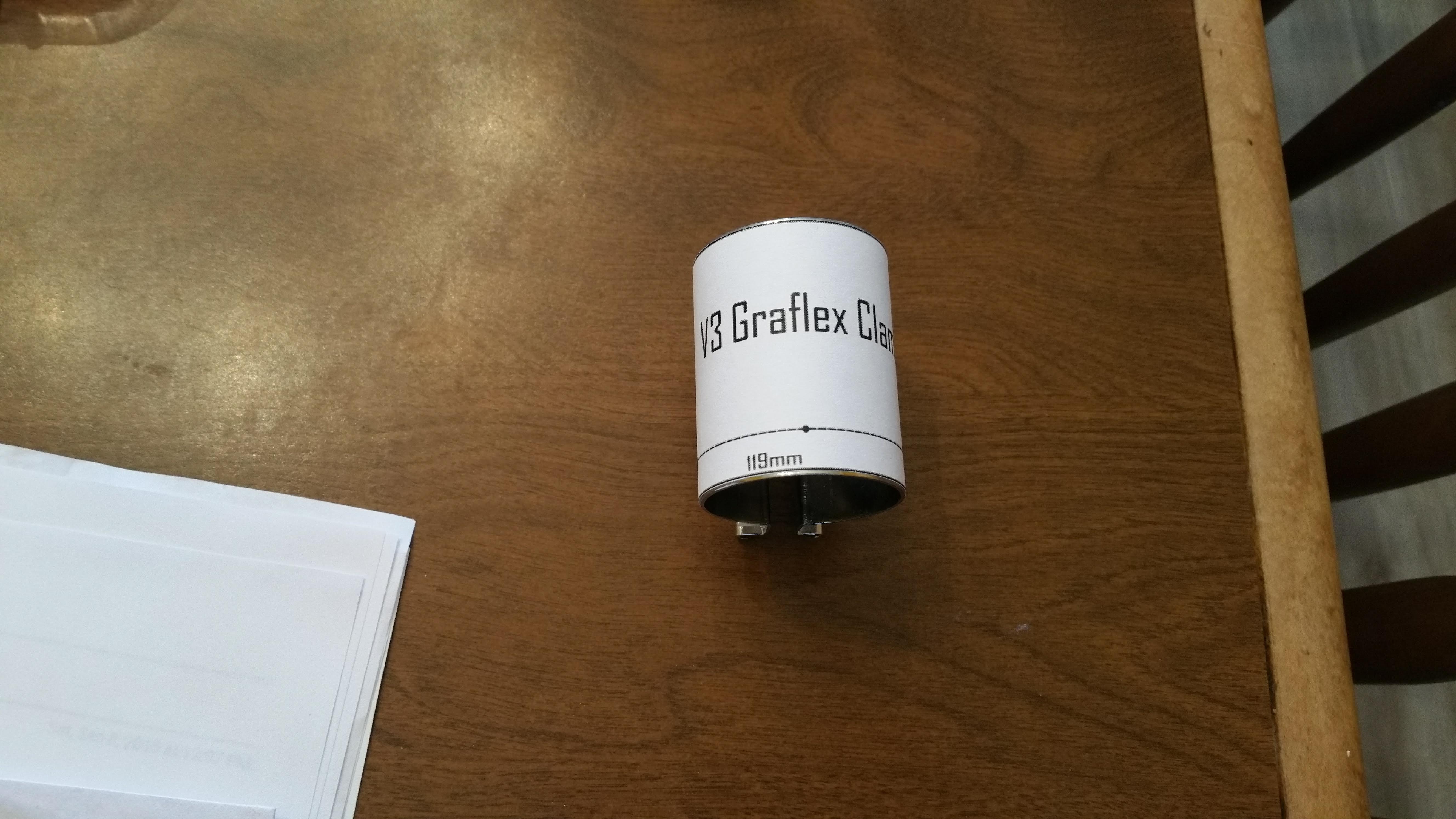

I got the V3 template on my TGS clamp! The clamp is a little wider than most, but it lines up perfectly with the hole when placing a little extra template on the right(?) side. Now I just need a little bit of handrail to center punch, pilot, and finish. I'm gonna get one of those stepping drill bits. Thanks to Trooper_Trent and Halliwax. I also got the inward tabs ground off with my dremel.
Excellent! So now we know it fits a vintage, romans, and TGS perfectly!!
