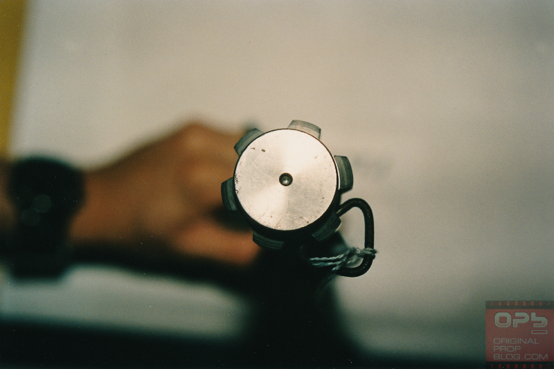

Also heres another archive photo of the bottom. I dont really see the raised ring around the hole, but eh... its easy to remove if needed.
Rare-LFL-Lucasfilm-Archives-Movie-Prop-Lost-Photos-Star-Wars-Indiana-Jones-Historic-Visit-Orig...jpg
Kylash: in that pommel photo you can see the faint ring. However I do agree it does not have the appearance of a raised surface texture. Again, I think it is a chuck slip marring / scratch.

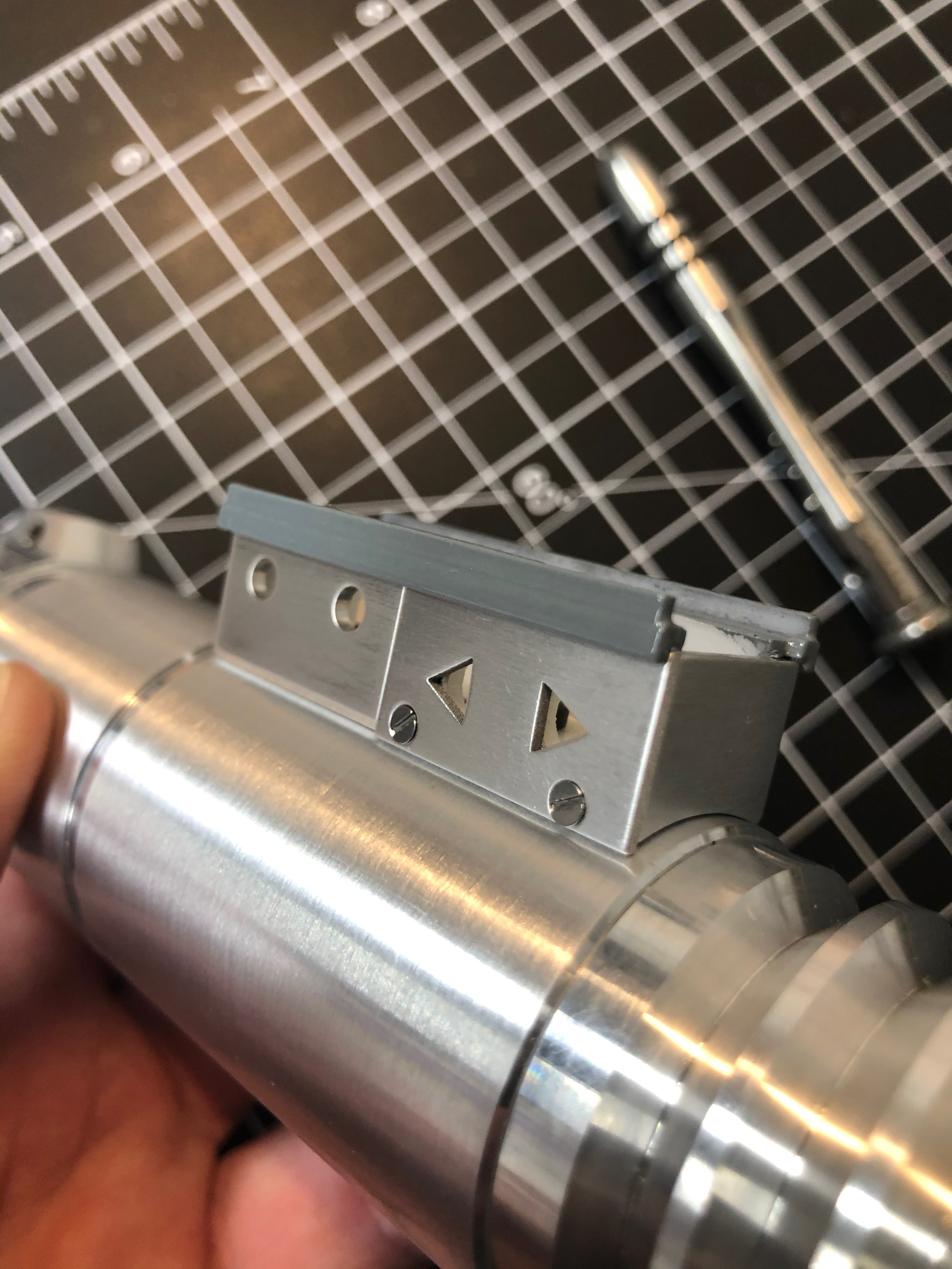

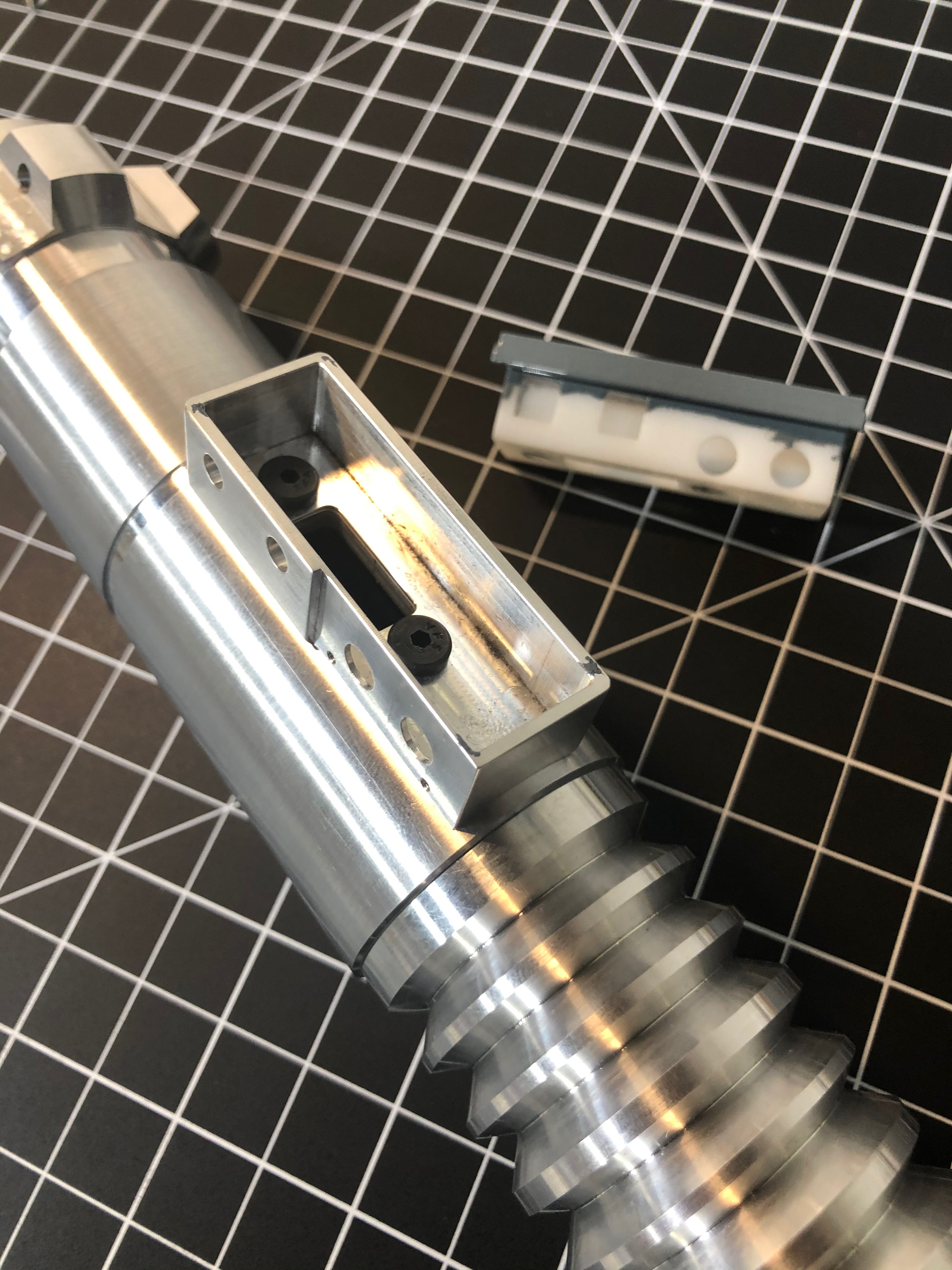

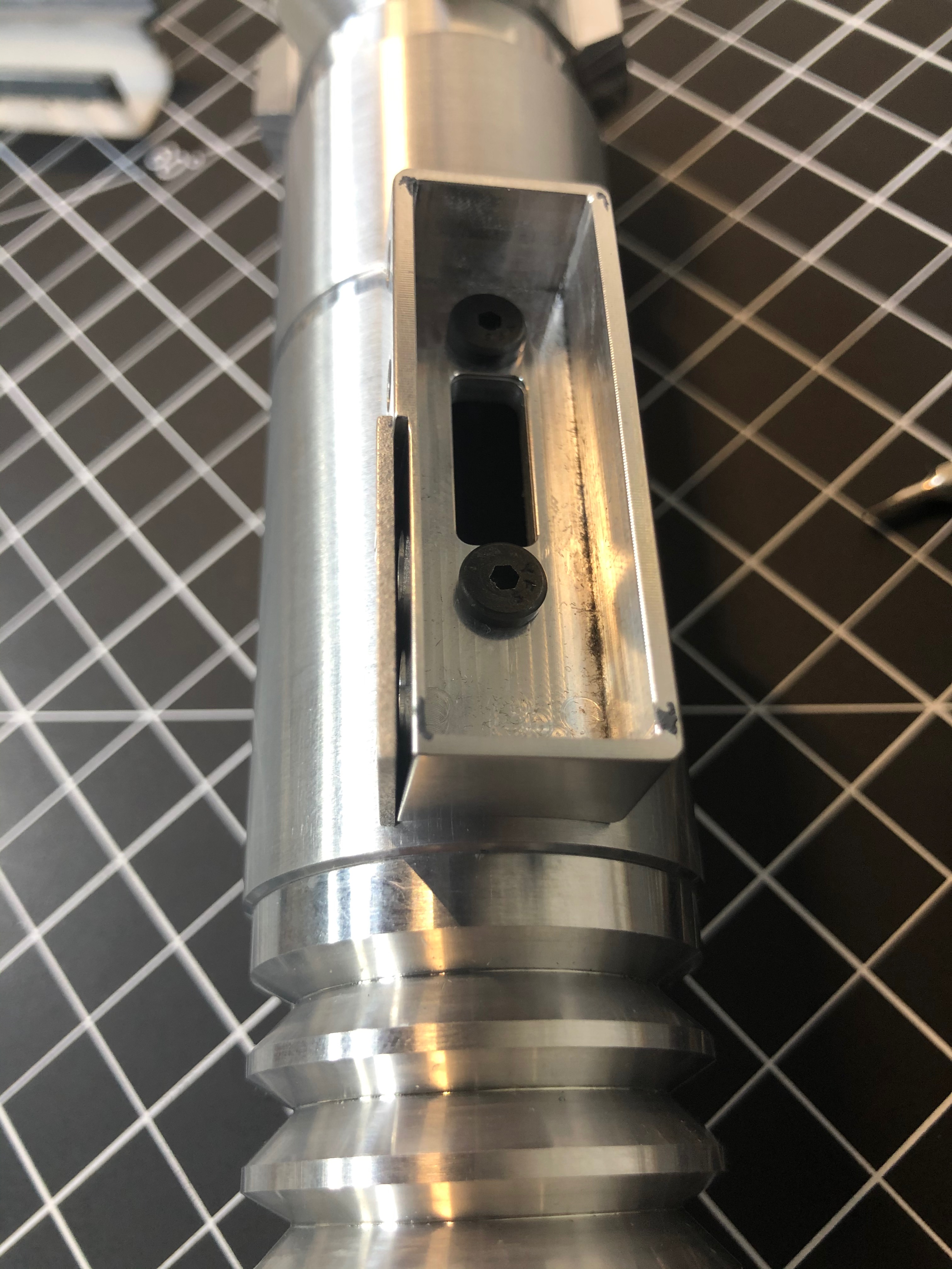

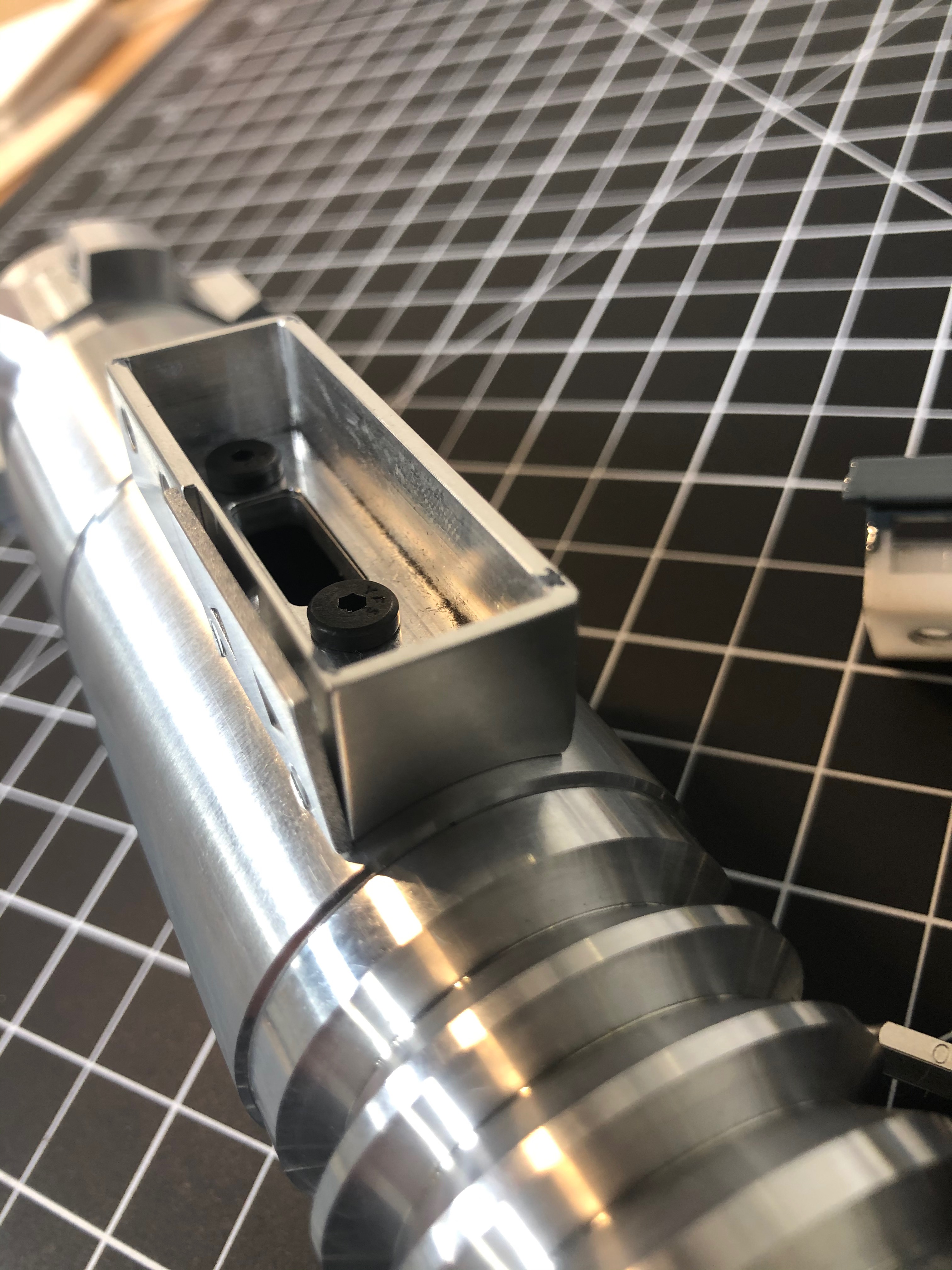

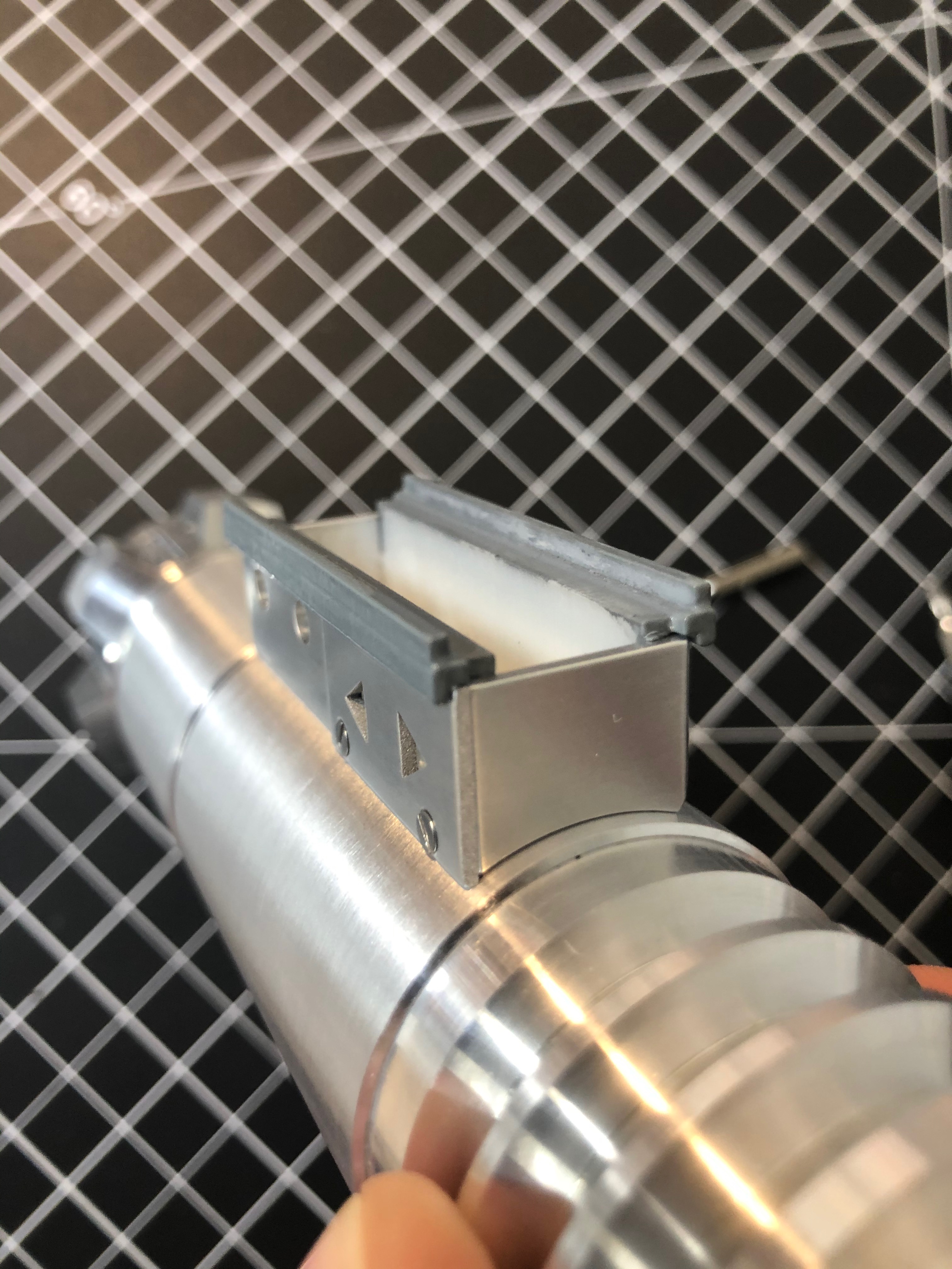

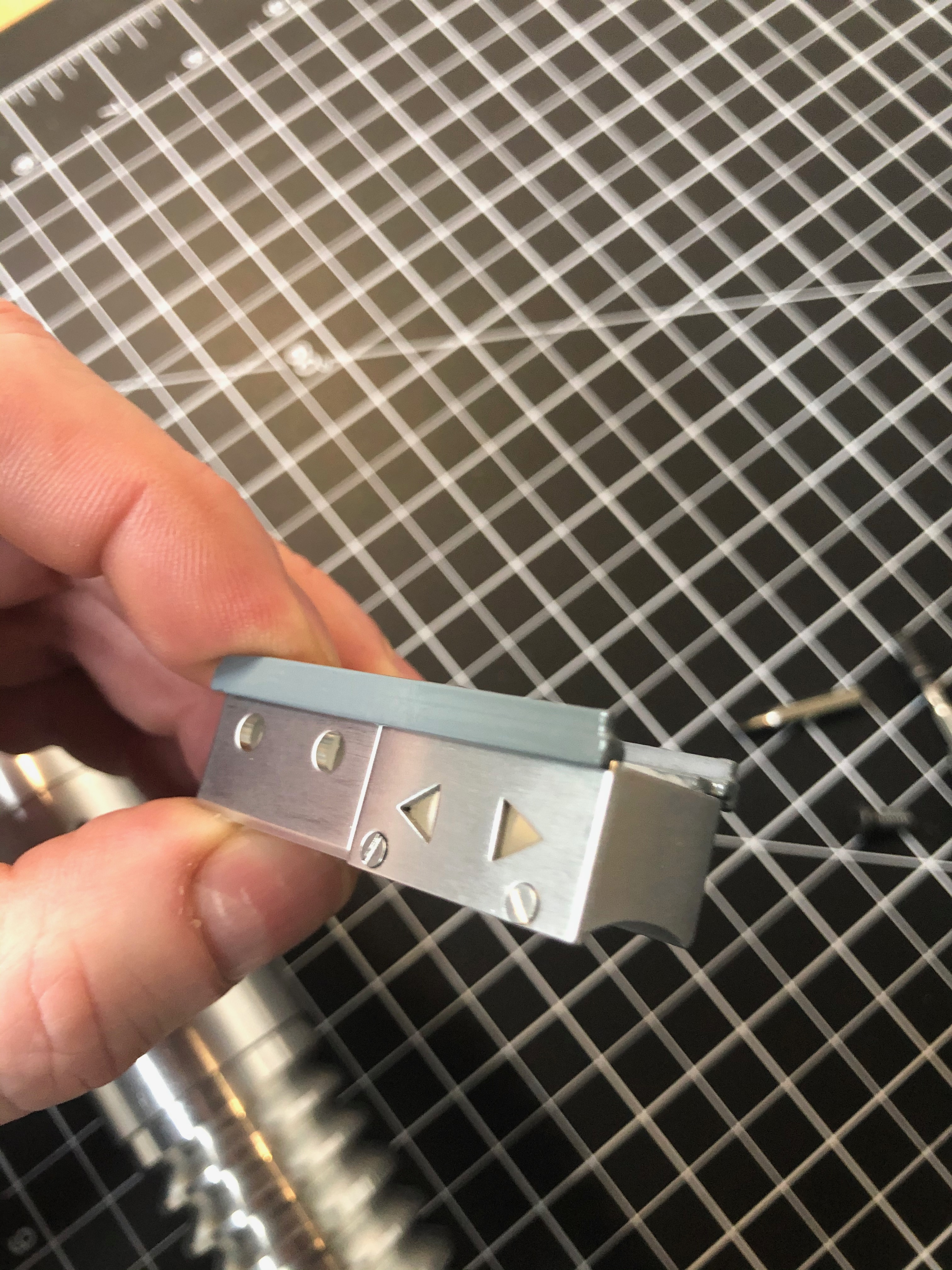

Here is the control box minus the plastic "canoe" mounted on the hilt:
Then I lightly tightened the arrow plate screws, allowing the plate to slide up a bit:
Then I tightened the screws to almost tight, as you can see the top of the arrow plate will bow out a bit:
Then I took the whole assembly off the hilt and snapped the "canoe" in place, which brings the top of the arrow plate back in:
Then I mounted the whole assembly back on the hilt and lightly tightened the arrow plate screws. It will sit pretty flush with just a tiny gap at the front of the control box. I'm sure I overcomplicated it, but it worked for me this way.
