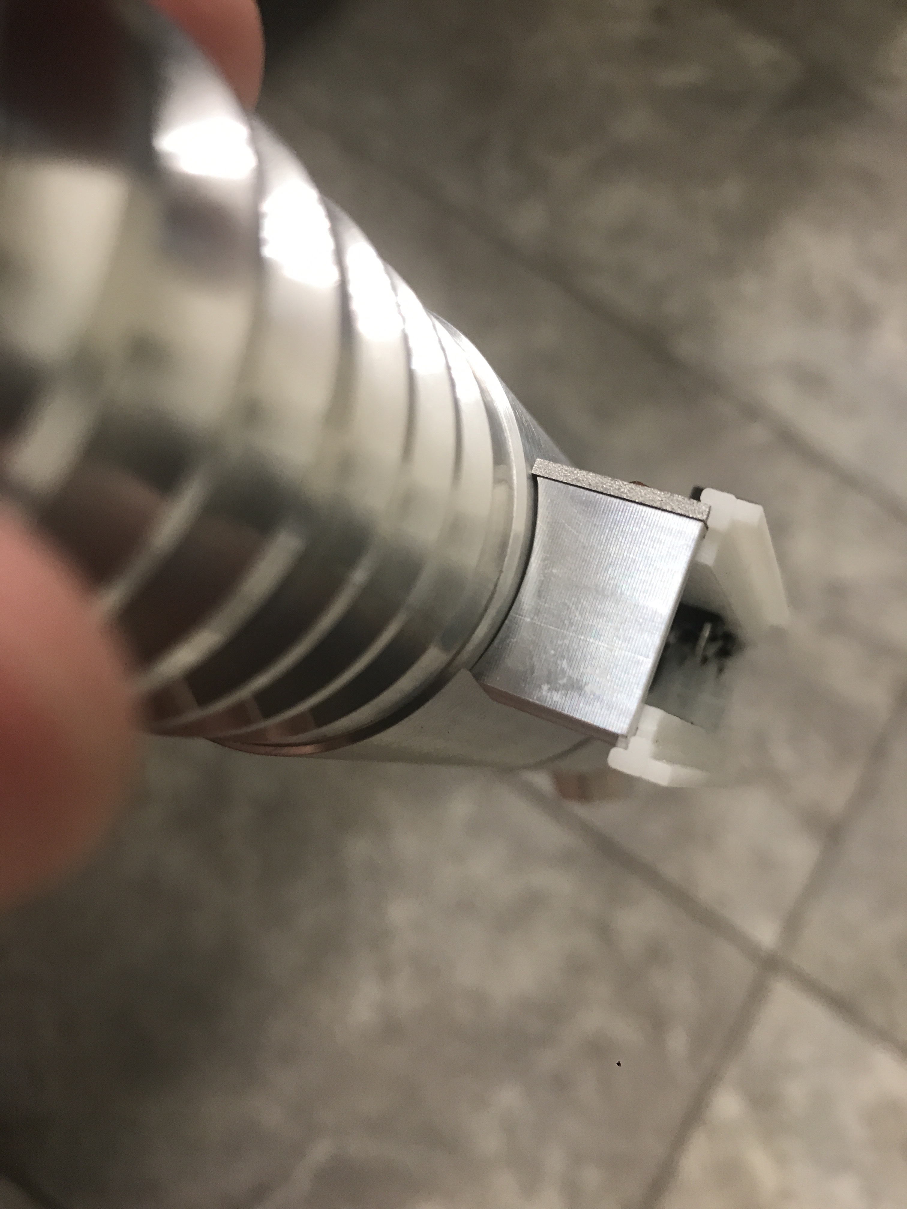

Beautiful work! Does the arrow plate need to be filed with a small angle on the back to get rid of this gap?
Going to sound like a noob here, but any suggested tricks to cleanly tape off the bottom of the emitter and prevent getting the Ace Antique Gold spray on it (VV Hero for reference)?
No filing needed. Screw the control box (without the plastic "canoe") flush on to the hilt before you put on the arrow plate, then attach the arrow plate by lightly tightening the arrow plate screws. This will allow the arrow plate to slide up enough for a flush fit on the control box. Once it is flush you can slowly tighten the arrow plate screws, but the top will bow out slightly. The tension of the plastic canoe will pull the top of the arrow plate back into place.
I gotta say I’m a bit lost on this explanation?

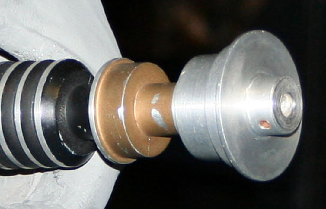

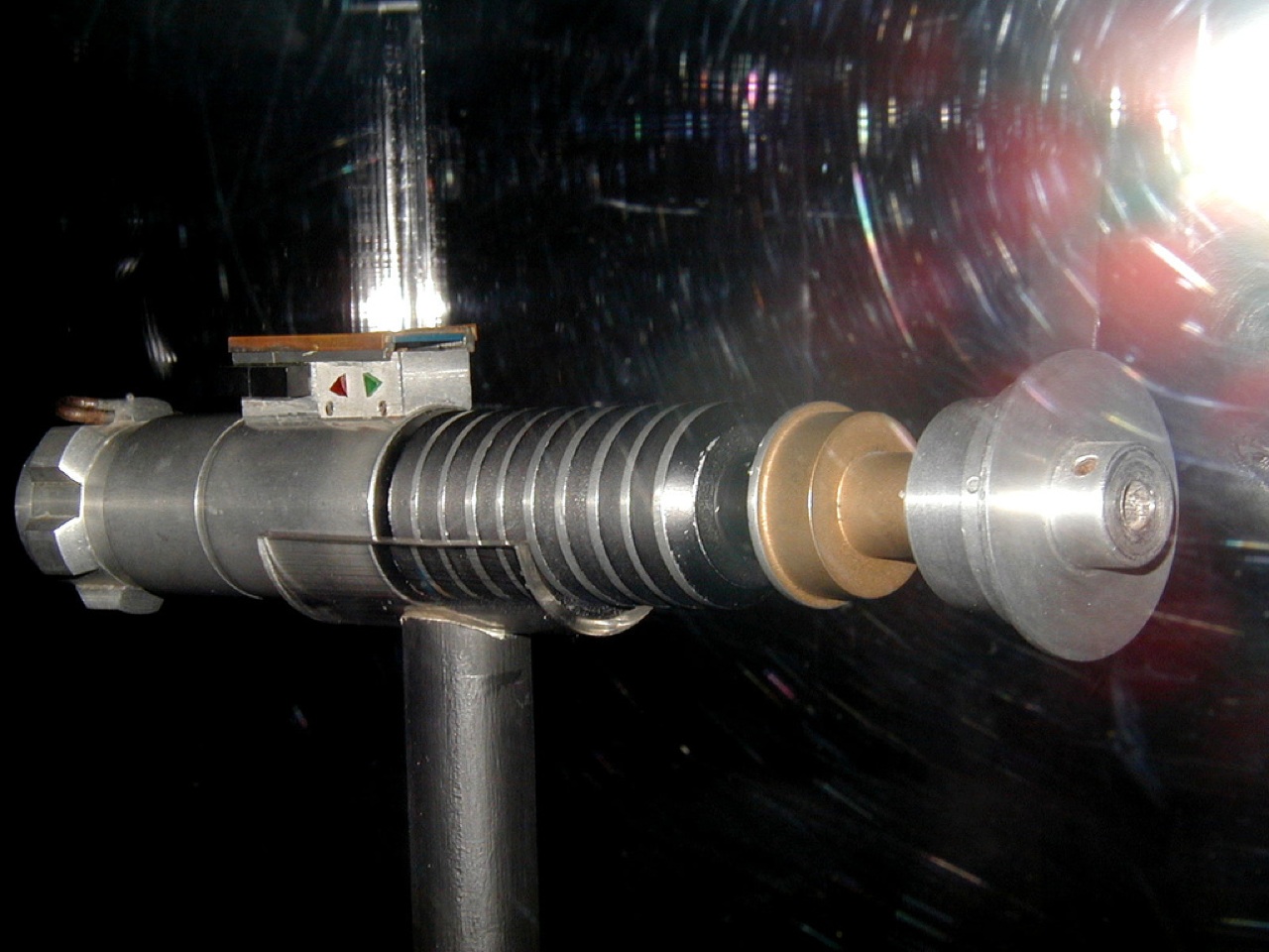

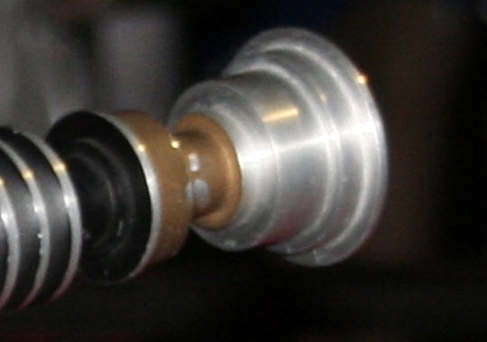

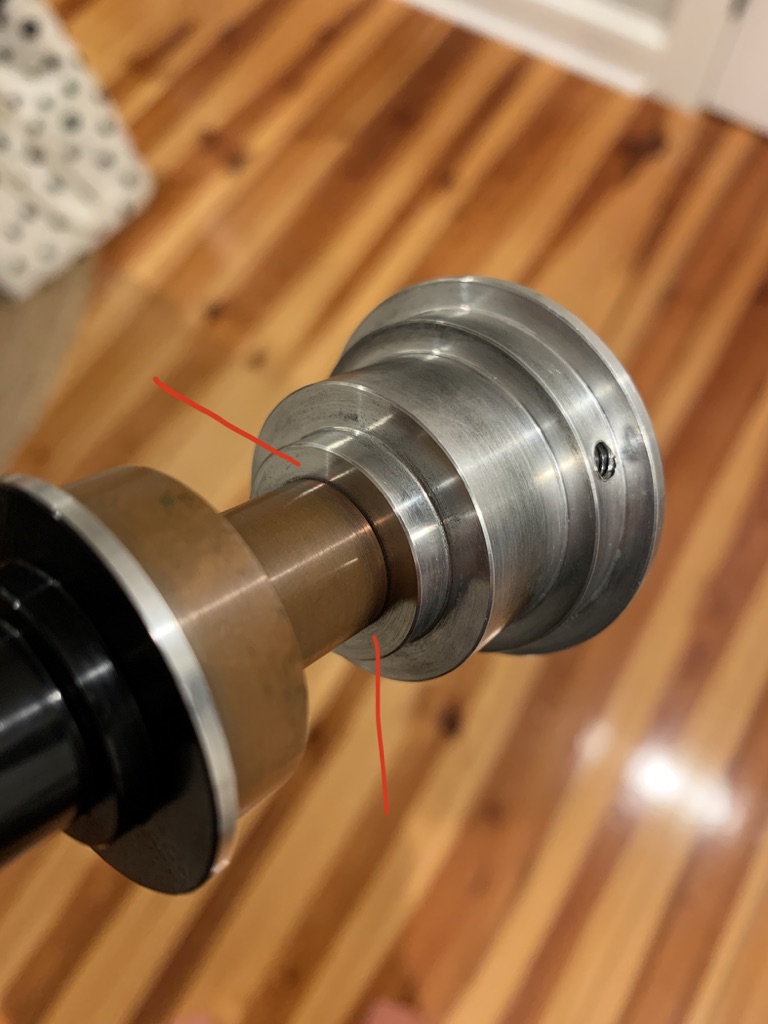

Okay, then. I suppose I’ll just sand off the pommel hole’s ring in the meantime, since PrinceZip confirmed that it’s not on the actual hero. Probably just a chuck scratch, as BRRogers speculated. I also knocked back the machining marks between the pommel cubes. While I don’t doubt Anakin Starkiller’s assertion that they’re there, they’re not visible in photos, and so they stand out a bit much in person. I’m going slightly idealized, rather than replicating every nick, scratch, and (in the case of the tour photos) paint chips.
I beg to differ...
I beg to differ...
there is absolutely a ring there. BRRogers and I just happen to disagree that it is raised. We believe it to be a chuck slip which marred the surface.
if you have definitive evidence to prove otherwise I'd love to see it actually. Everything we have found suggests a chuck slip mark. It is definitely there but not raised in our opinion.
