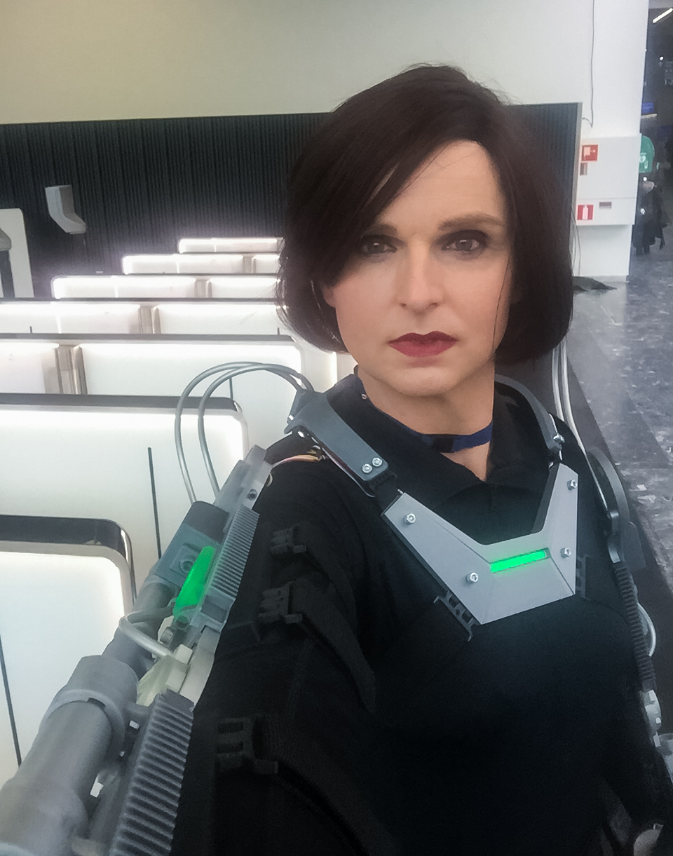

I caught up on sleep between Thursday and Friday and then pushed again to get a costume ready for Saturday at Worldcon. It wasn't entirely easy, but in the end I had a good build with the screen menus and voltage display working on top of the animation code I had copied from the sword project.
I had a blast cosplaying at Worldcon75. At the moment, I only have photos from my iPhone and DJI drone. Here's a shot from my iPhone. You may be able to find some photos (and video) taken by others posted on the web in the near future.
The suit did pretty well in most respects. The connector on the right arm was a bit choppy at times and the connector was going deeper into the armor each time I adjusted it, so in the end I couldn't even plug it back in (and my allen key was in the car, so I didn't fix it). Battery life was superb on both the armor and the sword with the LiIon on the armor at 3.9V and the sword at 3.8V after around 8 hours at Worldcon.
The sword also developed some connection issues between the LED strip and hilt, but those were relatively minor and could be fixed without an Allen key. As the blade flexes, it tends to pull the LED strip away from the connector. I can try using more of the 3M adhesive under the strip (at the moment only a few cm is used, so it doesn't hold that well). Replacing the connector with something that locks would be more work than I'm willing to do now.
The joints need a bit of lubrication as they were becoming a bit sqeaky towards the end of the day. The elbow joint tends to pinch my arm if everything isn't perfectly aligned and I try to reach up to adjust my hair or take a drink etc.
I think the costume worked great even without the legs, but I'll certainly do my best to have some version of the leg armor at DragonCon. Movement with the leg boosters might be a bit more cumbersome.
Oops, the second uploaded photo got posted accident. It looks a bit funny as a thumbnail, but it's not a bad photo (and I can't figure out how to remove it).

That came out really cool. Seeing the pieces was interesting, but seeing it all together on someone really makes it stand out. Do you still plan to do the legs?
Thanks. I'm pleased with the results so far. It has been a lot more work than I expected (but that's true of most things in life – optimists do thing because they expect the road to be easy while pessimists never even start because they know long it is going to take). My Fusion 360 skills are far beyond what they were when I started and I learned quite a bit about building electronics too.

Here's an elevator mirror selfie from WorldCon75. I added some grain and vignetting and adjusted the exposure & contrast a bit to make it a bit more gritty.
Brilliant work. I'm actually surprised PLA is standing up to that much flex without breaking - but your prints look incredibly finished, are you using these as they come from the printer or are you smoothing them and painting?
