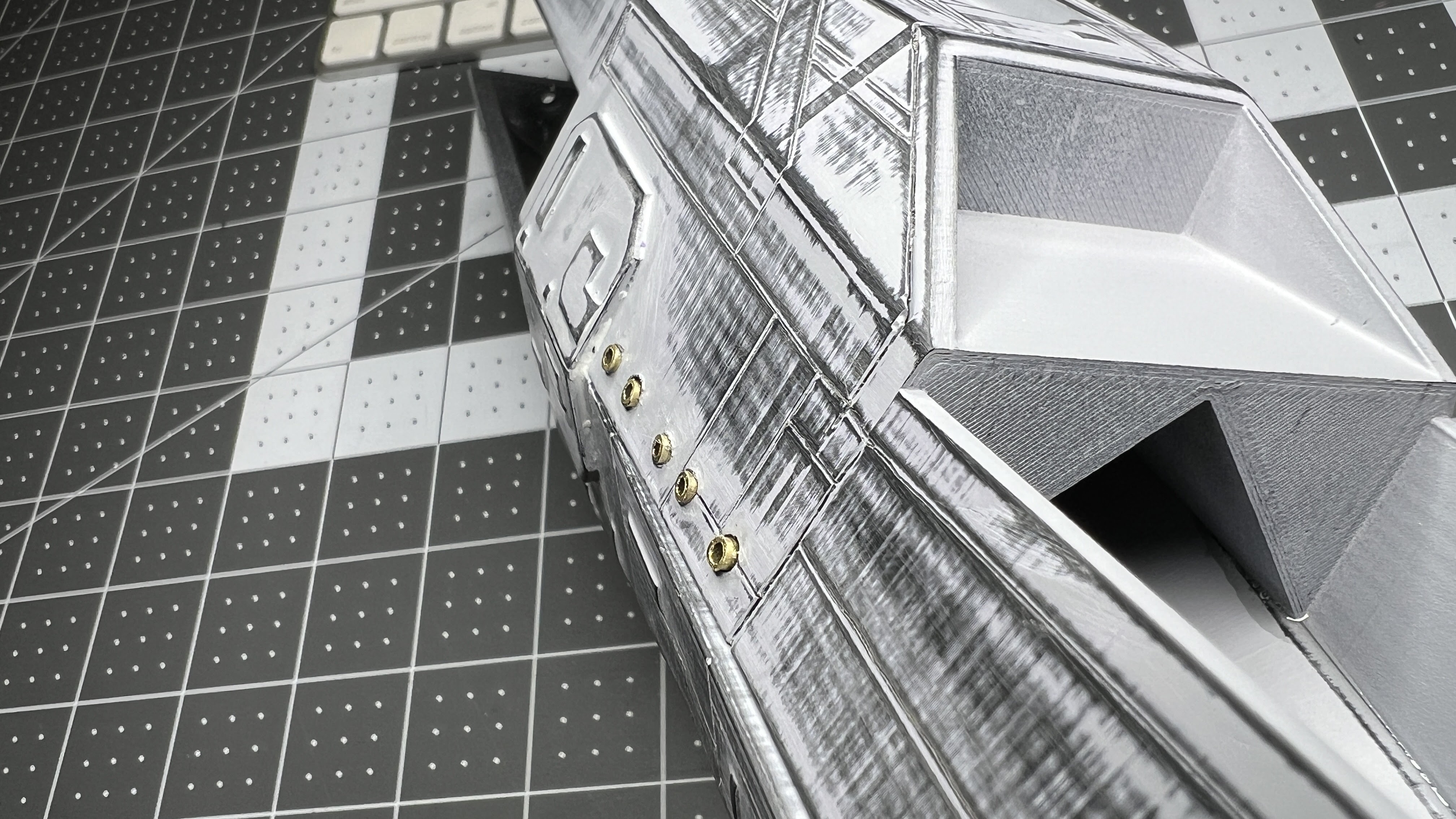

In the meantime, I drilled out the holes in the fuselage:

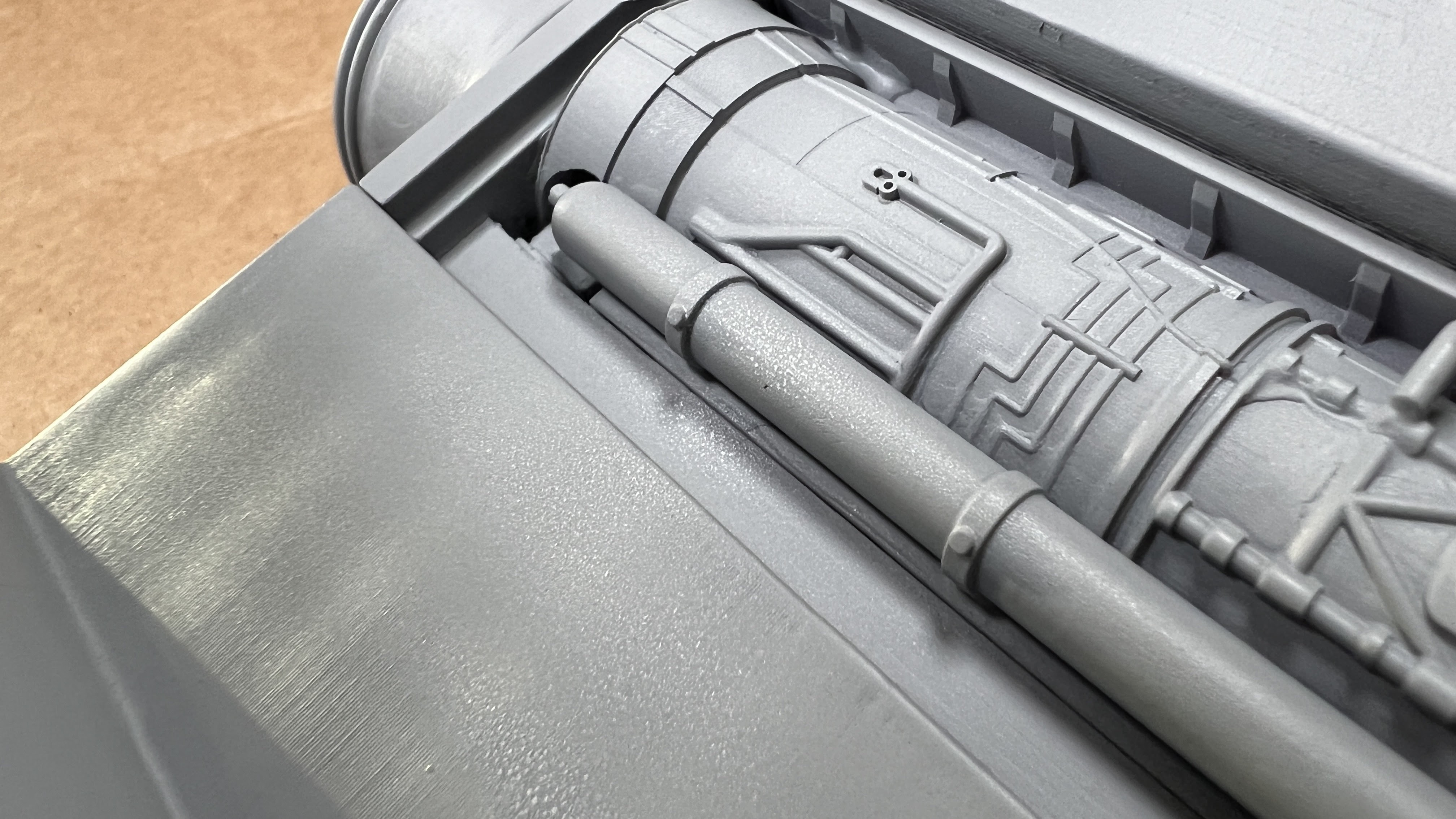

I also glued the gun shrouds on. I know that I said that I was going to leave this until the end, but I just couldn't resist. I made sure that they were oriented correctly to the rest of the cannon body and then hit them with some CA glue. Almost a shame to cover it with paint...

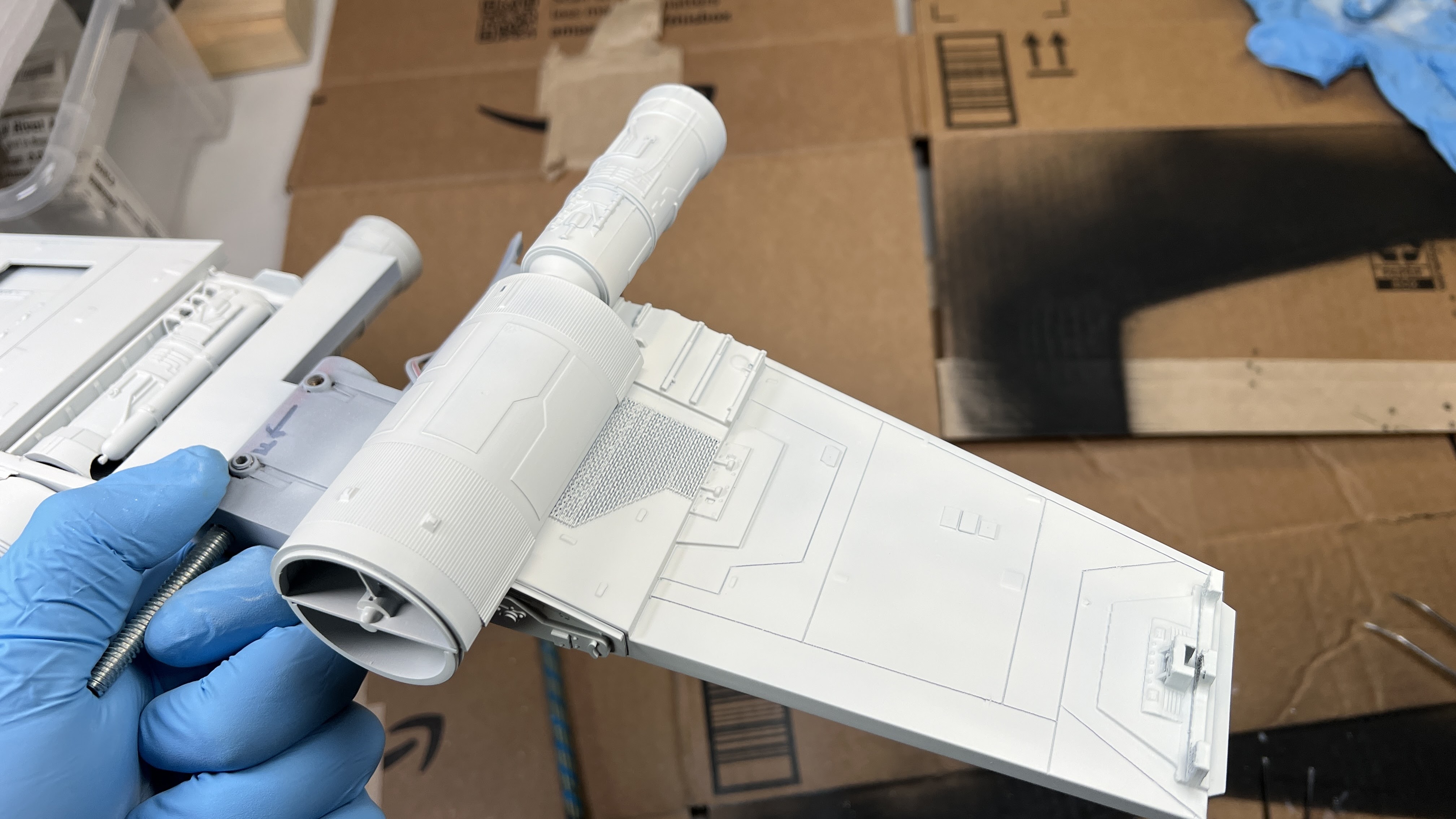

Had some warmer weather this week, so I went out and hit the wings with some primer. It's amazing how just a hit of primer pulls it all together. All of the resin parts, the brass, the FDM printed parts, etc... It's really cool! And it gets me jazzed about getting a base color on this thing!

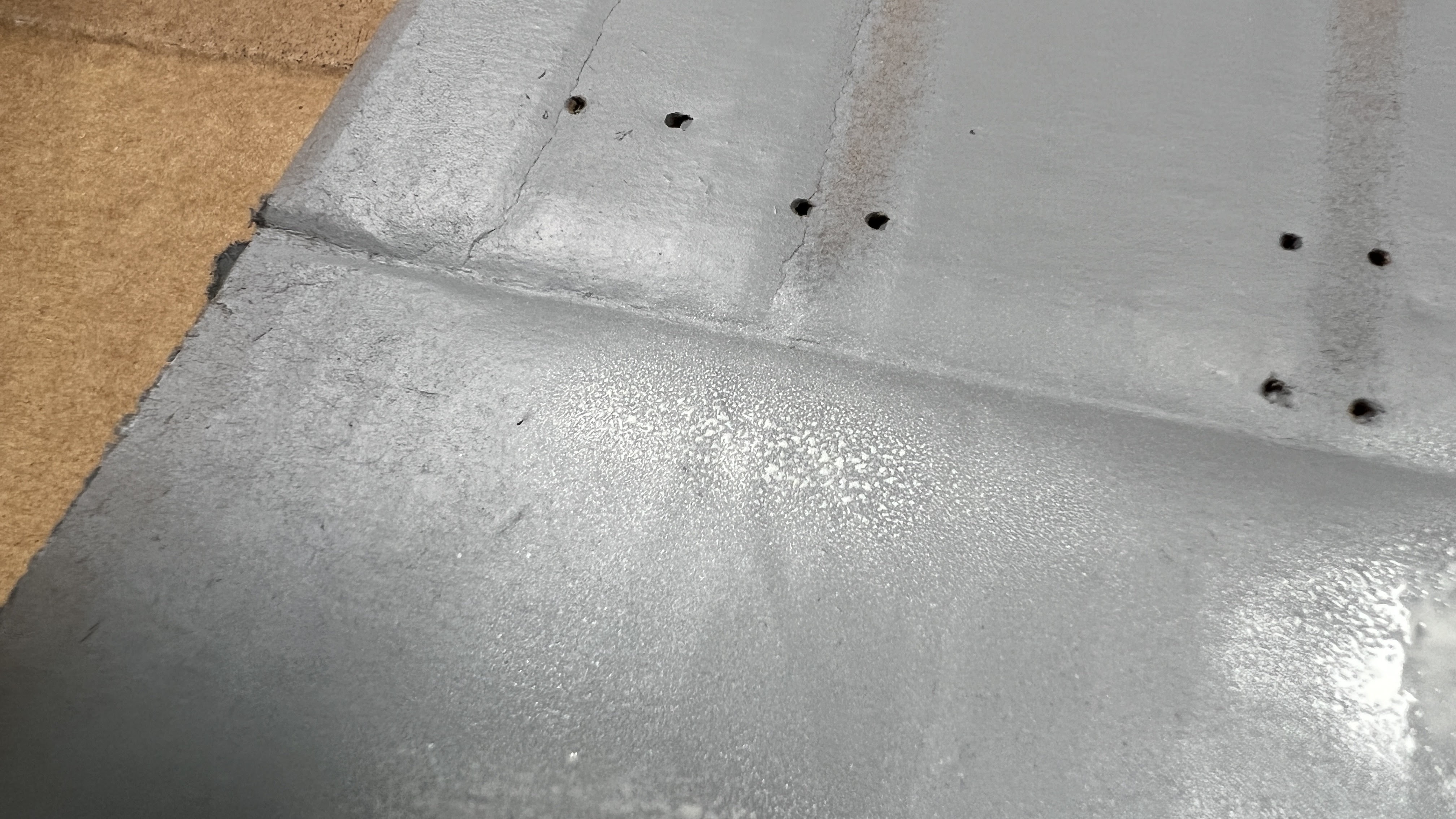

Goes on splotchy and beads up everywhere. SO, I tried AGAIN, with even less thinner:
Same thing again. Splotchy, and it definitely still looks too thin. (Don't worry, I immediately wiped the wing off after I took this photo). Grrr.
I have read up a lot about these paints. I know that they are thick, I know that you need to shake them forever, etc... I'm not a painting n00b. I've been airbrushing for years. Built many models with Model Master enamels, Tamiya acrylics, Vallejo acrylics, etc...
But I need help here. I'm stumped. My air pressure is just about 18 psi (I usually shoot Tamiya around 15 psi), I have tried thinning it in varying amounts, all to no avail. I really wanted to give this paint a shot on this model, but not if it's going to behave like this! :mad:

Your X-wing looks amazing! I've used some Archive -X enamel paints in the past, and yes they are extremely thick. You should think of them as a concentrate. You'll need more thinner than 50/50, though I don't remember what I used. If I need more thinner, I just dump more into the cup and remix it until it sprays the way I'm looking for.
That said, the bubbling looks weird to me, is the AX thinner an Archive X product? Almost 30 years ago I tried thinning my first ever bottle of Tamiya paint with water, and that's what it looked like.
Thank you! Yes, these paints are extremely thick. I actually posted on the Archive-X FB page asking for some advice over there, and they said that 50/50 is waaaay too thin. So I found some small cups and just dumped in a whole bunch of paint, and very slowly mixed in some of the AX thinner until it had the consistency of whole milk. I then spent last evening spraying the model with the base reefer white, and it looks okay. I kept getting paint drying in the tip of the airbrush, which caused some splatters in a few places. Today I am going to disassemble my airbrush and give it an ultrasonic bath, and then finish hitting the wings and fuselage with the base color. It didn't cover all that well, even for how thick the paint is, and I almost went through an entire bottle of reefer white. Is that normal? There's a lot of surface area on the X-Wing, yes, but it took over an hour of painting just to get somewhat good coverage on the base coat. I forgot to take photos of that though :rolleyes:
Anyway, I suppose that as I work with these paints a bit more, that I'll get better with them. I just really like the Tamiya paints because I can thin them with IPA, which helps them dry really fast. By the time I'm done cleaning my airbrush I can usually unmask the part I just sprayed and it's already dry to the touch.

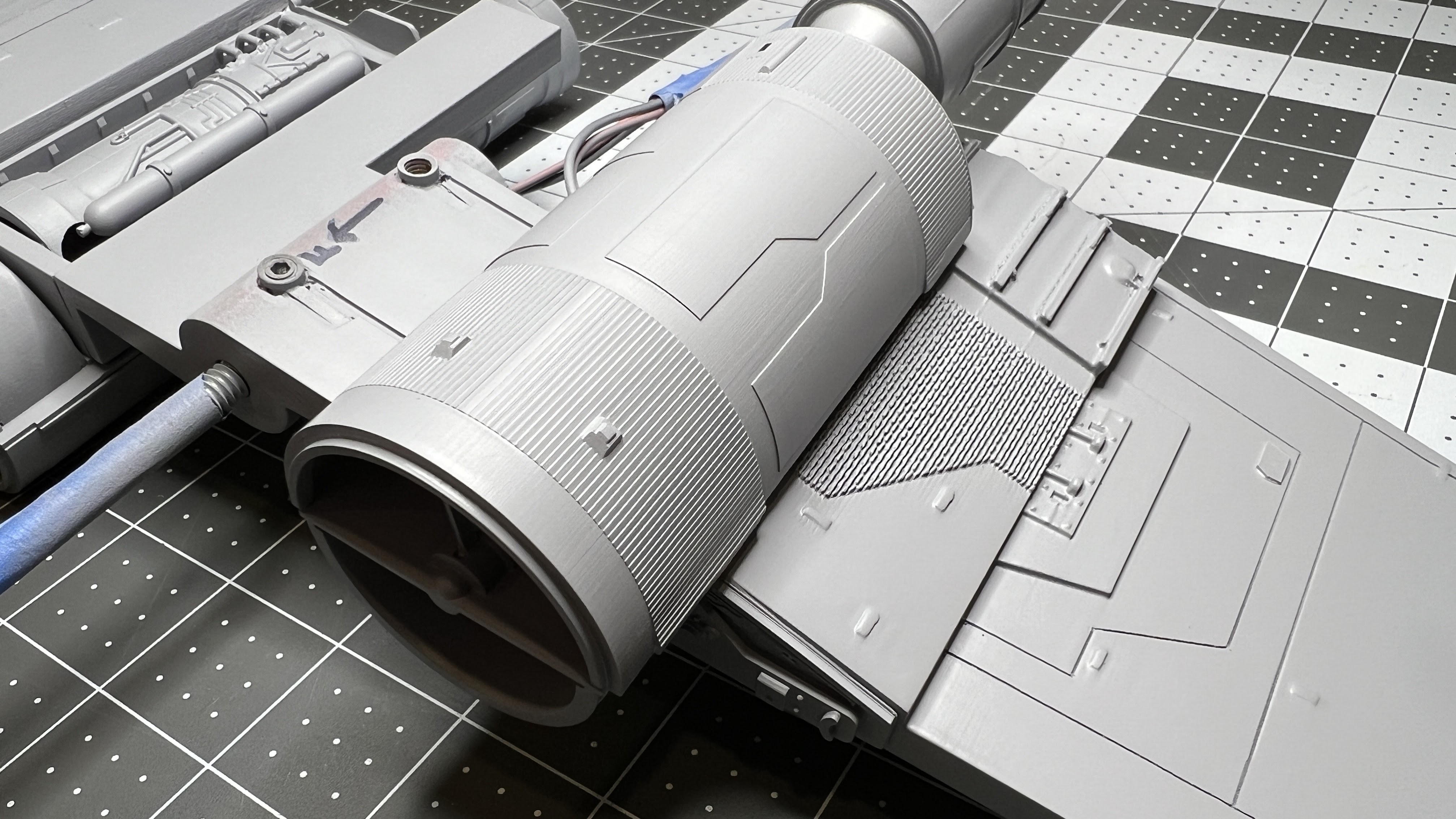

Little update this evening. Base coat with Reefer White. You can see a few splatters here and there. Hopefully those'll blend in a bit with the rest of the weathering once it's done. The white looks pretty warm here due to the evening sun coming through the window.
And two photos under artificial lights with a 5600K color temperature:
Weather seems to be good for the rest of the week, so I need to prime all of the smaller parts (nose cone, exhaust nozzles, cannons, etc...) and get those painted as well. I should probably go over these parts again with the Reefer White color. Now that I'm looking at these photos, I can see a few spots where coverage wasn't too good.

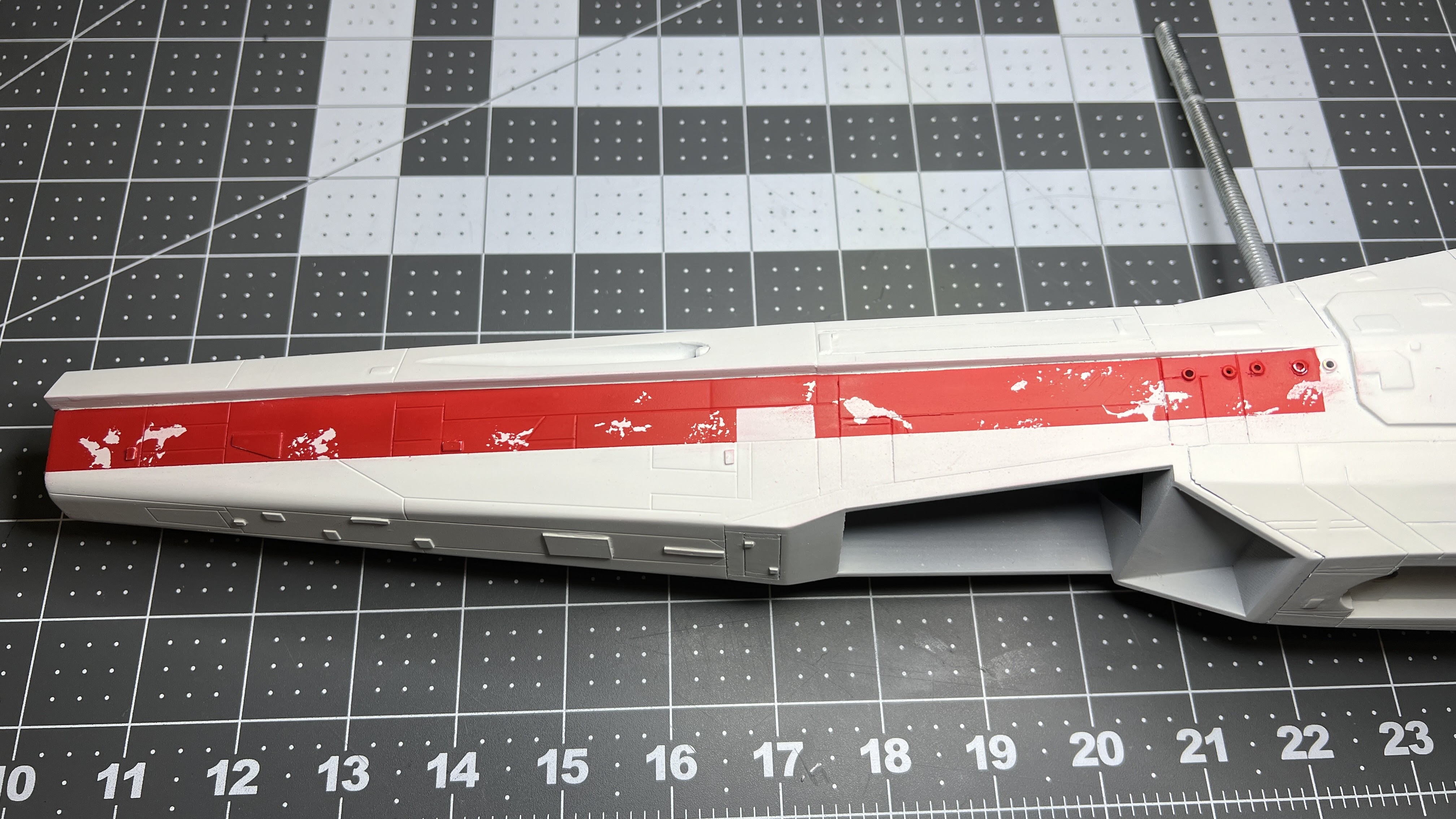

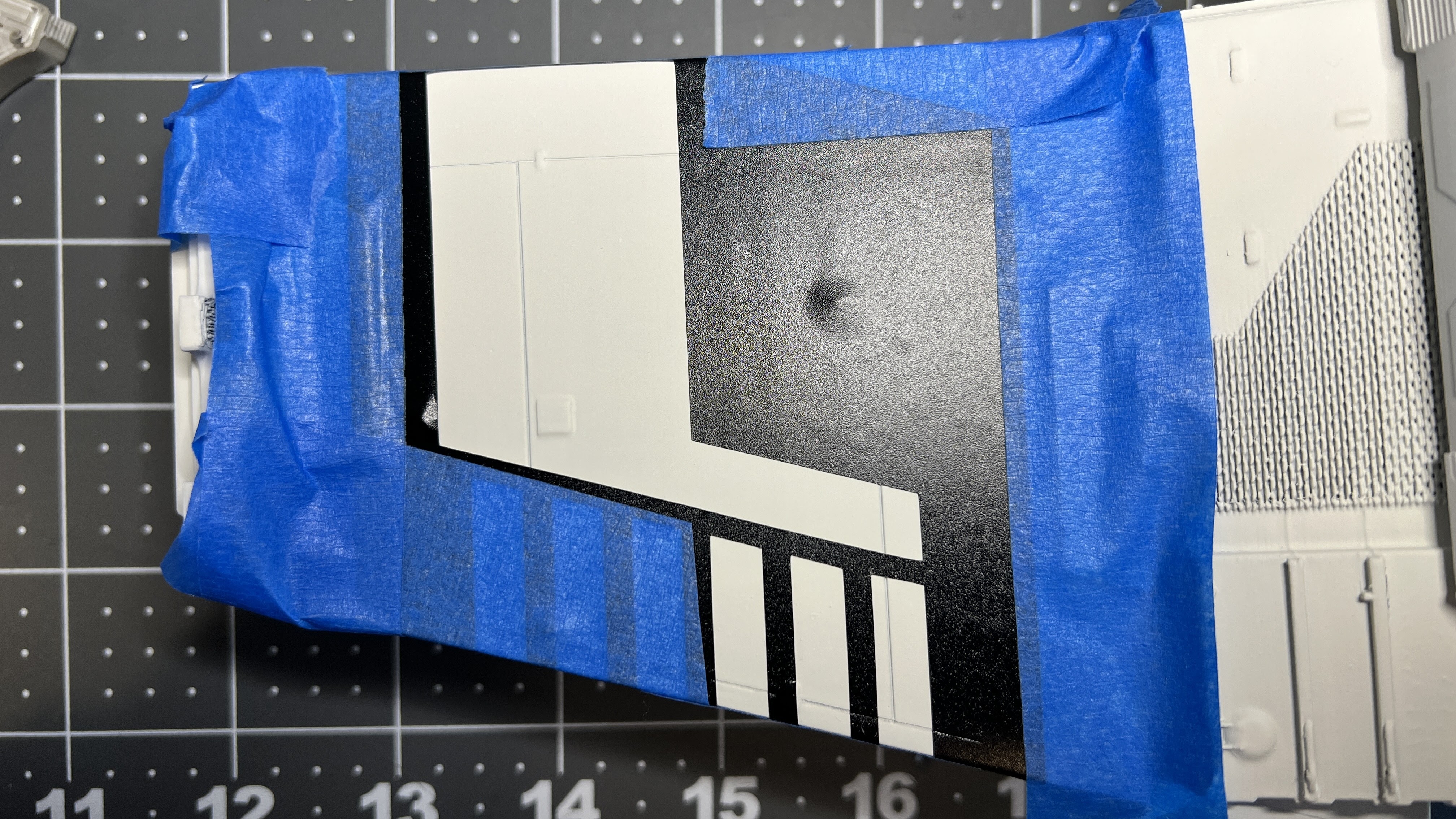

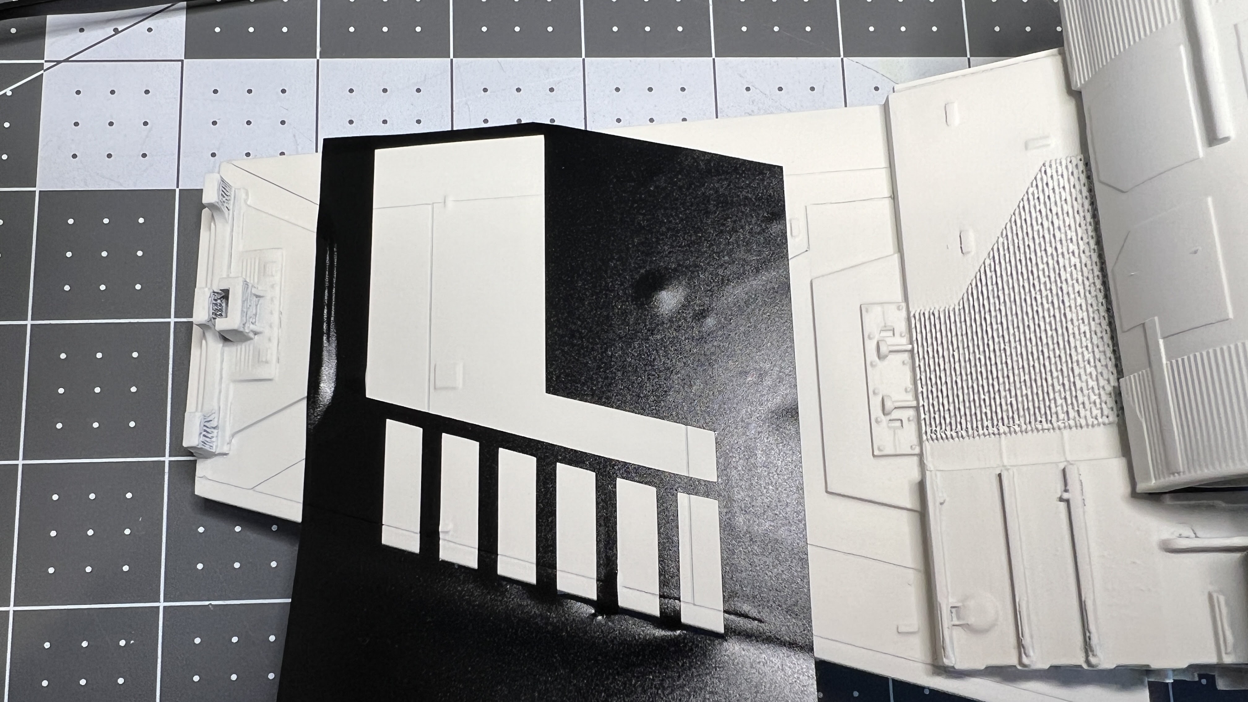

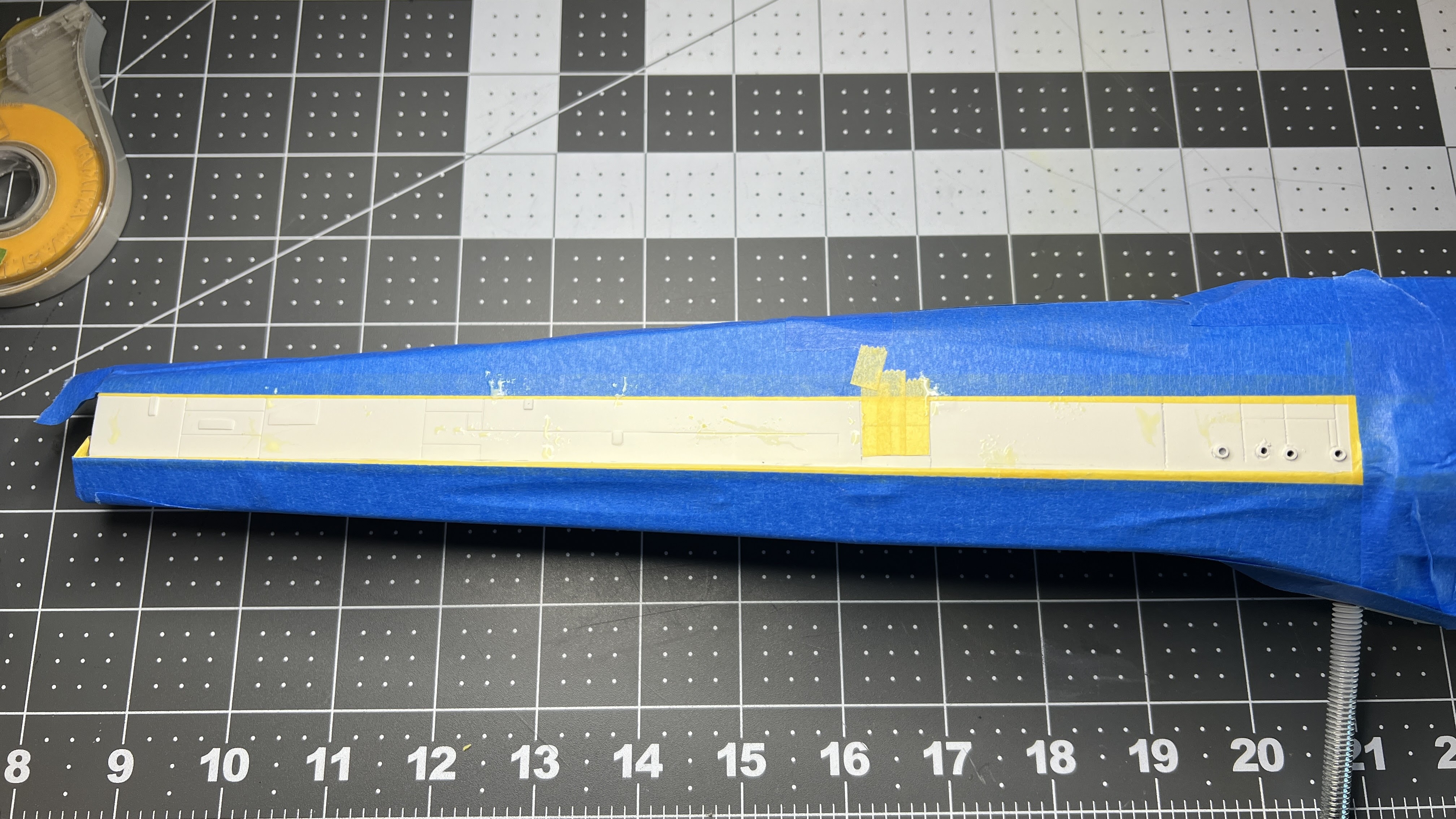

And speaking of that, I got some color on this bird finally! I was really looking forward to this, because I had made up some stencils in Adobe Illustrator for the wing markings, and cut them out on some low-tack vinyl on a Cricut machine. It almost feels like cheating! :lol: Instead of spending hours masking these markings (am I just slow?), I was able to apply the stencil to all four wings in maybe a half an hour!
Masking off the three stripes:
Masked off fuselage. I also went in and looked at reference and applied liquid mask (with a ripped sponge and a plastic pencil-looking thingy) where appropriate. It's definitely NOT exactly how it looks in the reference, but it's close-ish:
Then I put on my big boy pants and mixed up some Caboose Red for the markings:
Success! :D The vinyl masks worked perfectly, didn't bleed around the edges, and came off perfectly! This is definitely how I'll be doing these from here on out!
And some fuselage shots:
Super happy with how it's coming along, paint woes and all. I have seen this called the "Clown Car Phase," and that's completely accurate :lol:. Tomorrow I will be masking off for some more colors, and keeping that bottle of liquid mask close! Red 3 seems to be more chipped up than the other X-Wings in Red Squadron (although I could be wrong). Can't wait to get some more color down! It has really come alive for me now. It's not just the primer gray color that I've been staring at for so long!

Vinyl masks are definitely a time saver and they turned out perfect!
That was always the most tedious job when painting the X-Wings.
