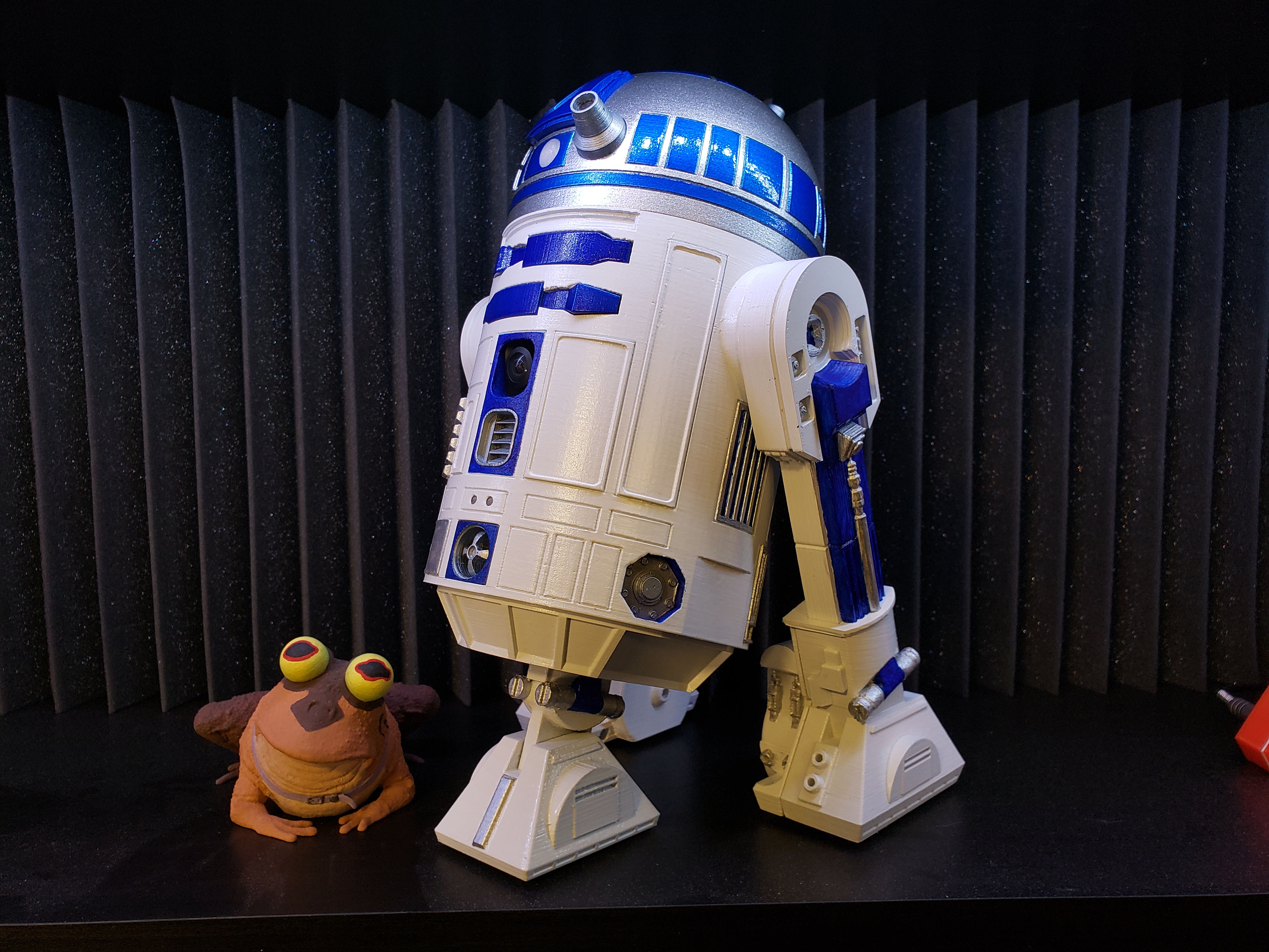

Just a progress update, here's all the versions I have so far, I decided I would get this 100% as a robot, then go through the excellent feedback I've received here and do a V2 that's screen accurate. The versions you see on the table: closest one is for a how-to vid, painted one is the demo, furthest is the hacked together development version (the logo on the back of that one is for the company I work for, wacky toys are my shtick around the office, final isn't watermarked anywhere). I'll release the V1 models hopefully next week along with a 'how to' video, code, and a shopping list so you can get it running. It's about $200 all in, which I think for a real AI drive R2 is a steal.
