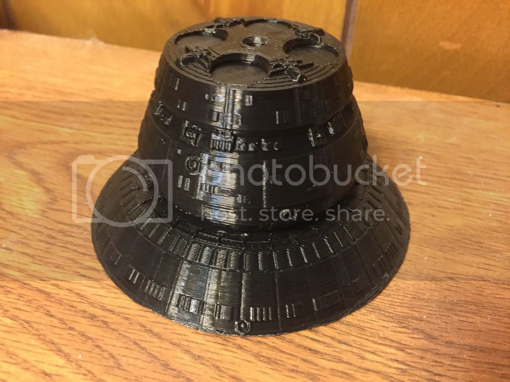

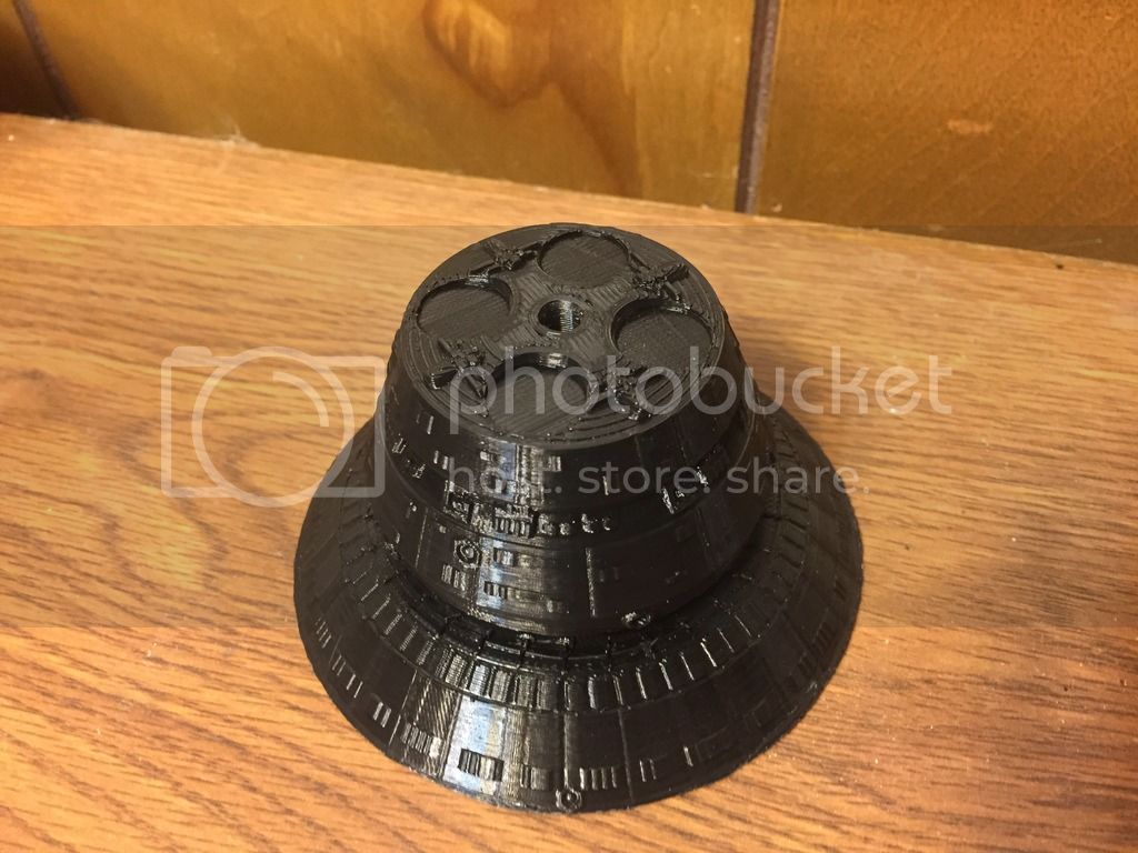

I got the piece printed that's called the "collar." It's the piece that goes on the back of the sphere and kind of tapers that piece back into the overall shape of the rest of the ship.
The collar printed really well, and it showed me that my sphere actually had a VERY tiny bit of warping on one of it's sides...not really noticeable and I was able to sand it out so it seemed to fit just fine.
One thing I'm noticing about this section of the ship, from this model and from the reference pictures I've been using online is that the command section of the ship almost looks as if it was designed to detach from the rest of the ship at some point in time...like the sphere could be jettisoned from the entire thing. I've not watched the movie in YEARS, so I guess it's possible that this is actually mentioned, or possibly mentioned in some publication about the film, but it just looks as if that's the case.
When I'm assembling it, I'm not going to use a ton of epoxy around the edges of the collar/sphere because of the fact that it appears to me like it's designed to come apart if it were an actual ship...the fit will be tight enough that it won't be noticeable, yet it will leave it "separated" enough that you'll be able to tell they are two distinct pieces. I feel that if I use epoxy around the sides of it, that some of the epoxy could seep out to the very edges and give it the appearance that it's one solid piece, which seems to go against the reference photos. It doesn't help that reference photos of this section of the ship seem to be primarily from OTHER models, though...as most of the angles of scenes from the film I've found show the Discovery from a 3/4 angle from the front, so the area where the sphere actually makes connection to the "rest" of the ship is hidden by the shape of the sphere itself.
I also tonight was able to get a good print from the three cargo modules, and actually assembled one to make sure it will go together well. I think it's going to work out just fine.
