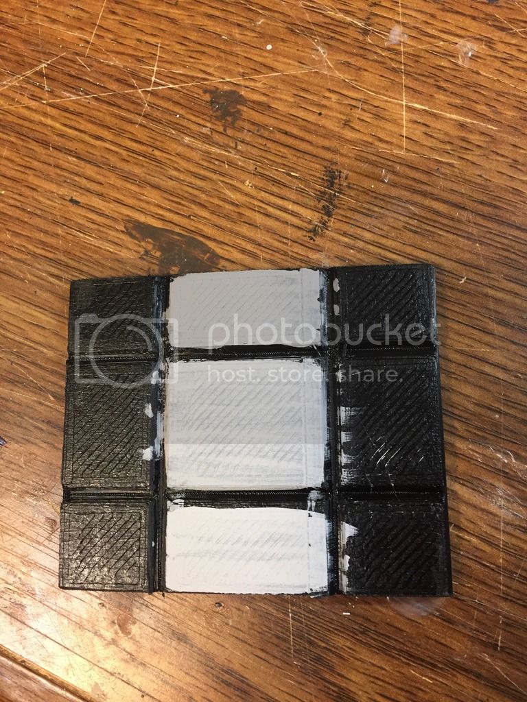

Here are the paint colors I've mixed.
The top is just gray, the middle is 1:1 gray/white, and the bottom is 1:2 gray/white.
Im leaning towards using the 1:2 mix, but I'm open to suggestions. Should it be even lighter?
Difficult to be definitive given the vagaries of photos and monitors, so go with what looks right to you. Just keep the variations small, using a limited range palette.

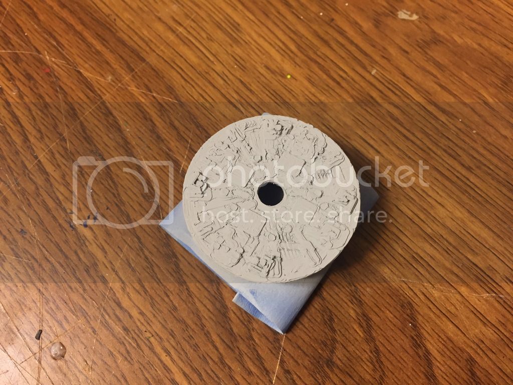

Anyway, I started by painting one of the pieces that will mount to the back of the collar piece. It turned out pretty well.
That tape underneath it was to hold it in place while I used the airbrush. It's a very lightweight piece, and I didn't really want it flying around the painting box I set up. That was just my first go at it...I'll give it another coat to finish filling in the little areas where not much paint ended up.

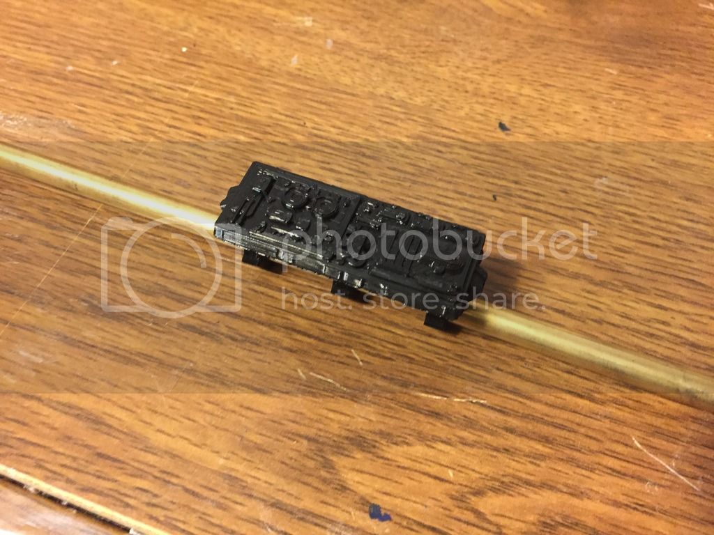

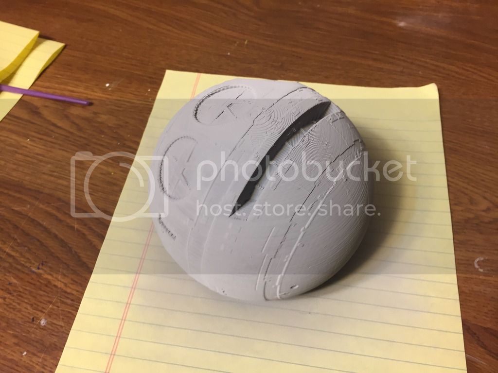

Next up I started on the control module. I wanted to do this just to see how it would look...the control module connects with the collar piece with glue on the INSIDE of the whole thing, so painting the outside will make no difference in how it attaches to the spine tube or the rest of the model.
It was at this point that I realized I was going to need more paint...so I'll be ordering more of that this evening...probably quite a bit more. The color came out exactly how I hoped it would...very light gray. It's a 3:1 mix of that Tamiya acrylic, so it's easy to get it mixed up in correct amounts.
The nature of the 3D printed parts means that I have to paint from two angles...almost like you were painting a staircase...one pass for the vertical boards, and one for the horizontal boards. The print lines make this necessary, and I didn't realize it at first. Once I started painting from the top down as well as from the side, the color really started to pop. What's really cool is that with the paint on it, from just a few feet away, the lines virtually disappear...so for my purposes, and the fact that I'm happy that I've been able to get this far with this model, I'm going to not worry at all about the print lines.

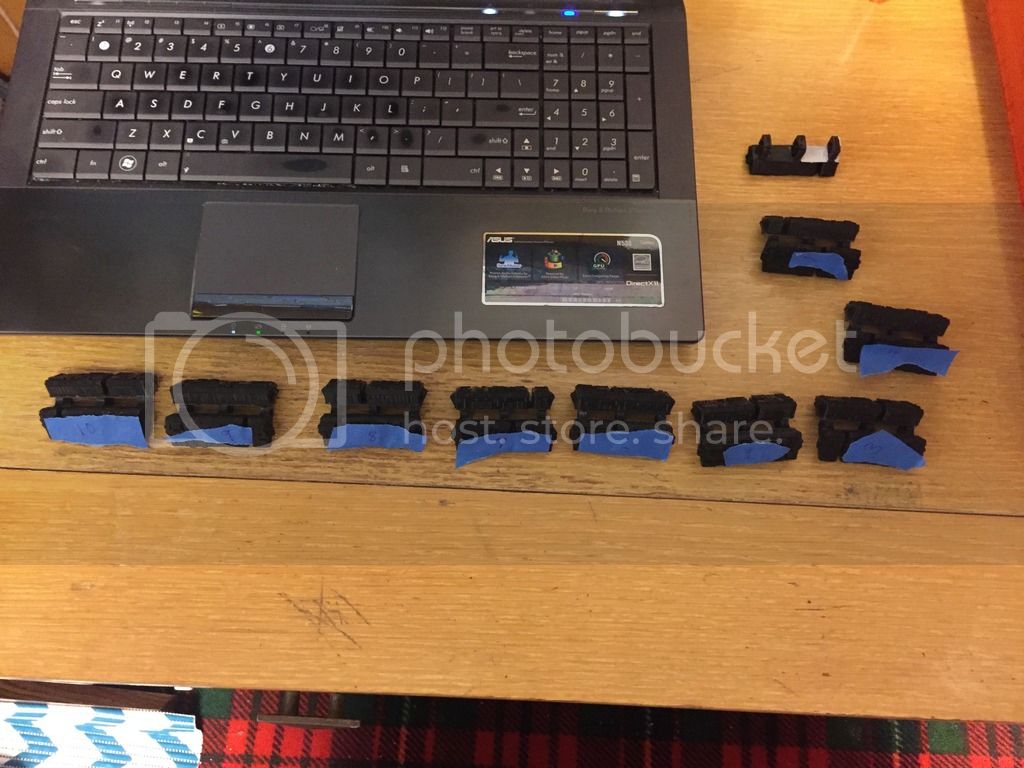

This is the final cargo pod assembly. You can see here how I got them all lined up. I would put the three nuts on the rod, then get them the correct distance apart. I'd then place epoxy on the side that connects to the cargo pod, and then I'd set the pod on top of the whole thing. The rod through the nuts is a good way of making sure that the piece will slide on and off of the rod. I haven't had any issues sliding anything onto or off of the tube that will be getting used as the spine.
Finally, here is my collection of cargo pods...all nine of them that were done, while the last one was on the rod curing. They're numbered because they'll be going on in a specific order.

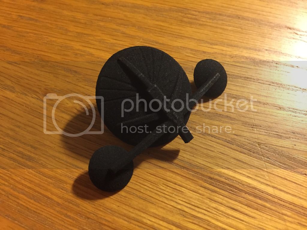

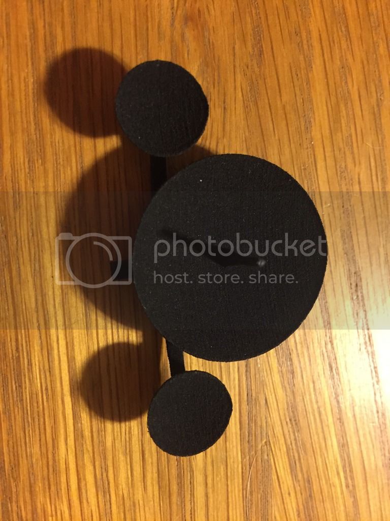

The Shapeways dish assembly arrived today. I'm just blown away by the quality. You can still see minimal print lines, so I think I'll be using this piece with my model. I don't see anything wrong with this...it was a part that my printer struggled with, so I see no issues using a purchased piece in this one spot.

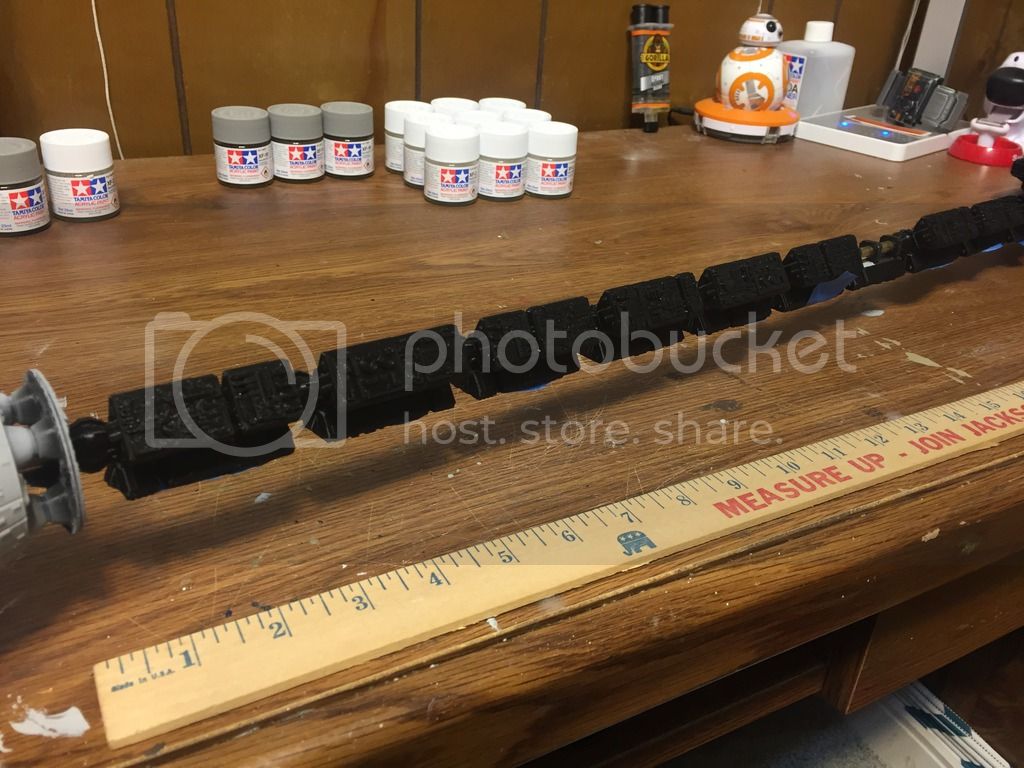

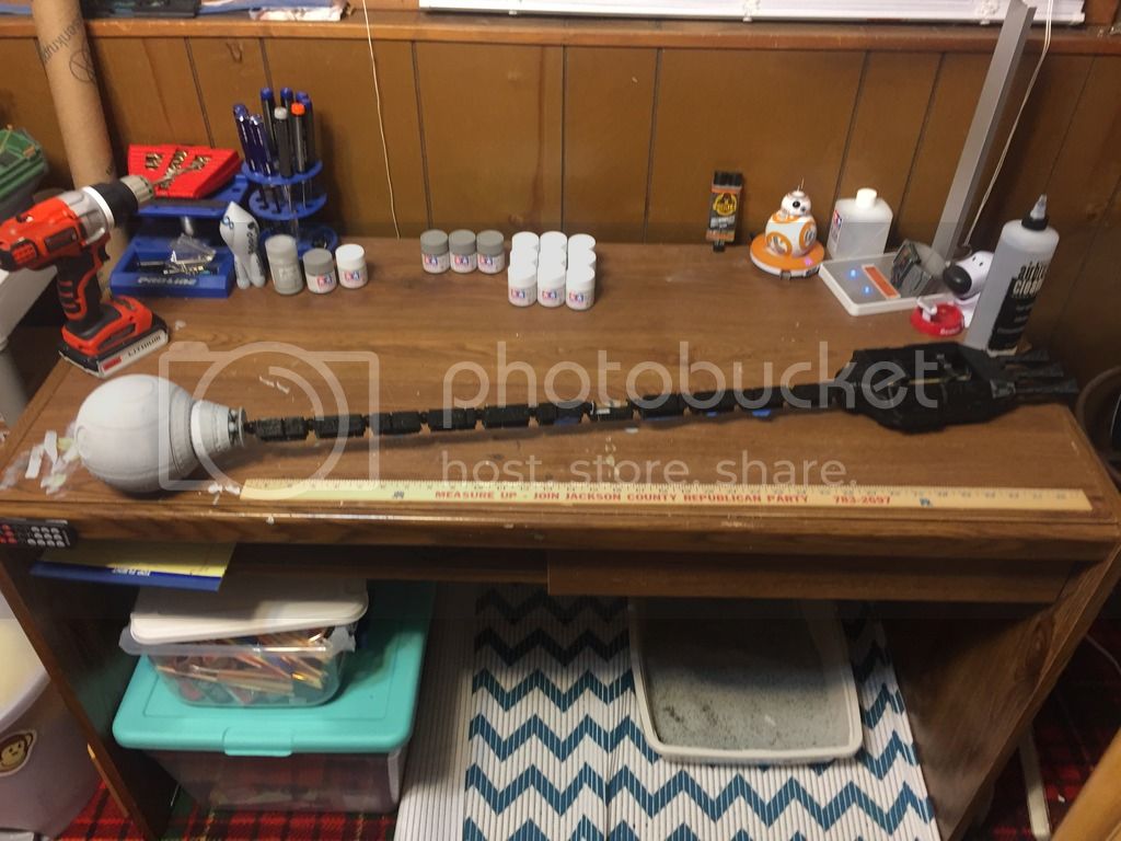

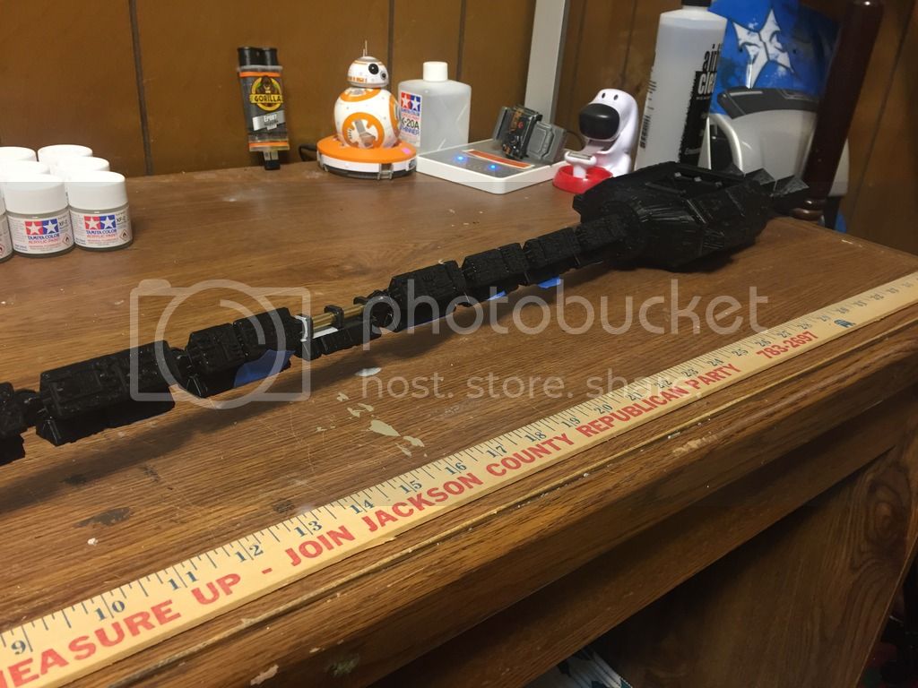

Okay...
...mocked up, not glued, yardstick for size reference...
Just a couple shots of the pods.
I'll be remaking ONE more set of pods. Looking at it alone it looks fine, but on the spine with the others it's off JUST A HAIR. I doubt anyone else would ever notice, but I feel like it's all that I will ever see when looking at it.
I think the the hardest part is going to be making sure the control module and the collar are completely straight. In this mockup the collar is nowhere near straight...I will have to figure out a way to make sure it's straight.
