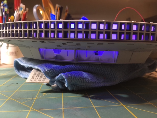

I like the ultrasonic idea, may look into that. I think this particular part just isn't translucent enough. If they were clear resin it'd be killer. Using the 2mm may be what it needs. I'm going to clean them again and scrape the inside more and see if that helps. If not I guess I'll experiment with the 2mm reds on some scrap plastic. I just wouldn't look forward to having to place and wire up all those LED's! I do want it right and am in no rush but I want to keep things moving along...and I want it to be stunning (y)

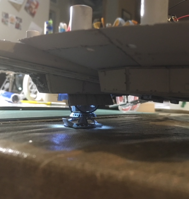

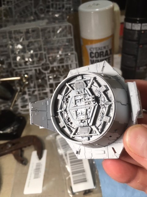

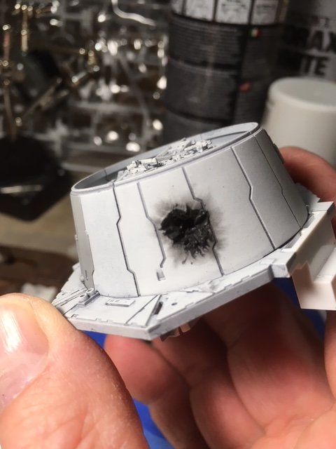

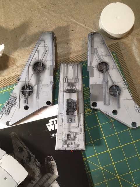

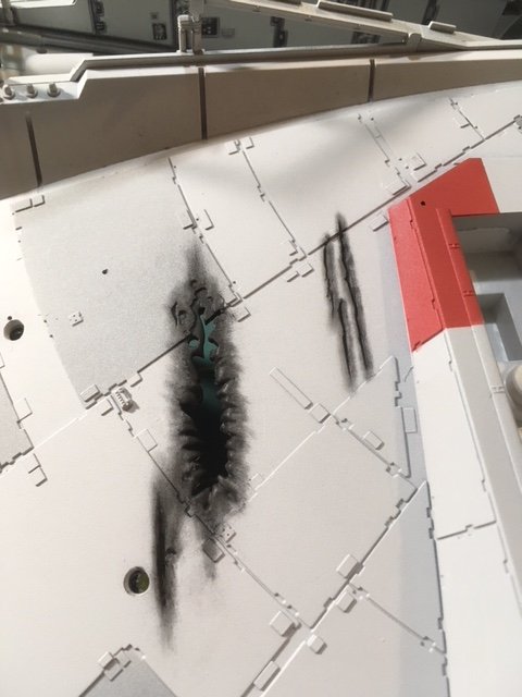

Past couple days work...battle damage on the docking collar...soldering iron works pretty good. I go slow and try to sculpt it best I can. Trying to follow the paint guide in the instructions but the pics are so bleeping small, trying not to over-weather it. still many miles to go. docking collars...big whoop right, lol. Finally pressed the front and rear lower sections together and the lower jaw. I hope I didn't forget anything...cause they ain't coming back apart. Front center landing gear in and light test, the second LED got me the look I wanted. Coming along nicely so far and having a lot of fun with it. Merry Christmas my friends

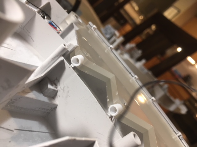

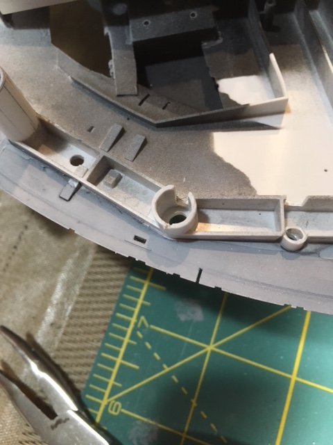

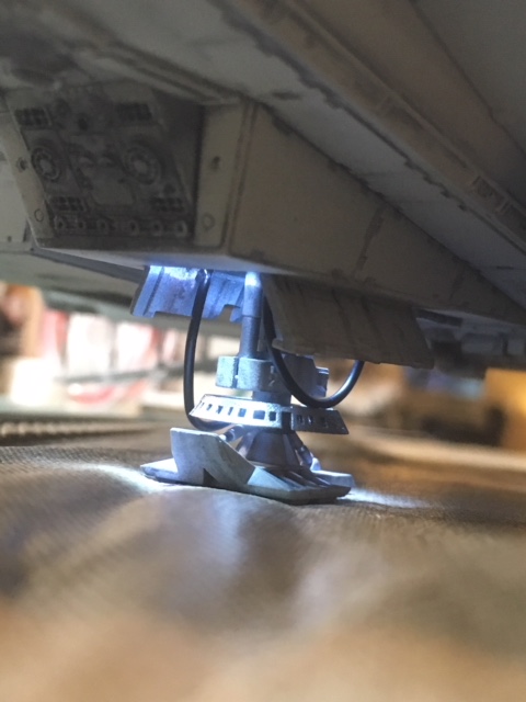

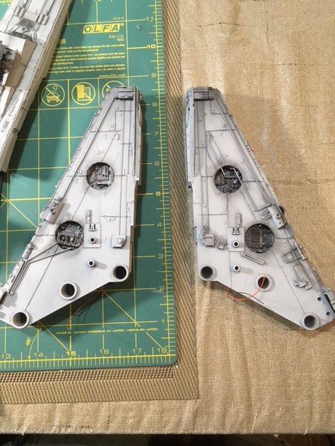

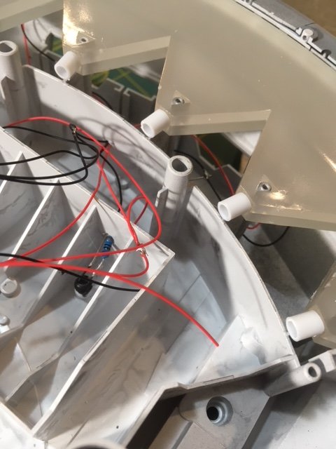

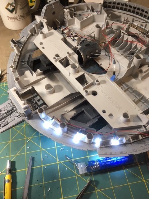

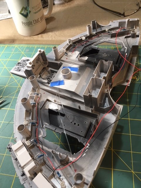

the port side front landing lights, had to really scrunch things down to fit under the mandible, but I reckon it'll clear. Chopped the back out of the first sidewall piece but that was the easy one. it all works...so far. On the starboard side, the one light seemed to land right in the center of an assembly tube, so I cut it down by half, and cut a channel for the LED to fit inside. I see no problems with it...yet.

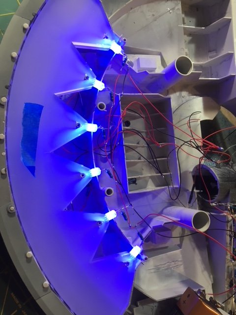

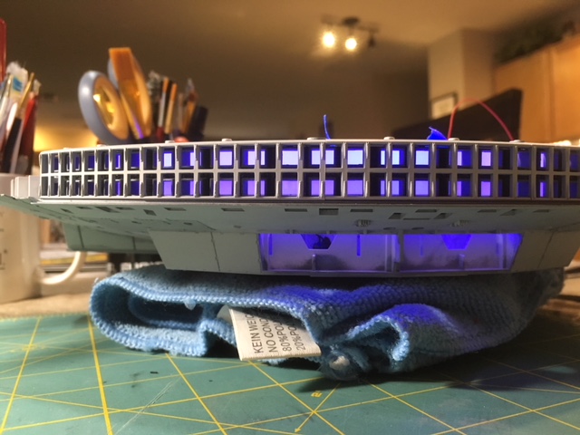

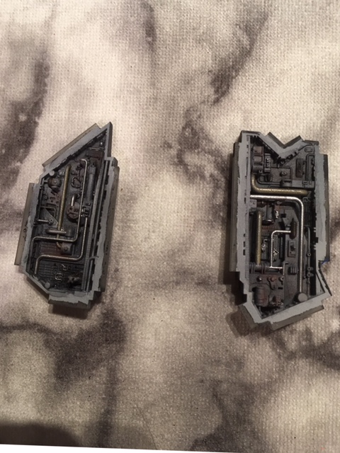

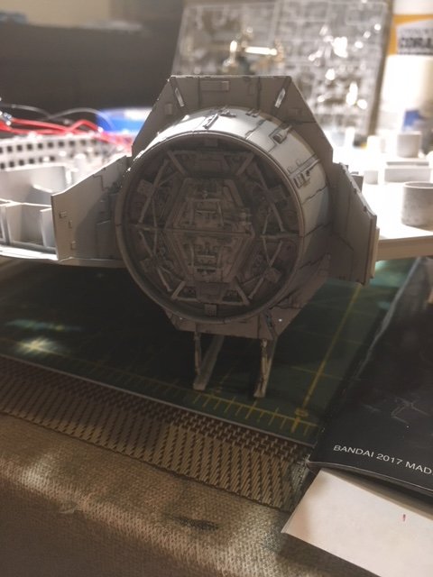

Well, I did a lot more than the pics, but it was standard stuff not worthy of pics and words...docking collars, the first two sidewall chunks and so forth. Though I do have a couple pics of what I did with the landing lights in relation to. This was part my solution to not using any of the kit electrics, this of course is the engine lights. being as my build has either just landed or preparing for take off, the engine glow should be relatively dim. I think I got what I wanted on the first try. And of course the brilliant ESB maintenance pits by Age of Plastic (y)

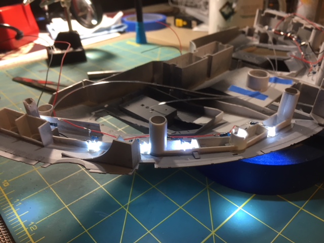

just a few pics of how i tackled this part so the mandibles will still go flush to the lower hull...and the first wall section i hacked up to accommodate them

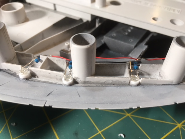

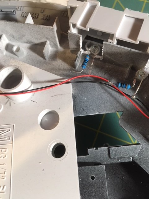

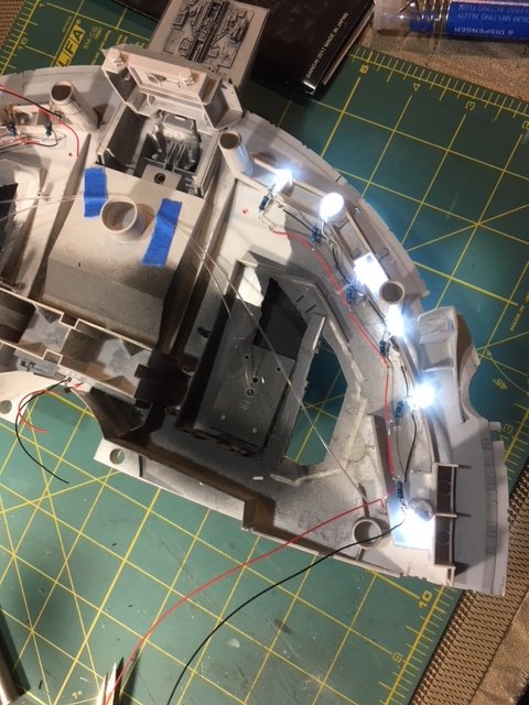

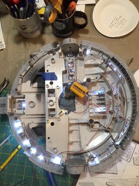

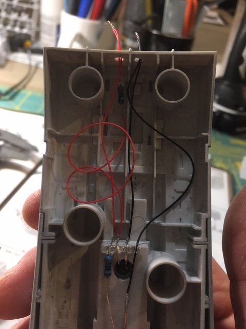

nothing spectacular, just landing lights. Although I've got myself a process now that moves things along. i set up the LED's for each locations requirements as to where and how the electrodes need to be bent, solder on the resistor, get a clear path for the hot and ground wires, use the trusty Laserbond to set the LED's in place, attach the far end of a string of LED's to the wires, then mark the red wire with black and the black with with silver sharpie where i need to strip the wire back to connect everything. Worked great and it was fast...except the last two LED's in the string were duds! LOL :mad: of course it was an quick easy fix, it was just funny that it happened the first time out with my new process. now I'll be testing each one first(y):lol:
