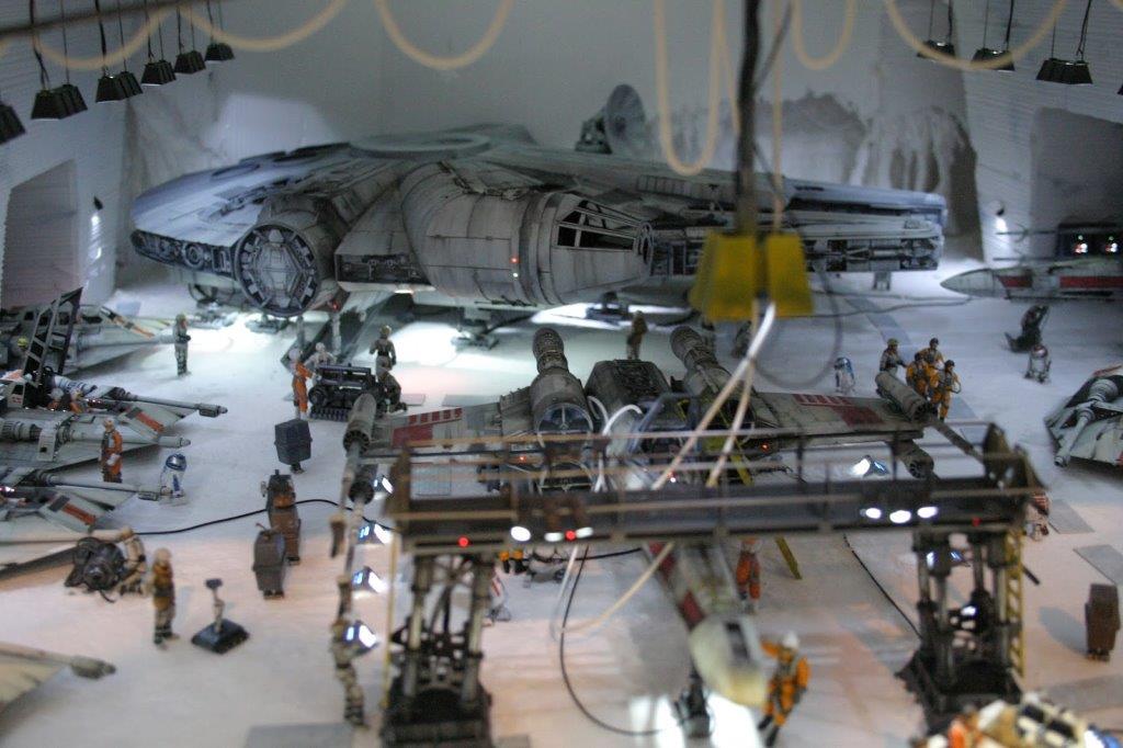

The Bandai Xwing on the kitchen table thread has morphed into something much larger. So at the suggestion of our good friend Socrates, we'll start a new thread with a title that's more in tune with the project. echobase1.JPG and this next image is, I believe, a 1/48 scale someone did in Japan? this is what I'm going for and hope it turns out at least close to as good as this one echo base diorama.jpg

I got some 3/16 white textured acrylic sheet two 4x4 pieces. I originally was only going to use it for floor and ceiling, then I figured I'd us it for everything. There will be some work with making the horizontal wall lines, and the slightly melted drip areas above the alcoves but I figured to just use sheet rock mud and spread it with a toothed trowel, then spray it white. The ceiling will be spaced down and the floor up, each about 1/2 inch to allow for all the wiring. Then once everything is cut and fits together, I'll epoxy the seams or use fiberglass strips and resin to hold it all together. I'm hoping to be able to slide it in and out of this boxed wall shelf and have everything plug into one power adapter, and have it on a remote. was also thinking of perhaps having a sound module that can play several different things. just have to work out how to integrate that. Was thinking if it turned out well, I'd be able to have it mobile to take it to shows...maybe. Anyway, the hole in the wall it's going in is 2ft deep, 3ft wide and 18 inches high. I'm hoping for at least 2 alcoves on each side. it won't be deep enough to need the shield doors though :unsure

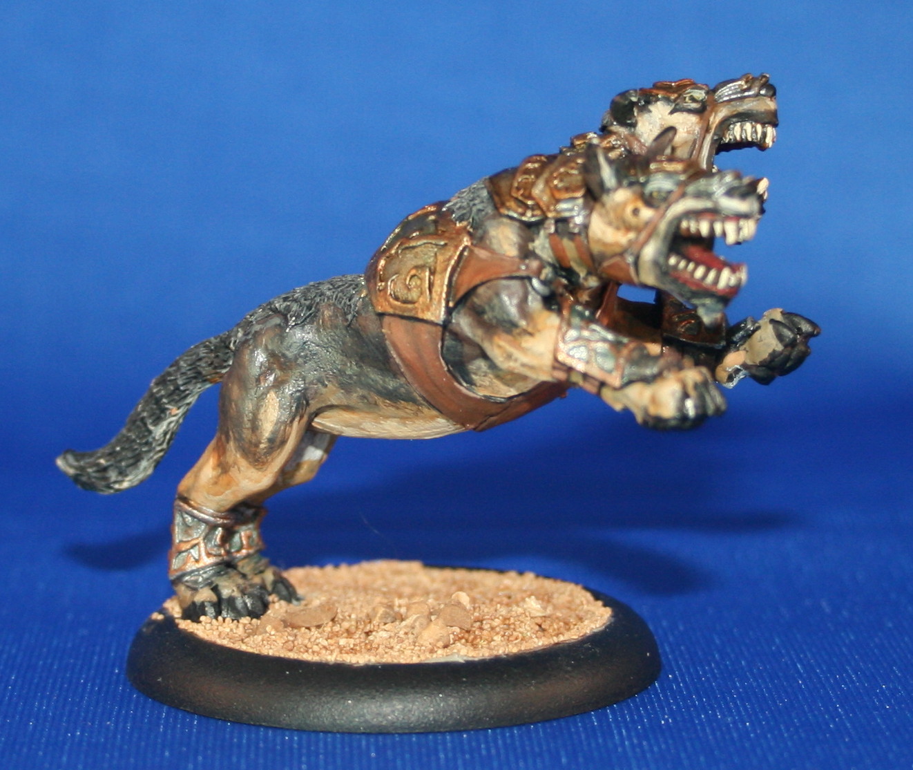

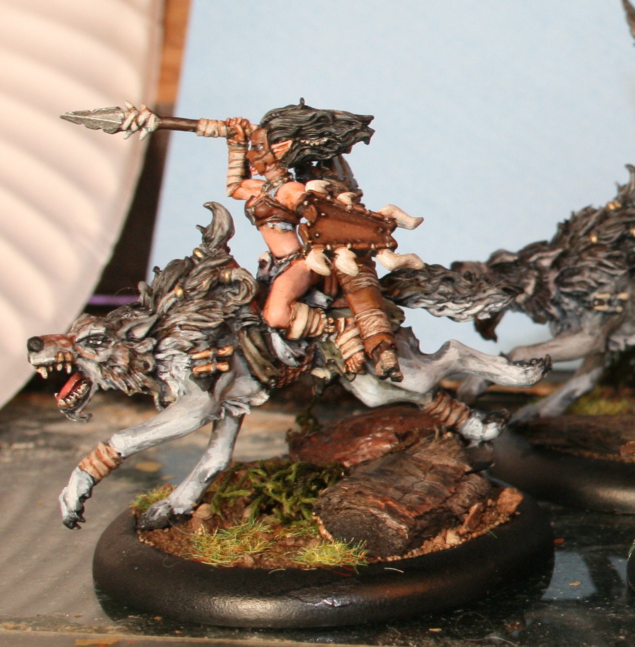

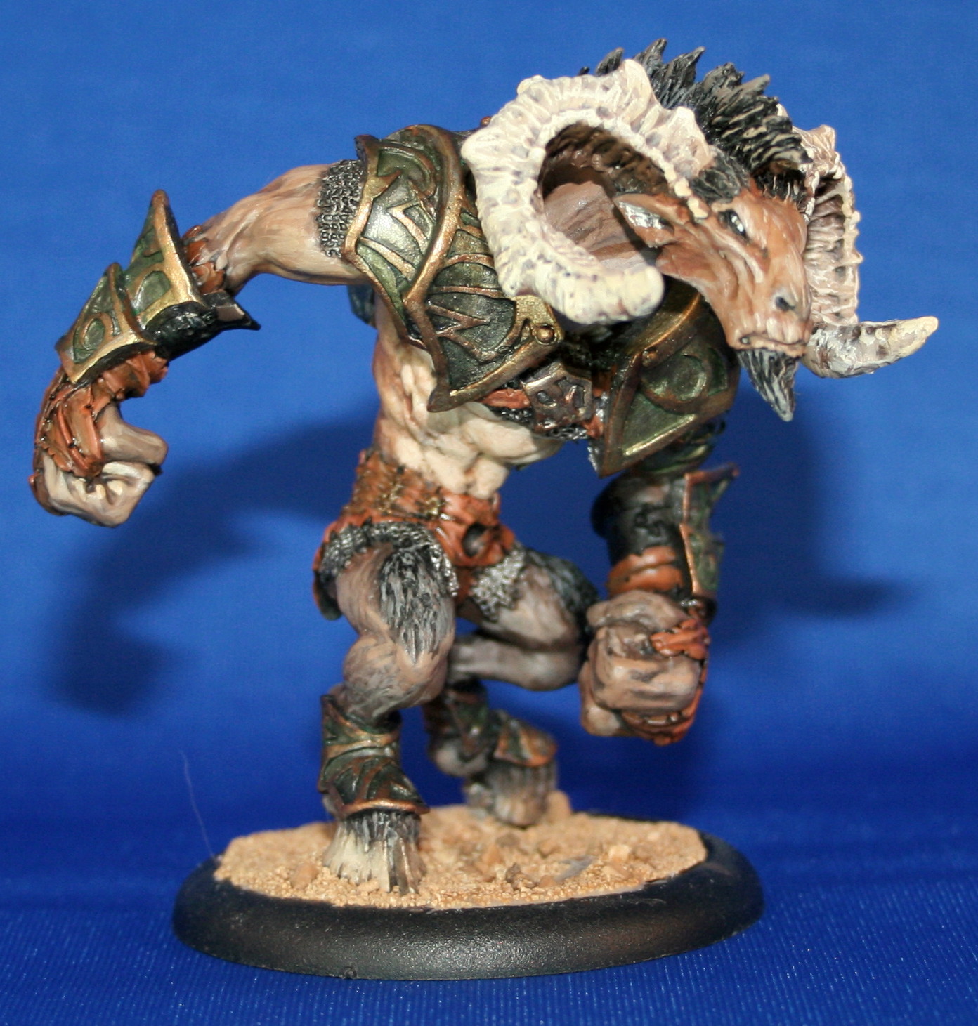

To simulate fur I sometimes will paint a lot of lines, then glaze over it it with a thin transparent layer of color to kind of tone it down and blend it in. Basically thinned paint, along with some acrylic mixing medium
You can kind of see the effect here on the dogs legs and muzzles and the warp wolf's arms, muzzle and legs
And maybe a little easier to see here on the wolf's front and back legs
Another option to add texture, although it's risky if you mess it up, is to use a razor blade to kind of care in some texture.
I found some better pictures showing the effect more close up. it is zoomed in way with extreme harsh lighting so it looks a little crude maybe compared to viewing in person at actual size, but still...
and here on the face and arms

thanks
I painted those for a tabletop miniatures game called Warmachine / Hordes
