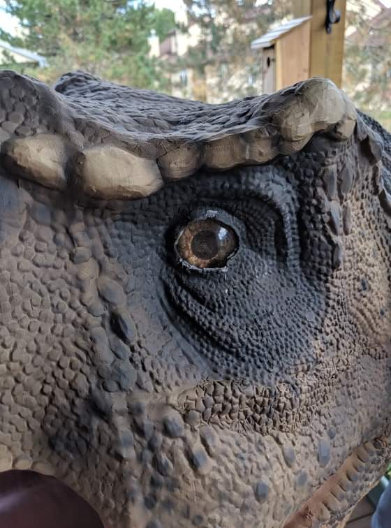

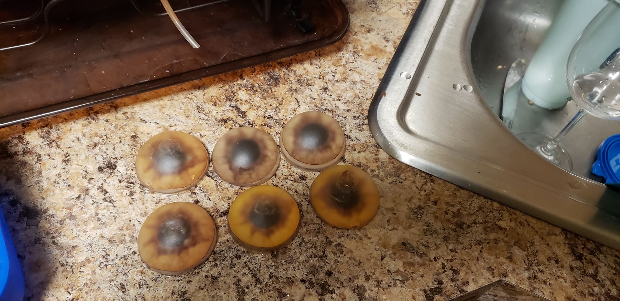

Question about resin polishing.....So I went and made resin Eyeballs using a circular silicon ice mold I had. It picked up the texture of the ice mold since it didnt have a shine. How do I go about buffing the shine back in? Dremel with a polishing attachment? Buff with something like FLitz and a microfiber cloth? Pour another layer of resin on top of the piece? Wet sanding isn't really an option for me.
Either will work. Best results If you have a Micromark Polishing kit or similar, where you can hand-sand ever finer grits and finish off with plastic polish. If you do use a dremel, 1. it's very messy and 2. be careful you don't get it hot (it'll melt or burn easily).

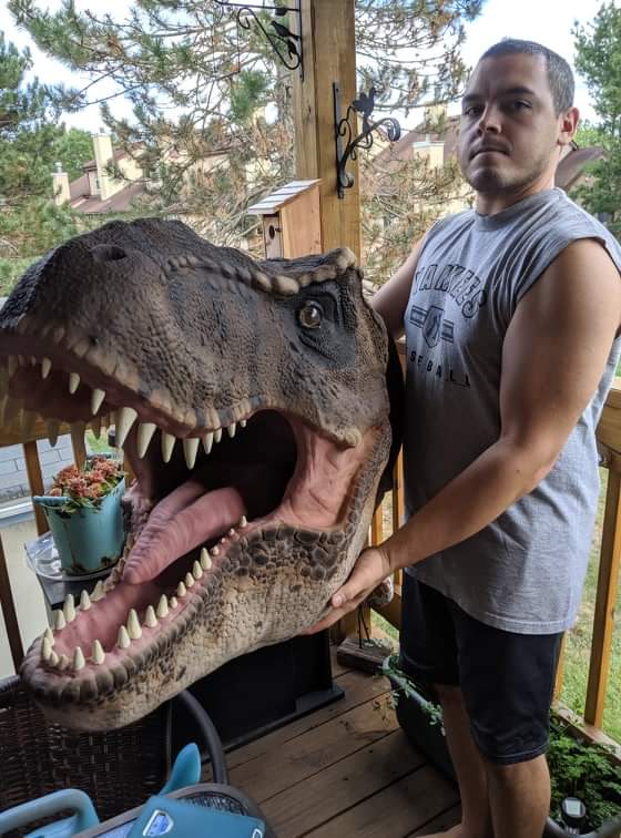

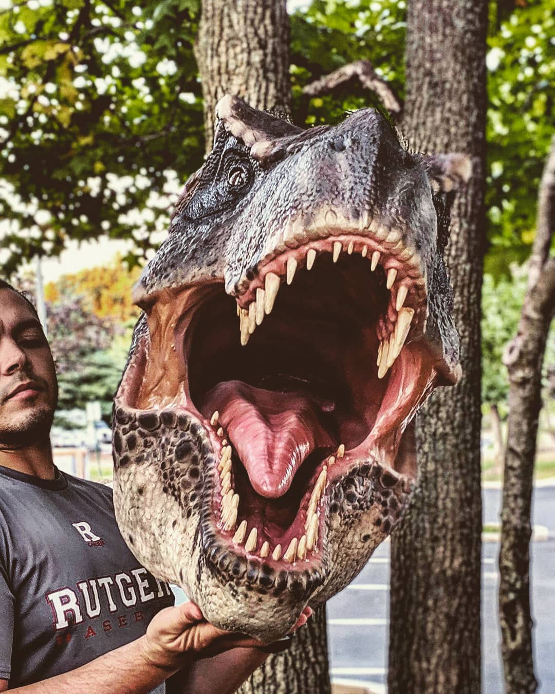

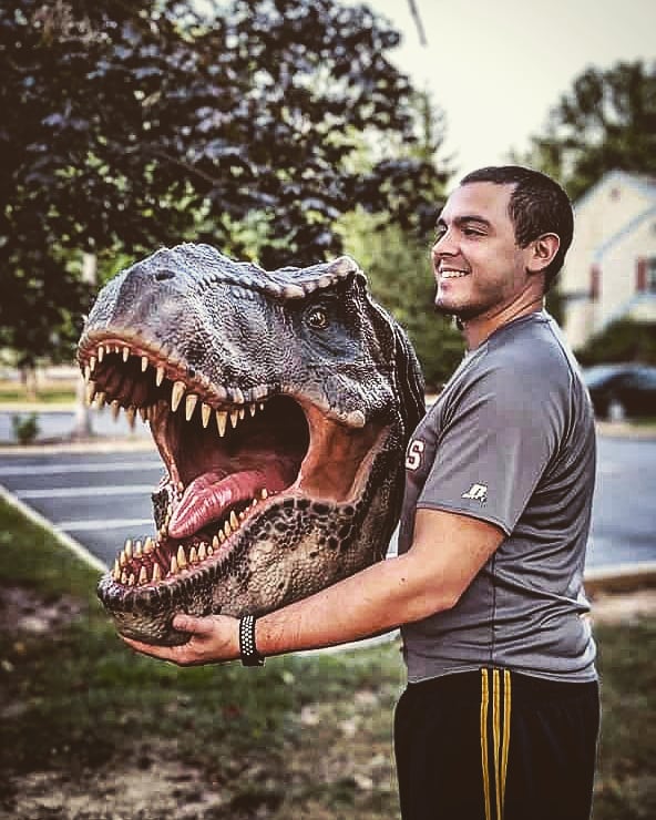

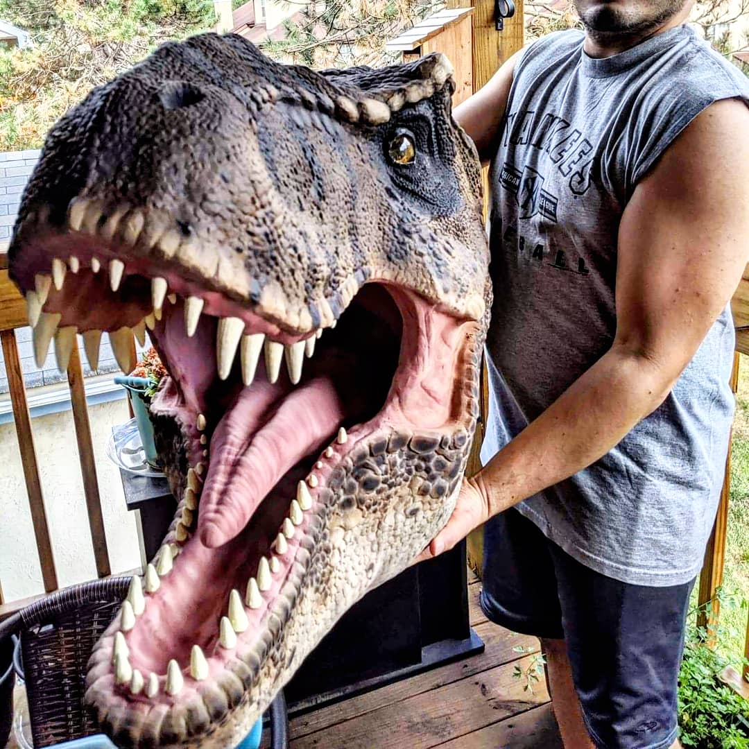

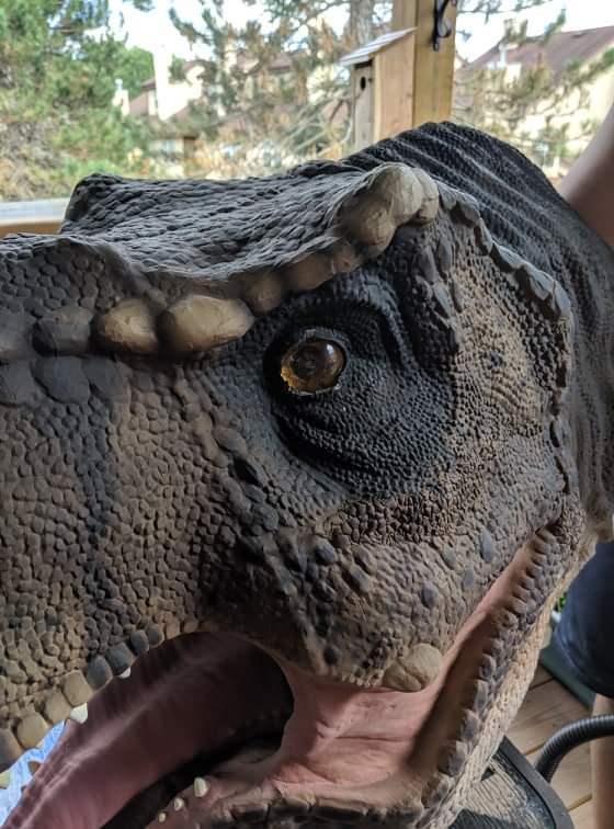

Looks like pouring another layer of resin was the answer! Super clear results now. Here is the result..... excuse my grumpy face, its a bit heavy and im holding it up with my arm,inside the back of the head,haha.

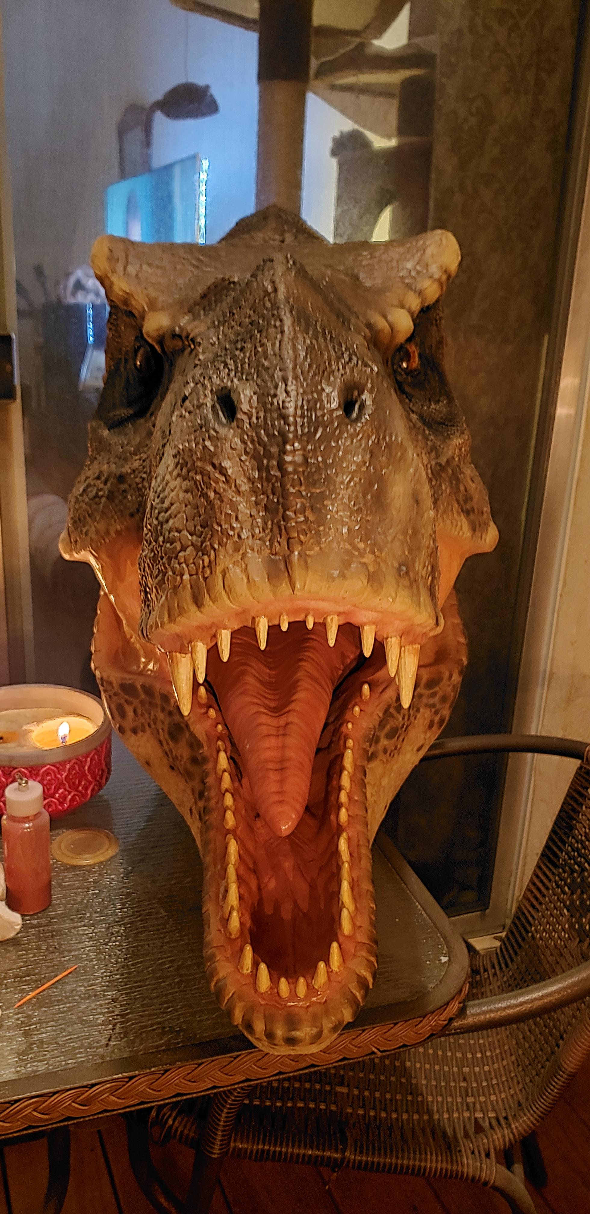

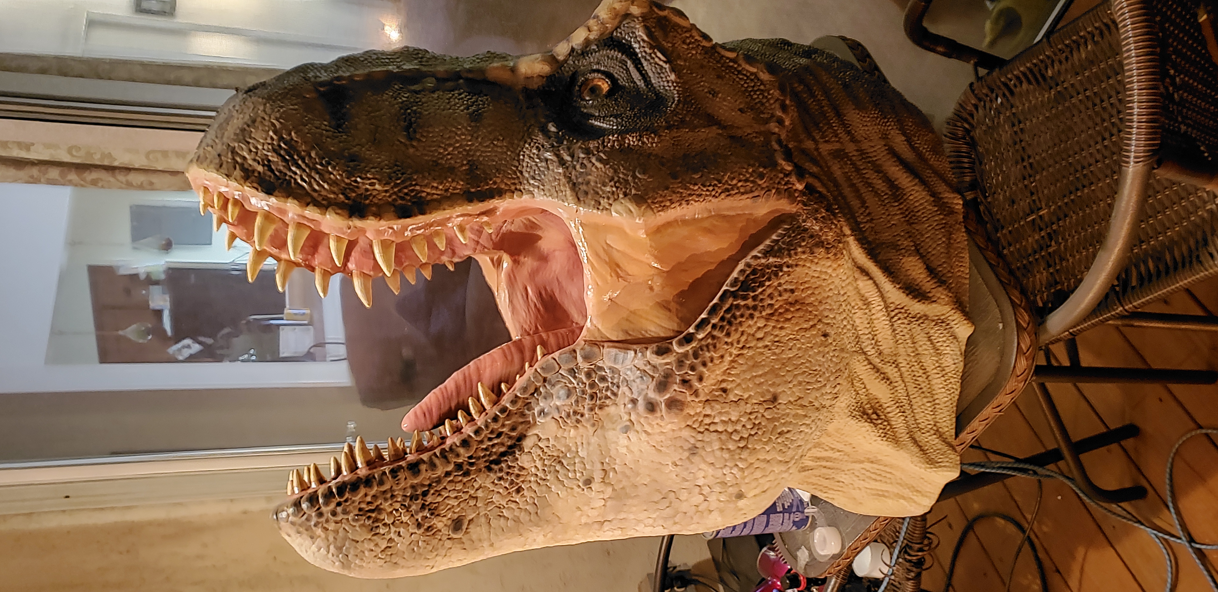

I made 3 different color eye sets, but the brighter yellow set won out. I wont make another dino head without making resin eyes from this point on, huge difference.

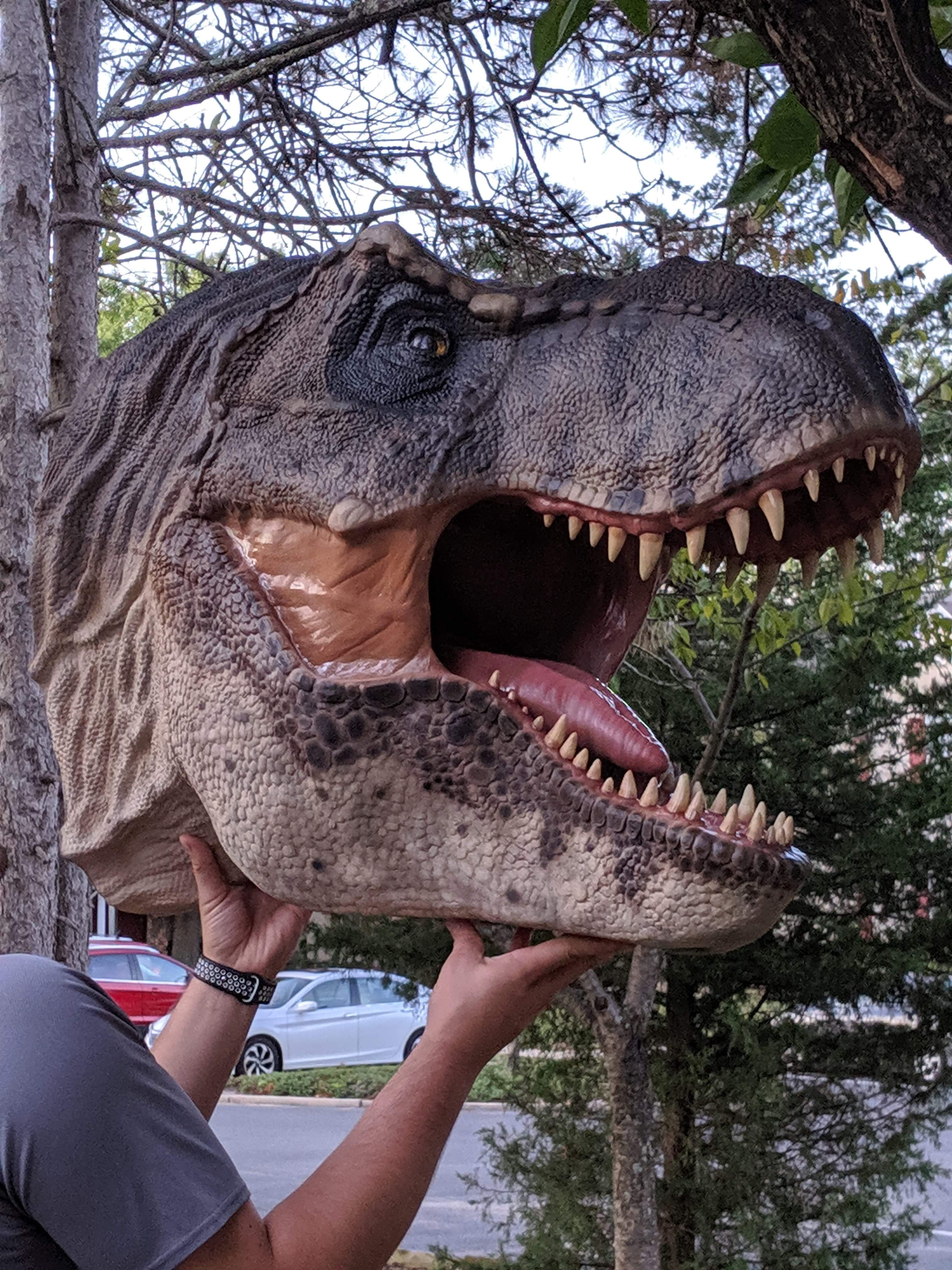

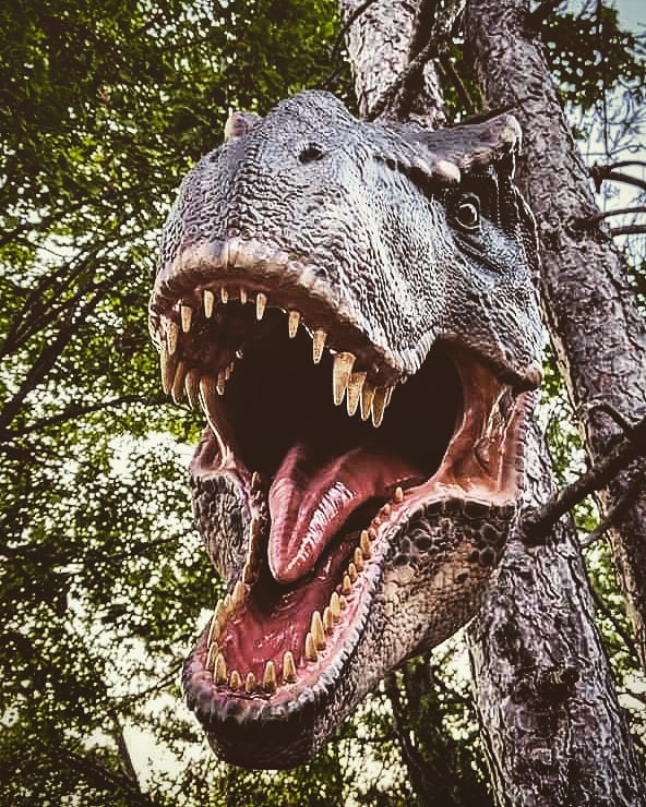

I can finally I'm happy with it. The paint work is done. I'm going to go outside around sunset to take some beauty shots, butnext step is to figure out how the hell to mount this thing. Its 100 Percent hollow except for where the parts connect. It weighs about 20 lbs.
Mount it with a bunch of broken drywall to look like it broke through the wall. That would be awesome!!! Or make a fake window like it can stick it's head out of the cage like at a petting zoo.

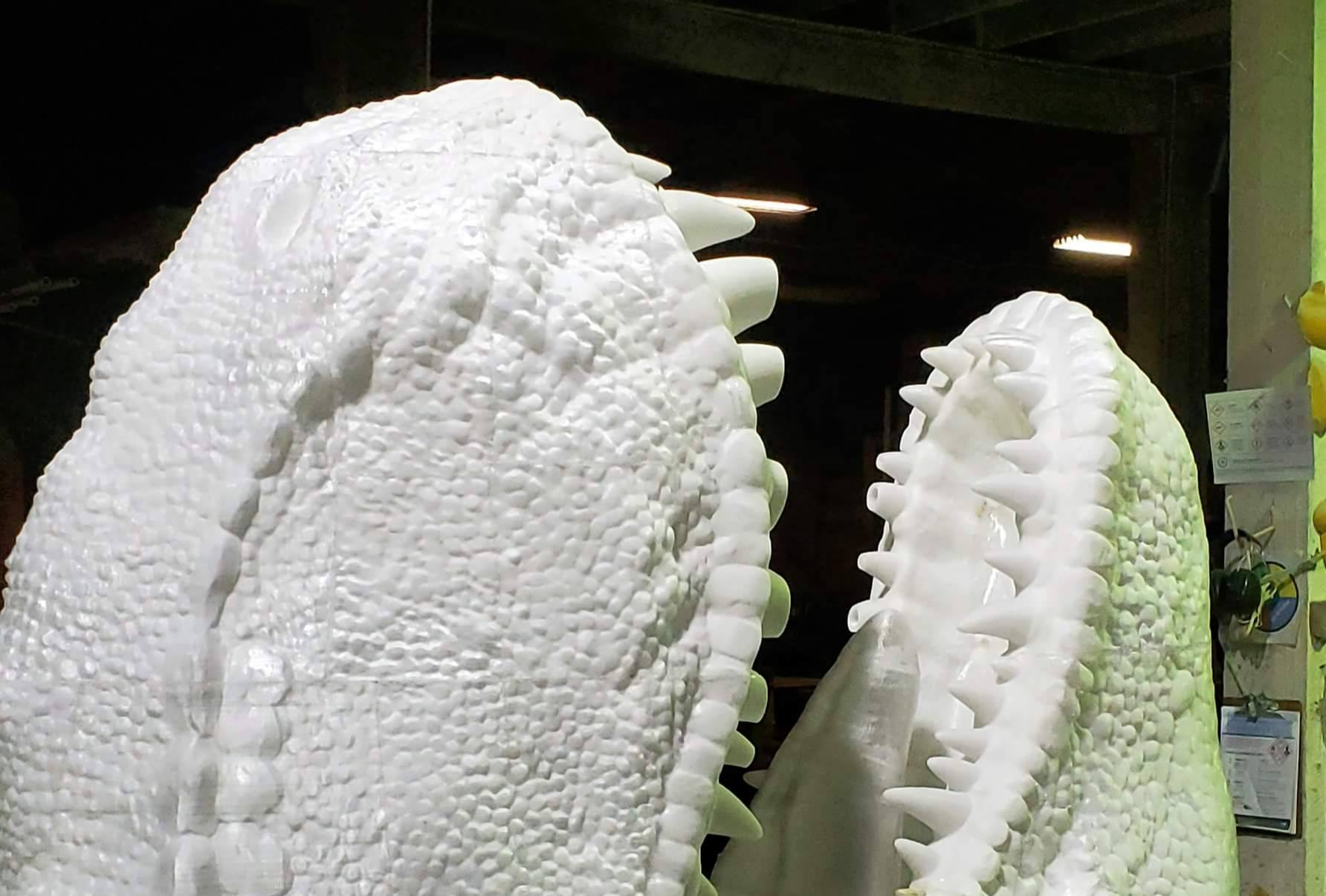

Now that this project is done I can show you the Full Scale JP T-rex Bust that is being printed for DinoFest at the Los Angeles Museum of Natural History! It is being printed by Across the Board Creations in BC. As long as there are no snags, it Should be on display there this weekend. Very excited to see her!
