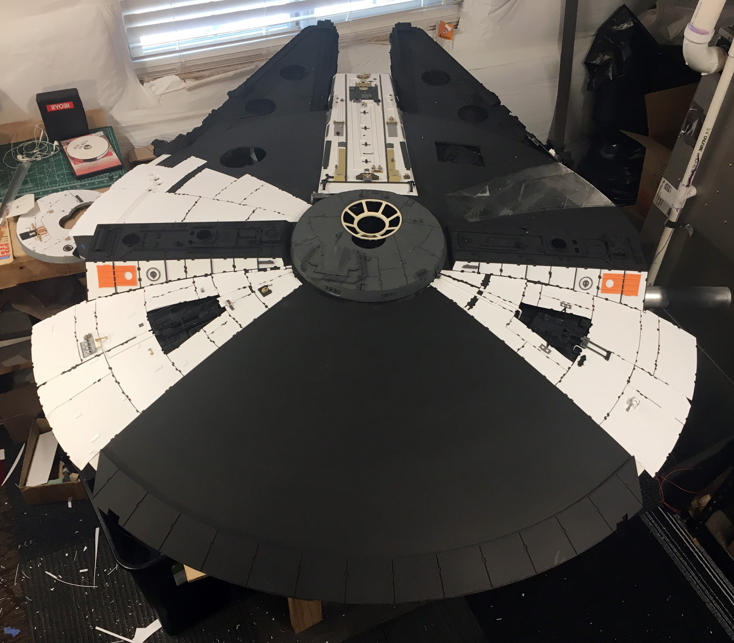

Well, here's a few more getting us towards that ultimate paint day!!!

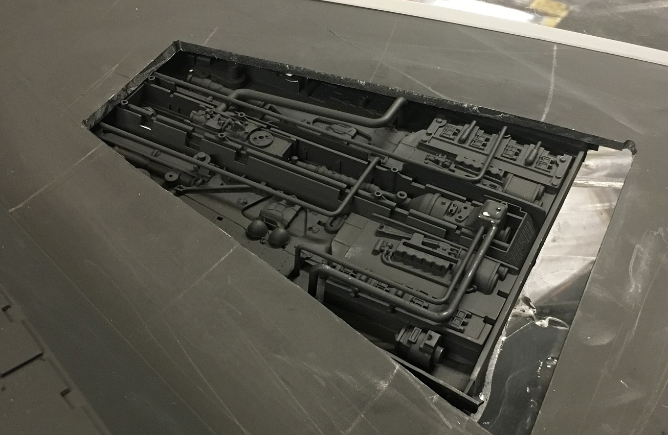

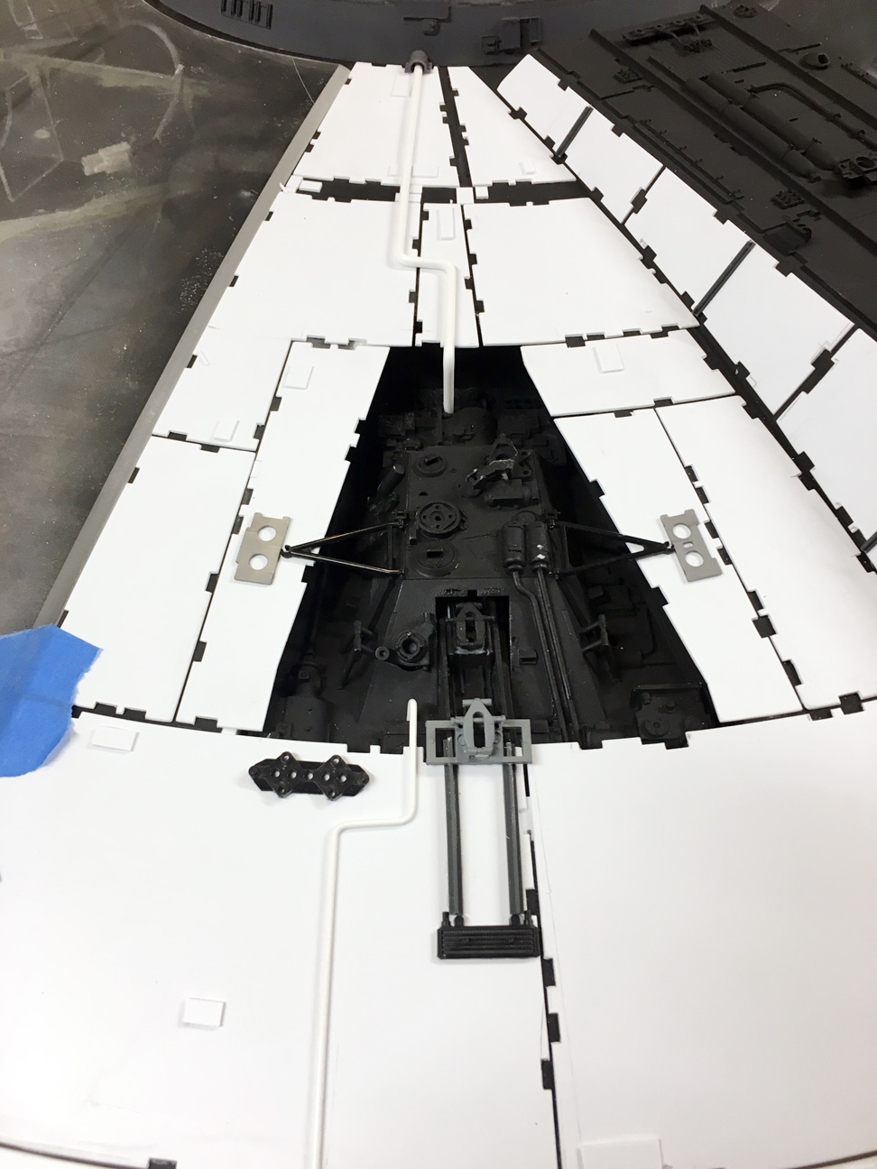

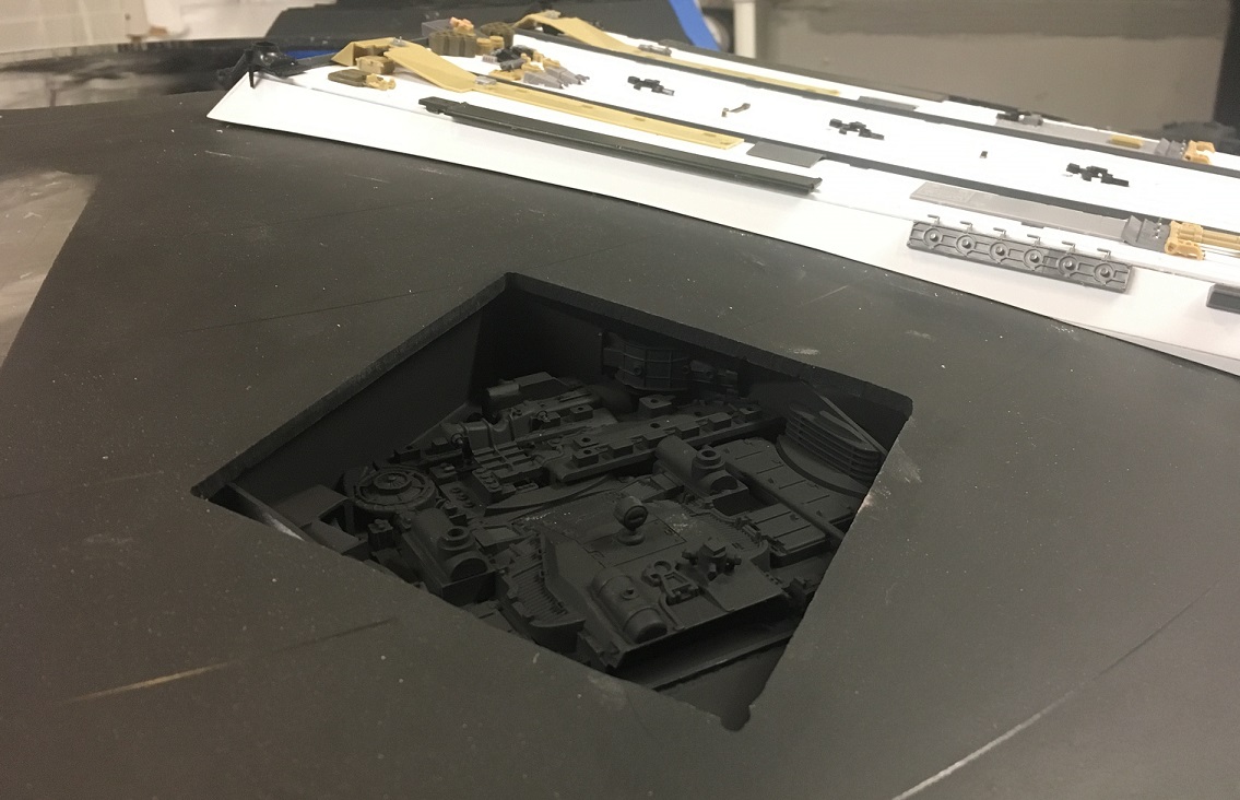

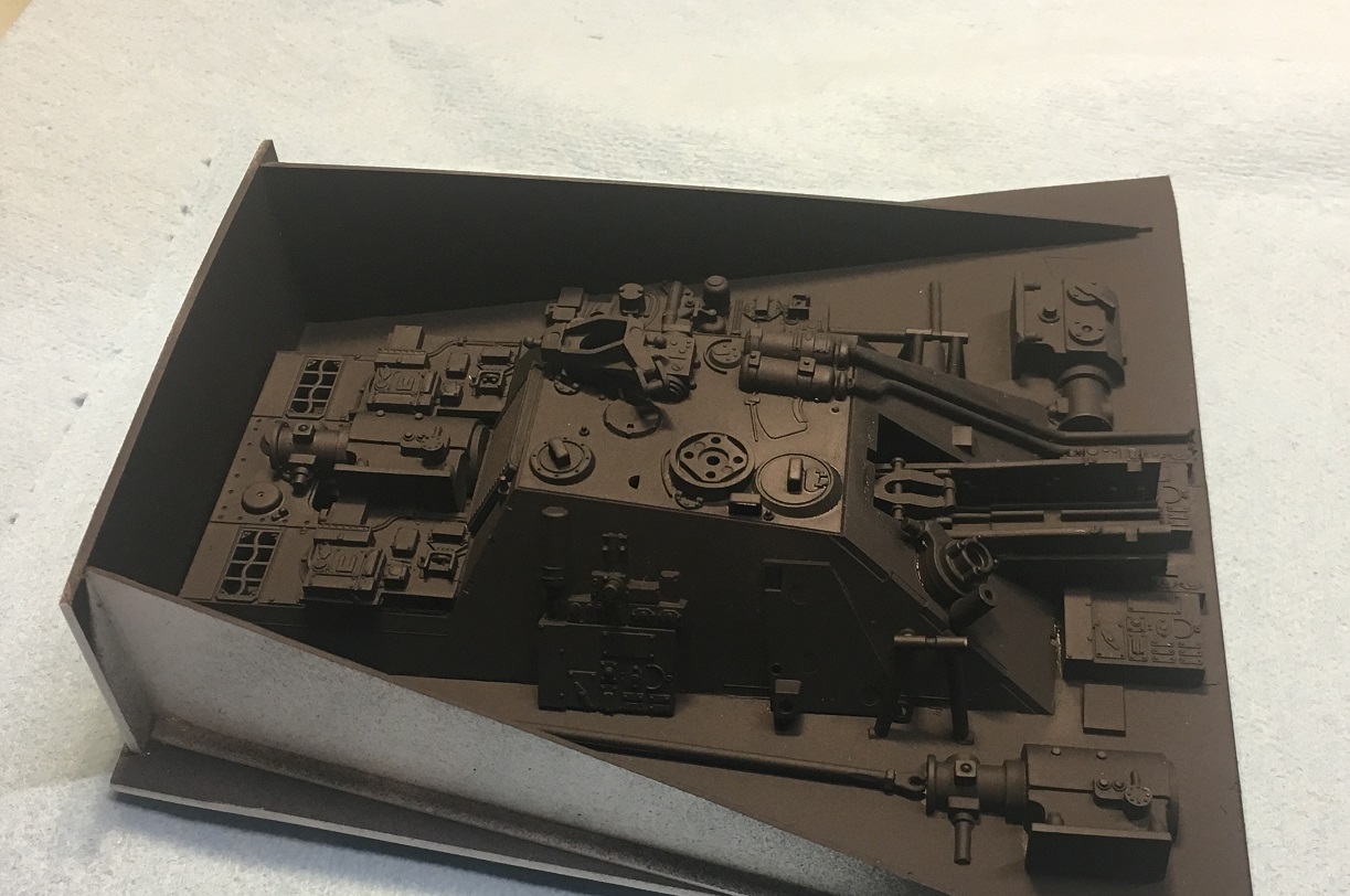

Here we have the top forward recess pit, walls built to conform to the hull
Just needs the plating to come down and overlap where needed - coming soon!

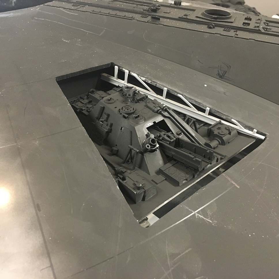

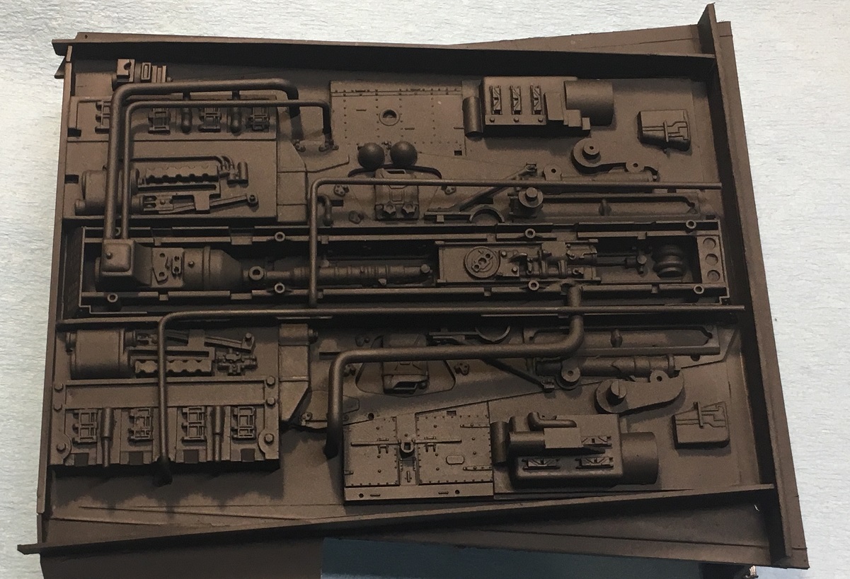

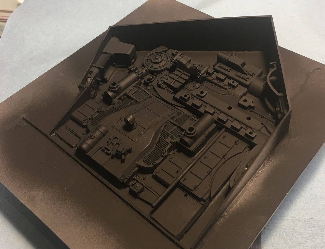

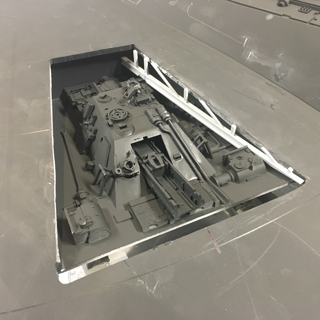

Then we get the "8RAD" pit mocked up in place, then settled in to the rear port Pit. Add some side support structure to get the walls the right width, and then bring on the plating to fit it all properly to size.
Getting the Pit to fit in Just the right spot!
Start adding plating in all the right spots.
And most of the plating is done here.

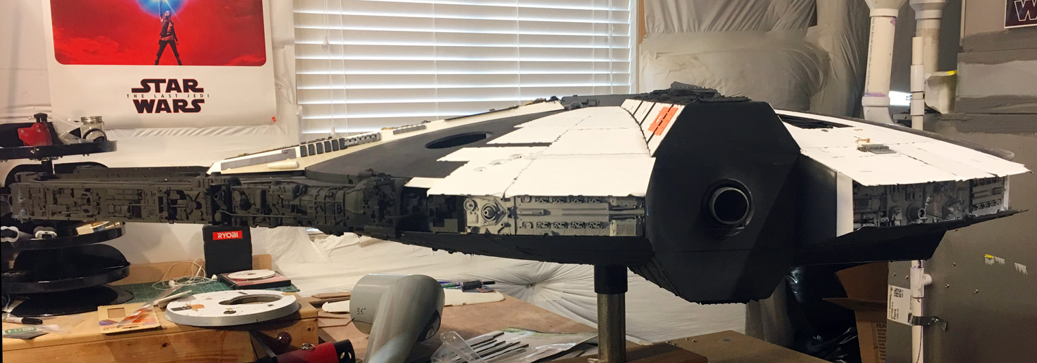

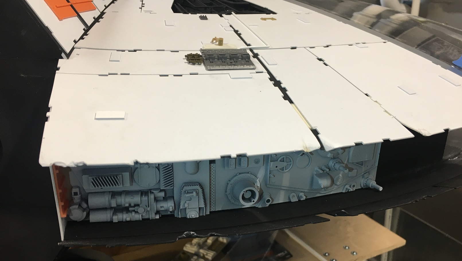

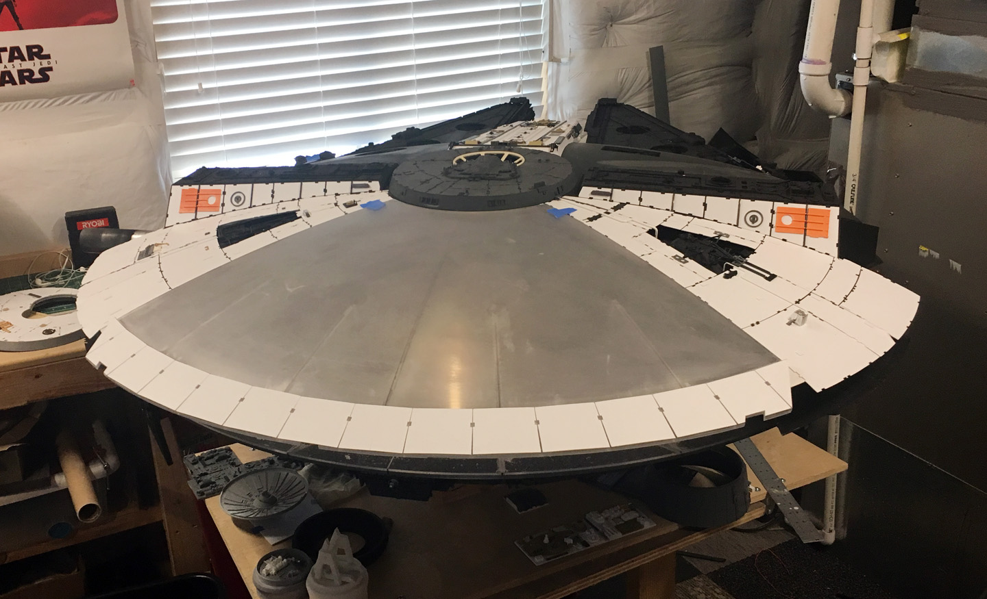

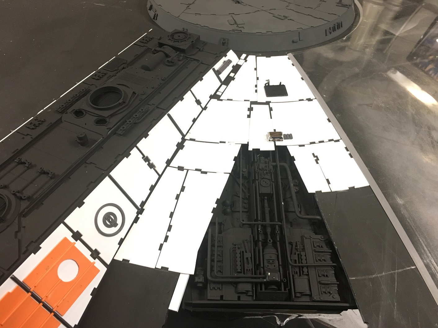

Here's a quick update. Mostly completed Starboard Rear Pit panels. I still have a few minor tweaks to make, but it's close. My Plating is not 100% due to some early placement errors that I decided to live with. If I get ambitious enough, I can always pop off the styrene plates and redo them. It's at one of those points where you just decide to live with some compromises and small off-sets rather than laboring over trying to get every little nibble exactly in place. Also started on the side wall damage/weathering near the docking ring. I still have some styrene to chop off to make it look a bit more 'angled' as it goes up. But it's fun to melt the styrene and try to get approximate shapes/deformations.

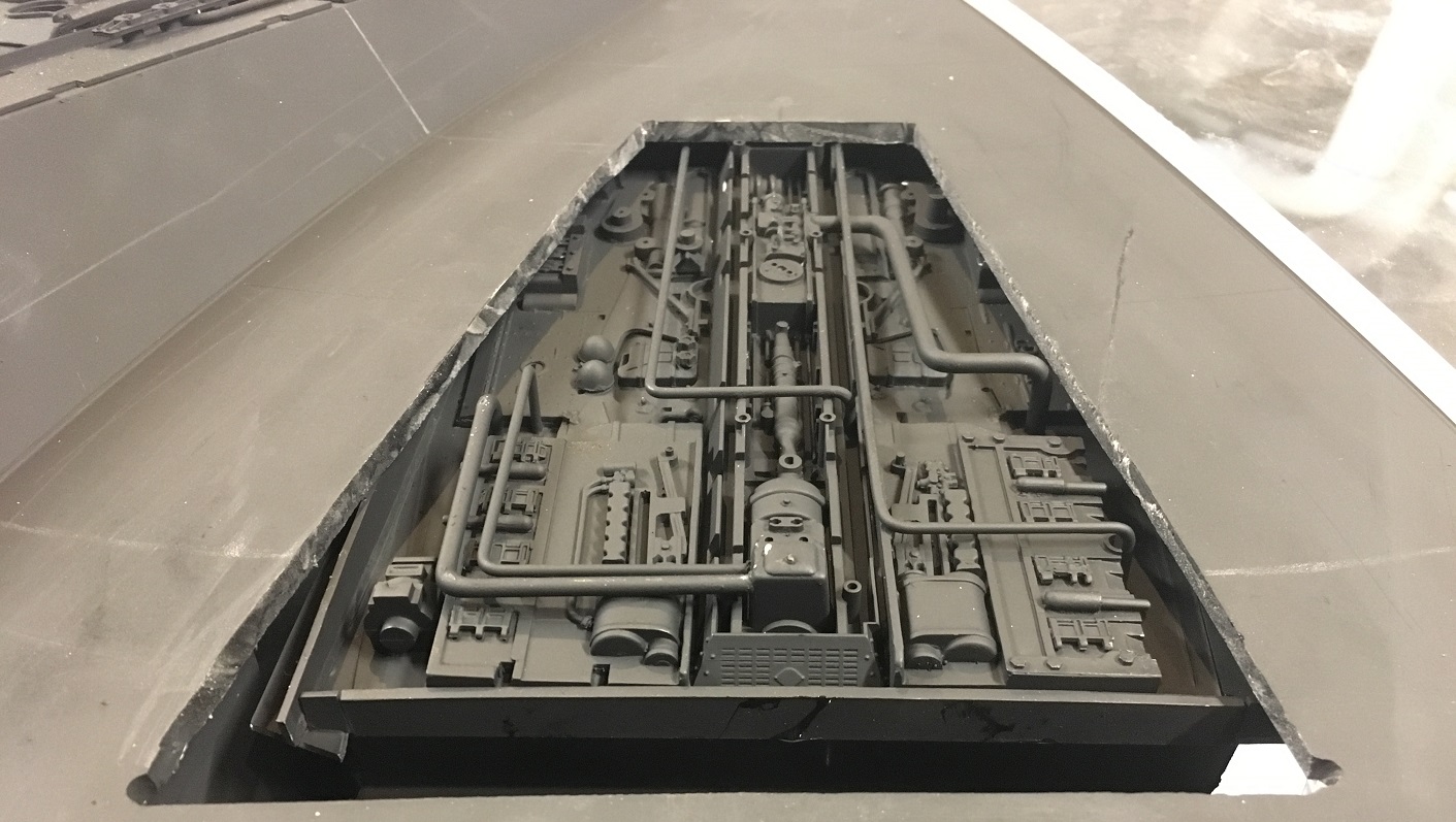

Piping installed into pit, along with the 'T' channels meeting the 8Rad part (Happy with the way/angle these came out)
Starting on the damaged side wall
Full view looking down
And the long shot, the overlap on the rear quarter is looking just about right!

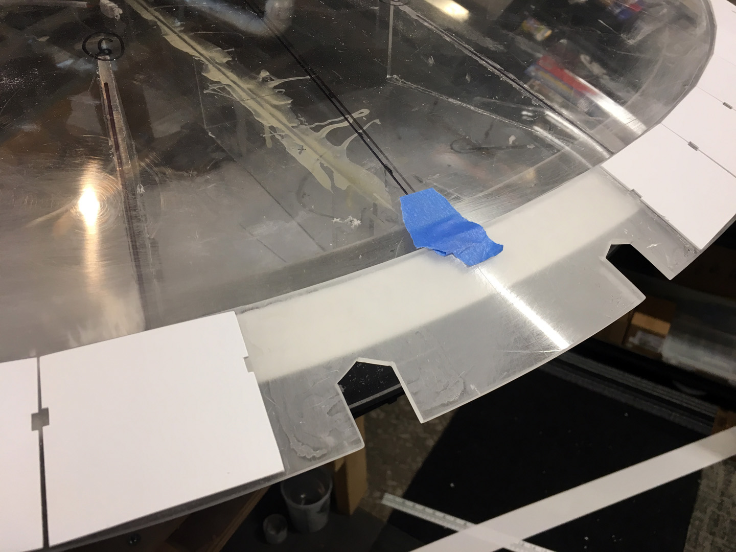

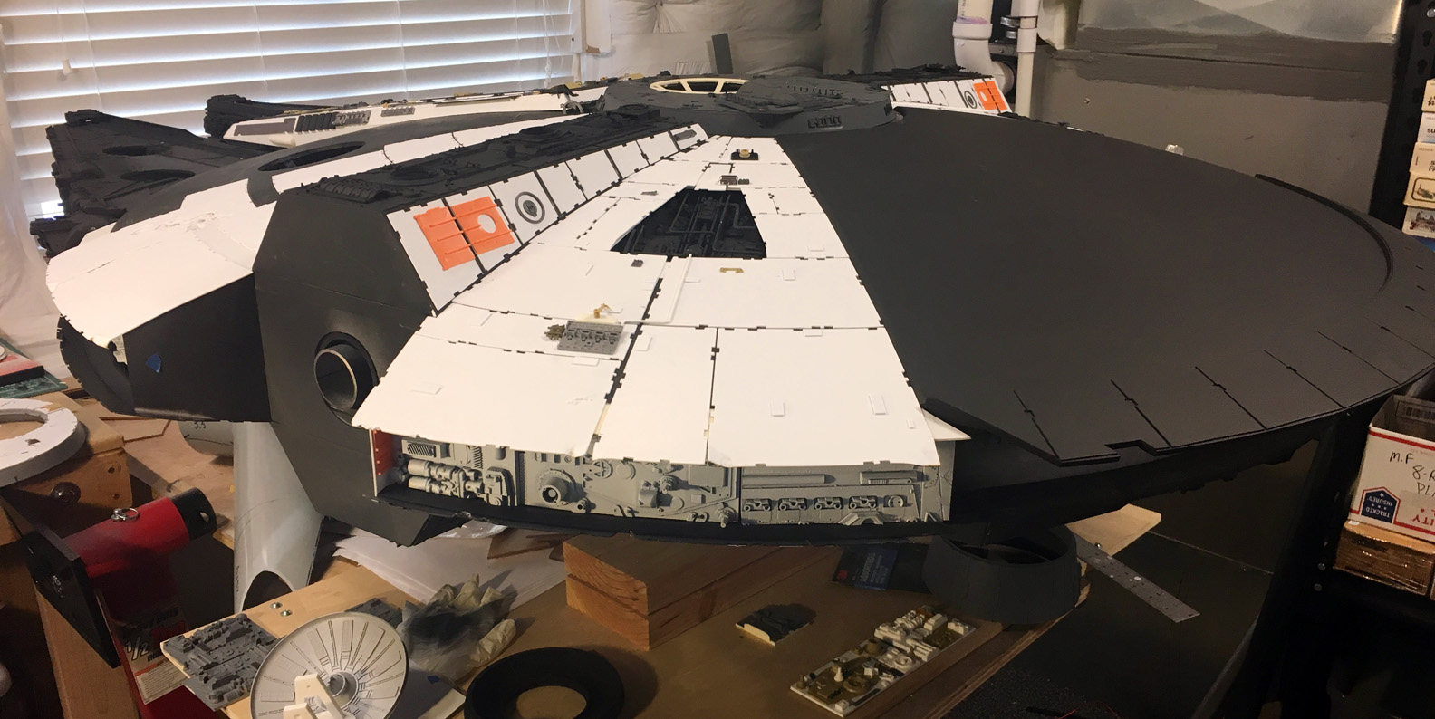

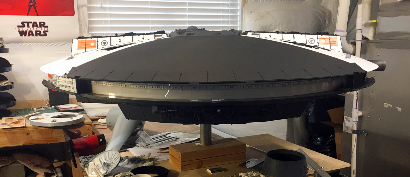

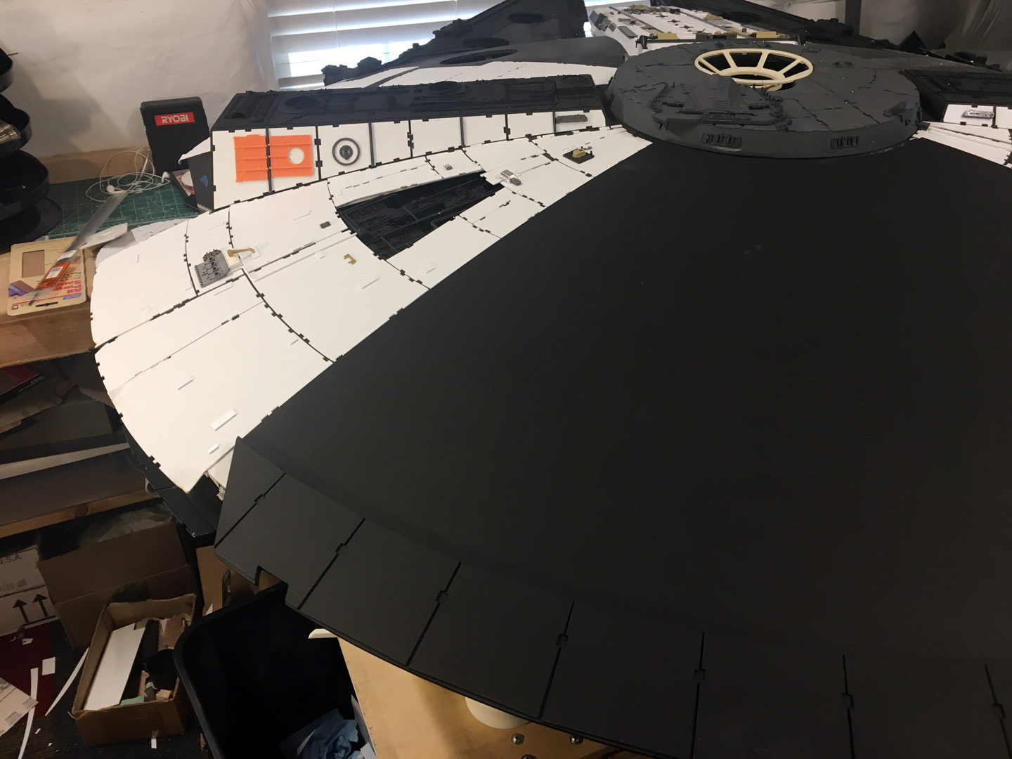

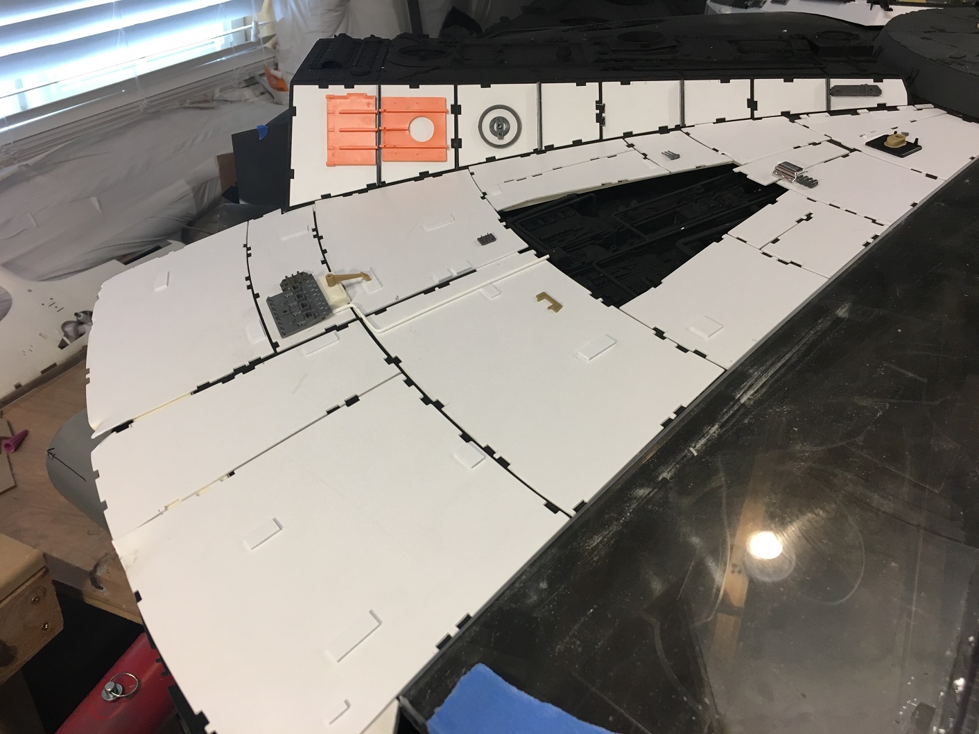

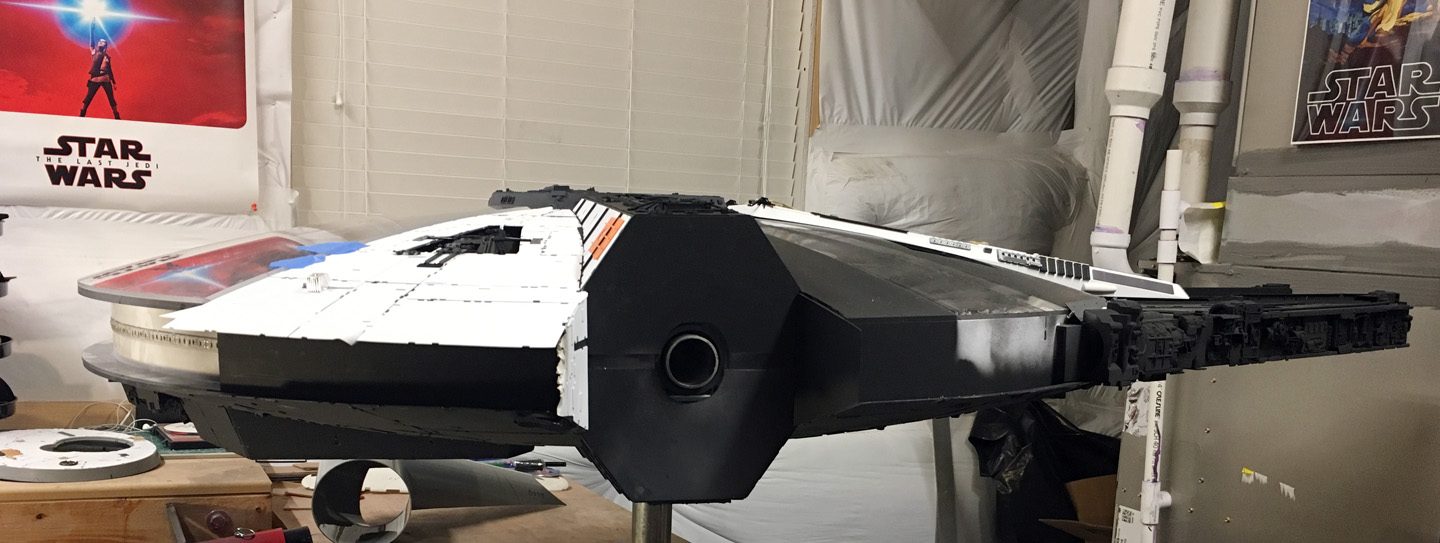

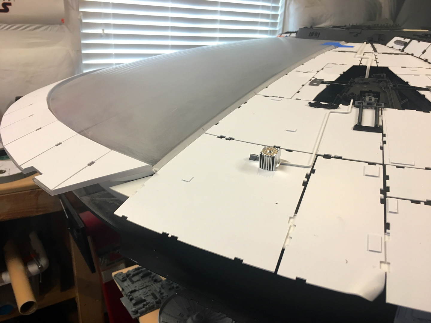

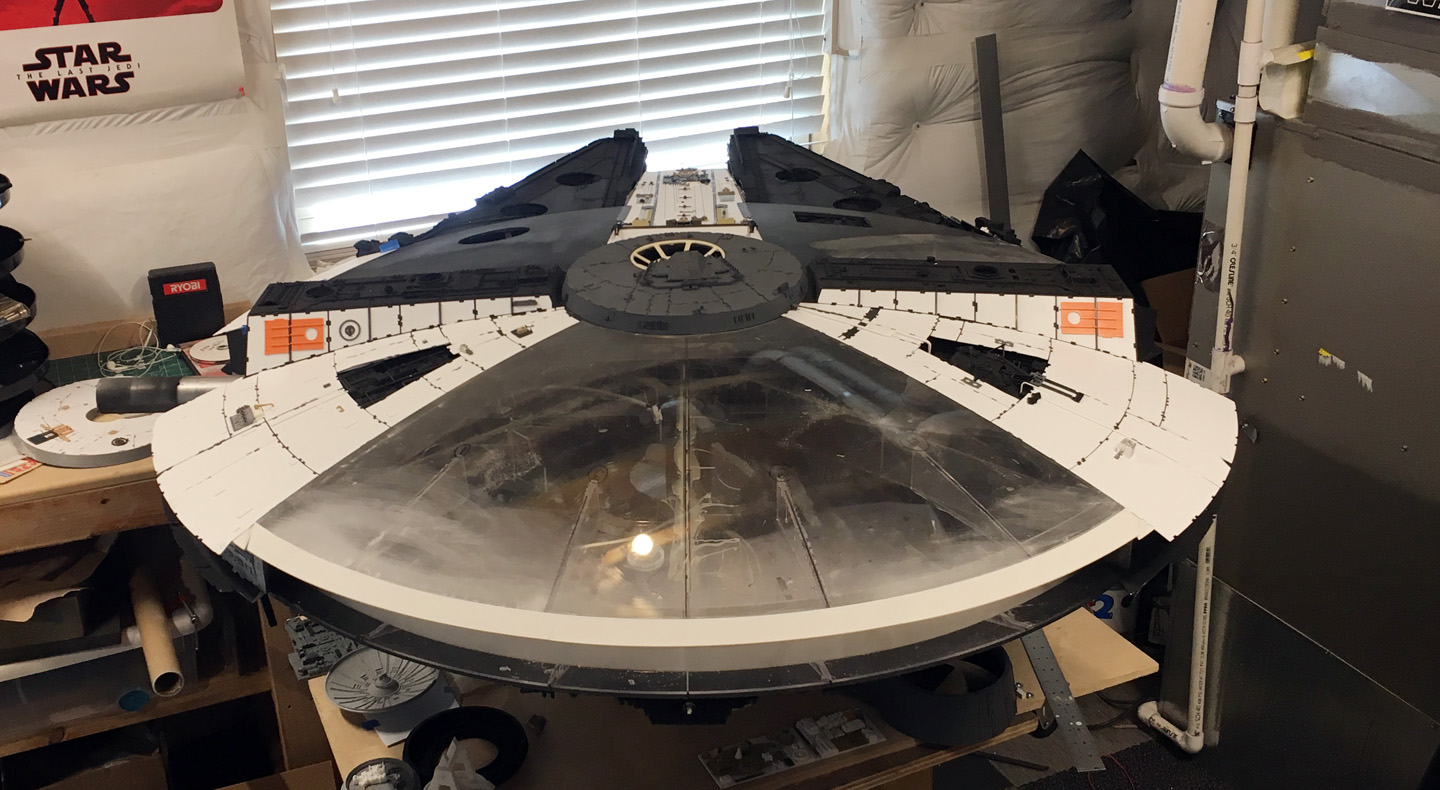

A few updates from the weekend. Got started on the rear engine deck cover. Started off with adding the hull extension. It lined up very nicely. Then a modification to the Acrylic 'Lip', custom cut the cutout sections that are there on the original, and added the styrene plating. I haven't decided if I'll also add the taper right in the middle that would have accommodated the mounting pipe. Then placed the Lip on top of the extension, and finished adding the last of the plating. After that, it was on to a good coat of primer, and checking the overall fit on the hull. It's great seeing the side profile, the overhang looks just right! This was a big milestone as the radius and the curve had to be just right to fit the upcoming 'blades' that will go over the edge, and of course all the parts that are next to be added.
Here's the hull extension, nicely lines up with the existing extension.
And a full view of the hull extension
Here's the 'lip extension' with the plating installed and the 'cutouts' into the acrylic.
The final plating installed on the lip, glued to the engine deck
The overhang looks just about right!
The Engine deck lip with the plating installed
Slapped some primer on the whole engine deck

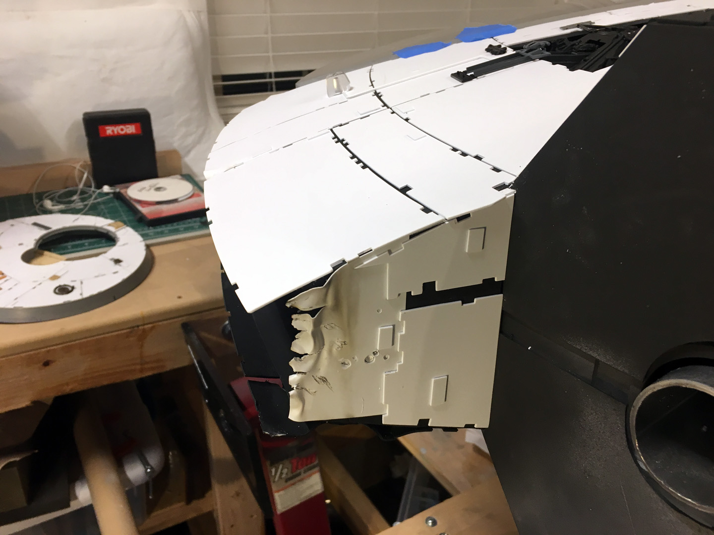

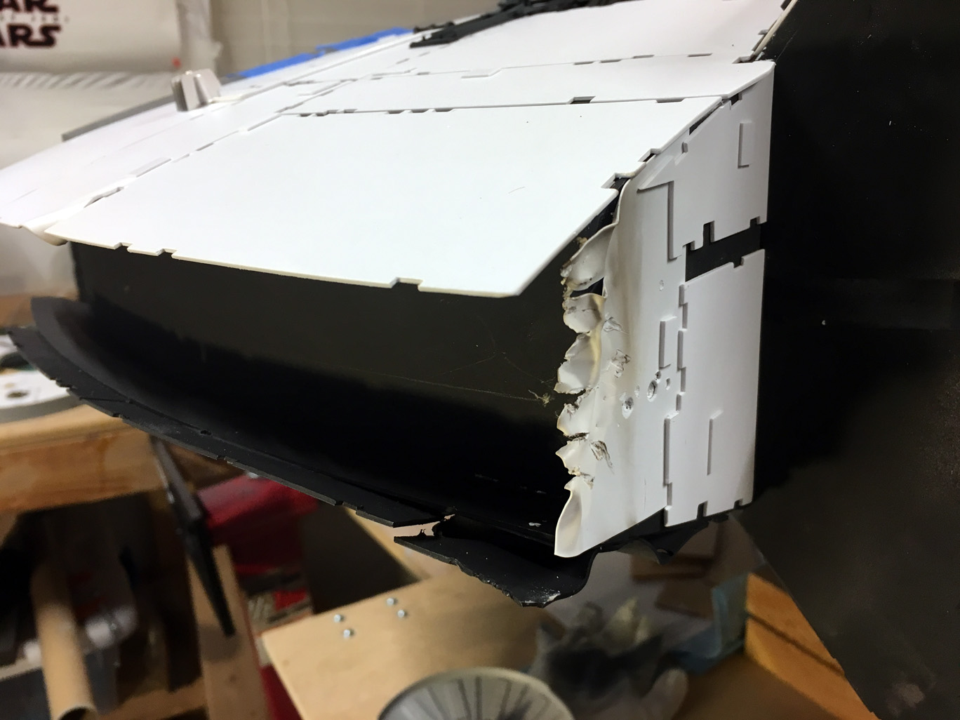

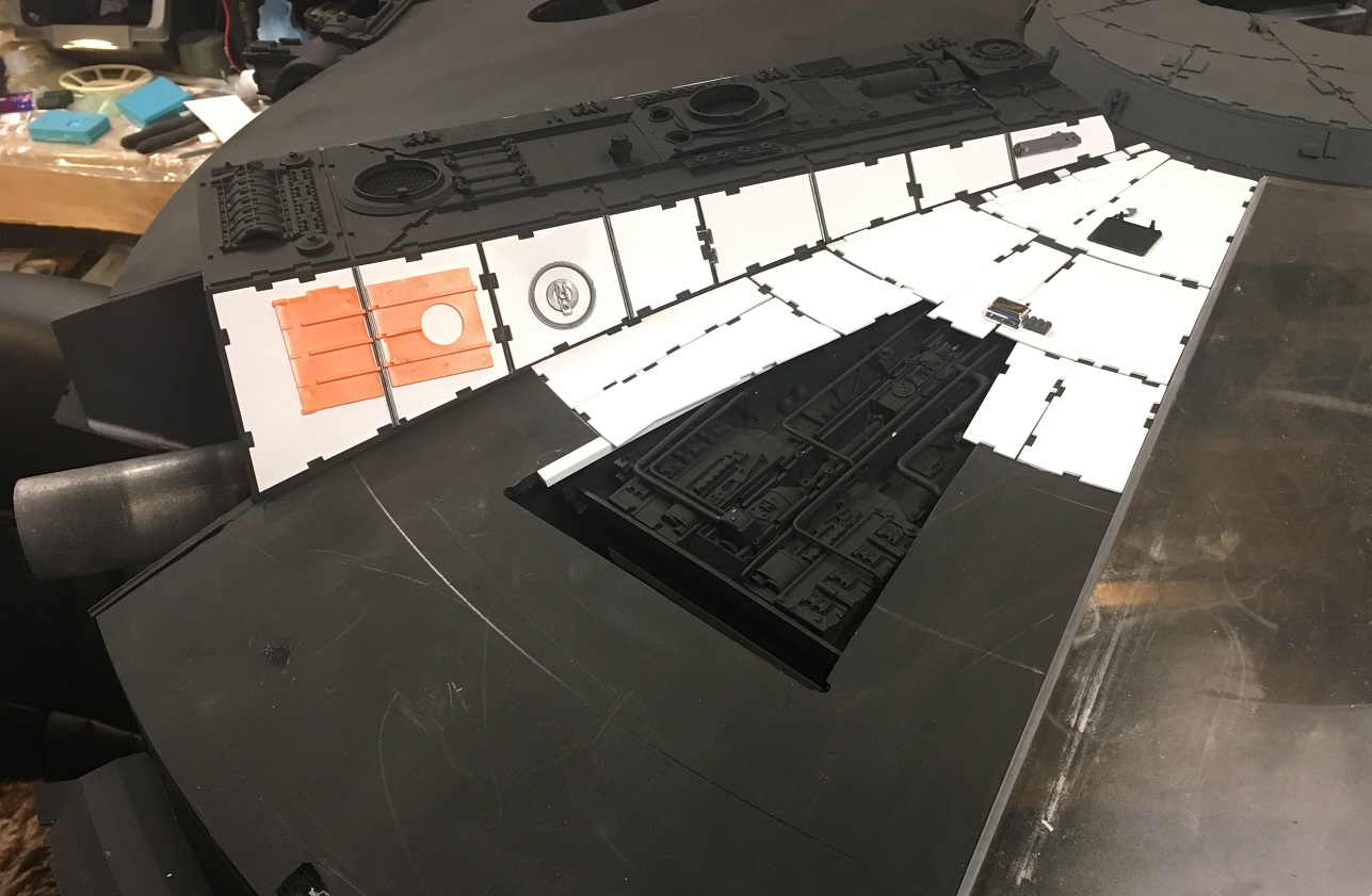

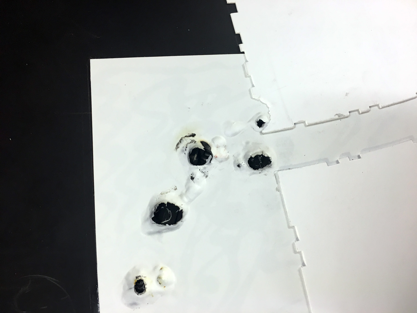

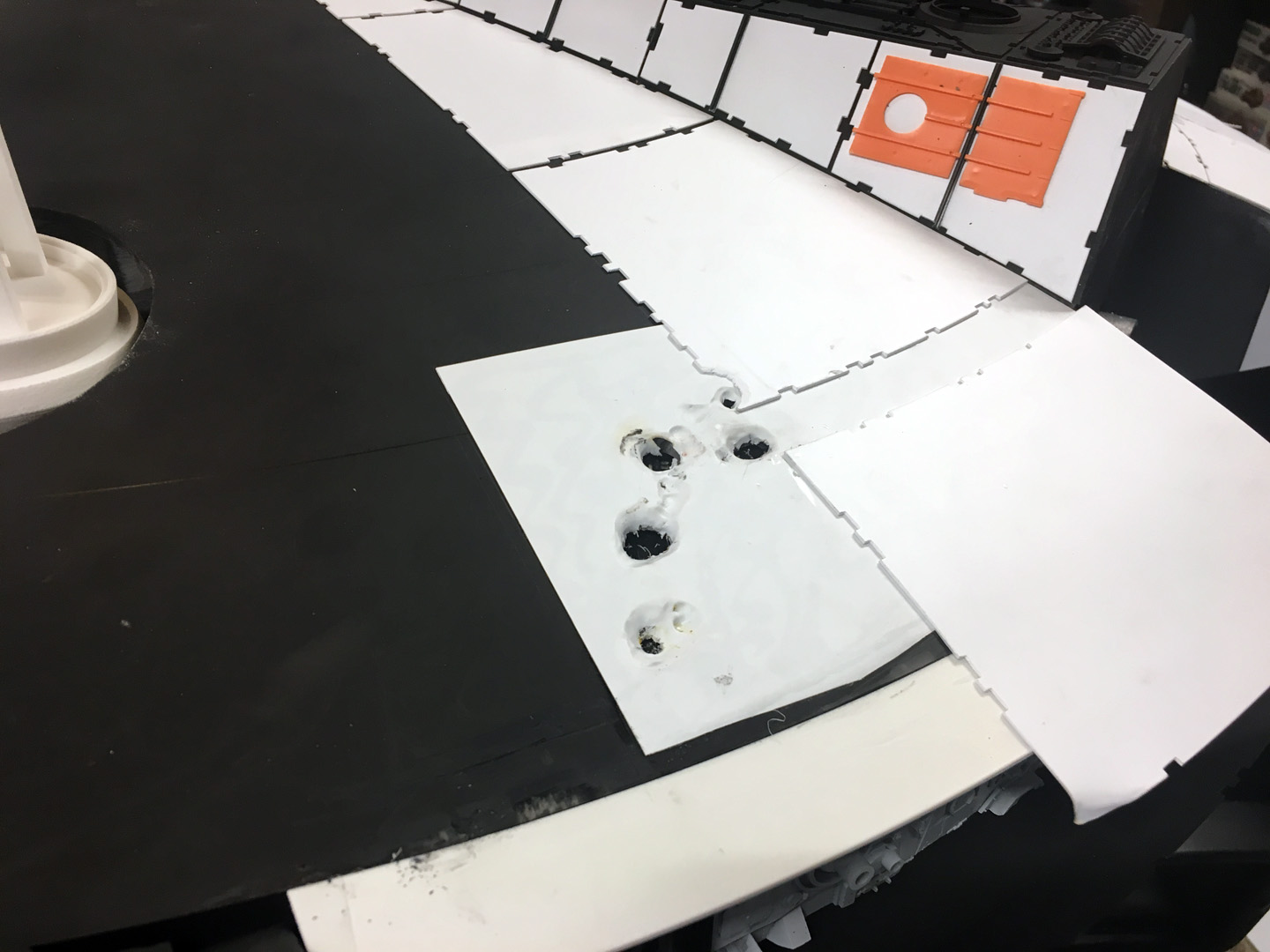

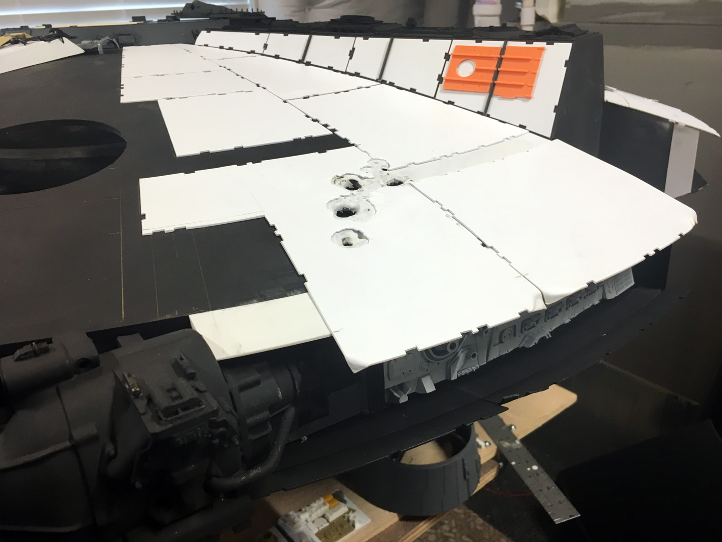

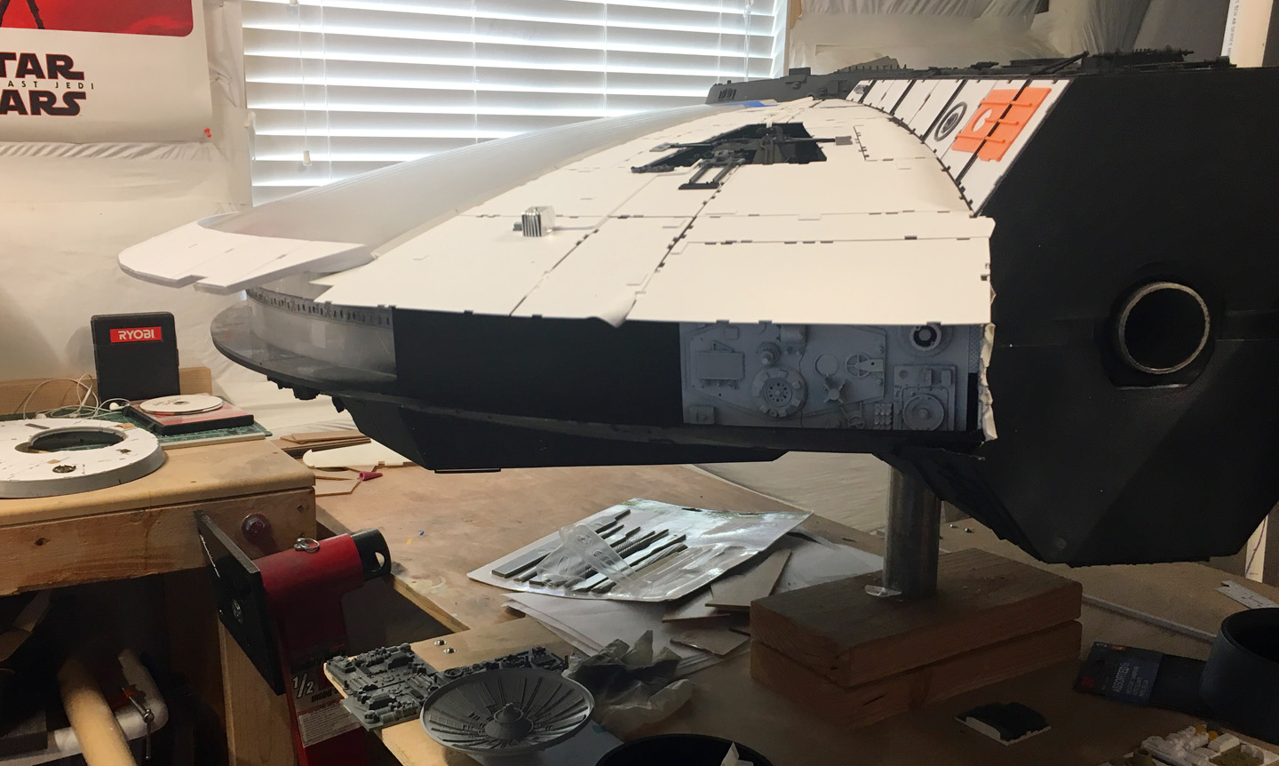

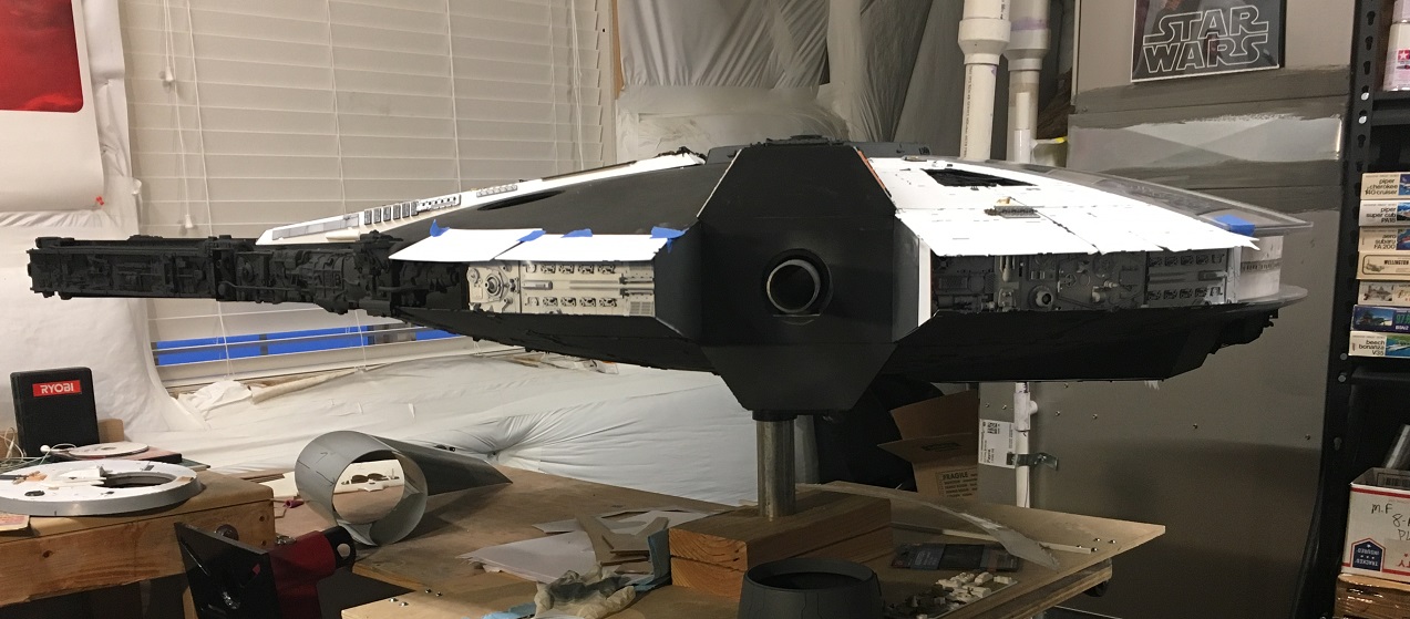

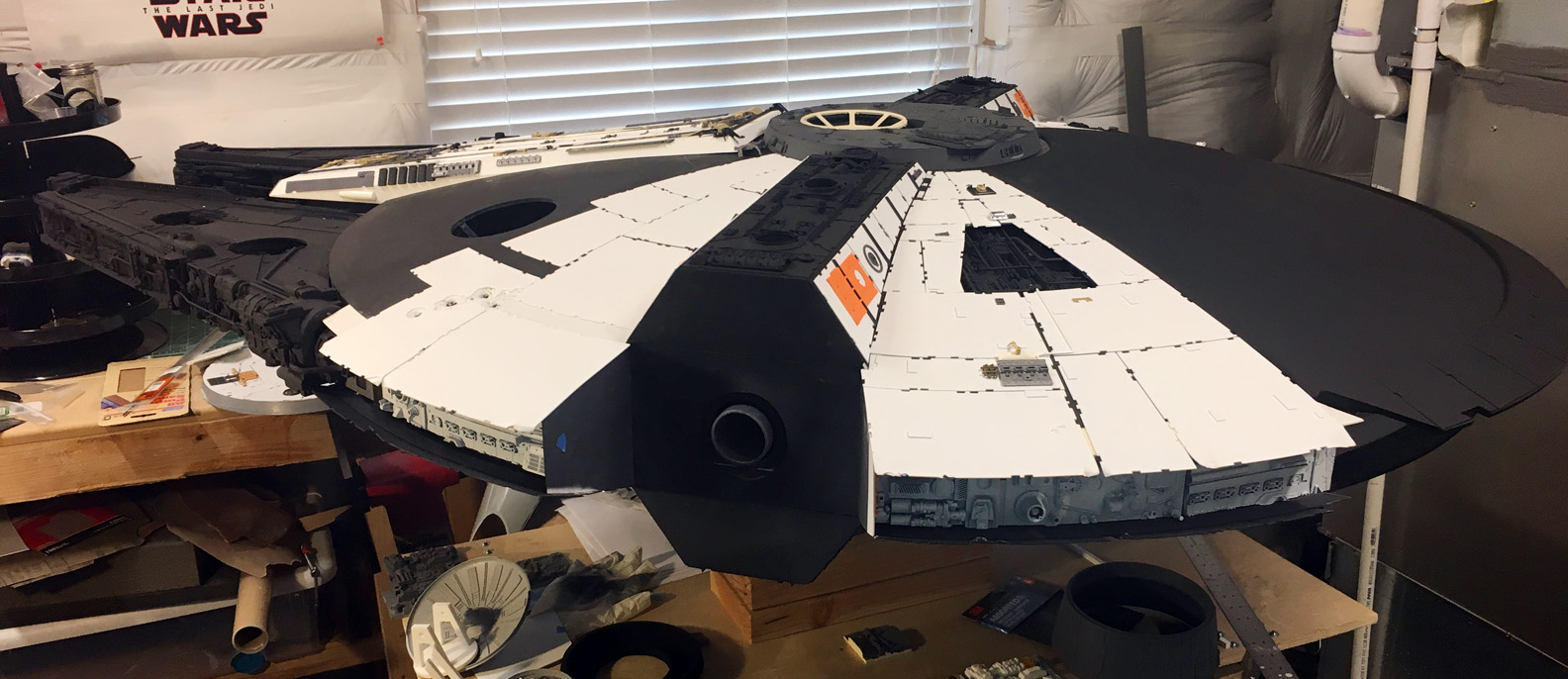

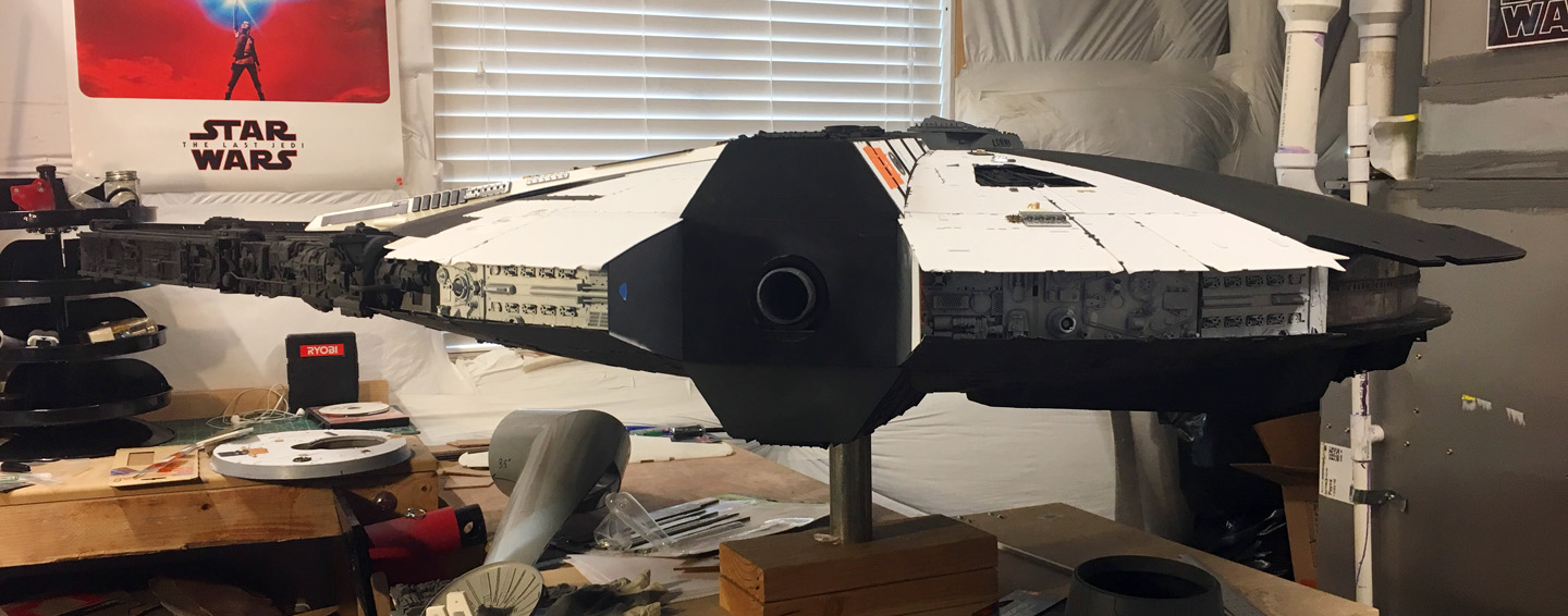

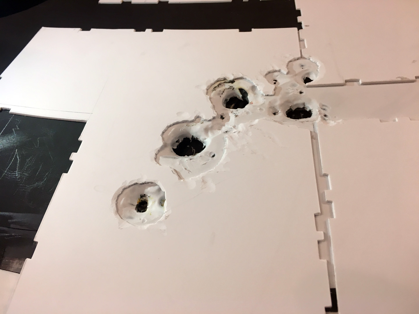

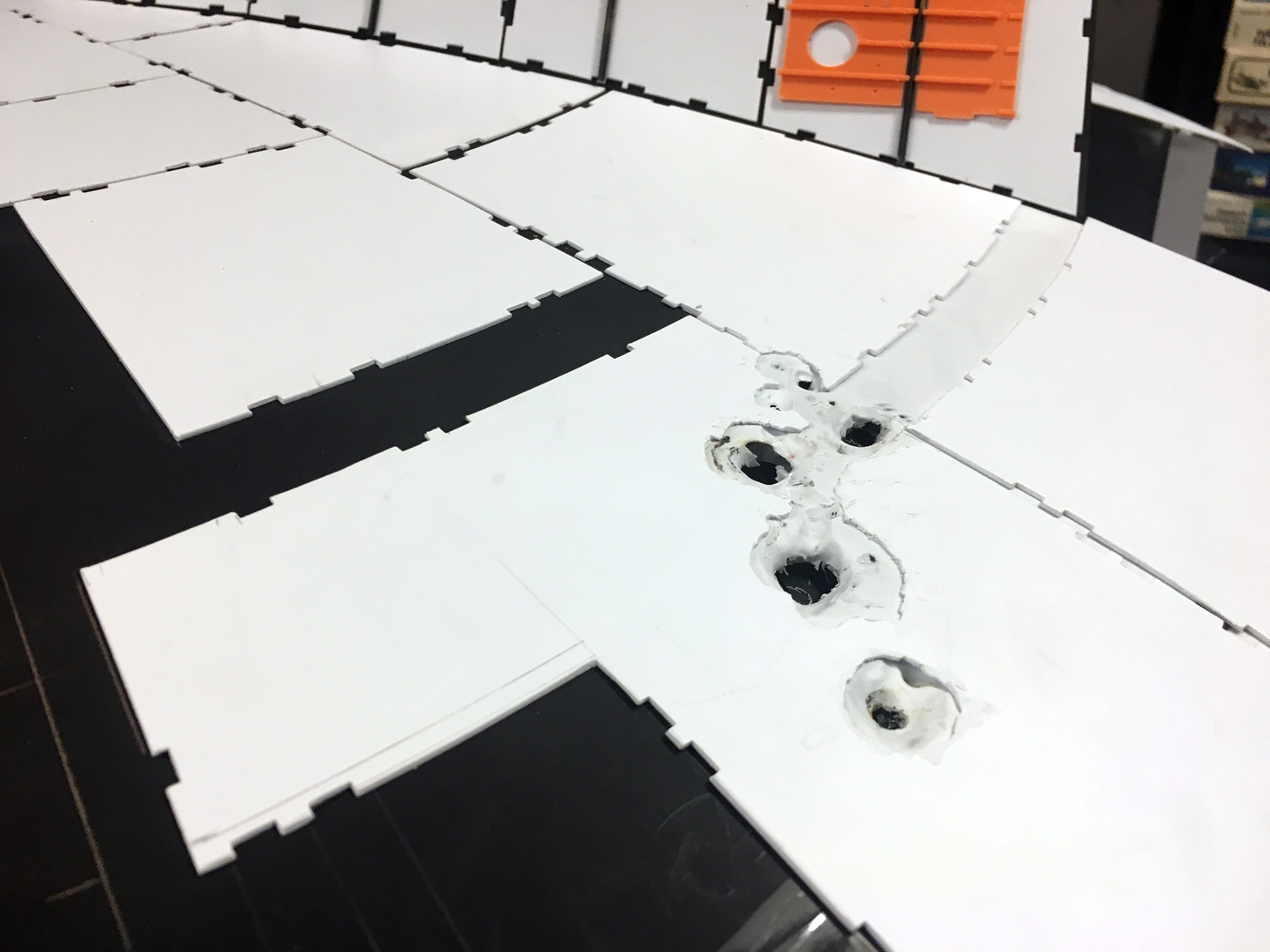

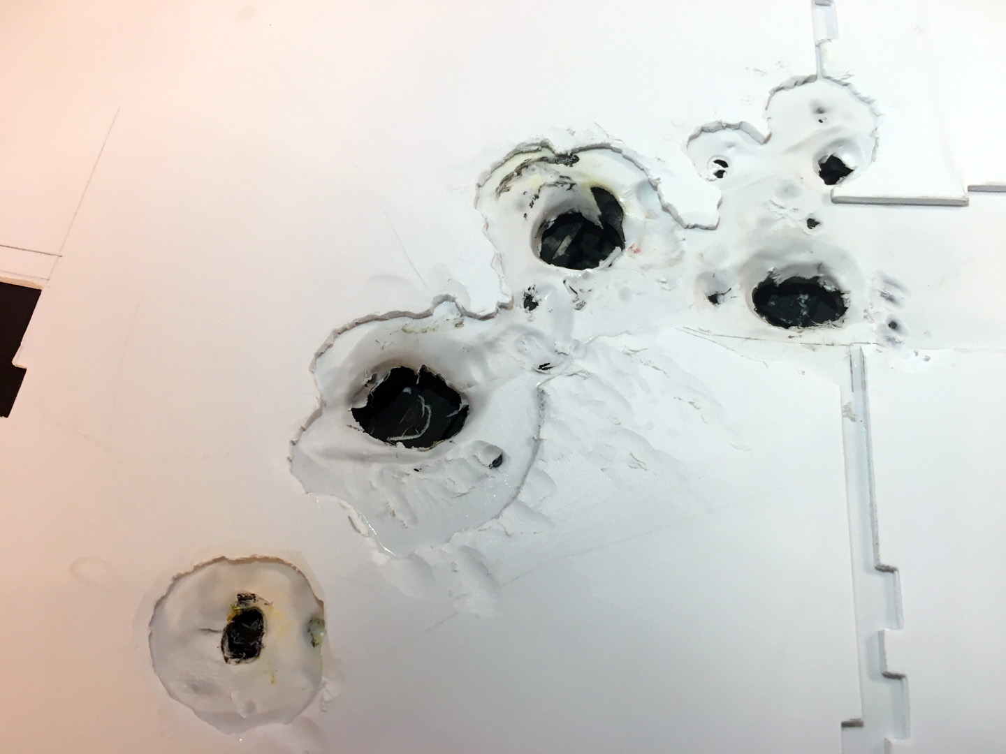

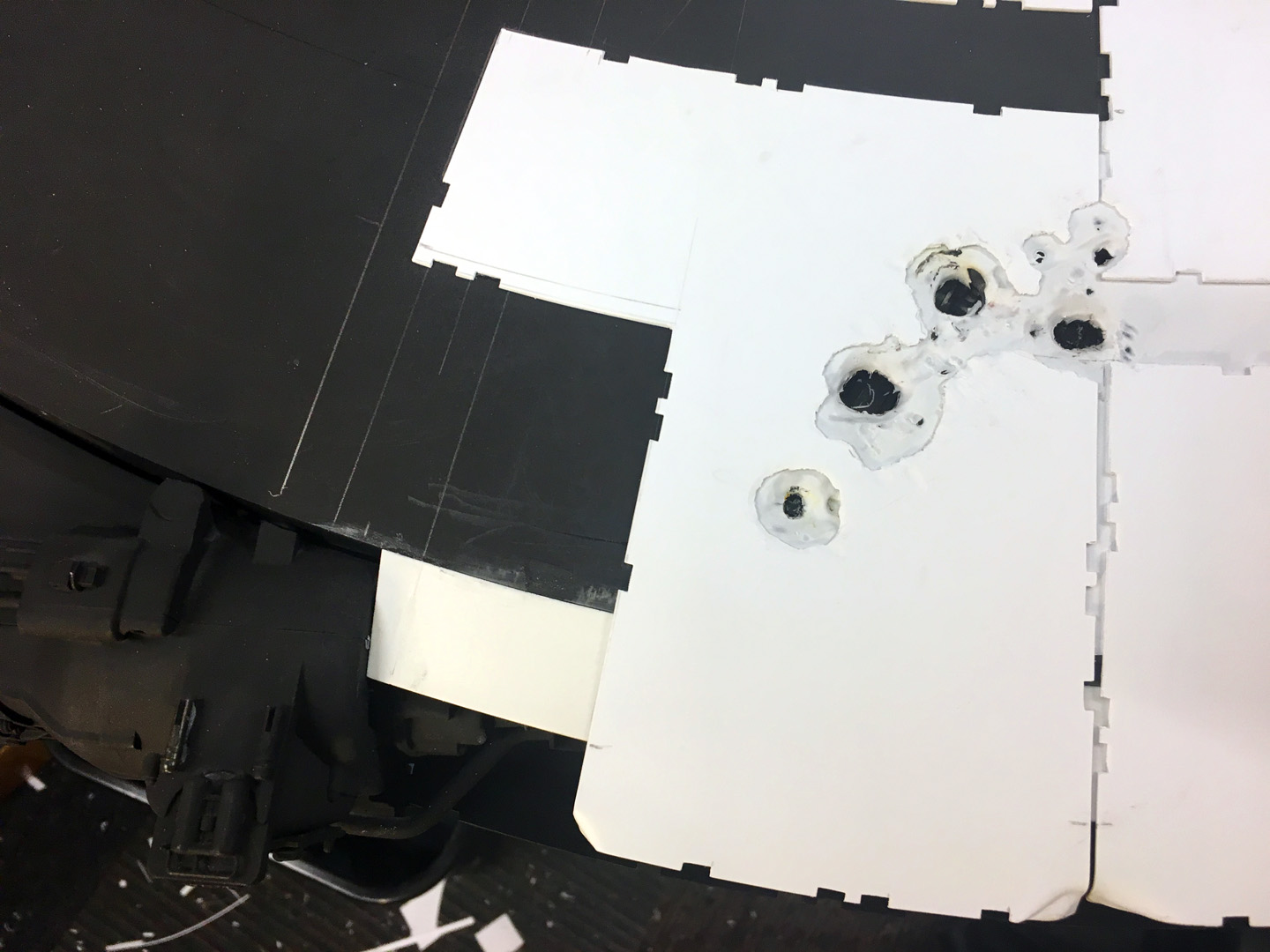

So here's a bit more progress. Worked on the hull damage area on the front Starboard Side and some of the plating. I still have some minor tweaking to do in here, like widen up a couple of the holes a little bit and continue shaping to closely match the original filming miniature. It is so much fun melting and shaping the styrene though!
Starting with the thin styrene sheet that gets melted into the holes I pre cut in the acrylic hull.
Hull Plating cut/formed to match over the melted styrene holes.

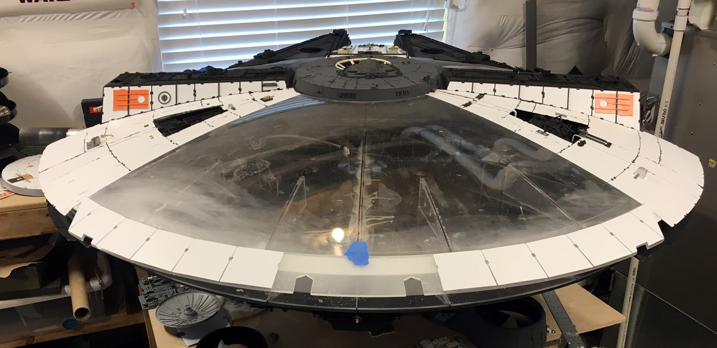

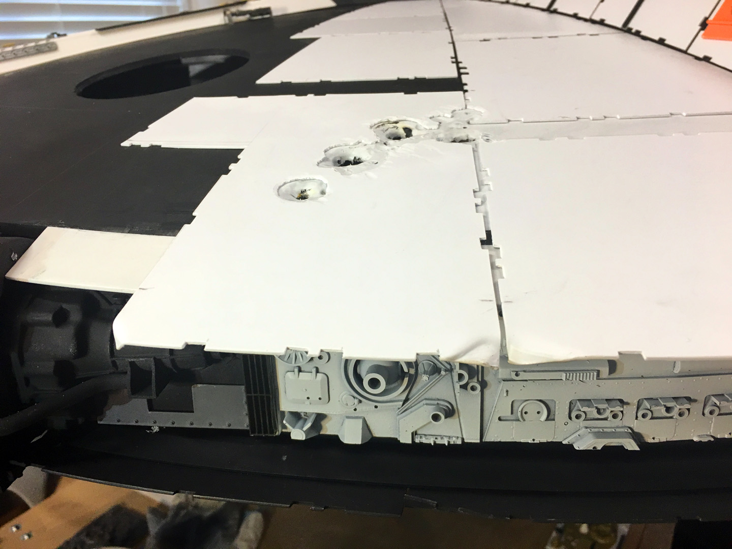

A few of the side views as the plating and overlaps start coming together.
Side view before engine deck cover in place
Engine deck on
Side view with engine deck on with overhang.
THANKS much Fellas!! Yeah, it's also a bummer that the phone cam distorts it all a bit, looks really good in person, especiially those overhangs. They look even tighter and spot on in person!
Something that helps with the wide angle distortion of your camera is to step back with your phone/camera and zoom in a bit. 70mm focal length is a sweet spot and provides the least distortion.
