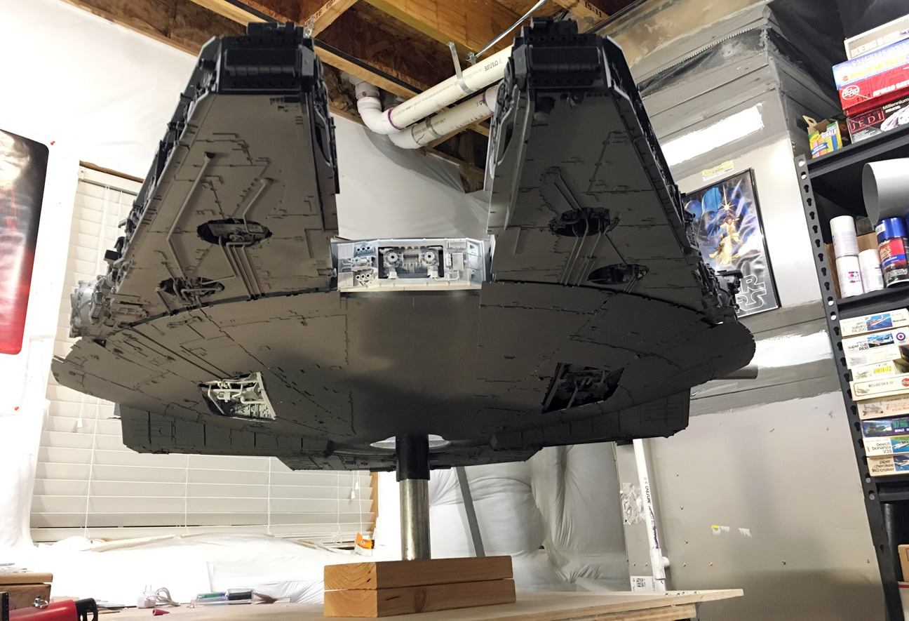

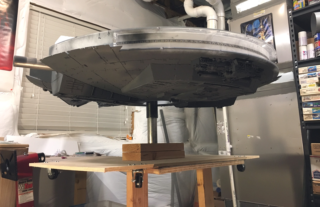

Sean...duuuuuuuuuude...I'm still trying to pick up my jaw off the floor seeing this!. How the heck you get this done so fast & looking so clean & simply amazeballs is beyond me...but there it is...what a sight huh. I know your feeling on sitting there looking at it, it's normal & I do it on some of my built sections, but your progress of the underside is another milestone. Now you thinking overtime & wanting to flip it over to do the top I bet...course you are:).
So impressed my friend!

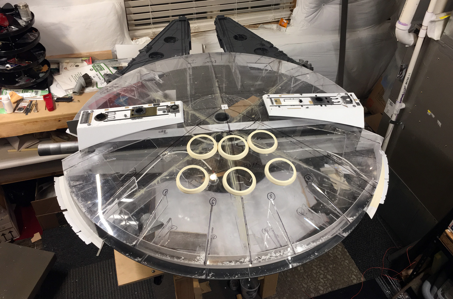

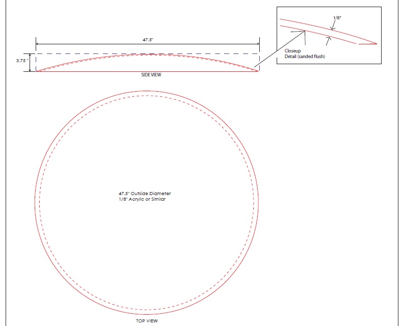

Thanks Mike! VFXSup64/Maruska's plans - that simple, out of the box. Those two amazing chaps' plans are the best 'starter set' around. I simply measured it up, went to a skylight company, asked them to blow mold 3 domes, and as previously mentioned, after 12 attempts, they got the 3 I needed! The domes definitely are a key player in getting this thing to come together! Those fellas' research is Gold and gave me a huge leg up!
This is the initial drawing I made - I later realized the thickness needed to be 3/16, which was the final blown material. Also, note the diameter, I went with the 'core' of 45.5, but the 'lip' extends 1", therefore adding 2" in diameter. After they realized they could not sand flush as I needed, I had the 1" routed off to meet flush to the core. As you may have seen in my earlier posts, I then re-add the 1" extensions to the dome, and skin over that. This gives me an exact replica of the 'inside lip' bevel detail.
I think there is a new prevailing opinion the filming miniature diameter (CORE) may be 46" even (Cardinal measures are common on this ship), but I can live with that minor deviation if it is indeed.
I hope this is okay to ask but would these guys be able to make more domes with the correct dimensions????
Also can I ask why 3?
Thanks
Jamesfett,
These were the only 3 of 12 they were able to crank out to the exact dimensions. (They made them in the 3/16 thickness) Unfortunately, they lost so much on this deal - they were a good, solid company to ensure I got the 3, but they kindly asked for no more work like that. Because they are a skylight company, they don't work to the tight tolerance/accuracy I needed. So Sorry, I can't refer to them.
The reason there are 3 is because you need the 3rd one for the extra 'lips' around the engine, and for the top engine deck where the 6 fan/vent assemblies go. They need to conform to the hull, so cutting that out of a 3rd dome is what makes it a perfect fit/overlay. So there is not much of the 3rd dome left over after chopping it up.

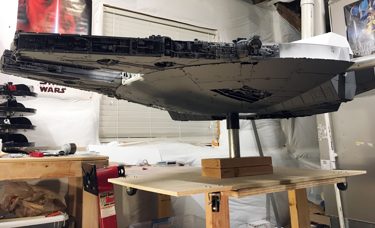

THANKS much Stu!! Yeah, I just flipped it yesterday (Thanks to help from Ryan/Belleauwood) - it's now elevated on the table, so I JOKINGLY had to do this with THAT picture - One can only dream/imagine what that must have been like!
Here it is now oriented properly and ready to begin work!
