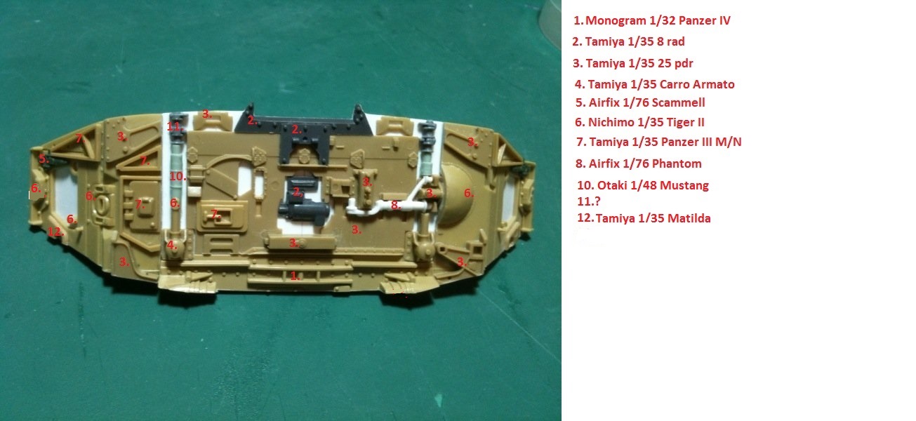

From memory it's 1/600 Nelson.
It is Nakajima.
Thanks! One is a correction and one was a spelling mistake of mine, oops!
And thanks to everyone for clearing that piece up. I see its shape now. And good to know I don't have to keep looking for a La Seine part on the Y.
Update: I fixed my spelling mistake and kit scale mistake back in the post with the image.

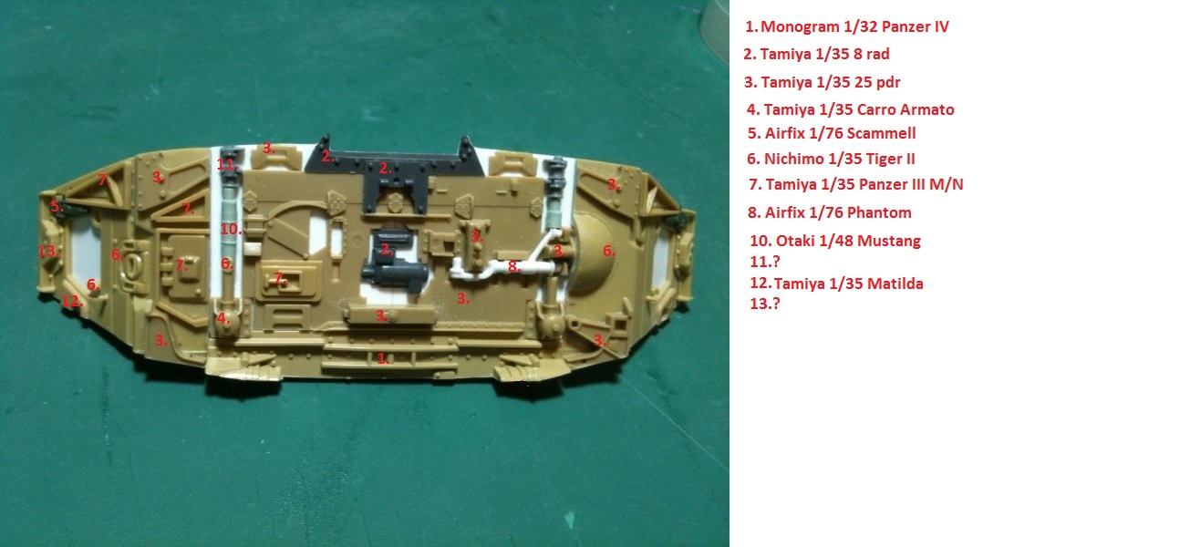

Looking for a hint on this part. Other than the obvious, I believe it to be 1/72, 1/76 scale and either a P-47, or a MiG.
Thanks
Re: Y-Wing Parts Map for the "Green Leader" Project
Updated Map
Anyone how to delete the old images?
