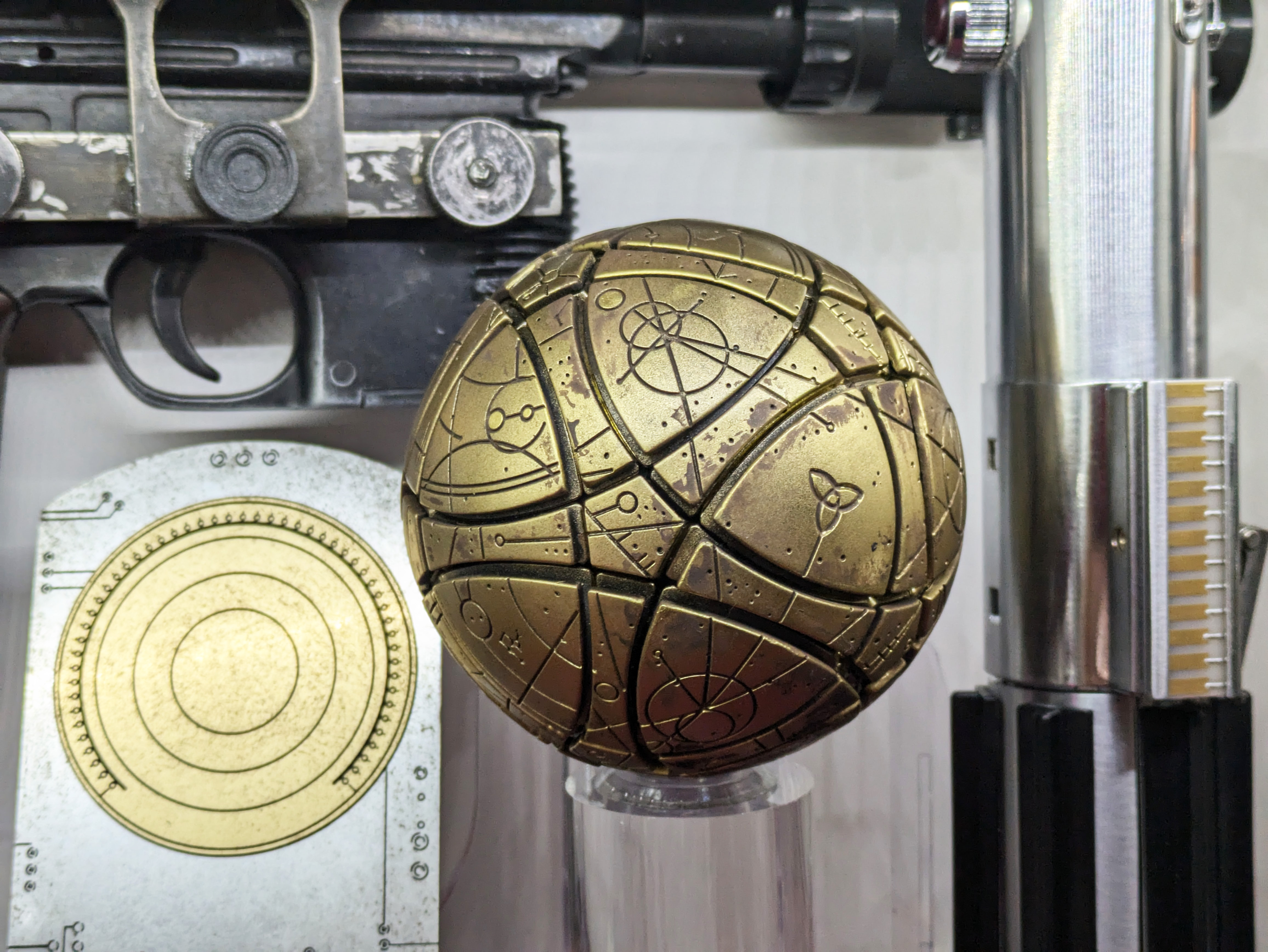

Just to let you know that I am in the process of printing the versions of the complete maps. For those who wanted complete unpainted ball kits (option 2), the kits will soon be available. During this time, I am making the versions with the painted bricks ready to stick on the megaminx (option 3).
I succeeded, I think, in solving my varnish problem (several thin diluted layers, instead of one big wet layer ;) ) and I reworked the color of the brass which I found too yellow with the added weathering ;)
I'll post some photos to keep you waiting :)

The paint and weathering look great! I love the design of the support for the lighting system.
Thank you :) just to be clear with everyone, there is no weathering here, it's just the base chrome coats before the weathering.
Julie has pretty much validated the weathering as well and I think it looks really great. She should have photos to show soon enough :)
