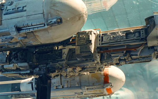

Here's an image of the Jammer I just realized I had. I found it on another model site a while ago. I'm sure it's been posted here before but I think it has disappeared from any threads it's in. I've never seen it here. I can see one piece of the droid strip on the left, along with the centurion piece again. And you can see the other piece from the Bandai 1/48 PantherG on the bottom there as well!

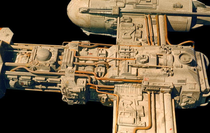

And this is an old one I found from the same site! I've seen a zoomed in version of it before here. It gives a bit better view into the neck area between the firewall and droid slot to see those Command Post pieces and even a well lit view of the top of the wings.

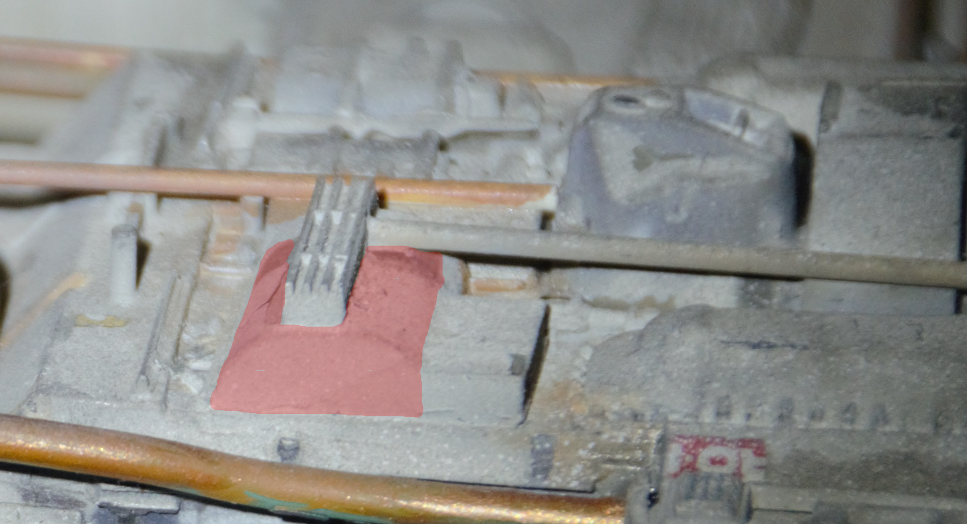

Is this highlighted piece from the Heller La Seine? I believe the kit is used and from the bad scans I've seen it's all I can recognize. Thanks for any help.
Re: Y-Wing Parts Map for the "Green Leader" Project
Ok thank you. Is the La Seine used at all on the model?

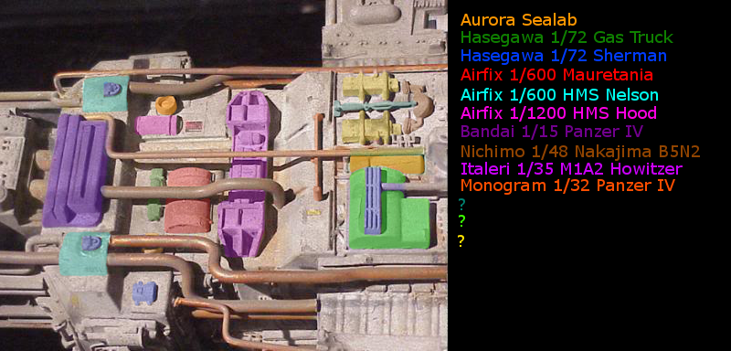

This is another view of the top of the Red Jammer thanks to the help of much more knowledgeable people from this thread. Let me know if I have made a mistake at all here. I wish I could figure out the mirrored yellow pieces here. I'm wondering if they are from a 1/450 Hasegawa ship maybe? I cannot find scans of those ships online easily.

I think that rectangular box on the right of it is attached to it too.

There's a clue given somewhere that those yellow pieces are from a ship. Closer views make it look like the bridge of a small scale ship - it's got tiny ladders on it.

I've read that the attached box is scratched and by looking at the buildup of EFX gold leader images it seems to confirm that thought. And yes I read that too which is why I think it could be from one of the Hasegawa 1/450 models which I have not found good scans of. Both the Tirpitz and Vanguard are ships in the giant stack of kits posted a few pages back. And I wonder if it could be in one of them.
So I should probably edit my second image to reflect the box as being scratchbuilt... my bad.
