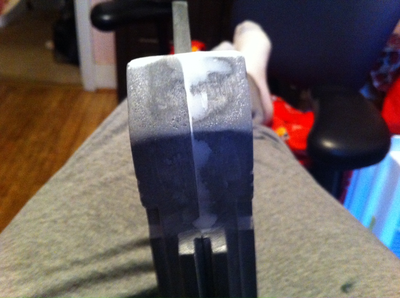

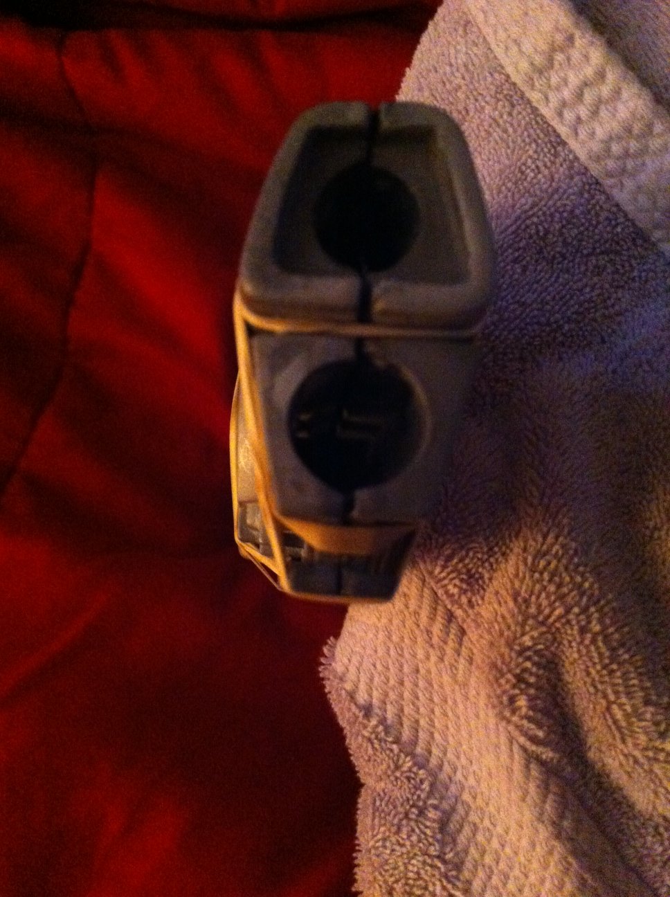

Quick Update. Well after thinking long and hard on the specifics of internal wiring vs my hope to "soon" move onto the holster I've decided to forgo sound and glue the two halves of this kit together. Here are some pictures;

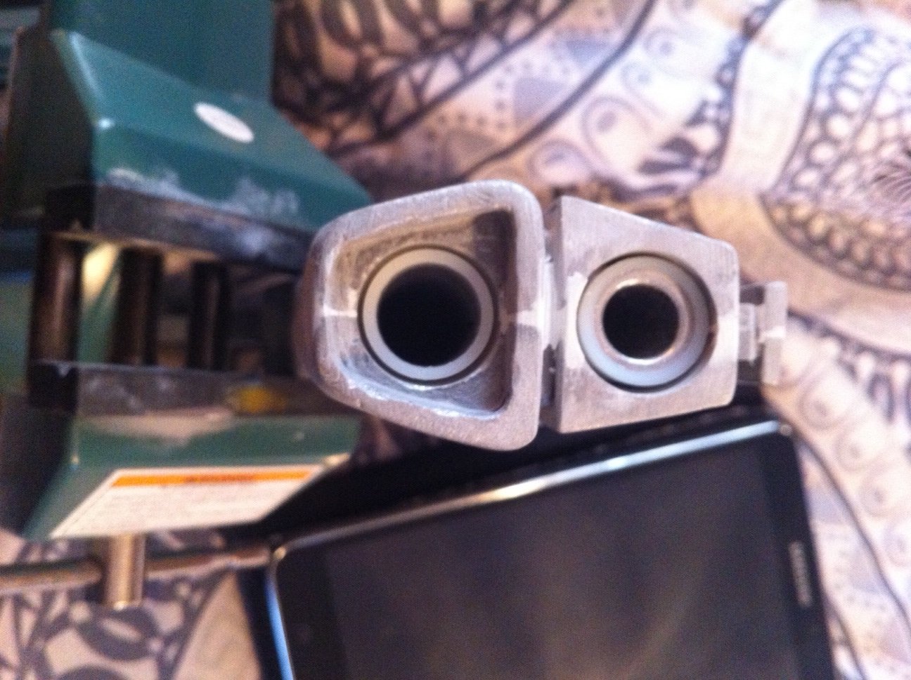

Now I really didn't like how the upper muzzle was looking in the piece so I widened the opening a bit to insert a tube that the metal muzzle that came with the kit will fit in to. The new opening and parts are below;
Now the real fun starts; puttying the gaps and fully blending the new upper muzzle pieces into kit. Mine you I might do the same thing to the lower Grenade Muzzle, (but with just the larger piece of Plastic tubing. More to Come!!!

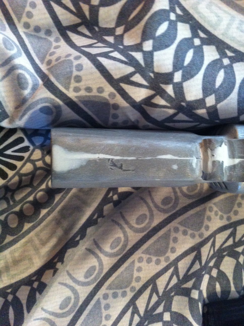

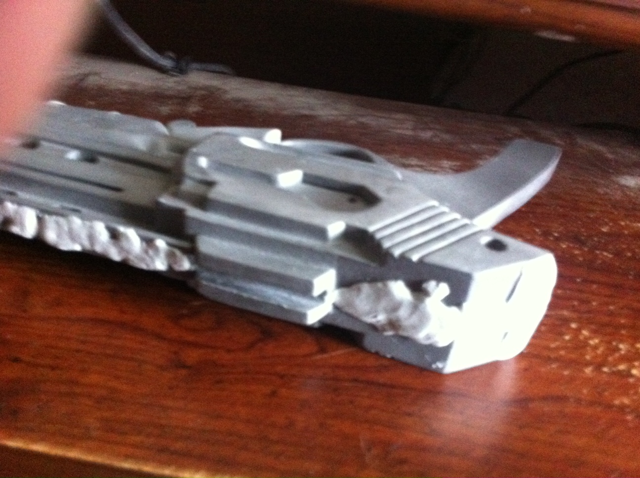

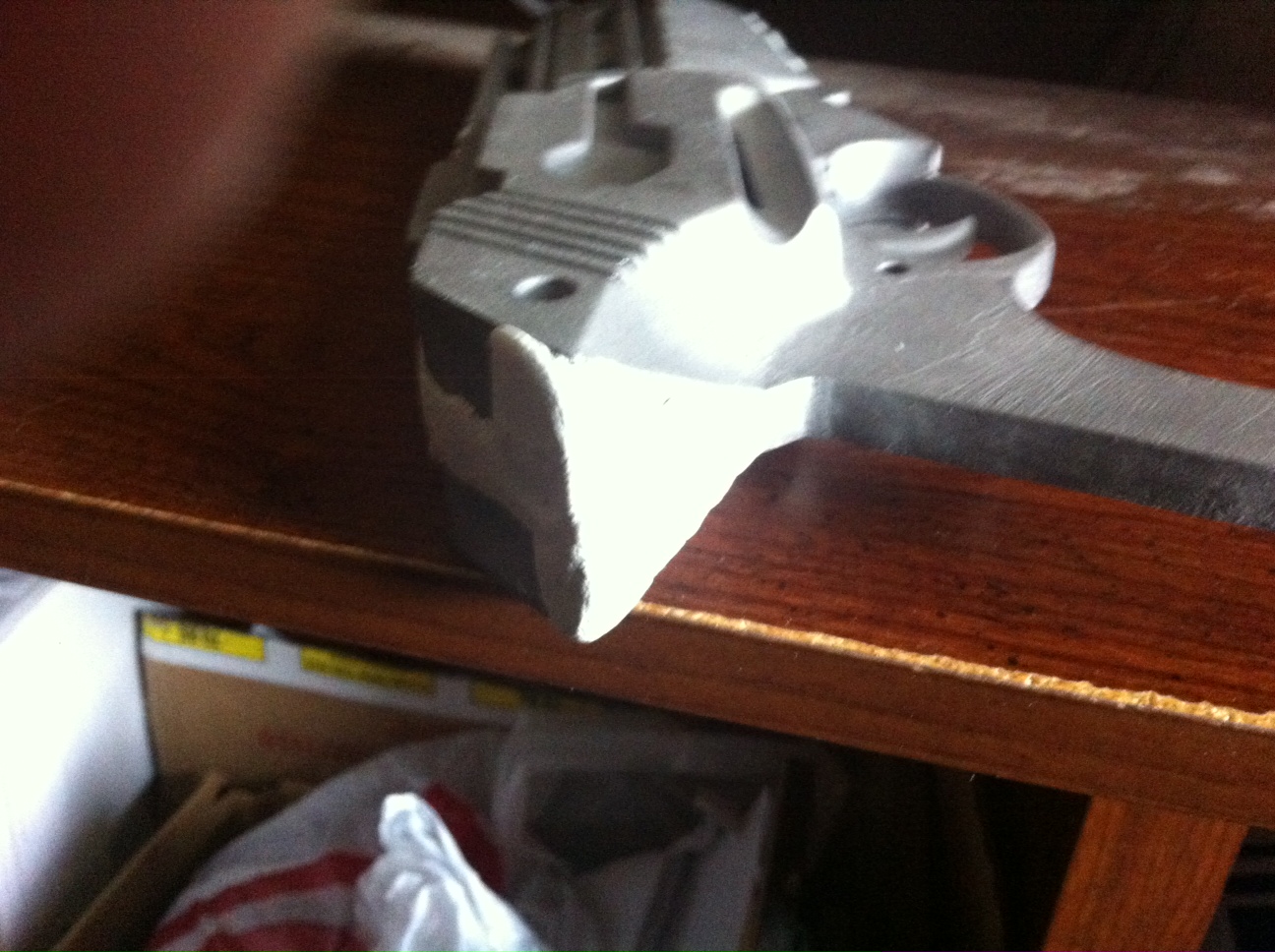

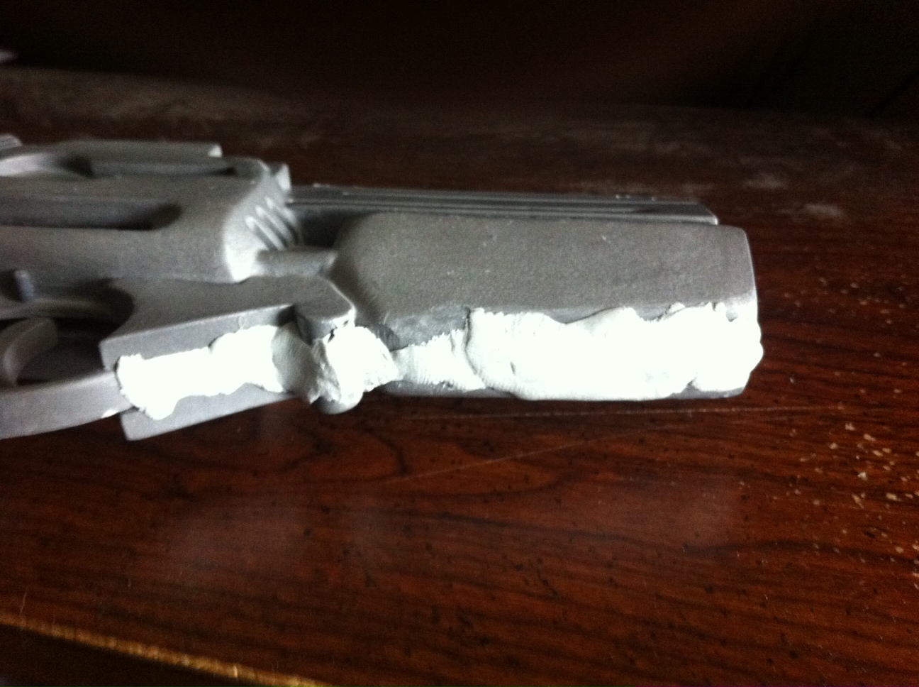

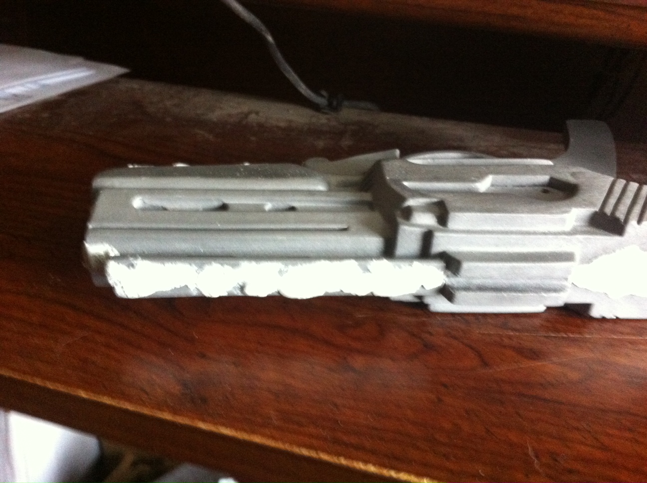

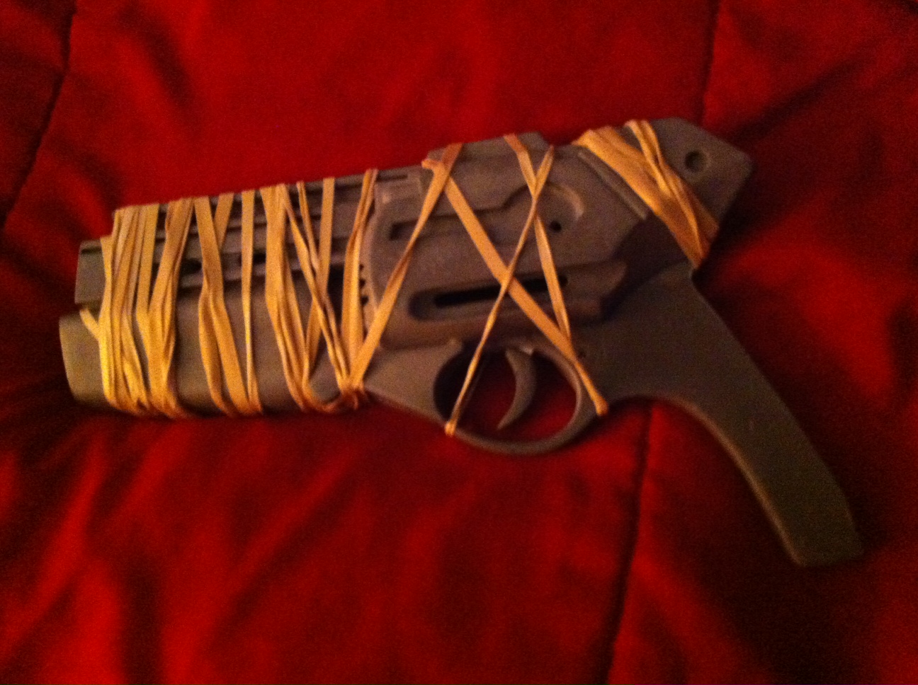

Minor Update today folks. The seams on the Blaster have been puttied and has been set aside to dry;

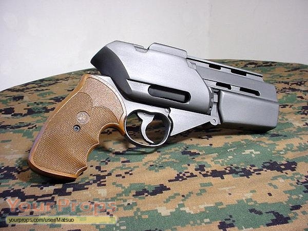

I'm using Epoxy Sculpt and by tomorrow or late tonight this stuff is going to be as hard as a rock and ready for sanding. Now that I have sealed the piece I'm wondering if I want to build it as intended; as the Season - 1 Blaster or make it a smoothie so to speak and go for the Miniseries Version below;
. This of course will mean filling in the rear grill detail as well as the recesses on either side where the switches go but the putty will work wonders here. Oh well the decision can wait a bit until I see what I have after sanding.

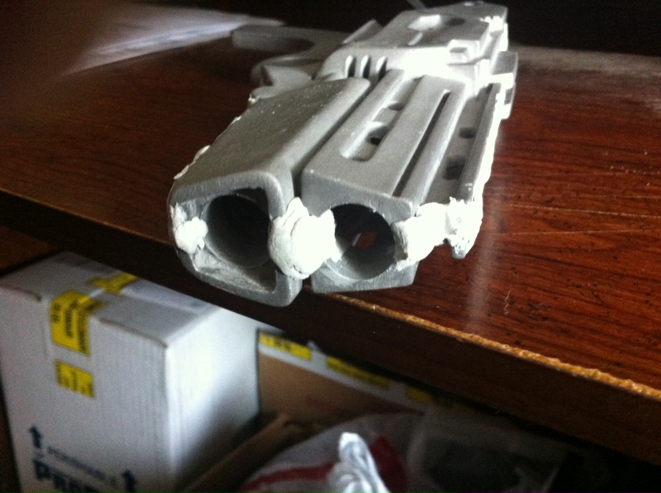

Re: WIP - BSG S-01 Blaster and Scratch-built Holster!!!

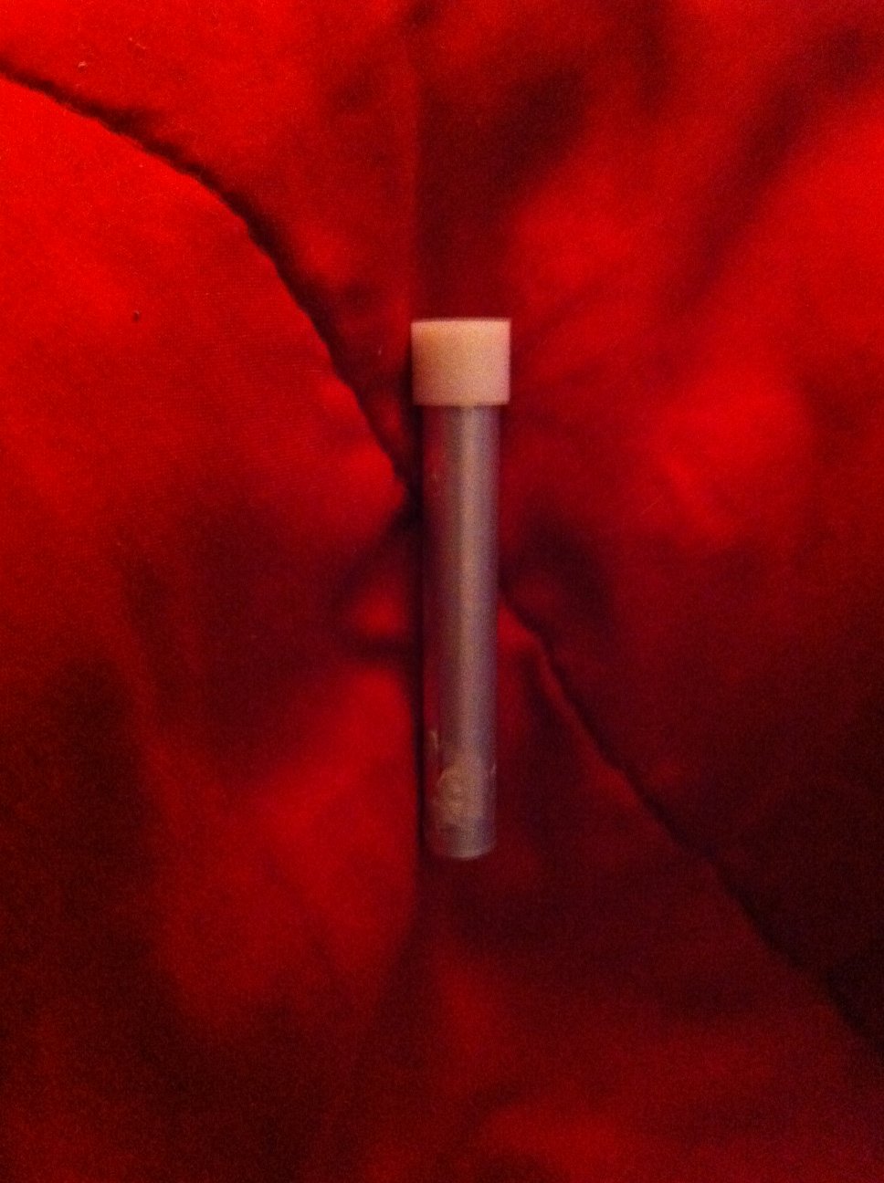

Some progress shots from last night. I've gotten a lot of rough sanding work done and I wanted to see what the new muzzles looked like with the metal and plastic tubes inserted;
The major gaps filled in well and its a big difference over what I started with;
A lot more work to do but I'm happy with the progress. More to Come!!

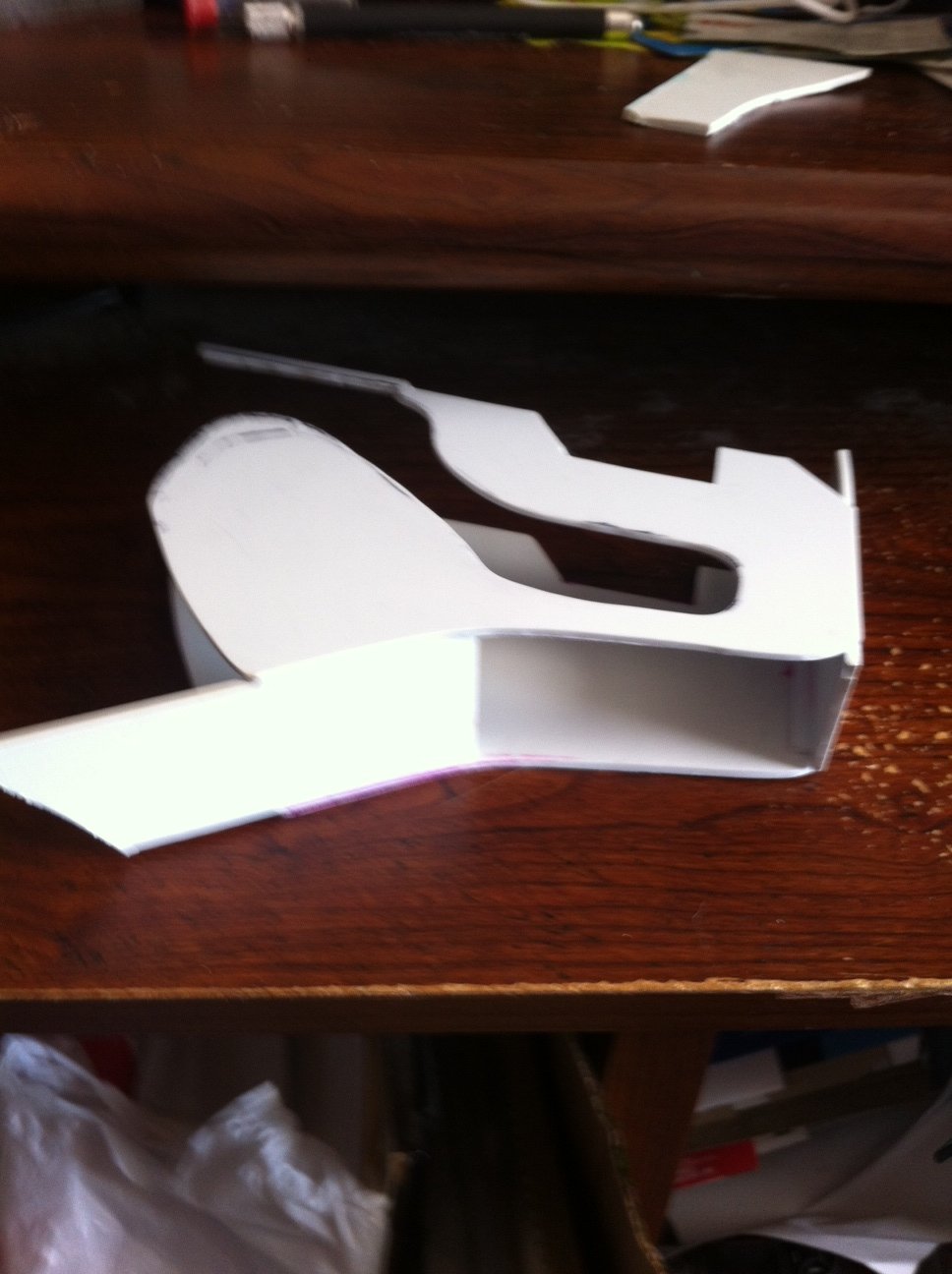

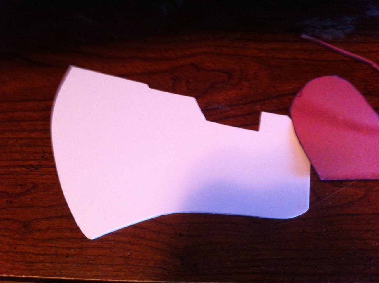

Now that the rough sanding is almost over I'm going to jump back into building the Holster. I needed the blaster together so I could use it as a form so to speak. The first hurdle is going to be cutting that flap out of the plastic.

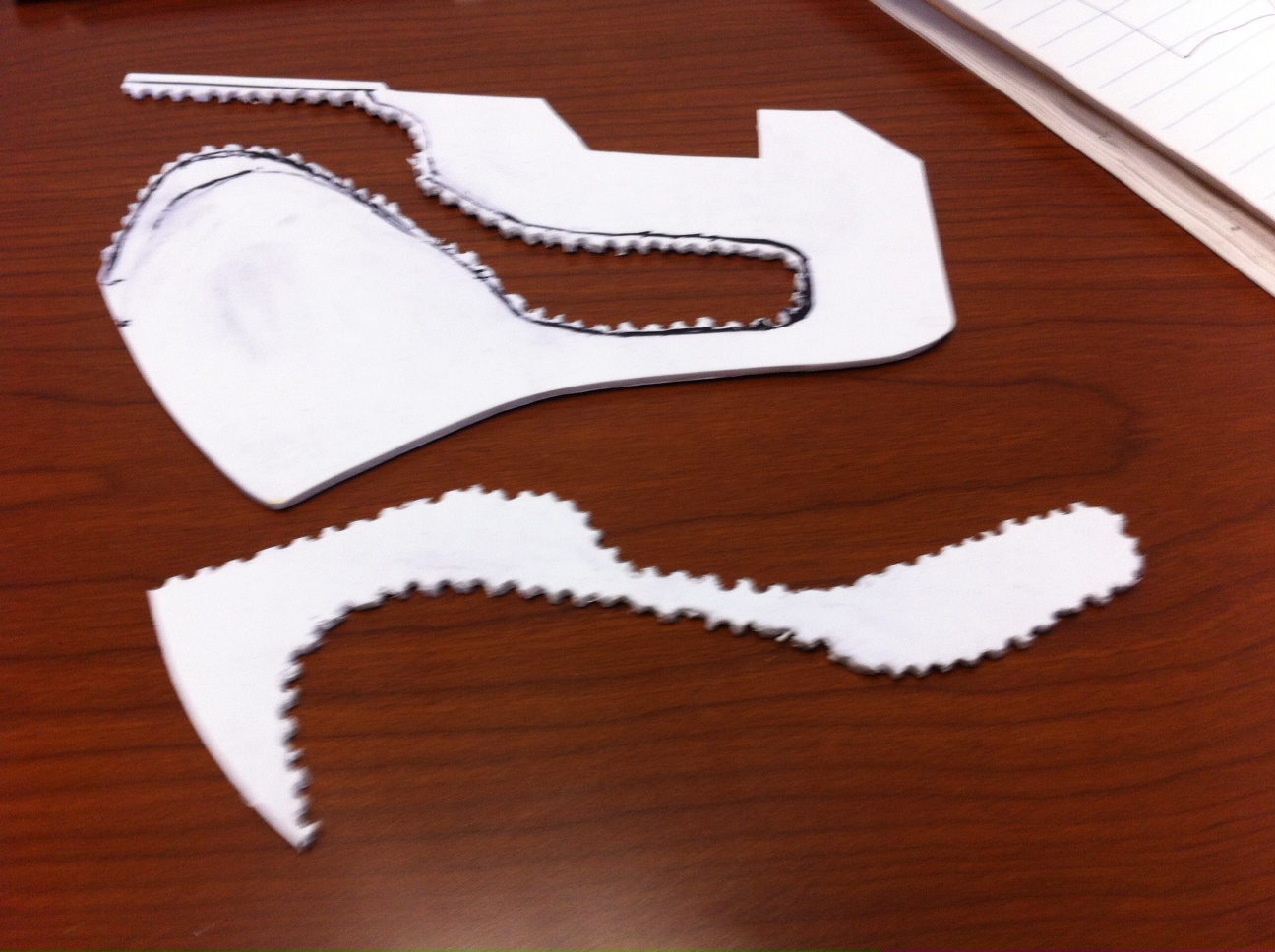

Probably going to do this old school; marking, drilling pilot holes along the border all the way around and then connecting the dots with the Razor Knife. After that it's back to sanding, sanding and MORE BLOODY SANDING!!!!!! More to come!!

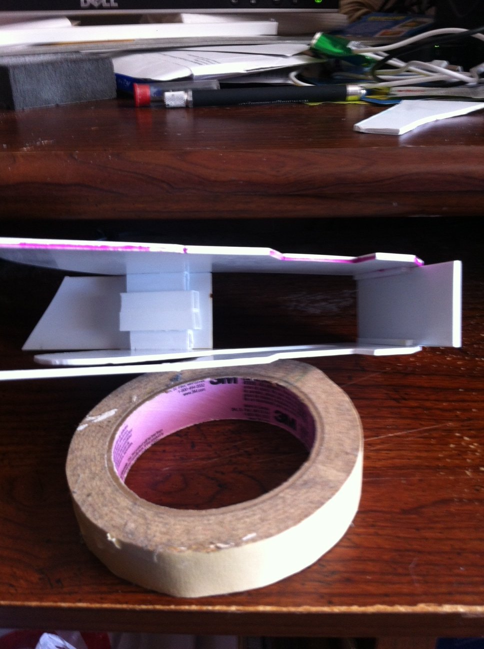

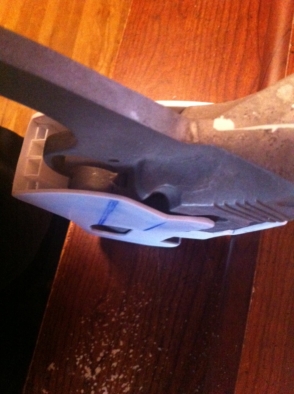

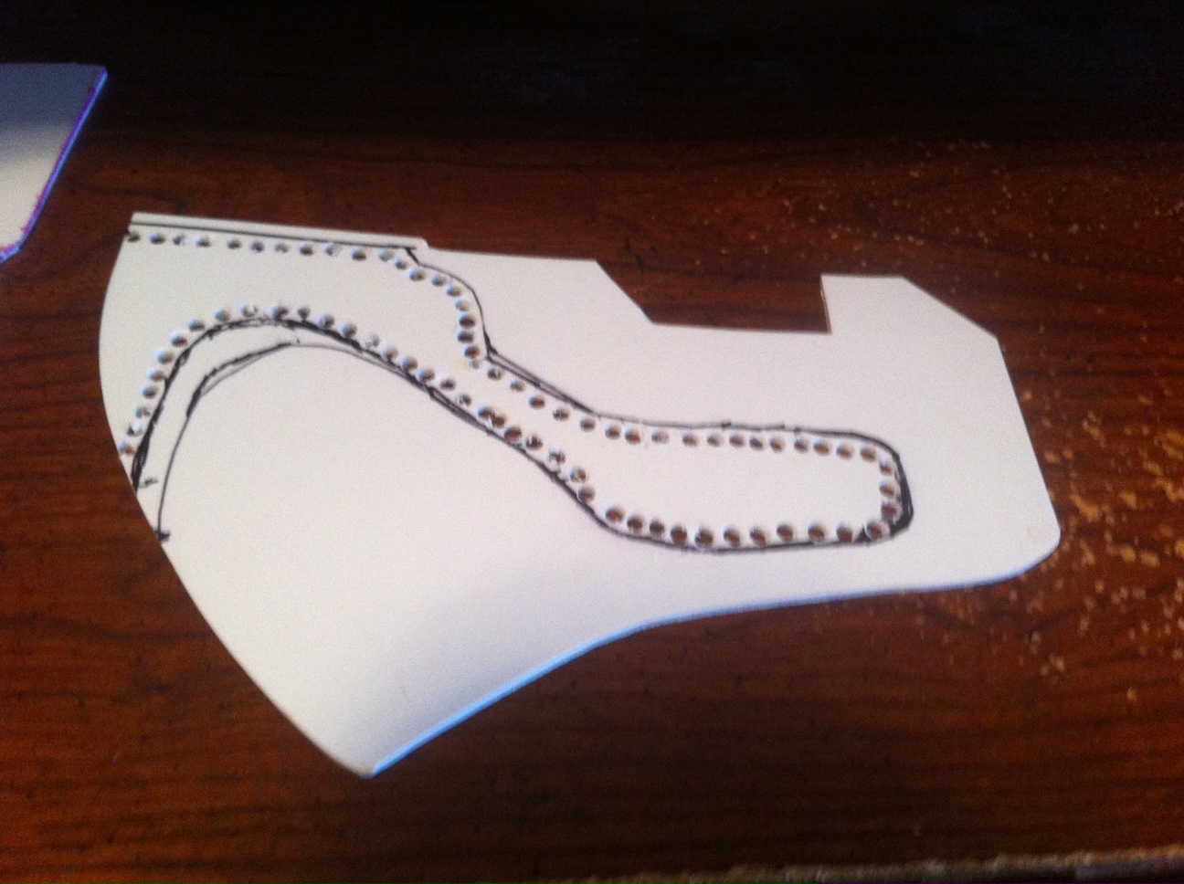

More late night work folks as I caught up on the latest episodes of my favorite shows; The Expanse and Agents of Shield that I had on the DVR. Pilot holes are drilled and now on to cutting the rough inner shape out of the plastic.
Note the double outlined curve on the LHS of the piece. After that is cut out at the highest point I'm going to try to create the "bent" holding "tongue" of the holster by heating up this section and bending it to shape. Wish me Luck!!!

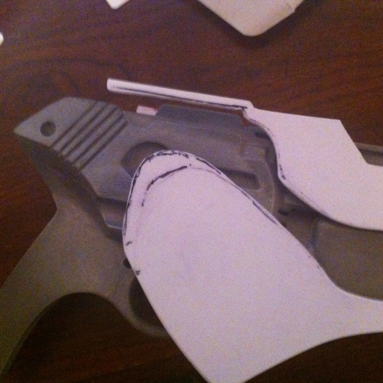

Got some work done over the last few hours while the wife and kids were watching a movie. Getting the pistol together has inspired me again. Take a look;
More to come!!!

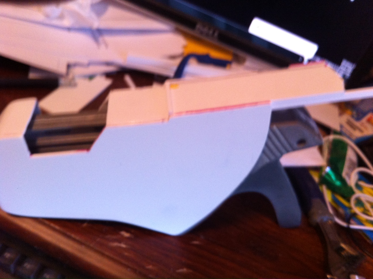

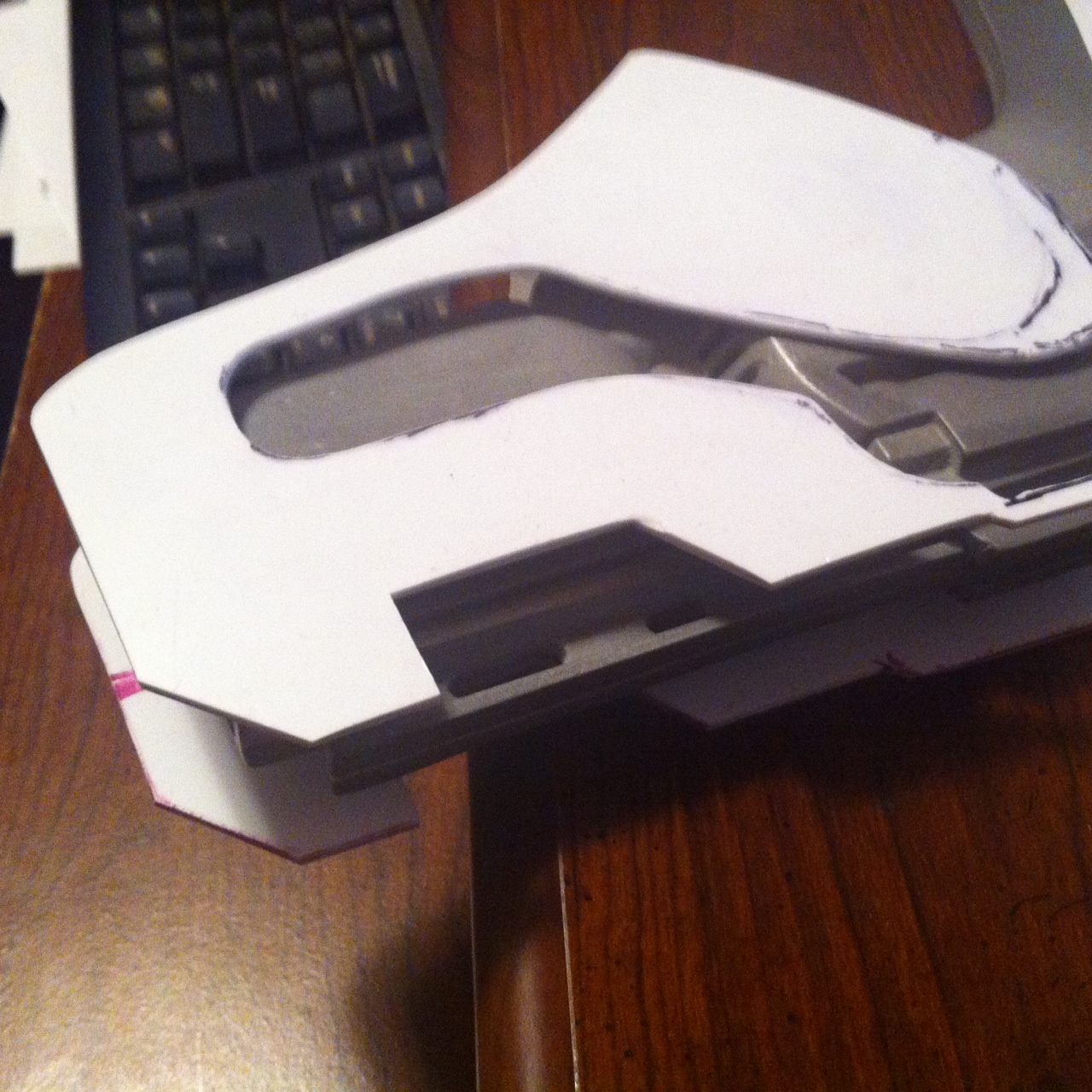

Minor update today; I've started to sheet the outer surfaces of the holster. One note if I ever attempt to build another of these holsters I'm going to use a slightly thinner stock plastic. I wanted to use the materials I had on hand but 1/8 inch stock is a witch to cut but now that I'm deep into this piece I'm sticking with it. Here are some pictures;

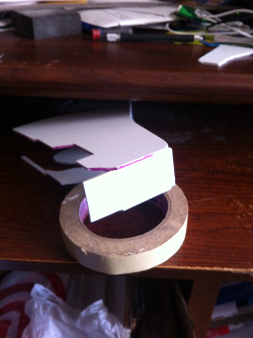

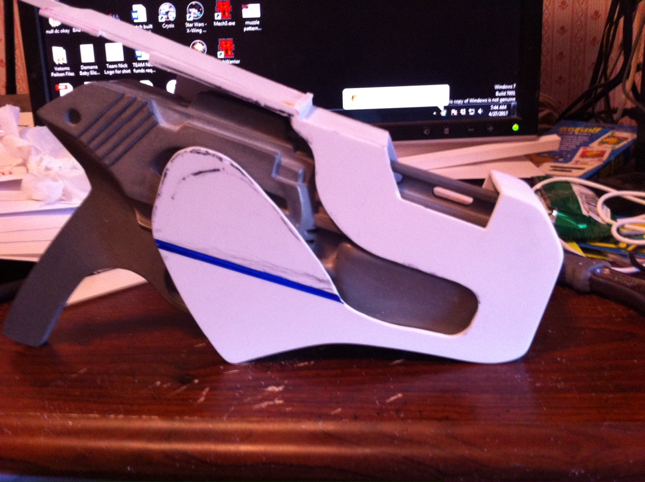

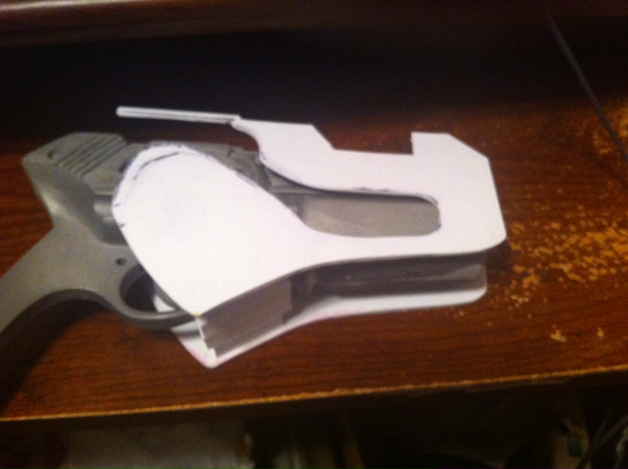

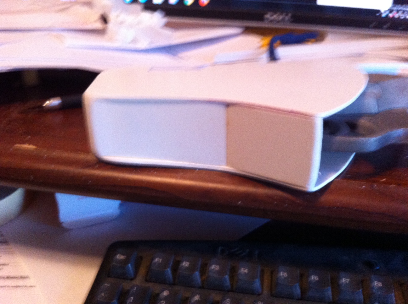

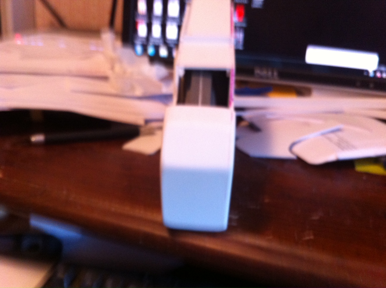

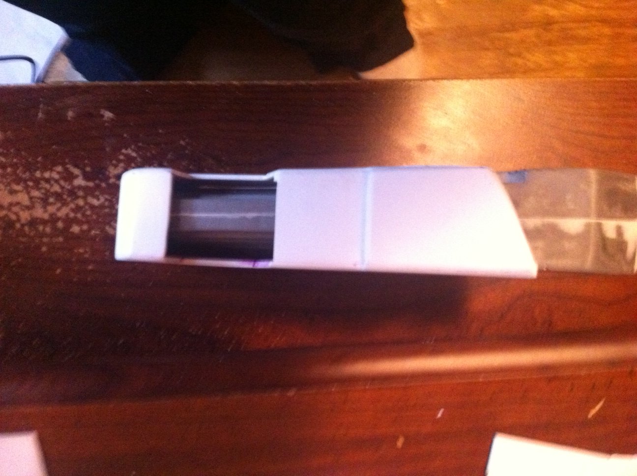

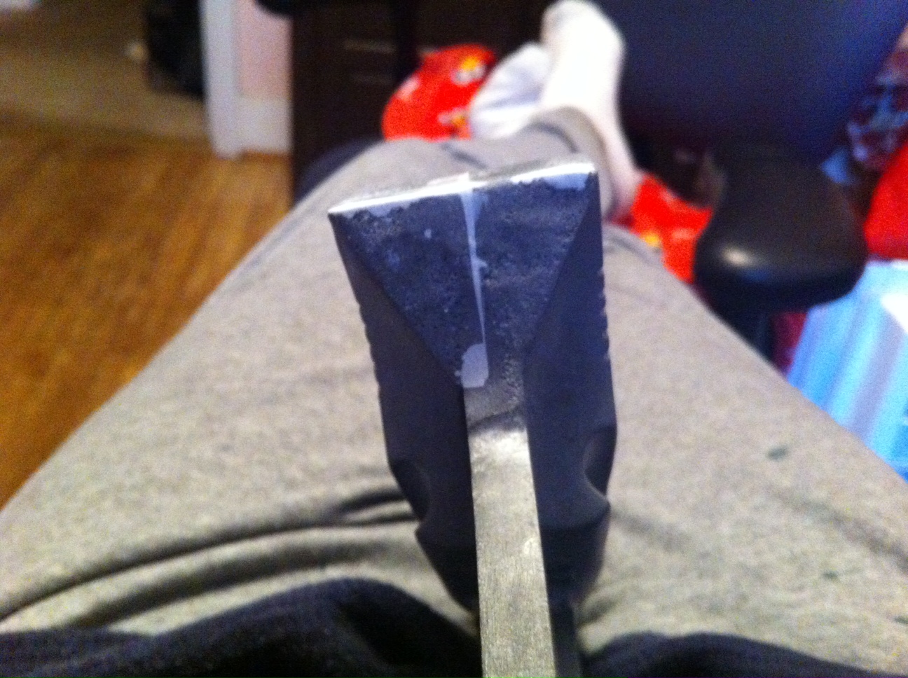

Minor Update today folks; the holster's sides and front are completely covered and I just have to add a cover where the pistol enters the piece. After that major SANDING and some CUTTING!!!

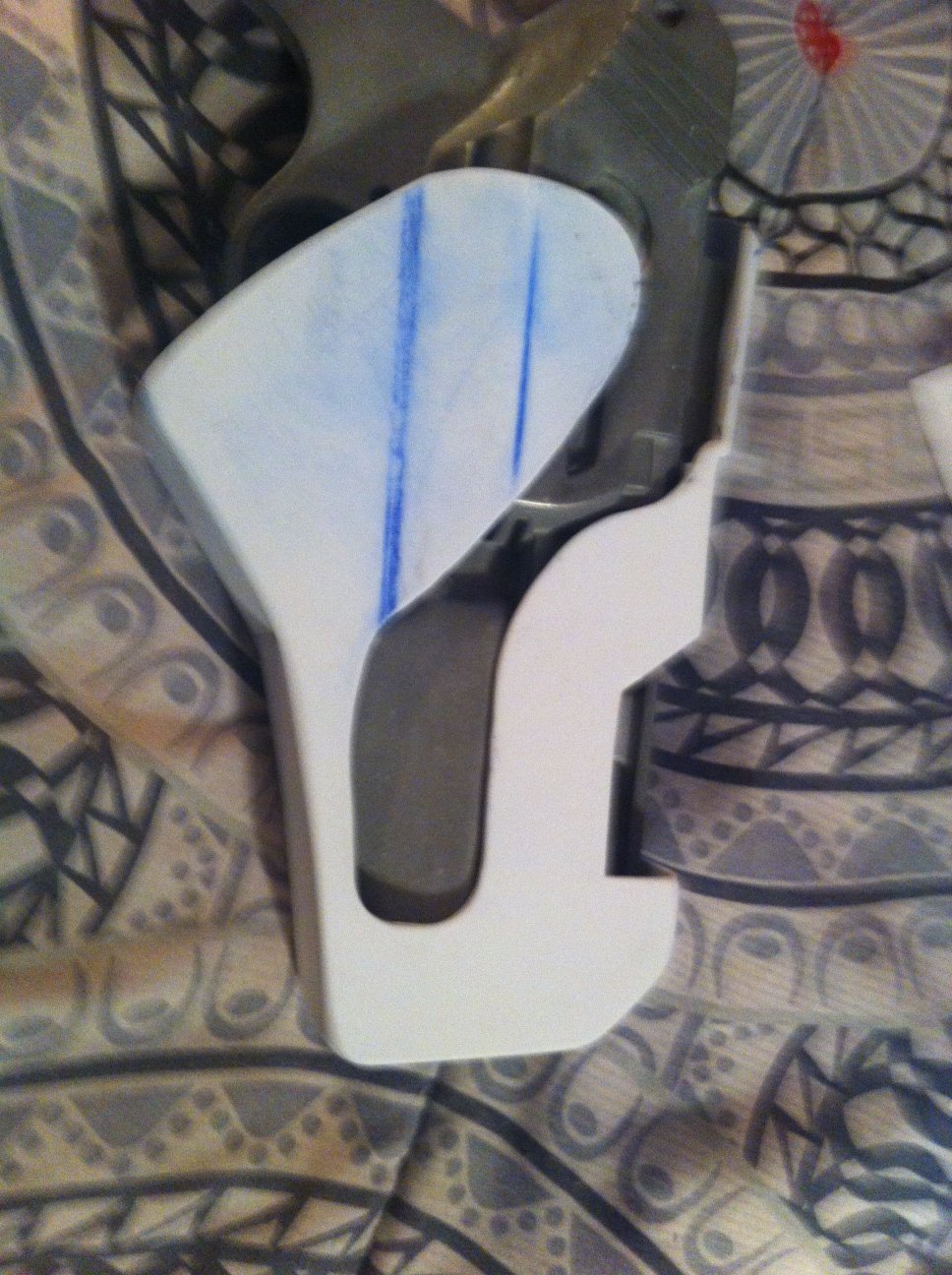

Oh by the way the "blue line" in the last picture is going to be my lower bending point for the retainer flap of the Holster. I'm going to heat the plastic with the wife's heavy hair dryer and bend the flap at that point using a metal straight edge. If that turns out okay then I will go for the second bend at a higher point (as well as re-work the shape of the flap a bit. Note, I have two more BSG Blasters that I want to build holsters for and I already know what I have to change in those builds. Among a few size issues is of course THE FRONT PROFILE!!!! Looking back I should have taken more time to follow the shapes of the muzzles and not just gone with a flat rectangular front. Oh well, I will get this holster and pistol done and then dive right back into those projects in the coming months..

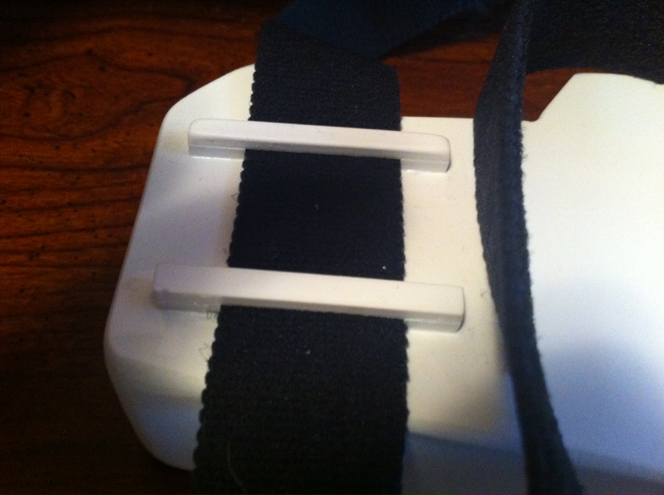

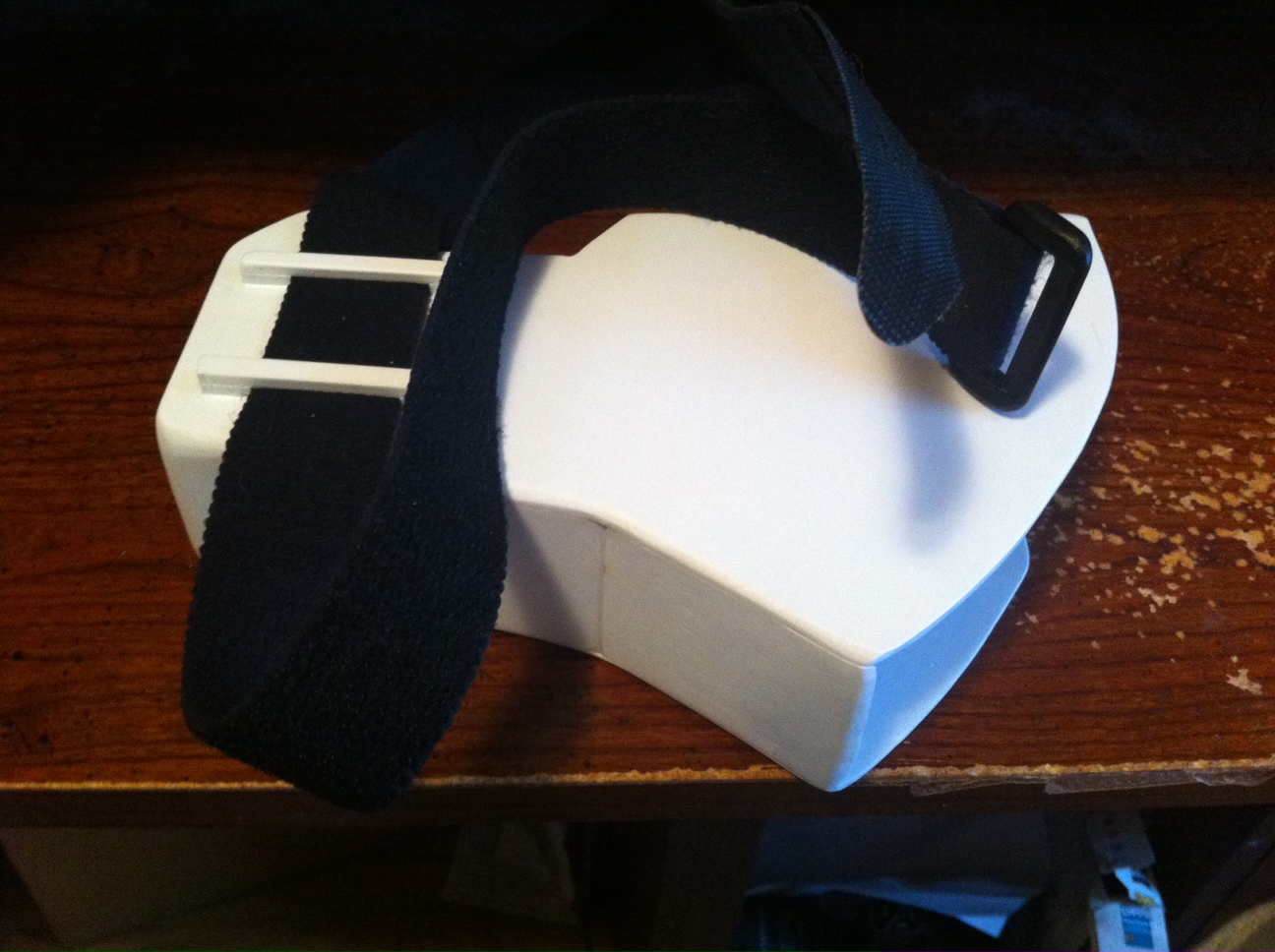

Haven't been able to do much in the last few days but a visit to LOWES for supplies also provided the Thigh Strap (1" Black Velcro) I was looking for. The attachment points are simple plastic strip stock cut to shape and it's ready for the next step.

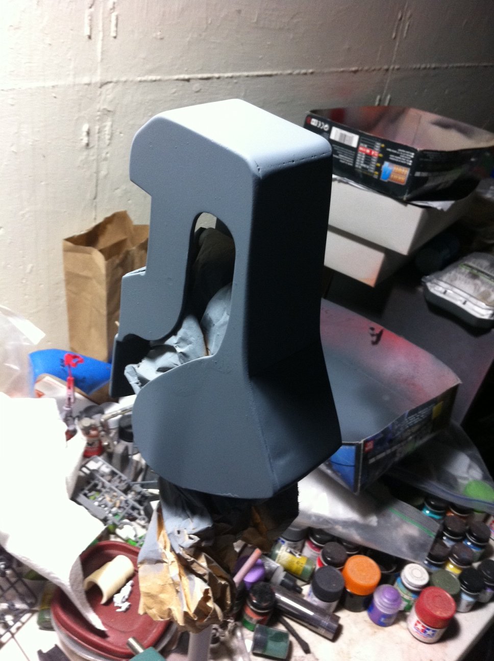

Minor update today folks, 1st primer coat has been applied. Pictures below;

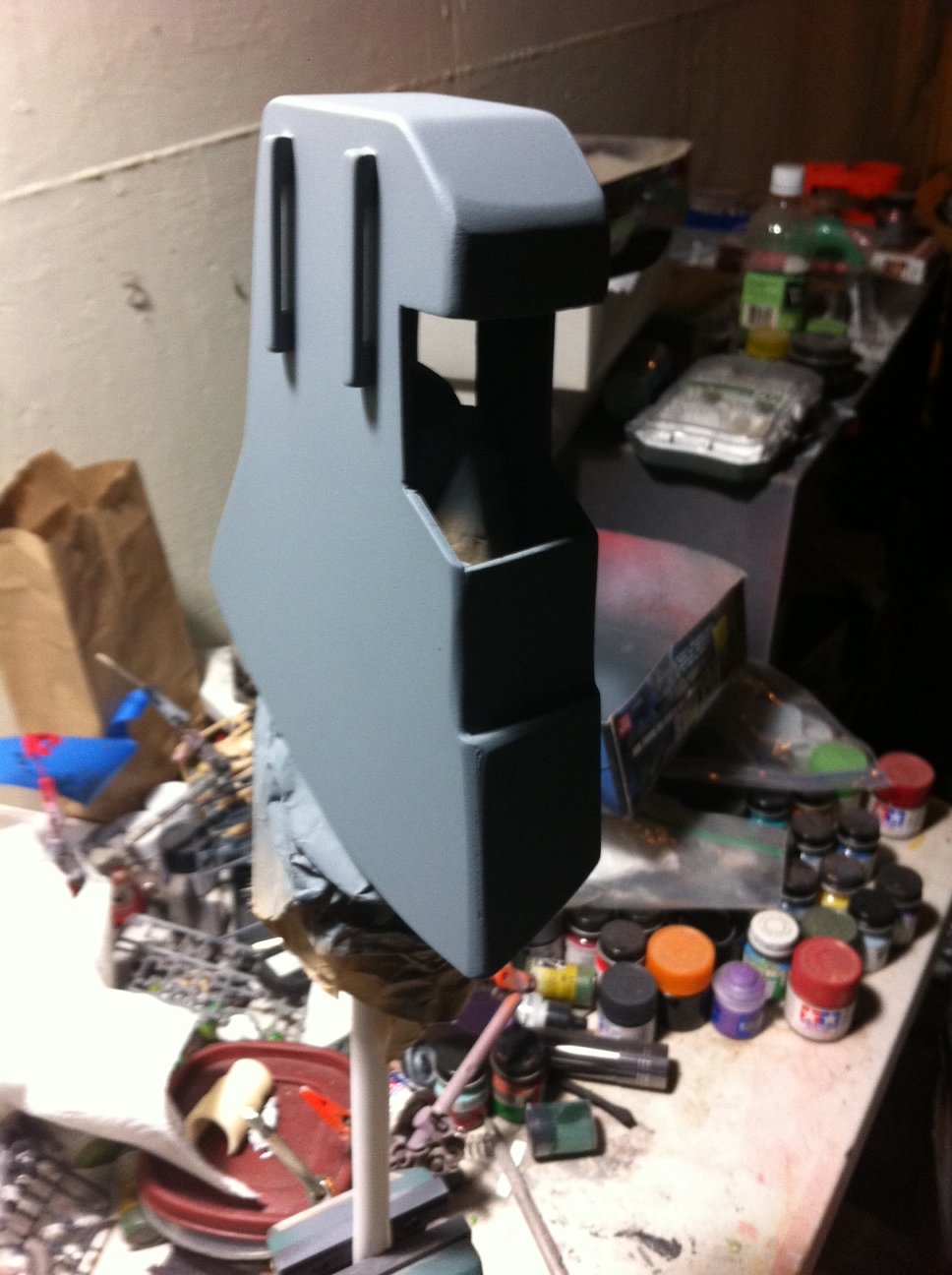

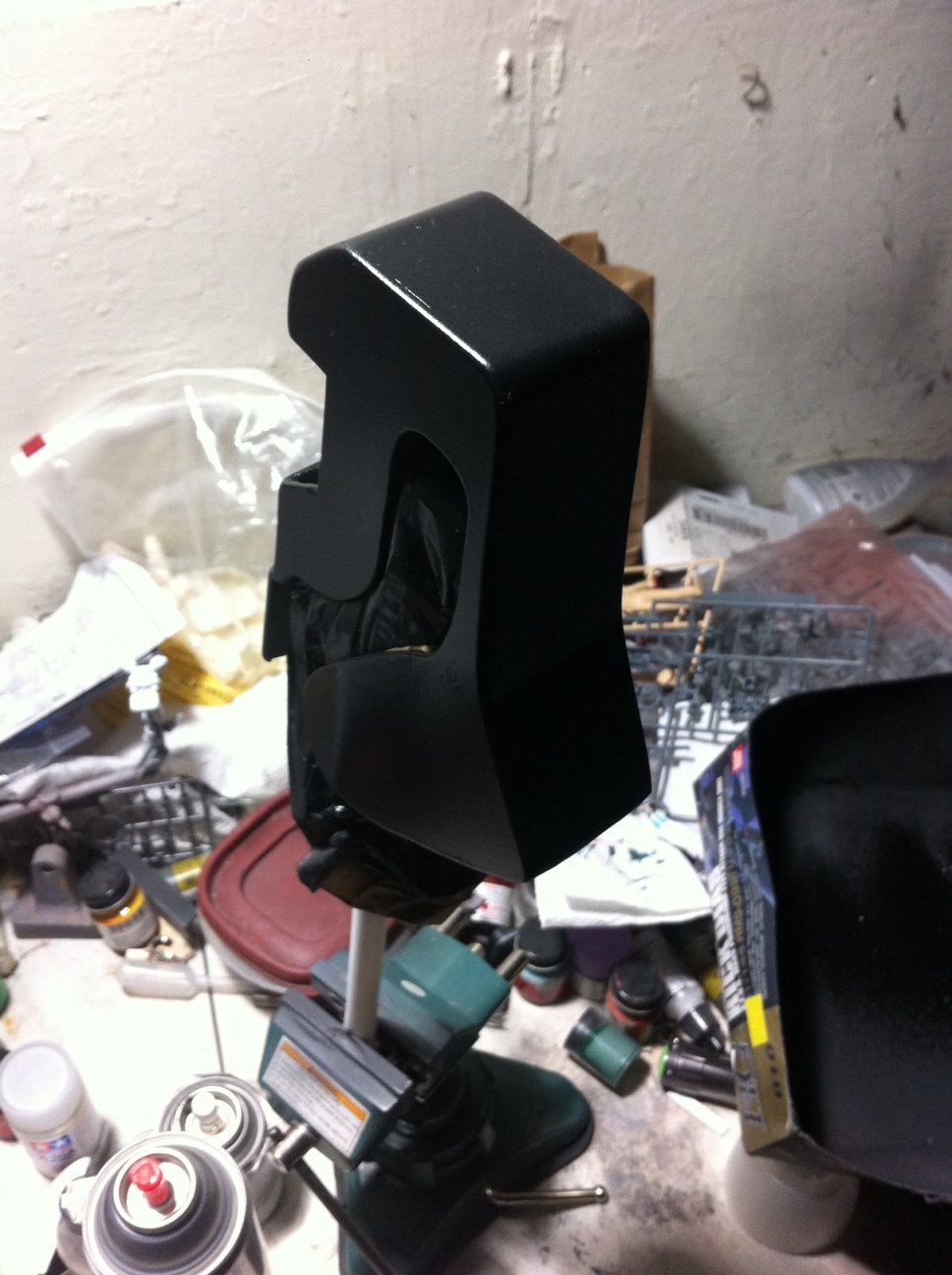

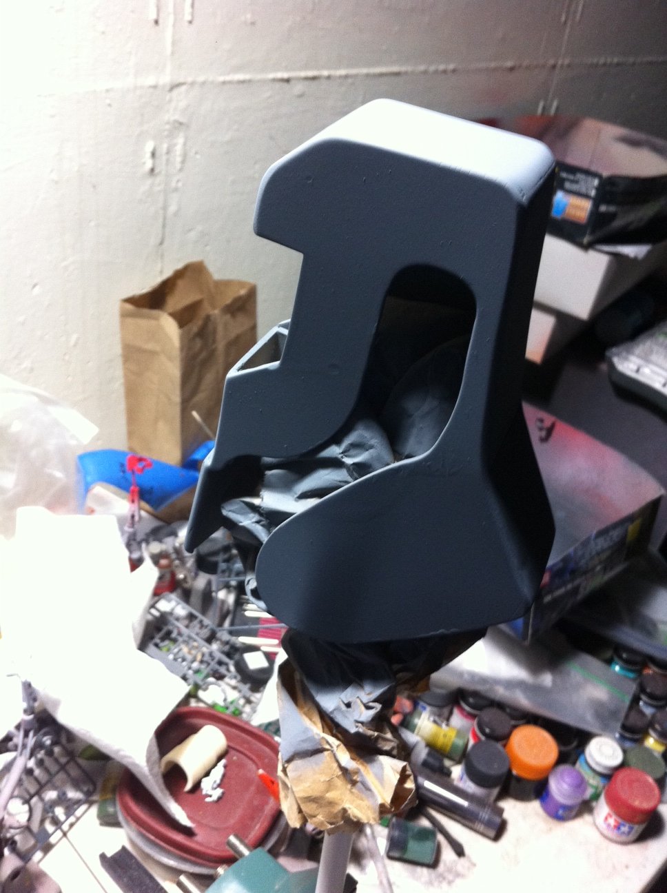

Another update today folks, 2nd coat of Clear Satin over the Flat Black. I like the finish but next time I might try something a bit different. Picture below;
Oh by the way the white specs on the nose was a bit of dust, it didn't stick to the paint given it was dry and blew right off after I took the picture.
Once again forget me for the "really" messy bench in the background, I'm still working on some Anime Mecha kits and a Heavy Gear Gaming Miniature and well I shoved them to the side to start painting the holster.
