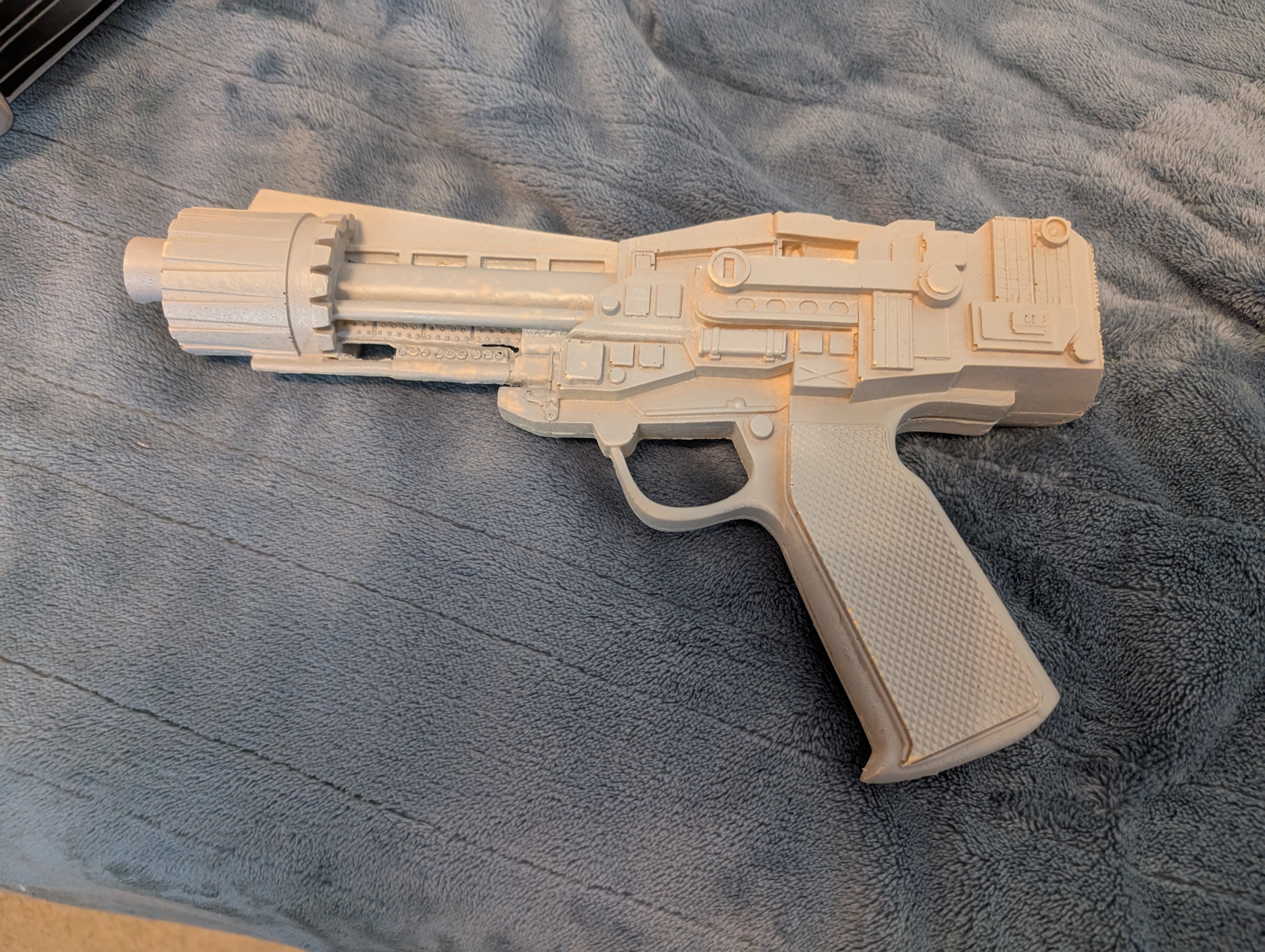

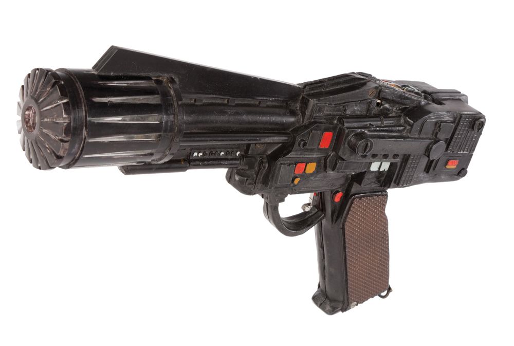

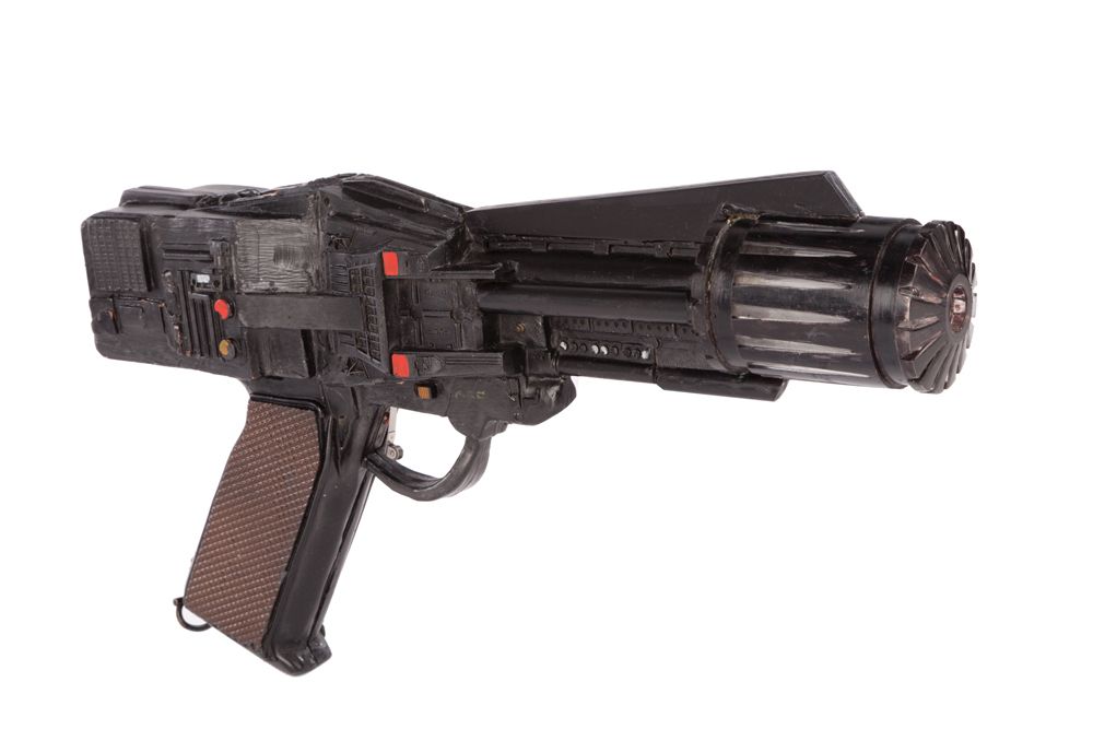

First, some of my inspirations for my design. The gray one is a flawed solid resin cast blaster that I got off of eBay many years ago. I wanted something cheap to use as a visual reference, and only in hindsight do I realize that this could very well be someone's recast. (sorry if it's yours, I did not knowingly buy a recast at the time) I used this only as a visual reference, I did not do anything other that look at it. My replica will have lights and sound, so I would add Factory Entertainment to my list of inspirations. I looked and listened to their product and will take all that into consideration when building my replica. The last two blaster pics are of an actual HERO prop working blaster that is the only known surviving blaster that had the FLASH. Since mine will have a working light in the emitter, I used the skinny-in-the-front wide-in-the-back transparent parts in the emitter like the surviving HERO. (some blasters are reversed) I made some design choices on my blaster to make it mine. It is not an exact copy of any one blaster.

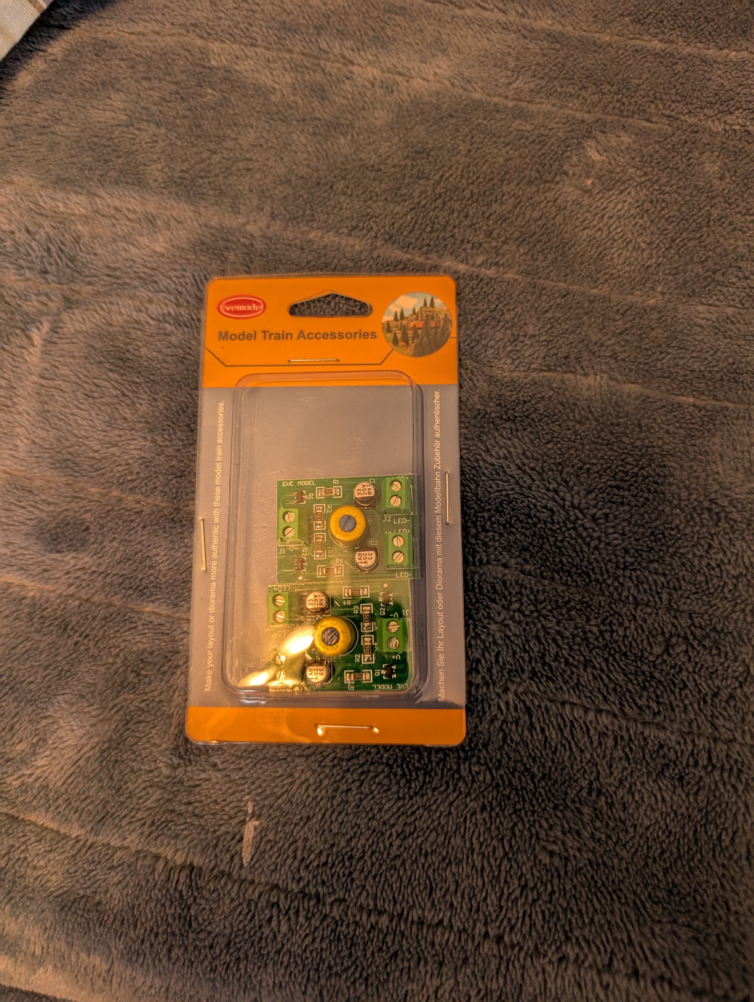

After minimal research I found a small device that alternates between two outputs of LED's. But I'll only hook up ONE LED. It has programable HZ timing. Meaning you can set it for 1 second on each LED, and it would normally light LED 1 for 1 second, then light LED 2 for 1 second. But I won't have an LED 2. So, It'll just light LED 1 and then turn off. You have to remember to let off the trigger after you fire or it would come on again after 2 seconds of holding the trigger have passed.
It should be noted that this board will NOT work with just one LED. Two must be hooked up.
