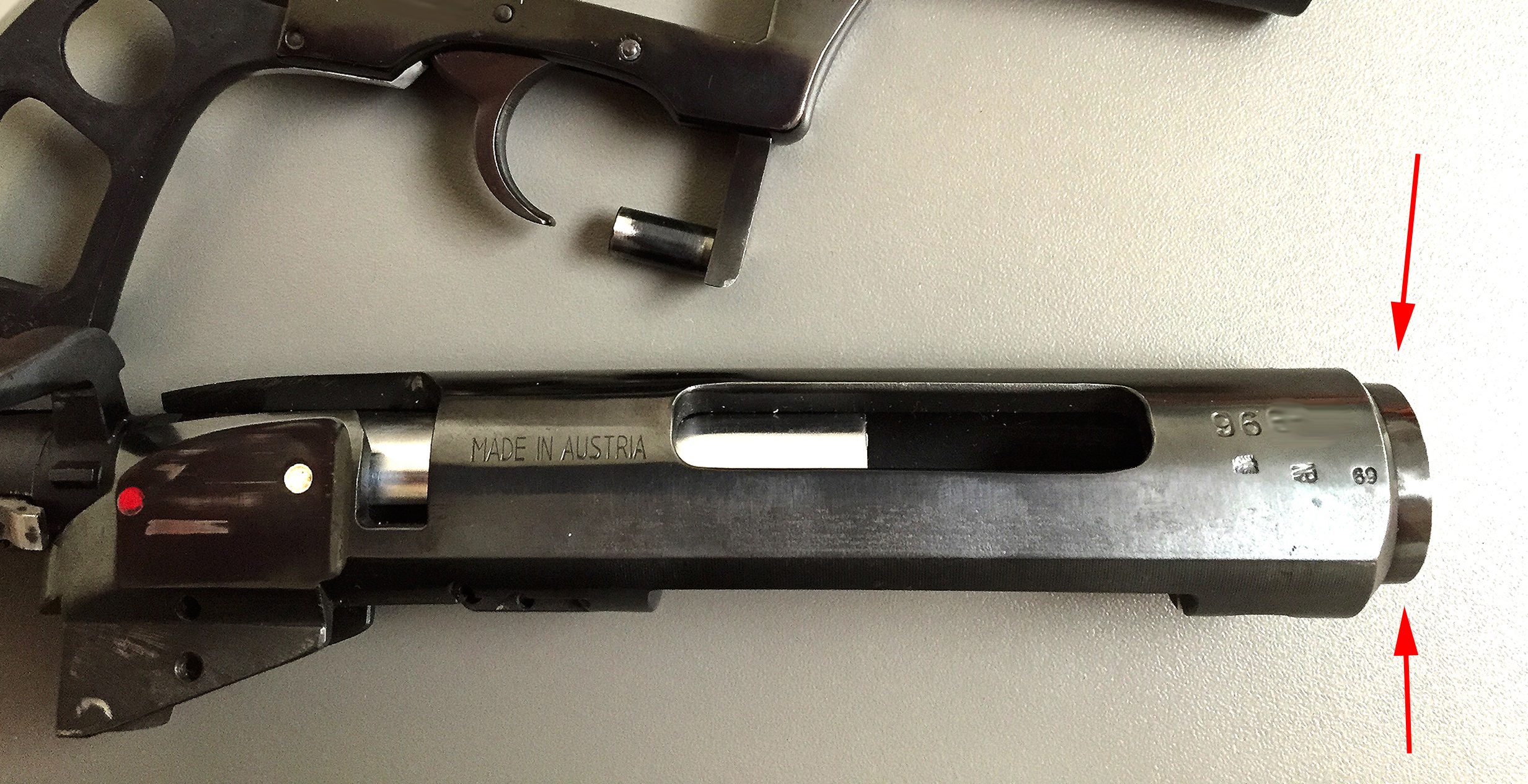

We worked on a couple of the Steyr receivers today. We removed what was left of the barrel, it was torqued into the threaded upper receiver. I am hoping I can mill it into the end cap of the upper where that pin like rod extends. One caution is clamping the Steyr with its asymmetric shape and polished surfaces. We 3D printed vice jaw covers and use a Kurt vise on the milling machine. Once you open up the bottom of the Steyr on the final mill pass you risk the receiver piece collapsing a little from over pressure from the vice and no support on the bottom since you've milled it off. We may put a filler piece in there to prevent crushing or to prevent the piece jumping out of the vice once the resistance from a once solid bottom disappears.

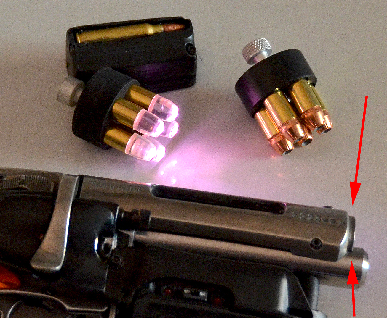

Since your barrel is attached, and removing it is harder than on typical rifles, you may have to do a relief cut on the bottom of your receiver. If you cut your barrel leave some stub on it as shown here. BarrelStub.jpg
ReceiverCap.jpg There is that end cap piece on the end of the upper where that rod / pin attached to the bolt protrudes from. Rich makes one but I may try to machine the stub into a cap since it is already threaded for the receiver. Lots of detail machining then you have to cut a chunk out of it.
BreechCap.jpgHere is one from Rich mounted on my first shooter.
