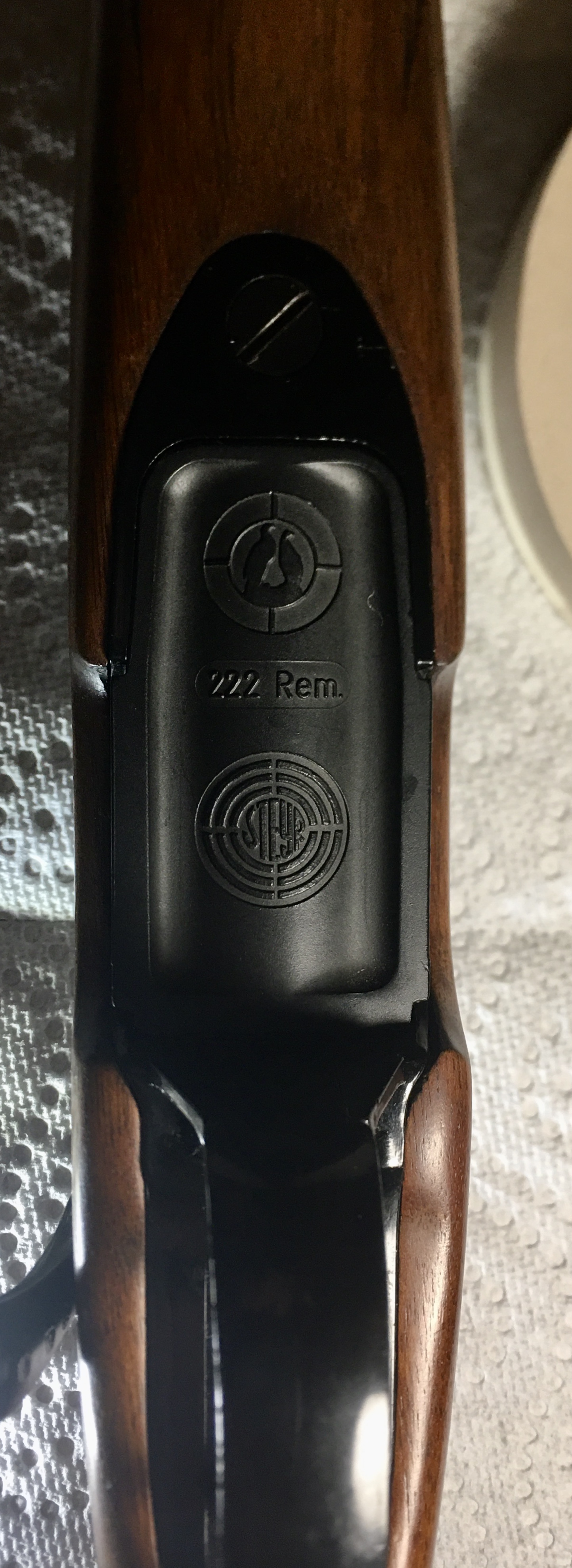

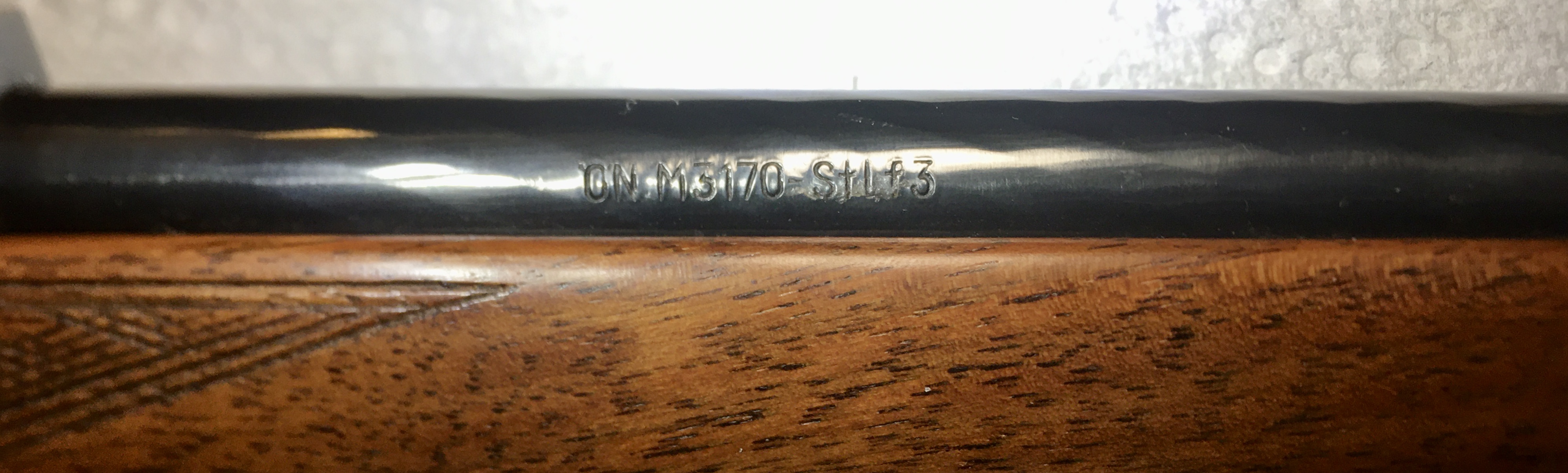

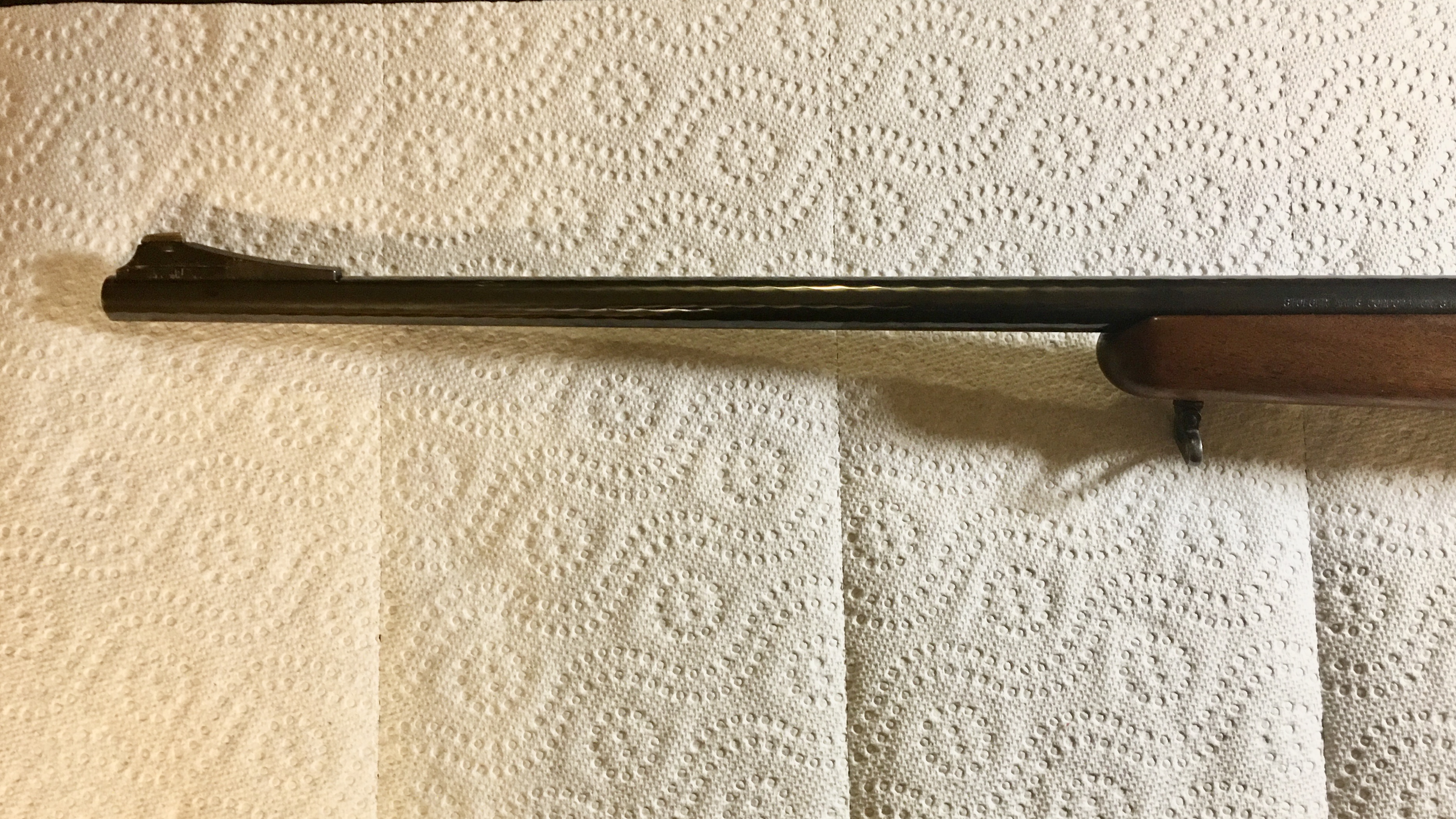

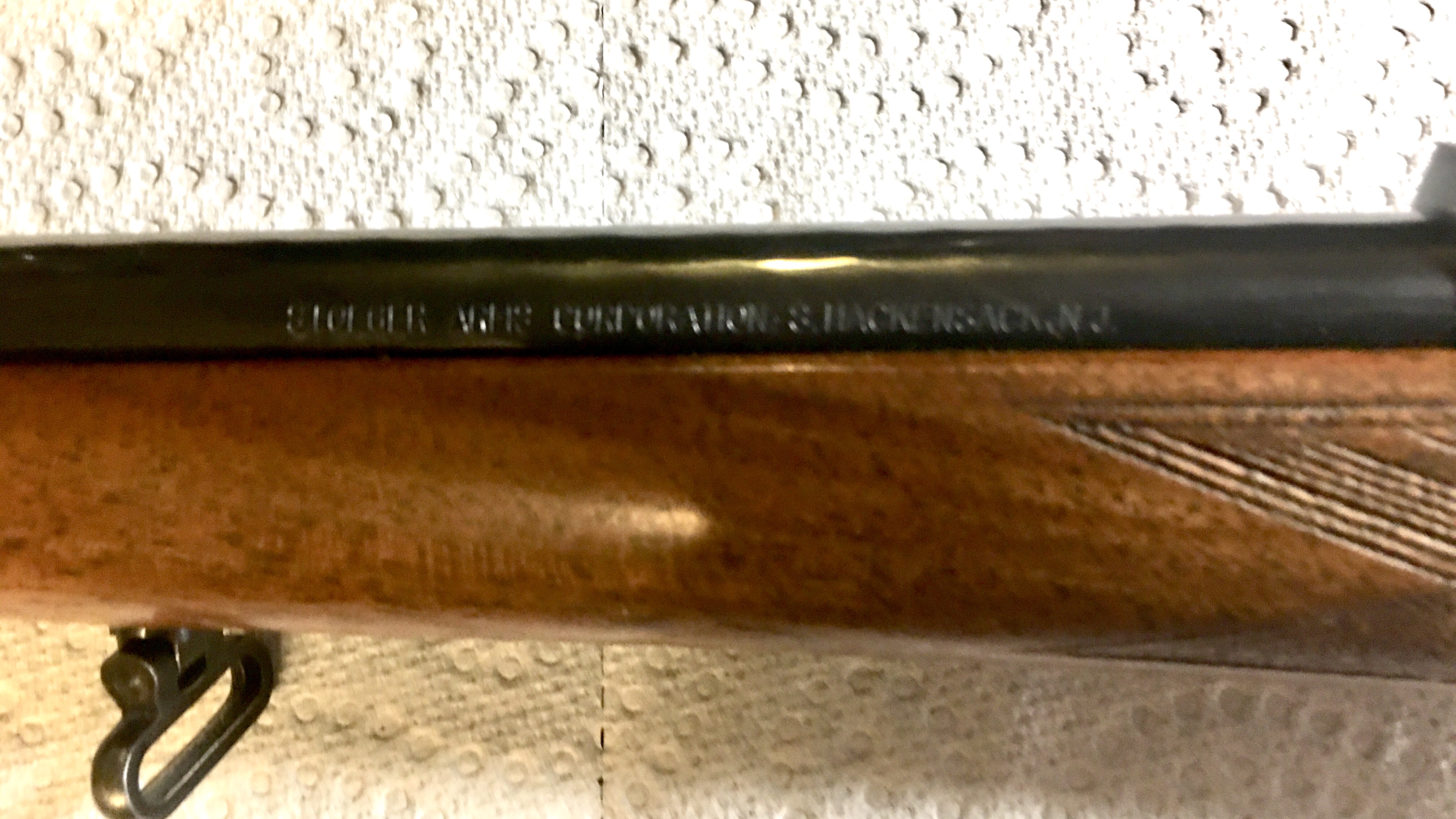

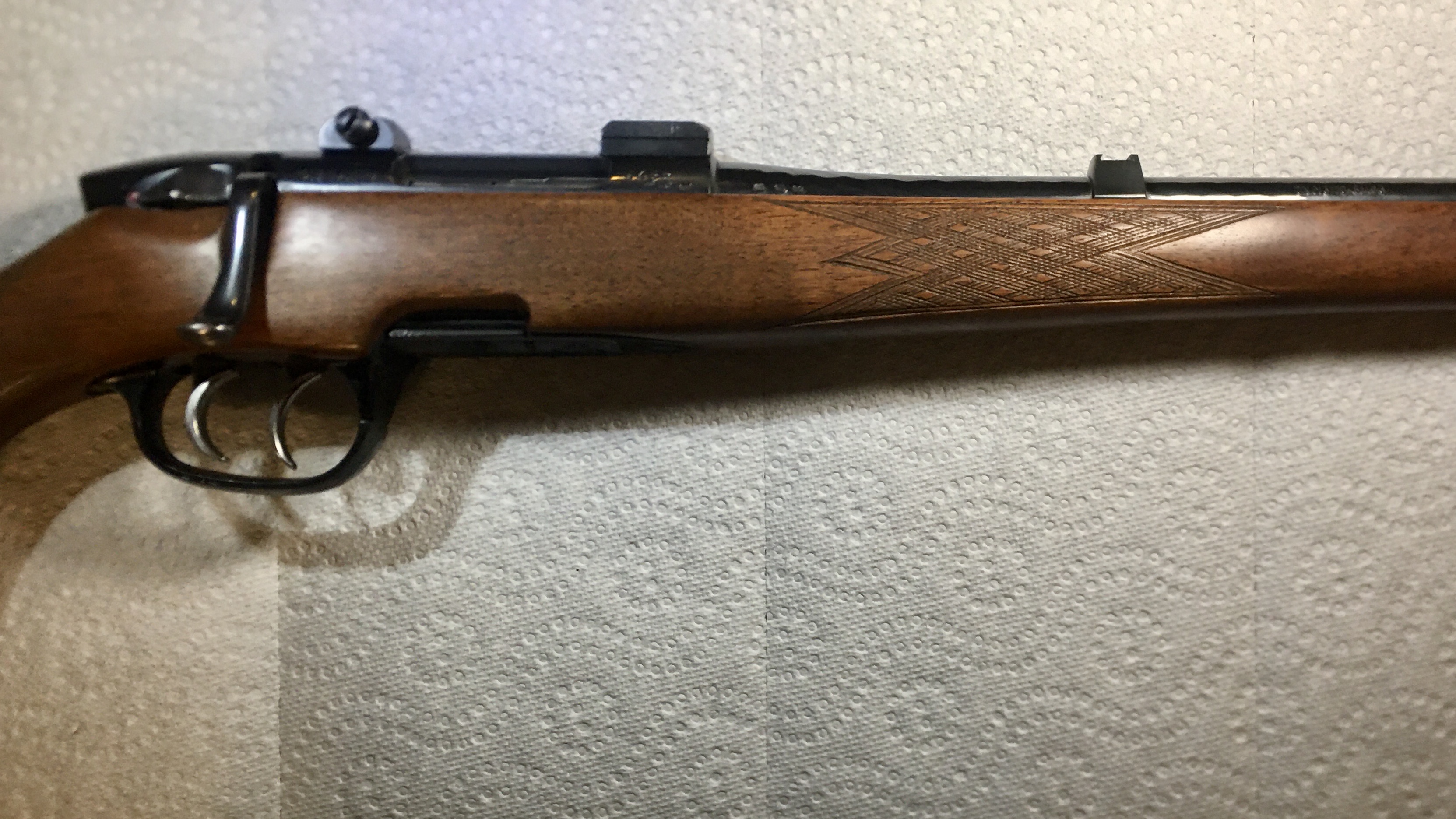

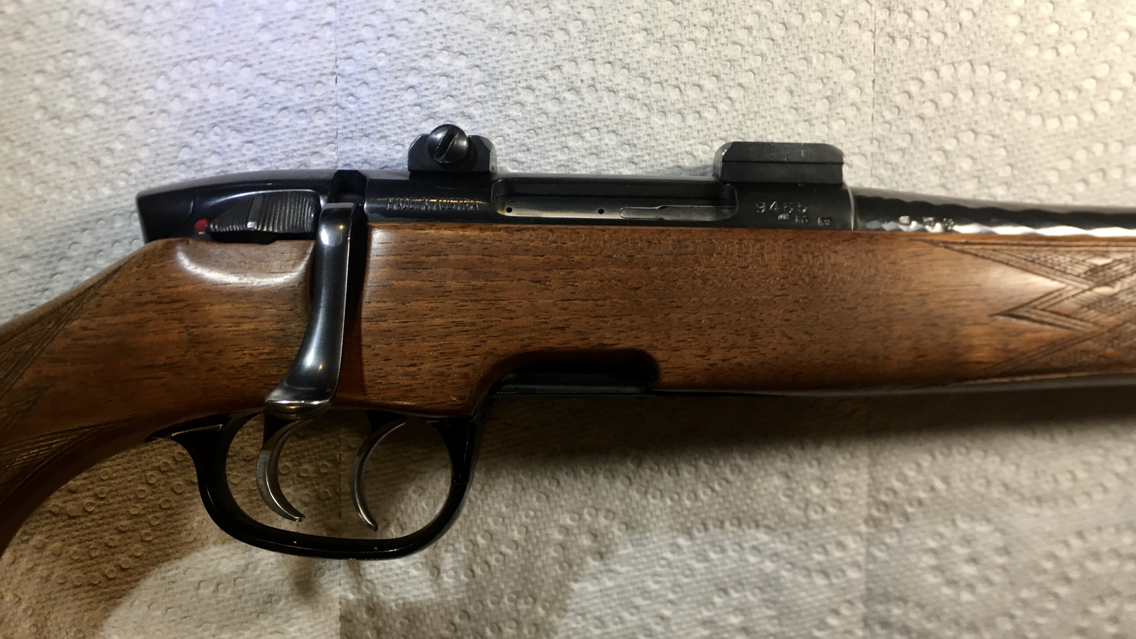

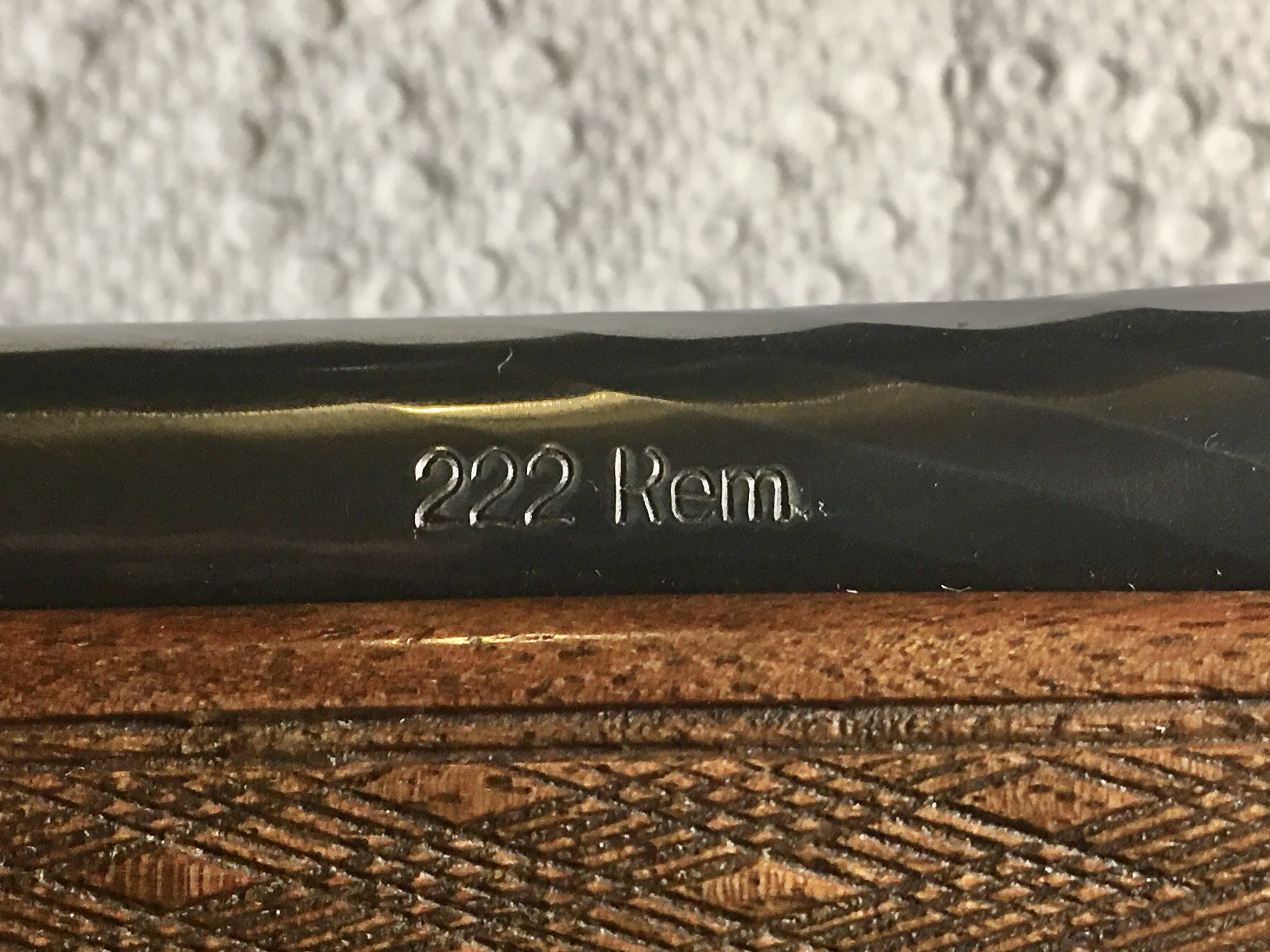

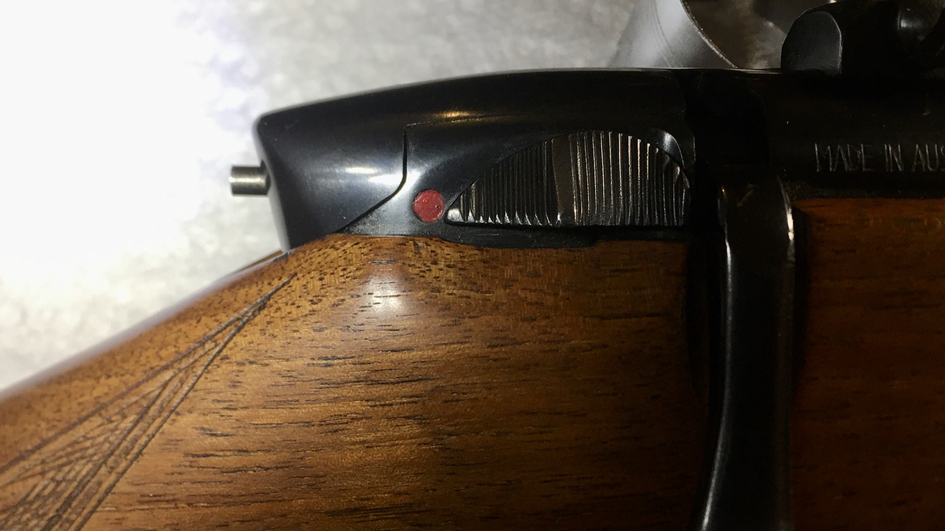

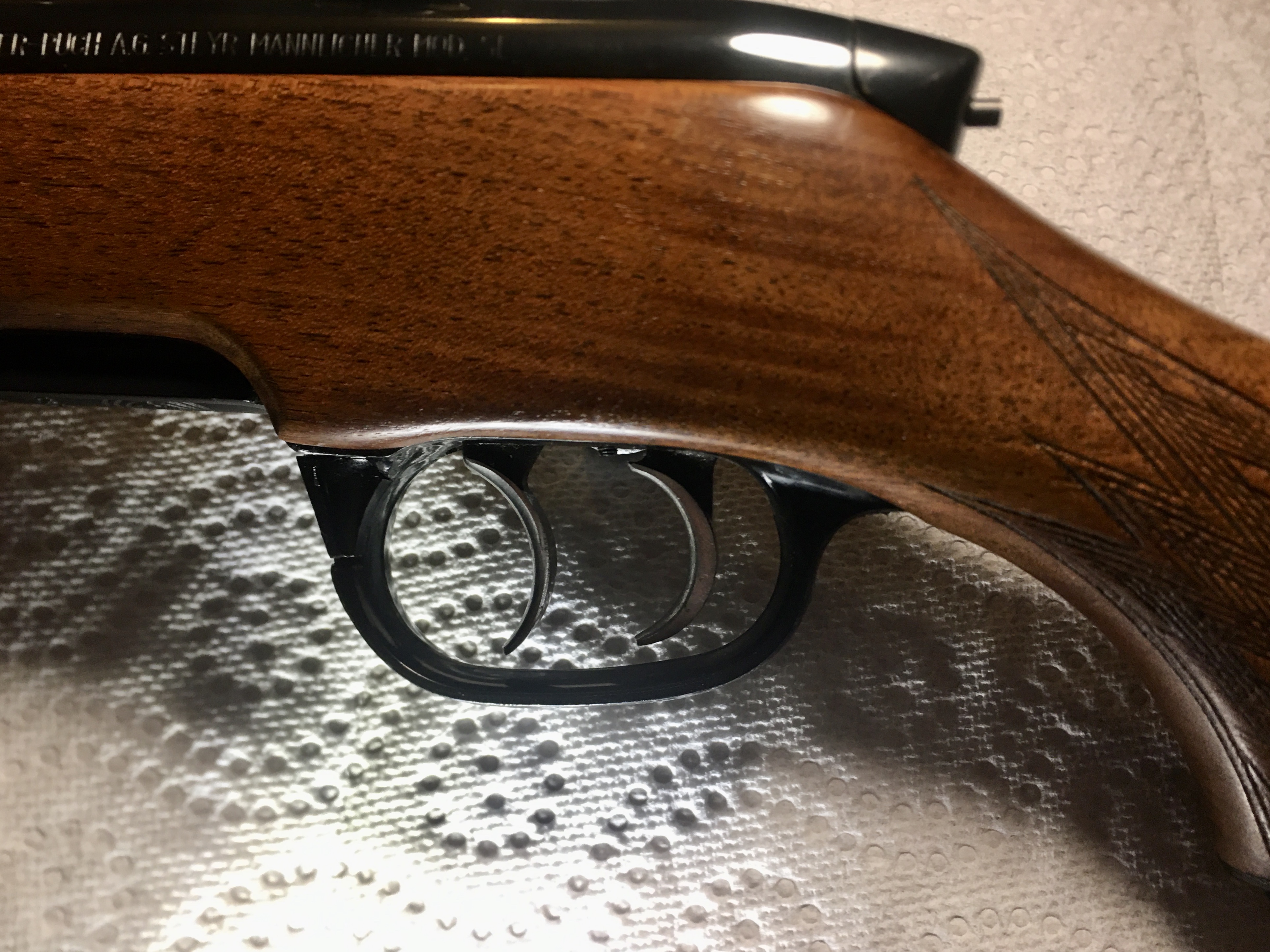

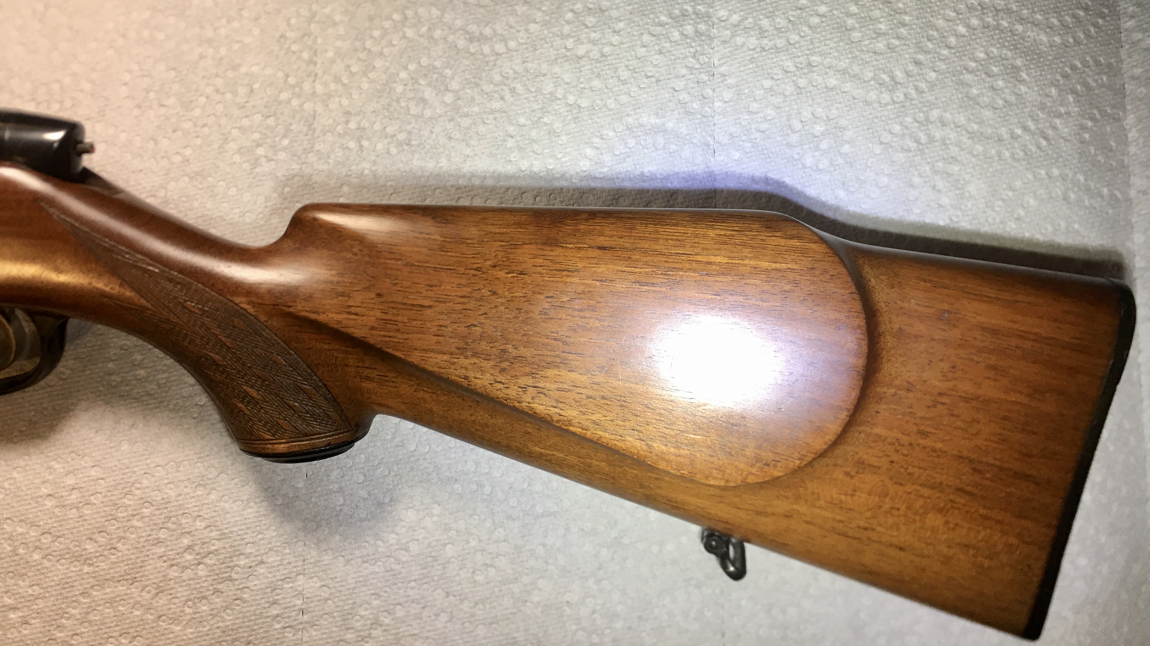

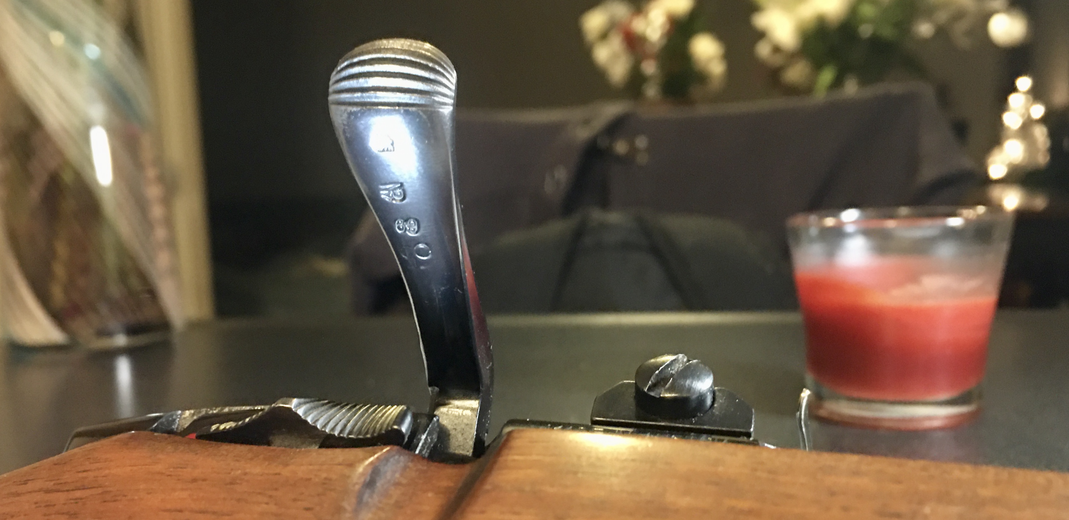

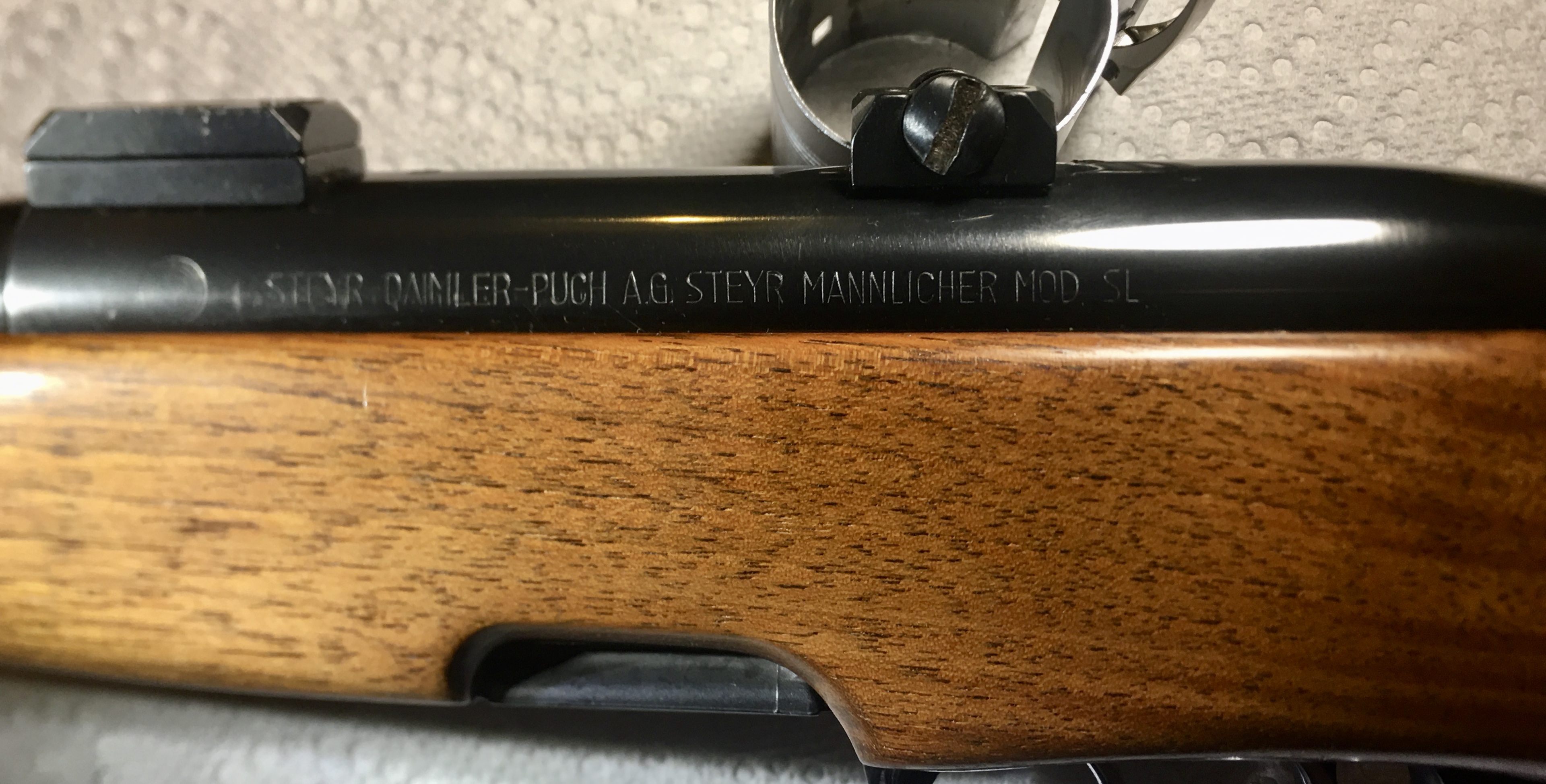

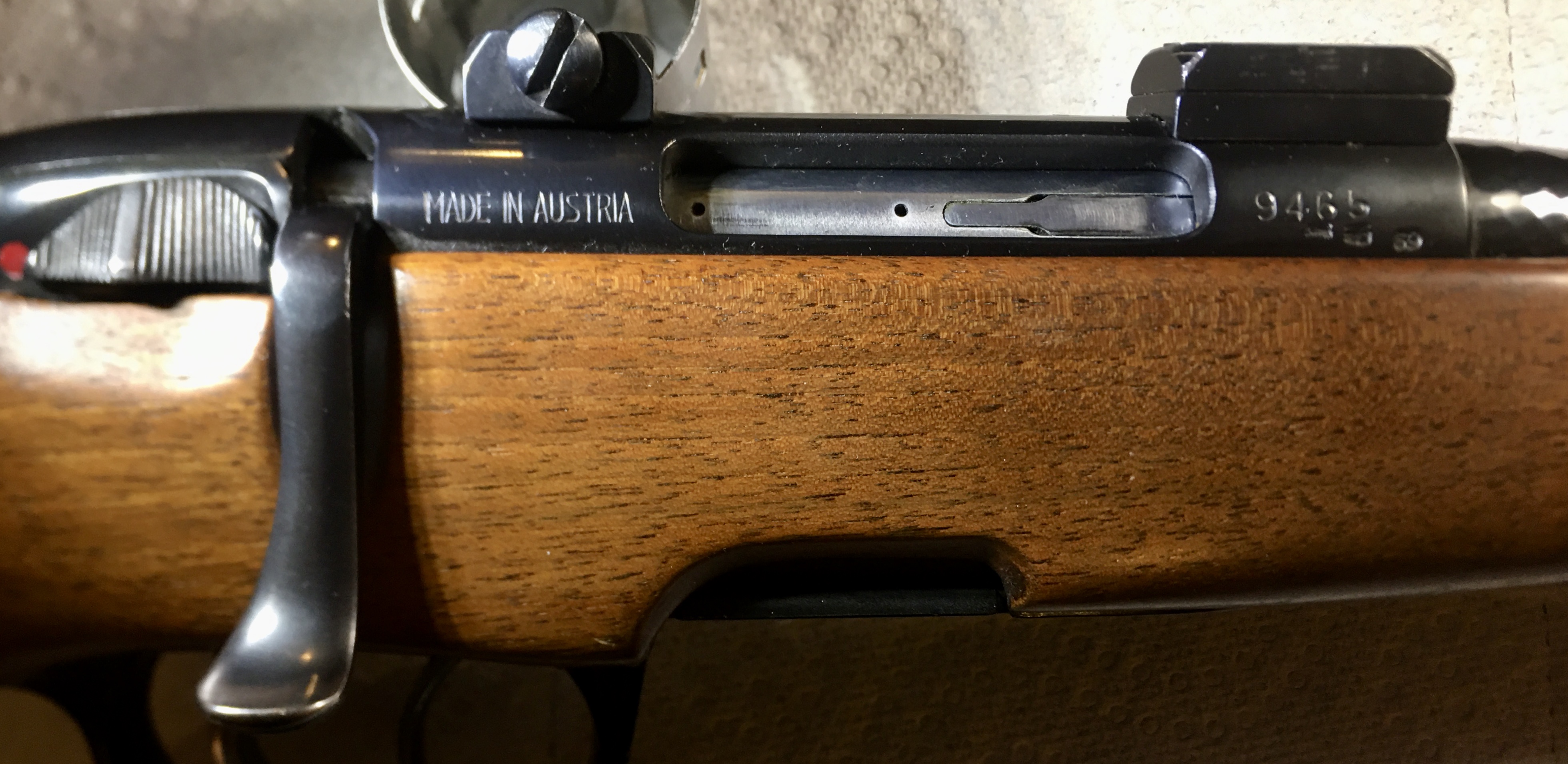

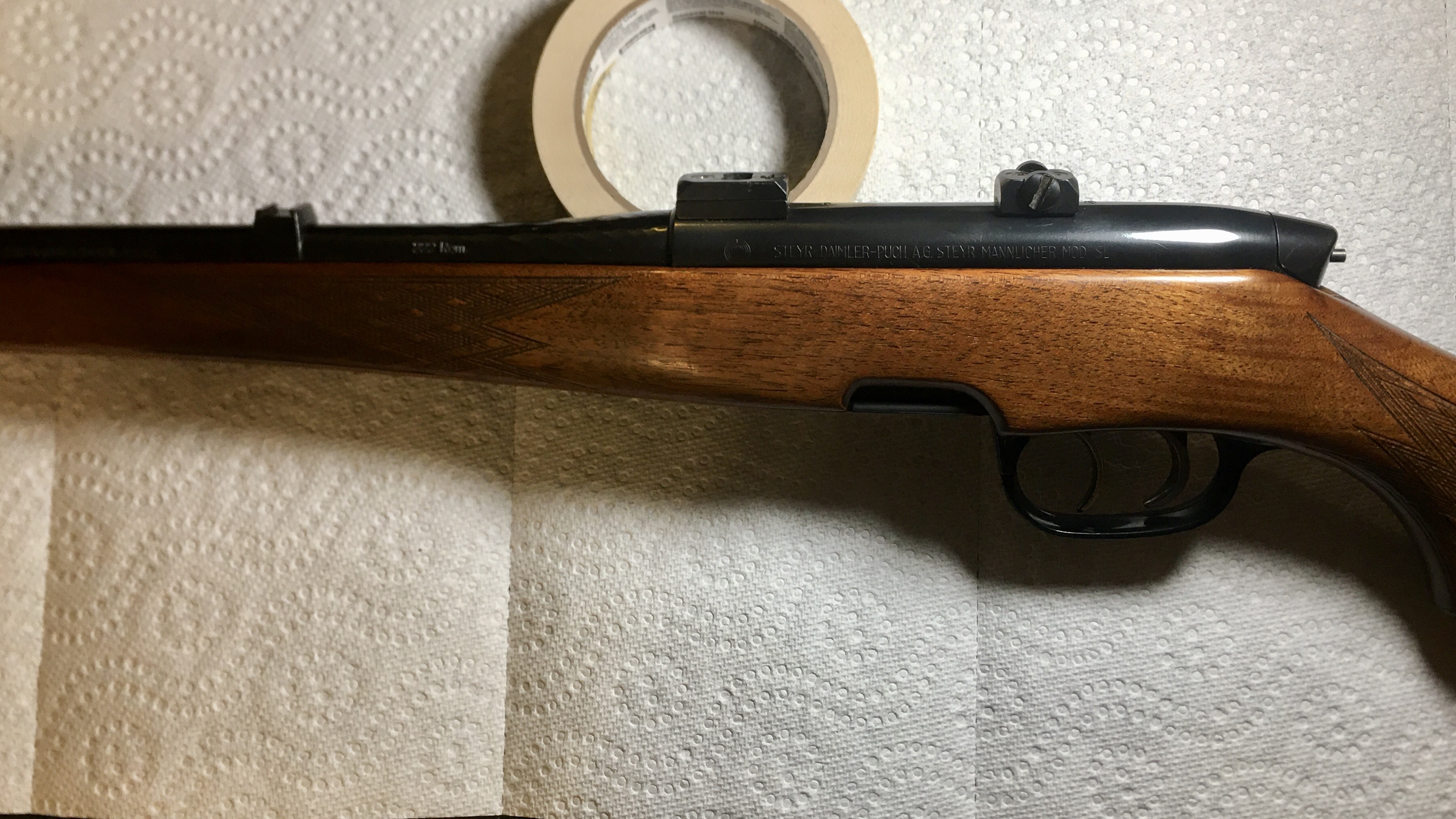

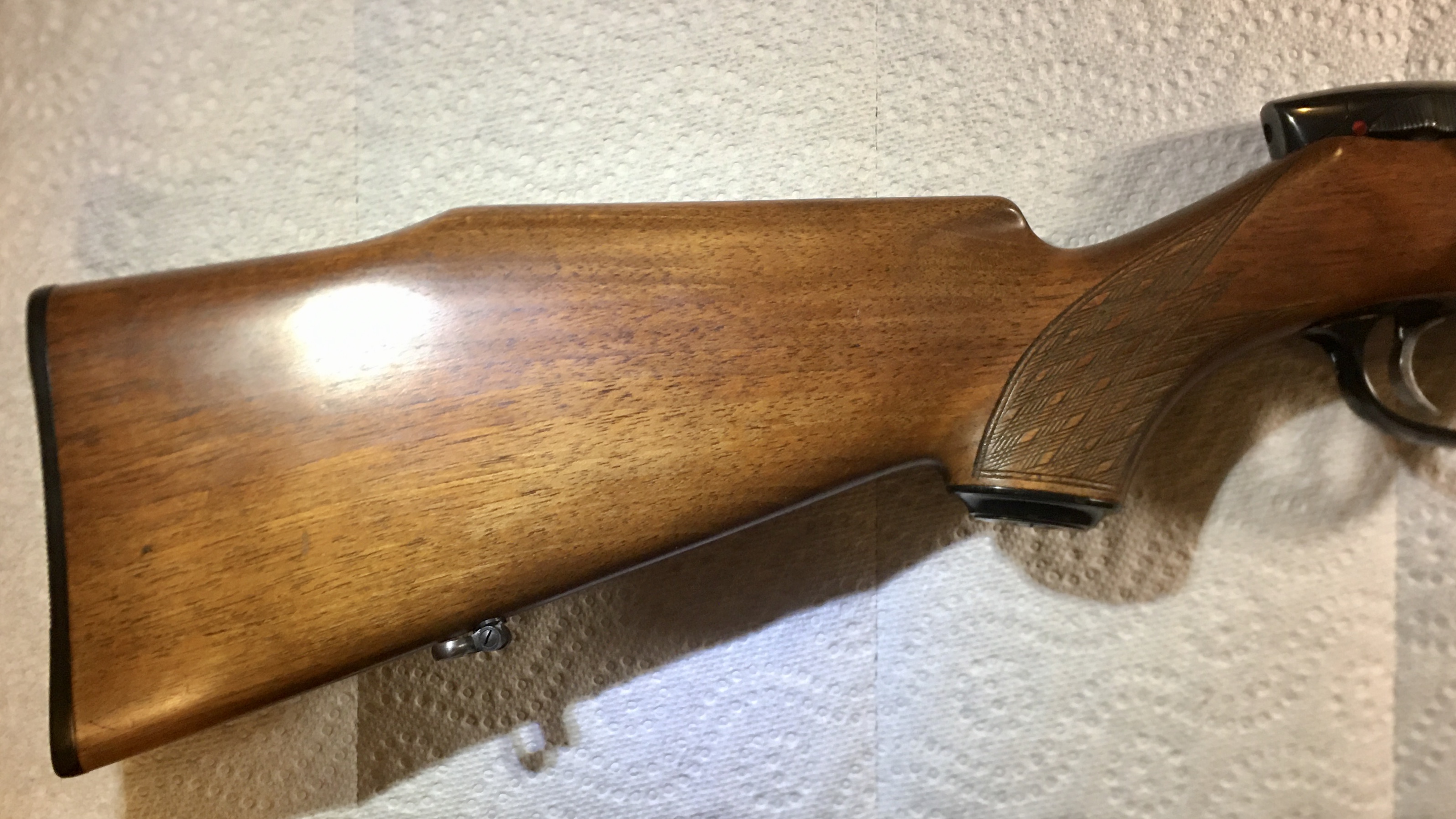

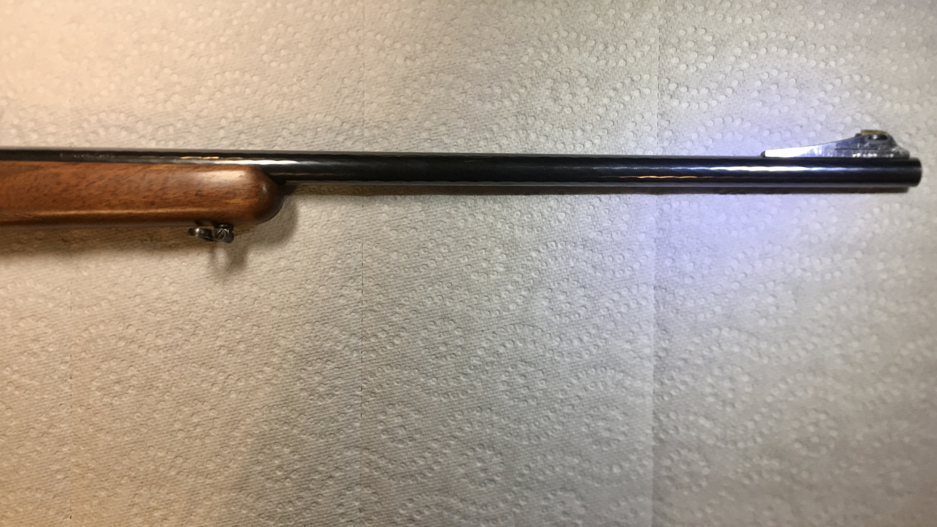

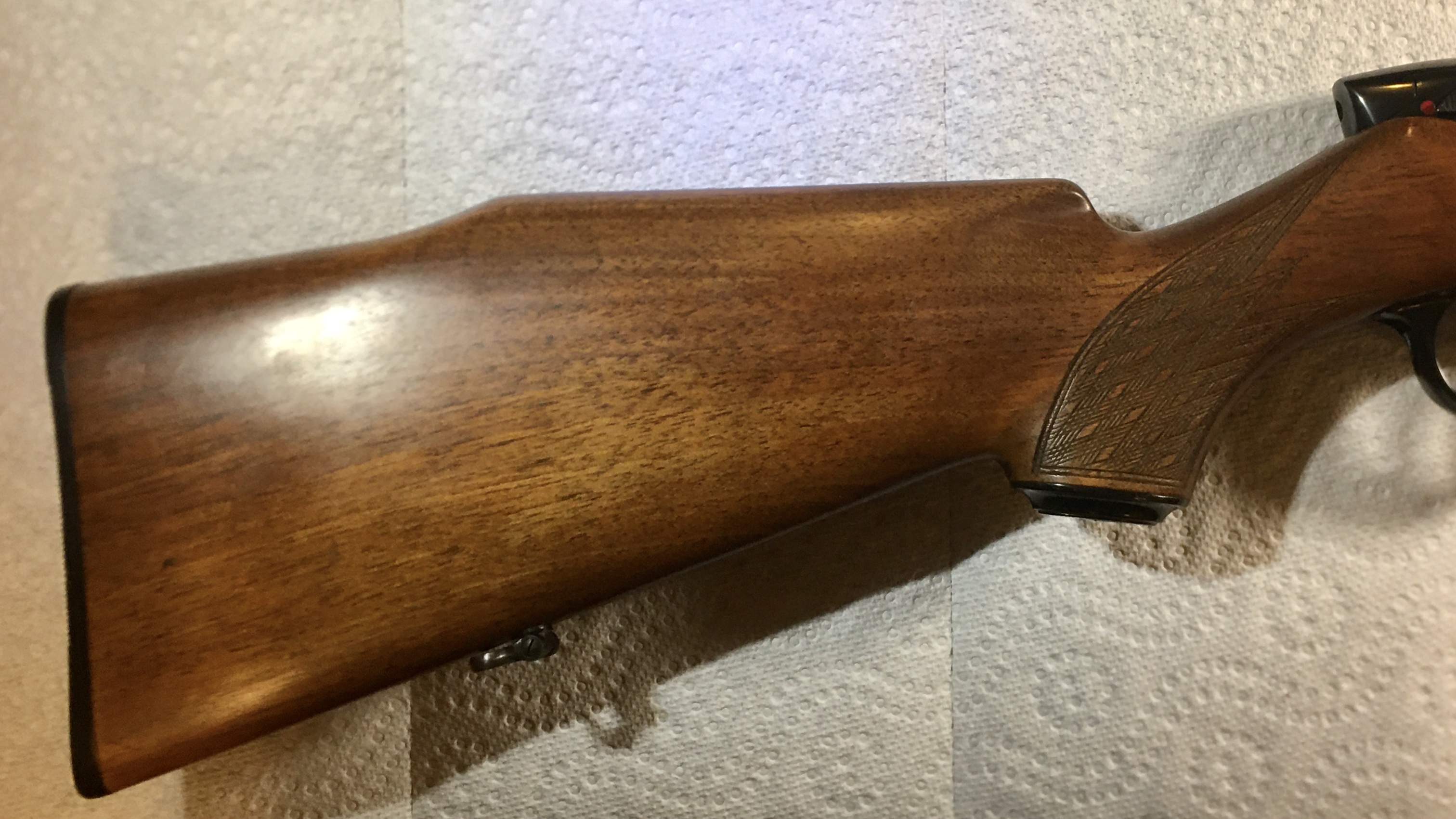

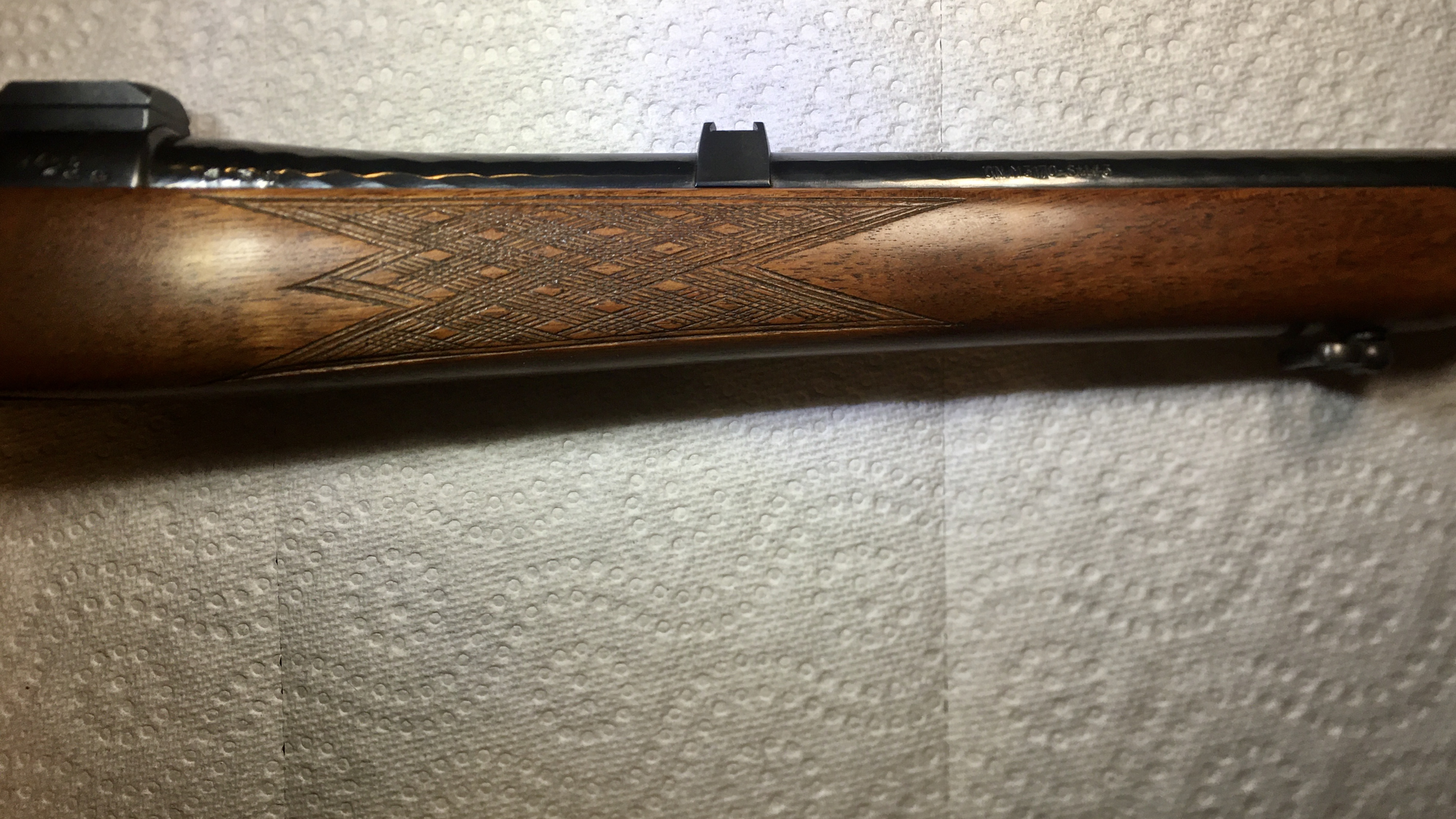

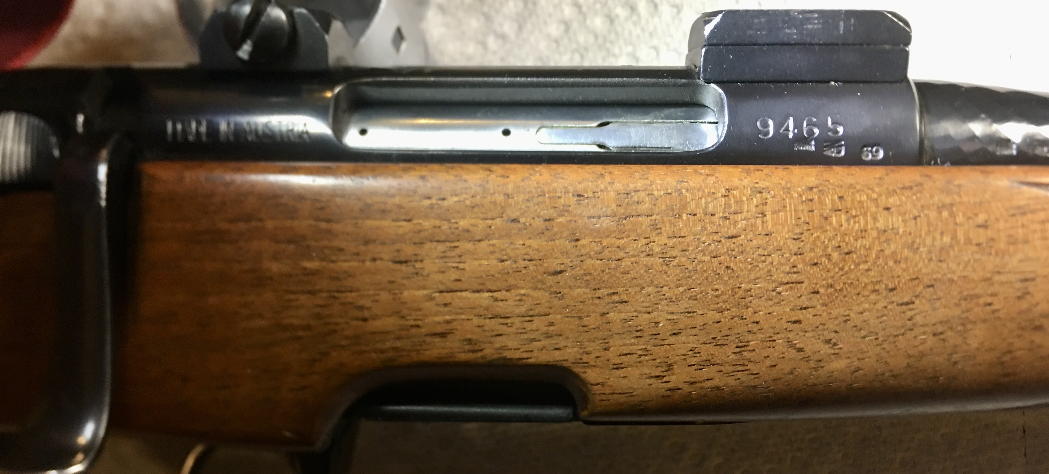

Okay, as promised, here are the pictures of the Steyr that has since arrived into my evil clutches... I apologize for the terrible lighting and as such will post them here, in no particular order, as thumbnails (mostly):
4B30CA06-EB95-431A-8F04-3C11AE8D0FAD.jpeg6D143EF4-B91C-41EC-930A-7A0015F3280F.jpegC8CFCCEE-5F8C-4EEB-A7F5-8C75CACFAE70.jpeg
96F772D8-A7DB-4F7A-9D5E-A5DEA7490F2E.jpegC09C2473-C99B-4C9E-B396-8ABF92F6D436.jpeg30066EEF-F6F3-4094-A959-9A111C1D75A3.jpeg
699EE246-27A2-4253-BAD7-7EFBA882FBF5.jpeg29B98844-0A7C-44C8-90DA-1952D1032A28.jpeg1EAFCEE9-6963-4203-8B27-FC63011CD760.jpeg
66FFECC9-FBF1-4A70-88AE-CB3B4ABA6A0F.jpeg847813E8-12A2-416E-8F91-C878AB9438B3.jpeg6790FAA9-6508-41F1-BF05-F6090CE28378.jpeg
E7389878-86E9-48CA-AD98-E06A33DC6CBF.jpeg6C9FBB8F-E965-47EB-9666-6166F2ED42EE.jpeg0C22CDE2-7712-47BC-AA3F-722AE6CAFDAD.jpeg
6AEE4A2C-F80A-406C-8C56-3C7272617399.jpegD0910F30-D5C1-42D6-B59B-D26790350705.jpeg84210E66-3B69-4458-B410-C612A3638287.jpeg
So there you go. I hope it was worth the wait for you... I know it was for me.
*For those wondering, whom have not read in other forums about the specifics regarding the double-trigger in the Steyr, please allow me to explain. This trigger set-up is called a “double-trigger” or “set trigger” type of fire control group.
It is dissimilar from most two-trigger fire control groups in that the two-trigger fire control group most people recognize is for a double-barrel shotgun in which one trigger usually operates firing (or activating the fire control and discharge of a cartridge within) one of the barrels, and the second trigger doing the same for the other barrel and action. For this arrangement, the barrels, actions, and triggers are more or less side by side (usually one a bit forward of the other trigger too). Double-barreled shotguns are often refered to as “SXS”, or “side by side” when the barrels are next to one another, or when the barrels are arranged in a vertical line, the shotguns are called “O/U” or an “Over-under”.
The two-trigger set-up of the Steyr (and other Set Triggers systems like it) is the Steyr’s Set Trigger fire control group are not designed as two separate independent fire control groups operating individual barrels or chambers and firing mechanisms which simply happen to be paired together in a single firearm, rather the two triggers of the SL make up a part of a single fire control system designed to operate a single barrel and action in a single firearm, but in two separate ways.
The first way is the standard way most firearms are operated: pull the front trigger (I will henceforth refer to this front trigger as the “break trigger”) and the Steyr will fire a chambered round. Nothing new or groundbreaking there. This “break trigger system” of firing a firearm is how pretty much how all firearms we are familiar with operate.
The SL (and Steyr’s other models within this product line series - Models L, S, and M) has a Set Trigger system that allows the shooter to change the pull-weight for the break trigger. Pull-weights for break triggers (or solitary triggers within a fire control system) fall across a wide range but popular consumer firearms are divided into sub-groups based on intended usage and purpose share smaller, and focused ranges of trigger pull-weights that differ between these sub-groups. It is probably most easily illustrated in the sub-group of handguns meant for self-defense or concealed carry in that the vast majority of semi-automatic striker-fired pistols run within one pound (in either direction) of a 3.5 pound break trigger pull-weight.
On average, bolt action hunting rifles, like this Steyr Mannlicher SL, tend to settle around a 2.5 pound break trigger pull-weight right off the shelf.
The steps to change the pull-weight for the break trigger of the SL is to pull the “set trigger” (the trigger in the rear) before firing the rifle by pulling the break trigger. By first pulling the set trigger, the required break trigger pull-weight is reduced to a mere 8 ounces!
For competitive shooters, ace marksmen, and avid hunters this is incredibly special as it should allow crisp precision shots by negating many of the common errors in precision shooting that happen during and after the break, much like golf, somehow it is the follow-through messing everything up. But taking the breaking point of the break trigger from 2.5 pounds down to 8 ounces would likely cover a multitude of sins.
All this info and exposition is to say, oddly enough, that although Deckard’s blaster does have a double-trigger, it does not function like the Steyr, nor does it function like a SXS shotgun. In fact, the front trigger on Deckard’s blaster doesn’t do anything at all! Further, the two triggers on Deckard’s blaster aren’t even from the Steyr!!! They are two Bulldog triggers.
So one of the greatest actually tragic losses in completing this build is the scarificing of this remarkable Steyr SL’s Set Trigger fire control system and the ingenious and masterful shooting experience Steyr had packaged along with it developed in the heart of Austria.
